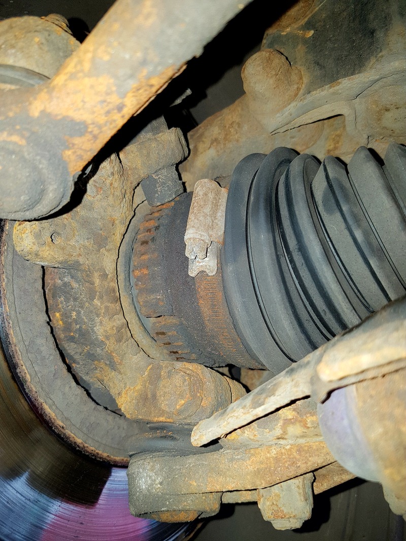

However, it looks like my hubs have had abs sensors at some time (172 cup) so not sure what driveshaft I have on the car. Any way to tell?
