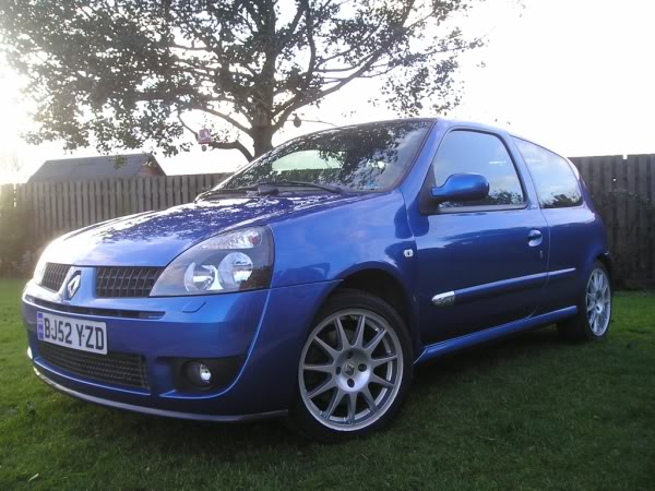

can you put a pic up of your front end please mate?

the wings come out further then the 4" as its really striking on how flared they are actually after i compared mine to Chris' 182 !
Ill add a piccy in a sec if i can find one
Has
  RS 182 - Black Gold
Bodyshop absolutly hated me for it.. i was really fussy and wanted it spot on. All reno mounts used. Had so much doen to get it on i was checking progress every day over the whole week they had it.
Has
  RS 182 - Black Gold

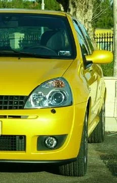

Compare how it is on this 182, you can see the wing sticks out a hell of a lot more. Seeing one up close reminded me how far it does stick out on the 182 then mine.....

yeah cheers, see what you mean. Why was there so much work involved when all the mounts are the same? Isn't everything a direct fit?
