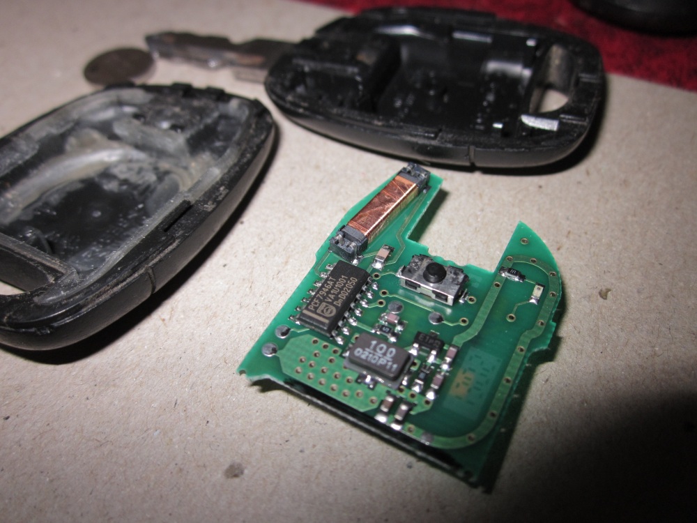

I've been reading about keys being a common cause of this... I've read the trick about pressing the button in when you turn the key, and putting the key in both sides, but that doesn't seem to help. The key looks in good condition. I opened it up to see what battery was needed and had a look at the circuit board while I was there, with a 30x magnifying lens, and I couldn't see any damage to the pcb or broken solder joints etc. I put it all back together and went to start the car but the red light remained solid for several attempts. On the 12th or so try, the car started normally. There was no flashing this time, so it seems to vary between "red light flashing all the time" and "red light remains solid" whenever it feels like it! After I drove the car, I turned the engine off and immediately restarted it twice without issue, but I bet in the morning it won't start easily.

When you took the key apart did you notice an oblong copper wound block on the PCB, or a small coffin shaped carbon chip, in the moulding of the plastic key body?
  Black 172
Thanks for the reply Matt, here's a pic that may help. It's a 2002 ph2 172.

The oblong copper wound block is the transponder. I think it is possible to gain the code from the key and have the copper oblong deleted and have a carbon chip burnt to replace it.
