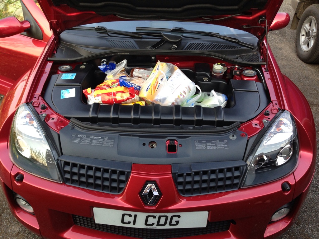

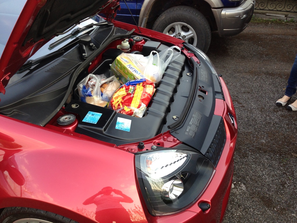

  An orange one
Popped out earlier in mine to do a spot of weekly shopping!
Never fails to amuse me the peculiar looks you get as you stick your shopping bags "on the engine" lol ;)
These cars are surprisingly spacious, 4 bags in the front and 3 on the ledge behind the seats! Done.
