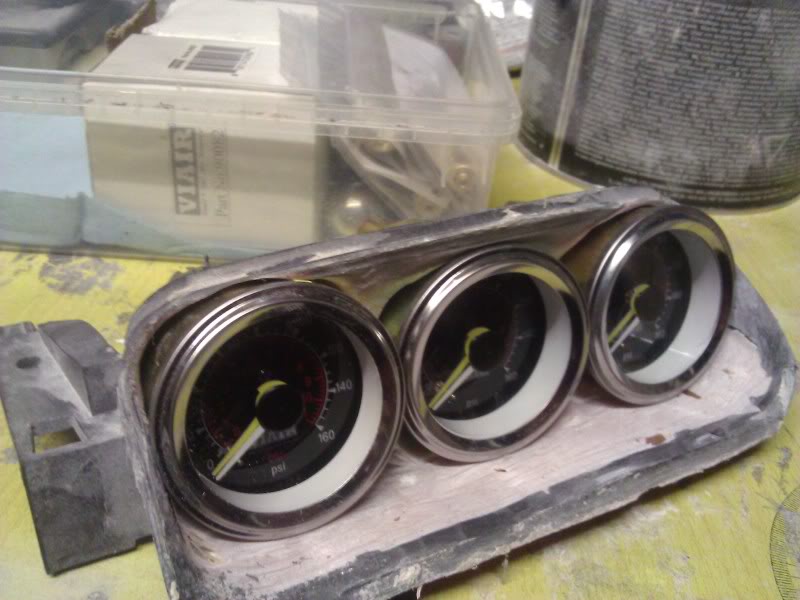

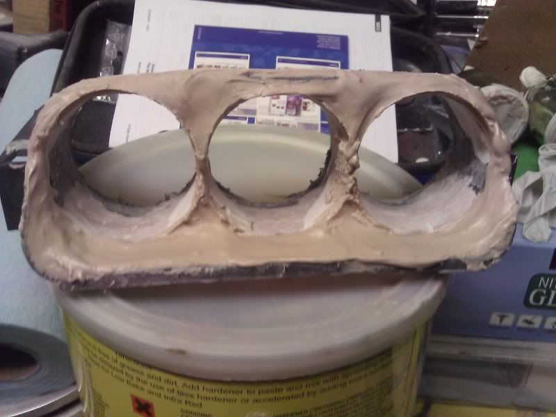

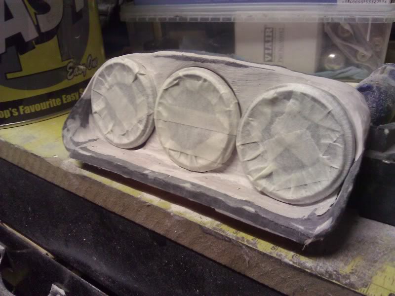

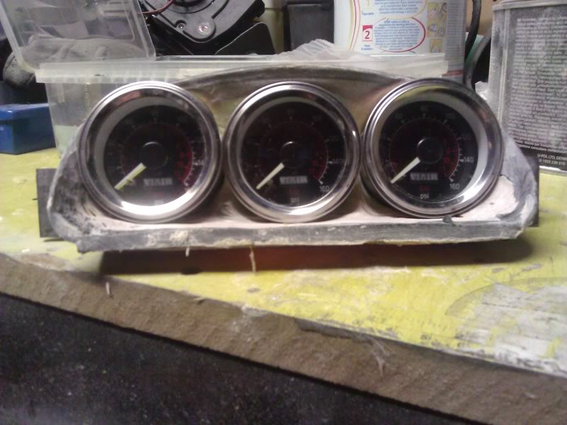

decided i wanted to keep my gauges where they orginally where. very similar to the 5 door. execpt i have 3 dual needle gauges. front/trailer/rear bags. will have a small one some where for the take pressure.
as you can see abit of filling to do not too much though.
Mickb
  van low and 1.6 16v

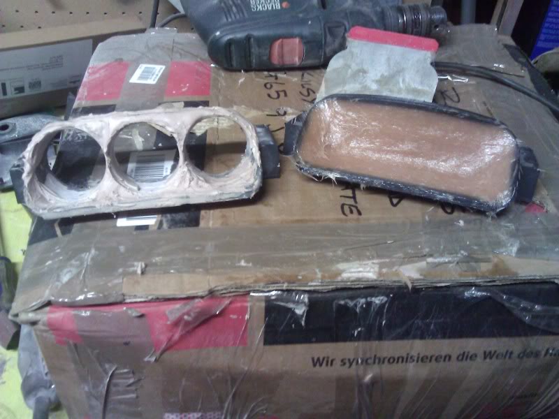

now the filling started... been too long since ive done this. and wasted a fair bit of filler oops.

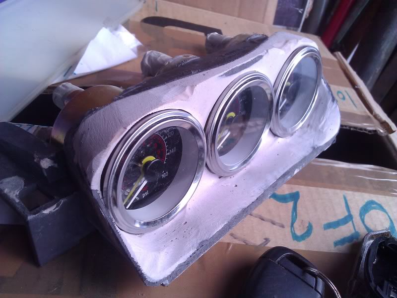

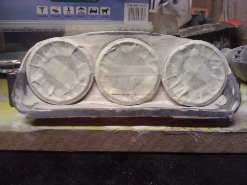

bit of sanding and a trial fit
remask and fill again for the night

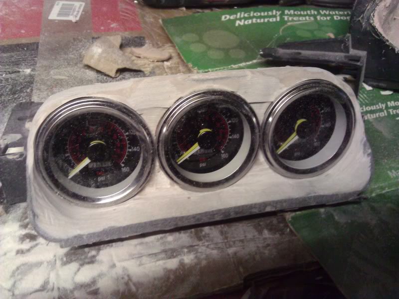

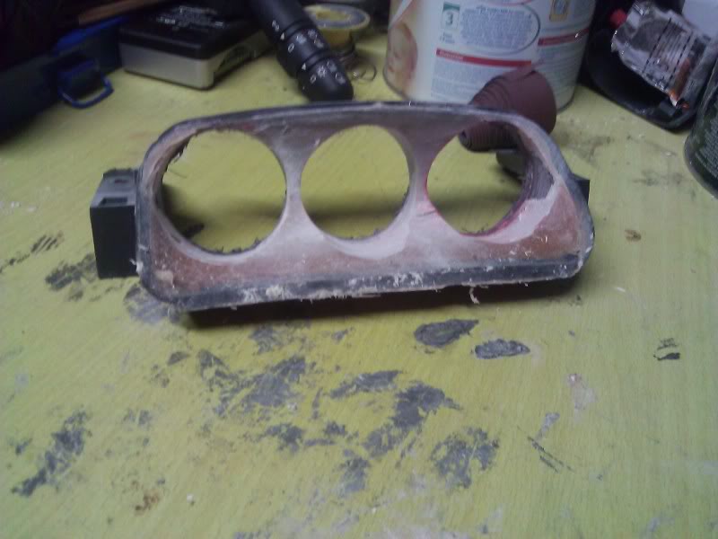

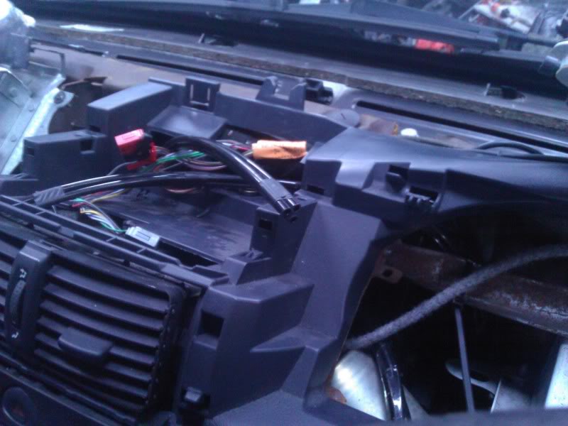

realisted i couldnt find my da or any pads to sand it. so 5min at work spare i gave it a lil sanding, made a big difference wee bit more and ill be happy with it. currently got the full dash out the loom. as i need to get clifford sorted and i was having a ballache doing it. and now fitted new loom that has elecetric mirrors and ac. to find i need to pick up a different airbox.
Mickb
  van low and 1.6 16v

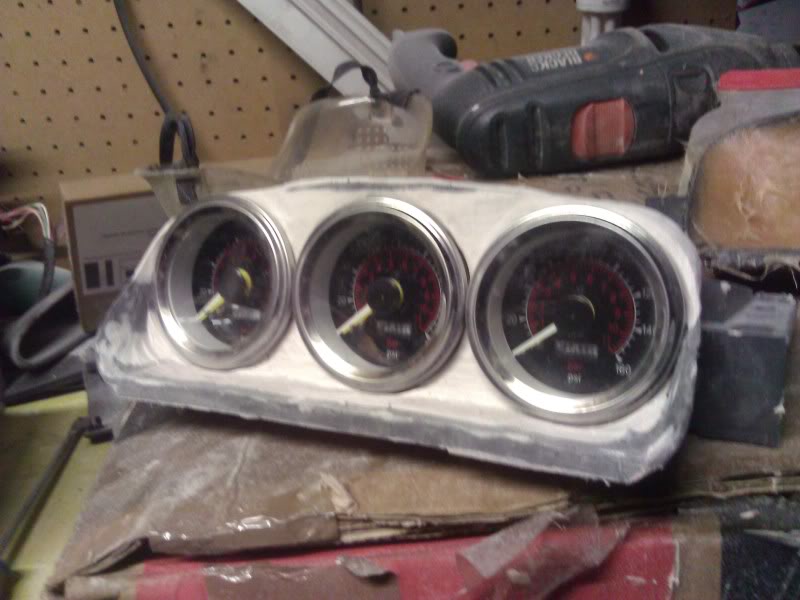

Yeah. Used that for doing the holes put to 52mm from 51. Used the da to do the front face to get them level. Dremel will be fine for shaping

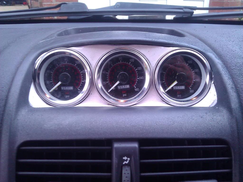

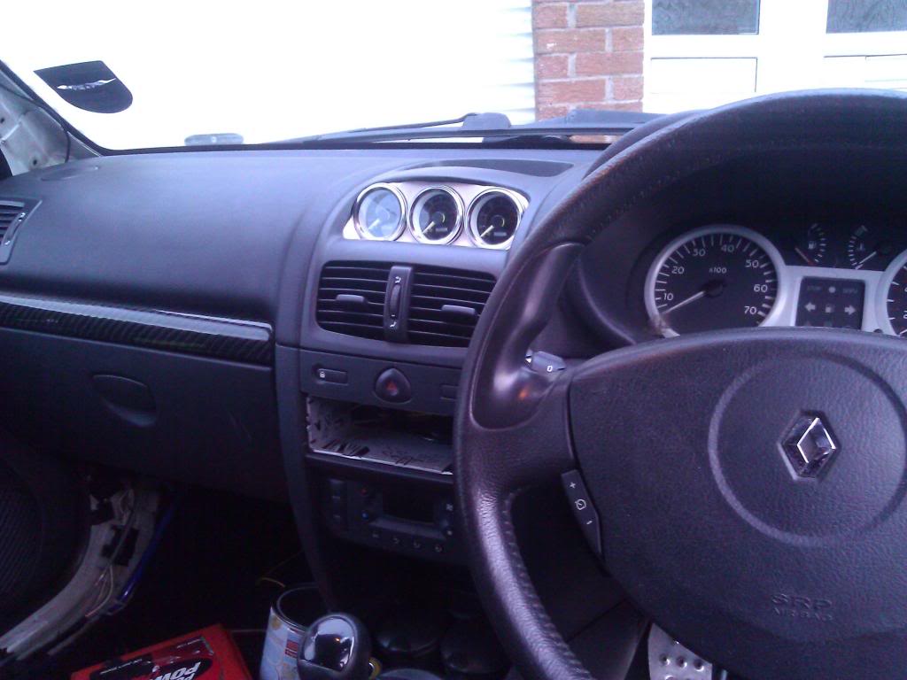

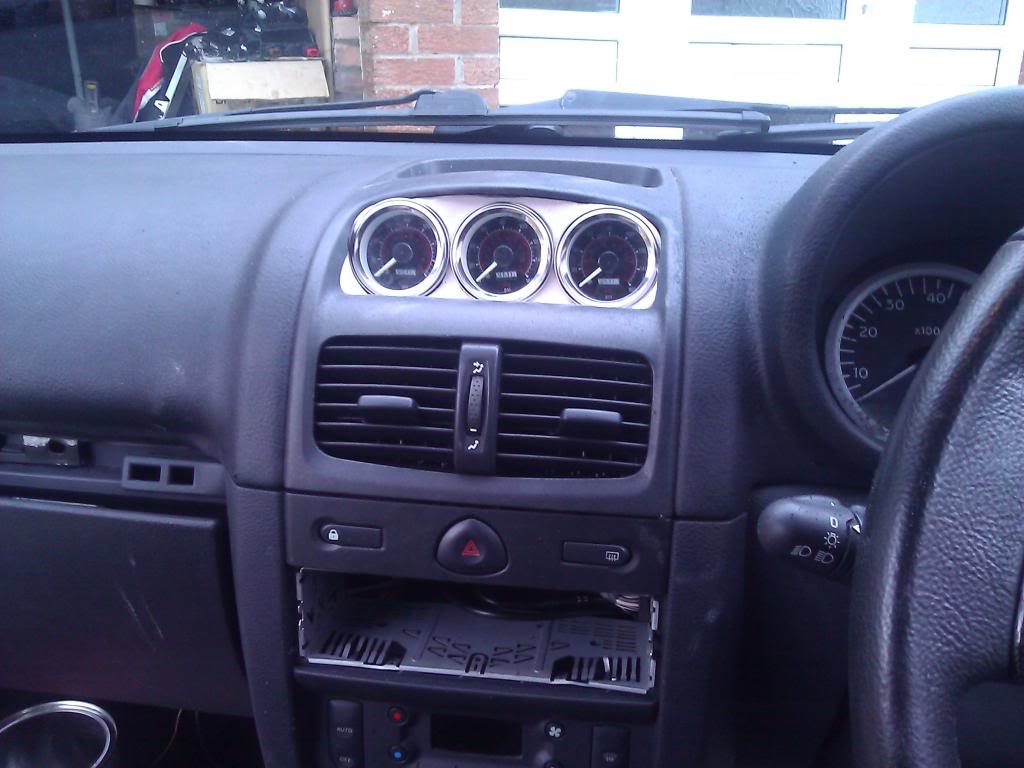

soon, just need to get the clip on it and adjust few things. get air con bracket/compressor, and will have a high spec van.
gauge pod needs more shaping so the top of the dash fits
Dr HMS Derv Destroyer
  MK1DTi/vivaro/corsa
How the hell have you retro fitted auto climate?
Pods looking good man! Are you making the top longer to come over the dials ?

Dci raz, will be extending it ever so slightly. As go the ac not finished yet.

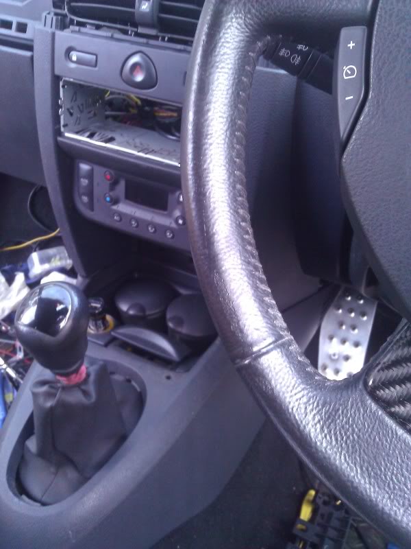

finally got the auto climate sorted. bar the air con, just waiting for my bag of air con seals to come before i fit the pump and get it gassed, also order pure motorsport top mounts. more reasonably priced compaired to the ktec ones. just got to sort my abs out. refit the orginal abs loom. as the harness i had has male abs connection instead of female. also spent tonight splitting a sport dash loom so i have the cruise control parts. picking up the wiring diagraam disc tomorrow to see whats needed to be added on the engine side of the loom. then get it configured

bought a dci loom fitted fit climate. abs was diffenent to the vans abs so instead of buying new pump and sensors ive picked out the old loom to fit back in as well as fit/configure cc john

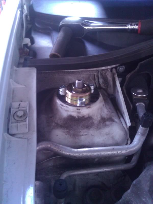

tomorrow im fitting my 12mm air lines and making up brackets and new 6mm sump guard with 2x titanium drag blocks. and will be fitting my new struts / top mounts, i went with the pure motorsport ones.

so yesterday i got the gauges 6mm pipe ran from the boot to up behind the dash in the centre console to the where the clock would be. also wired up the light for the gauges too.

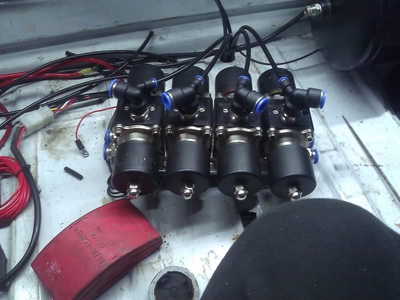

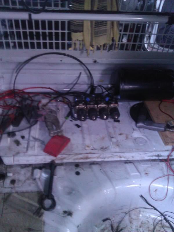

allt he wiring for the valve block is done and works. fitted the new push fittings in the bags and ran the 12mm pipe from the bag to the valve. and got that all working. just need to weld a plate in and use my bulk head push fittings. all thats left to do is run the pipe to the front bulk head. then fit the new front shock units and pure motor sport top mounts and then fabricate the sump gaurd. so all going well and me not being a lazy cnut then it will be all working.

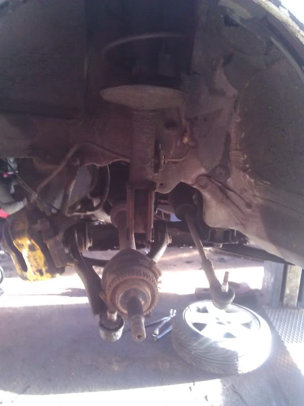

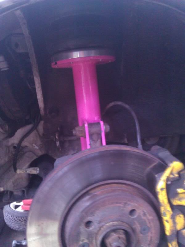

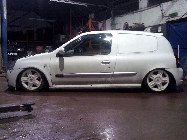

spent most of saturday f**king about. as usual when i go to the unit. but i got rest of the air fitted. and got stuck on the ramp. its all in just needs the install. made more pleasing to the eye. also got 6mm sump guard made. just need to notch the chassi leg and fit my titanium blocks.
out with the old
new in
then stuck on the ramp as i hadnt ran the pipe work through. that what happens when you f**k about.

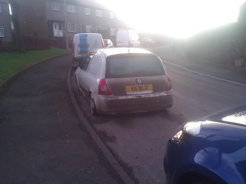

pic from last night
and was too hung over today so by time i ventured out and took a pic it was dark.
will try get pic of the guard that was quickly made and how it sits in daylight.

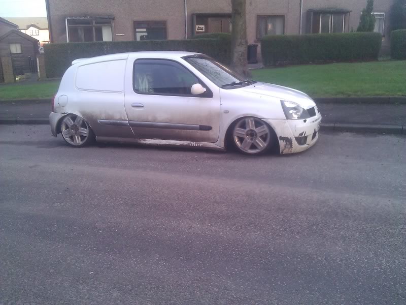

Bluebeard
  Whichever has fuel
Mick, I don't wish to be rude, but it seems to be going backwards. It looks fcuked!
Heez
  Superleggera'd Bean
FLOL! Batshit mental...
I don't know if I love it or not. Wheels look so SO lost!
Mickb
  van low and 1.6 16v
i know, im getting around to fixing it. got bumpers to get painted and tailgate etc. its had a right good beating.
Bluebeard
  Whichever has fuel
WTF's going on with the back arches?? Looks like a fcuking Vauxhall Nova all rusted out.
Mickb
  van low and 1.6 16v
trailers away to get painted then they're getting this to fix and full respray. the paint cracked and i just never bothered my arse sorting it.

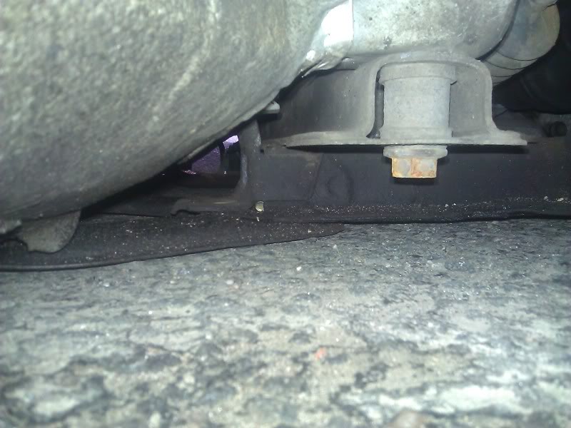

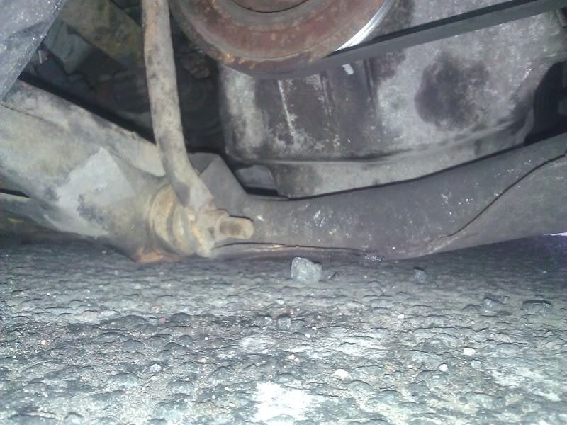

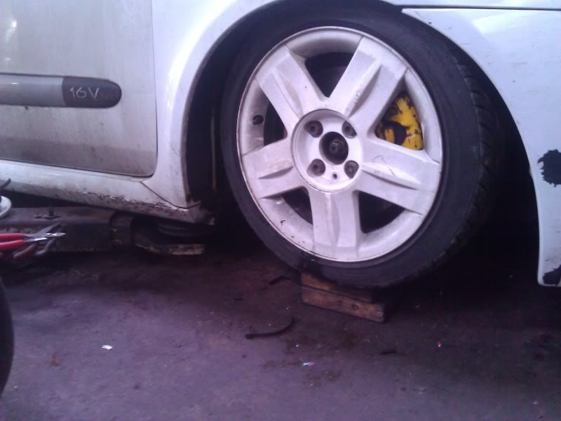

this afternoons epic sparks took its tow. two cats eyes caught me out. sump n gearbox gone. so thats me out for awhile.
  Focus RS + S3
Gutting mate!
i always look at this thread as its massive temptation/inspiration for me to mod my van
Mickb
  van low and 1.6 16v
all back and running with no guard. so have to be extra carefull. this is why
