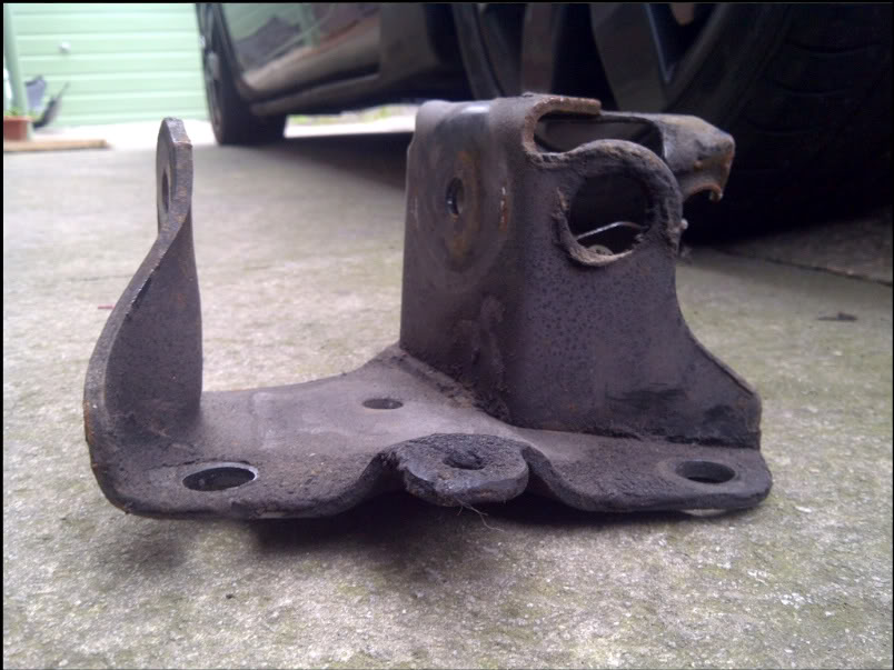

i've just got a part time job so after bills are cleared the winter will involve getting her mint again. i need two clamps/plates or whatever they are called that bolt the beam to the chassis, i have one for sure in the garage, not 100% if i ever got the second. hoping them being replaced with a full geo setup and corner weighting session will straighten the thing up, its like im riding a shot bull at the moment, its actually horrible... then i can get my studs/nuts on and start to enjoy it again.
50/50 on stripping the rear suspension off this week and rebuilding it with fresh beam to chassis plates as the one that took the whack is obviously damaged.
  BMW M135i
A brand new set is £100 or so for both so not the complete end of the world. Might be worth checking the bearings over too make sure theres no play in them or anything.
Otherwise fingers crossed the brackets are weaker than the mounting points :(.
even with what you say it just adds to it being the brackets dont it, i mean they took a fair whack and everythings been replaced at the back bar them, welll the coilovers too but not gonna be them... gonna get them sorted asap (like this week) as i've not driven the car in anger since november....

when we fitted the rear suspension i STUPIDLY never fitted new hub to chassis plates. i have one here and p@blo sorting me another this week. sunday in between BTCC and my hangover i'll be sorting it out. so in essence i'm undoing all the rebuilding work i did on the rear lol... but after looking at various things it can only be that and i am NOT going to give up.

so this is the new part, its dirty not rubbish. well maybe it is but its straight. i think.

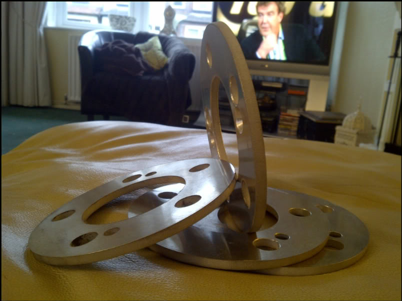

oh and the 6mm spacers, may as well post a pic.

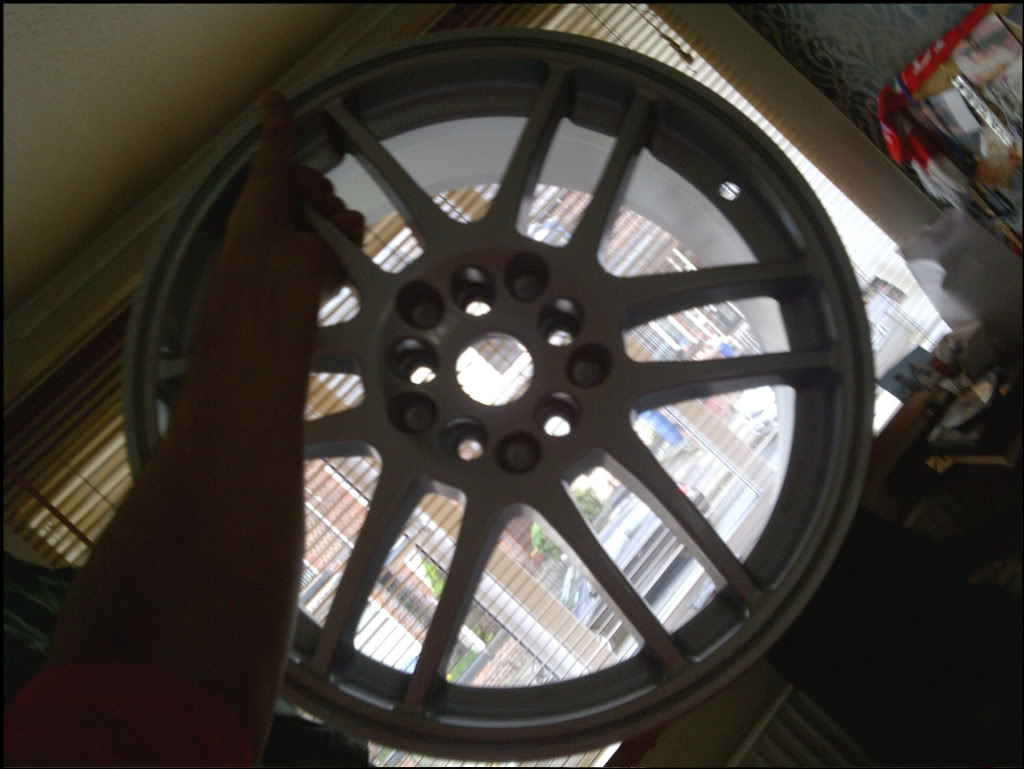

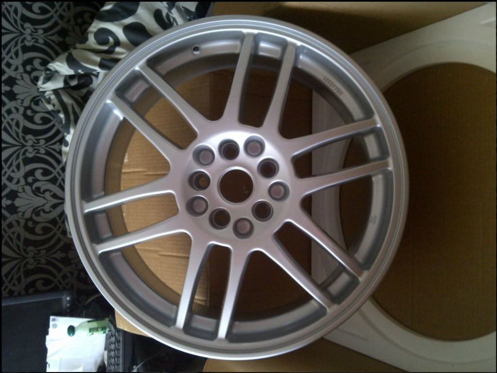

In 18", their offset sits at ET50, which in plain english means they will be wider in the arch sort of giving a touring car look, I honestly nearly squealed when i opened the box, they are absolutely stunning, r riad has took some proper pics but i'm putting these up now as i couldnt wait. I was noseying around demon tweeks last week and one of their experts ended up telling me the wheel is heavy, old and crap...
old? brand new in box....
crap? used from F1 to lemans
heavy?
not that i need to justify it to that random or anyone but there we go...

Didn't realise they did F1's in 18s, were they a special order.
