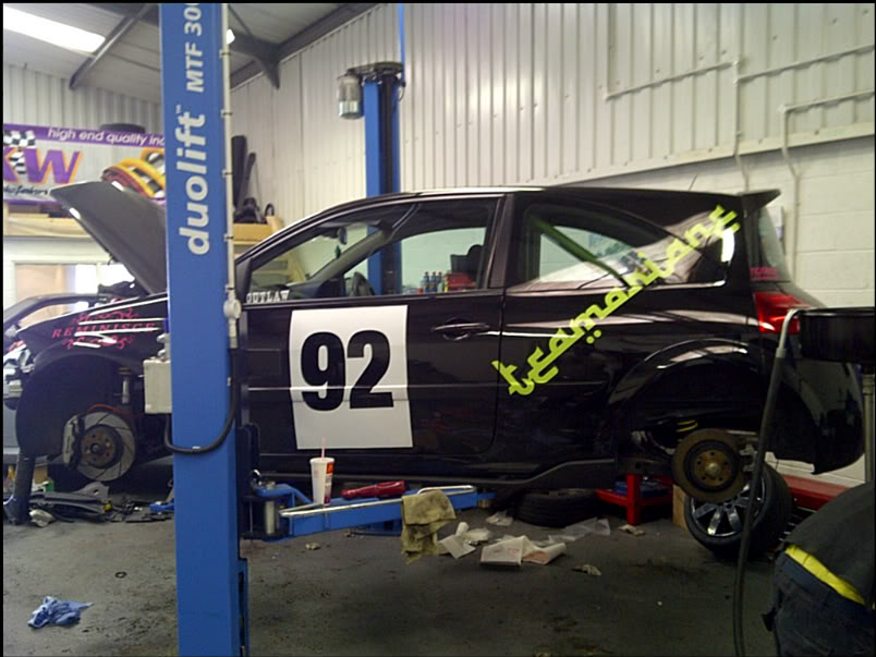

It was always my intention to take the car to LeMans 2011. If the car wasnt ready i'd have not taken it. Got it to BTM about a week before we were meant to set sail to Calais. Freds workload was huge though and the car wasnt even touched till tuesday.
I knew he didnt really have the time but if it wasnt fixed i wasnt going to go... if people think thats selfish, they havent been to leman before.

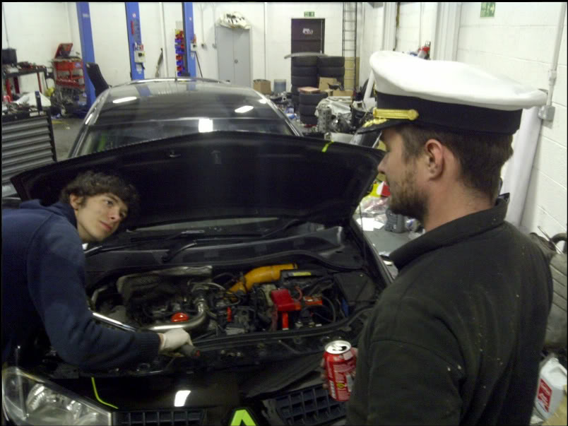

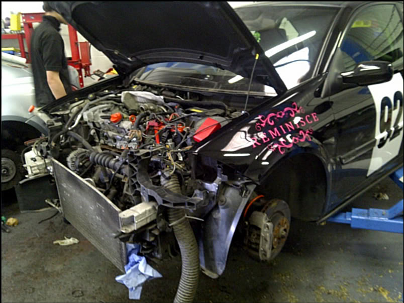

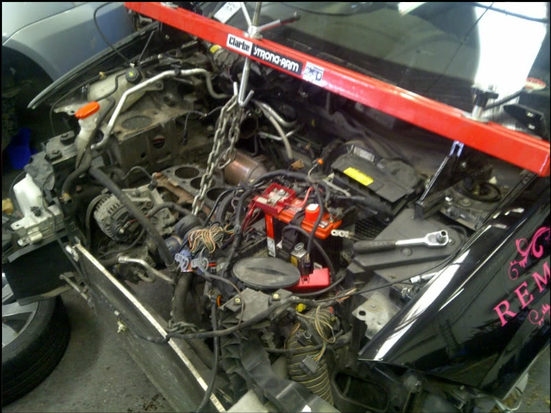

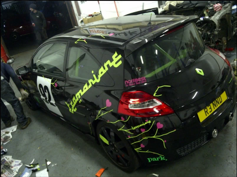

So on tuesday morning with 48hrs to go we set to work. Myself and sam started pulling the car to bits under freds supervision. He was working on other cars so we were kind of left to it and because i've had the bodywork off her before it was no biggy. To motivate and make the car look half decent i got on with my stickers for LeMans half cut by me, the others done in an excellent fashion by the bryan brothers.
this sums up freds stance during the 48hrs...

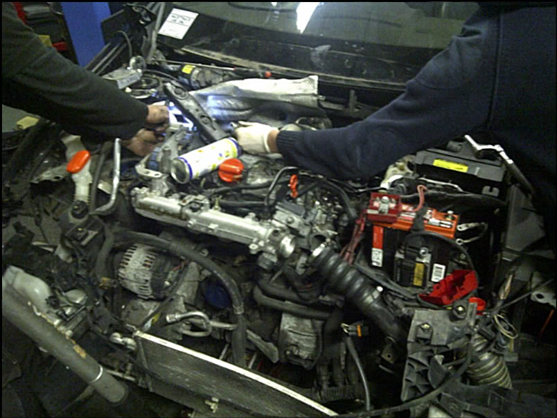

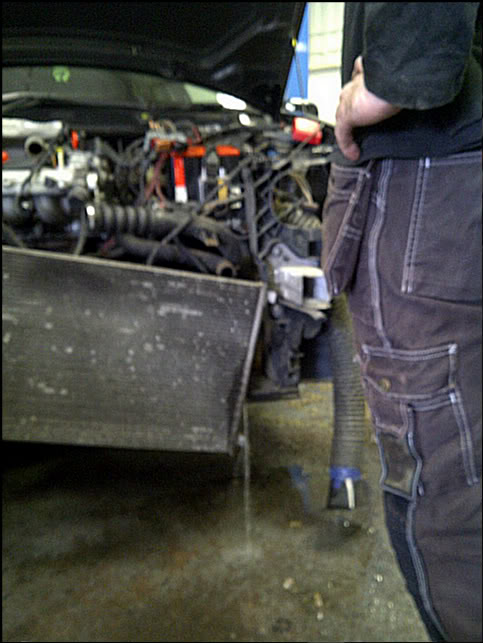

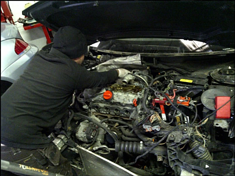

Being a really messy engine it took ages to pull everything off.

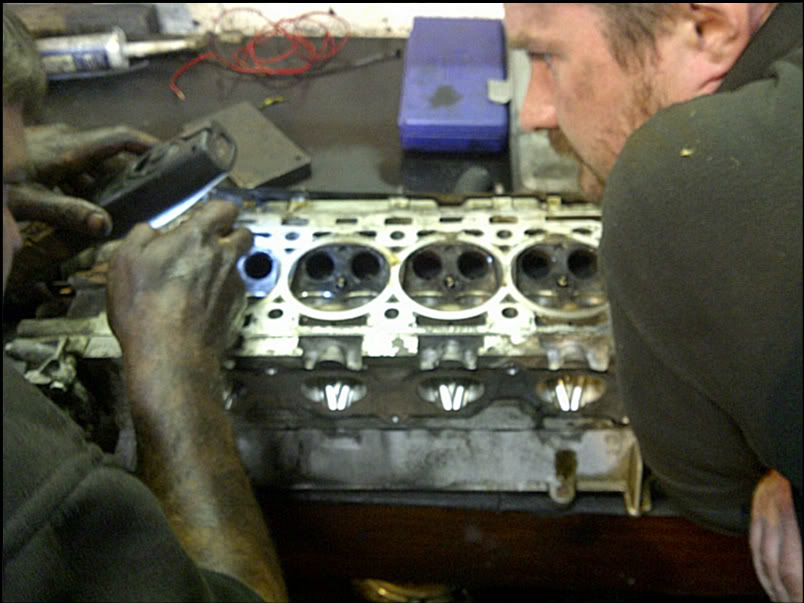

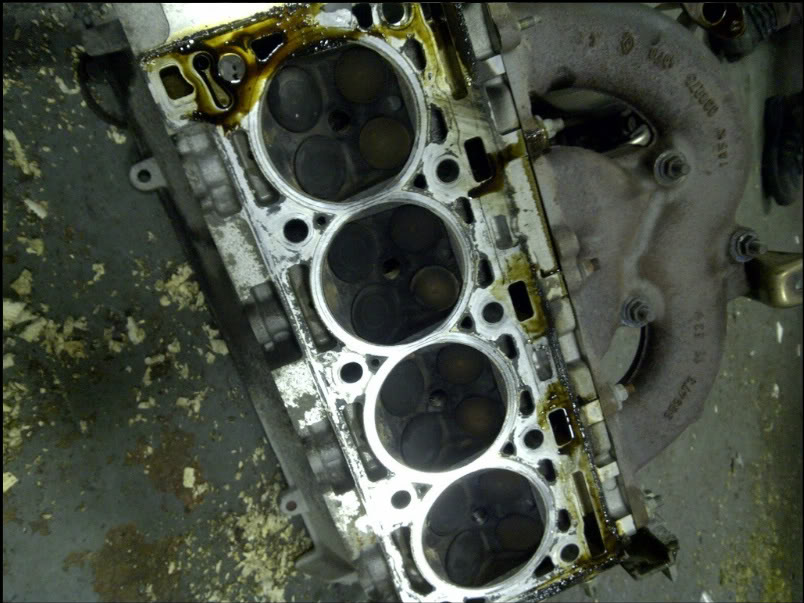

we worked our way down assessing where and what the cause for loss of compression was, alot of people have said what they think it to be and when it boiled down to it Fred was in the right. I wont beat around the bush, the cars had a tough life, it was one of the first to be mapped in the UK and has spent ages on the dyno. This obviously wears parts down. The main problem we found though was that cylinder three in the head was the weak one, yet when fred did his 'tests' cylinder one was the one that dropped all its contents.

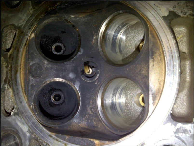

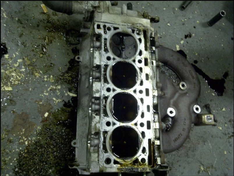

F4RT Head.
As you can see in this pic the apparently fine cylinder one has dropped all its contents obviously something major is up....

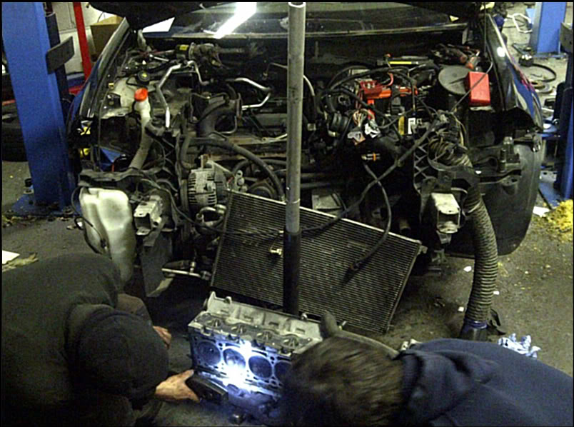

Without going into detail to much the valve seats werent sitting in their seats properly. This annoyed fred as he'd pulled the pistons from the engine to check for scoring and damage and they were fine as he's always said they would be. So in essence we were left with a bare bottom block with a seperate head that needed all its valves reskimming. 24 of them and each need about an hour.... FFS. All along BTM had said it was the valves and their seats but hey ho.
Fred called in a few other specialists for their opinion and it was the same, look in the pic below and note the build up on the exhaust side, granted it should get sooty and full of fuel but you could literally peel this off and feel it not letting the valves work properly...

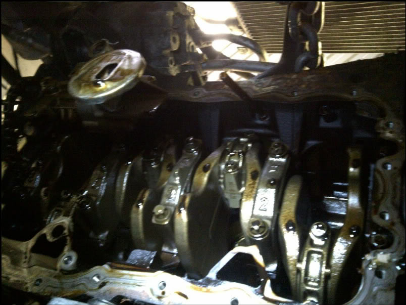

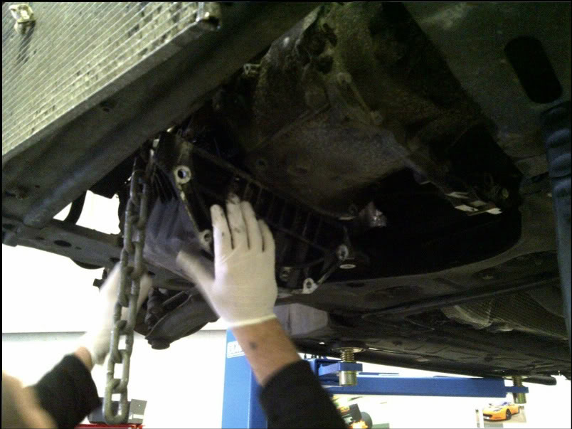

sump off

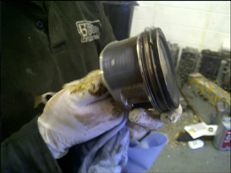

Pistons checked, and checked again, no scoring or damage to the ring landings (is it?)

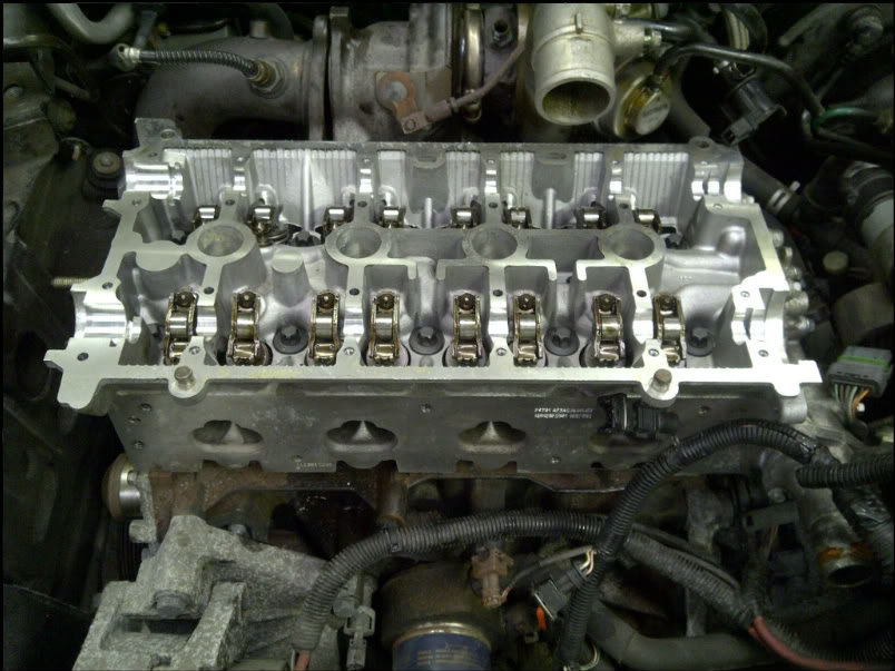

Book time stood at 44 hours, We had Wednesday... On the way out of BTM on the tuesday night at 11.50pm fred had an idea. The Velsatis head is very similar to the meg (he thought)... A quick midnight call to Adam @ Renault Wolverhampton confirmed they are the same bare head. Fred had 3 Renault developed F4RT heads from Dieppe and bar a check or two would go straight on...
Wednesday 7am, Fred
'Dont come near me till this afternoon, this is a BIG ask by even my standards so FCUK off i dont want anyone near me all day....'
We left him with 10 redbull and some ciggies.

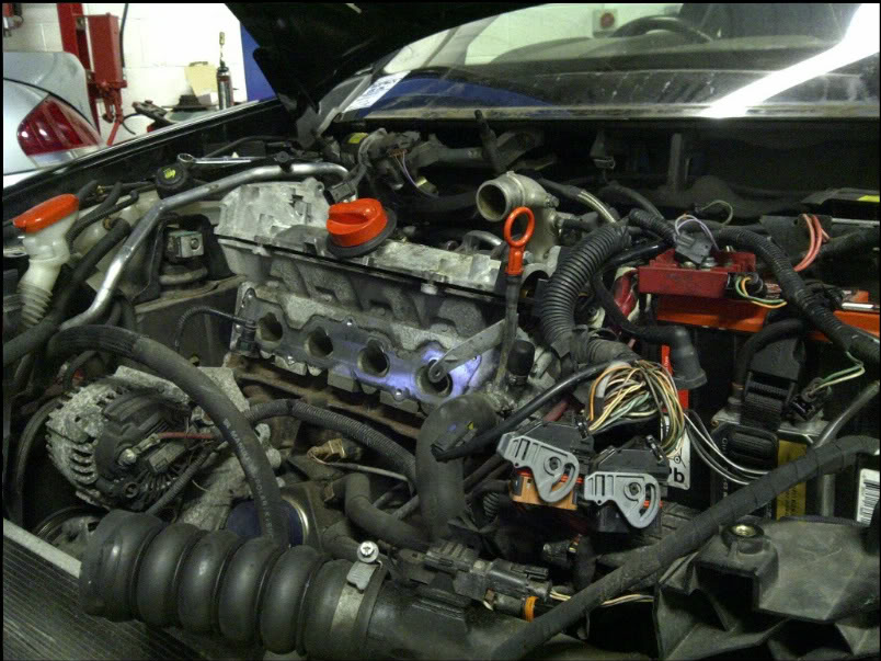

Now I dont exactly know what happened in the time until lunch but when i arrived the engine looked like this.
It had a new sump on as mine was bent, it had all the pistons pushed back in and new gaskets and thingys fitted, cams in and all timed up, the shiny new development head was on with new valves and valve seat, a far cry from the burnt and sooted ones that came from my head. fred showed me the new valves and how they should have a 2 tier level of colour, mine were a mess... 'overfuelling its tits off'...
Throughout wednesday I carried on with the graphics and occasionally helped out, ie tightening the bolts on the top of my engine, so I could tell everyone I had done all the work :evil:
Fred explained that he's also fitted a different 'BTM spec' headgasket that slightly raises the engine compression.

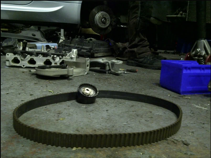

So another two hours lost but we were now getting to a point where we could not give up. Some of the LeMans lads arrived and fred sent them packing to their hotels as we had the rest of the engine to get in. I went to BAP engineering to pick up my severly buckled rear wheel which had been weighted, another thankyou. And sam set all the parts ready for them going back on.

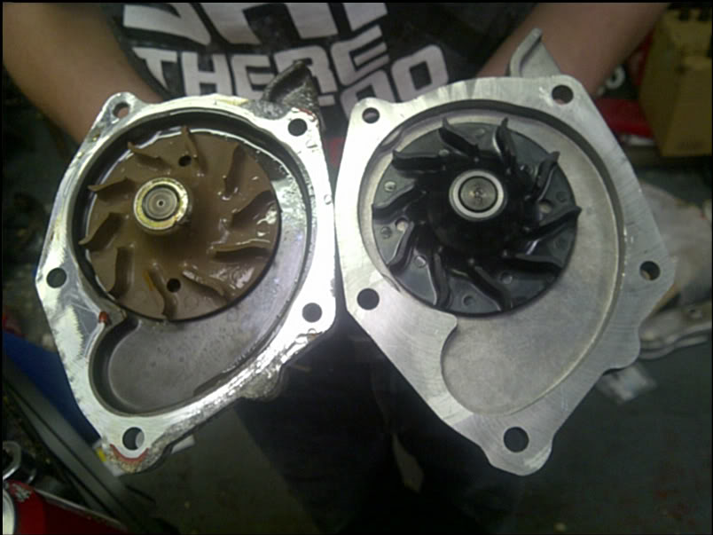

So cracking on the rest of the engine got built up during wednesday evening, at this point freds back, hands and head were fried, myself and sam werent in good shape but fred was f**ked. I learnt so much over the two days about engines but bar embarressing myself lets just leave it with the engine was pieced together slowly, a new water pump went on, a new radiator (leaking heavily), new cambelt and various other little bits. It was now Thursday morning 2am. We had to leave for the ferry at 7am....

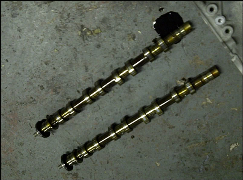

Cams going back in... we were looking at Velsatis ones but due to a few unknowns we played it safe at went OEM.

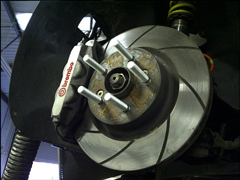

Fit wheel studs and bolts that we didnt get time to put on.
(I test fitted them at BTM...)

Are those discs HCs that Rich has cut the grooves into? Where did you get the studs?

studs and nuts are from tweeks Tim.
