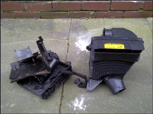

I've long wanted to alter the induction setup on the car, did some measurements and tests a while ago to see if a phase1 172 airbox would fit, and it does. although it require no battery there, luckily I've also wanted the battery relocated to the rear for a while. Riads said to use the airbox from his car whilst its sat there so that'll get 'stolen' this week.

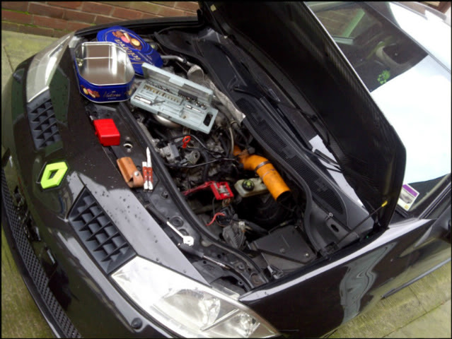

today I set about stripping all the gubbins out ready for battery cable, I thought it would be expensive but I managed to sell my race battery to a friend running an M3 race car, with the money from that I bought a clio battery in. shocked me at the clio batterys weight, weighs nigh on the same weight as the race battery, I'm also going to use the base plate/battery tray from the megane to sit the clio battery in. As you can see below bar the engine, ECU and gearbox there is little there, excuse my biscuit tin which is not empty anymore!
can also see the space which is there for what I've detailed below.

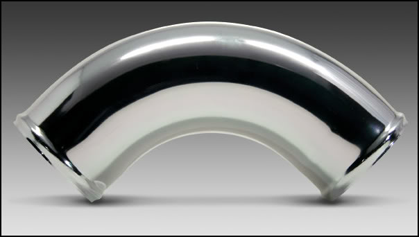

I managed to sort a deal for some cabling too, although its quite heavy so re-assess that this week. In the enginebay the airbox will connect to the turbo intake pipe via a 90 degree aluminium pipe.. whilst the ECU will sit flat, its lay in no-mans land in the pic above.
a little will get cut from the pipe to make the bend, the leftover will then be the connector for the aluminium pipe to the airbox. still with me?

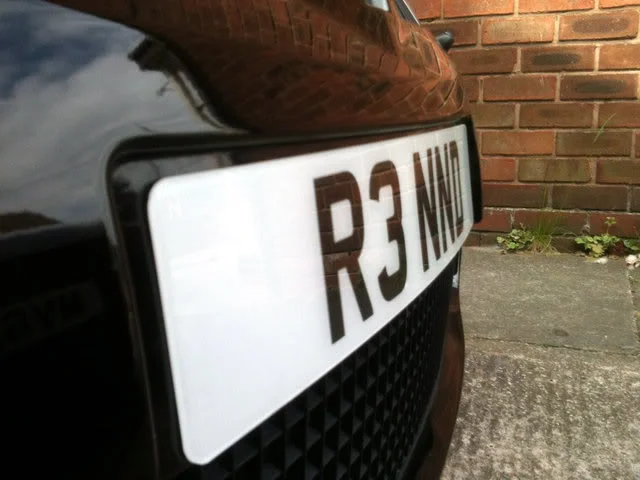

* New smaller front plate from FancyPlates fitted.

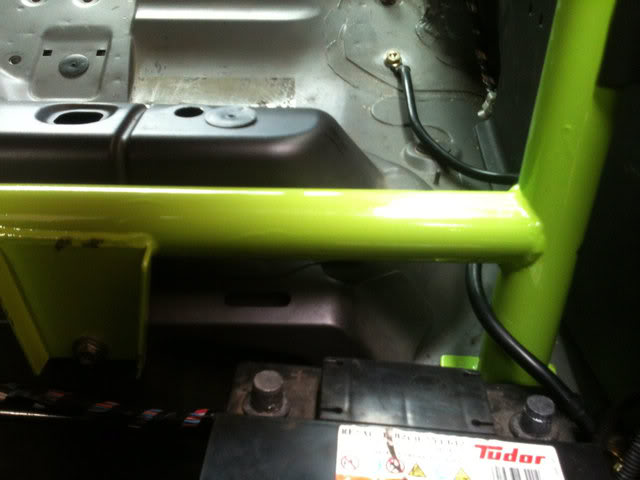

* Battery moved from bay to behind pass seat, Negi feed run to chassis point and posi created with a BMW E46 M3 cable, clio battery used.

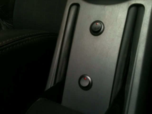

* In car TC switch toggle binned and replaced with 2 LED switches

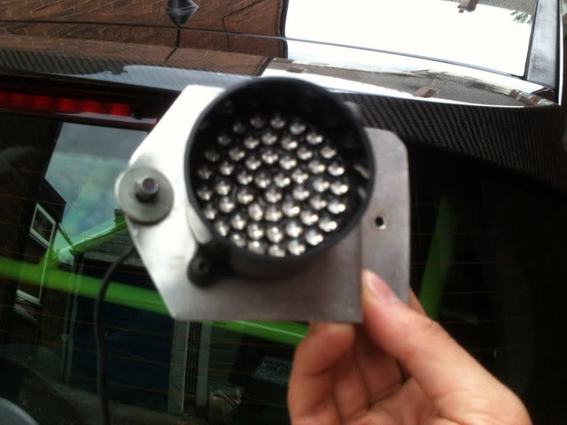

* F1 style rear LED foglight fitted under 3rd rear brakelight, not for road use and totally for my personal enjoyment.

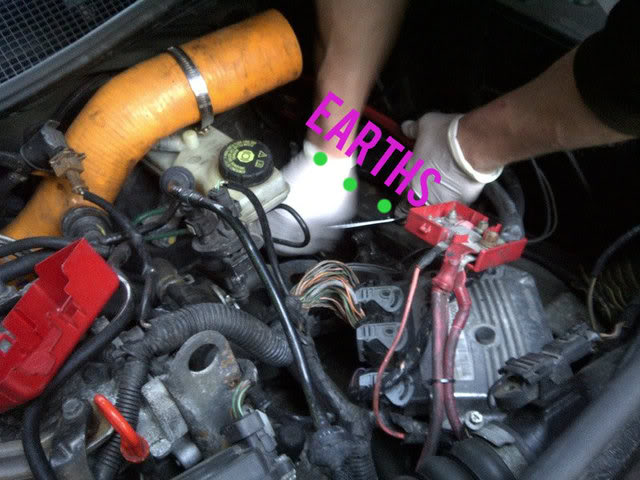

* Enginebay dressed and all crap cleared from it, along with metals polished, slightly corroded metals painted matt black and earths set on chassis.
