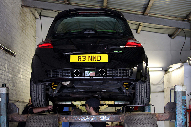

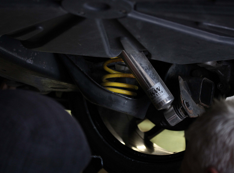

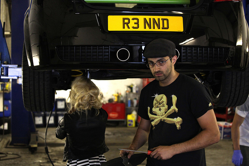

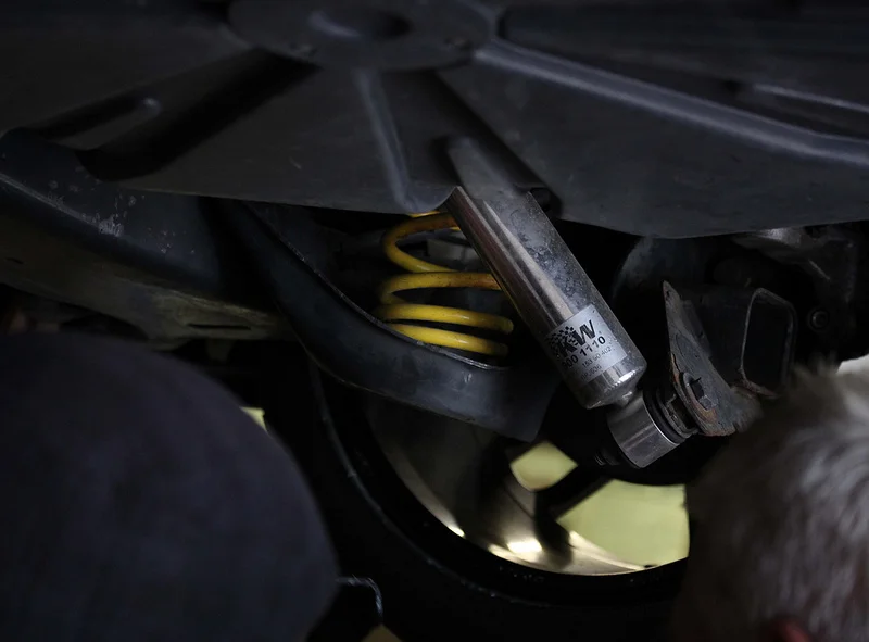

Had the rear beam off in about 10 mins to bolt the replacement plates in, brake lines off and plugged plus all other ancillaries, licked the underside with protectant whilst i was at it too, so the car now has 100% Phase 2 cup rear end inc roll bar (thinking about it the only thing thats ph1 225 ff is the shell, side and rear windows!) Pulling the rear plates off theres no visible damage but the cushioning ring for the left spring has deteriorated and stretched, showing left to right stress movement, anyhoo we fixed it and replaced it.

Tom and riad then reckoned they could fix the handbrake, so i left them to it as the missus showed up moaning i hadn't seen her all day, hard to explain the meg handbrake but it failing is a common problem. basically the two cables hook onto a teether under pressure, if one is a little more slack the teether bends until it fails popping it off the cables. To my shock they fixed it and we timed it tight so it only needs two clicks to bite.

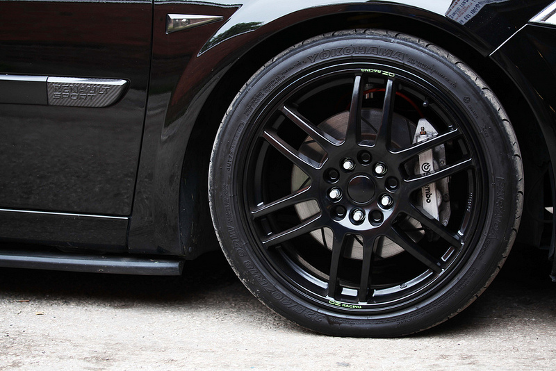

Onto the other lift we removed all the rivets and connectors for the skirts and remounted them, miles better now and i'll seal them this week with some black sealant i picked up over the winter. i also sprayed my centre caps black (bar one i got stuck testing the fit) no biggy to fix though, having some green oz centres made up to finish them off this week.

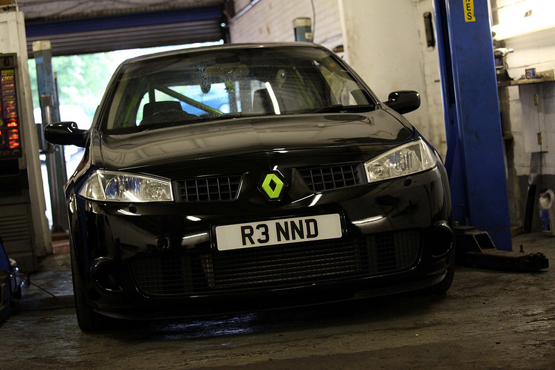

So MOT passed, car just needs taxing and a quick blast to BTM for some front work and mapping.
