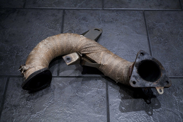

Over jan I picked up a heat shielded Decat, which I'll never obviously fit as thats highly illegal. hi.

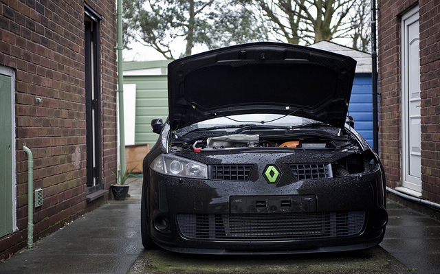

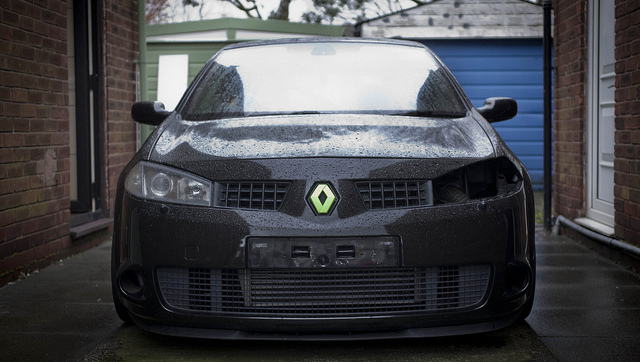

Bought a single xenon projector a while back, then managed to have nicksons set off him which were alot more built up, they were clouded and not 100% according to him, the OCD in the boy must be on another level as they are literally perfect, only got round to fitting one before close of play and a quick pic after i got the bumper back on shows the state of progress.. Everyone has always said visually the car is 99%, the only thing letting it down has been lack of projectors over the years, well thats obviously not going to be a problem from here on out. a little mod i've waited for years but it makes the car look SO MUCH better, well it will when i fit and buy the xenon bulbs in february.

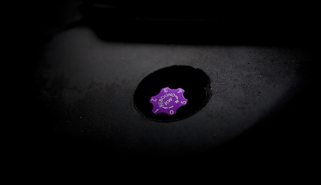

Also managed another little mod that most would see as pointless, since i've had the V3s on the one thing that has always pee'd me off is that KW never supplied pin adjusters for the dampers. thanks to to brother Riad I now have pins sat in the holes I cut for the top of the damper, it finishes the look off and gives instant adjustability. I'm opening the DIY scuttle holes more this week though as its a little too tight a fit at the moment.
KW adjuster by NaithanAriane, on Flickr

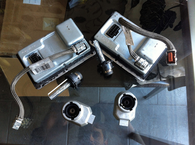

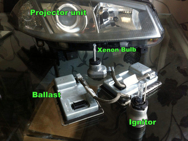

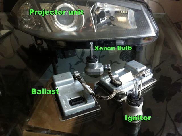

Excuse lack of progress guys... paternity and the weather being the main culprits. Been buying up bits and bobs and the second the weather turns i'll update, this update is mainly for those researching and who would ever consider retrofitting Xenons to a none xenon'd Ph1 225... In short unless you have mega monies or find a complete unit, dont bother!
You need;
2 ballasts.
2 xenon bulbs.
2 ignitors.
2 looms to splice to existing system.
Mesane 225 PH1 xenon by NaithanAriane, on Flickr
You also need the slam panel mounted self levellers which for now i've not bothered with, although I will when they come up/I can afford them.
A lad on megsport was selling the above bar the actual units and looms (I thought he was including the looms too but hey ho) Paid 50 quid for all the above. So for a setup that I can imagine costs hundreds I cant complain even if its just the ballasts that work (As they are meant to be mega money).

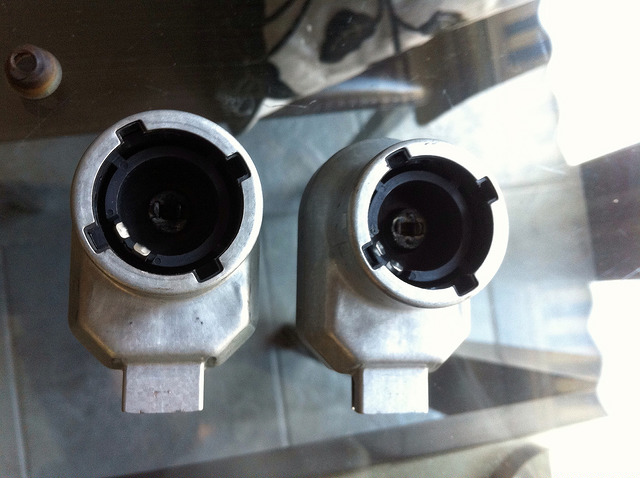

As I stripped the units down today, the ignitors contact points to the bulbs have corroded a fair bit. Its only when you remove the rubber seal can you see, the pic below shows the burns to the rubber seal and until I connect the lights up in the next few weeks I wont know if they'll even work.
As shown below.

Must have been some crossed wires over Facebook, let me correct!
There is only one loom needed to connect the headlights up mate, not two.
You're so close, the loom connecting the lights to the car is the only thing missing. Unsure on brand new price, but if Ads can get you a decent price then happy days! Mine all came in the same box fortunately.
No splicing needed either! Plug and play. The headlights plug into the loom, and the loom connects to where the old headlights did (Unsure as to what it is actually called, there are lots of electrical connections in that little black box). Just route it in all the same places the old loom was. One problem I had, was the headlight loom didn't have the plug for the bonnet switch for the alarm. Easy and simple to transfer over, just something to be wary of.
Levelling sensors aren't slam panel mounted. Front and rear axle. More ball ache to get sorted than actually fitting the xenons. I've got the sensors and loom, just not the time or effort to get them sorted (as they require programming via a Renault CLiP to work).
Xenons work fine without them, they just won't auto level when you've got a heavy load in the back of the car. Meh.

I didn't have a clue about it being a single loom, if it runs down one side what about the other side? or am i being totally thick as funk there?!
As in if one side connects to the new loom what does the other side connect too? the wiring i have now already in?
thanks for your input mate, really helpful!
Not a problem mate, anytime!!
Yep, single loom.
The wires for your current headlights travel across the slam panel and reconvene on the passenger side before routing into the black box where the big white plug goes.
Exactly the same for the xenon units.
