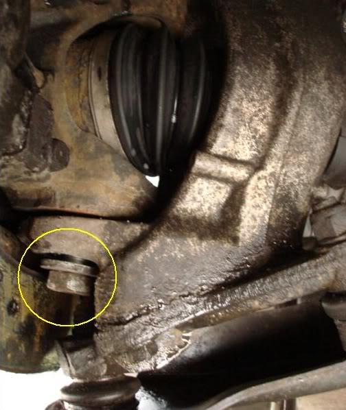

My mate tom had the car up on his ramp and noticed that the lower arm bolt connecting to the hub was bloody finger tight....!
I'd already wasted 100 on the cars tracking at this point, P@blo said he'd be happy to take the hub back and I could have a pair of driveshafts off him instead as a straight swap... So all the issues over the year and the trouble in LeMans was due to a loose bolt, thats life hey! Scary to think if that had gone though, well I dont know what would have happened but not thinking about it, Tom has said he'll check the car over after track, long runs so i know its safe hands if not being tinkered with at BTM.

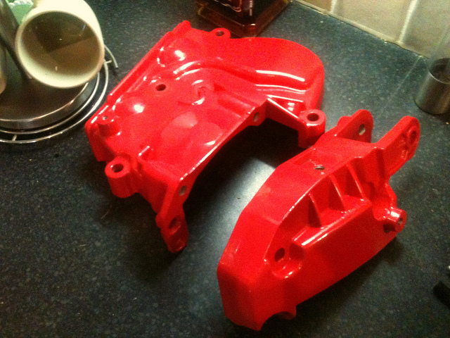

Got some bits off the engine back from the powder coaters, waiting on some more as soon as they arrive I'll post it up.
RS Meg powder coated parts by NaithanAriane, on Flickr
