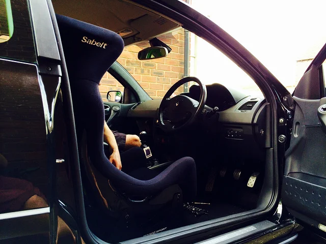

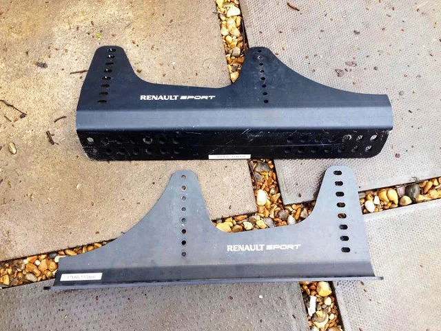

I bought BigAshs Sabelt Taurus seat off him recently and managed to source some Team Pyro RenaultSport Clio Cup Racer mounts for dirt cheap. The 225 has the same floor plan as the 197 so they are a straight bolt in job (obviously with mild tinkering as is always the case with Renaults.) My mate Alex C got me some eyelets and bolts from his touring car workshop, thanks again for that, and helped me get the seat fitted in properly.
Snug, low but my days its good. Really puts you in the car now and you feel the car moving about on the road, I love it, granted I used a pillow in it for LeMans but nobody needs to know about that. This is how it looked during fitting.
photo 4 by NaithanAriane, on Flickr
photo 1 by NaithanAriane, on Flickr
photo 2 by NaithanAriane, on Flickr
Feedback on it has been great and yeas the passenger seat is staying OEM as my nan comes shopping in it with me!

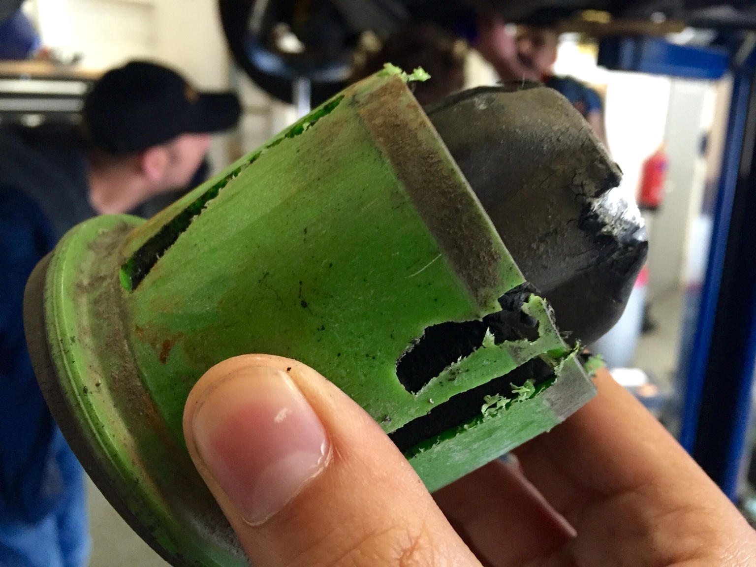

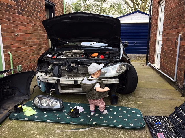

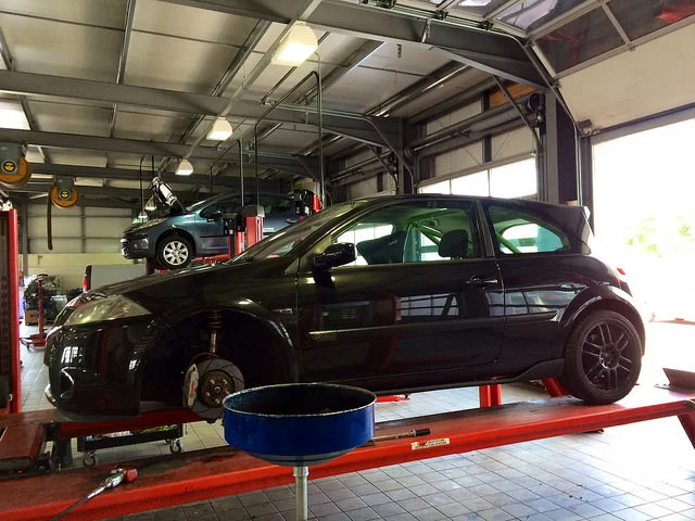

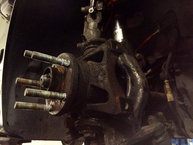

The O/S hub was totally mashed so I decided to get it taxed MOT'd and down to BTM. Whilst it was there Fred replaced the gearbox oil (which was like treacle), sorted the CV boot, changed the oil, fitted the Milltek decat and sorted the hub bearing out. Unfortunately we didn't have time to fix my N/S CV boot and check the hub and on return from France its really deteriorated, more below. It was mainly due to time, the bolts on the cat took HOURS to get off, they were a right bugger, gotta be fair to fred he kept smiling and we got it all on.
photo 3 by NaithanAriane, on Flickr
photo 5 by NaithanAriane, on Flickr
Car felt alot smoother on the way back up north, the gear change was better but not much noticeably better. The decat though, my lord. During startup, when cold its marginally louder but not so much you think 'god thats had a decat put on'. Its when you're at speed and you can hear the turbo spinning along with the boost being dumped and/or used it truly becomes addictive. The midrange is alot stronger since fitted, talking 5/7bhp off the top of my head but theres definitely greater pull, its thrown the engine management light up once but a single flash with the scangauge and it hasn't come back since. It'll need mapping asap as a friend blew his car up with a decat and no fettled map and I dont want that. Pops and bangs on overrun are naughty but no way in your face. So its all good.

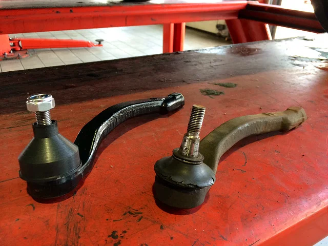

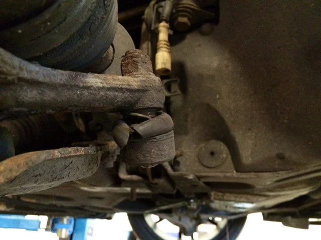

It was then time to set off for lemans. We met Danny and Gaz and along with my mate sy in his R26 we set off from Mcr on the tues night at midnight.
The cruse down was nice, the car wasn't heavy on fuel and bar a minimal pull to the left felt utterly fantastic. We got to the others at about half four in the morning and I decided to sticker the car up in the carpark of their hotel, as you do. We'd done an allnighter and were 7 miles from Dover so sleep seemed pointless. We left for Dover at 9 and pulling onto the M20 I decided to give Gav in his diesel Megane RS chase. Closing on him up the slip road I braked and there was an almighty wobble. Its like nothing I've felt before in a car and it scared the s**t out of me, the car started to instantly wander across lanes. My brother told me to stop but being so close to Dover i decided to nurse it, applying the brake the car kept violently juddering so I'm thinking the calliper has seized.
My heart honestly sank as for once I had tried to make the car run well and be in top form and yet again she'd developed an issue. We kept going and crawled into the ferry port, I passed through passport control and then slowly through the check in booth, I turned left and lost steering. I was hoping I'd make it to the holding lanes and get under the car but we fell short. My brother jumped out saw one wheel pointing left and one right and noticed the drop link had fallen out, yeh, THE DROPLINK HAD FALLEN OUT!!!
photo by NaithanAriane, on Flickr

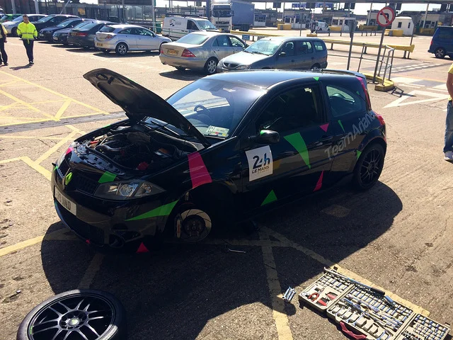

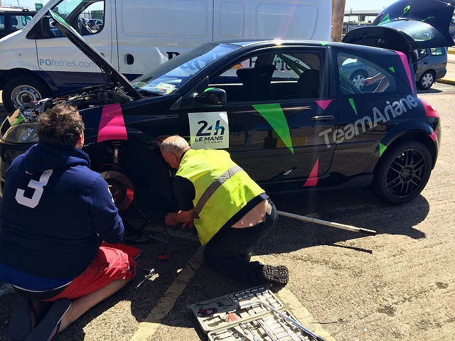

I was literally lost for words and started to get really annoyed as we dragged the car into an area away from everyone else. I started to think about it failing at speed and how I'd have had no control but as someone said 'someones watching over you'...
What happened next really made me realise how lucky I am to have the friends I have. James (Bigash), his mate Dom, Danny and Gaz, Riad, Bloor, Rich and Sy between themselves instantly got the car jacked up and the wheel off. Fearing the worst we could see that the nut had sheared on the thread and that due to it being a fine thread a spare nut wouldn't cut it. Bear in mind it was 10am when this happened and the ferry was leaving at 11.10am.... I resigned myself to not taking the car at this point but and old chap then turned up, Bob from P&O maintenance. He basically says theres a ECP/GSF in Dover so he'll have a run over there and see if they have a drop link, we ring and they do... Off he trots and we're sat there. We checked the hub and drop link for damage and this point and it was all ok. I was still full of adrenaline at this point due to what had happened and went to the ticket office to book a later ferry and calm my little self down. He arrived back at 10.45...
We used the bolt off the TRE and tightened it back on (holding the bottom of it too so it didn't spin as I think thats what caused the issue in the first place) and dropped the car, due to Bob from P&O's ancient jack catching the side skirt as we dropped it in a flurry of excitement we clean snapped the front of the side skirt off, FCUKS SAKE. But the car was working so I taped it back on we started the car and I kid you not drove into the loading bay as we were called forward to embark, we then got shouted at for stopping for a celebratory pic!
Arrived at Calais and were first off, we got south of Calais and the car seemed fine, pulled into a service station and waited for the gang. It was HOT and I gotta be honest the meg absolutely sang her way to LeMans. The roads on weds are a little more quieter and it was the best journey down I've had in all the years I've been. I noticed now that the gear changes were really smooth as the new oils were in and doing their job perfectly.

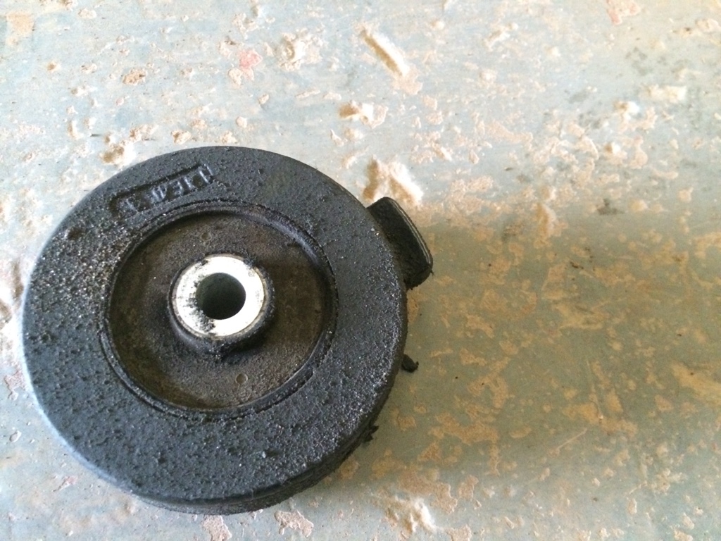

On the way back on the Monday morning the N/S part of the car with its shot bearing started to creak and clunk and isn't 100%, but the car like on its way down flew on the motorway and made short the journey to Calais. I've not had a chance to get the car on a ramp since I've been back but it needs CV and hub refurb so thats on the agenda for the next few weeks. When we got to Dover we got onto the M20 ready for the blast back up north and finished off the old "Bad luck comes in threes" as a massive stone cracked the windscreen from top to bottom. I didn't even react at the time as I was so worn out and wired from it all.

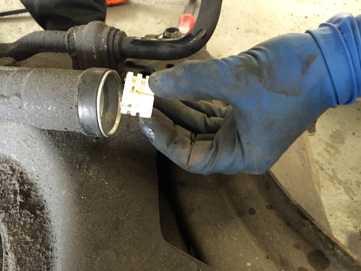

If in doubt, crank sensor..

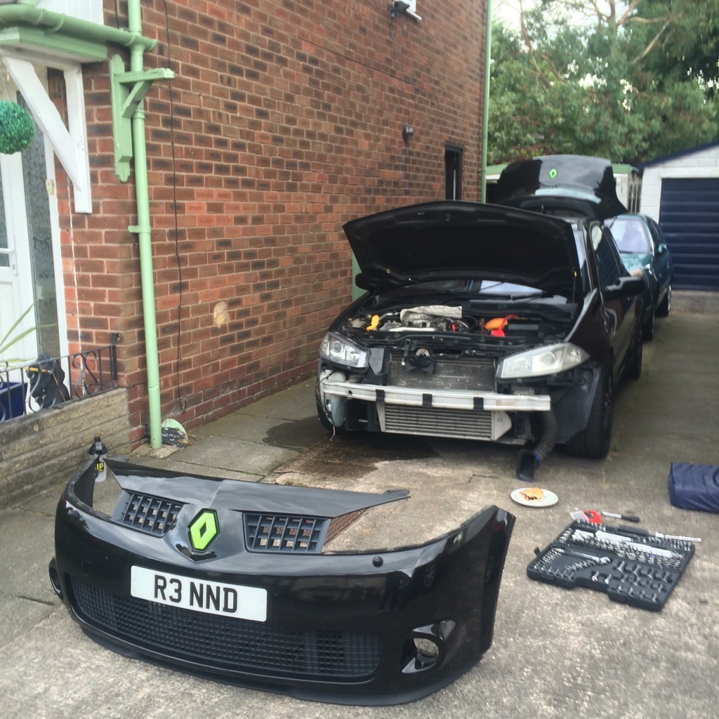

Thanks to Warren for letting .GAZ. and myself get underneath his Megane to remove his crank sensor to test on yours! :rasp:

Right.. I diagnosed and fixed your car myself with my tools. Nickson helped a tiny bit :p

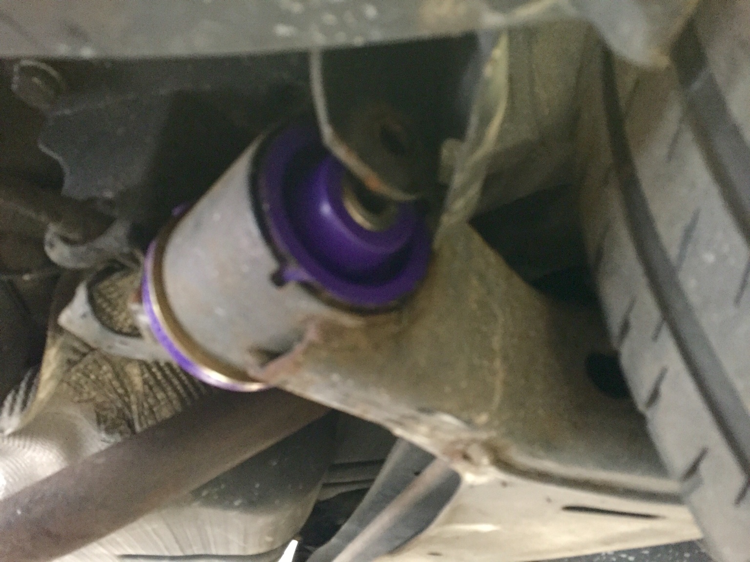

In May I got some Powerflex mounts fitted, they really smoothed out the idle, and stopped the shudder on idle, easy to fit and a worthwhile upgrade, around this time I noticed the flywheel was knocking and shuddering. So I ordered a TTV single Mass flywheel, (I still haven't fitted it but it'll be going in at the end of September with an R26R spec clutch and the rear Powerflex bushes at a pals garage).

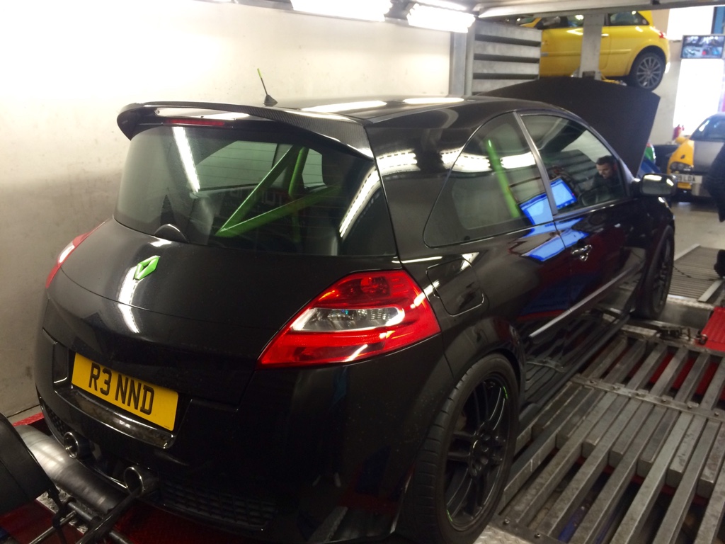

I purchased some 630cc injectors and took the car up to Paul@RST to have them fitted and the car mapped. Got some positives from it and negatives.
Basically the power is now being limited by the exhaust, the exhaust has always been an important bit of the car for me... People always ask why it sounds like it does and I've never really told... It's down to pipe restriction, 2.75" down to 2" roughly. It in effect it strangles the airflow but this causes the car to not flow as cleanly as it could. I obviously want more power so I'm going to have to sacrifice a lot of the sound.
What I plan to do however is open the exhaust from the decat to rear box to 3" and still have restriction post back box (to 2.75/2.50"). So it'll just be a larger and more free flowing setup compared to what I have now, I just need to find somebody reputable and affordable to assist.

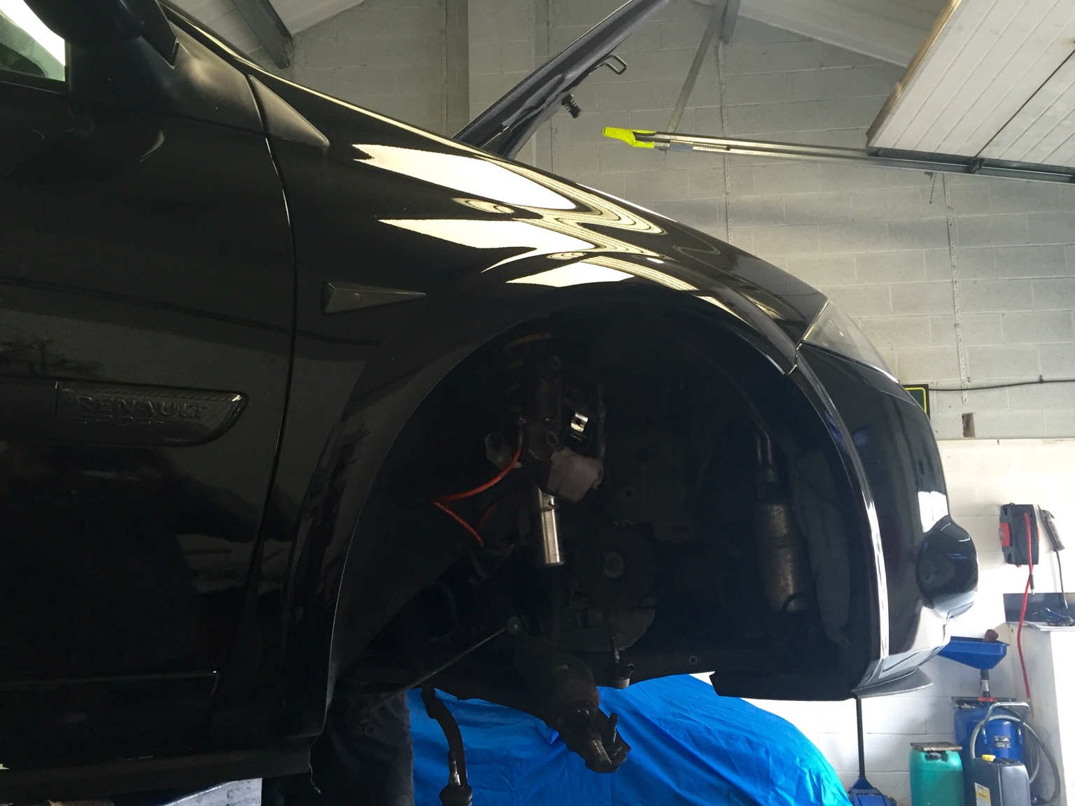

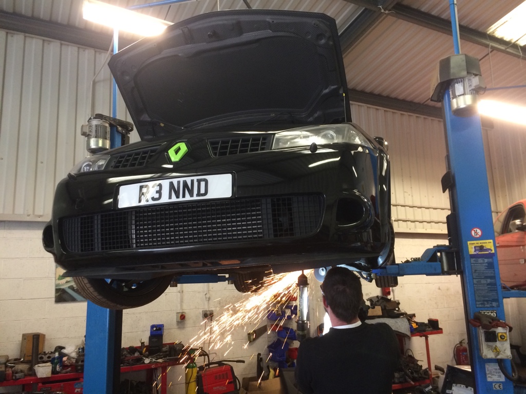

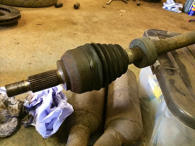

Had a few spare days so took her to Fred for gearbox mount to be fitted and CV boot fixed..
He found the above sat bolted into a void so we took it out, I think it's for balance or resonance but none of the later megs have it so it was promptly gotten rid of. Weighed a fair whack too.

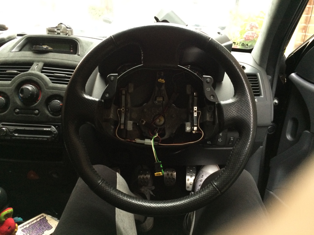

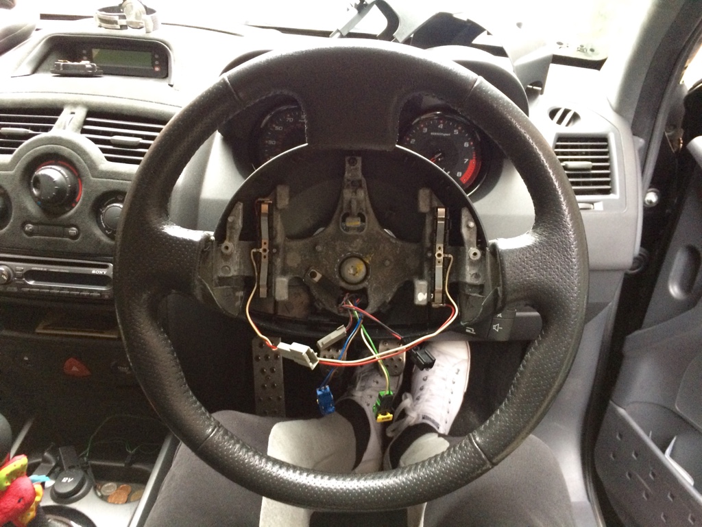

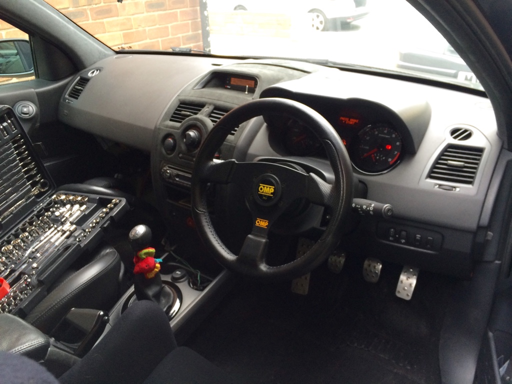

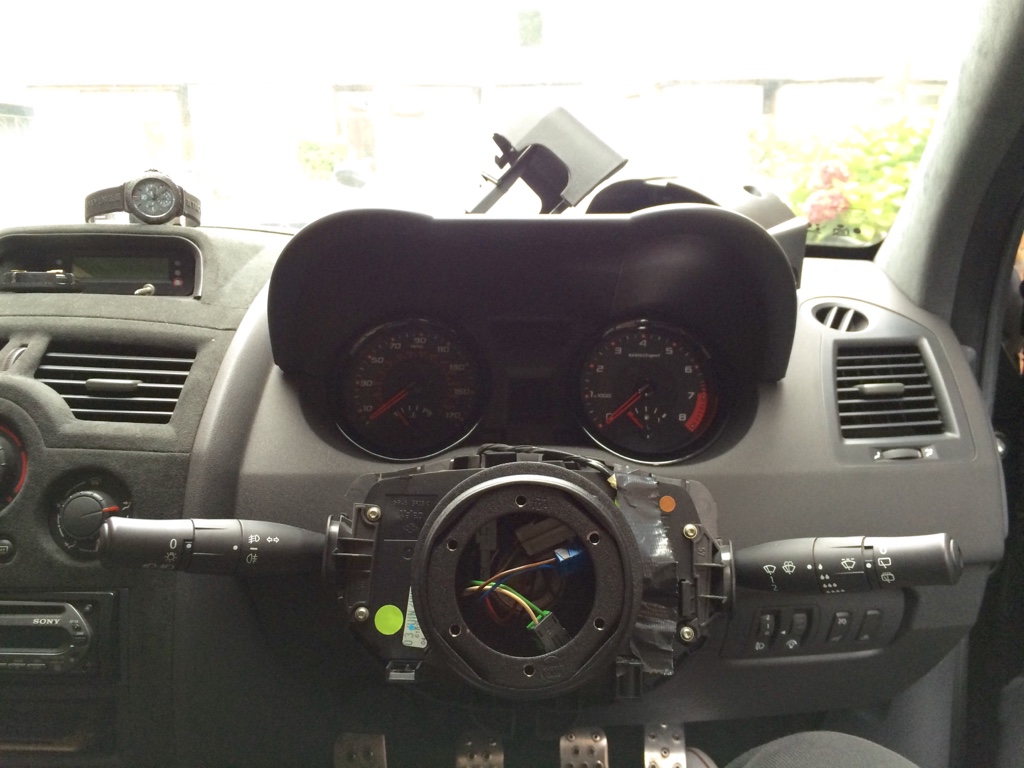

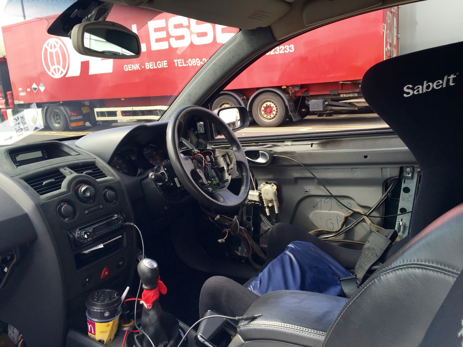

Fitted the OMP today, quite easy really, even for me.
Started by taking off the old wheel and all its gubbins. I'm going to retain the cruise control so was careful to not rip any wires, you'd have to be an idiot to do any damage but this is me we're talking about.
Turned wheel 180 degrees, Left battery disconnected for ten mins, I undid two screws and pushed a screw driver in behind the wheel which in effect pops the airbag unit off.

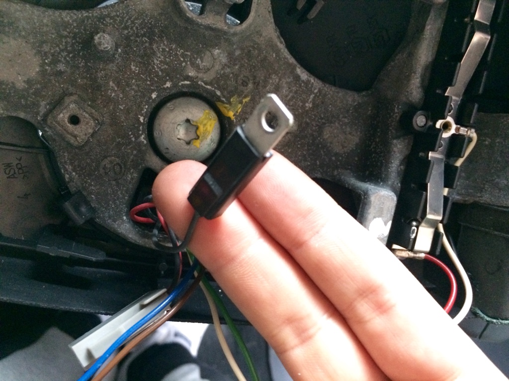

I always have the fear that the airbag will go off even with no power so I took my time and eventually disconnected everything.
No idea what this is, take it it's an earth?
I also removed the steering wheel volume control but only realised upon closing it all up there's a massive gap.
Fitted the boss...
So it's on, not put the airbag resistors in, connected the horn or the cruise control but I'm happy with it all.
I need to get the CC button set from Josh G off here and work out what to do with that sodding hole.

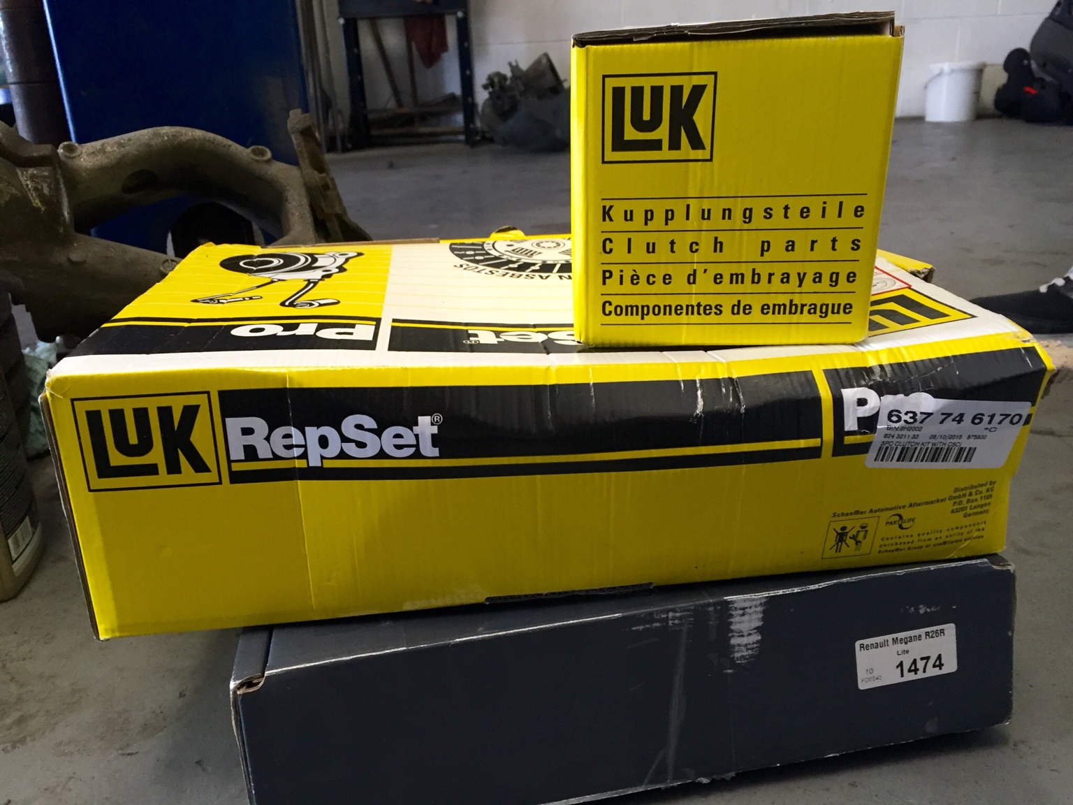

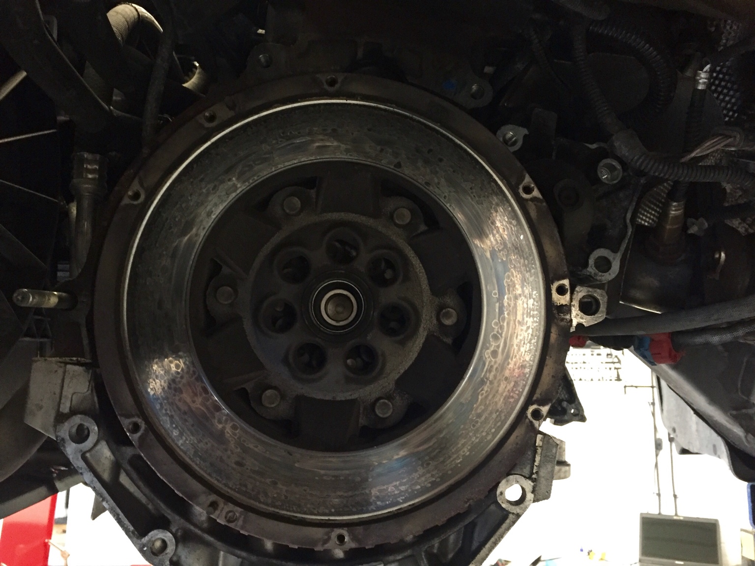

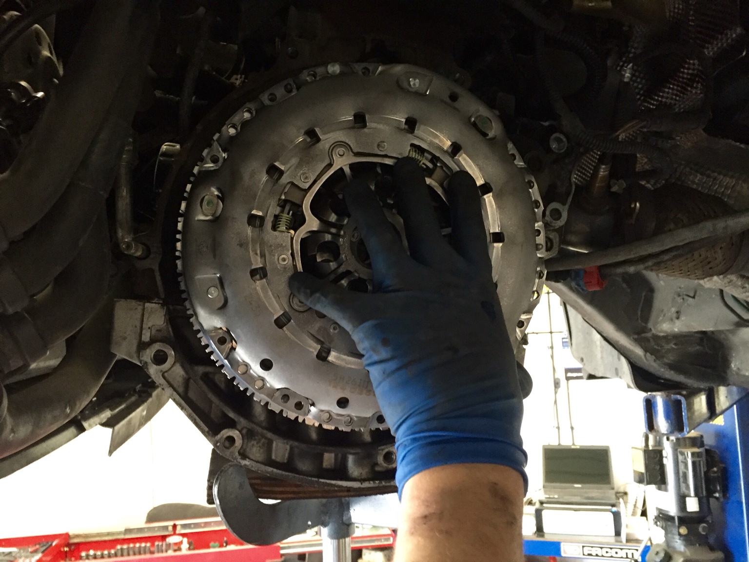

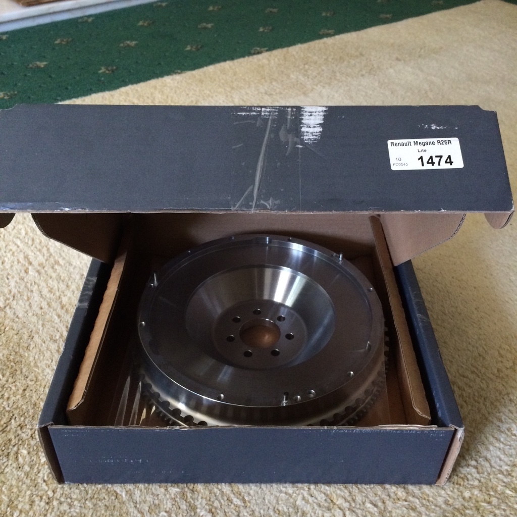

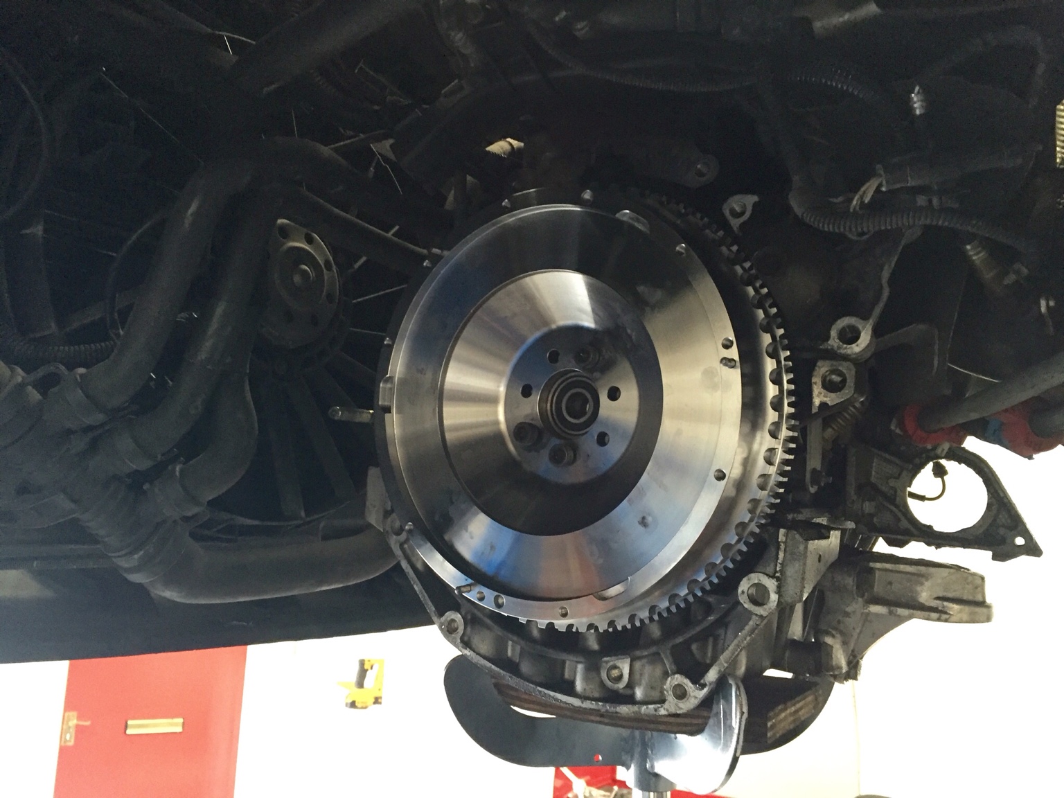

Fast forward to May and I got her over to Mark Blacks. Whilst there Mark lived up to his absolutely sterling reputation and worked his magic. I had all the bushes Powerflex'd, new steering rack bush, hub refurb on both sides, new SMF, .R Clutch/CSC, service and all faults cleared.

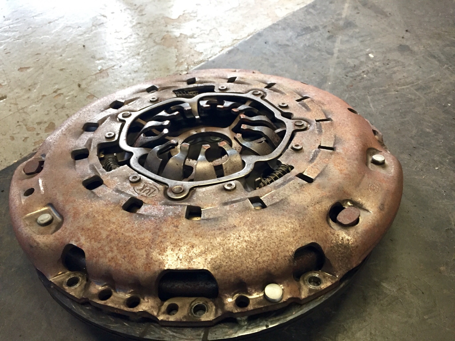

Apparently the DMF had a week or so left in it, white burns on it and could have been nasty if it failed.
Ended up with a little mishap whereby the clutch ordered was the wrong one, my guy at ECP made the mistake but its no biggy, these things happen.
I left it with him for the week to do other bits and picked it up ready for Lemans.
