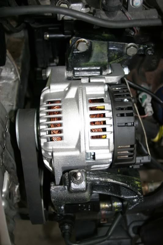

i have already posted about my alternator woes, and it was at this time i got all the work done, alot went on and i have posted some already, the engine mounts and the stud conversion were done when we discovered we couldn't continue with the alternator...

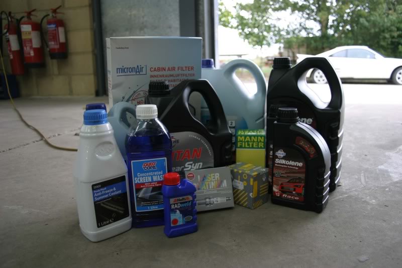

so all the consumables
^^thanks to opie oils
^^^and maynard...top bloke

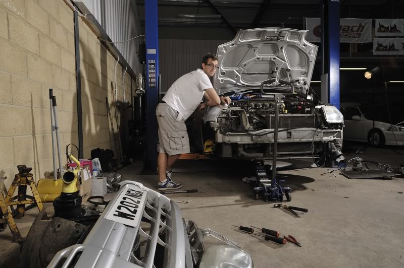

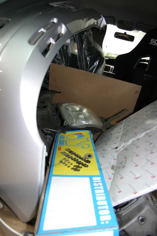

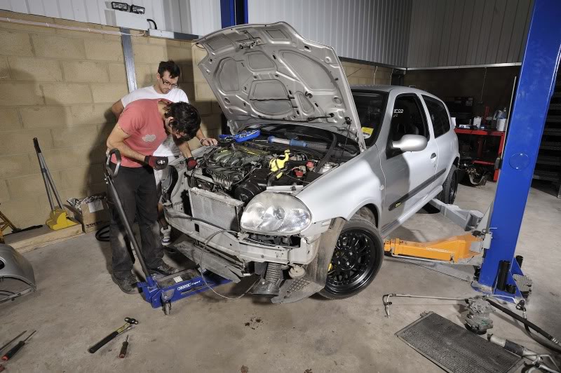

and to begin...the car was stripped down
all bits in back of car to keep tidy

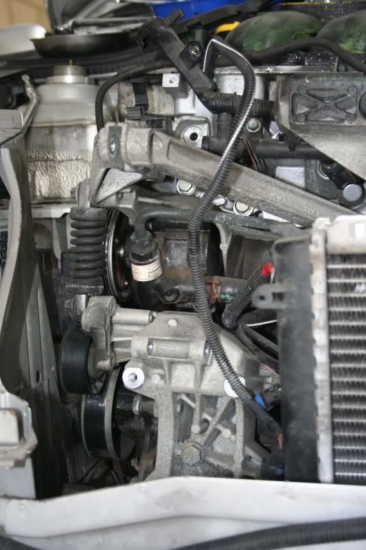

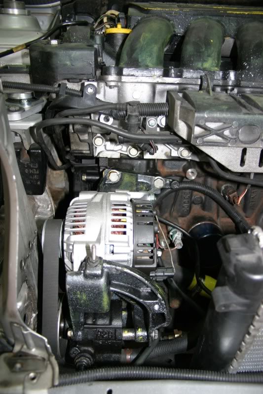

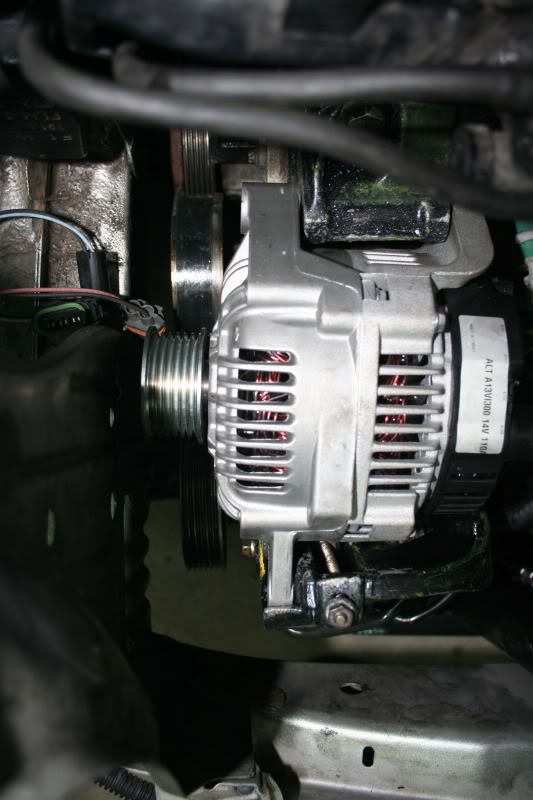

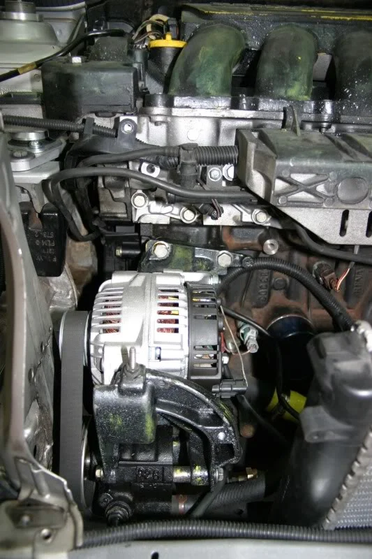

and then onto the alternator...it was a case of 3rd time lucky and i ended up just ordering a cup alternator from renault...best way imo, should of done it sooner, product code can be found earlier in the thread..
wrong alternator
right alternator

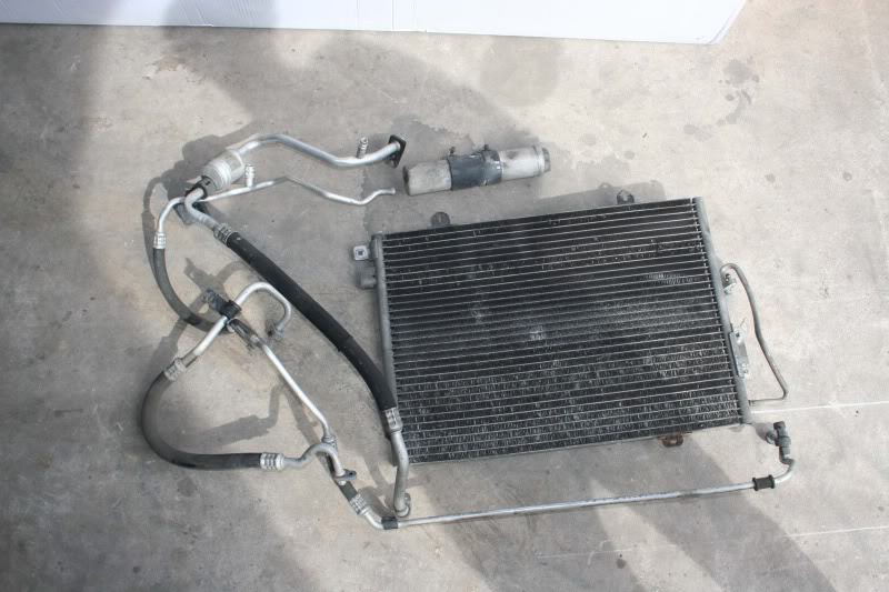

much better fit, and as all this was now in, it meant this didn't have to be

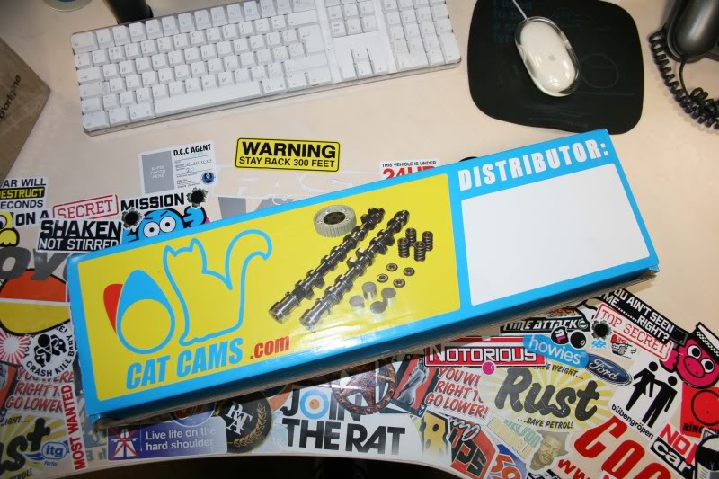

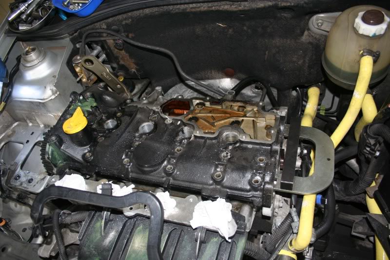

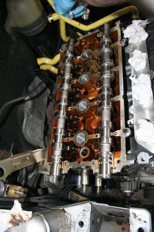

so then onto the cams....
opened up.....
the timing
the outcome - well without being mapped i am majorly impressed, so much more torquey.....Catcam 428's are awesome and highly recommended

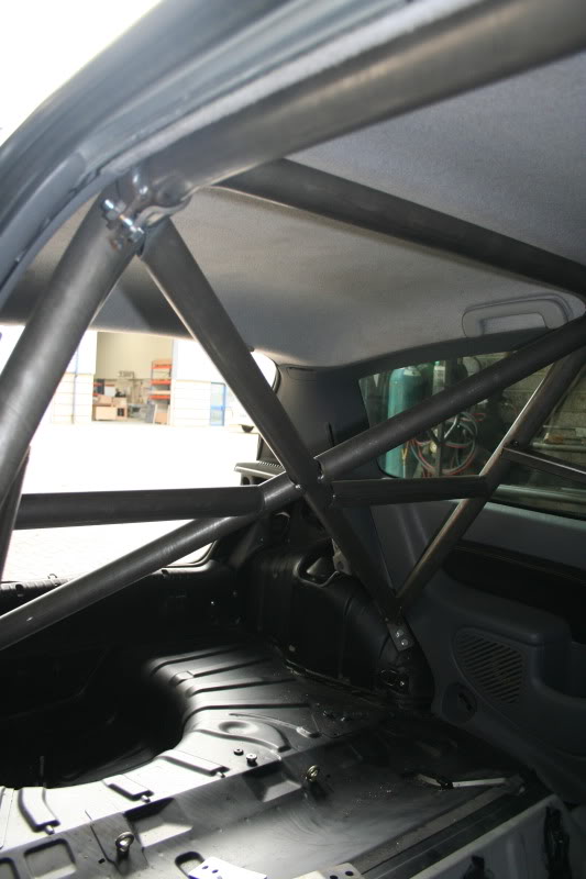

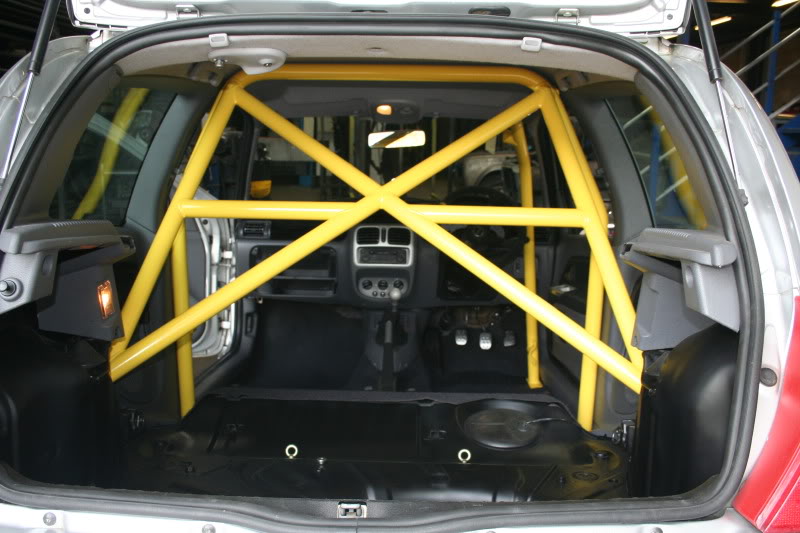

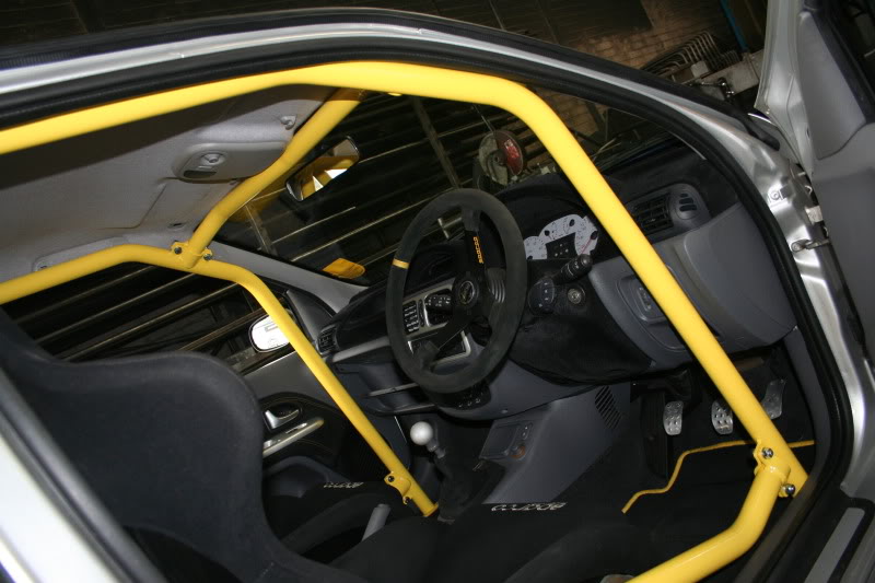

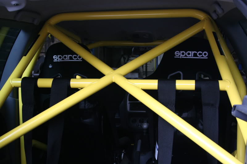

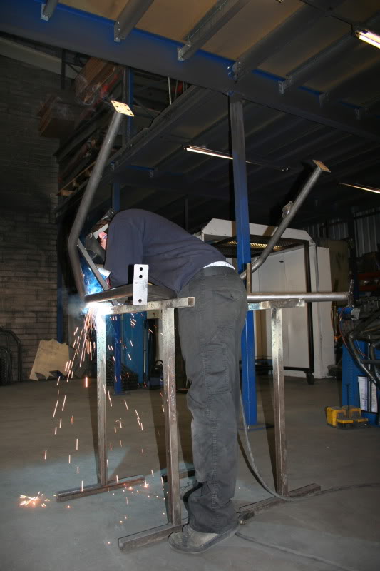

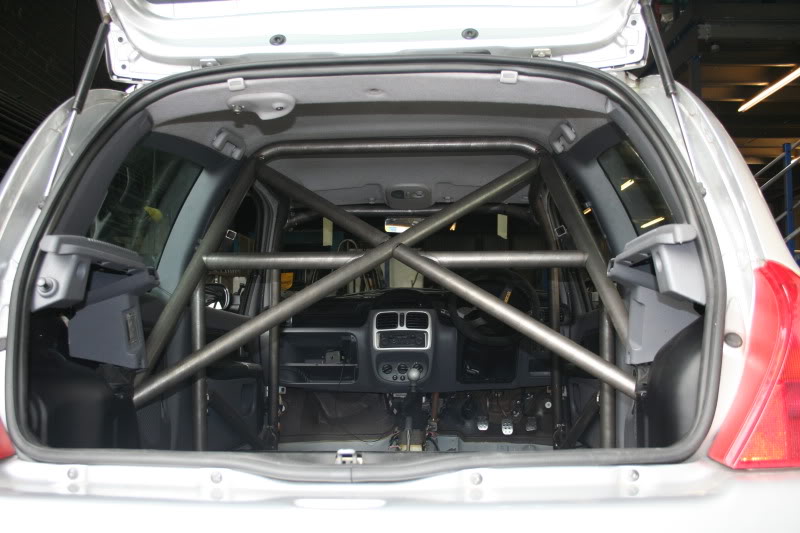

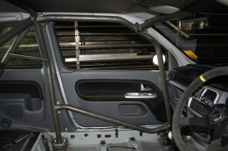

the day after trax the car was dropped off at CAGED for beleive it or not a roll cage....

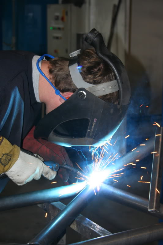

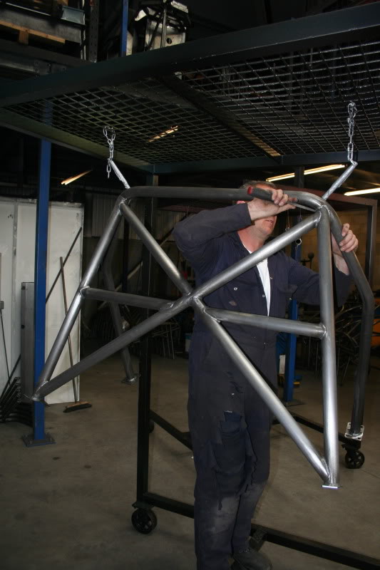

they built the cage and just tacked it together to get the shapes perfect, then got in contact so i could be there for the final part, i went down today i watched / helped sort the final bit..pics show the flow...
the cage tacked and placed in the car
taken back out and being finished

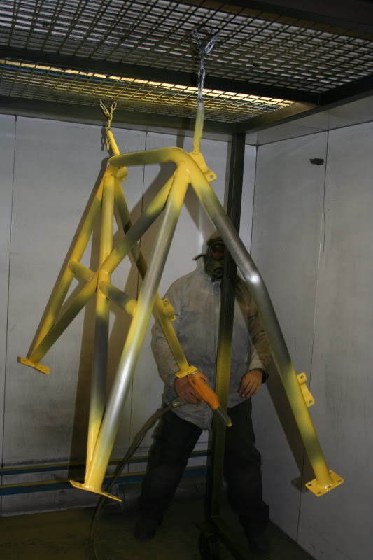

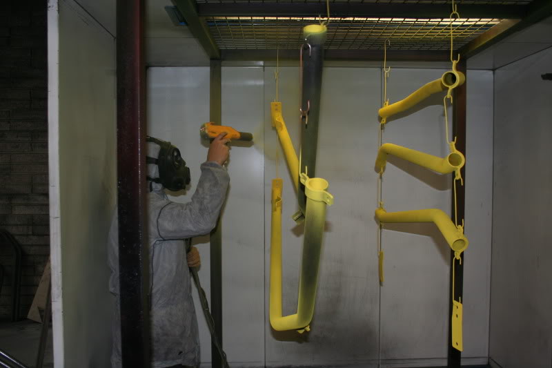

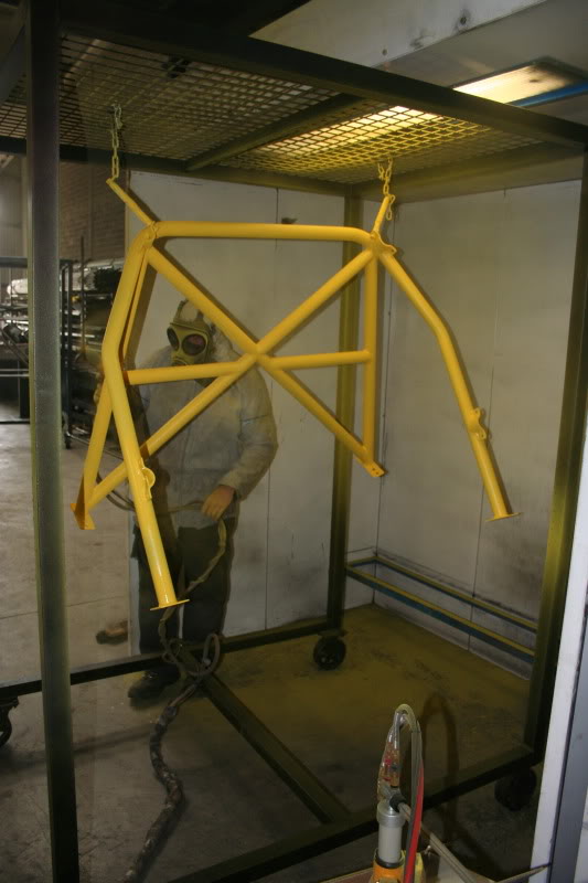

this was then heated for 10mins to 200degs, then powdercoated

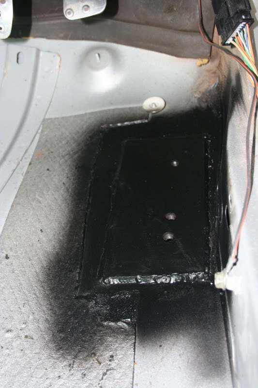

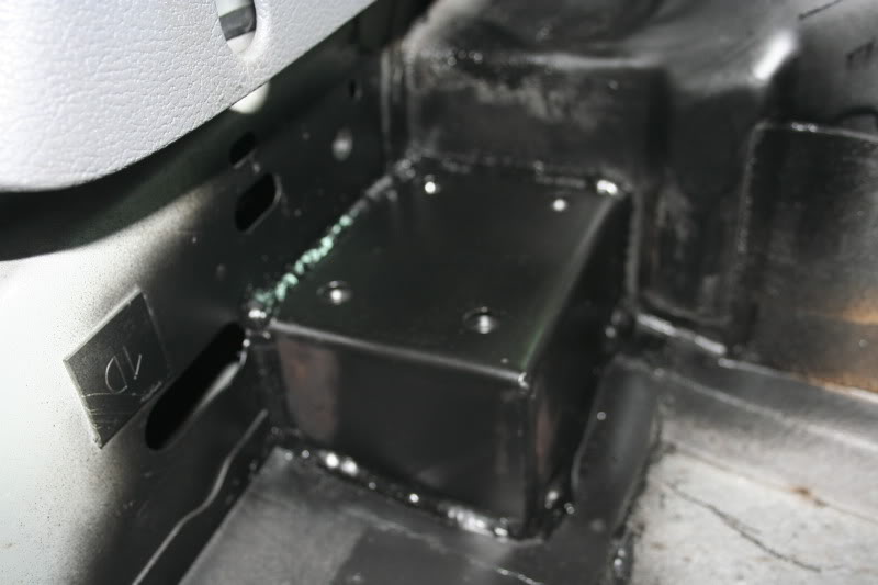

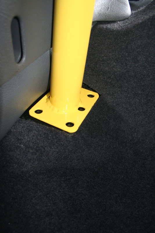

this was then let to dry before applying to the car...as it was drying i decided to paint up the mounting points to match the rear satin black of the car

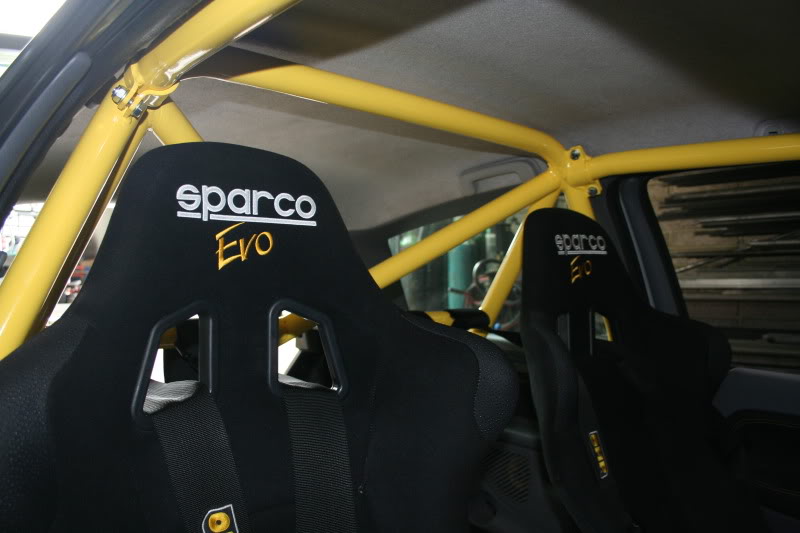

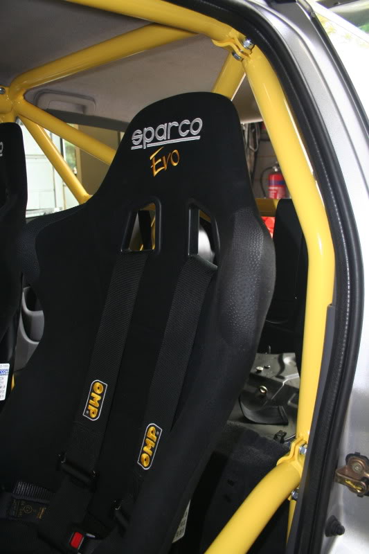

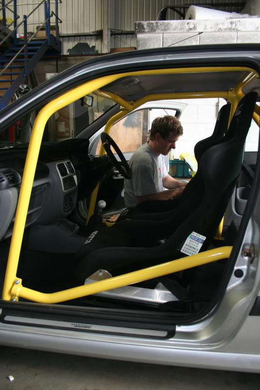

cage was then placed in the car and bolted in...
all going in
CAGED is a great company to go to for this, they have masses of experience and can apply there work to anything and basically give you exactly what you want..well worth it over a standard (non-custom) cage from the horror stories i have heard....
