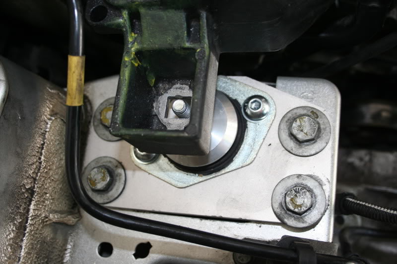

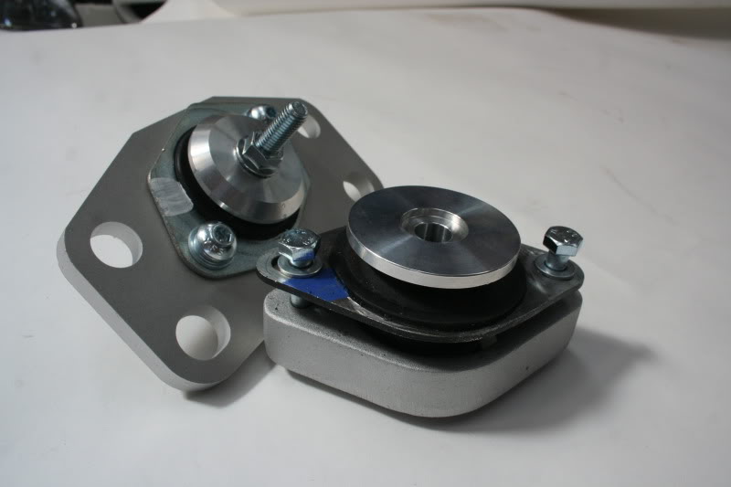

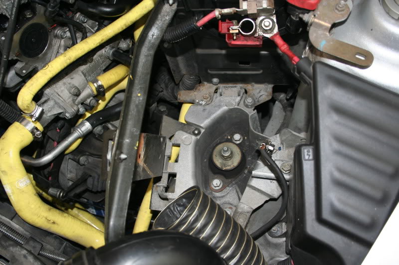

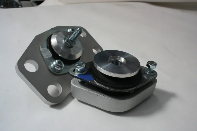

received my K-tec (vibratechnics) engine and gearbox mounts.....so went to the office and collected them, then went back to the workshop and fitted them, on the gearbox mount the so called captive nuts were rubbish....glad i have upgraded now...
mounts
gearbox mount in place
upper engine mount in place

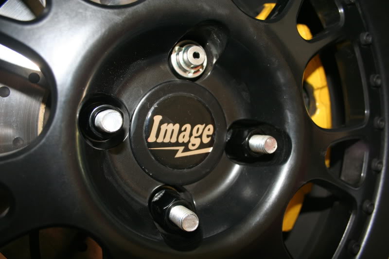

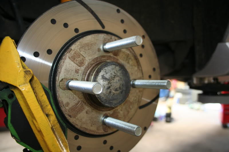

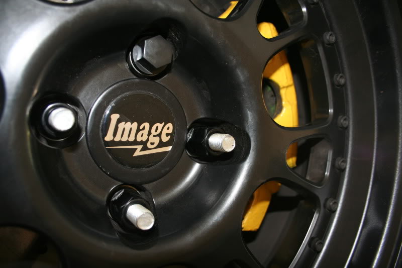

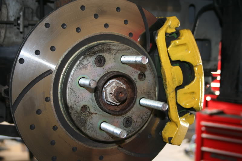

then fitted my stud conversion studs and bolts from Grayston, i decided in the end to go for the 80mm studs all the way round, would deffo give me mucho clearance for the wheels and open studs, i then had to measure up 4 and cut these down for the lockers, took a while to get them all loctited / measured cut and fixed but i think they look awesome, will make the job of changing wheels easy...
studs in rear
studs in front and cut down for locker
with bolts and locker on
with all bolts and locker cover on also

interested to hear opinion on the mounts after what i said about them, might be next in line on my list too

will let you know on the mounts bomber..the car is getting a fair bit more hardcore now with those and the cage...

I need a new gearbox mount but have just had a standard new upper engine mount fitted!?!? Wonder if the Ktec gearbox mount would be alright on its own.

think studs need to be on my list too, especially as ive got the track and road wheels now. just make it a bit easier on swapping all the time.

it takes a bit of patience and maths to sort the lockers stud but if you can be patient its worth it

drove home and all was good, bit of vibration from the new mounts but if you can't hack that you must be a p*ssy...goes well and all feels so tight
