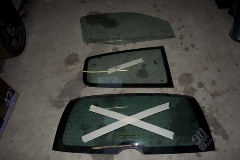

When I worked for BMW Mini they used to put little rubber blobs like the blobs you get on the bottom of your laptop or computer. So when the glass was decked it wouldnt go in too much and sit flush

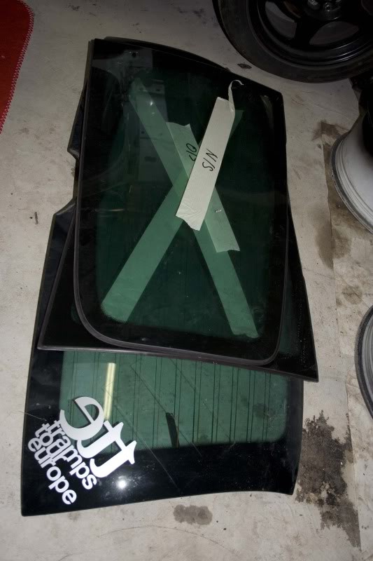

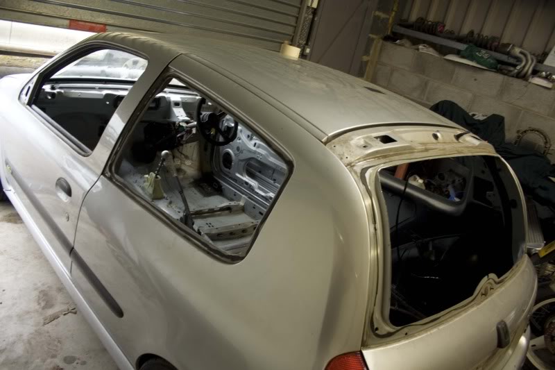

so i had another day on the clio yesterday and there was a few jobs i wanted to get done prior to today. i achieved a few of these but the others just got lost amidst doing others, oh well.
The first thing i needed to do was remove the front drivers and passenger windows, i got a call in the week from my mate where the car is kept saying that the rest of the windows had been removed, happy days, so when i got down there i was left with this...

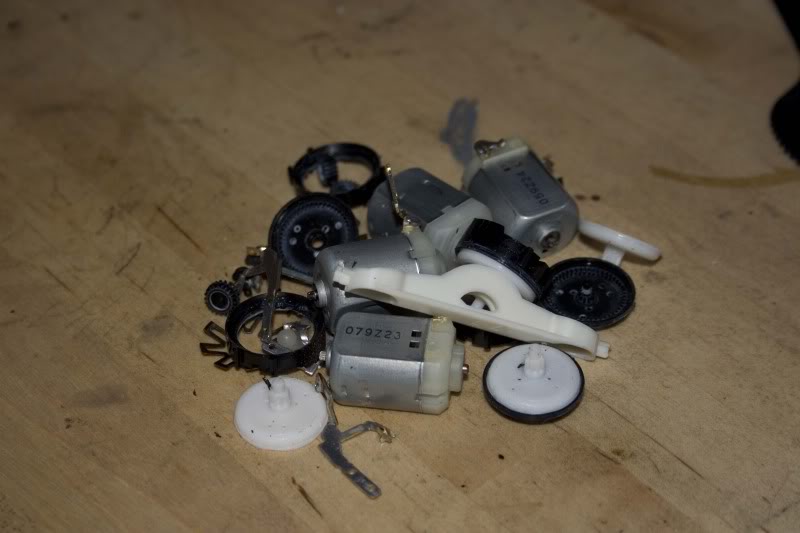

20mins later and the fronts were both out also, motors, all wiring, rubbers etc etc, she now sat windowless (except for the windscreen just placed in)
(the motors, and full door looms and all the glass will be up for sale if anyones bothered)

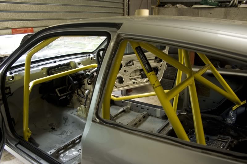

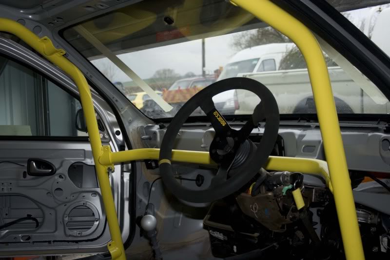

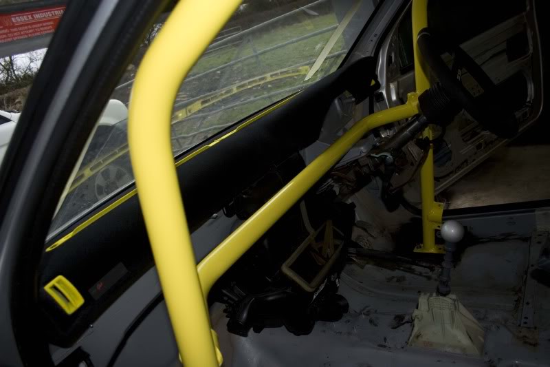

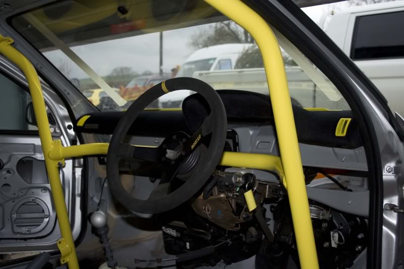

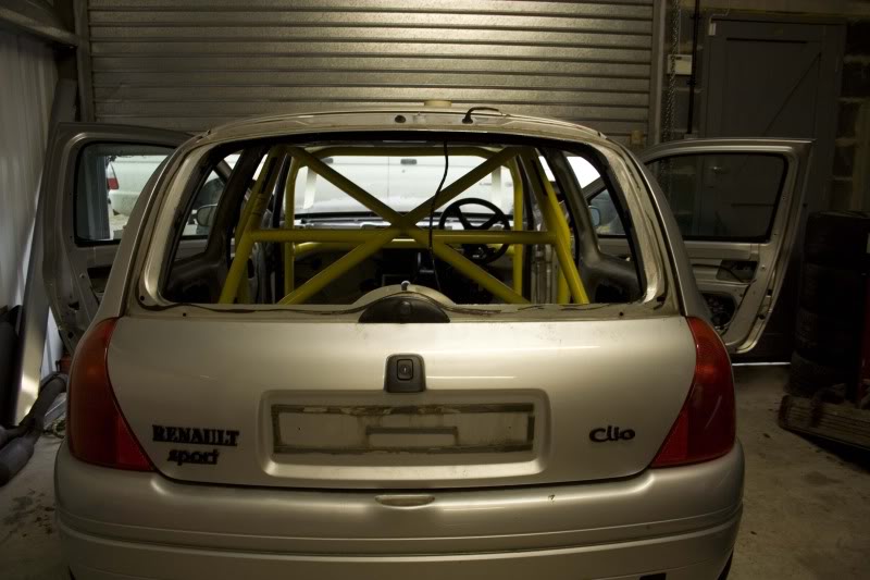

next up was to remove the cage, only a few weeks ago the cage had another bar welded in across the dash area but it needed to come back out again now as the interior needs more work, so on with it, however i trial fitted the mark 1 dash back in with the new dash bar in. To say i am happy with how it looks is an understatement.
before:
after:
it sits perfectly and it looks spot on height wise for where the race technology dash 2 is going to sit, happy days

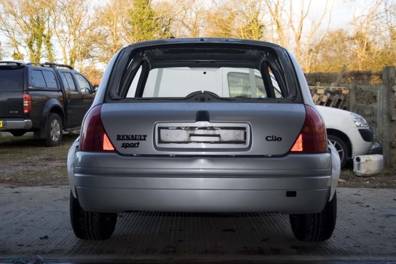

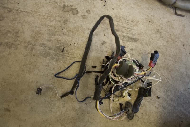

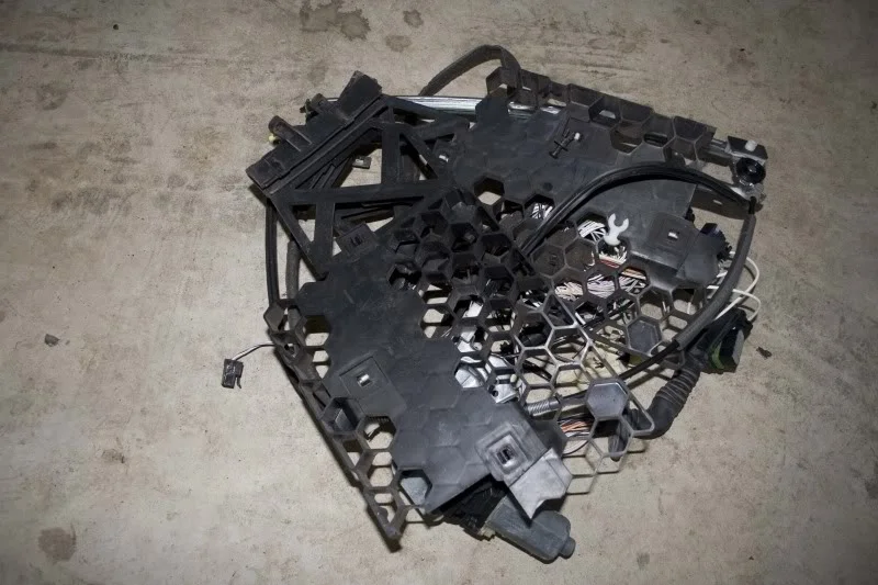

next up with all the windows, the cage and blower / heater matrix removed i set about removing the rear loom as this was only held in before by the rear window heater. Now the rear was going polycarb i didn't need it, so out came the rear loom and that soon got chopped and yanked, i cut one wire i shouldn't but its now back together so its all good
lots of wires

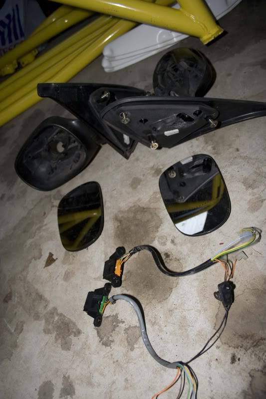

next up i got distracted by the wing mirrors, i removed these as i wanted to remove the wires from them, they won't need to be electric so i got to it, got dam that was a pain in the ass, its not just a few wires, but a whole world of pain, heres all the stuff removed from just wing mirror mechanisms
but they both got done and put to one side, now a darn sight lighter...

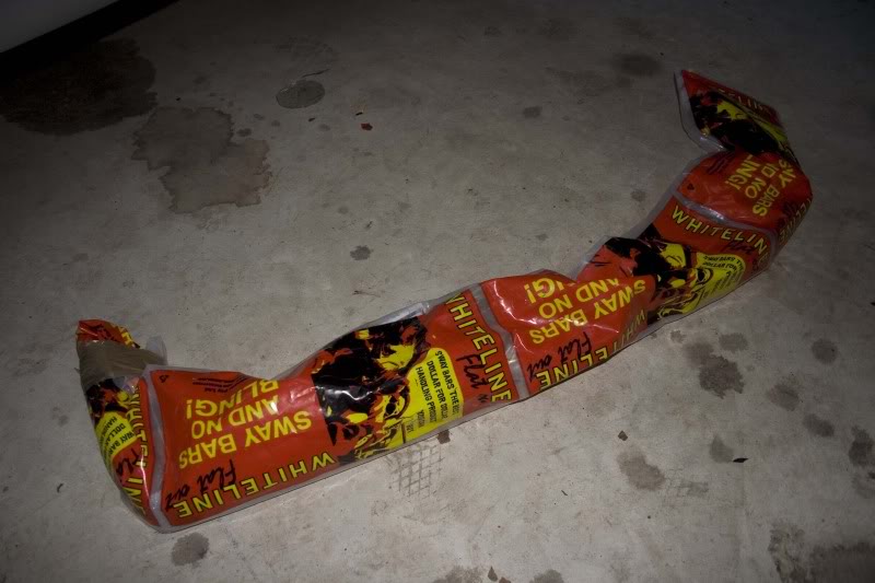

i thought i also better take a snap of my whiteline that i received the other day, also in the pack are some front whiteline camber bolts, this teamed with the powerflex bush kit that is on its way should sort the front out a treat, all i need now is some new coilovers.

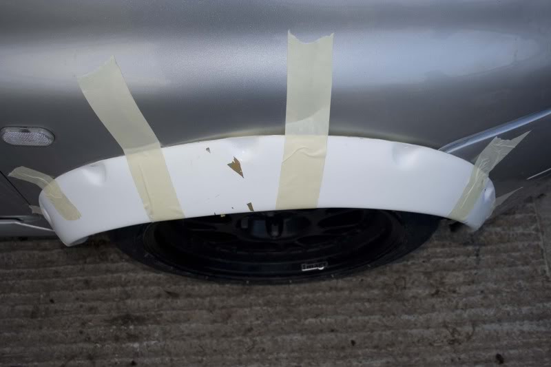

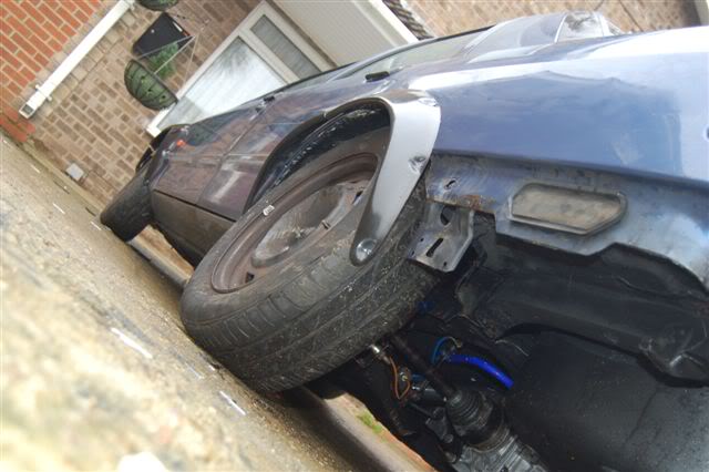

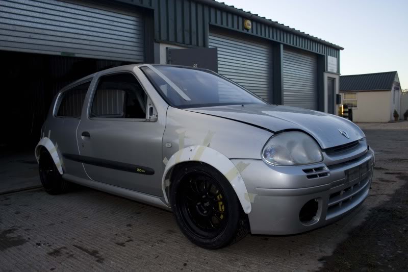

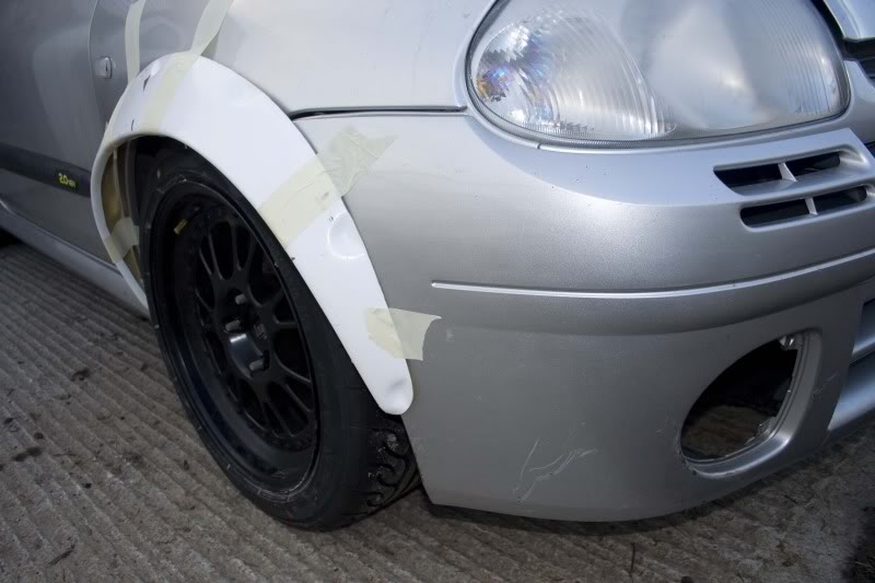

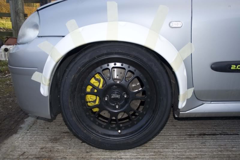

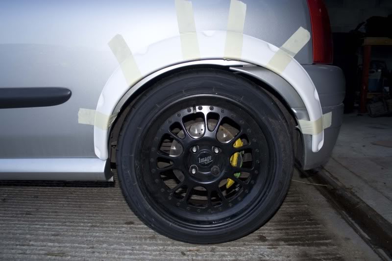

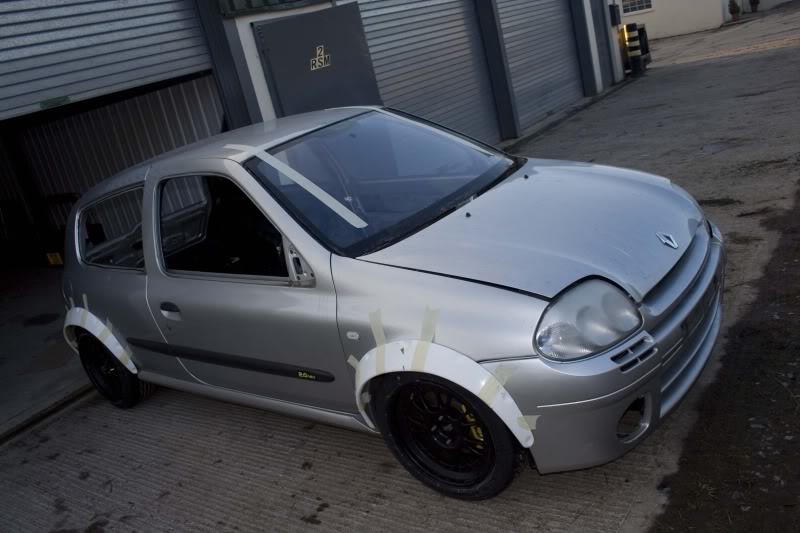

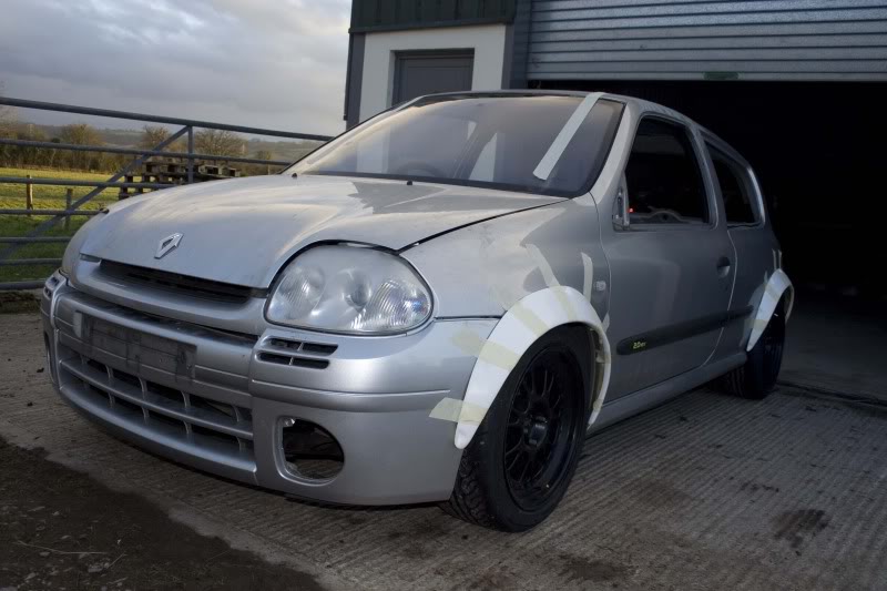

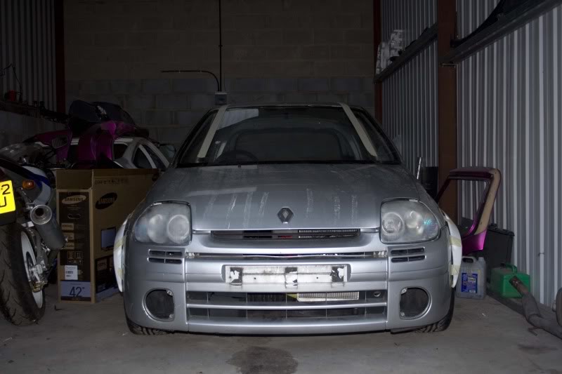

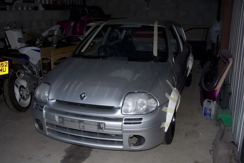

and so with the end of the day approaching and me not wanting to get into anything big i got to taping the over-fenders on for an idea on how they would look, the people who have been following the thread will know why these where going on... i received the over-fenders a few weeks ago but with other bits going on, then the snow i only managed to get them mocked up today, see below.
They are a universal, and really the only aftermarket type of thing you can get, i was a little bit dubious of the size when i got them, and then offered them up to a 19" wheel we had in the office (which they fitted relatively well). I always said that if it didn't look right it wouldn't happen and i would have to look at some other way around the issues i may soon have.
Needless to say, i think i will be posting these back.

overfenders :eek: i love em but the track needs widening loooooooads for its to even be close to working visually, good progress though buddy
Re: No Compromise ph1 ITB build (Fastcar, BTM, TDF, RS Fab) - ITB update p77
they just flat out don't work with the lines of the car, hence why they will be going back i think
Shame the over fenders don't work, I guess they don't suit such a rounded car so much as an 80's square box :-(

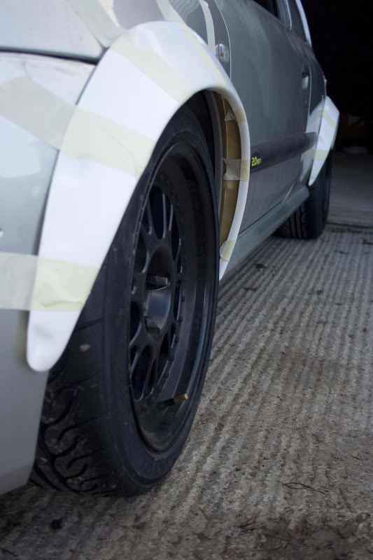

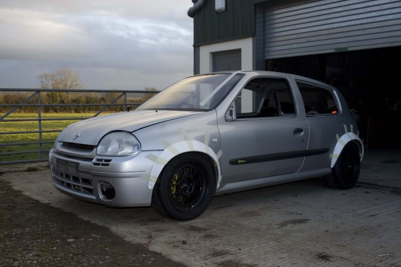

you mean like this? ...lol, it's a collegues car, these are exactly the same over-fenders, works on his (this is a work in progress)
Such a shame this didn't pan out for yours :( Would of thought you would of mocked something amazing up on PS first mind you??
Az you hav talent init!!

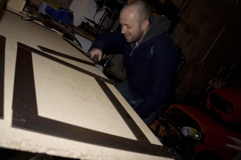

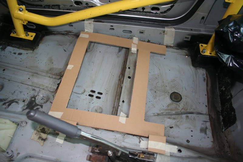

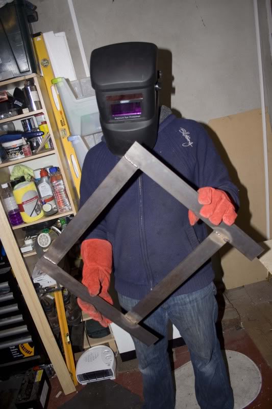

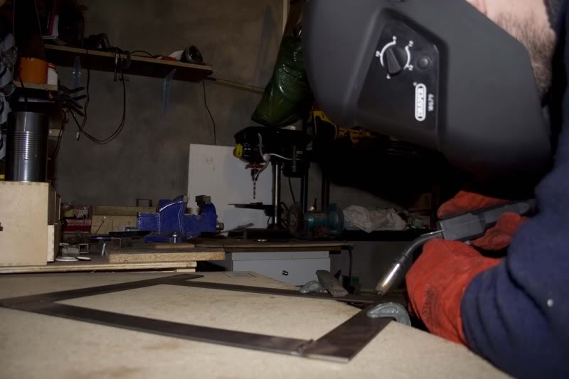

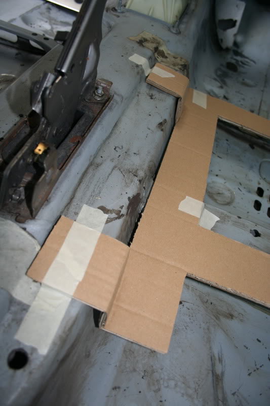

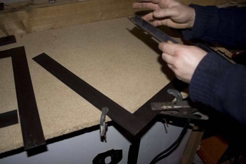

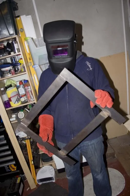

not done massive amounts this weekend, ended up going and collecting a van with my mate then popped back and started some fabrication on the seat subframes with another friend of mine..

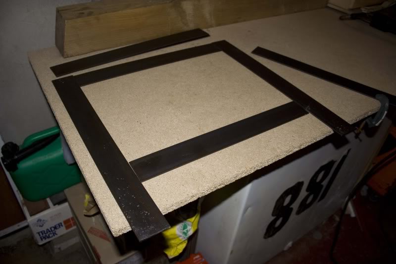

the initial idea was to create the same as this carboard template out of 4mm sheet steel.
the thing that i was a little bit unsure of was these tabs and how they would work and how strong they would be
we got fabricating...
so 1 done
we done the same for the second and then looked at the tabs, we bent these up but dues to the nature of the bend we were unsure, we decided to go and check these against the car, whilst checking them my previous worries reared there heads again, we were unsure if the tabs would be a good idea, they could flex alot and may not be the best approach, we think the best approach now may be to not weld the tabs on and instead to bung the holes in the exhaust tunnel, then bolt through the rails (that go across the car), possibly through to the underside of the car and keep strength here using spreader plates....
all opinions and ideas welcome on this

The rails on mine have been fine bolted to, Adey has only bolted his to the rear seat rail because be sits so far back. I've never bothered with proper frames.

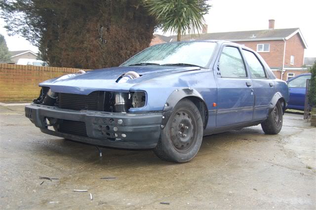

Is that stavs sierra? hoooooge turbos = likey

looking good fella! I think i might be the only one who quite likes the arches!
how has he only used the rears mate? the rears were the problem, they tilt slightly (ie do not sit flat), how else is he mounting them? spacering them up elsewhere? could you point him in this direction mate?
its jamie's from fast ford mag, awesome isn't it
might have already said but do you have a particular target date?
i did have a re-think about the arches, lol, i thought actually they could work... that was after a few people said they looked awesome, then i thought through how much work they would really be, and i removed them yesterday, they will be posted back tomorrow.

Adey's seat is now sitting at the angle of that rear beam, drug dealer stylee. He'll be over in the week, will take a pic and send it your way

then i heard from the polycarb wndow man and we are having a trial fit next week, excited now
