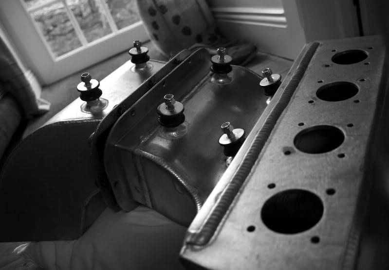

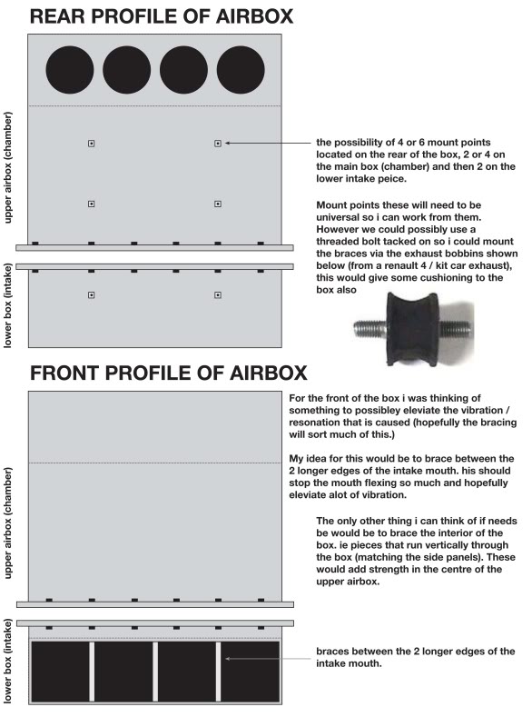

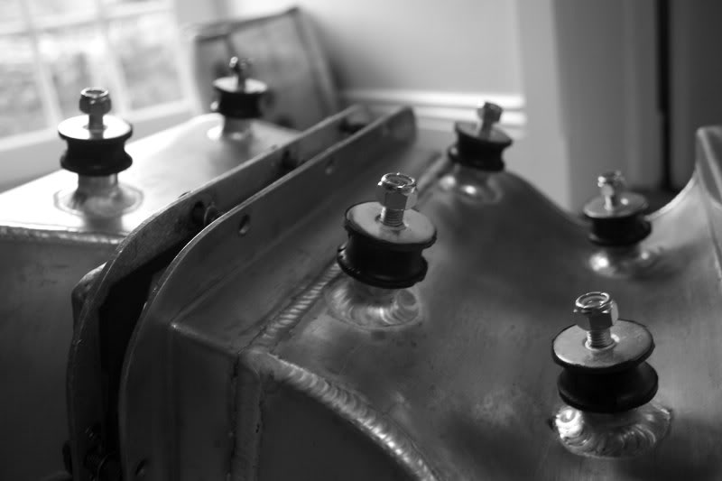

as mentioned above/previously i collected my airbox from RS fabrications
the idea of the work was to just give the box a bit more support, it was thought the best way to do this would be to have support off the block to the rear of the box so when the block moves the box moves with it, i drew up a very quick indesign file and got it sent to Russell at RS fab.... looked a bit like this...
and i collected and it looks like this...
very happy, think it will do a very good job,
they also decided to do some other strengthening bits to the box like some double welding (inside and out) and a support bar at the base of the mounting face,
i am now going to look for some nice spongy gasket stuff for the mounting face of the box, possibly cork or something, i will post with what i come up with

That welding makes me feel like a little school girl! Cork might start to flake off if its getting wet and dry often, might be wrong though

That certainly looks the business. :D

I have no idea if that's good or bad but it looks cool.

Trident motorsport at Silverstone do a high density sticky back foam,it's very good,we used it for the camera mount.

The airbox looks very very well made :)
cheers mate, will research now.
