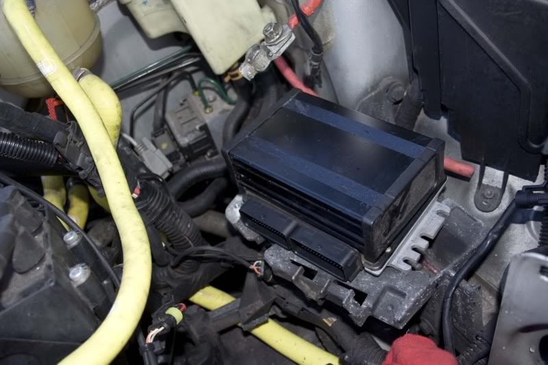

So the first job of the day was to run the battery cable from the engine bay through into the car. To do this i first wanted to remove the ecu off the brackets, the water bottle and the power steering bottle as these were still holding the last bit of hear shield/carpet at the back of the engine bay. It all came away quite easily. the ecu's were unplugged and there was loads of access.
am i right in saying that you can somehow just bolt the ecu back down like the above?...sure people have done it without having to drill more holes etc.

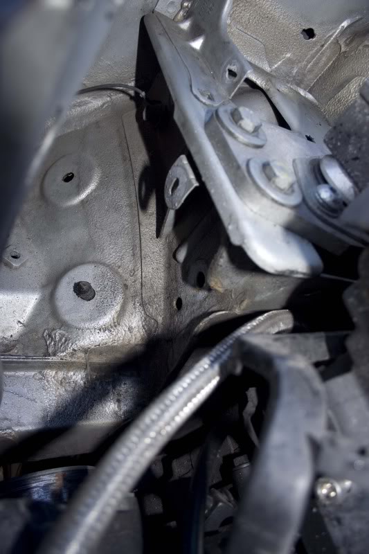

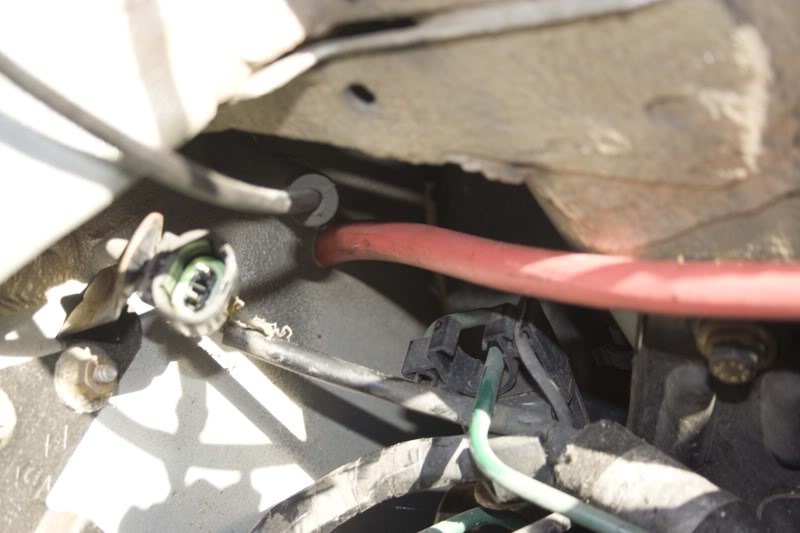

With all that out the way i found a nice spot to run the battery cable, this would sit about half an inch below were the bonnet release cable passes through, here you can see the cable going into the car from the bay...

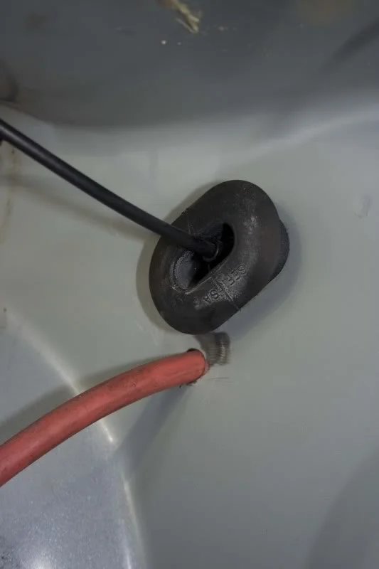

and then out the other side...
i do have a bung for it so it will be water-tight, but that was at home, will only get removed before paint anyways...

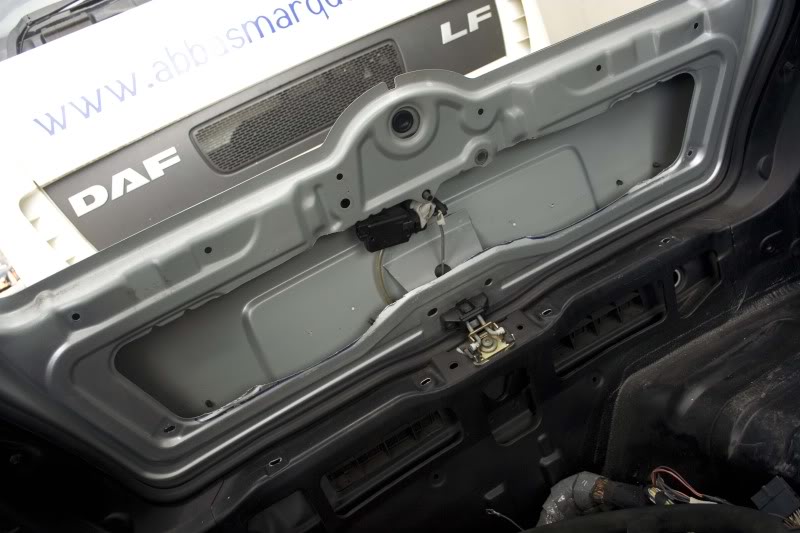

so onto the next job, i keep grinding and cutting bits and thinking i have done, i did this the other week, but i still had stuff to do, on todays list was the tailgate, the steering column and the rear seat upper mounts, so first of all with the air-saw in hand i got to work on the tailgate, i was super happy with my neatness, it doesn't really matter as this will be covered in carbon anyways, but nice to be neat.

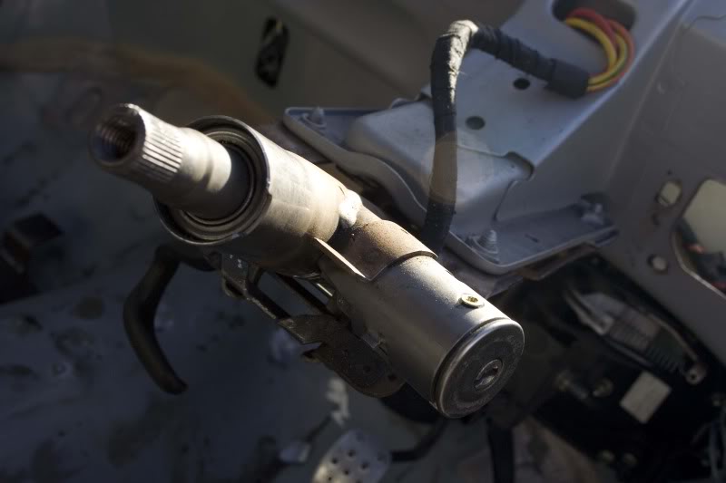

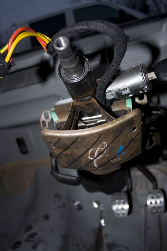

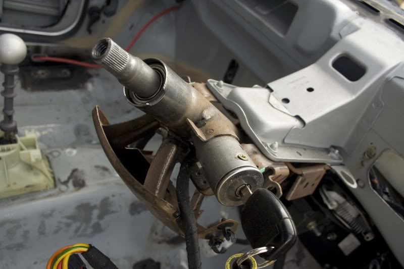

next up was the steering column, you can see where i had marked up for chopping (it seems hit and miss what clios had the extra bits, oh well gone now anyways)
marked up
and after, nice and neat, i air-sawed these then took a grinding disc too them to get them nice and smooth

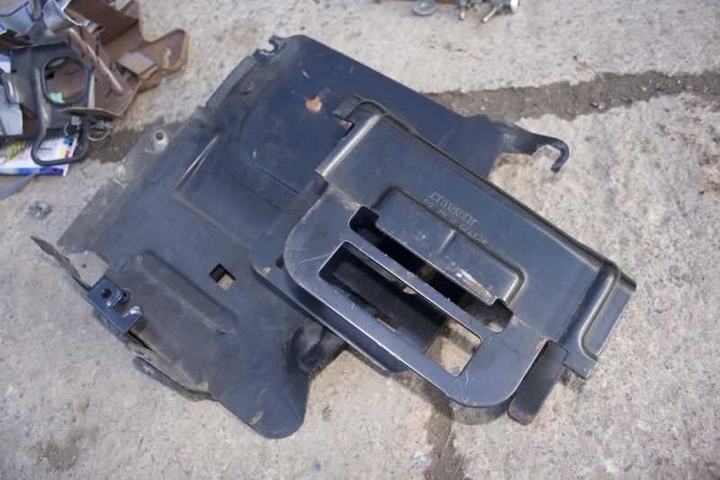

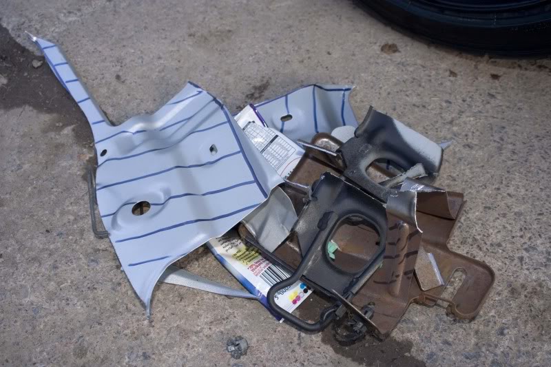

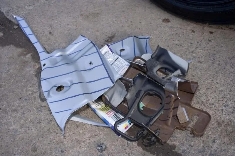

and finally on my path of destruction was the rear seat upper mounts, i was a little unsure how / where to cut this but with a change from the grinding disc to a cutting one i felt the force and just cut away..... job done, and again tidied with the grinder.... happy days, and i think i really am finished now with the power tools....
final bits of metal removed today

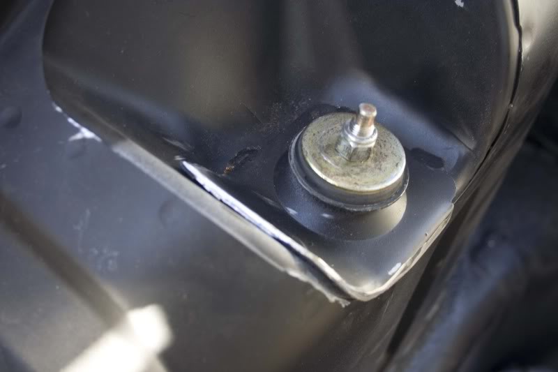

i am sure i did a few other little jobs inbetween but they were pointless to post i think, another thing i wanted to do was remove the massive weight on the drivers side front strut tower, so engine jacked up, engine mount removed and then big weight removed... nice big empty space, surprised how heavy that bloody thing is...lol

I think you have been looking on our car Mr Bone.;)
You need too get that battery cable out and drill it bigger,then put one of those funny grommets in,they come in two pieces or your going to be in big trouble.

Yeah could use one of those,but the only thing is it's another two joints which is not such a good idea.I'm trying to find the one I mean.
