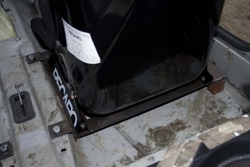

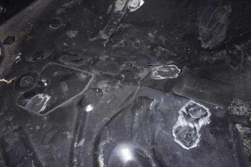

I started off yesterday grinding off the ecess of the welds in the rear of the car, we welded all the holes that were not needed in the rear, these were all ground off nice and flat, along with the front cross-member.

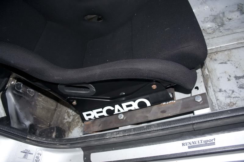

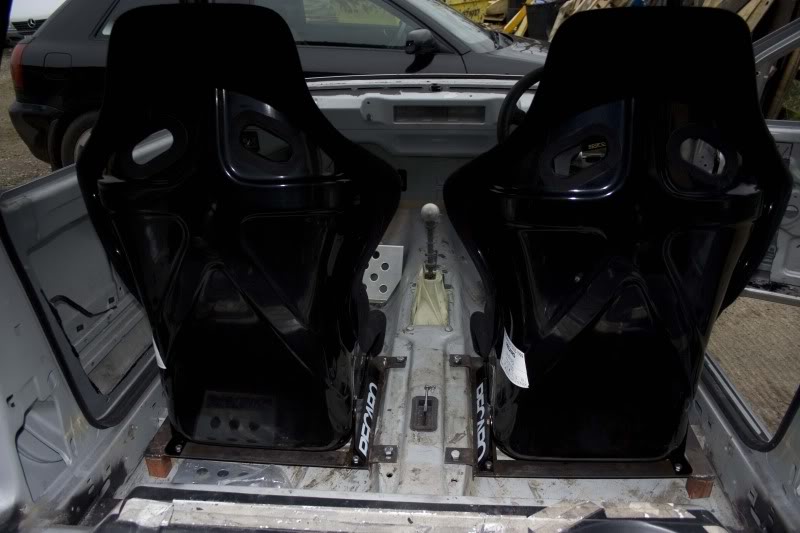

as may have already been seen the other day when we were welded up the seat subframes, well over the past 2 days i got all the bolts i would need sorted, drilled the subframes to fit the car and the seats and then bolted them all together, as you can see the subframes use the existing mount points for strength but still sit nice and super low.... very happy.

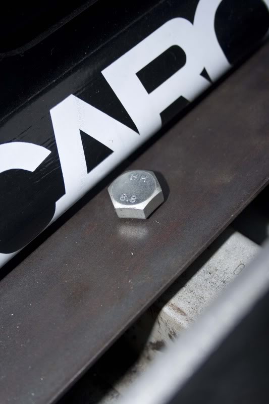

it is impossible to get the subframes to sit flat across the 2 rails that run adjacent to the car, as you can see here there is some space between the subframes and the car (this is the rear drivers side, sill side mount point).
this will be what the above hockey pucks will be used for, they will be trimmed and will sit inbetween the car and subframe at this point, nice and solid but with a tiny bit of give.

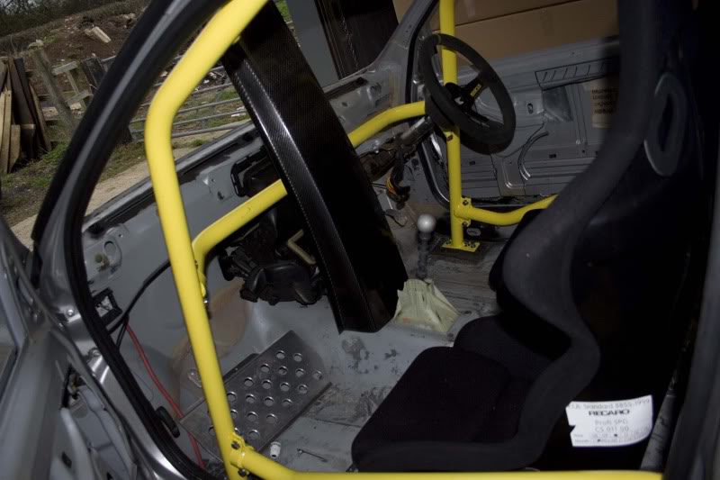

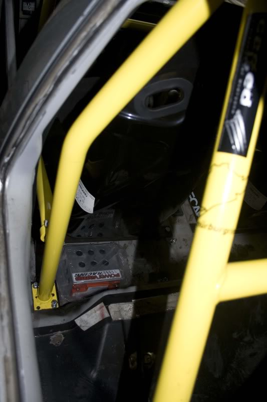

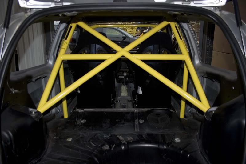

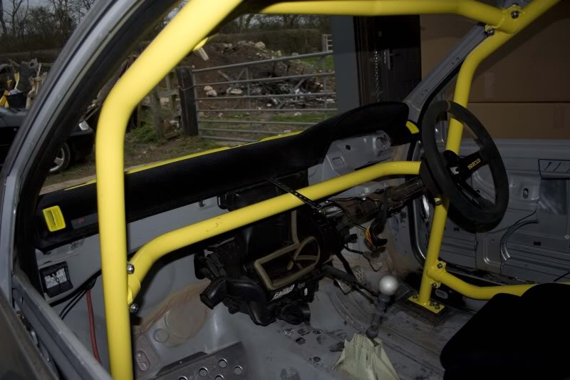

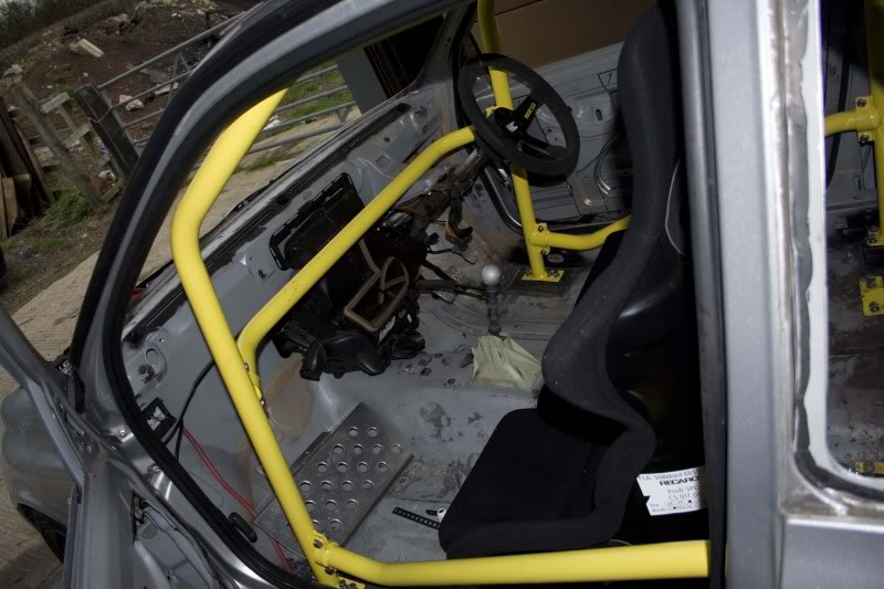

so i think we are now onto PRE-ASSEMBLY, i now have all the parts ready to get the interior looking and fitting right before paint, this is a pretty important stage as everything needs to be perfect before being removed for paint... so...
seats and cage starting to go in...
blower and passenger footrest (yet to be bolted down)
the powervamp racing battery and cage (yet to be bolted down)

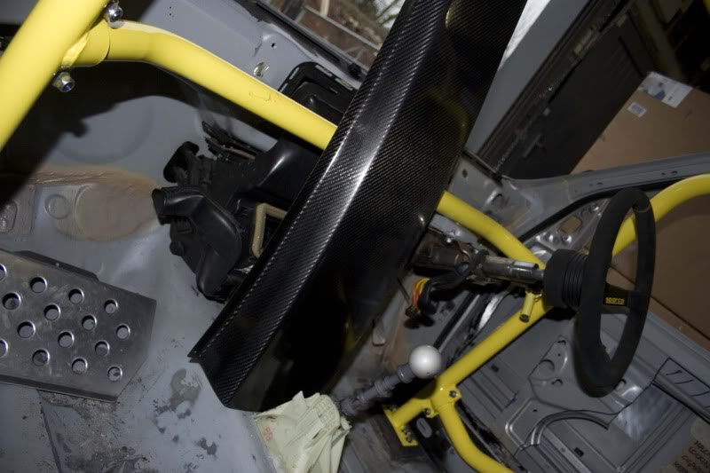

and the flocked mark 1 dash...

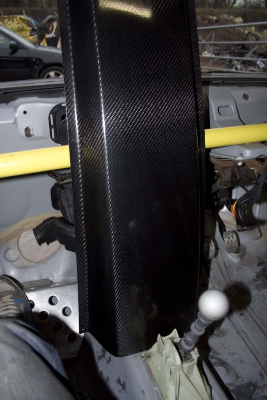

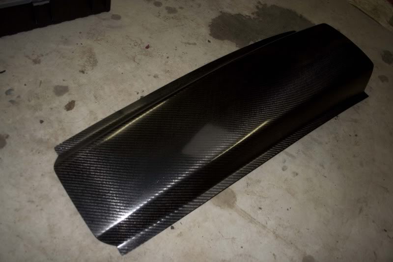

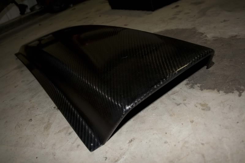

very happy with how its all gone, so whilst on a high i decided to un-wrap my delivery, gorgeous...

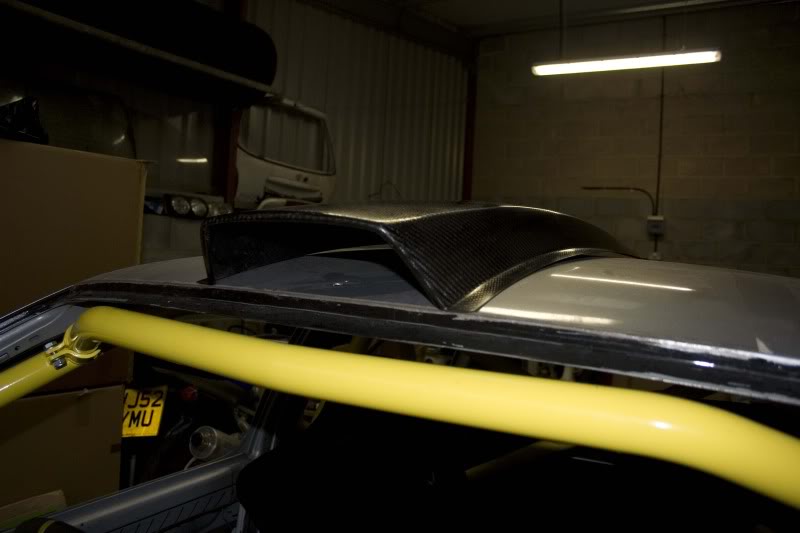

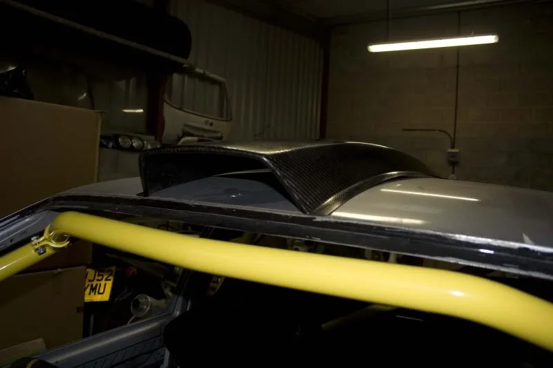

for those that have missed it, it's a Revirie Lotus Exige S2 Carbon Roof Scoop.
and as a roof scoop, it looks bloody good...
it really got me thinking about ordering another as that will not be its application in this instance......but no, i have neither the funds of balls to do that so started eyeing up where it will be going, and to be honest i am chuffed with how it looks like it will fit, with a nice bit of trimming it should be spot on.
it covers the blower and will house the standard blower dials sunken into it.... but thats for another day...

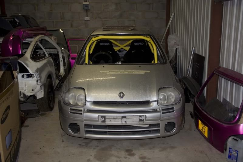

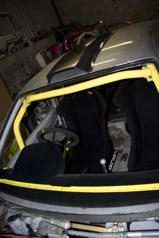

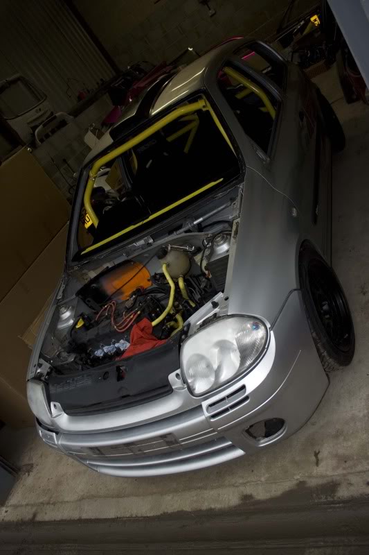

so this is how the car sits now...
it will be like this all weekend as its a wedding this weekend, but the next time i see it i think the front subframes is coming off, any tips advice about that next job is welcome...

Your trimming a £300.00 roof scoop to make a dash!!?? Geezer you could get that form made up for A LOT less than that!

OH i see! I really could not think why you had bought that sexy piece of carbon. Great idea tho, it'll look fantastic when the inside is painted black.
Thats just how i roll.... Lol
Nah in all seriousness i have thought this through a fair bit and getting custom carbon stuff ain't cheap, however i didn't expect the scoop to be double the length i needed, however this may mean that i can actually run a roof scoop, who knows, either way the left over carbon will not be wasted.

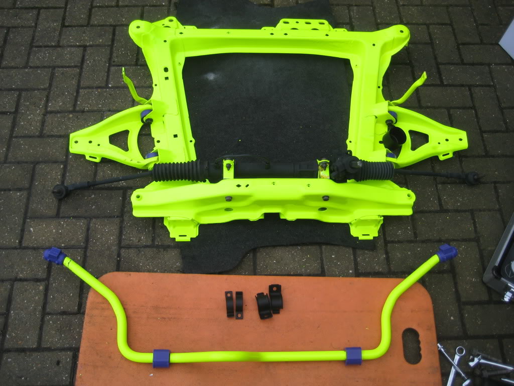

i had a good nose around Chris's car on Sunday, his sub frame looks brilliant Its sooo bright! you going to match it to the cage?
  TrackCar & F30 330d
Re: No Compromise ph1 ITB build (Fastcar, BTM, TDF, RS Fab) - ITB update p77
Ben_p did that to one of his 172's was an epic car. Acid yellow roll cage & subframe :)
  Evo 5 RS
aye, I remember that car. Looked amazing! Mines just satin black ... boring lol
Nafoff
if it was going any colour it would go the same as the cage yes, infact the people that i have already spoken to do the powdercoating were Caged Laser Engineering (Caged)

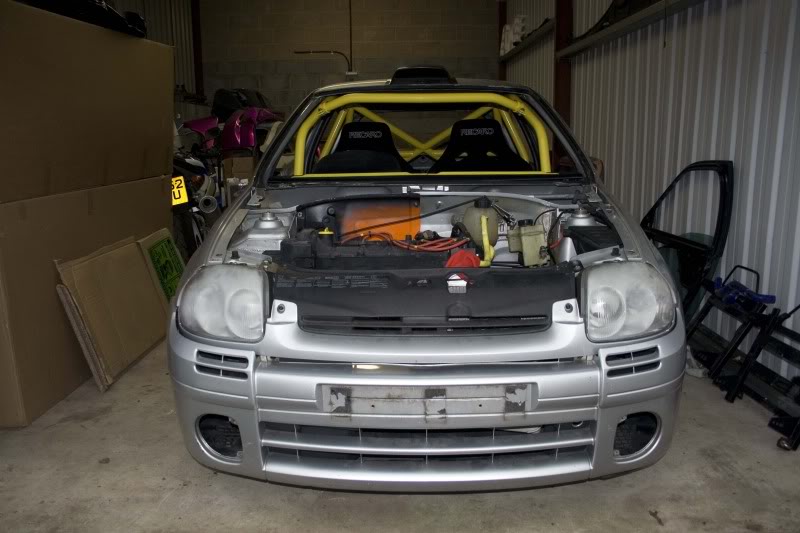

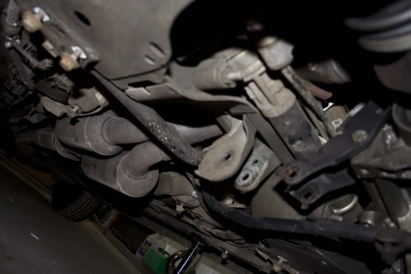

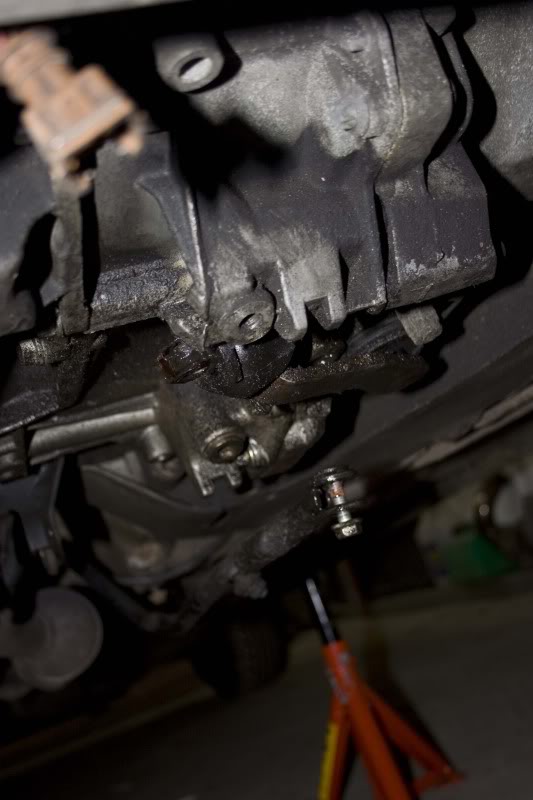

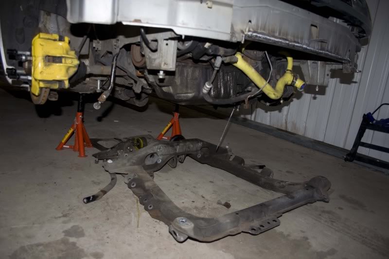

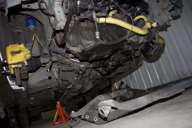

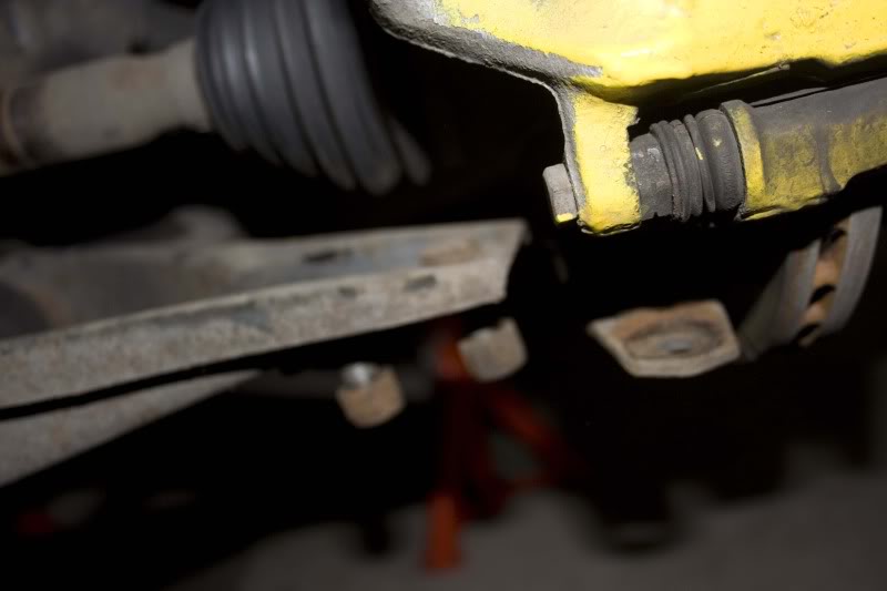

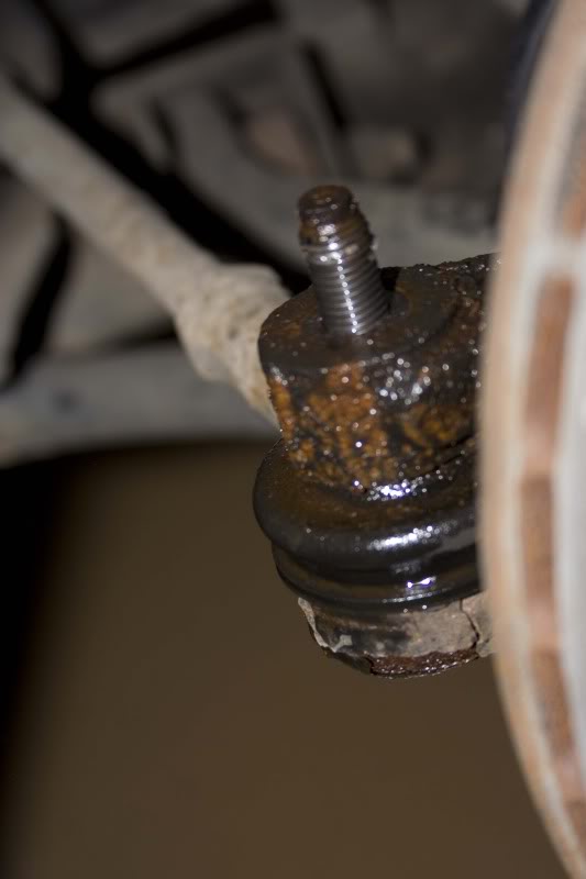

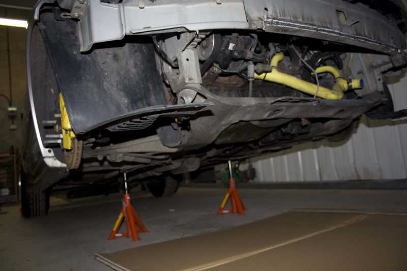

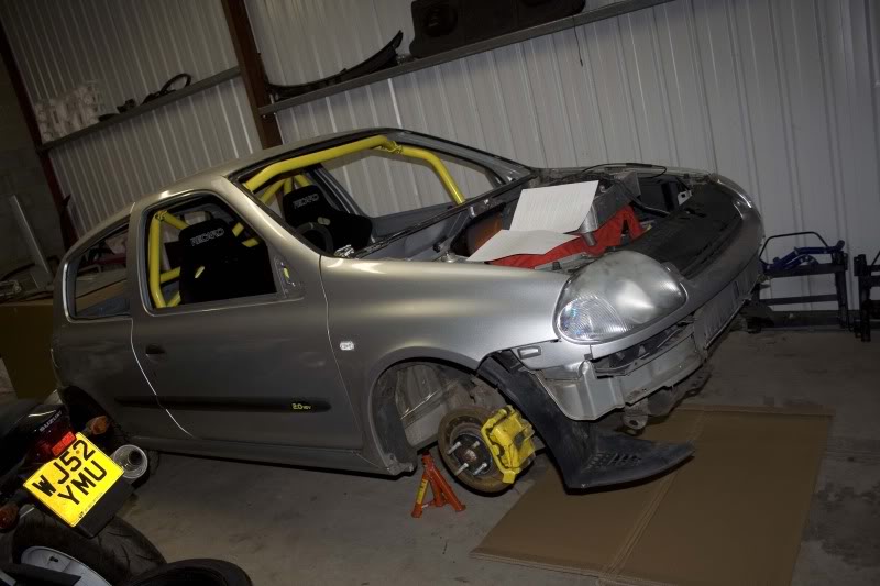

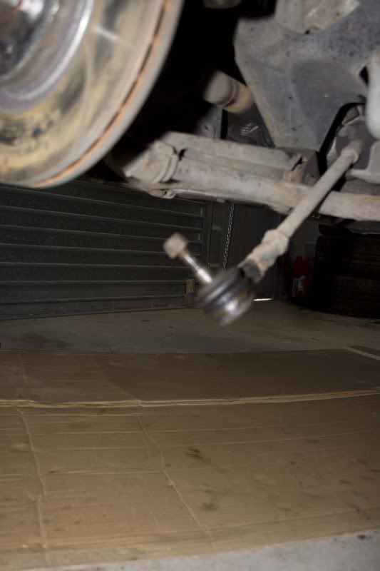

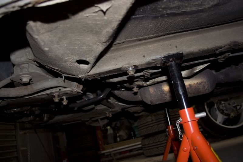

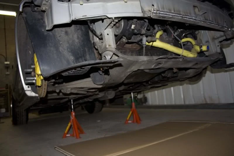

so the update from today... subframe off.
sometimes i am really not a fan of this forum, there are some proper idiots on here, however last night and this morning i found 2 people that were totally the opposite, they took time out of there own to help me. I asked advice from Gray and from Crispy about removing the subframe, i got a step by step guide by both of them and followed those today making it very easy in the end... i will copy and paste the words from one of there lists and just add my own pictures
Jack the car up so it’s nice and high, Remove front wheels

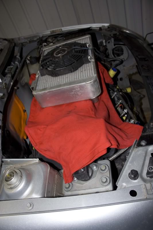

i also had to tuck my radiator out of the way as it sits on the nearside front of the subframe (ontop of the engine will do....)
Undo lower ball joint bolts, the rest of the suspension can stay as it is. Just be careful not to pull the left hand shaft out.
Undo the things that are on the end of the steering rack that attach to the hub.
Unbolt the gearbox mount that is at the very front of the gearbox.
Unbolt the 2 rectangle bits that are at the back of the sub frame which attach to the chassis
Undo dog bone mount.
Completely remove the long gear selector which reaches from the bottom of the gear stick to the little bit on the gearbox (i left mine on at the gear stick end...).
Undo the two little bars which are attached through the wishbone bolts and attach to the chassis (so one each side of the car)

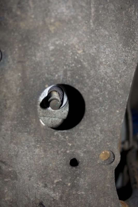

Now I think it may be easier undoing the 4 bolts for the steering steering Column and removing the whole thing rather than attempting to just undo the single bolt that attaches it to the rack.
Then there should be 4 main bolts which hold the sub frame onto the car. Make sure these a soaked in tonnes of penetrating spray or wd40 as if the bolt "wings" snap then they are a right B*tch to undo. You’ll see what I mean.
If you’ve got one then use a trolley jack and a long spade or bar to support the weight of the sub frame and wiggle it loose. With all the part on the sub frame it’s F*cking heavy so be careful.
it was the 2 top steering rack bolts that were the pain for me... god dam it are they hard to get too....
so all off, basically stripped of wishbones and ARB.... decision tomorrow on what to do with it colour wise
