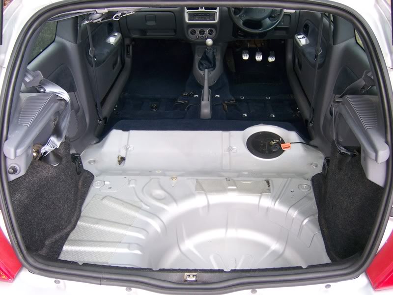

with all the seats out i decided to give it a clean, will do this again before stuff goes back in but now hoovered and metal cleaned

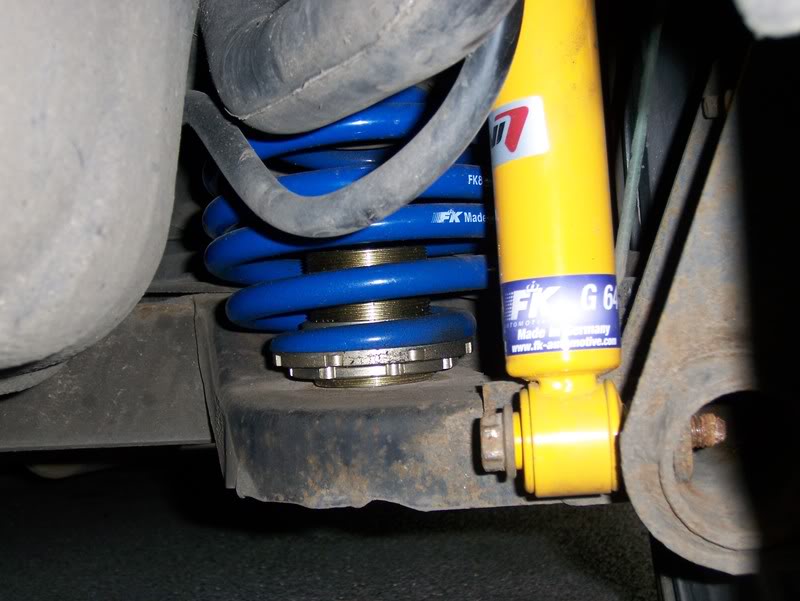

with all that out though i am sure its risen up
and i am sure its set at its lowest...i hope not.
can i set this lower anyone?????

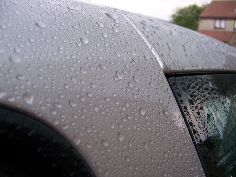

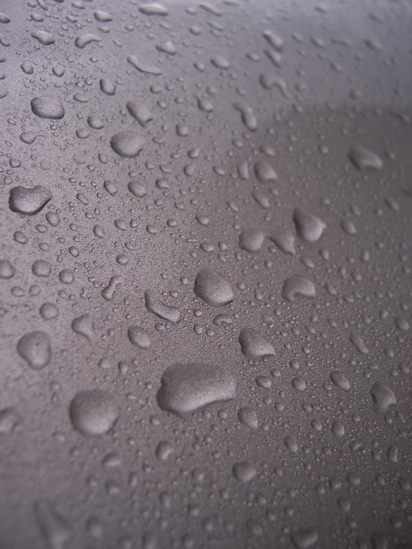

then just gave it a quick wash to get the bird turd off.................beading?
Re: someph-ing different...........

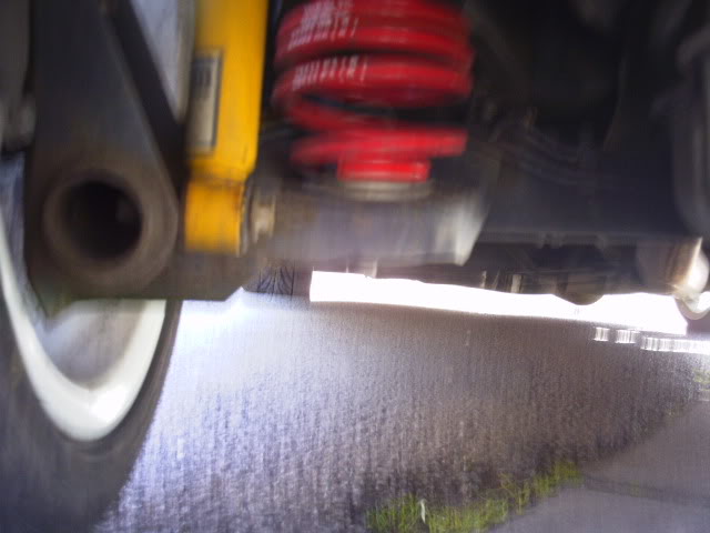

crap pic but if you look carefully you can see the adjuster is below the
trailing arm and gives a further 10mm drop aparently. i know that mine is
low but i still have my back seats in.
don't quite understand what your trying to show me here...lol
if you look at yours your adjusters at the bottom of the spring mine are below the arm which the springs sit on. so mine sits the width of the adjusters lower(10mm)or so. but they are none adjustable now.
understand?lol
i do understand now yes, so do you even need the adjustment rings in there then? if they are underneath they are not doing anything?
unsure on that.think they might be on there to stop it pulling through. had my mate fit mine.just watched and with 197gaz's instructions fitted them.
was him that told me about putting it underneath otherwise would of never known :o

Take the bottom ring off and wind the top one down to the axle dude, Personally I dont lke leaving the spring just on the axle. You wont notice the 4mm you'd gain by taking the top one out anyway!
i did the same,left the top one but removed the bottom one
