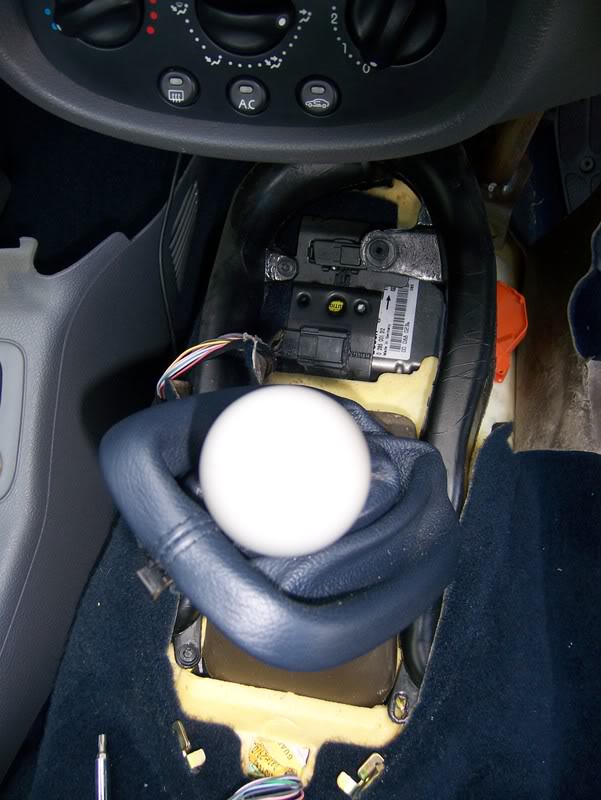

apparently this holds the key.......
there is a pin somewhere in this that if you remove it it breaks the connection therefore distinguishing the light.
  2.0 175dci rs meggy
Re: someph-ing different...........
pin 7 is a earth to the light in the instru panel
pull the pin out of the connector - light should go off
and once again my name aint against the pic i sent u (ggrrr)
Nafoff
ok...so where do i find this connector?......
i do nothing at the moment mate...not even moving pictures around...lol

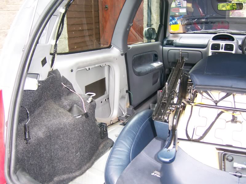

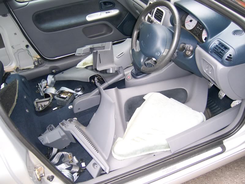

more progress then

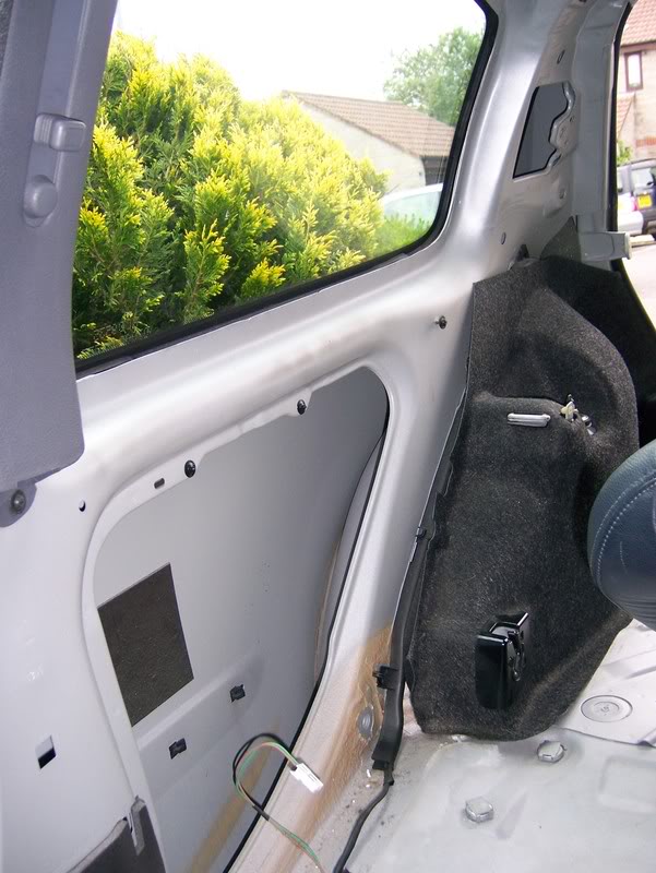

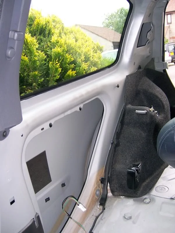

decided this afternoon i would try and remove the seatbelts all round....
got the fronts out quite easy...then noticed that to get the rears out you have to take the plastic panel off, and to do that you have to take the rear quarter off......so i did...lol
both sides
all done, all out, and the mass of stuff
so the main question, should this all stay out? or should i just put the trim back in?

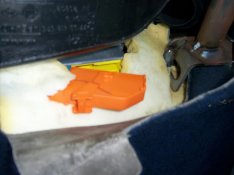

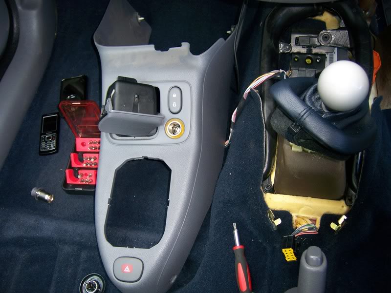

interior panels back in now, so onto the airbag light......
this is a barsteward

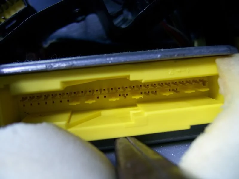

first got the panel / trim off, a call to jamessrich confirmed the bit i was looking for, i had to snip the carpet going over the centre to access what i needed but this is not an issue as you won't see it, got the foam out of the way also.......its real tight in there...
the pins in there are super stiff, it was really resisting me...not much room against the others too.
not pulled any out yet because of this and will try again tomorrow, just want to confirm i am pulling the right one

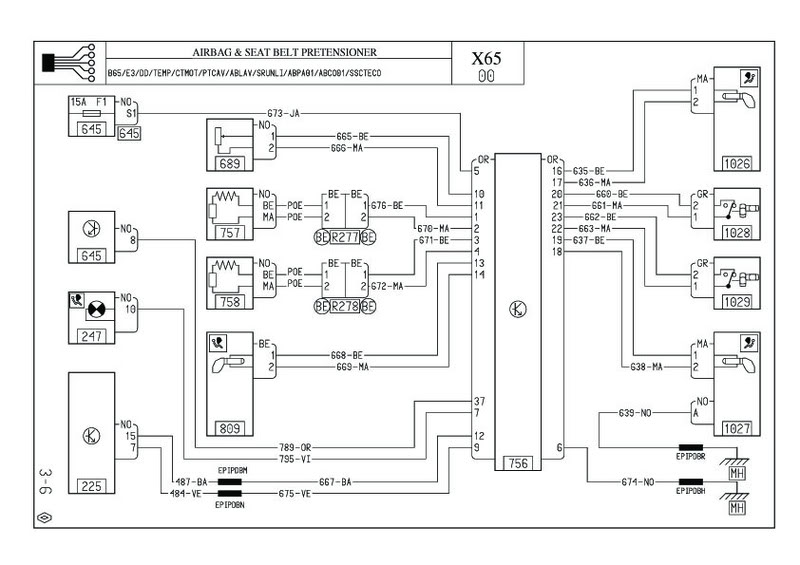

the plan
the plug

I have no idea what I'm supposed to be looking for on that plan, good luck, lol!
