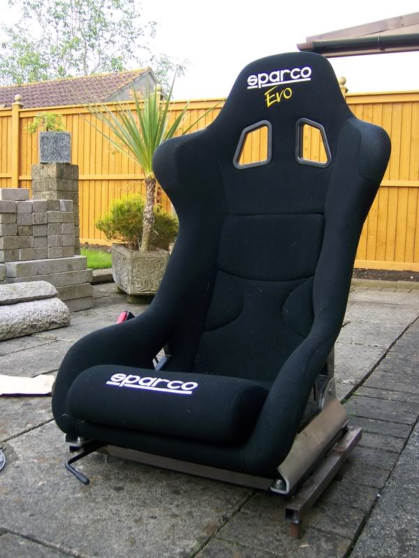

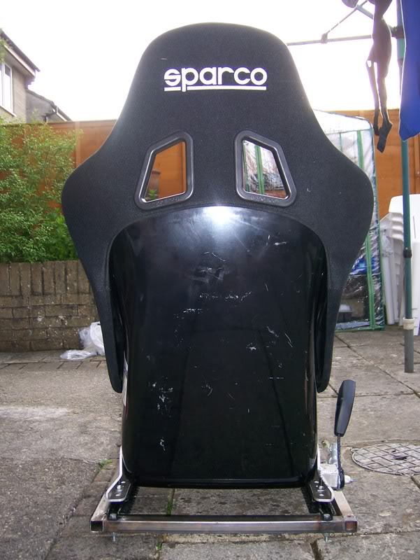

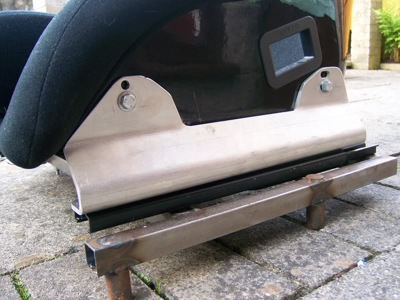

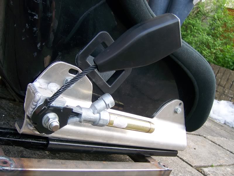

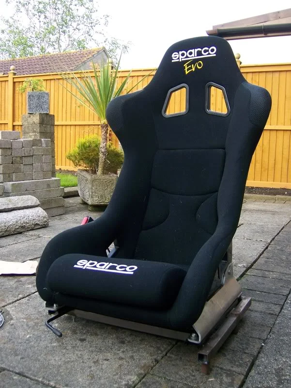

got these off another member yesterday, well chuffed and can't wait to get them in the car (bit hard with 1 arm, if any locals fancy helping...wink wink)

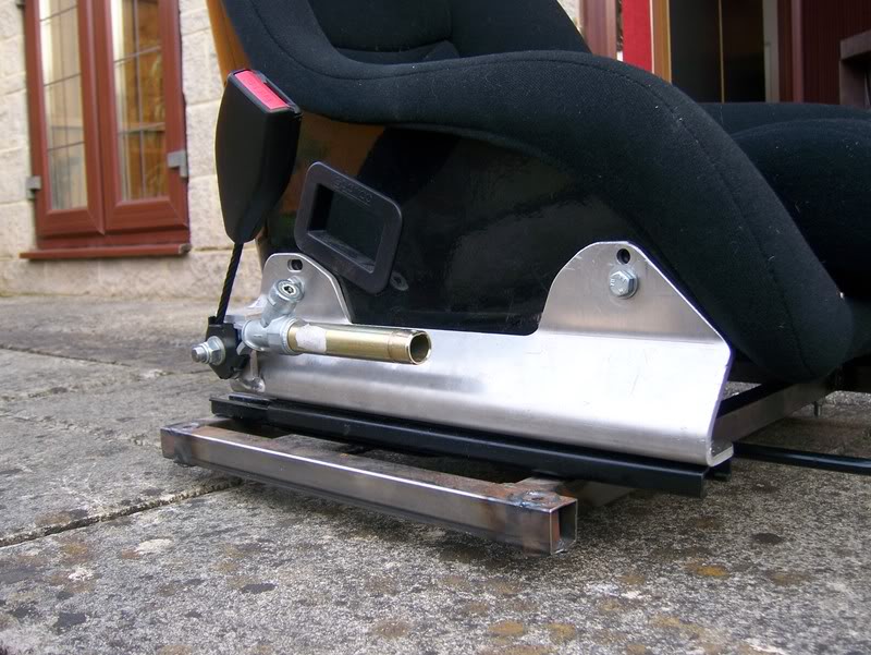

they also have custom subframes and sidemounts
the sidemounts were custom made at quite a hefty price, they fully incorporate the standard renault belt pretensioners so all you have to do is plug in the existing wiring and be on your way.
i may be selling these sidemounts as i am going for harnesses so pm me asap.
original interior also for sale
what can i say though...very happy boy

Awesome seats! The sidemounts are impressive too.
  172 Race Car
Re: someph-ing different...........
Those seats are lovely mate, good purchase.

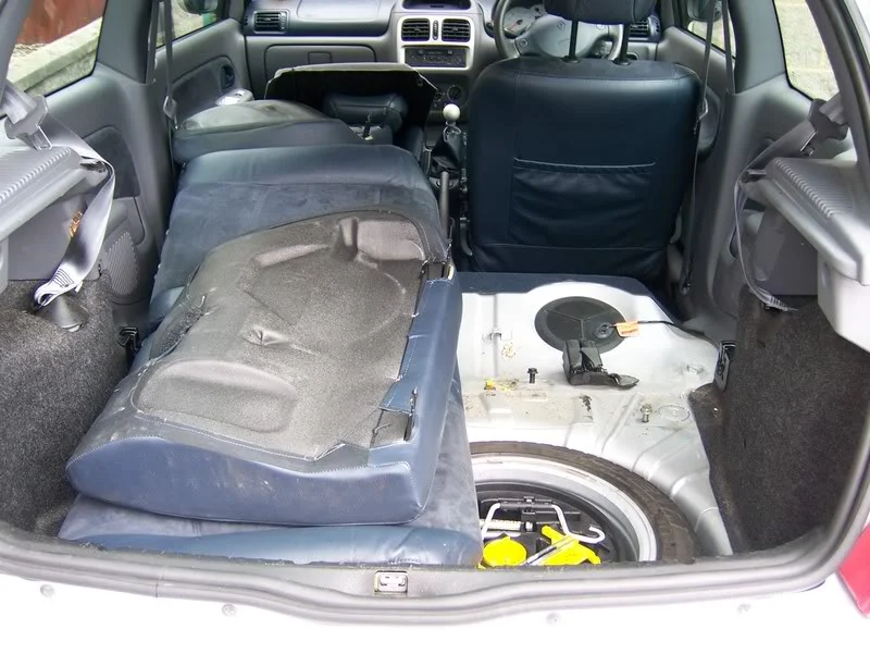

another update

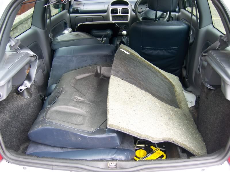

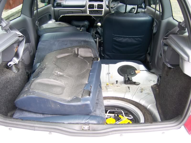

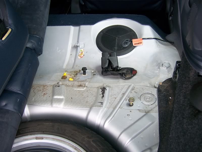

the rear seats and all buckle fixings are out, still need to remove the actual belts but that won't be for a while as i do only have 1 arm to use still
was a struggle getting the rears out, that bar is a pain in the arse, dad had to loosen the bar bolts off as they were ceased in,
how it stands now
lovely and dirty under there
with all the stuff in there (like step-toes car)
and the buckets subframes now have a lovely coat of black on them to tidy them up, now need to find some help to remove the front seats, am i right in saying its 4 bolts per seat? and they are all underneath the car?
