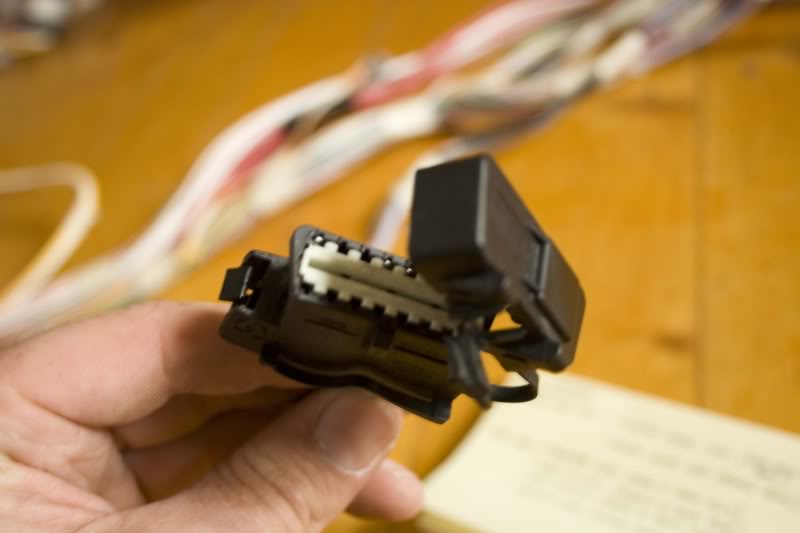

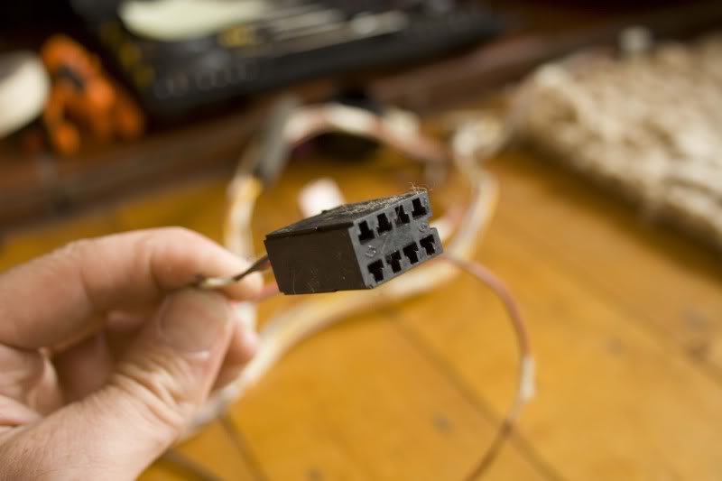

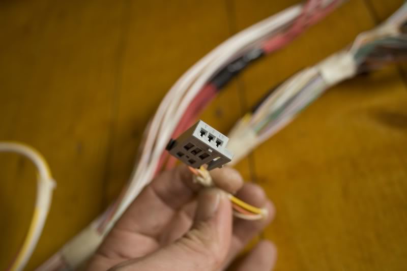

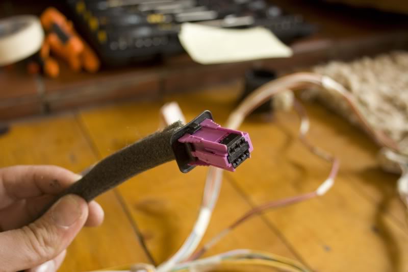

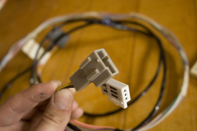

so amongst all the will it won't it work i still need to loose these extra connectors, so just reposting this with what we seem to have distinguished the plugs may be... sound about right???
any help again very welcome....
Passenger Rear loom - Midway along - Grey Plug and Clear Plug - SPEAKERS???
Passenger Rear loom - Midway along - Black Plug - SPEAKERS???
Main Loom - Passenger side (i think) - Black 6-point Plug - DOOR SENSOR????
Main Loom - Near Ignition - Purple 6-point Plug - BRAKE PEDAL SWITCH???
Main Loom - Near Ignition - Black 8-point Plug - DOES NOTHING???
Main Loom - Drivers side - Midway along - Grey 3-point Plug - SPEAKERS???
Main Loom - Centre Console - Black with Cover - OBD PORT???
Main Loom - Centre Console - Black Female Plug - HEATER???

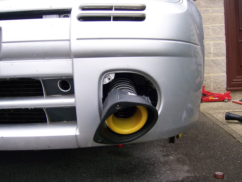

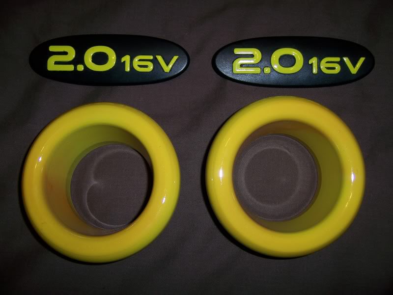

Hey mate, this has probably been asked before but would take me weeks to find the answer. What induction kit did you use and where did you source the yellow ends? Were they part of the set, and about how much were they?
Thinking of doing something similar.
Any help/info would be greatly appreciated.
Thanks, Jack
Nafoff
hi jack, this air feed was just feeding the standard phase 1 172 airbox. There is alot of conversation on here about what is best but it is quite widely known that the phase 1 172 or espace V6 are extremely good, possibly with an aftermarket filter inside, like an ITG.
The trumpets were bought second hand but i believe they are pipercross items, these come in silver but i got them re-painted yellow to match other items on the car.

Thanks, thats great. Would I be able to source the air feed from a renault spares site or just have to happen upon them with someone selling?
Again that's awesome thanks mate. Oh and the car is freaking amazing!
Nafoff
You will need to source the bits, none are renault items...
you will need the trumpet's, various companies make them, it may be worth looking on demon tweeks or something as i know they do them.
you will also need to look for the ducting, again demon tweeks do this
thanks for the kind words...

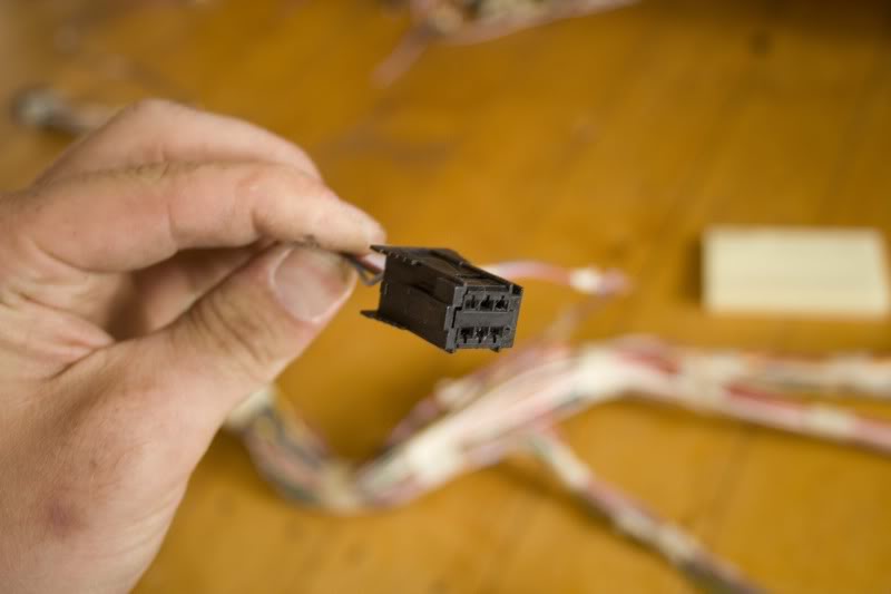

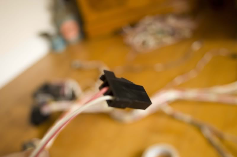

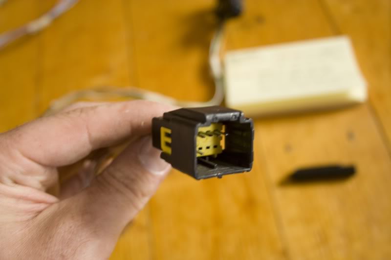

UPDATE:
this morning, (i know, already) i have trimmed the left over plugs off the loom and traced the wires back and removed them, leaving the ones that we named above as important.... mainly the brake one..
so i have these 2 that we don't seem to know what it does, i really need to know if anyone can help as the loom needs to be done asap...
^^^this was suggested to me that it was a door sensor but i know this is not the case as i still have these and they are also on the looms that run down each side of the car.
^^^this was suggested to me that it does nothing already, if this could be confirmed that would be great...
on the note of the door sensors above, i am right in thinking i don't need them anymore? i will be running manual locking and no interior lights etc etc, can anyone confirm this?

piercross do a cold air feed kit
. A bit of pipe and 2 trumpets. Cut the pipe in half and you have one for each side.
75mm is the size we use.

UPDATE:
so after chatting with a few people including THe matt faulks of TDF fame i will be removing these 2 plugs, we are all pretty sure they do nothing (or nothing important...lol)
whilst removing these i will also be removing the door sensors, i will not be running central locking or anything (no point) so won't be needing them either....
