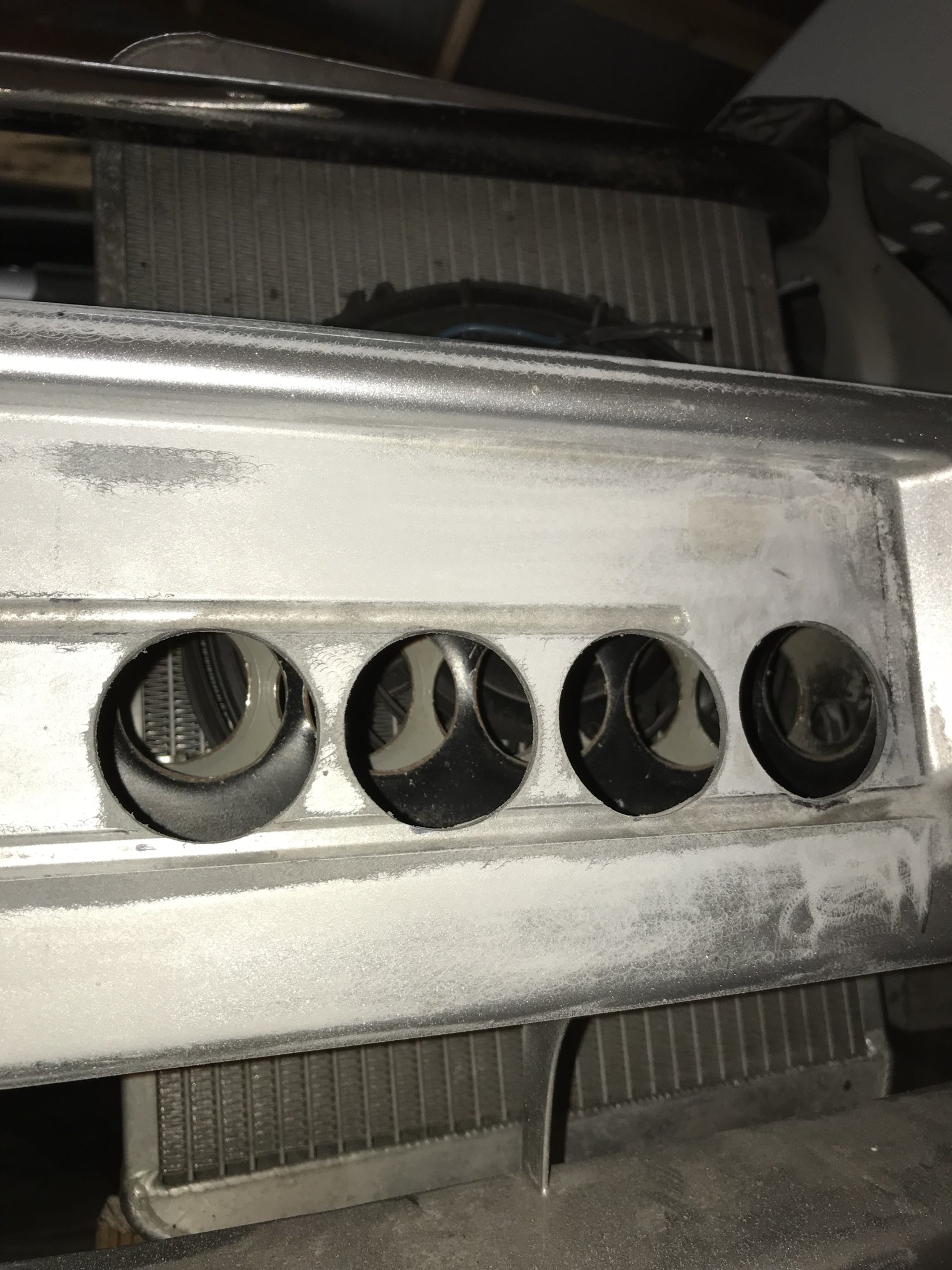

With the thought that I would need to cut the composite panels, the bonnet and roof I thought I ought to invest in a Dremel, and that is what I should of invested in first time... instead I went for the Euro Car Part Am tech version....

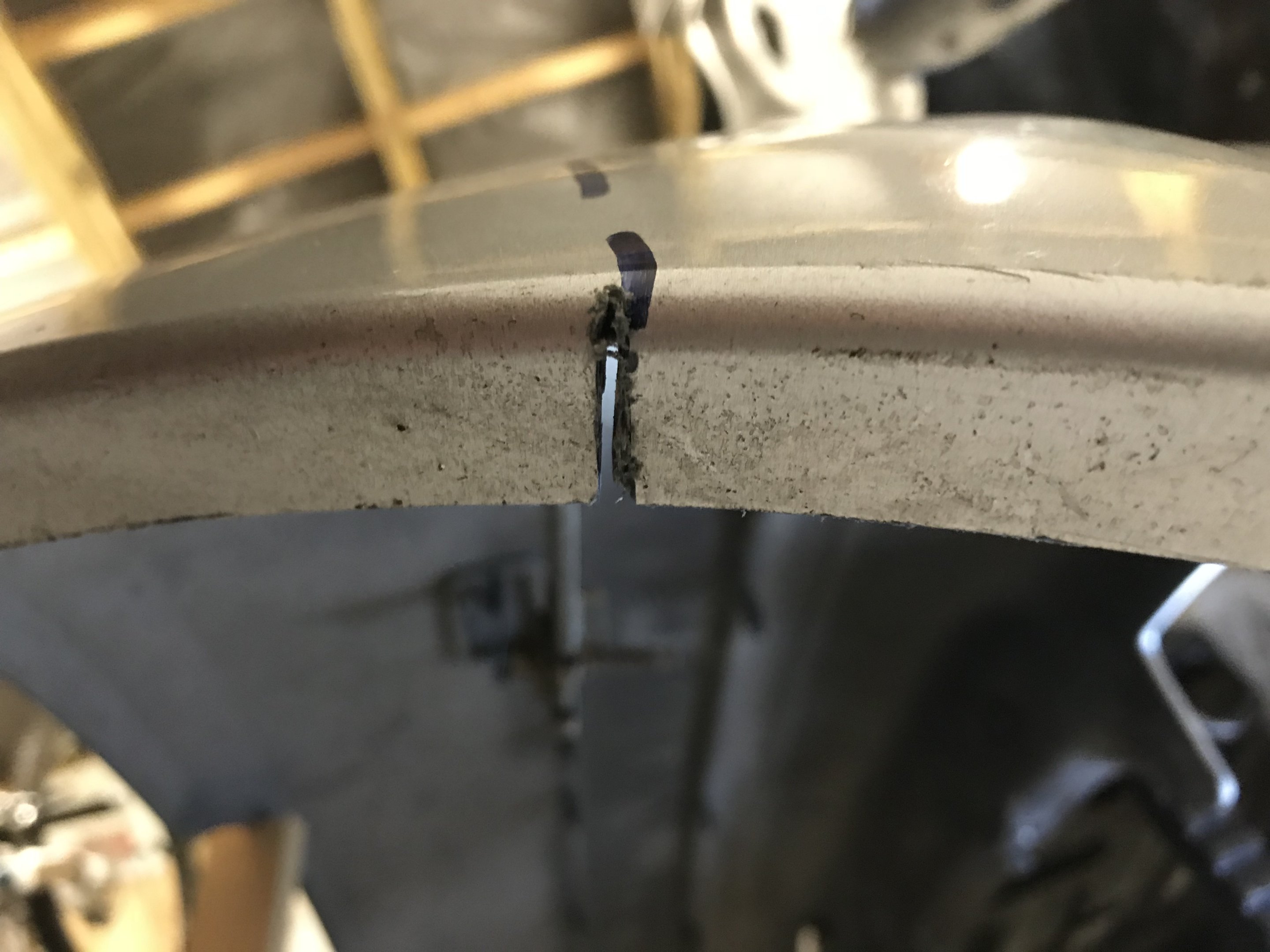

I opened it and looked at it... and that is when I think the motor gave up... it did tickle 1cm of the bumper but then died... needless to say it has gone back.
I decided to just go very careful and use my normal grinder/cutting disc, which in the end turned out alright... pretty pleased with the results tbh.
Before
After

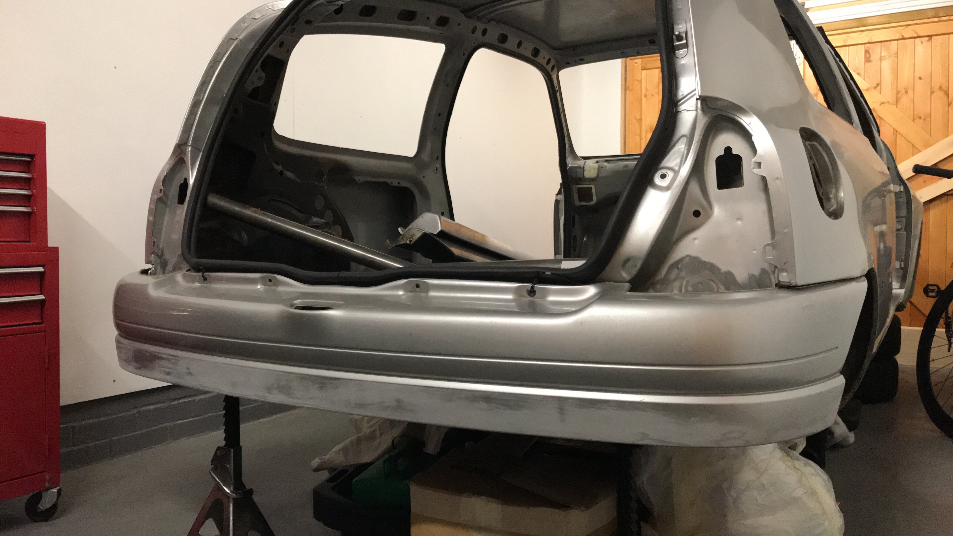

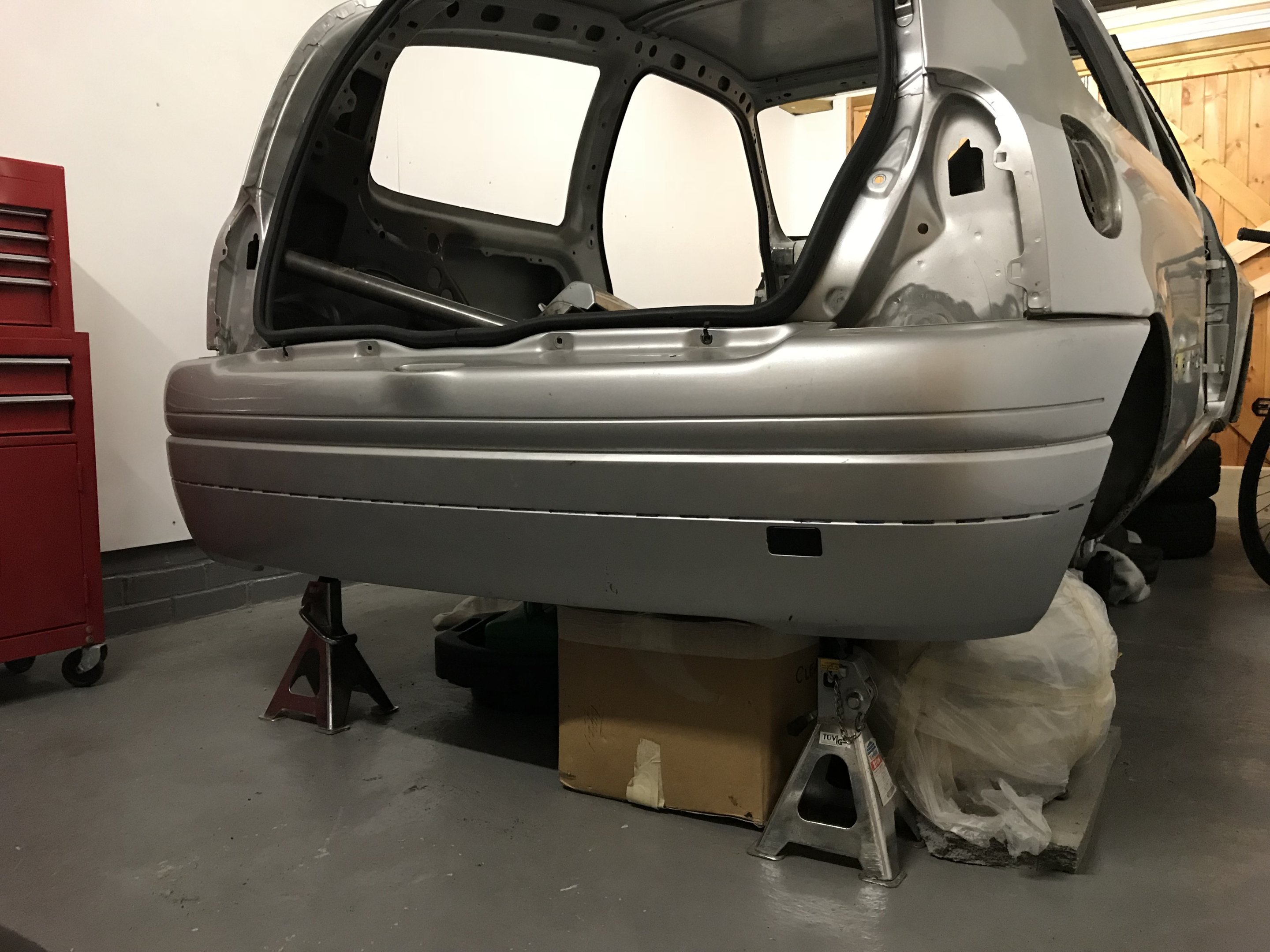

The rear bumper now sits perfectly inline with the boot floor and should massively aid air flow. (just need to purchase the actual Dremel now).

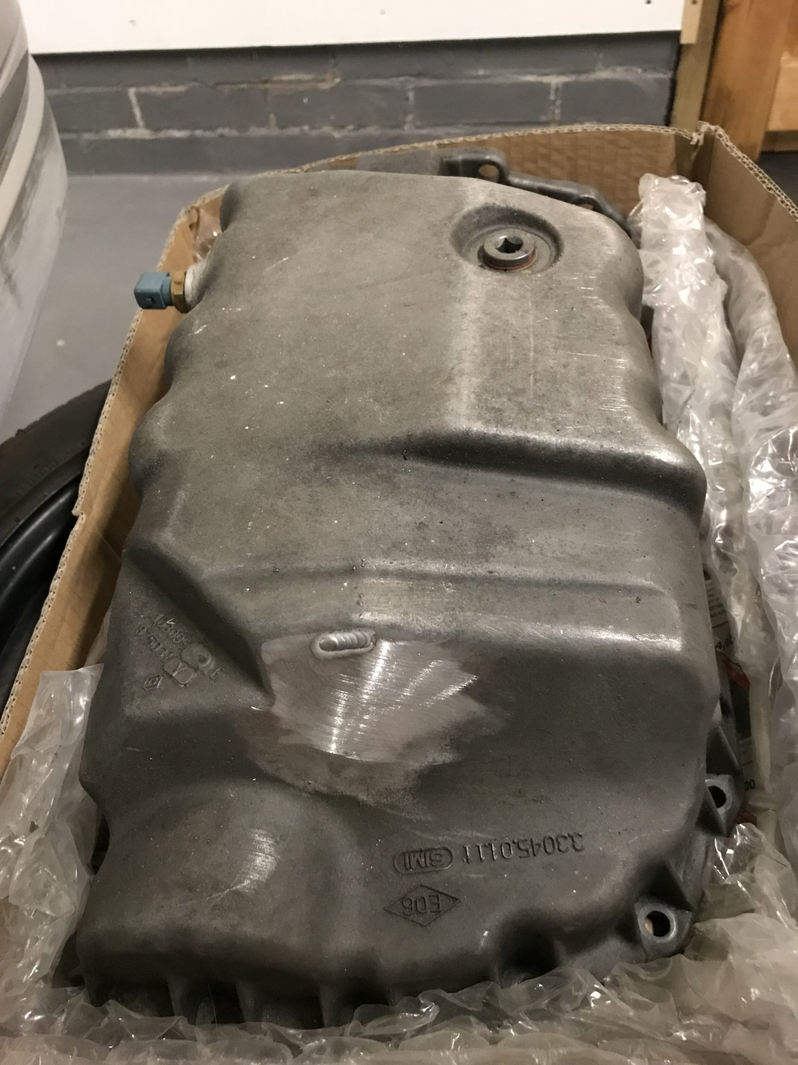

I also sorted my parts stash as whilst the car goes away the engine will also be going away for its cambelt and service, now the engine can go away with a box of parts all cleaned and freshly painted so all is ready to go back in when the car is back.

Realise I deleted my double post and my post has now gone :smile: cut away bumper looks great, can't wait to see it finished as I am sure you can't, what exhaust are you going to run? Don't know whether I have missed in previously :up:

Cheers. Not decided on the rear exhaust manufacturer yet but expect it will be a custom job as I know the specs I want. 2.5" all the way through, central rear exit with straight cut tip.

Sounds good, that's why I asked as I thought it would open up centre exit etc. with the flat boot floor and the shortened bumper, look forward to seeing it :up:

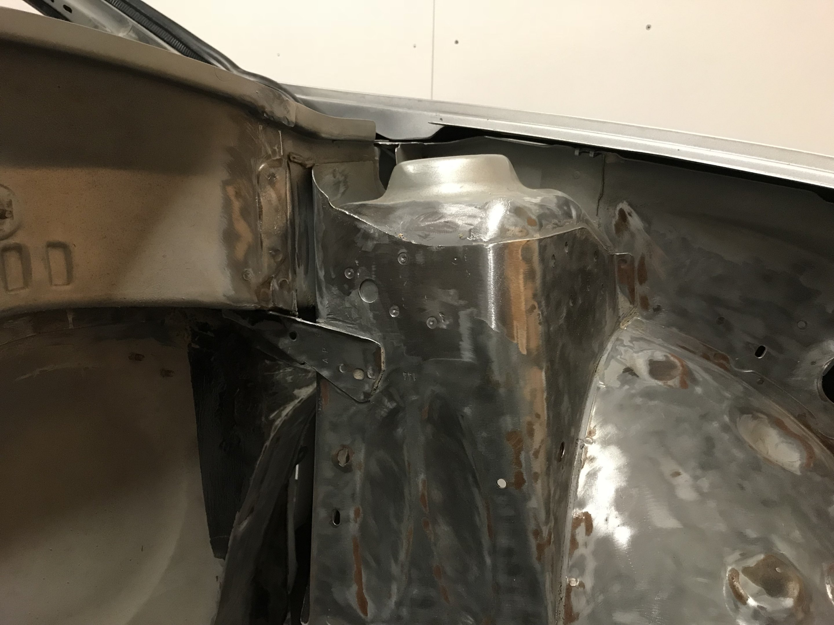

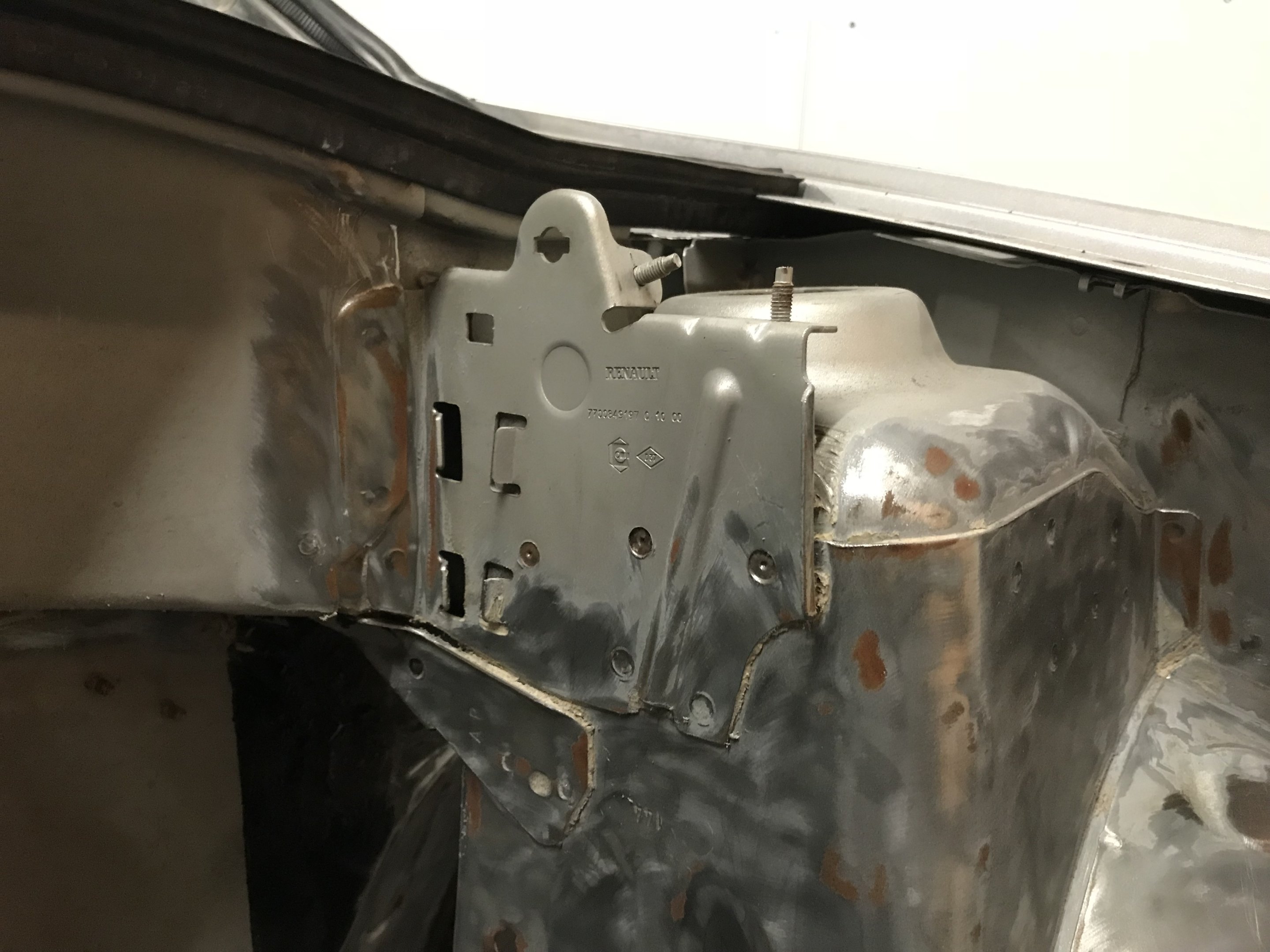

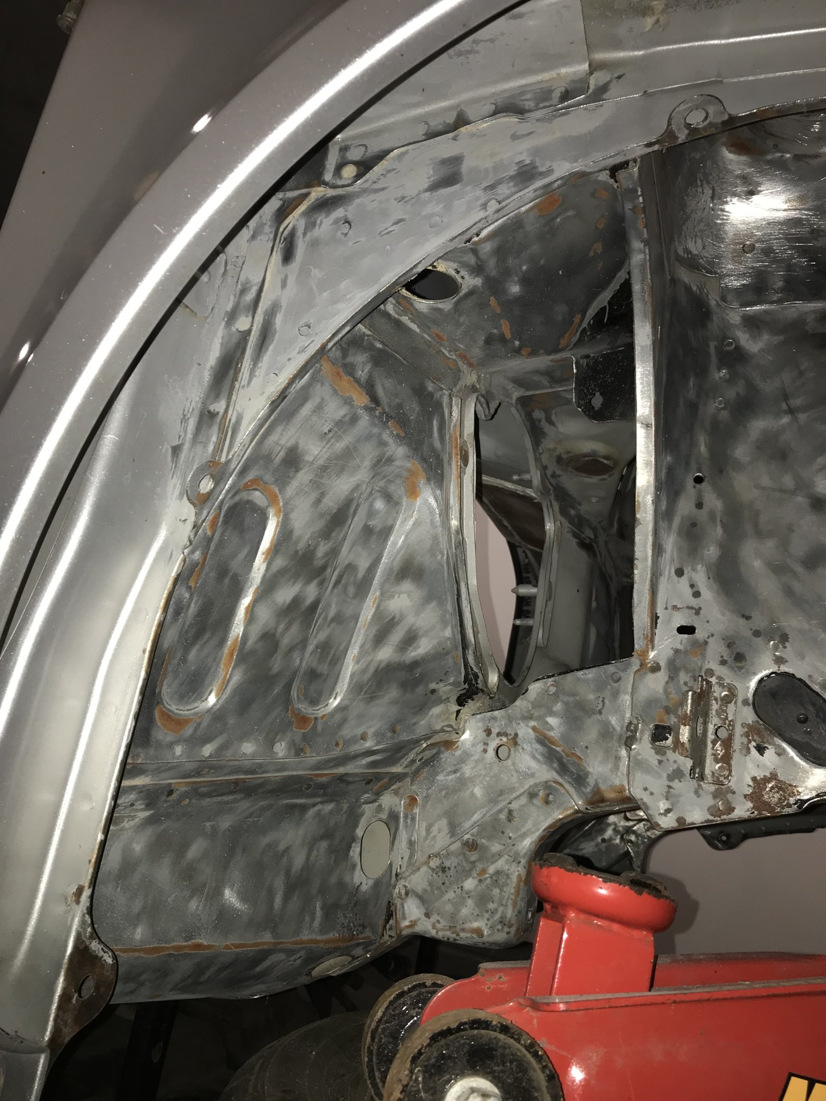

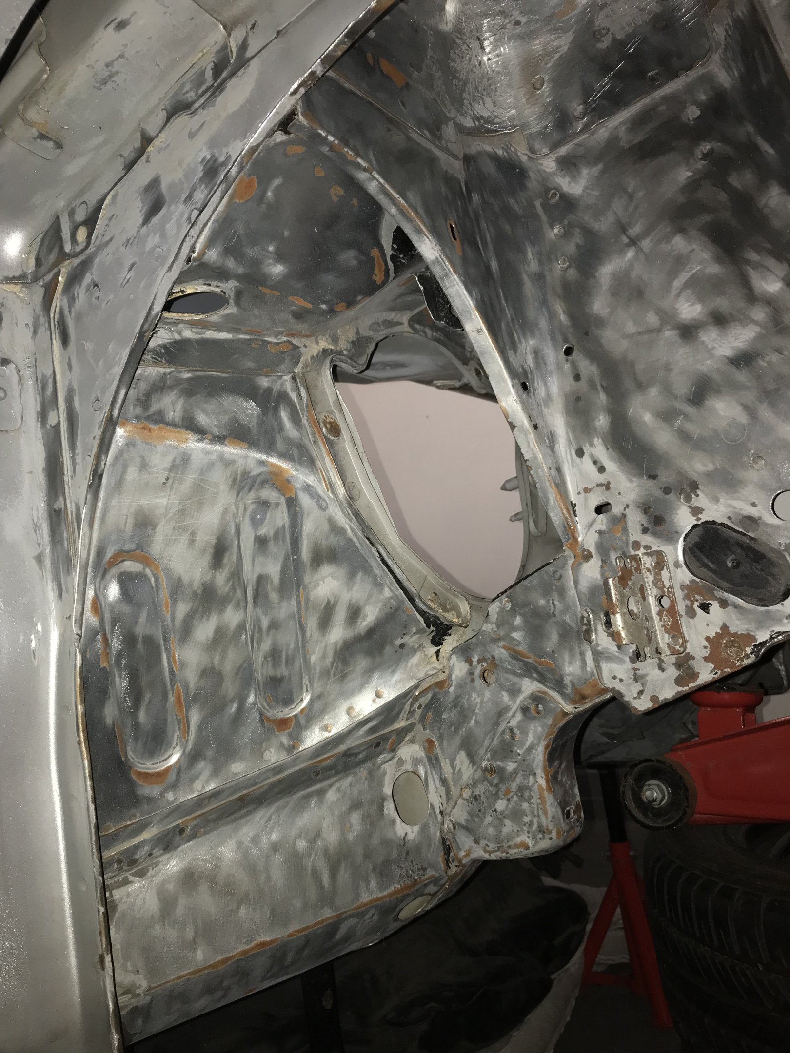

I then noticed the arch liner mount holes in the wheel arches were still there, so they disappeared too

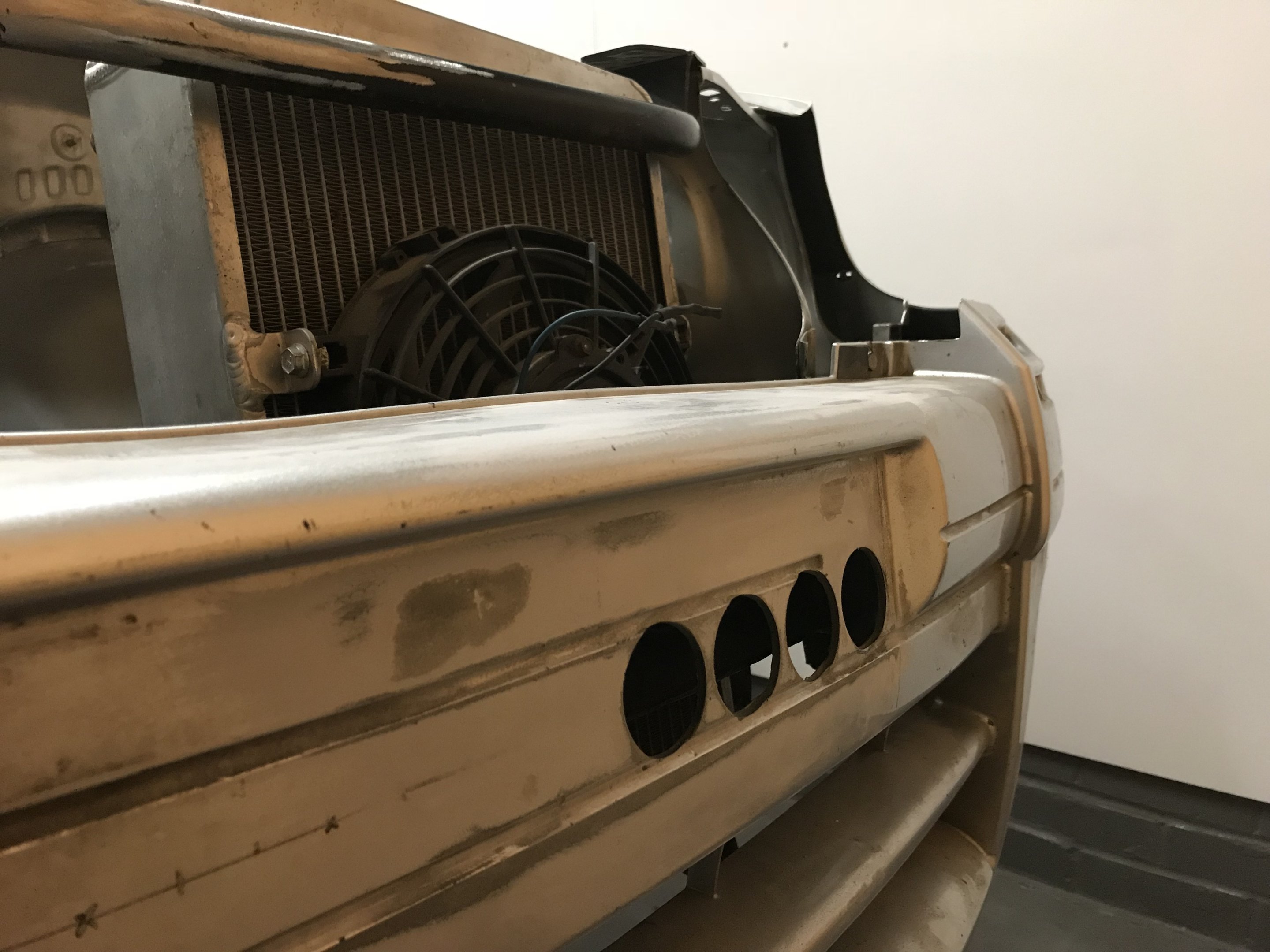

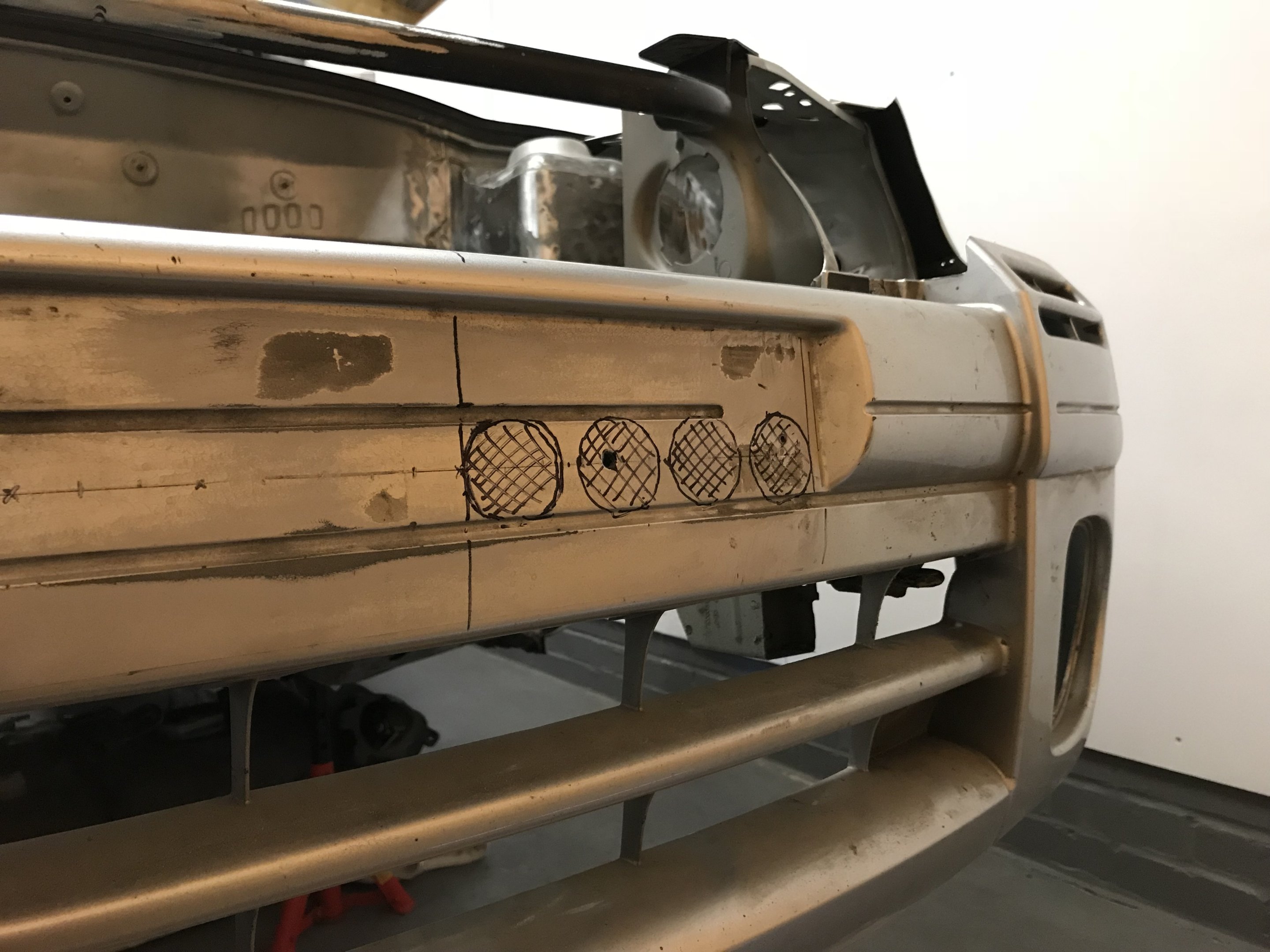

Next up was the front bumper. Way back when I did the tour of Europe the car suffered a little from the heat, I think this was dealt with when I returned but I thought I would make provisions for this anyways. With the car having the custom airbox and radiator (that sits vertically rather than horizontally) I set about creating better airflow to the rad straight through the bumper and front bar.
That was pretty much it for butchering the car. I fitted up the front and rear bumpers to make sure all was good and to keep things all together for moving the shell. I then went to fit the bonnet and was quickly reminded that many years ago a bolt sheared in the bonnet so had to speak to my neighbour nicely again. I say again because the same night he helped out with a helicoil to sort the bonnet he also dropped around my repaired sump. A little while back I purchased @BIGASH's looms and along with that came the sump with an extra sensor welded in, however there was a little bit of damage where I think something in the engine tried finding a new way out... My neighbour was kind enough to get this welded so this just needs to be switched for the sump currently on the block.

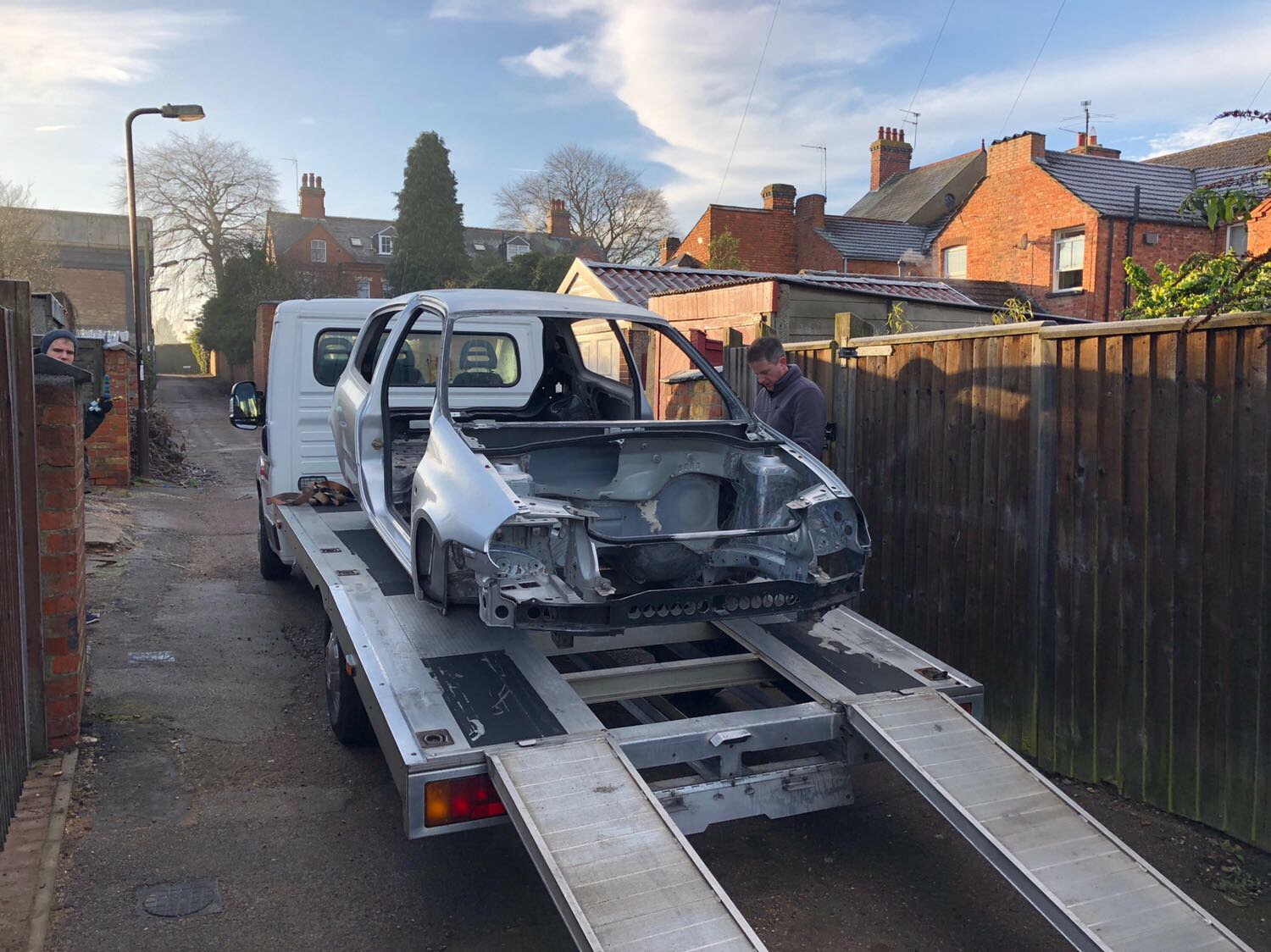

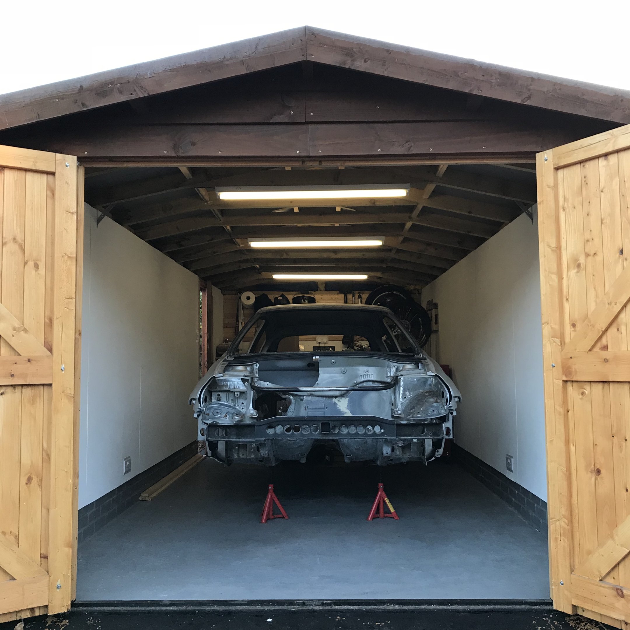

The night before moving the shell I needed to move everything out from underneath the car, I also wanted to move anything that was too close. It was all stack at one end of the garage allowing lots of movement around the shell. The following morning nice and early I was joined by @BIGASH and a flatbed truck I hired. I opened up the front garage doors for what must be the first time in 2 years.
The flatbed driver brought a dolly which we placed under the rear end of the shell, we then lifted the front end - NICE AND LIGHT. It came out of the garage pretty easy and then went onto the flatbed not that much harder...with the help from a winch.
The journey was only short to the fabricator and all went well. The shell was moved into the fabricators workshop and we talked over the plan of action.This was really handy as we could talk over thoughts about how the cage would fit, how some of the metal inside of the car would be changed and timings - I must say I am very happy I am now heading down this route than having to rely on my neighbour.
The fabricator has been keeping in-touch and letting me know the progress of the build, all is going well and I will be heading over between Christmas and New Year with the seat to make sure the harness bars are welded in at the correct height. At this point it will also be discussed when the car is going into paint (conveniently next door to the fabricator) and the complications around that.

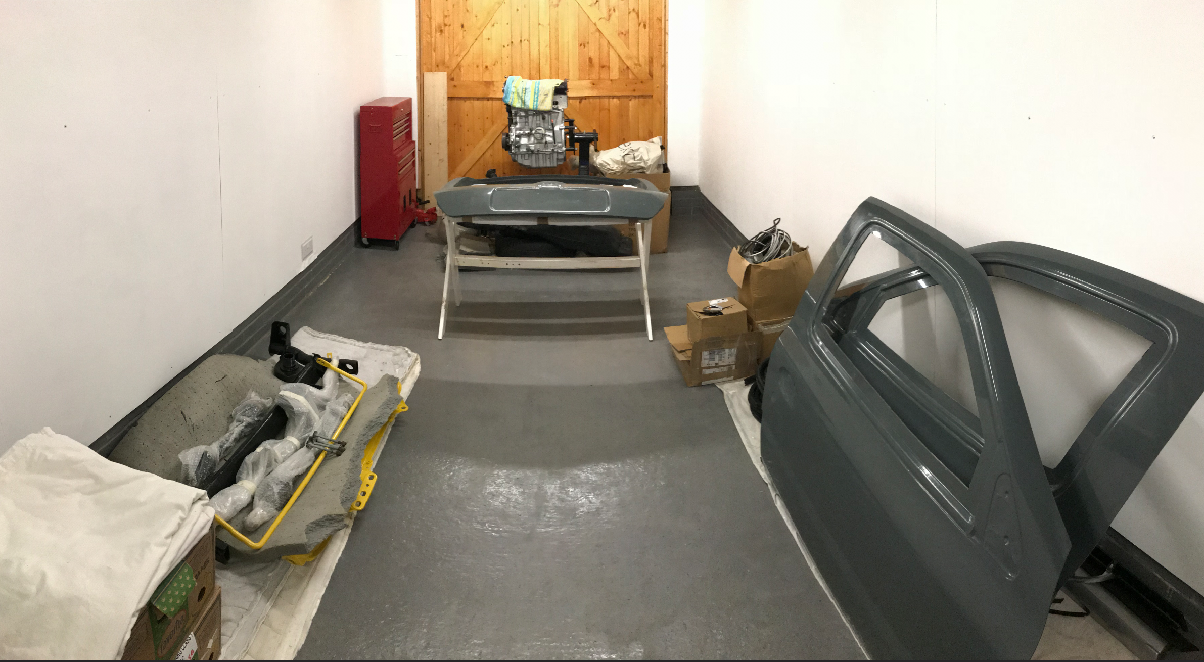

Right up-to-date now to today. With an empty garage it gives me room to organise my parts and work on them. I have set them out in three areas (left to right): RUNNING GEAR, ENGINE and PANEL FITTING.
There are a number of jobs that I need to complete whilst the car is away, ready for the rebuild when the shell is back (listed below):
1. DOOR AND TAILGATE TRIMMING. The doors and tailgate are total blanks so they need holes cutting for all items to be fitted including mirrors, handles, trims, hinges and catches although my main consideration is how I am going to fit the windows. All these need to be done asap as these panels need to be dropped off and test fitted at the painters early in January. To help me along with this work I knocked up a stand to work on the panels (should save my back).

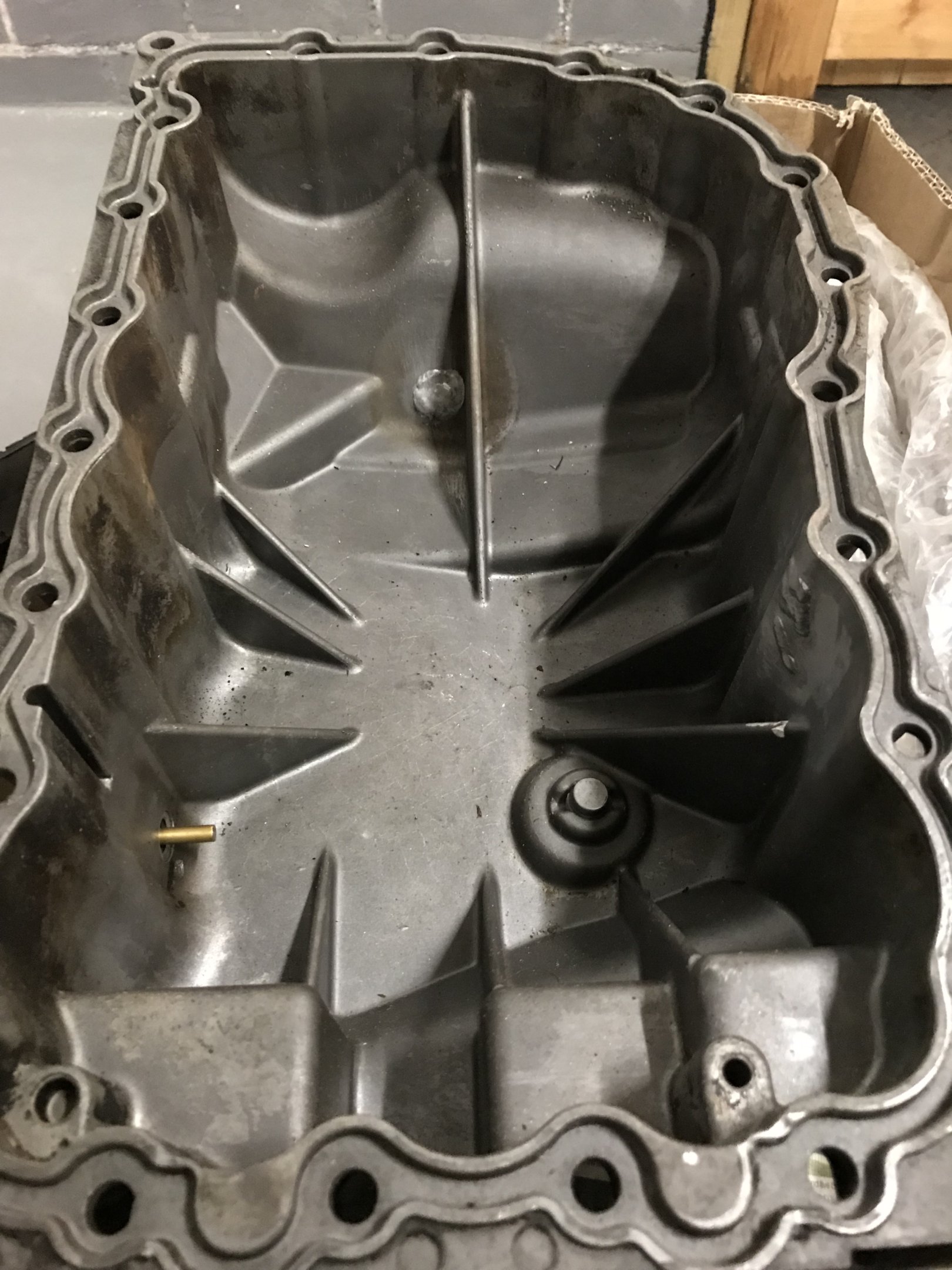

2. ENGINE BUILD. The engine needs to have a new cambelt fitted, the new repair sump and then all the gubbins bolted back on. I will be speaking to Beaniesport about this and either taking it down to there workshop or asking them to come to my garage. Ideally this needs to happen in January so that the engine is ready to go back in when the shell is back.
3. RUNNING GEAR. The idea is to build up the rear beam and front sub frames respectively with all the suspension etc so that when the shell comes back this can all be bolted straight on - I may even take the rear beam with me and bolt it on at the body shop meaning it should be easier to move on the return journey.

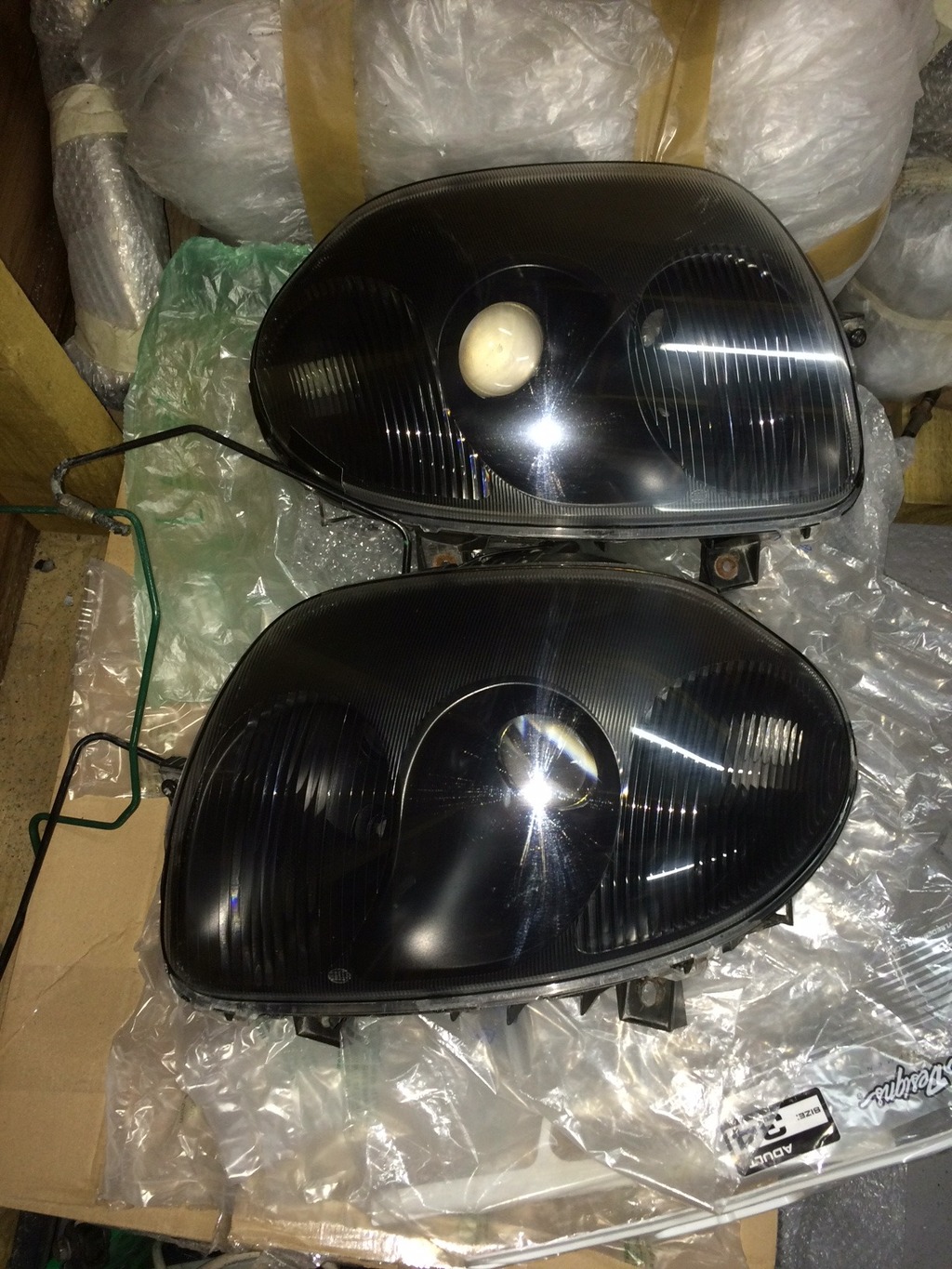

Managed to get a bit more time on the headlights this week, proper effort to get these done, and although they are not 100% they are a hell of a lot better than they were, and fine for a track car... all sealed and drying.
Random post revival but what did you use to reseal them?
My ph1 lights are discoloured on the inside so I want to give that a go.

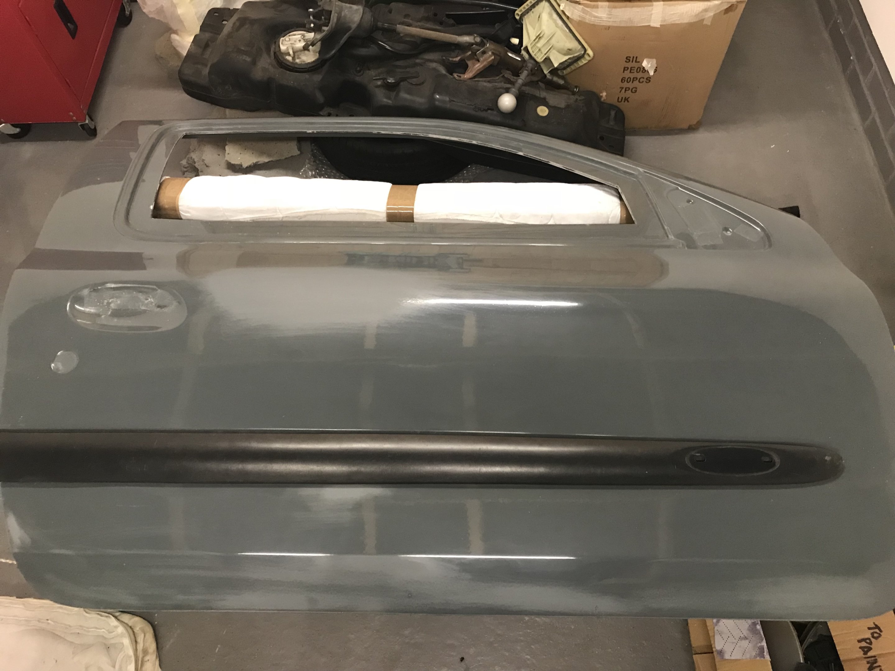

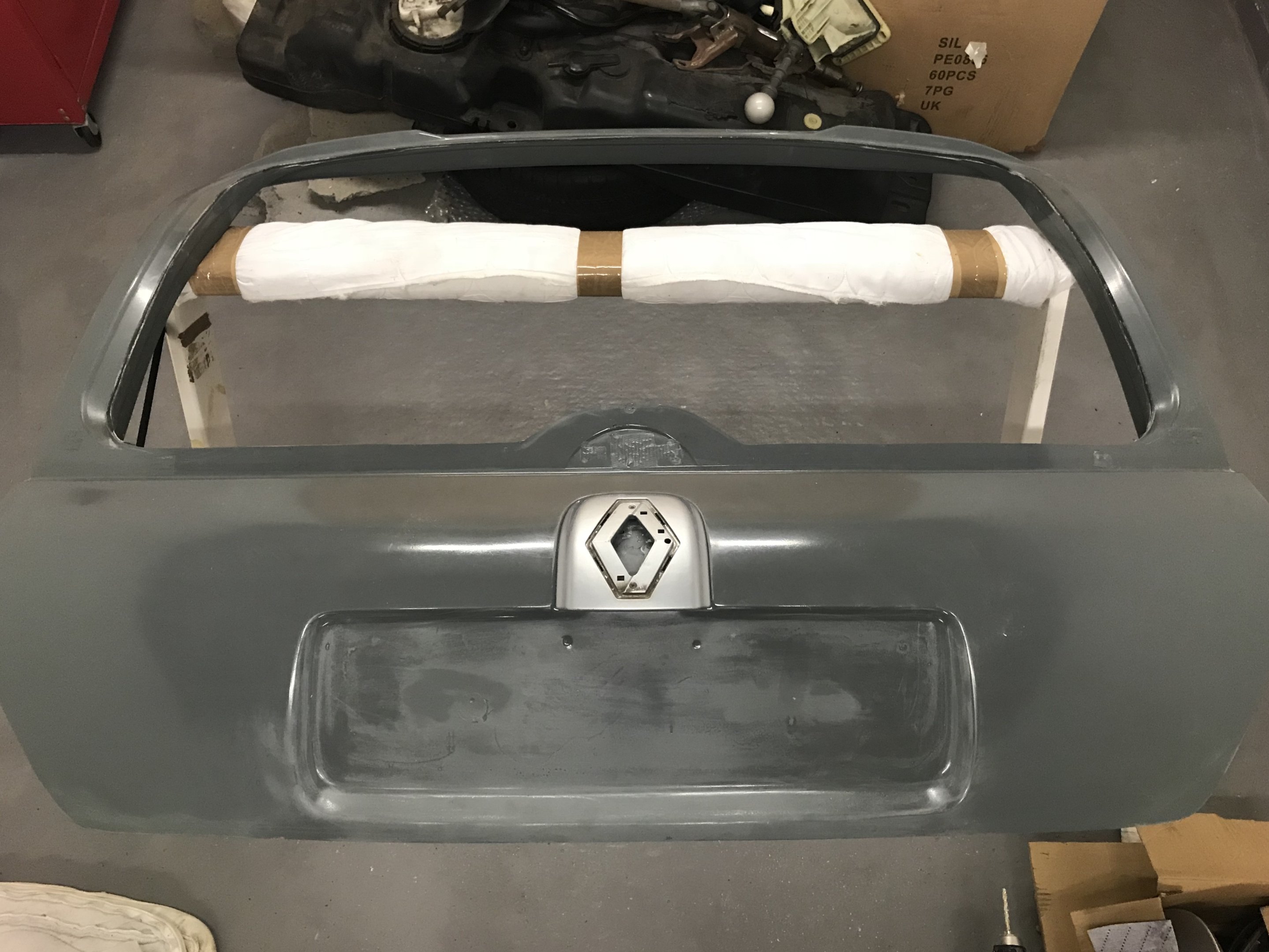

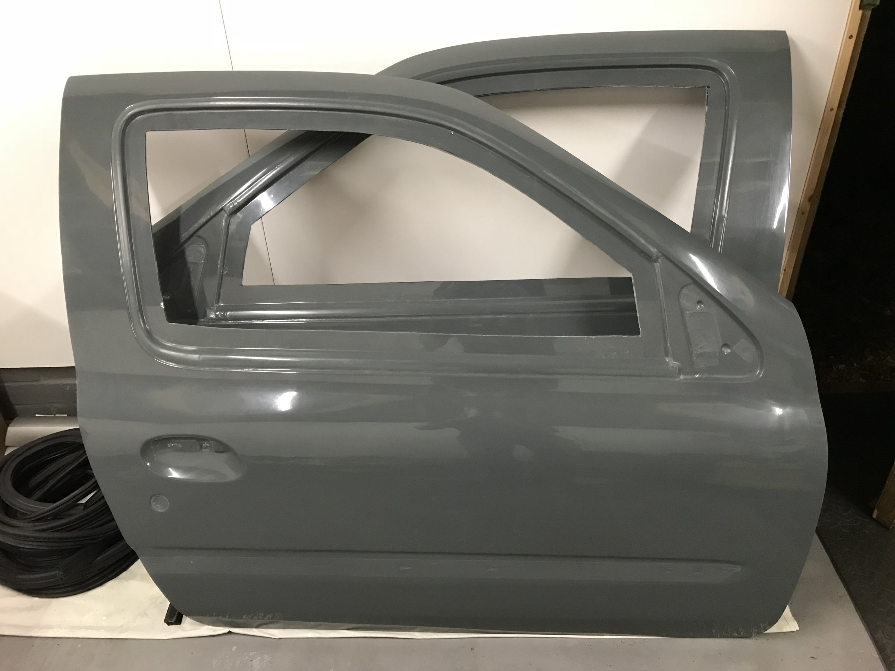

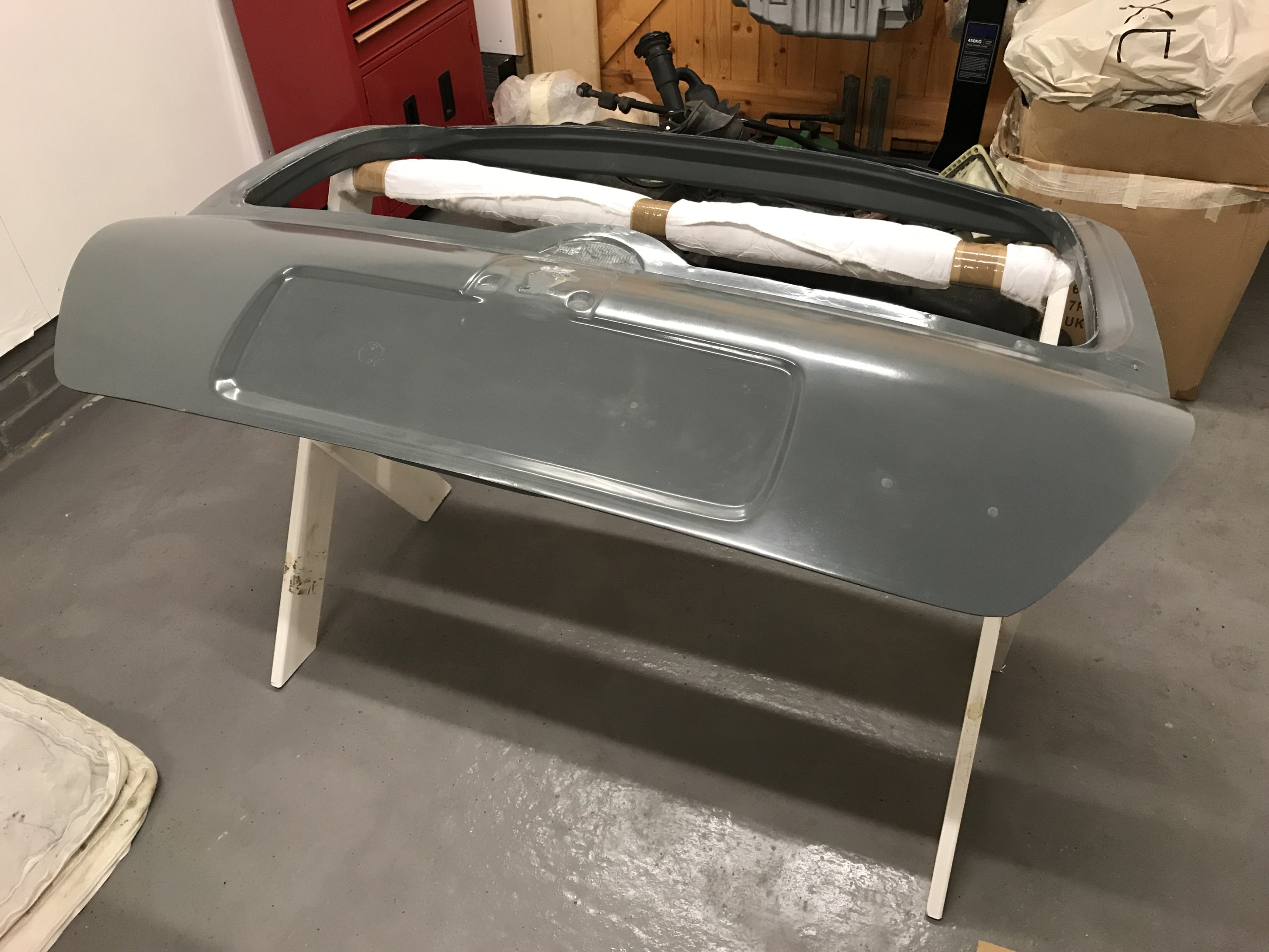

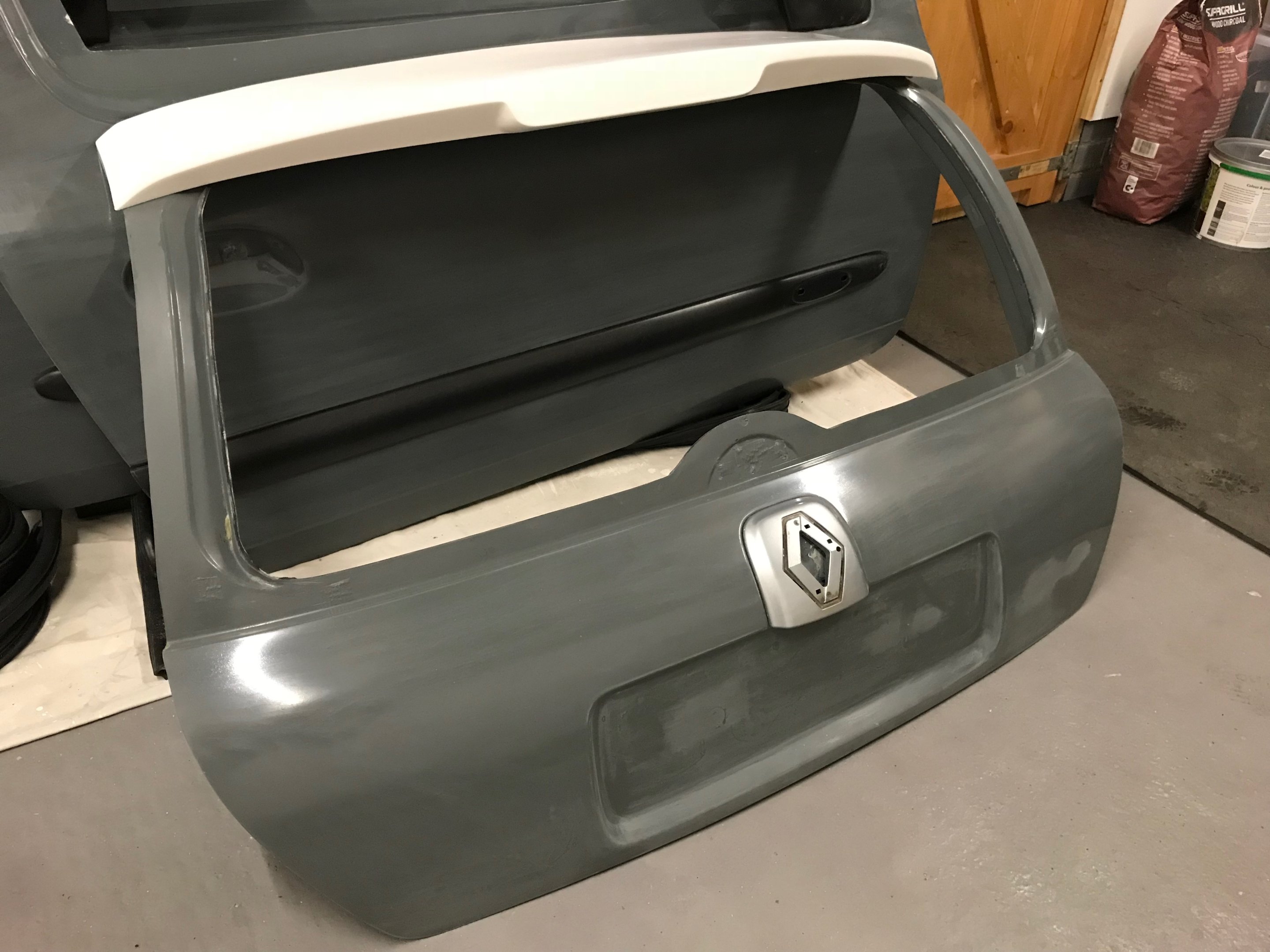

I have started mocking up some of the extra fittings on the composite panels. The first and probably the easiest item was the rear boot badge. I also needed to sand back some high spots in the panel.
Without the car being here it is hard to see where I need to cut the top for the mounting, but this can probably wait until I go to the car and fit the aerocatches (ordered with the ebay 20% discount today). However I do need to fit the new spoiler which I am a little unsure how to approach as it is hollow inside. ANYBODY?

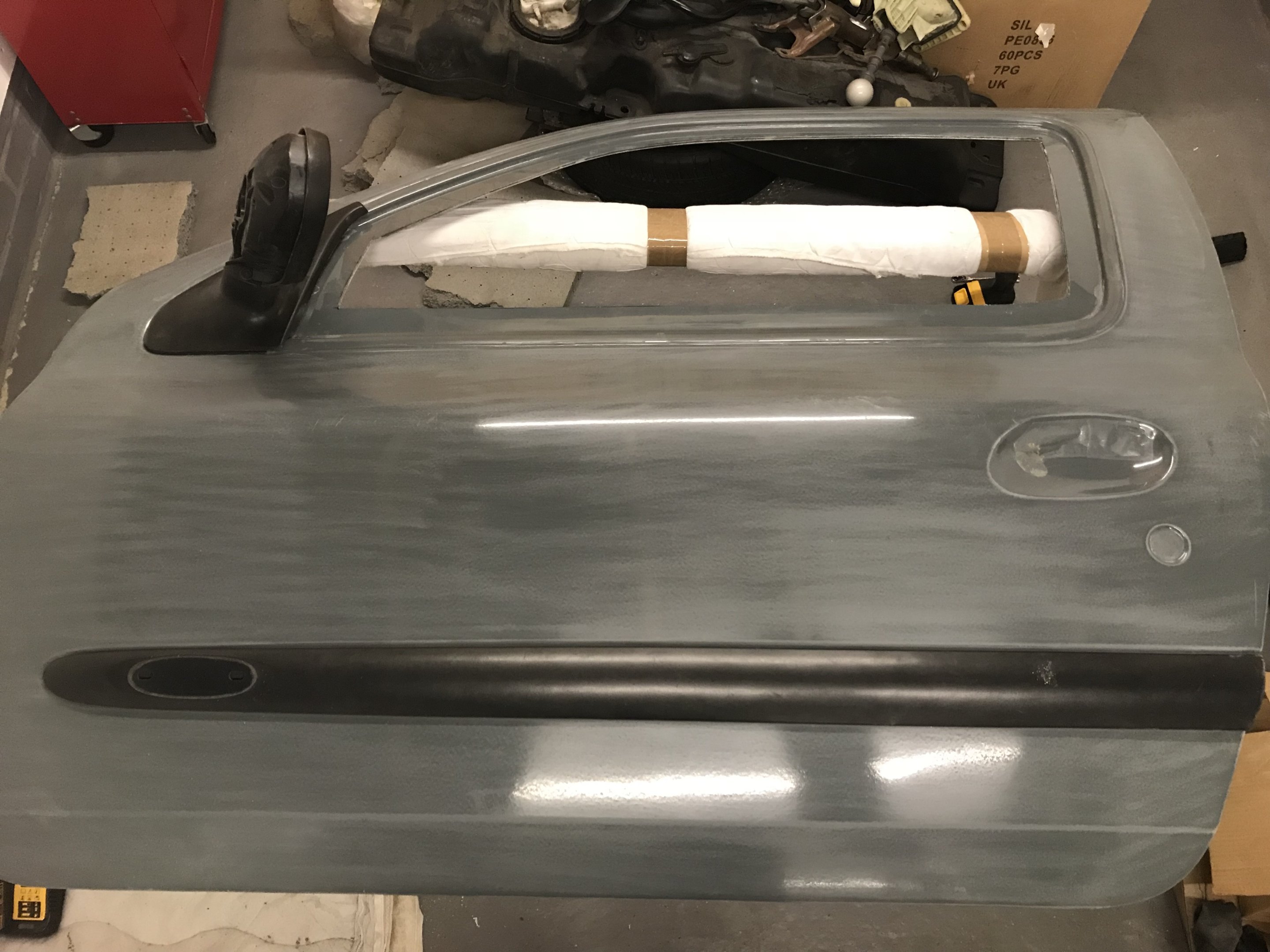

Next up after the tailgate was the doors and the rubbing strips. Initially I wasn't going to run the rubbing strips however where the holes would be in the composite panel these were a little messy, so I have decided to keep them. I measure and marked these up and set about trimming them. Then followed by the 3 holes for the wing mirrors.

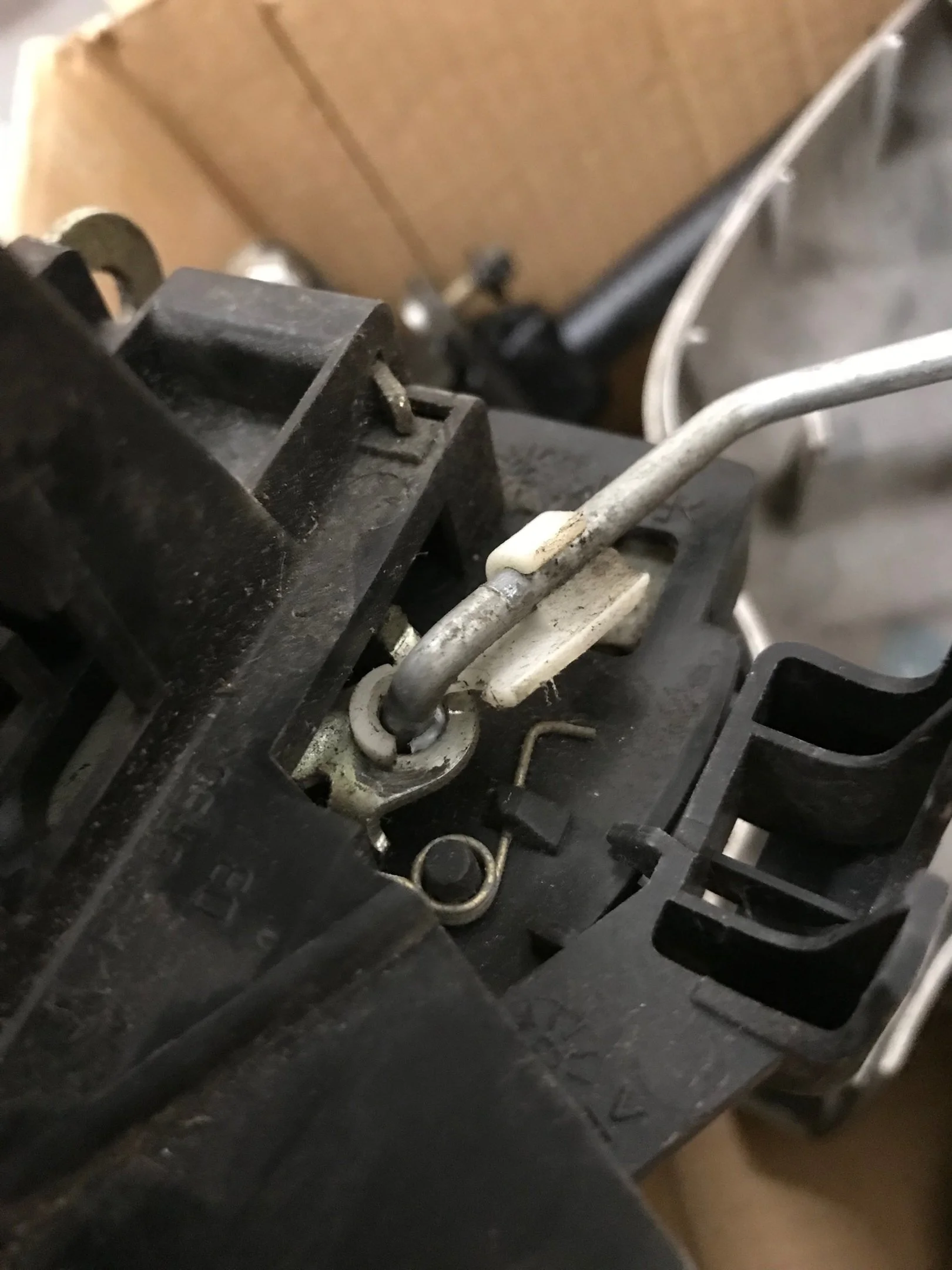

That brings me up to today. I did start the day with the plan of looking at the latch mechanisms however when i got out to the garage:
(1) it was bloody freezing and my hands were suffering, also acknowledged by these tiny little clips in the mechanism breaking
(I hope renault sell them, anyone any ideas?)

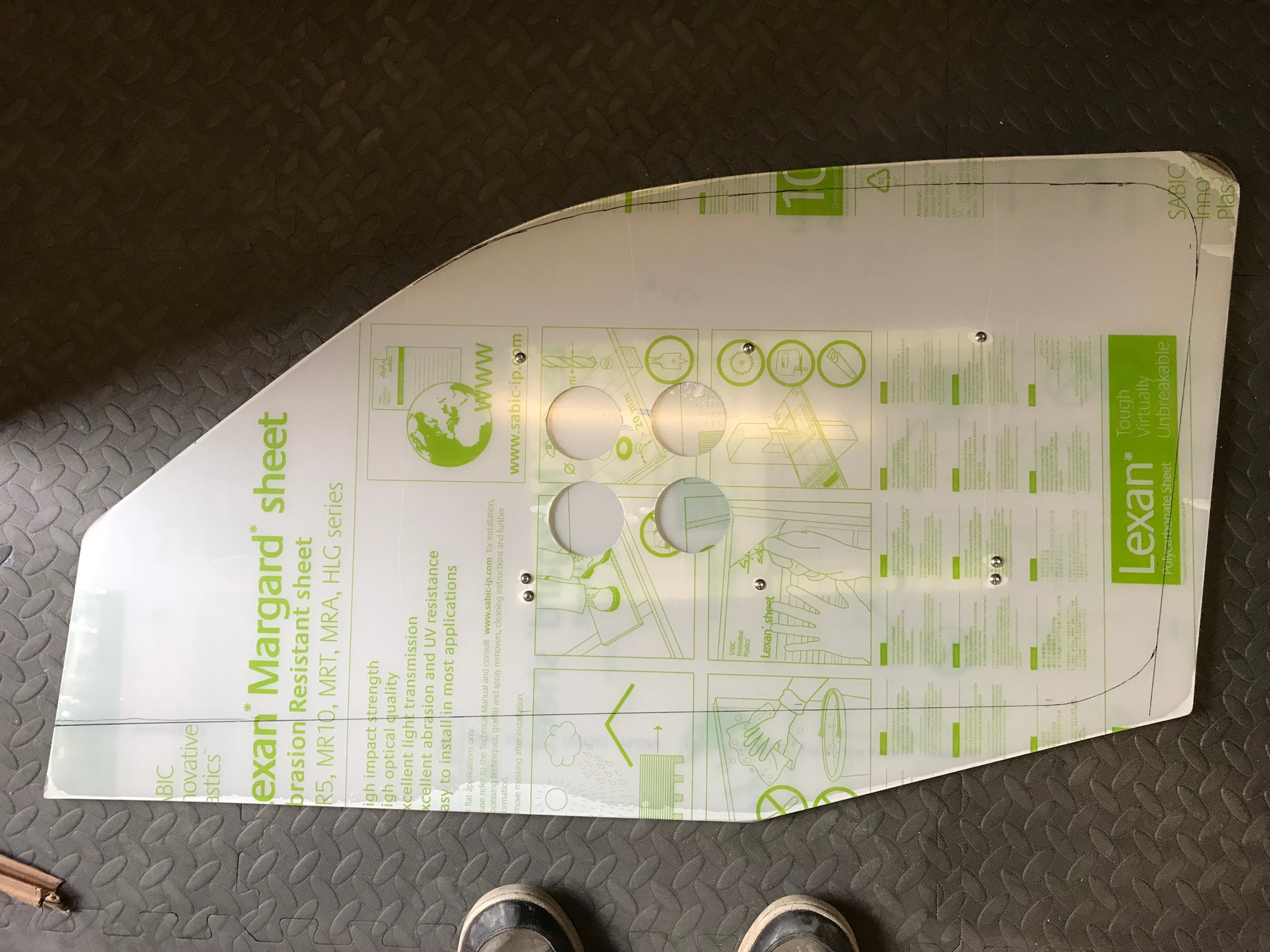

(2) I didn't feel I had the right tools to be cutting these areas out, Cue ordering a Dremel and some Diamond cutting blades. I probably also need to see a blank door to see how the areas have been cut. I also need to sort some hinges for the composite doors (someone was looking at cutting these out for me, but I think they are struggling so I may have to go new).

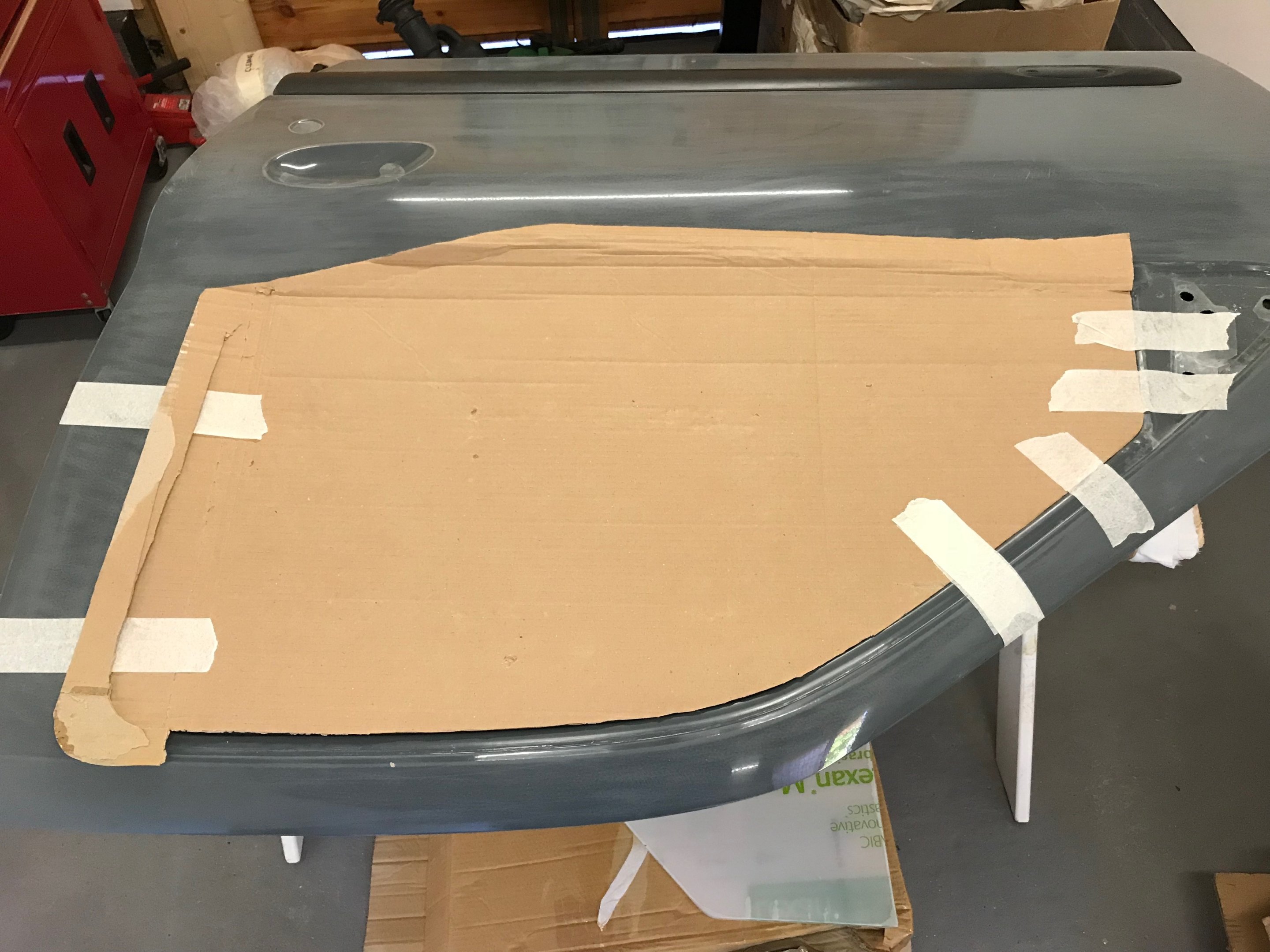

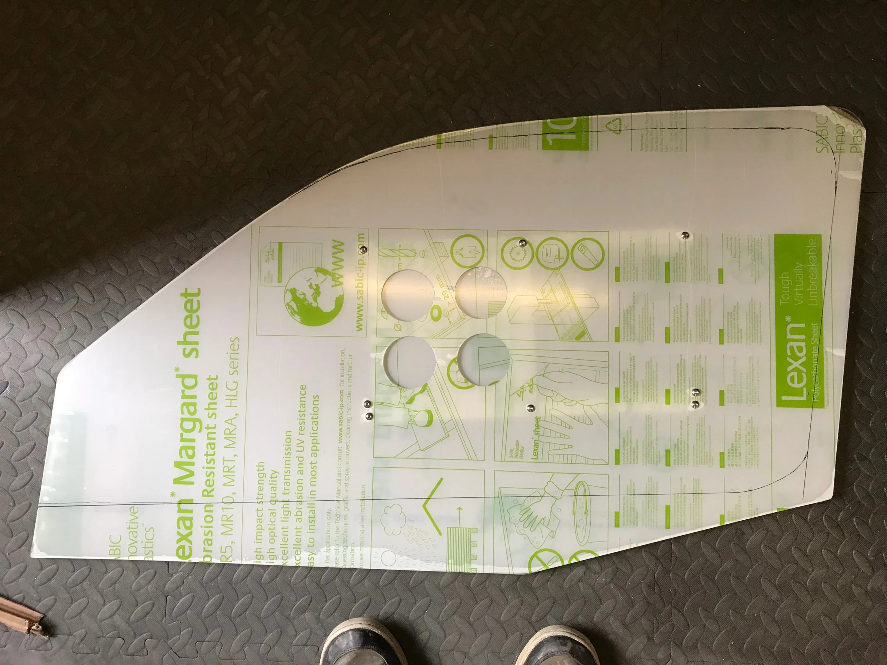

I decided to look at the next best thing and issue I have to overcome. A few years back I ordered some ACW Motorsport windows. When I picked up the composite doors I noticed that there was no ability to drop the windows into the door apertures (as the glass ones do). I believe the windows will have to be mounted to the frame left around the edge, meaning I need to trim down my windows a fair bit.
I first marked and cut a template to the same size as my current window. I then put this over the aperture in the door and trimmed it to fit, this was them transferred back to the window and marked up, sure enough though I do not have the right tools to cut this again so again I have ordered a jigsaw and lexan cutting blades.... frustrating.
So very cold and frustrated it has been left. I really need to be as far ahead as possible with these composite panels as they will need to go with the car to paint which will probably be in the next week or 2, however I don't think that is going to be the case at present as I am away on holiday for a week on Saturday. I have hopefully ordered all the tools I need though + the aerocatches so when I am back on the 6th I can crack on.

Coming along nicely. Are they CMC doors and boot?

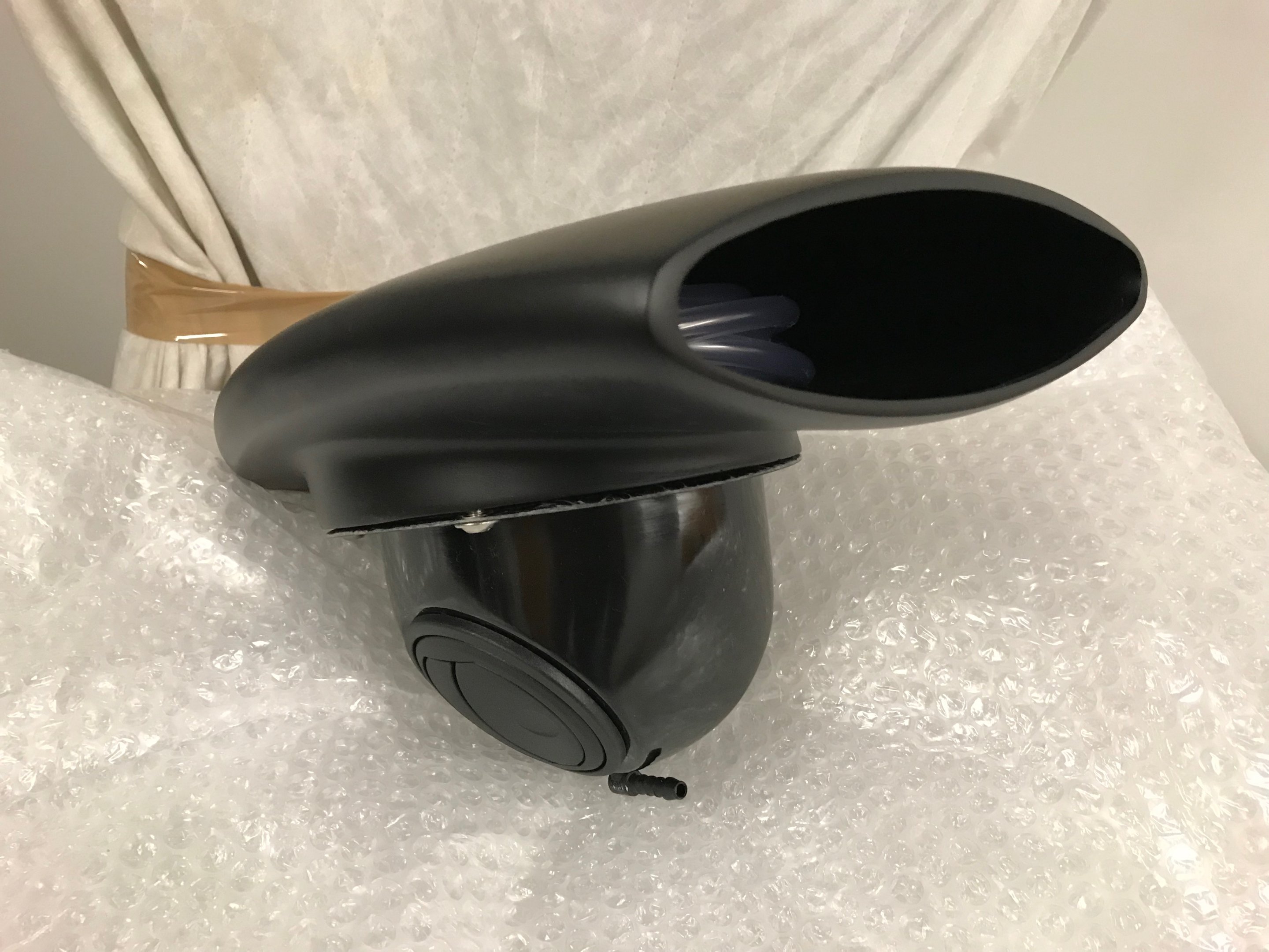

Have they stopped doing he CupRacer shape roof scoop?
Nafoff
CMC stopped doing the doors and tailgate. These are from CCF and are quite different I believe. They seem stronger in some areas but tbh really not sure on the window fitting (but can for sure see how this makes the door stronger).
I got the mrk2 cup racer scoop from CMC. I don’t think it is on their website, but I spoke to Chris about it.

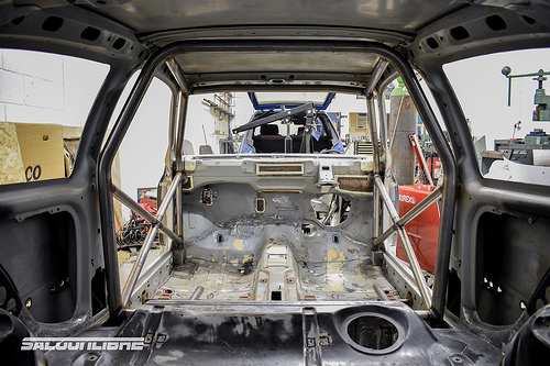

Cheers all, I visited the fabricator today and it is going well. I am sure some images will pop up at some point... I'll just say he is known on here and is pretty damn handy
Fabrication should be done by Wednesday morning and then the car is moving to the painters.... I really need to crack on with the composite panels now...
  A special one.

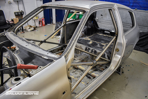

The guy who built the space framed pug 205 by any chance?
  172 Cup

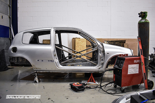

I always wonder, how do you weld the crosses on the outside?
You mean where they're shrouded by the A & B pillars?
You don't tack or weld the main roll hoops to the footplates until after fully welding all the roof & door bars, otherwise in most cases you'll never get the torch in the gap to complete the weld.
