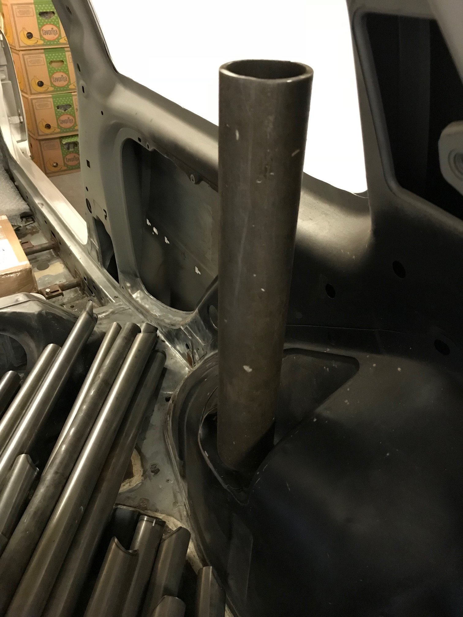

So I am still trying to sort the extra tubing to tie in the rear suspension turrets, but something has been ordered and is on the way - hopefully this will be correct.

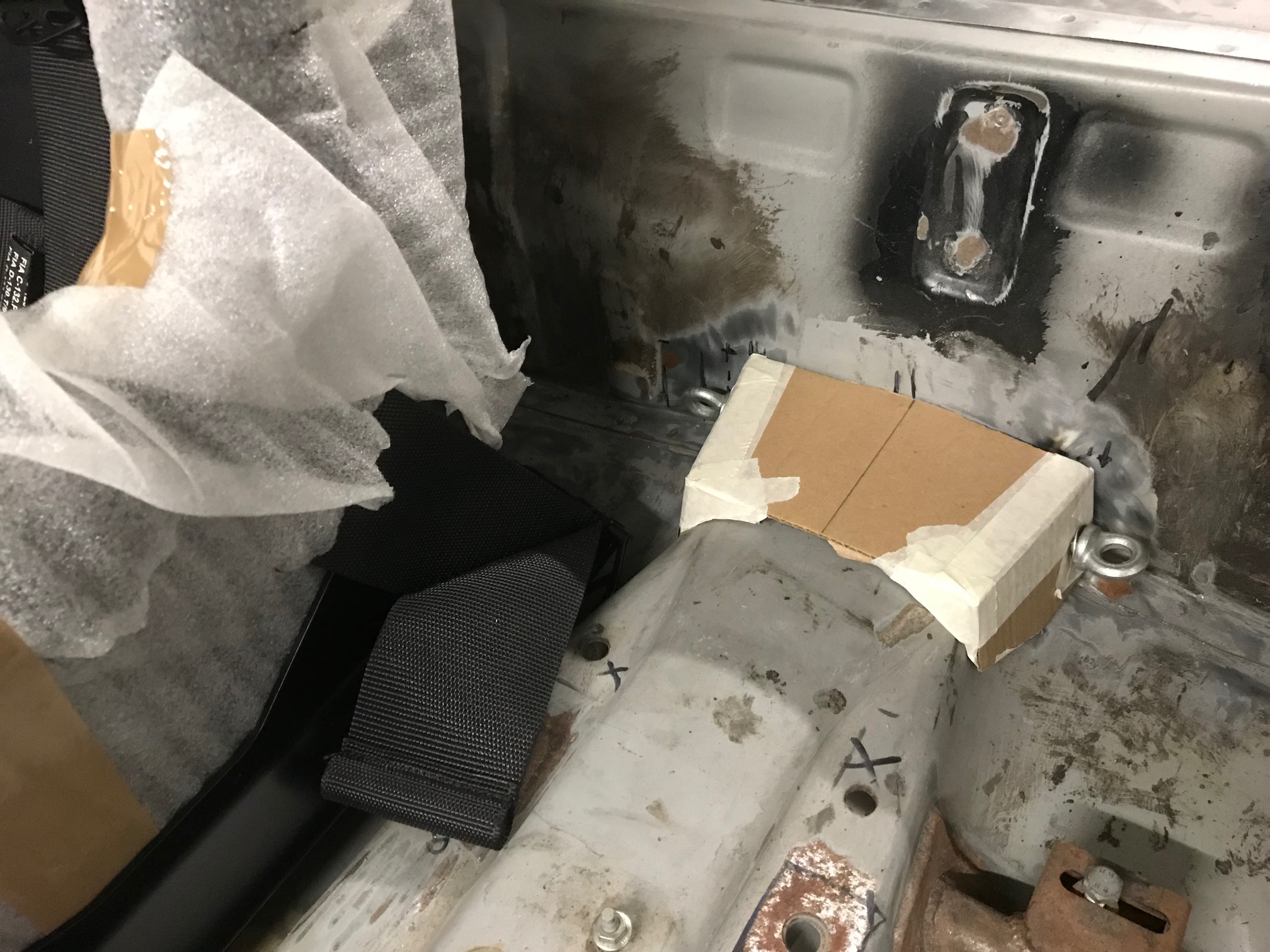

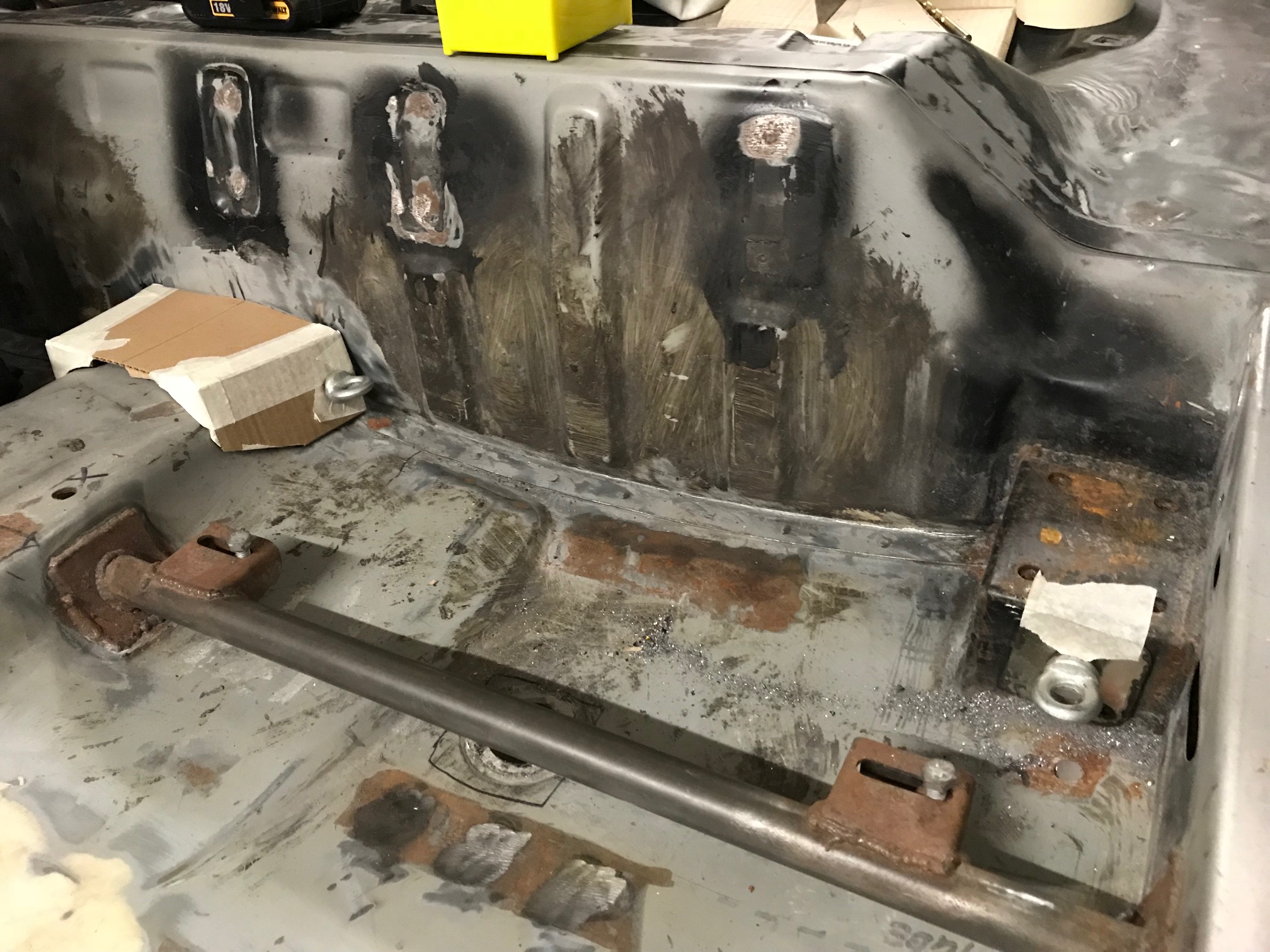

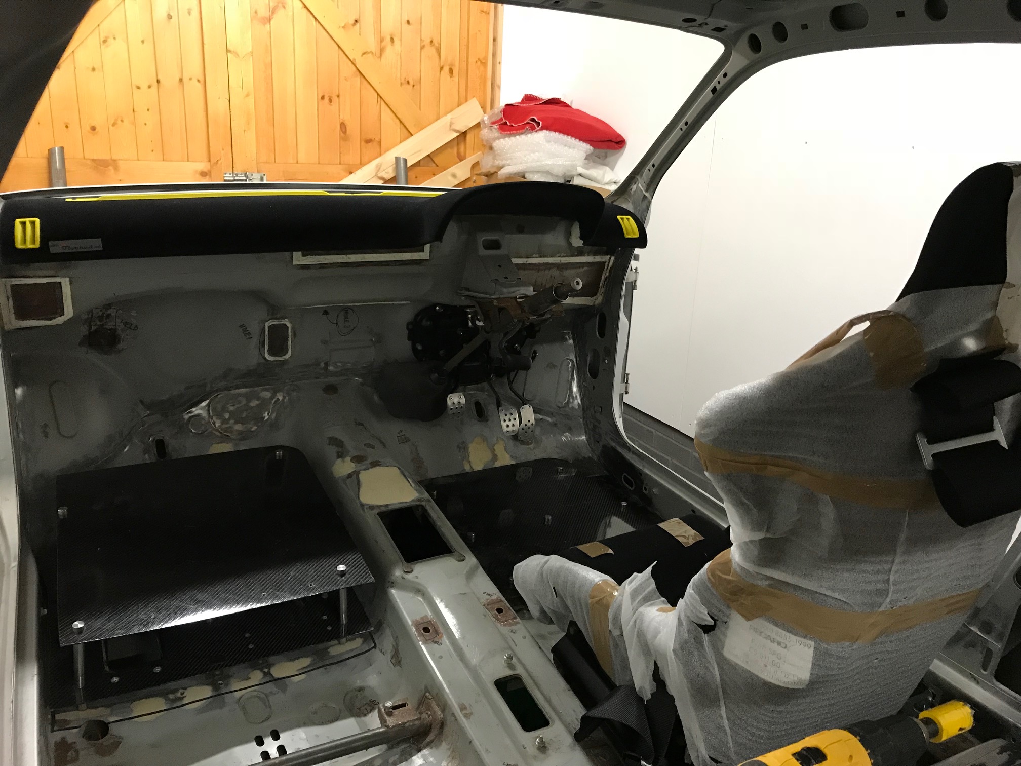

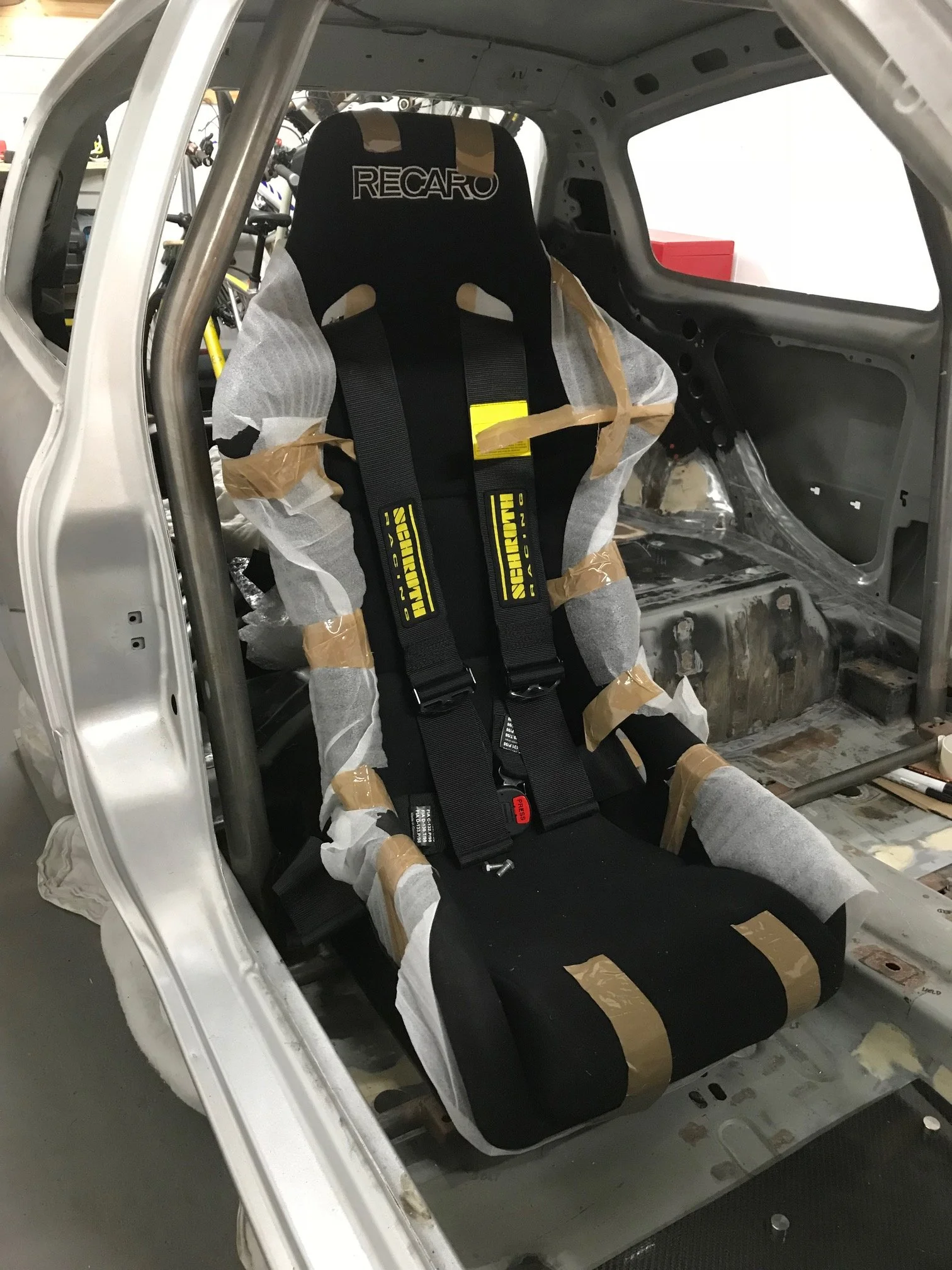

There are only a few of items that needed to be addressed - harness mounts, false floor mounts and the height of the dashbar. To figure all these out I needed to get some interior bits back in so I could measure and mock-up. I dropped the subframes and seats in, bolting them down and then threaded up the harnesses.
I could utilise the current welded in feet of the main hoop for the outer points, the plates will then be welded to these. The inner points are a little more tricky but as I will be running a lower brace bar across this mount I am deciding to strengthen this end of the tunnel area. I have mocked-up this section which will be replicated in metal and welded in, holding the eye bolts and also later tying into the brace bar.

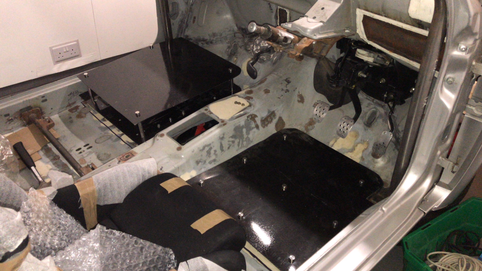

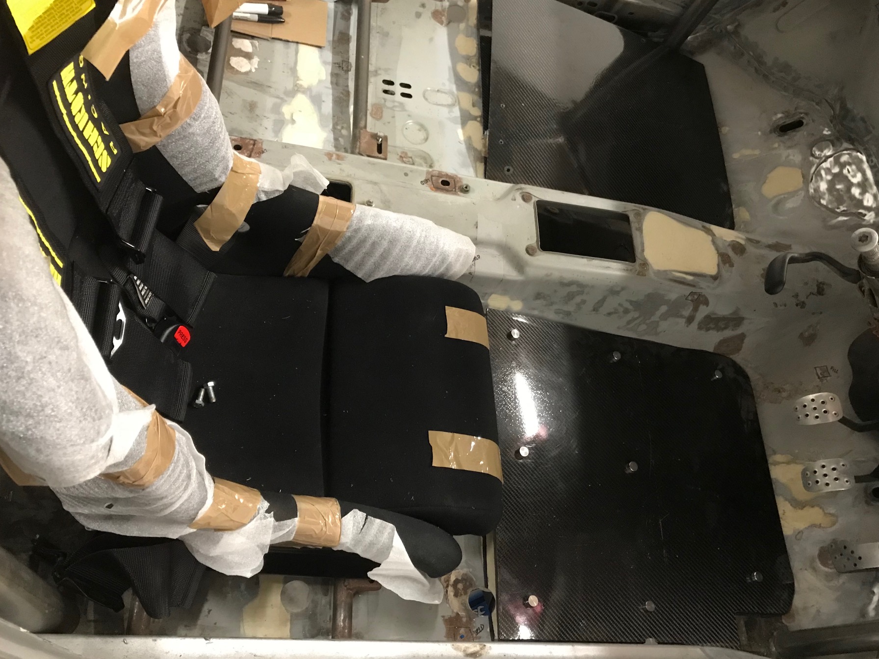

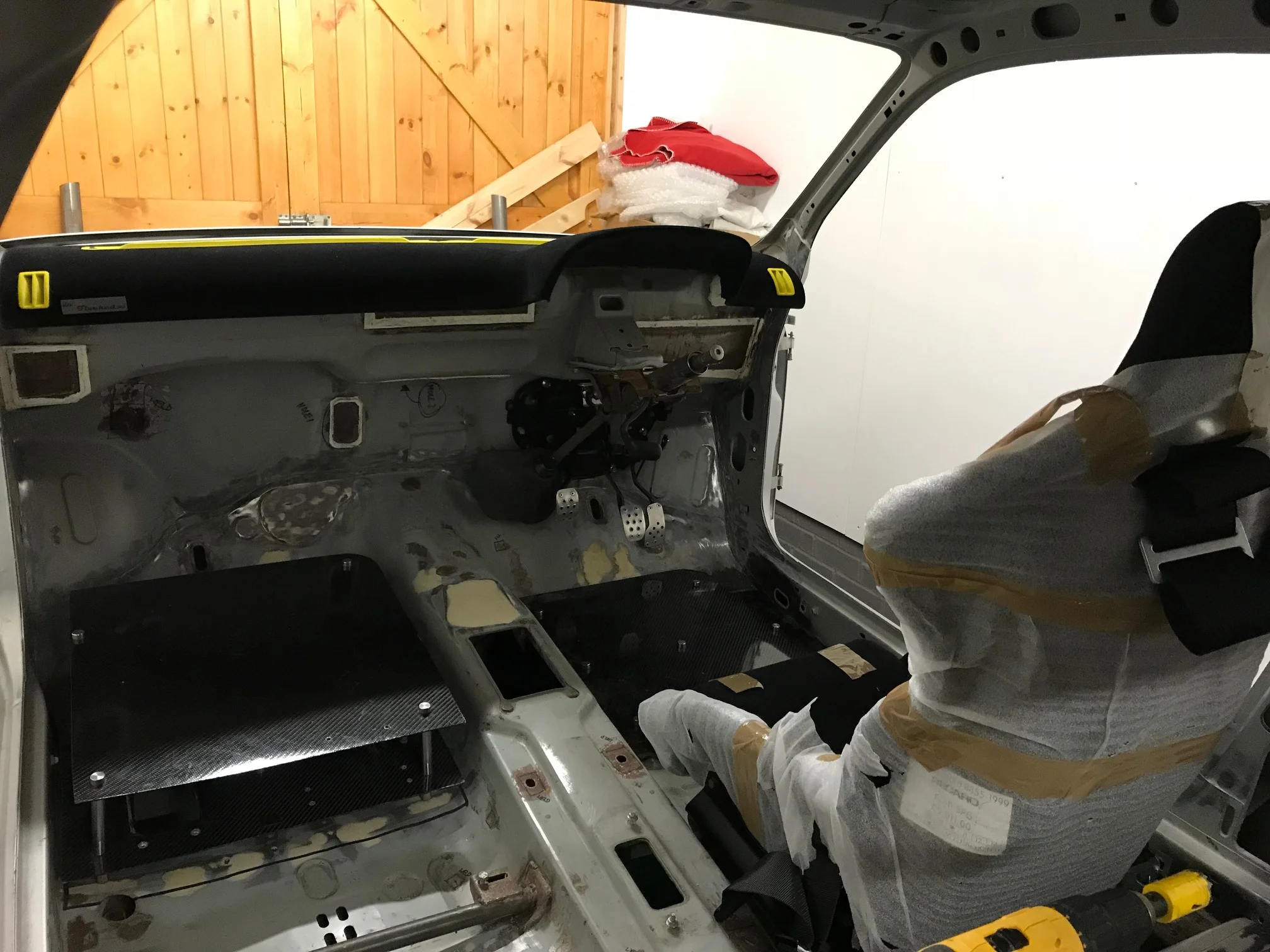

With that addressed I then turned my attention to mounting the carbon false floors. They fit snuggly in the footwells so lining them up is important. Using threaded bar they then bolt down - the bolts will be welded to the floor hence the importance of mocking up before paint.
The drivers side was pretty easy, the passenger side a little more troublesome as it has 2 floors (the lower houses a lot of the electrics and the top covers it when you have passengers.

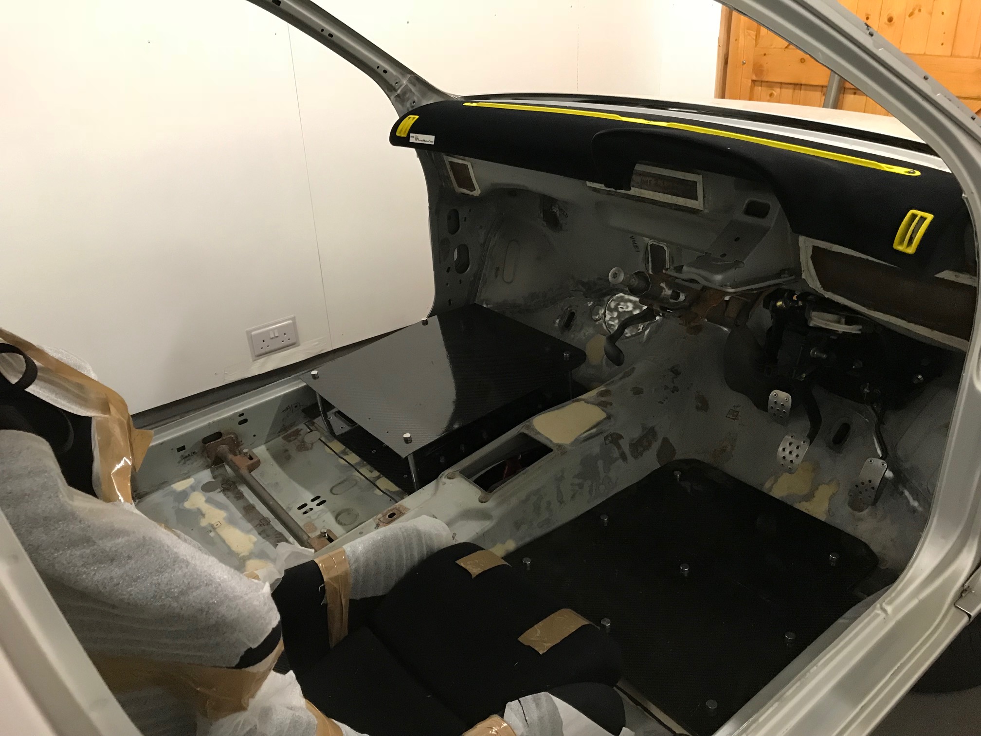

The last and quite simple job was to just get the dash in so I could see what height I will be welding the dash bar in at, this will be marked up on the shell so I know when we are welding it in. Even though it is still a way off of being finished its quite exciting putting stuff back in, it somehow feels like its moving forward a fair bit.

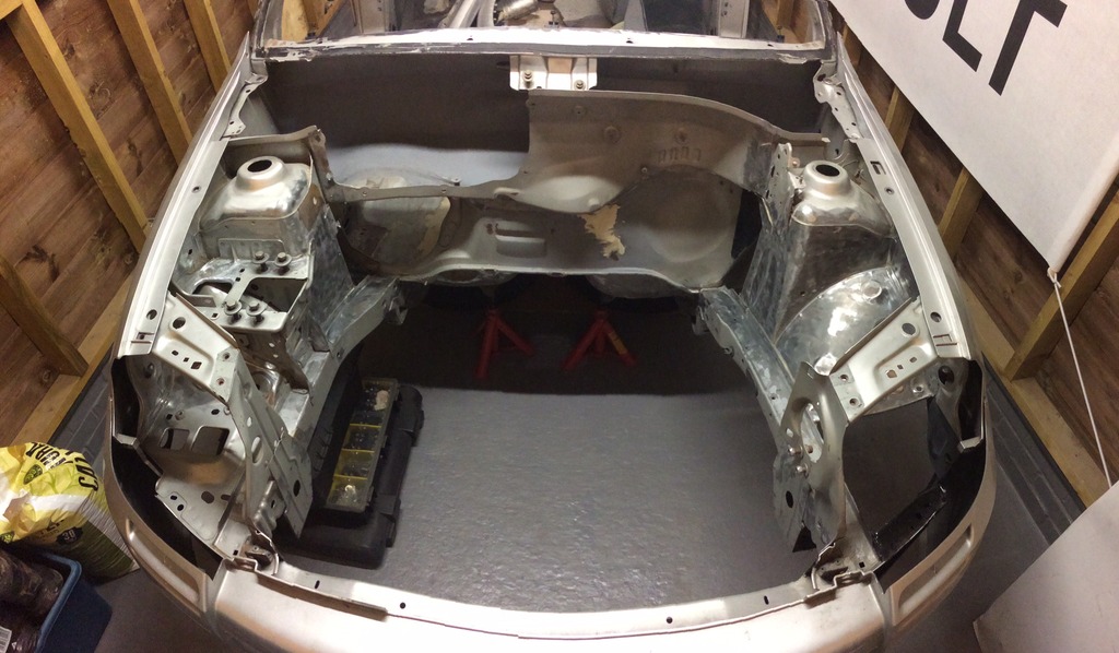

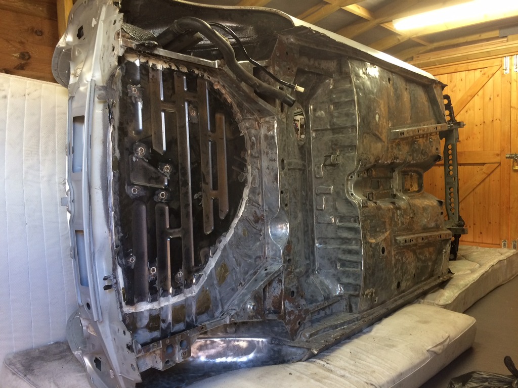

Where the clio will be stored is currently an unknown, however what I do know is that it can't go into storage in its current state. After stripping all the underseal there is a lot of bare metal which would obviously just rust if left. So instead of potentially giving up again this time there is going to be a major push to get it in a much better state. I am possibly working to a deadline of the end of February/start of March to have to move the car, at this point I am aiming for it to be a rolling weathertight shell, this means the below needs doing:
Fabrication needs finishing
I now have all the extra cage tubes so 8 tubes now need profiling, the turret tops need cutting to size, tunnel brace needs welding in (this is currently with a fabricator being produced), A and B pillar gussets need making, the numerous holes, the wing trim holes and the rear arches need patching, nuts for the false floor need welding in and holes need to be cut in panels for the roof scoop and aero catches (aero catches need to be ordered). The cage welding was going to be done by my next door neighbour however with the looming deadline I can now not rely on favours so this will be going to a fabricator at the extra cost.
Paint

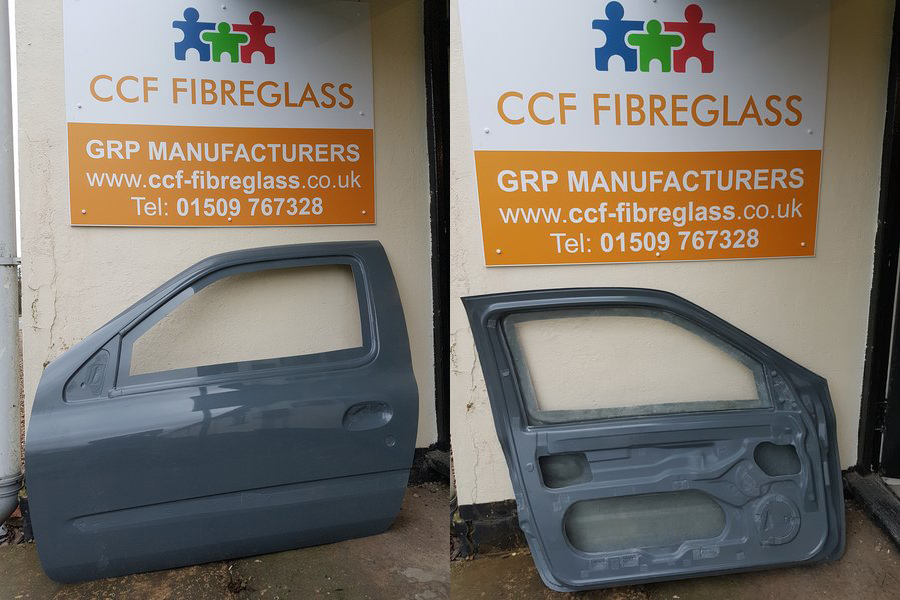

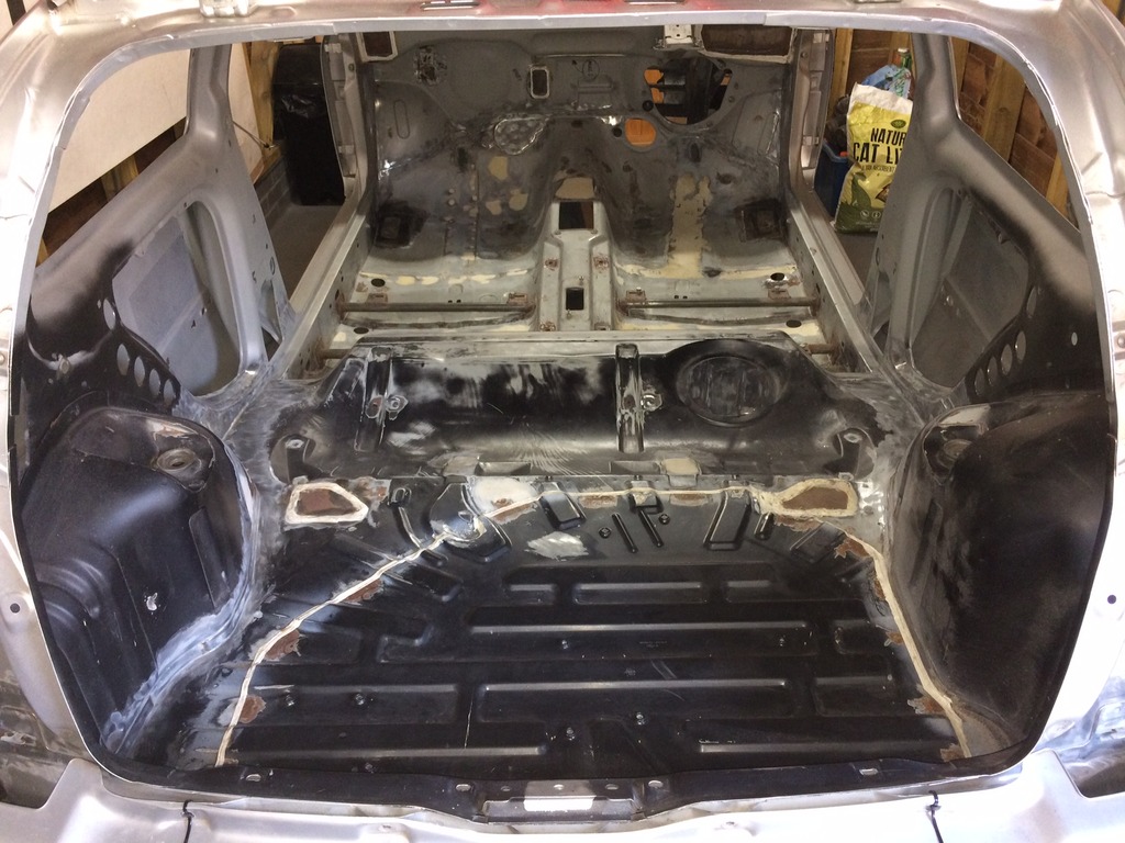

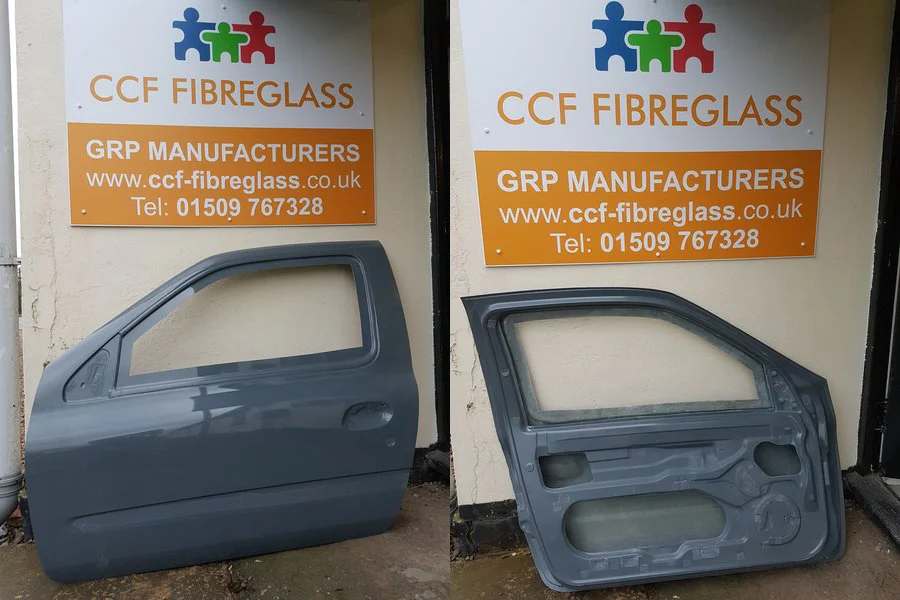

What can I say about paint, it needs a lot - basically all over... Inside, outside, underneath and the engine bay (pictured above). Before this however I need some new panels. About 3 weeks ago I managed to sell the lightened doors and tailgate in favour of some fibreglass panels that have now been ordered. The doors and tailgate (pictured below) are coming from CCF and I have ordered an older cup roof scoop and a cup spoiler from CM Composites (pictured below). Once I have these items I need to purchase some aero catches for the bonnet and tailgate and some door hinges from Renault. The doors do not come with holes for the side trims so I will be matching the rear 3/4's to these and welding those holes up. I do still need to pick up a new fuel filler flap and a new rear badge (as the fiberglass tailgate is ph2 shape unlike my ph1).
(Shamelessly stolen from @Russ Rallye's thread, thank you chap)
A colour has not bee chosen yet but it looks like it will be going grey inside and will be a solid colour outside (to keep costs down). I have a couple ideas but am still very much unsure on it - part of me is saying white for ease.... but we will see. I need to have a further discussion as how far the painter will be going with re-assembly, I am wondering if he will want to check fitment of the panels so it will depend on how far this stage goes to what I will be doing in the next stage.

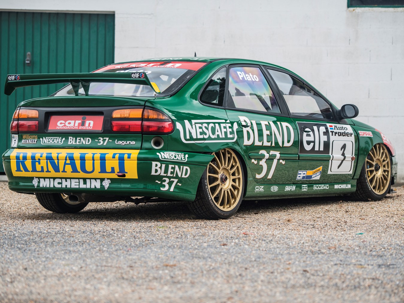

Green and yellow like the Laguna!! Will have to go gold alloys and a Nescafé sticker too... You cannot to wrong with a bit of BTCC-ness. Big wing also compulsory.....
