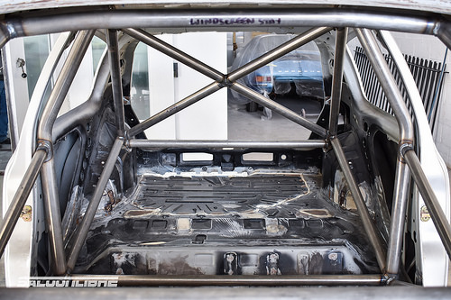

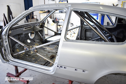

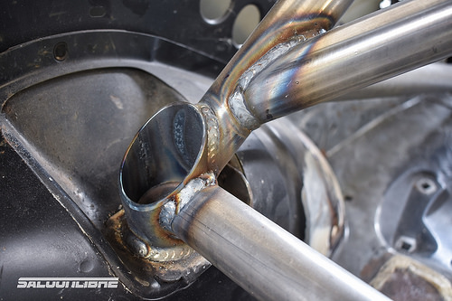

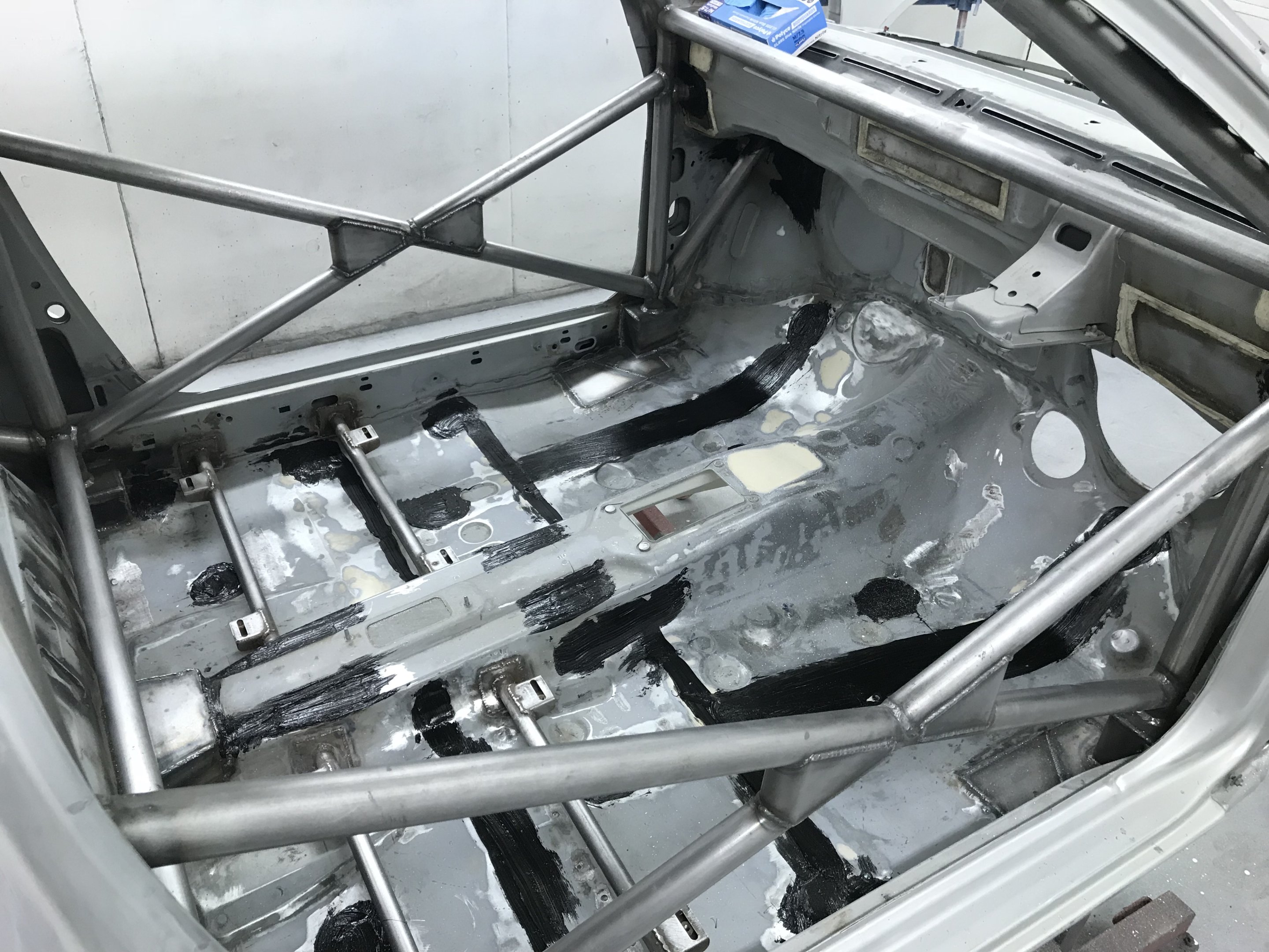

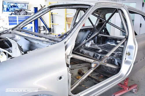

But even then. When you look at the lower barr joint beneath the B-pillar. How do you get acces to that? I mean, the cage doesn't go up anymore, it doesn't move from left to right, nor does it go forward. Or can you wiggle it about just enough to get the torch in between?
Cage looks really good though.

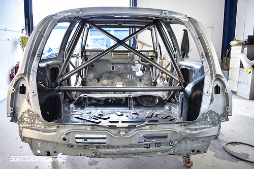

Noice, though I may have added the A-pillar reinforcement tubes myself. Looks lovely though.
There are a lot of things that could of been added but i think this is a good middle ground between strength/safety and weight.
I wish It made sense to just clearcoat the cage rather than paint it, ha
All in all though, very happy and the car is already in the bodyshop. I now need to get the fibreglass panels sorted asap.
Nafoff

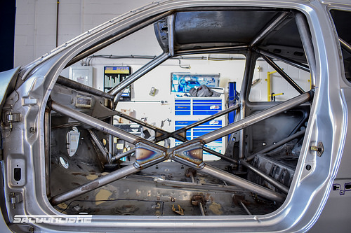

No harness bars for the cage?
The lateral rear strut bar is high enough to have a decent angle on the shoulder straps, the angle is 12deg.. (MSA / FIA allow anything between 10 and 45).
The diagonals are also oriented such that the harness bars would be really short and off to one side, so the straps would be skewed if added.
JamesBryan
Ahh right, i assumed the bar going to the struts would be used for harnesses after i'd posted.

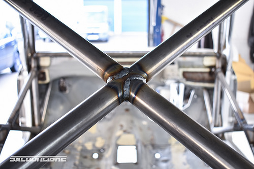

Be nice to see some gussets on the cross/diagonal bars :wink:

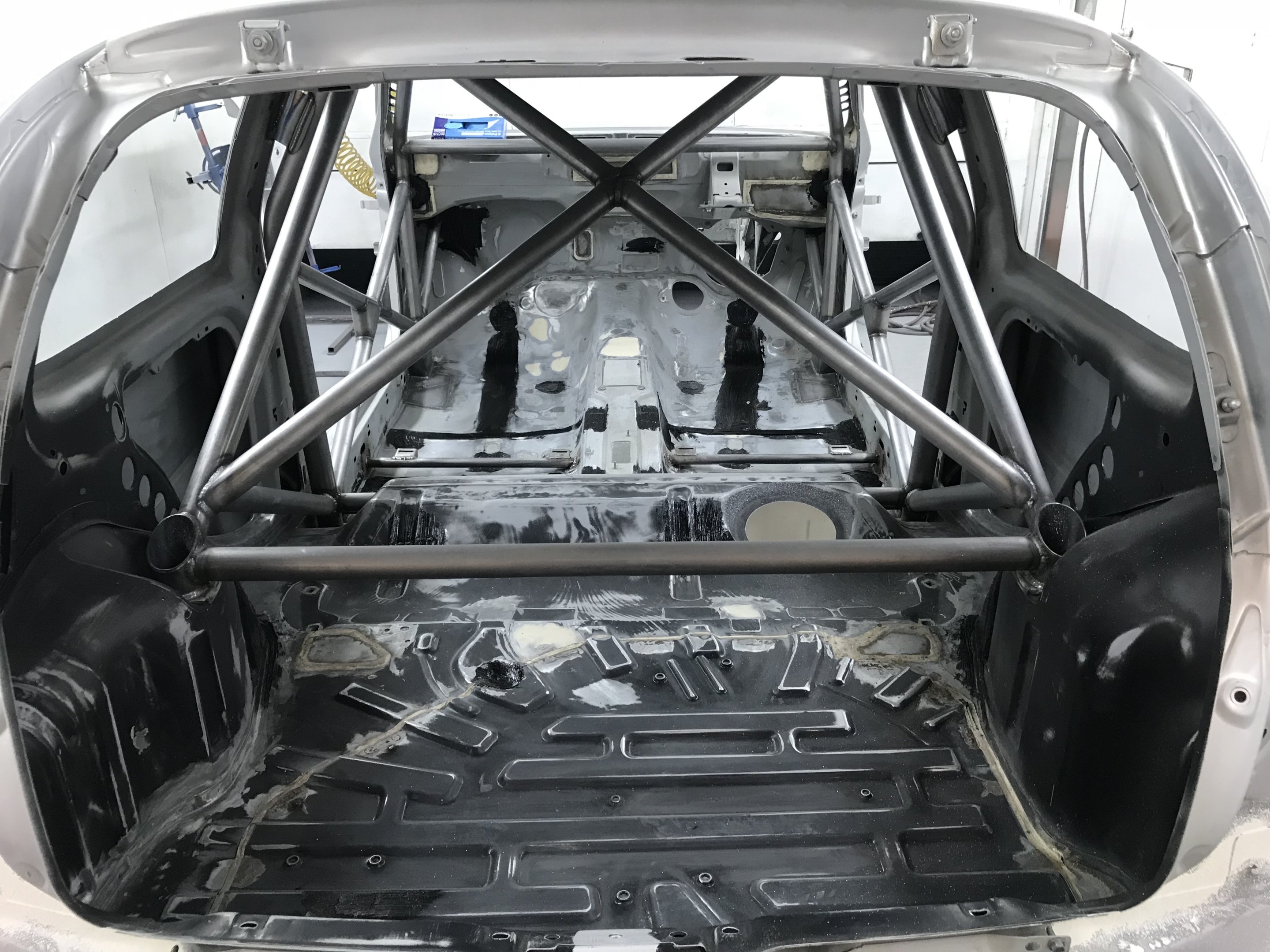

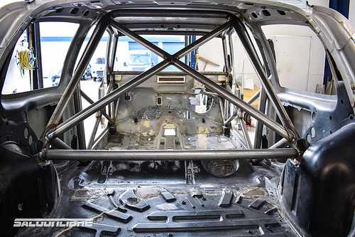

The base of it is the Oreca/Sassa (I would say 6 point but it already triangulates to the front susp).
I have then added a dashbar, and changed the location of where the rear triangulates to (use to be the arches and is now the rear susp), + the rear lateral bar between struts, his meant I needed to purchase the lower backstays (from main hoop to rear struts) and the rear lateral bar extra
  172 Cup
All additions to the cage mentioned would be nice but it all adds weight.. we're talking +10kg easily for A-pillars and harness bars alone, and that's the kind of weight people go to a lot of trouble to try and remove! If the cage is certified then no reason to add anything more. :up:

Cool thought iy was Oreca.
They have seemed to be a good fit from what I've seen
Agree with the above unless you go T45 then eat your heart out or intend to go rallying.
The least amount of bars that is still safe gets my vote especially with the added pickups to suspension!
massivewangers
  Several
Understand the reasoning. My thought was that the MSA are mandating A-pillar reinforcement tubes for new build stage rally cars from 2019 and I can see them extending that to all disciplines (knowing the MSA!) so it future proofs a bit, should it ever become a competition car. That and it looks cool lol.
  172 Cup
It definitely does look cool!
That is an issue but there's always a clause that it's for new builds and not cages with an existing certification (such as Neil's). Unless MSA are changing tact now and making a whole load of previously certified cars ineligible? I'd be very surprised if that were to happen.. a lot of people would be understandably pissed!
All that being said, I fit any competition car with A pillar reinforcements for that reason because all my cages are effectively new builds.
  172 Cup
The problem with T45 is you're still bound to minimum material spec of 50mm x 2mm / 40 x 2mm so you don't save any weight at all - unless you have the money to get a cage homologated!
I can't remember the exact wording in the blue book but I am sure they are making arrangements so that cages with existing FIA homologation can have the new tubes retrofitted. As you say, the new build clause usually protects existing cars but, with the MSA moving cars to the new passport system in the coming years, the wording seems to have been left open enough for them to make people update existing cars. I wouldn't put anything past the MSA lol.
Exact wording is "..vehicles first issued with a vehicle passport from 01 Jan 2019.." so it doesn't look like they'll force this on cars that have already got a passport, but you're right in that any pre-certified cage will need to have them installed to obtain a new passport from 2019 onwards.
Interesting that they've ditched the A-pillar angle requirement for having the supports and instead moved to a measurement from the B-pillar support to the upper corner of the A-pillar. Still, I doubt many cars will have this dimension less than 200mm, so again it's going to be pretty much mandatory.

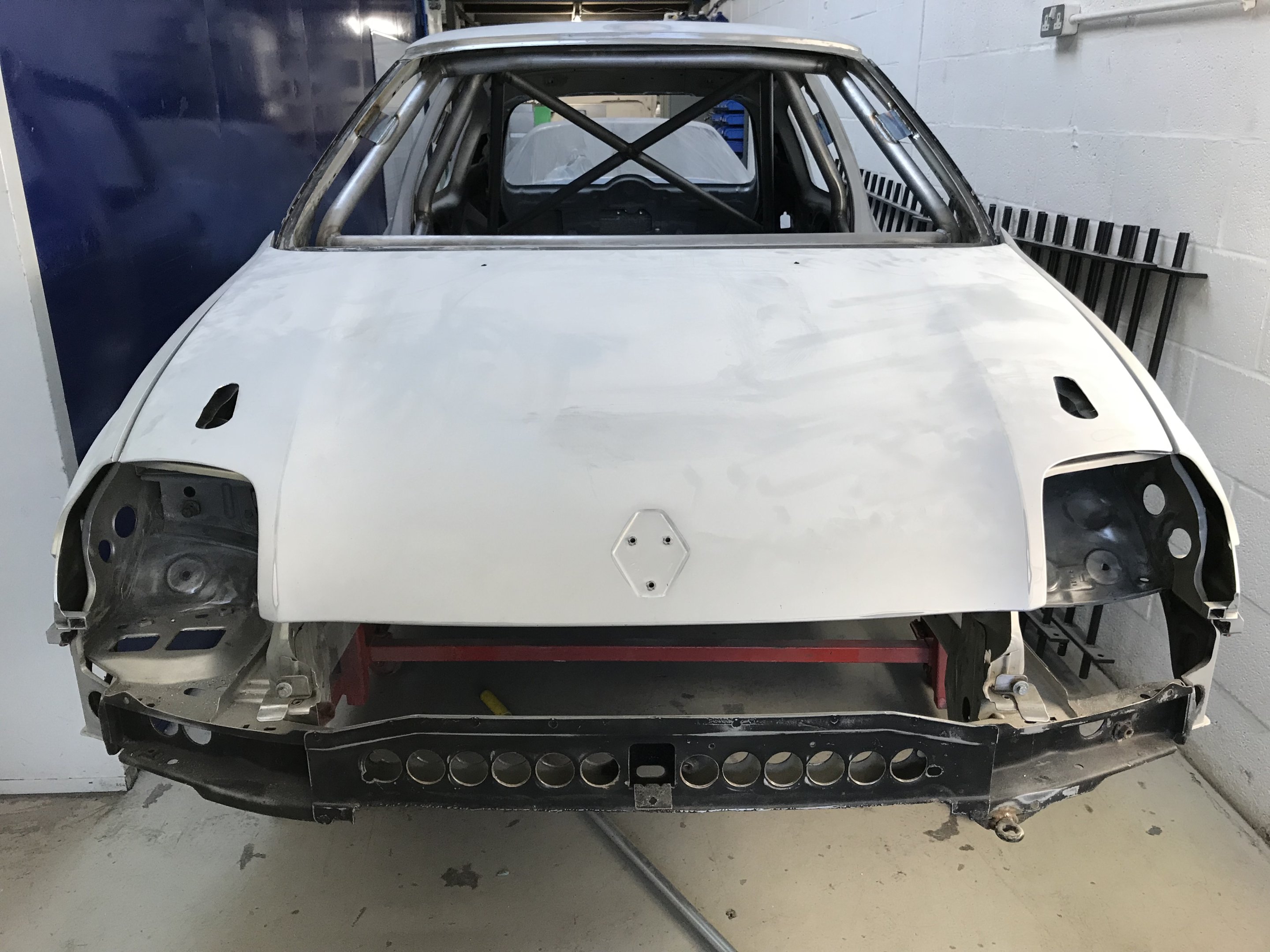

UPDATE:

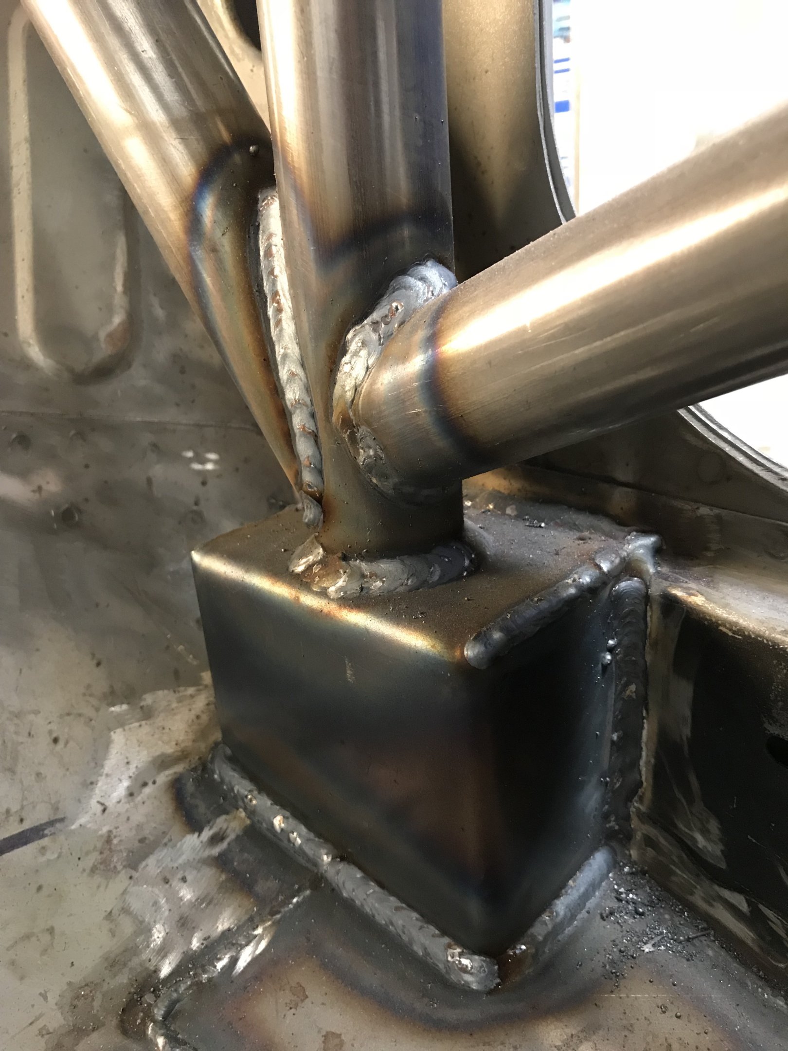

So as seen from the updates kindly uploaded from @CamMoreRon above, the main part of the fabrication on the cage is pretty much sorted here a couple more detailed images, including the harness mounts over the tunnel.
The car has been moved to the bodyshop for the next stage now and I visited them over the weekend and had a good chat with them about the shell - needless to say the original quote wasn't quite going to cover it so the price has gone up by half again, a little frustrating but I am confident that I will be getting a good job. As part of the discussion we talked colours, I was originally thinking that I would do the interior black to keep glare to a minimum (no matter the exterior colour) however in an attempt to keep the job easier and a little cheaper I have now decided to go one colour throughout as after asking around a fair few people it appears glare isn't that much of an issue - this change in colour though did have a knock on effect meaning I had to change the colour of my brake line order....
The other plus is that the bodyshop have said that I can go down after I get in from work at 7.30pm (inconveniently only over these next 3 weeks) and work on the remaining items needing prep for paint - having better tools and a knowledgable eye over this is reassuring.

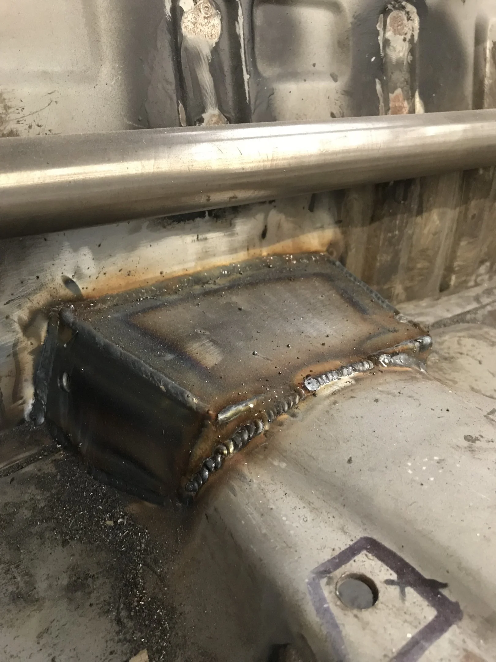

  • Bigger holes need blanks welding

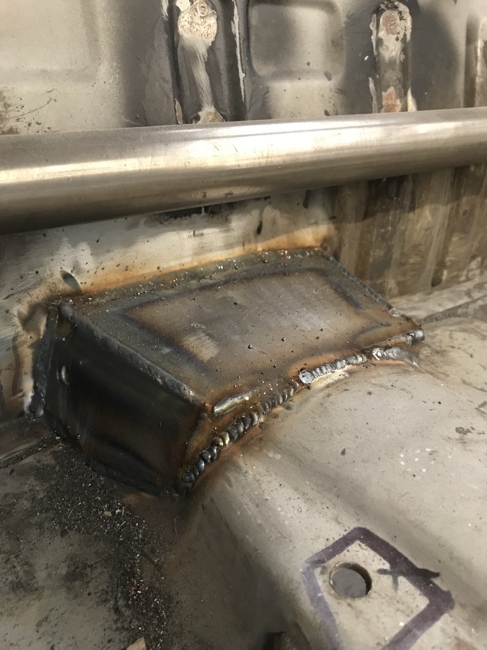

  • Outer harness mounts need welding
  • Tabs for A&B pillars need welding

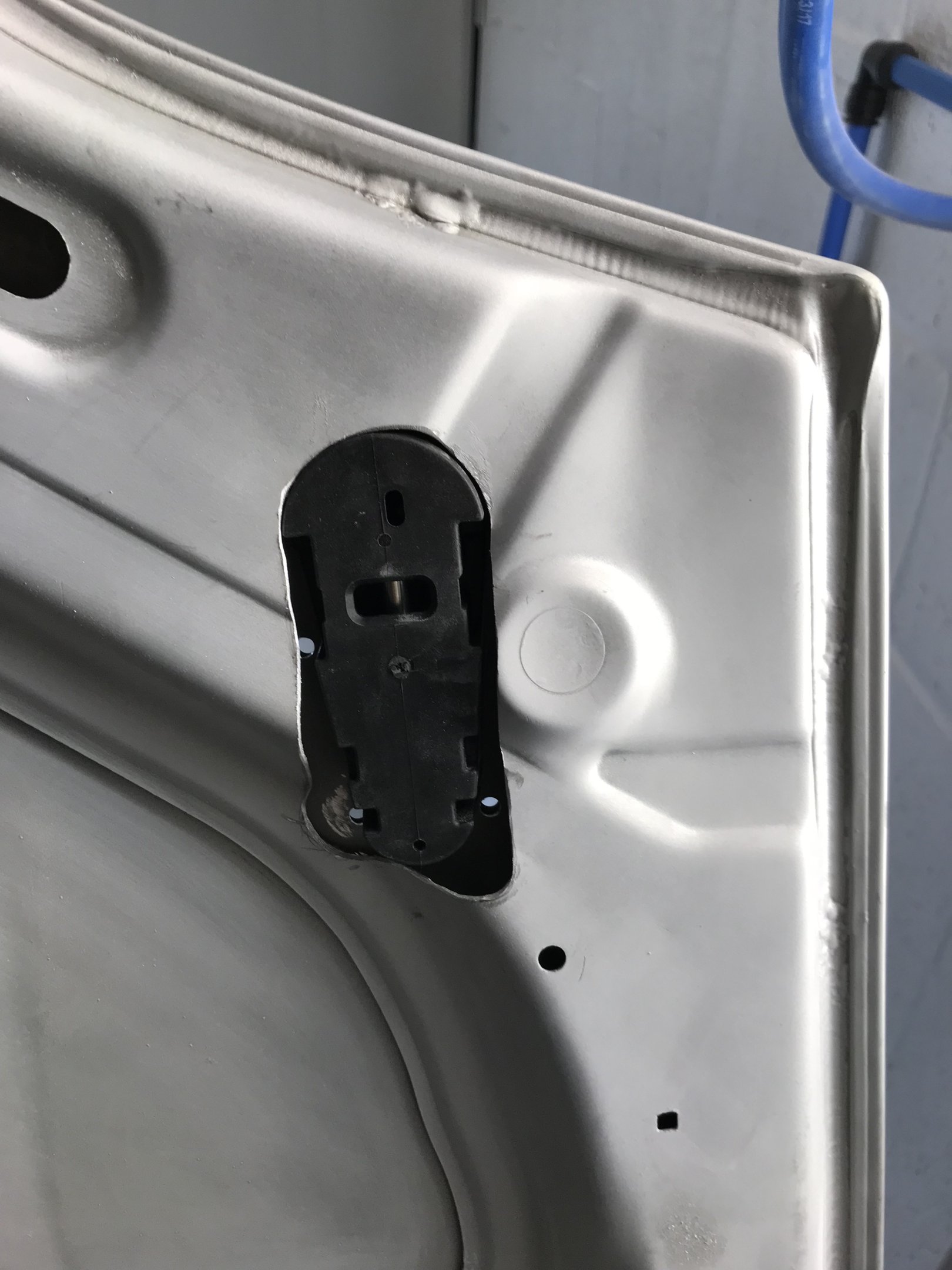

  • Mock up and cut aerocatch holes in bonnet

A fair list and one that I am keen to crack on with asap.

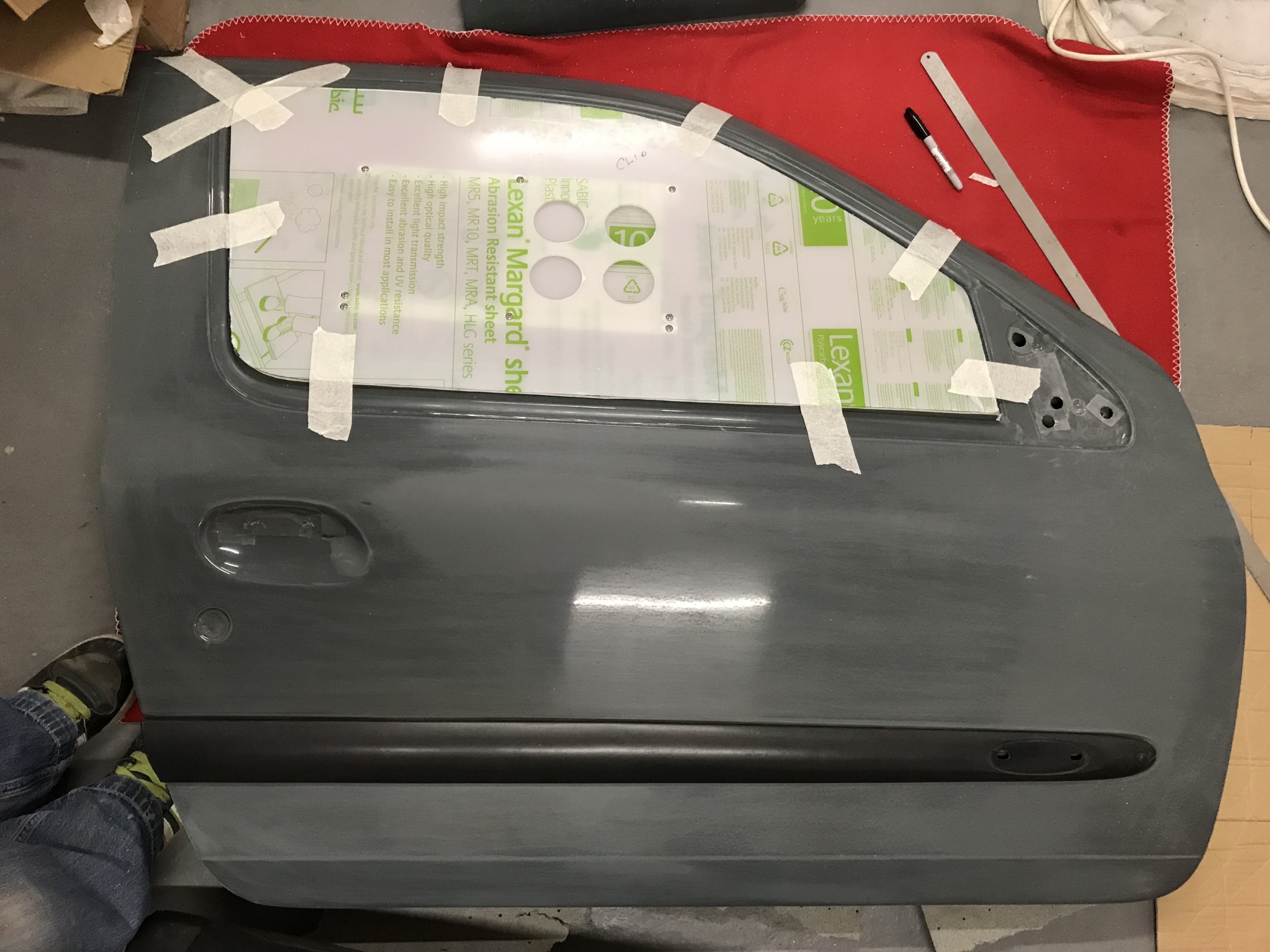

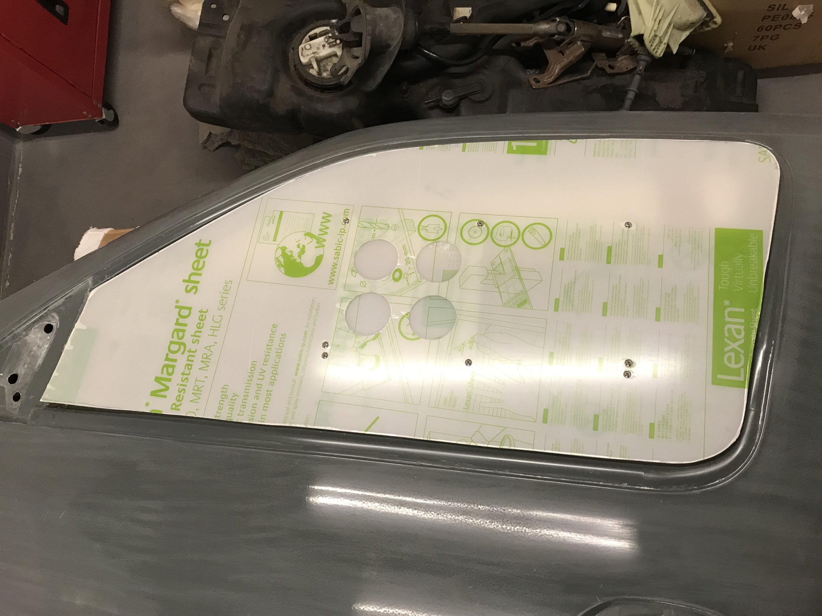

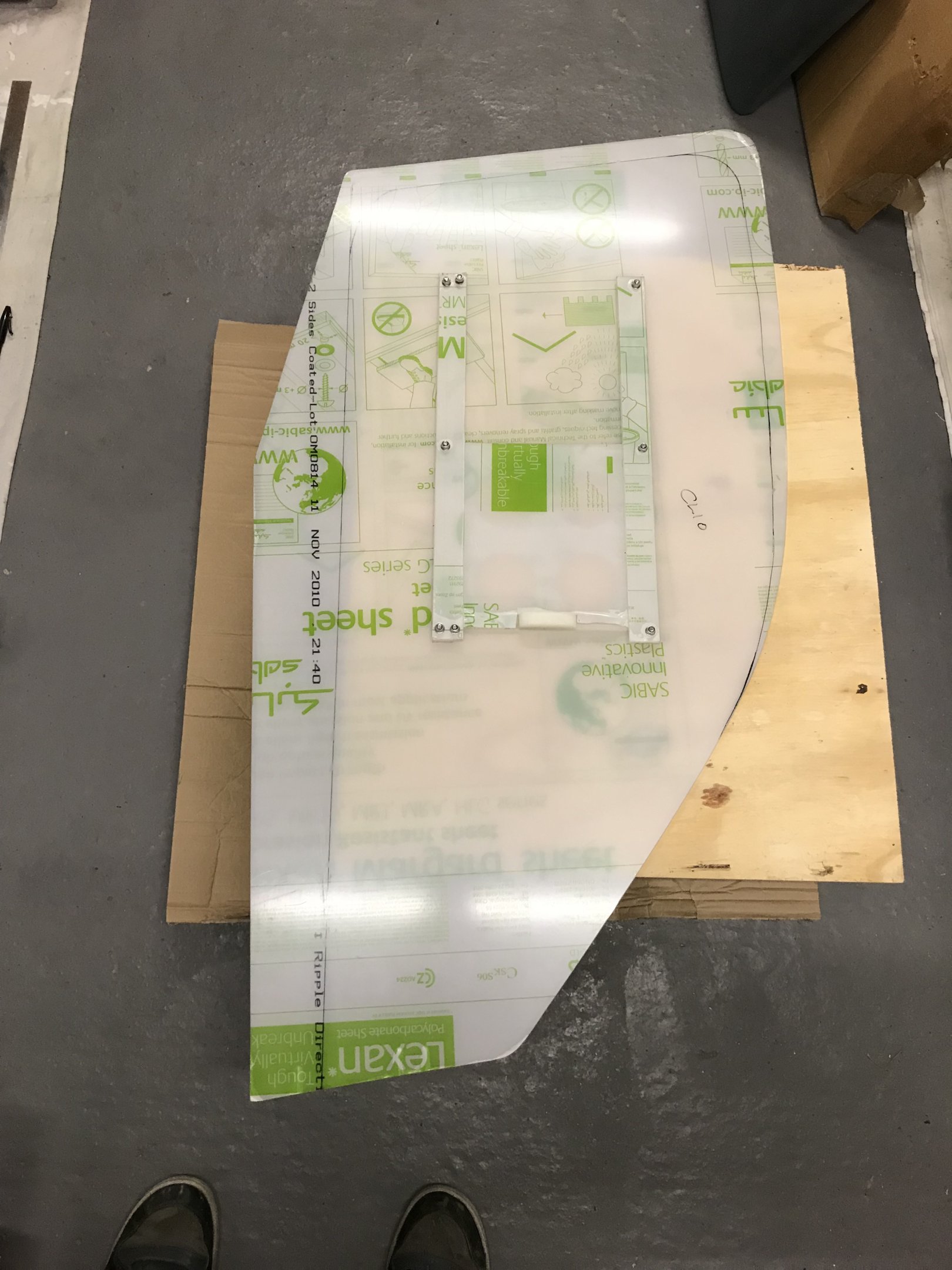

However with the above not an option over the weekend I set about finishing trimming back the Lexan windows whilst I still had the doors off the car. I think I previously showed how much needed trimming back (image below) - at least thats less weight again I suppose. ha
and both sides trimmed back (typically one went perfectly and the other was a ball-ache).

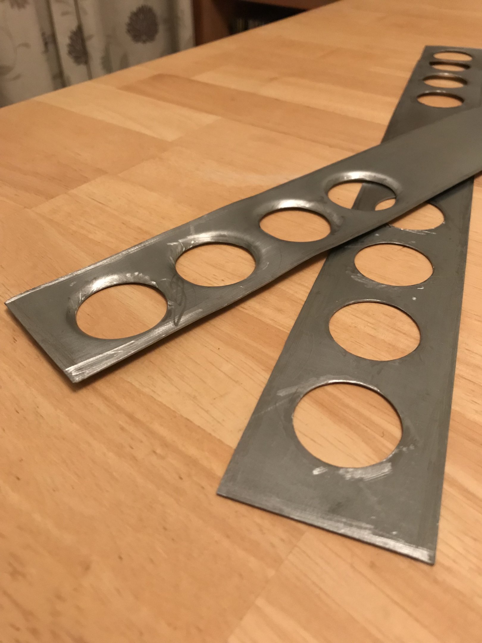

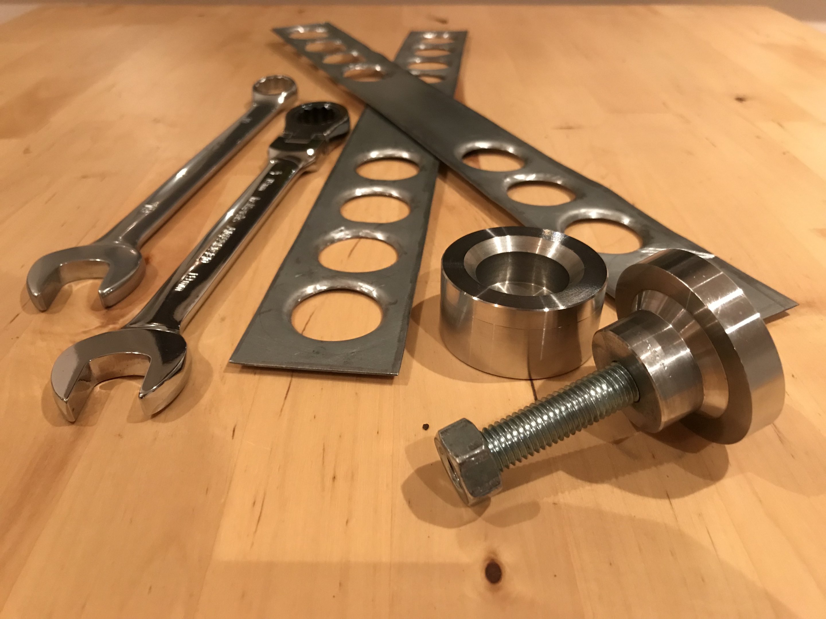

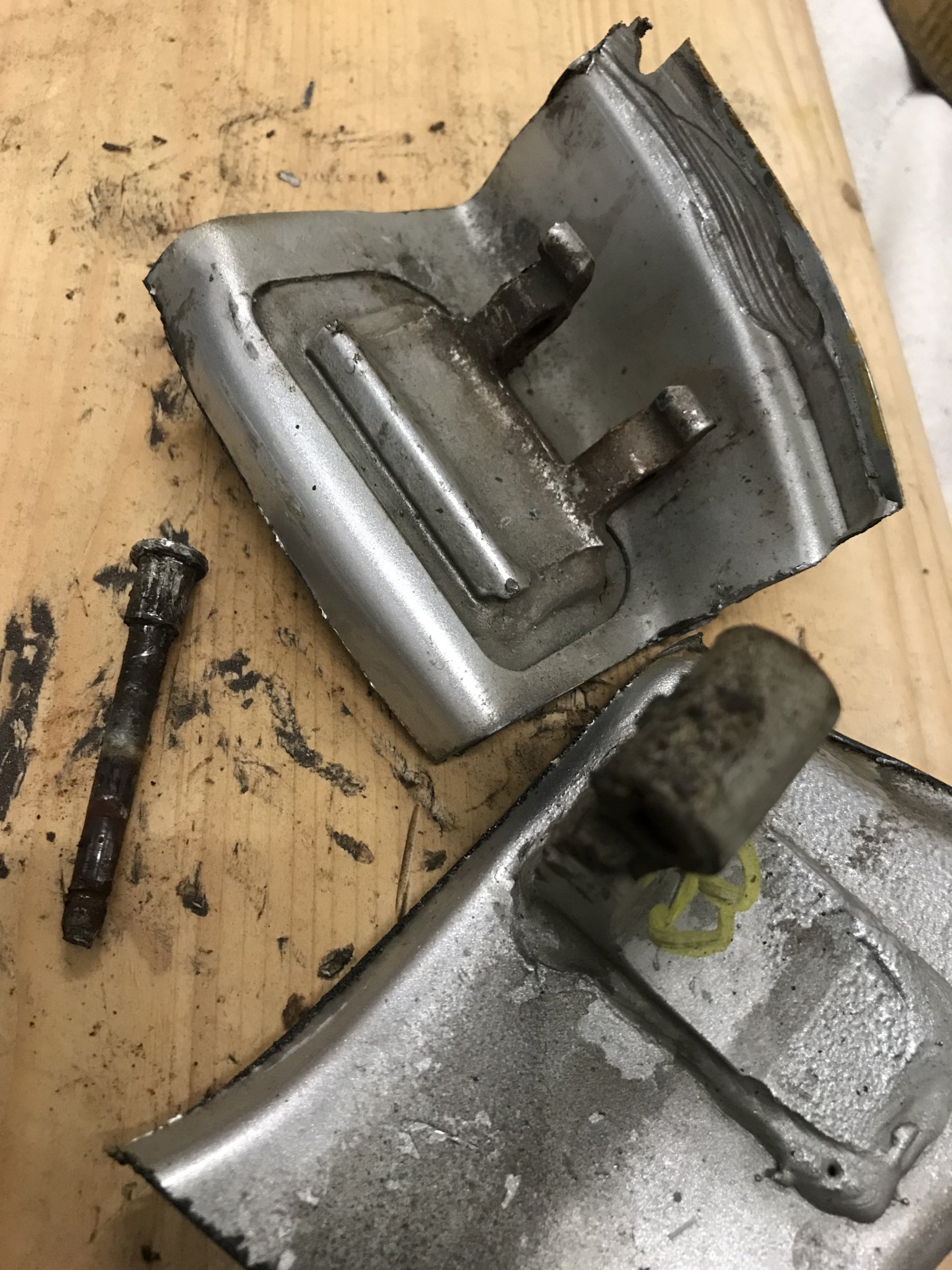

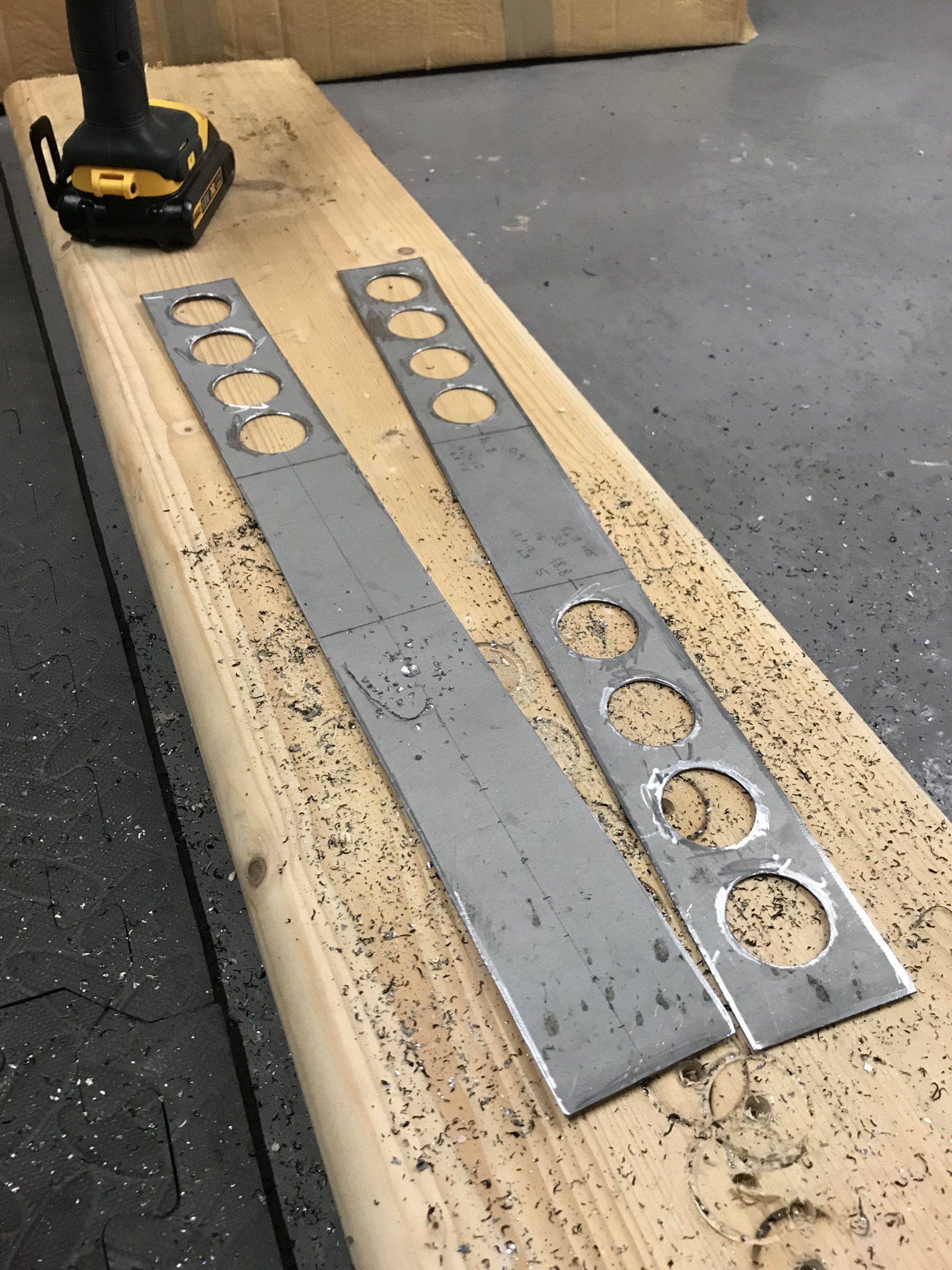

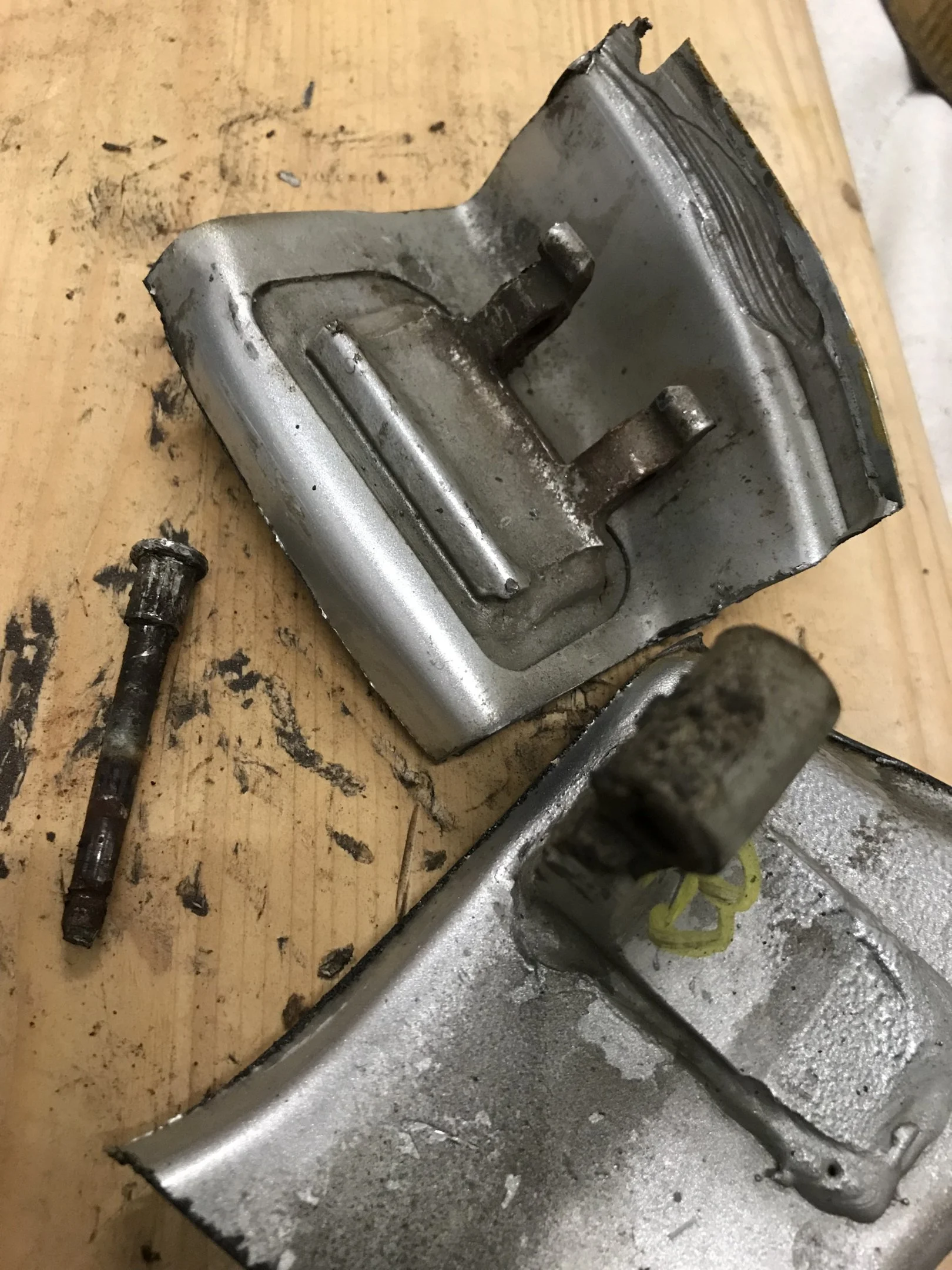

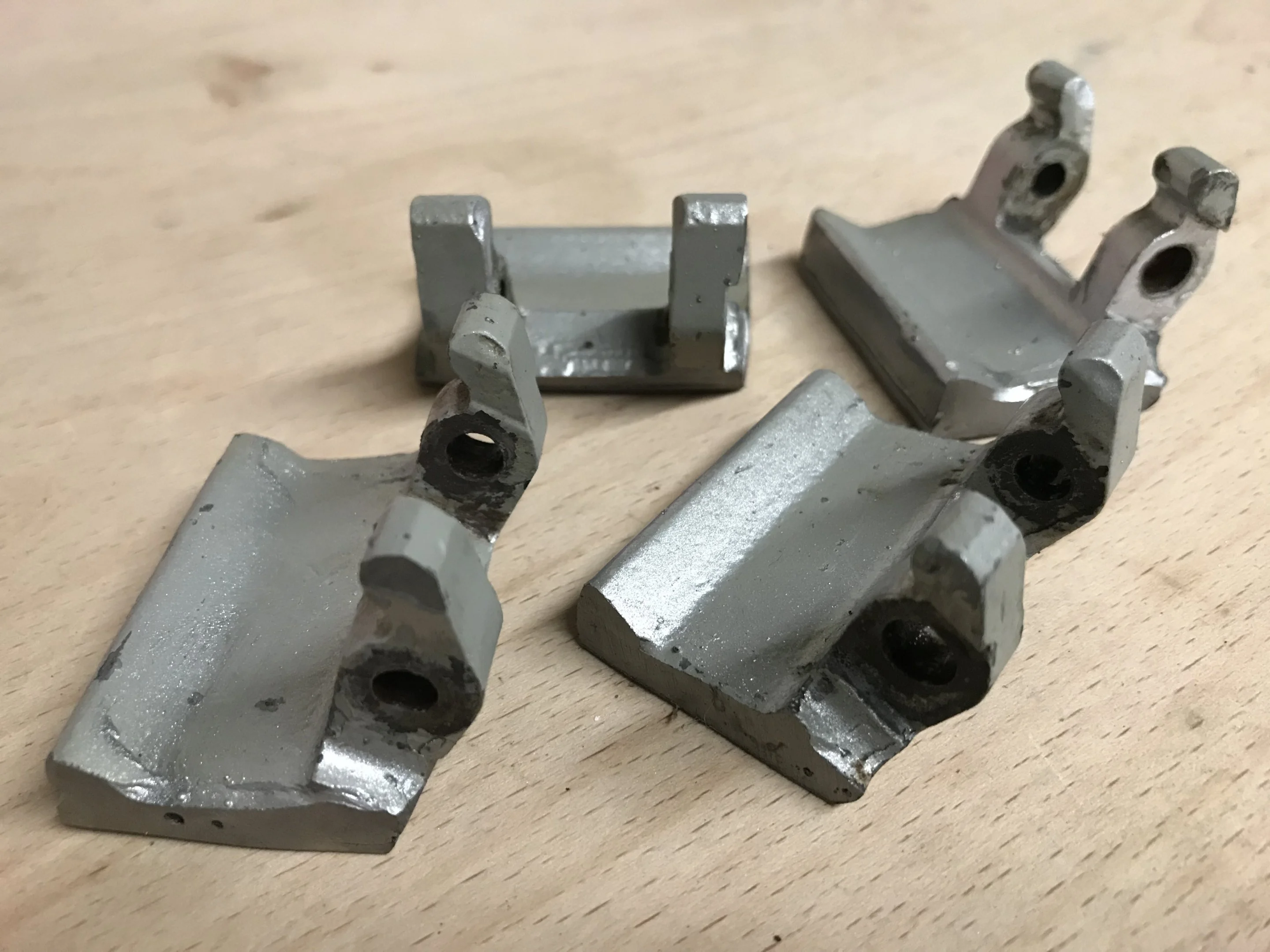

Next up was to sort the hinges so I can hang the doors. There are 2 options here, either cut the hinges off your old doors or buy a new set from renault. I sold my old doors and it was very much looking like I would need to purchase new until the last minute when I managed to pick up some cut-off items, perfect. I received them today so with an evening free (originally planned to be spent at the bodyshop) I set about trimming these back to just the hinges.
and done.... These will need a piece of threaded bar wedding to them to then mate with a spreader plate and some nuts (to sandwhich the door), pretty please with how they come out.

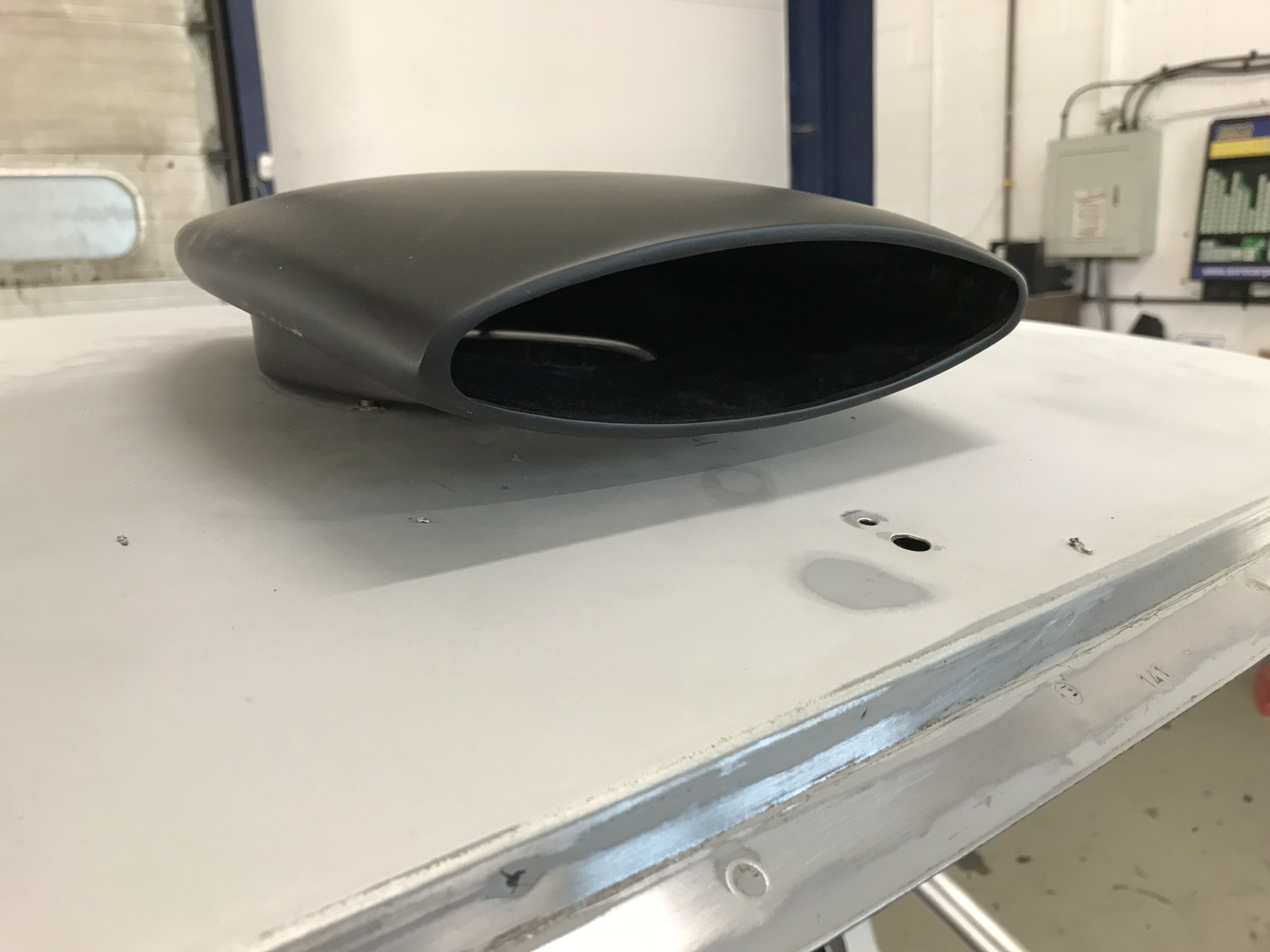

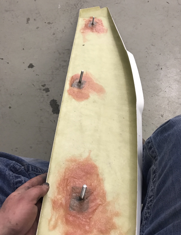

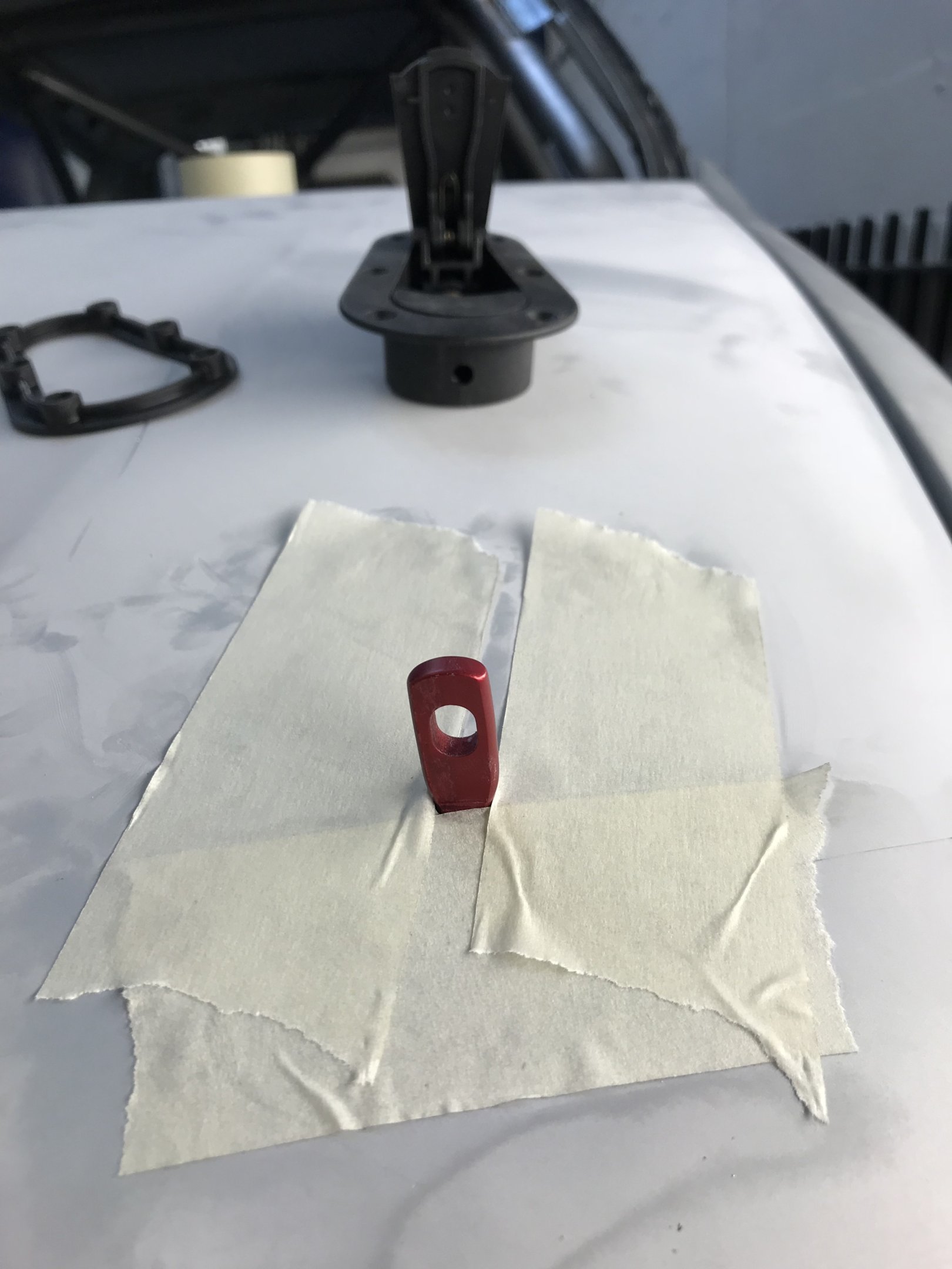

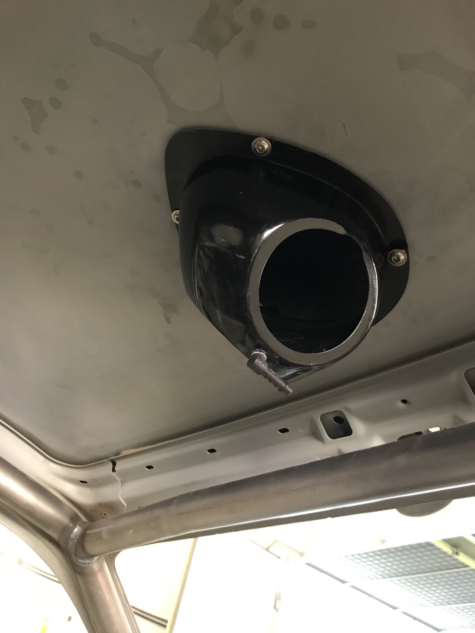

Roof scoop hole cut and roof scoop test mounted, I initially went for the multi-hole approach but the hole-saw was a bit s**t got a wriggle on and made a mess so I opened it up to one large hole, no bother. (the aerial hole has now also been welded)

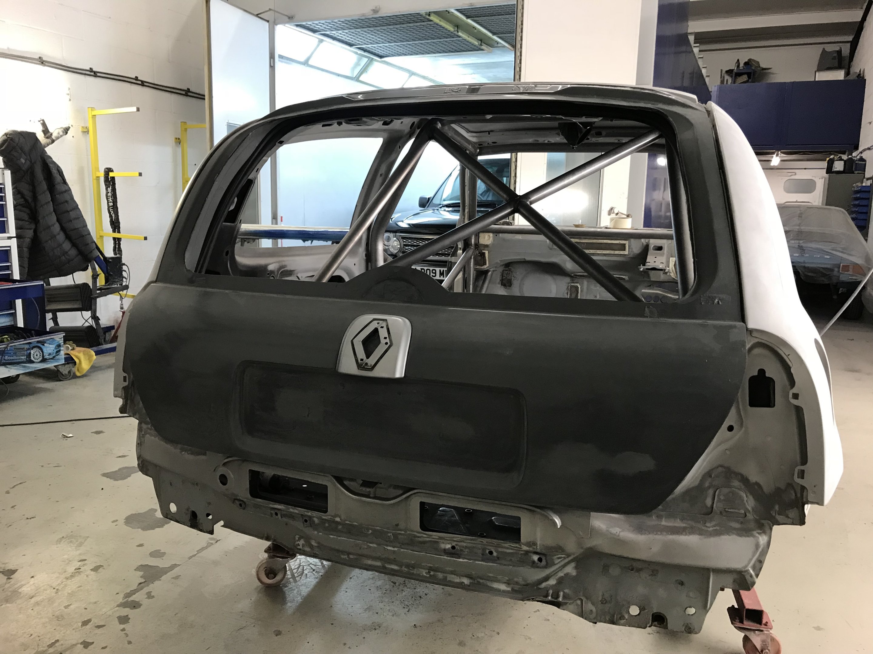

Next up was the tailgate, this needed the holes for the hinges trimming out to hang it, only once this was done could I then look at marking up and trimming the panels for the aero-catches. All went well, I had to open up the back part of the panel a little more but again, no bother. (no pictures of the finished article as was either to late or I had to get a wriggle on to sort the next panel)

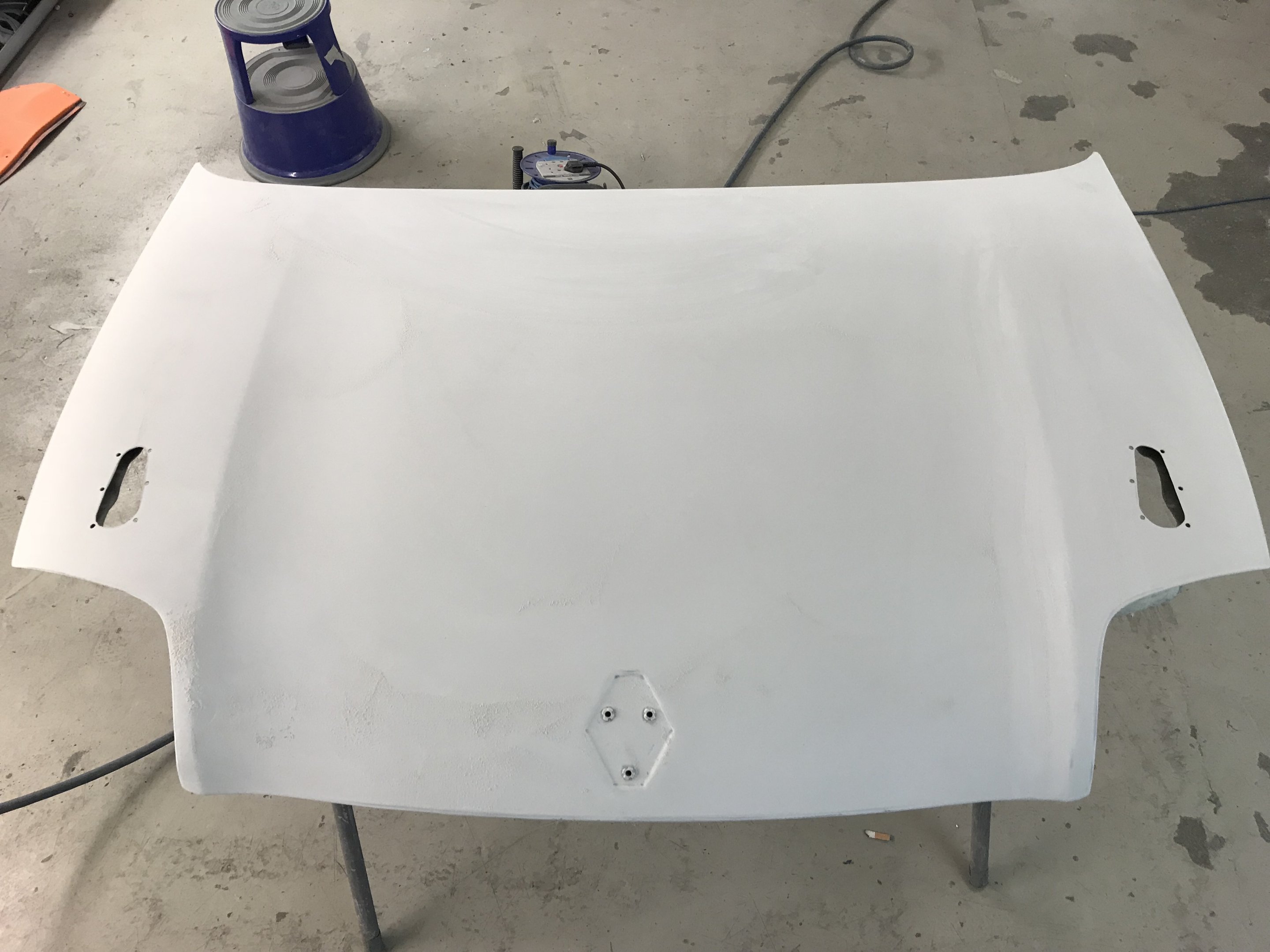

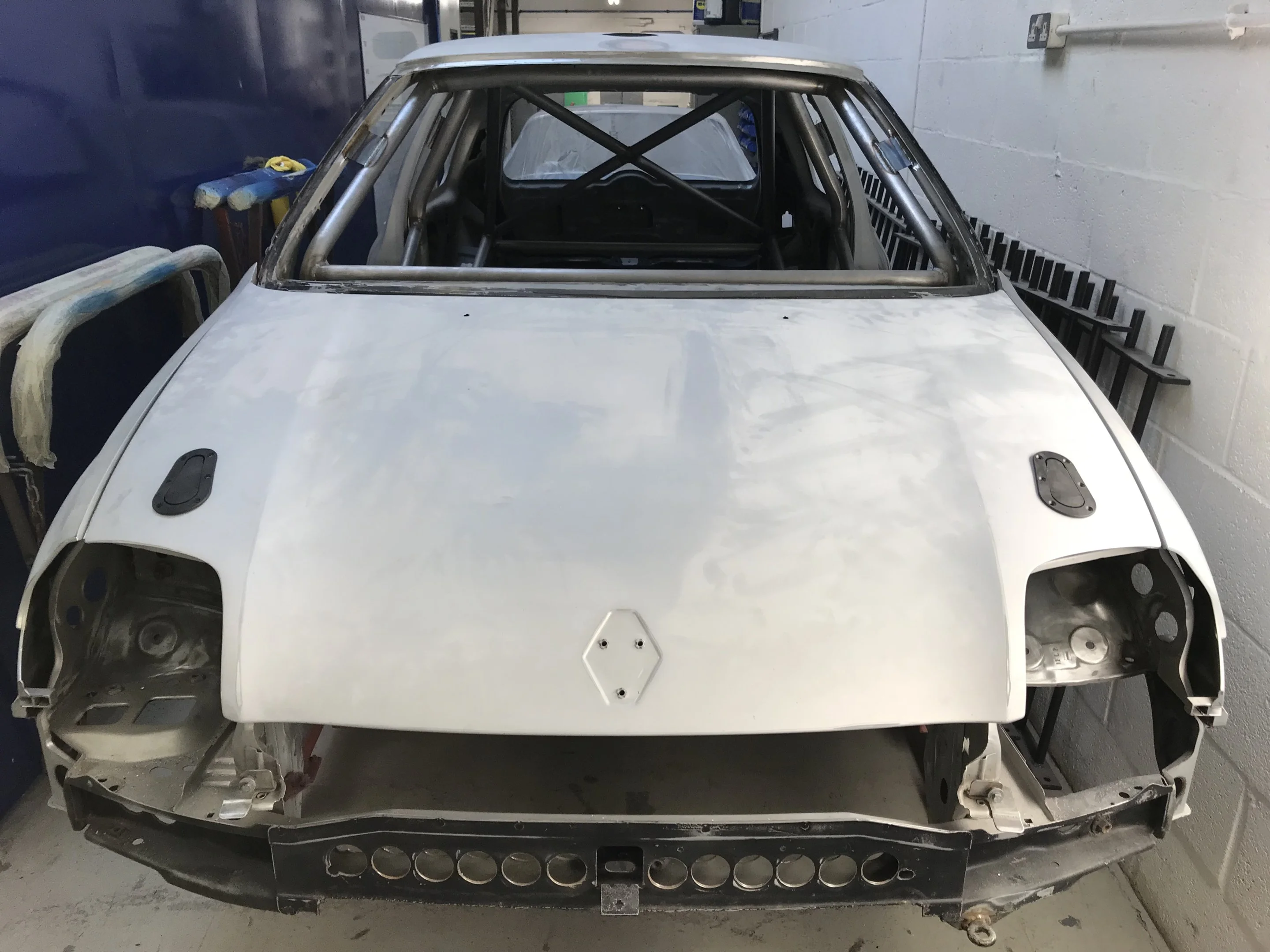

I then moved onto the bonnet, lining up the bonnet, mounting it and marking the aero-catches for cutting. Using the bodyshop tools was super helpful and made the job very easy. The top holes are easy, but with the shape of the second skin on the underside you have to do a little more work than the top (to allow for the aero-catch sandwich back plate), again no real bother though....
and then with the windscreen washers welded over, (by the bodyshop)

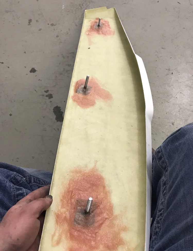

The bodyshop also cut (holes in the tailgate) and bonded threaded items onto the underside of the CM composites spoiler ready for mounting once painted.

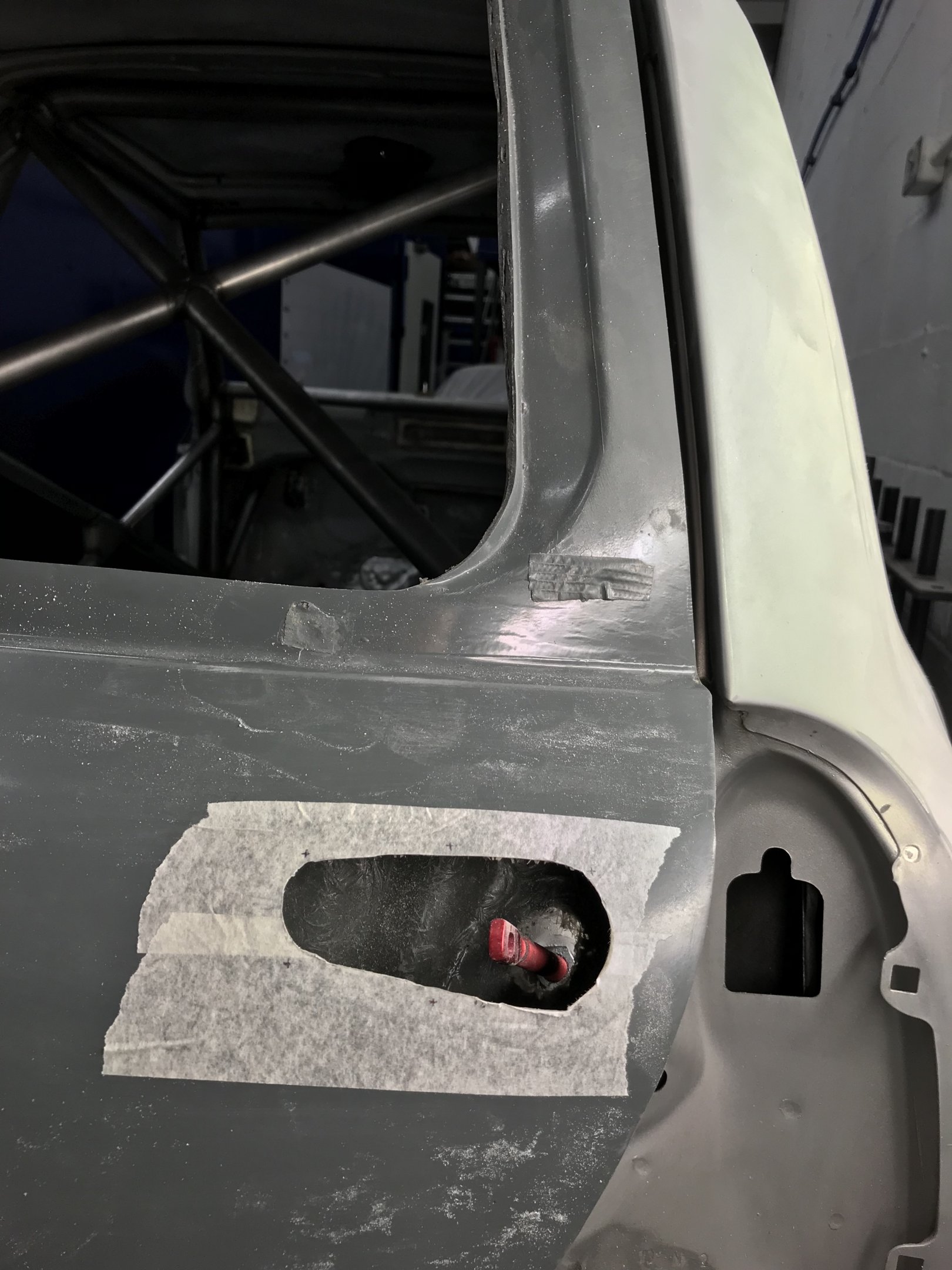

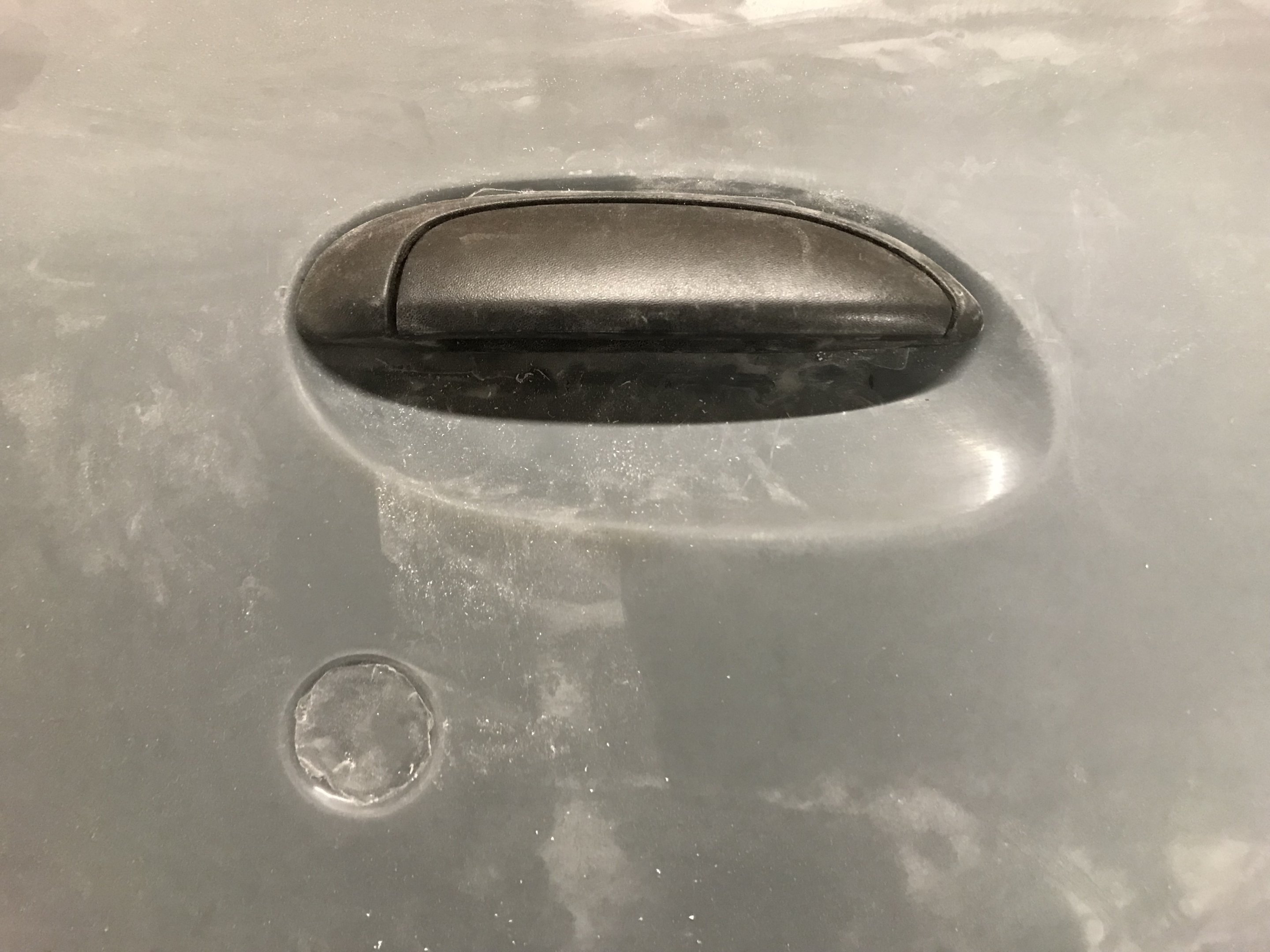

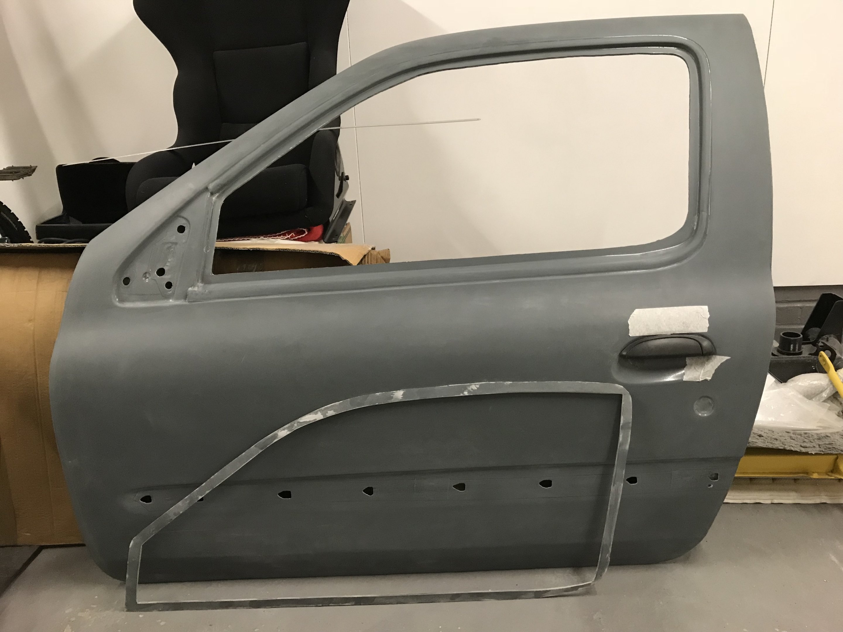

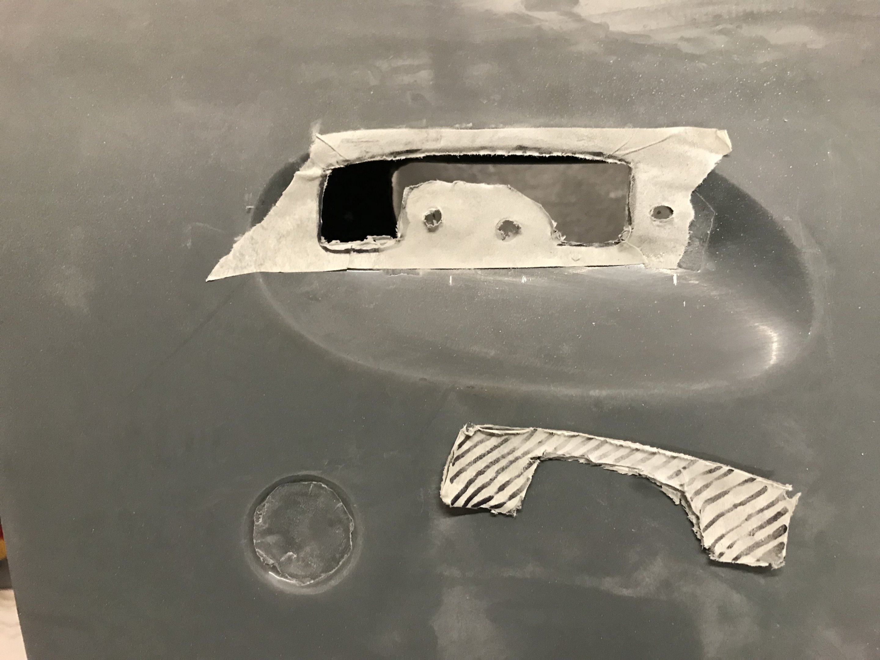

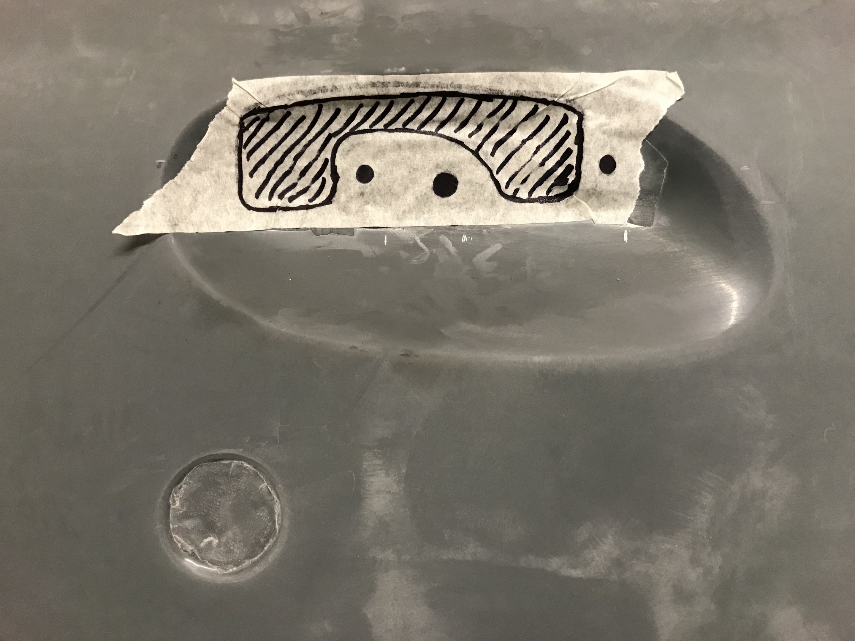

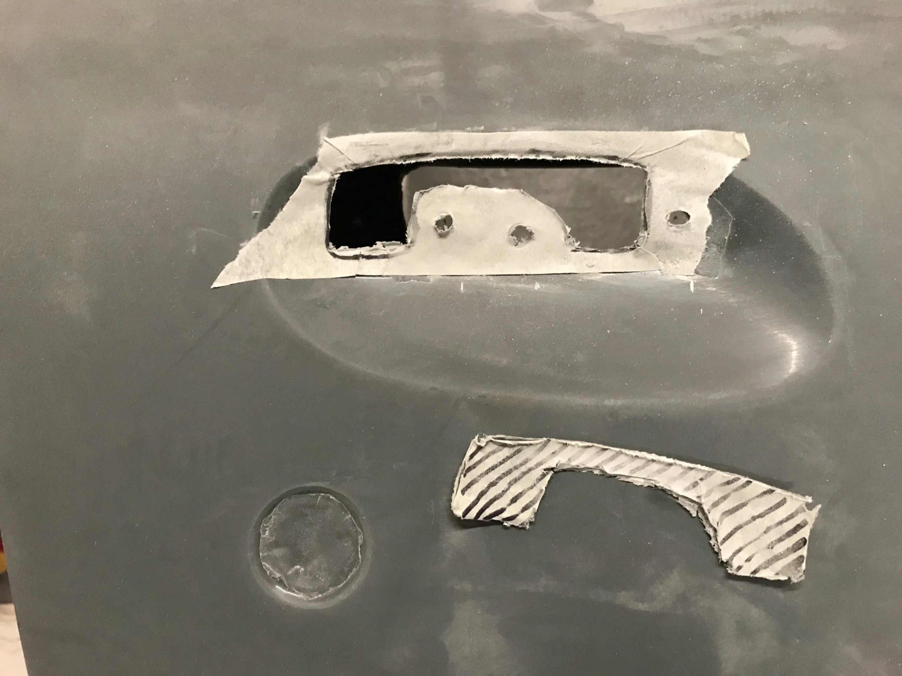

Next up for me was the doors, I new these were going to take some time so struggled to fit them in. Getting all the parts of them marked, trimmed or cut back went on and on and they were literally the last thing to be painted, but again... all done.
The main area I was concerned about was the handle cutout, its pretty fiddly but having done the first ok the second went a lot smoother...
Marked up
Cut back
Test fitted
I was on a little bit of a confidence streak which was good as the next part was the window aperture trimming. I really felt there was way to much excess in here, I marked up how much I wanted left and trimmed both doors back to 15mm. This should be sufficient to bond the windows to. By doing this it did separate the panels in some areas but this was addressed with Sikaflex and a load of clamps. Had I known the panels would separate I think next time I would probably not of cut the windows back and then mounted them inside but these doors are moulded with the rubbers in them too, so not sure it would of worked.... either way, guess what - no bother, done now.
Note: the doors are going to have the lock recesses skimmed over before paint.

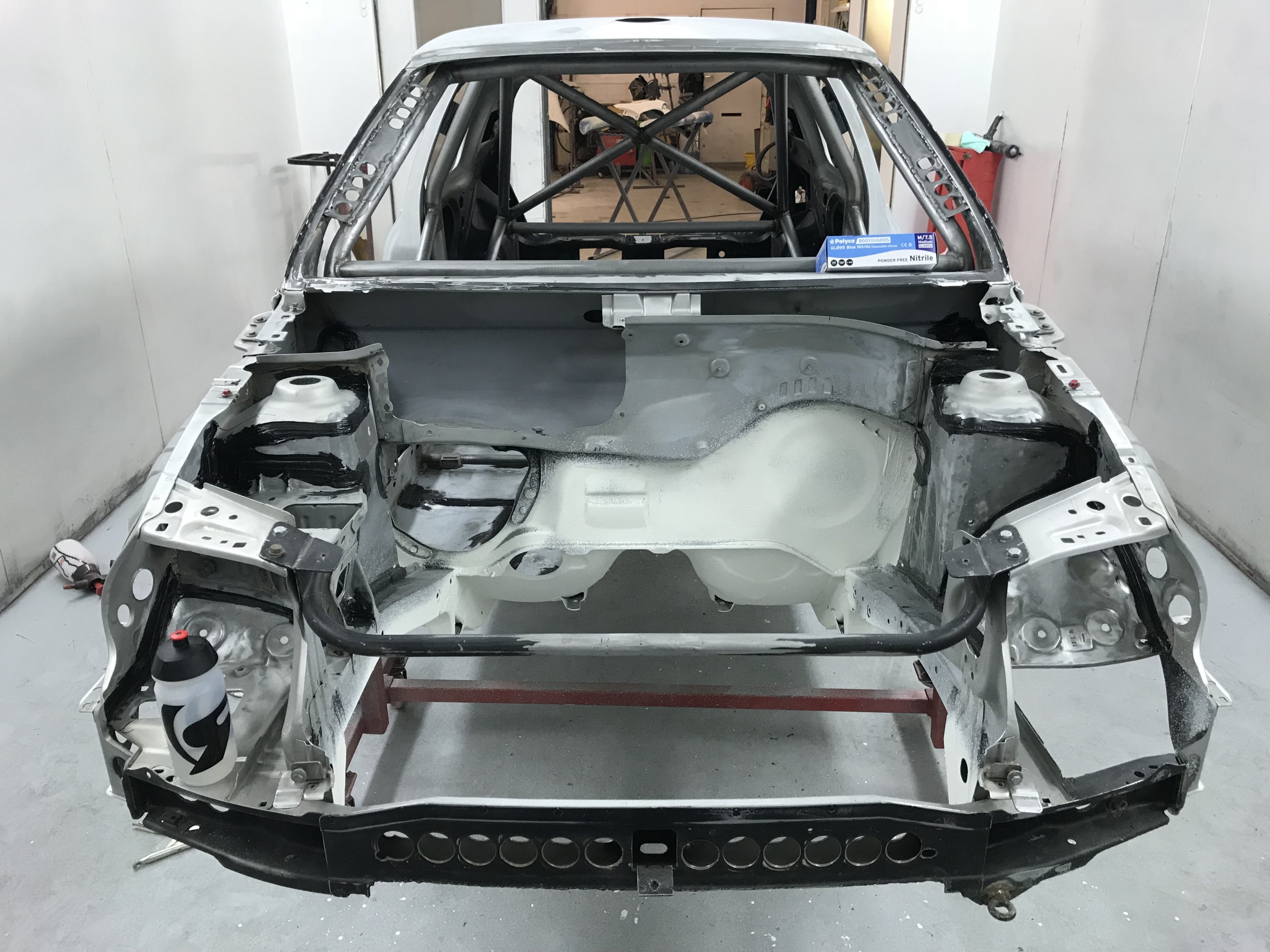

Whilst I was piss-ass-ing about with the doors this the bodyshop was finalising prep of the shell for paint. There was a fair bit of work in this, more than the points previously noted (Rust areas on sills and rear arches, Seal all underside and arches, Seal engine bay) but they cracked on and have really done a nice job. Along with this the eagle eyed may have spotted in my previous post the tabs on the cages A and B pillars. I wasn't 100% sure I was happy with how these appeared and the following day I mocked up some gussets that would sit over these. The swaging tools made for me by a mate very early in this project came in super useful again. These were made, dropped off asap and then welded in.
When dropping these off we discussed what I wanted to do with regards to seam sealer and the underside of the car. The painter said it was not the most sensible to leave the seams unsealed as water ingress here would just rot it from the inside out. With strict instructions to keep it light this was applied to promote the longevity of the shell. Also I decided to go for stone chip on the underside of the shell, again this should promote the longevity of the shell.
I visited the following day to a shell in the booth and ready to paint. All holes in the shell welded or sealed, the underside stone chipped and the A pillars gusseted I was very happy with the progress I was now very excited to see it with colour on.
This brings me not far away from the present day (and another 10 photo's posted).
The car has now been fully painted, inside, outside, underside.... The bill for this was quite significant in the end, pretty much double the initial quote (although this was given without seeing the shell). I felt a bit uncomfortable about this, but I know that it needed it and there was a lot of work in it. As mentioned this should preserve the shell significantly and with this staying in my ownership I can only see that as a good investment.
