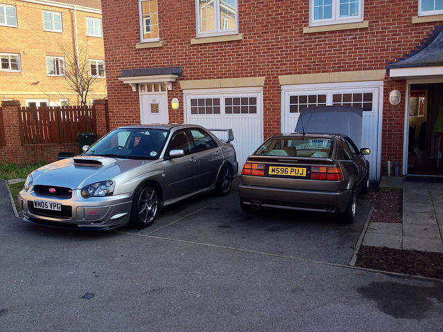

Mates impreza parked next to my corrado;
Rado & scoob by cobzy1, on Flickr
Thankfully after a lot of back and forth it has been repaired properly so good as new, just can't wait to drive it again as the TTS courtesy is dull as dishwater.
