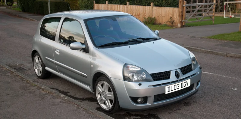

The day I brought her home. After nearly a year of not having a car I was ecstatic!
Bough from eBay (after checking it out) for the bargain price of £1200 she came totally standard with a rusty exhaust, no MOT or service history!
It ran incredibly well, and I wasn't put off by no service history because I had most eventualities covered. Interior is perfect bar a couple of slightly rough thumb grips. Outside slightly worse for ware with stone chips and marks, but for a 10 year old car I wasn't too fussed.

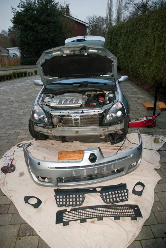

Next was some servicing of my own... Checked everything out and also sprayed the top grill, fog surround and badges in satin black. Also chucked on a Skoda splitter.

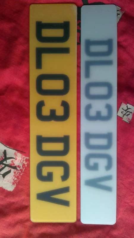

Still being broke and not having money to do 'real mods' I got some illegal plates...

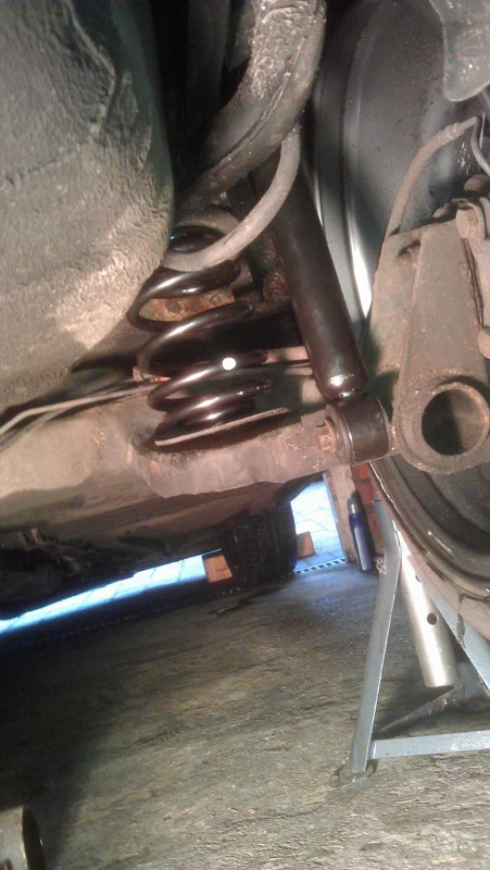

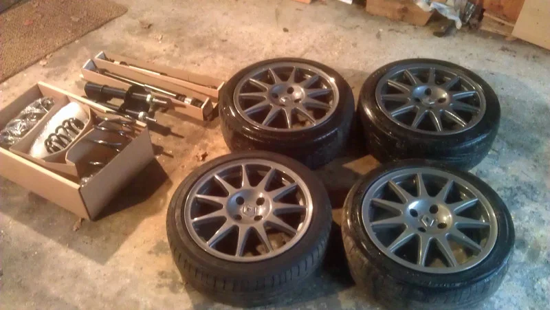

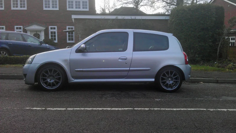

Cooksport springs, OEM dampers, and genuine Trophy wheels with centercaps and tyres.
They were fitted soon after.
And they look the business. This is before they settled so they are a tad lower now but they sit bang on. Love the look and love the feel on the road.

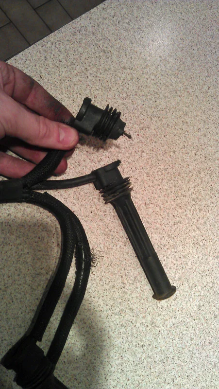

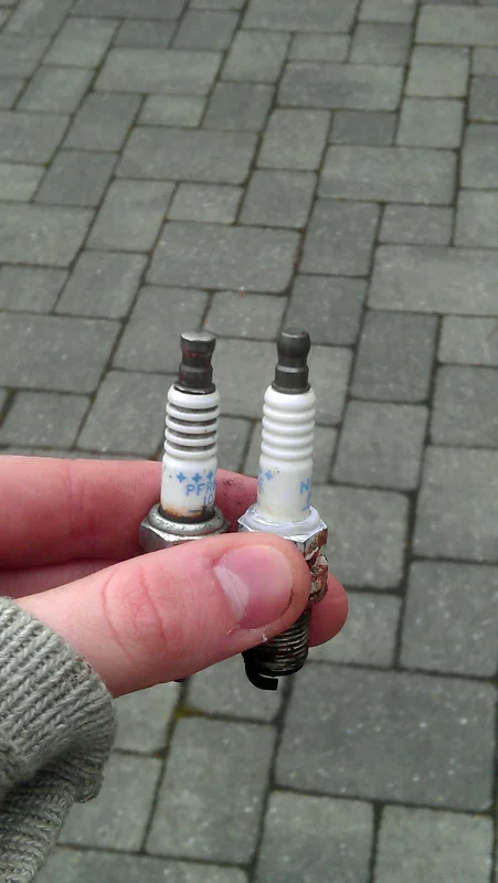

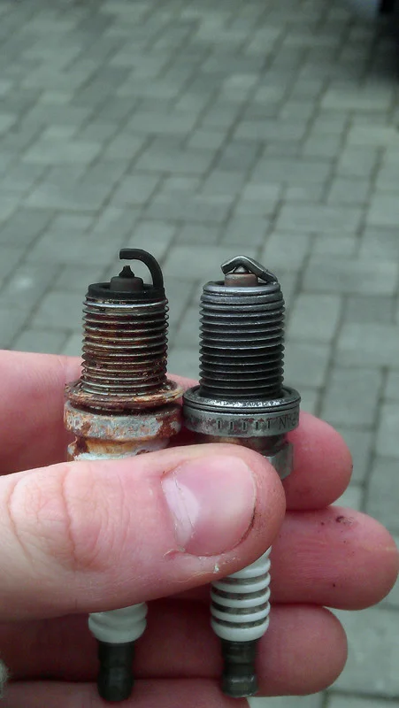

It threw a plug about 4 weeks ago. The damage to the offending articles speaks for itself, only the inlet stopped the plug going through the bonnet.
It ate an HT Lead...
... and jackhammered the plug. This is compare to an old plug I had hanging around.
Compression test = OK
Endoscope = OK
New HT leads, New coil pack, new spark plug, and Voila! Right as rain.

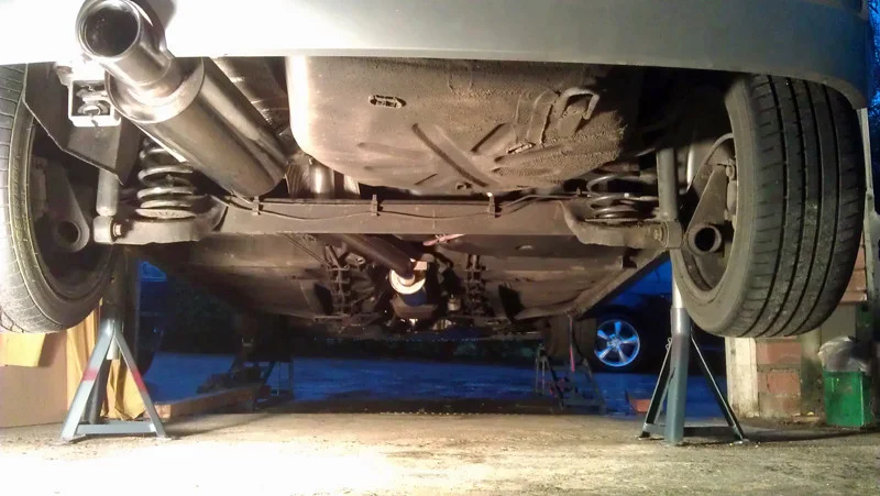

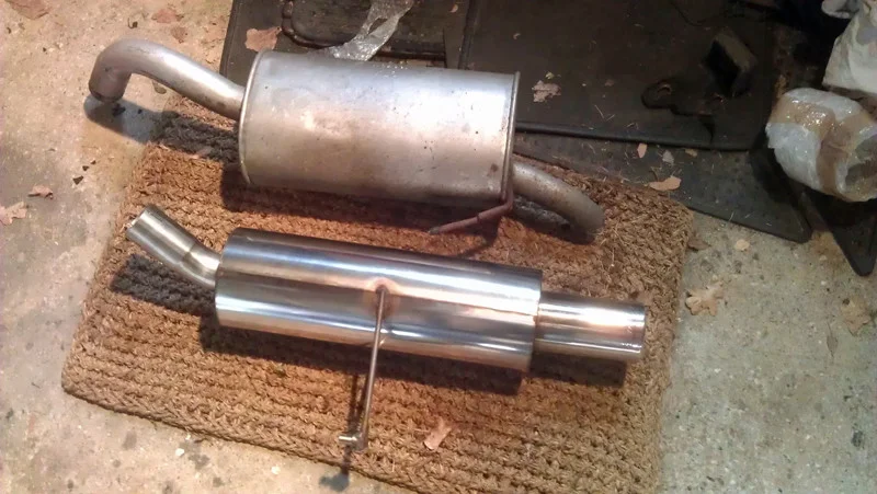

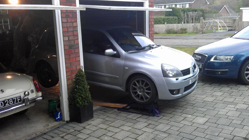

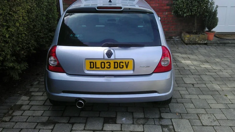

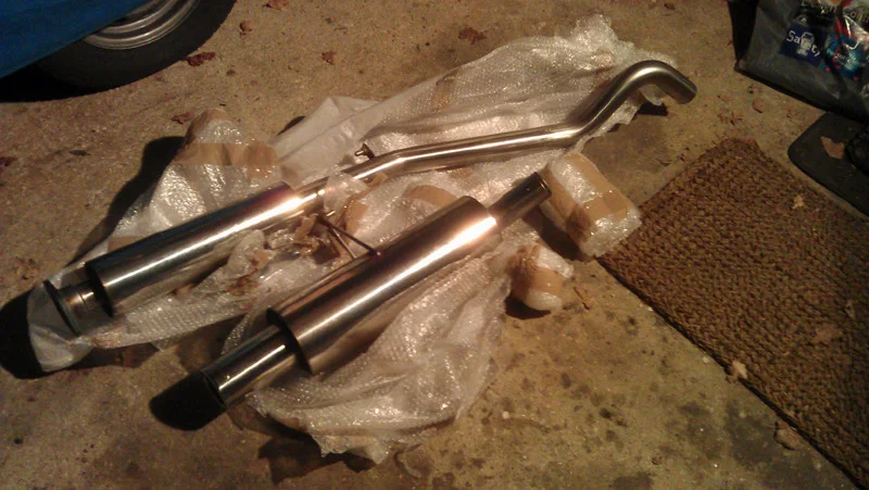

A few weeks prior to the above incident, I decided it were high time to do something about the eBay back box and rotting centre pipe which at this point sounded like I was dragging a bag of nails behind me. A gorgeous Piper Exhaust with 3.5" tailpipe was on my doorstep 4 days later. I was sat with this in the garage for a month before finally getting to fit it.

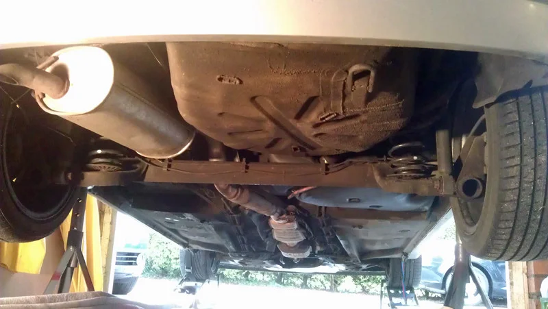

Get her in the air!
Before.
Old Vs. New
Fitting the new pipe was an absolute doddle. New mid and rear hangers, a gasket and some high temp silicone and she was done. For anyone thinking about going for a recessed exhaust, definitely take off the rear bumper and get the zaust sitting BANG ON before you think about making a mark for a cut. I have no doubt it will save you much heartache when your bumper doesn't fit on the gap where you pipe exits.

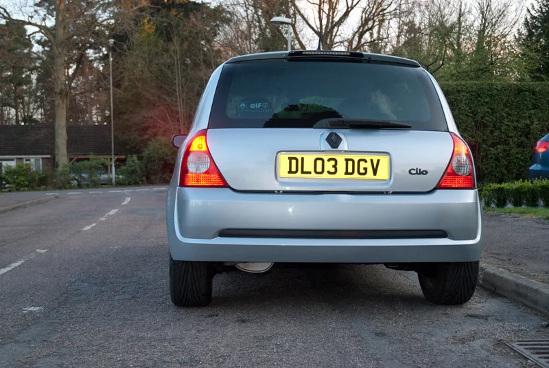

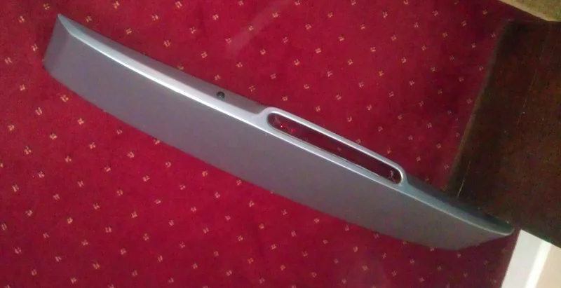

Then I grabbed a cup spoiler just for the final touch.
This is the car as of this morning.

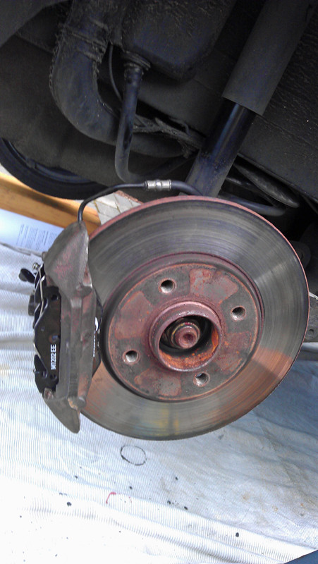

Another pressing issue which I will be all over next payday is the brakes. With no service history the only thing I new about them was that the rear discs were changed for the MOT when I bought it.
At present, the rear o/s caliper is totally seized. So that will need replacing, along with new rear pads all round. I figure at the same time I will get a hold of some Goodridge braided hosing, DS2500 front pads, Brembo front disc and a total flush of the brake fluid.

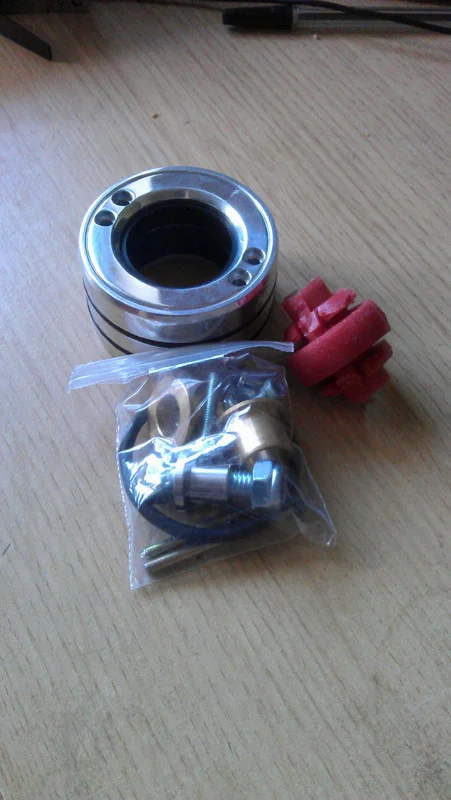

  3. Fit Yanoo's Stiff shift kit

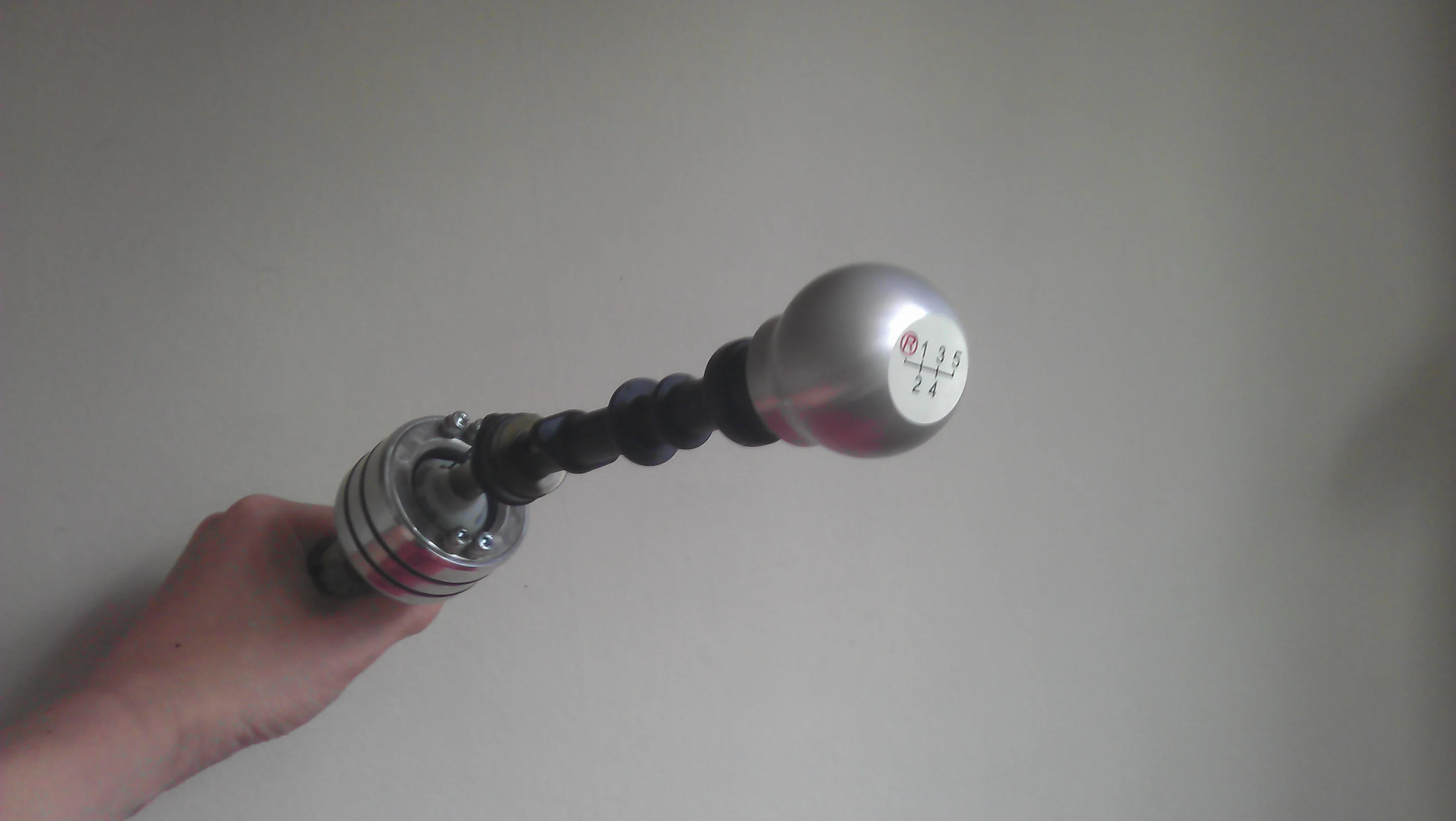

The Yanoo Stiff Shift Kit
Can't wait to get it fitted, but pussied out doing it yesterday because my engine mounts are desperate for replacement and I don't need a shagged gearbox as well.

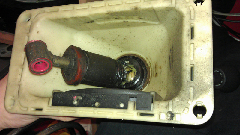

So I bought a cheap gear lever off eBay to fit my Yanoo kit into before removing the old one. Described as 'A+' and it looks like this on the underside...
I won't add who it was, at least until they have had the allotted time to fix the issue. What I will say is that, to my knowledge, they don't trade on this forum.

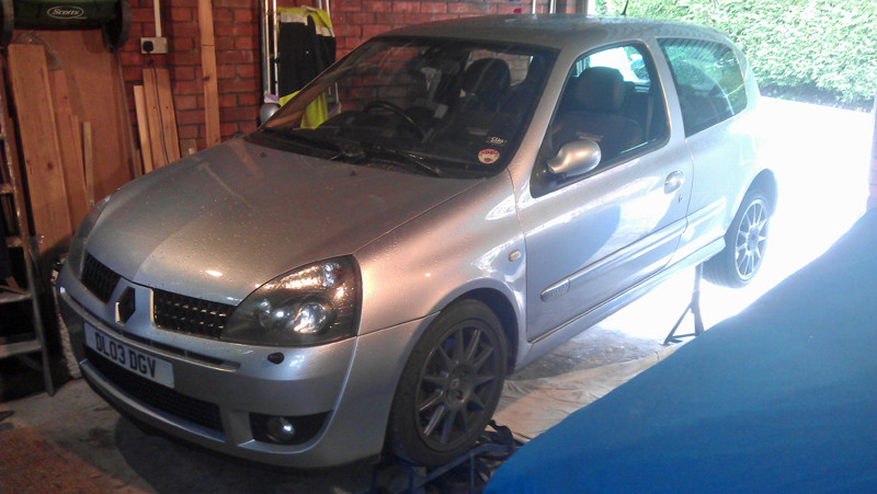

So back in the air...

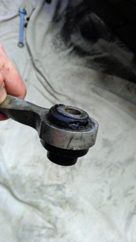

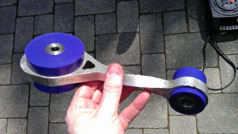

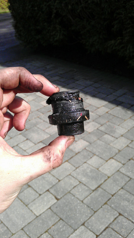

Out with the Dogbone, and my god it was bad. When Dan said it was bad, I had my suspicions, the gear change had never been great and the pick up always seemed a little slow compared to other 172s I've been in.
Wasn't actually much left on the small end.
MMM Poly...
Next up was the pesky seized rear caliper.
No pictures, but I grabbed one from Renparts and they came through again. So on it went with the new pads.

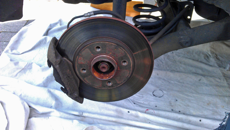

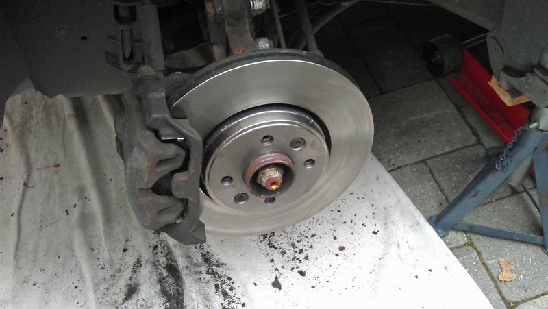

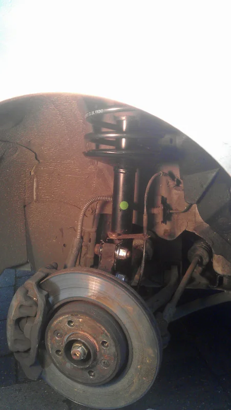

Then the fronts. My god the fronts.
I took off the front offside and the caliper and both the carriers were completely seized. So I ripped 'em open in the vice, wire-wooled the rust and grime away and filled them with some silicon grease. Smoothest. Carriers. Ever. I doubt they came out the factory that smooth.
I also dropped one of the carriers at some point and spent nearly 2 hours looking for it, whilst swearing profusely.

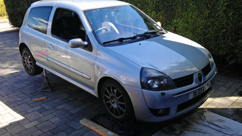

New discs went on and when I was done it looked a little something like this.
I've still not fitted the brake lines. The rear lines were so stiff I didn't know how to begin taking them out, not really sure what I expected. The fronts, well, it turns out the caliper on the off side front doesn't have a bleed nipple as some genius sheered it off - guilty as charged. So I bled the rears with boggo DOT4 from the local auto factors and I'll be looking at aquiring the services of someone with a workshop for the lines and the removal of a sheared bleed nipple - any takers?!

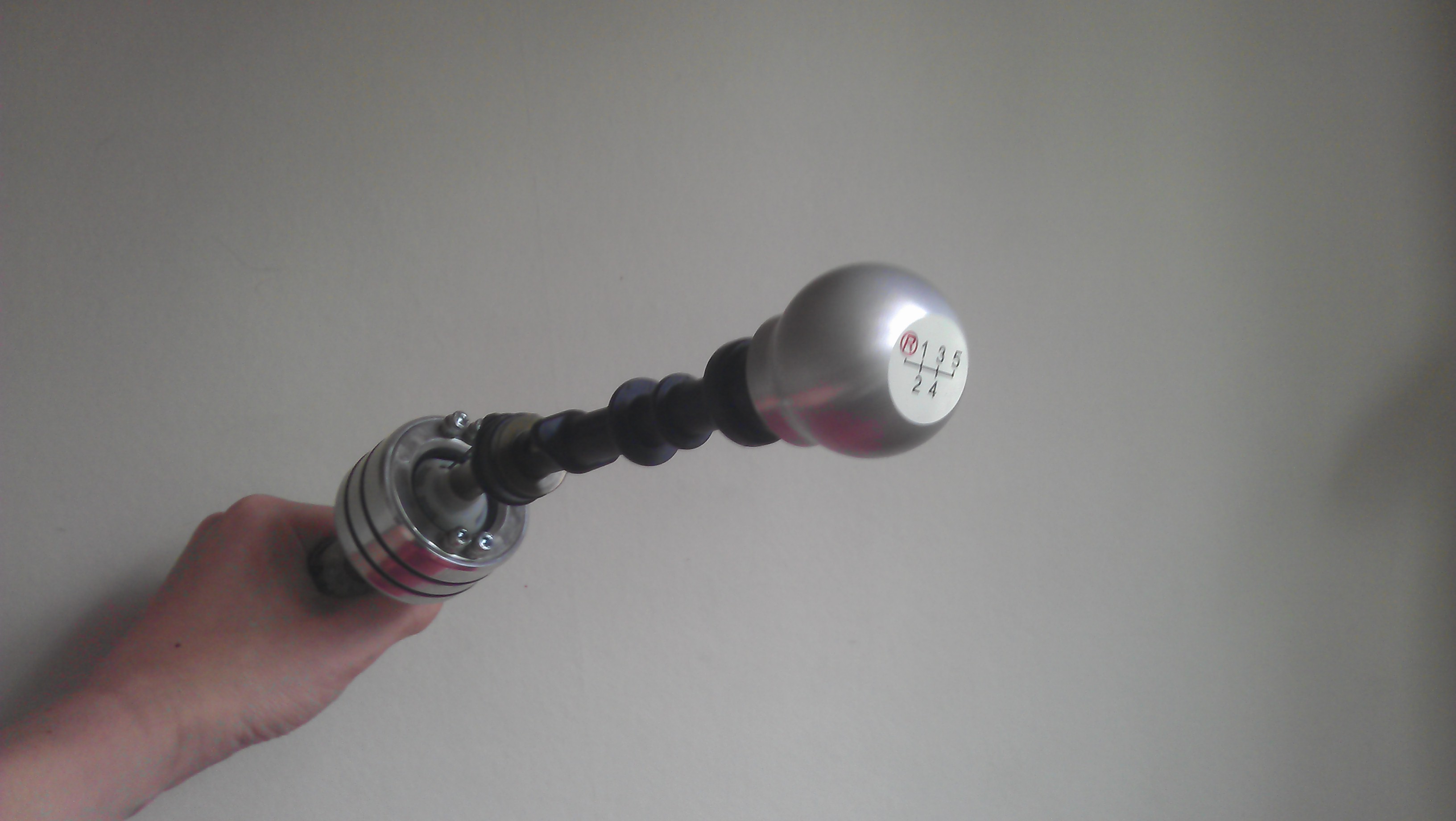

I did make an attempt to fit the stiff shift. However, after chewing up 3 torx bits (all made of swiss cheese) just trying to remove some of the heat shielding, I gave up and I'll have to find someone with either an impact driver and some strong torx bits and a ramp to get the job done properly.
The brakes are awesome. Both in braking and in not being stuck on all the time.

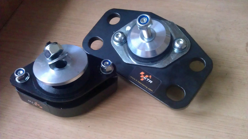

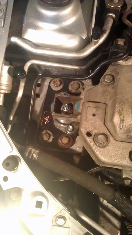

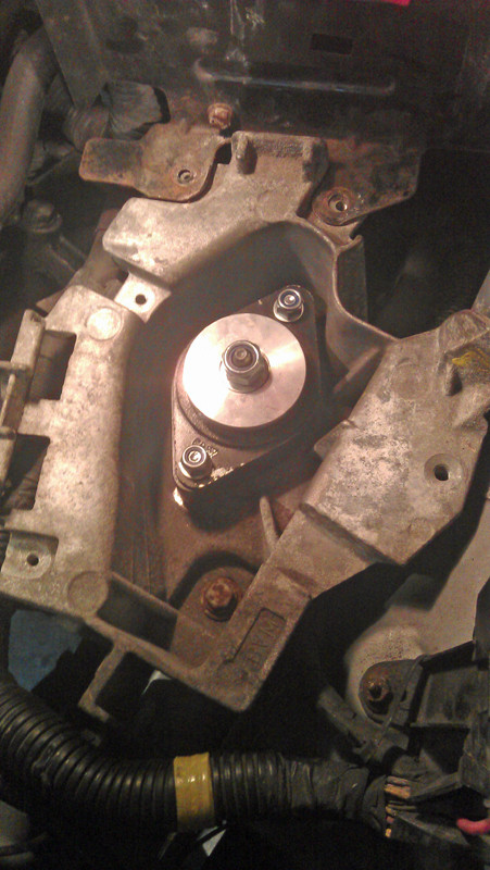

Next job is upper engine mounts. I think having put the dogbone in has revealed just how bad the uppers are...
debussetti
Mounts and Yanoo's shifter went in!

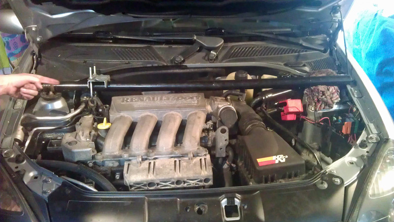

Assume the position!

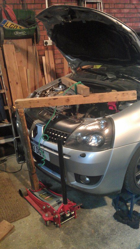

Don't have a crane and didn't dare supportthe engine buy it's sump, time for some leverage!
In with the new mount.
Now for the otherside, and a new support, wound up by a couple of nuts on a random exhaust clamp that was lying around, hanging off the lever for the jack.

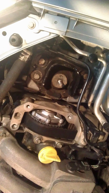

Off with the cover, reassuring to see cam belt in good condition.
And in with the new mount.

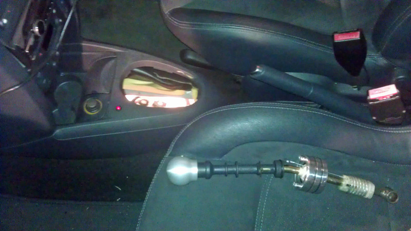

Dropped the old shifter out...
...and in with the new!
What a difference! I'm really not noticing the increased vibration a lot of people talk about, but accelerating feels so much more immediate.
Really happy with Yanoo's Shifter as well, makes the whole shift feel much more deliberate and feels great! Yanoo's instructions are incredible as well, everything went better than expected.

Supporting by the sump is fine. Just have a piece of wood between the jack and the sump. Like the make shift crane though!
