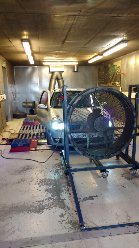

Today was the day with the South Central group, we headed over to Surrey Rolling Road for some Dyno fun.
I'm a little heartbroken, but optimistic...
All clean and ready to roll

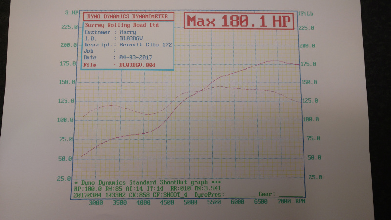

Here was my graph...

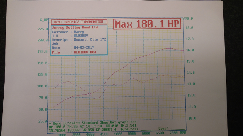

And here was the issue...
Dan said it would likely need a second visit to get the map finalised, so now booked in to see him on the 13th and clean up that top end!

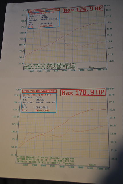

This was my car Before (Top) and After (bottom) of having SJM's Cam package installed. The AFR you see on the bottom we eventually found out (and also Dan backed this up) was due to it being mapped on a faulty O2 sensor. Dan took it back immediately and spent A LOT of time road tuning it and couldn't find any faults at all. His equipment was showing it to be absolutely safe. Too back that up i then spent the best part of 6 Months driving it around without any issues what so ever.
Sadly my engine had slowly started to destroy itself until it started drinking oil.
