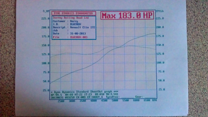

For an engine performing that well, i'd be scared to spend any big money for being very disappointed with the gains!

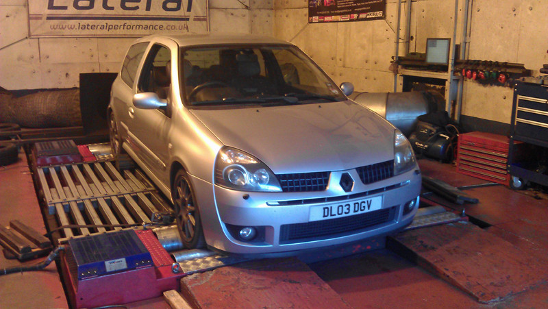

An update, with pictures and whatnot. Nothing very exciting though...
On the rollers

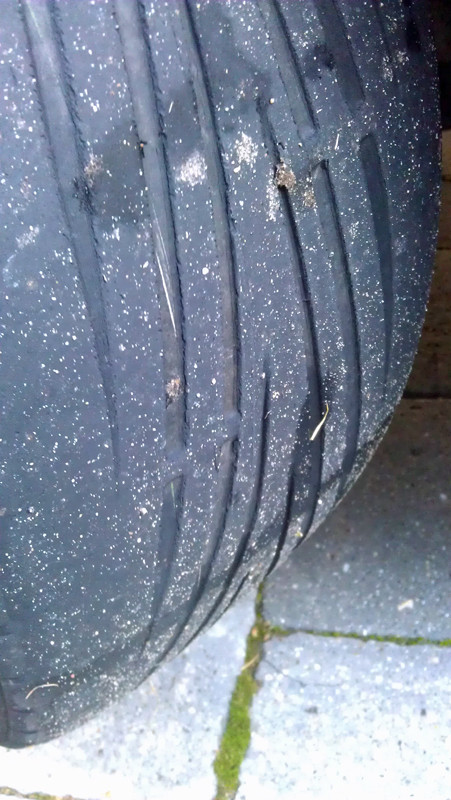

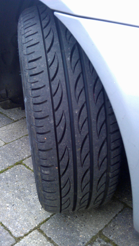

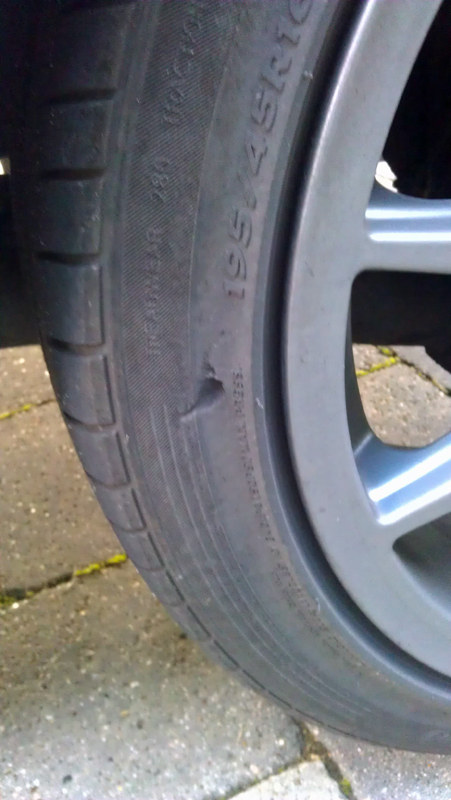

My scarcely legal front tyre... and rear with a chunk missing.

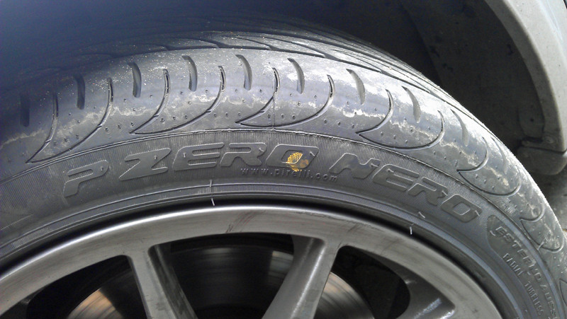

Took a punt on some Pirelli P Zero Nero XLs
Not sold on these yet, the difference in road noise is incredible, they are whisper quiet. The grip in the dry seems good but not pushed them at all. Not sure if it's me, but seems like the sidewalls aren't as stiff as I'd like.

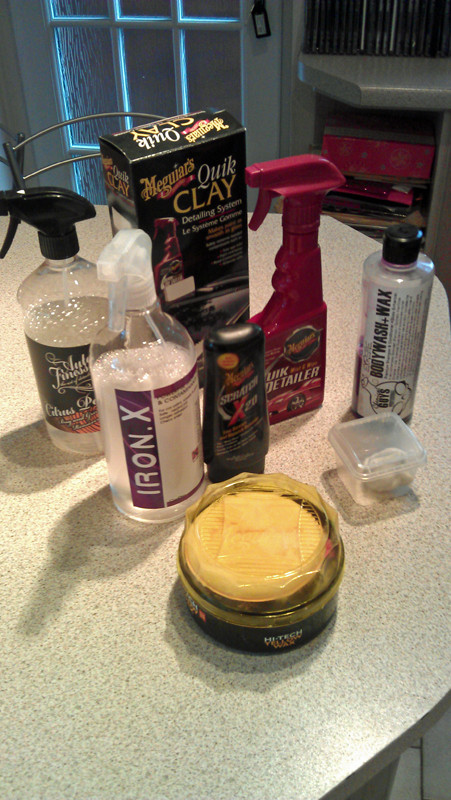

New friends while the Iron X does it's thing.

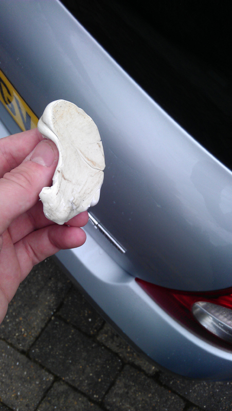

A quick clay, followed by some wax (too boring to photograph)

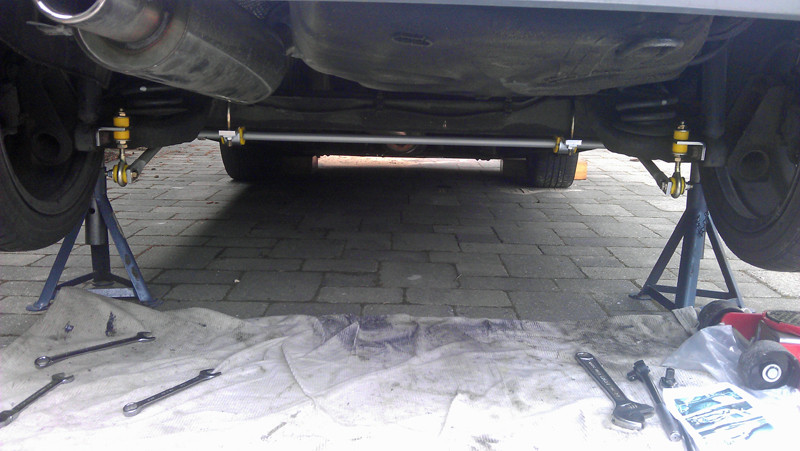

  1. Poly Bushes on the front end - maybe even the rear with the new Powerflex kit

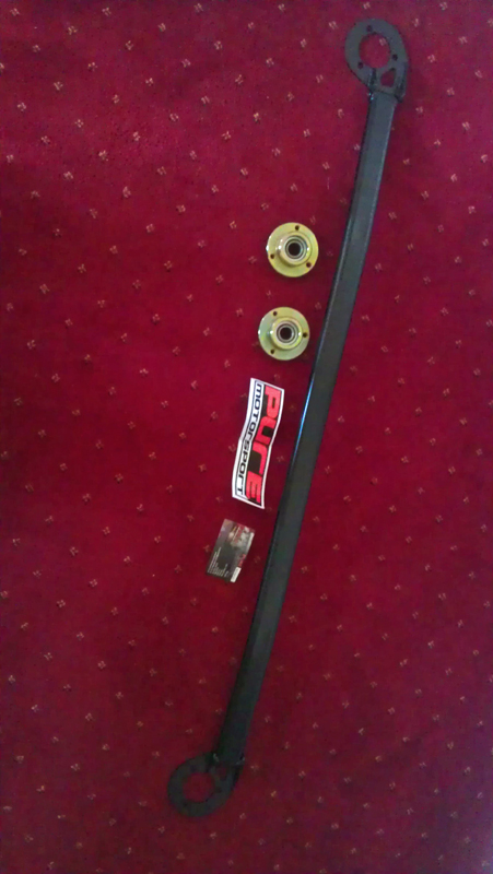

  2. Pure Motorsports top mount and strut brace / Maybe AST

5 and 6 likely to change, given my rolling road results I don't want to spend money on an engine which seems happy at the moment.

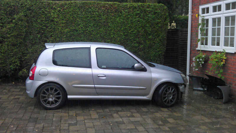

So I have much unused holiday at work and rather than letting it go to waste I took a week off to doll the car up a bit.
Day one was not a good start, it starting pissing it down as soon as I had the front bumper off. Note to self, always check the weather before working on the drive...

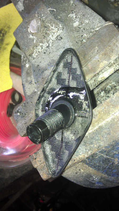

Moved the car into the garage and ripped out the front washer jets and pipework. Nothing interesting about that so step 1 was to modify the jets to become some shiny carbon blanks.

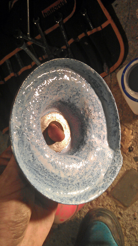

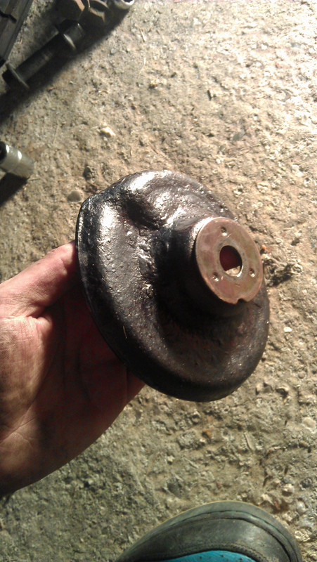

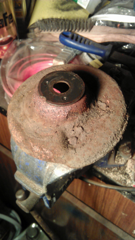

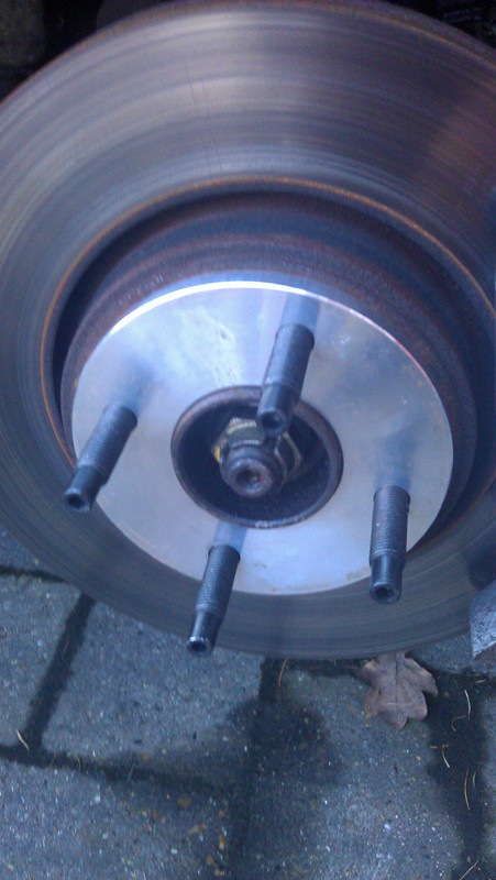

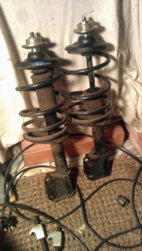

I whipped out the struts and set about cleaning the tops up with a wire wool drill bit and some H80.
As luck would have it, this little beauty turned up and was promptly fitted.

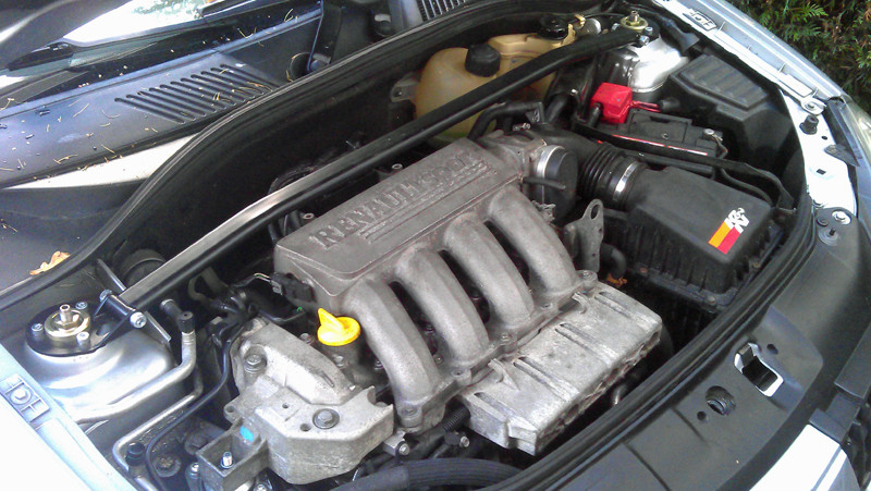

A quick snap from this morning of engine bay with the PMS Top Mount & Strut brace kit. After driving this for a week, I have to say WOW, what a difference?! Even with the front end rapidly approaching 100k miles, the whole car feels so much tighter and twinned with the Whiteline ARB, the car has great turn in and neutral cornering ability! Plenty of new bits to add to this and bring everything back to the start.

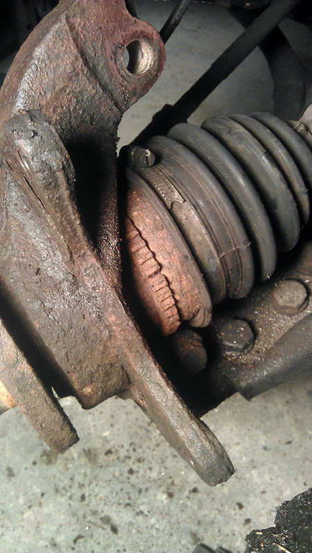

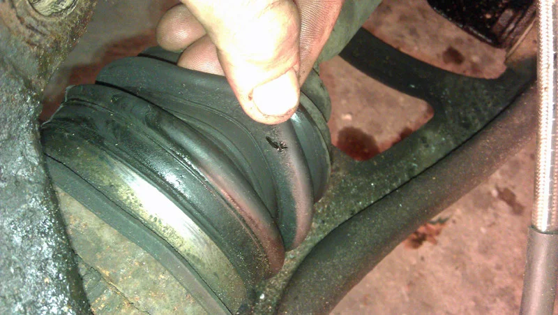

Assessing the damage, a tiny hole in the outer CV boot and a cracked ABS ring, fortunately all on the same side!

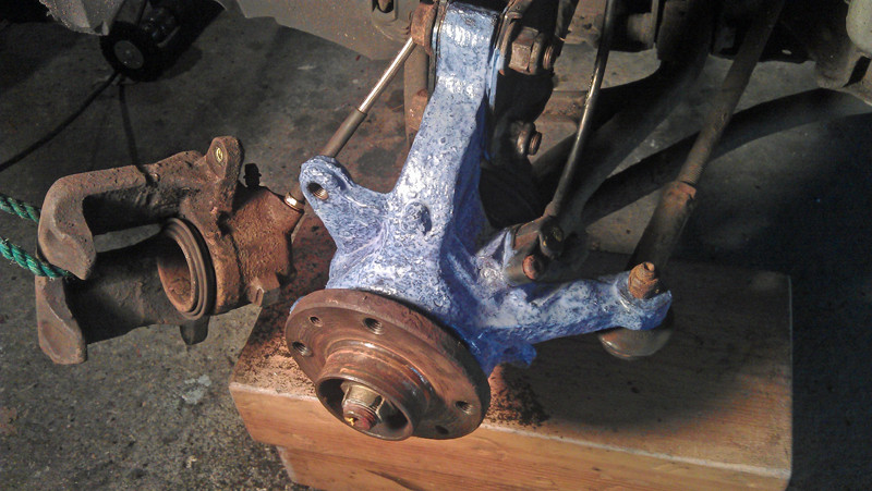

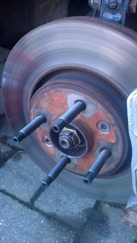

Cleaned up the hubs with the wire wool and on with the H80.

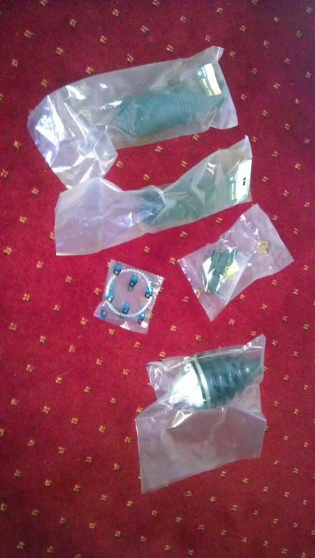

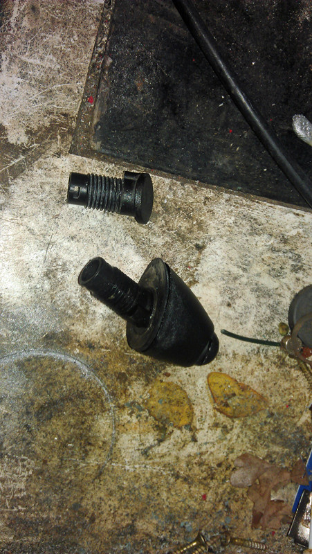

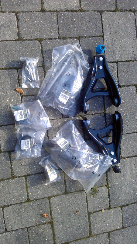

A shopping list was formed. Adam at Renault Wolverhampton sorted me out with a box of tricks, and then a second shortly after when I realised I needed more. New 'cup' wishbones including bushes and ball joints, track rods, track rod ends, steering rack bushes, bump stops/damper gaiters (mine were mostly in two pieces as seen above) CV boot kit and rear reg plate light. An ABS reluctor ring from eBay and no shown some Powerflex ARB bushes courtesy of Kam Racing.
Sadly most of this is beyond my mechanical ability/know-how so it's booked in with Stone&MWM in couple of weeks for all the bits to be fitted, tracked and MOT'd.

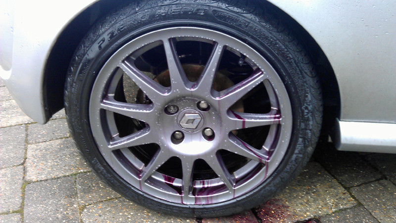

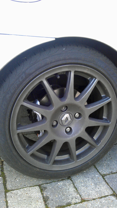

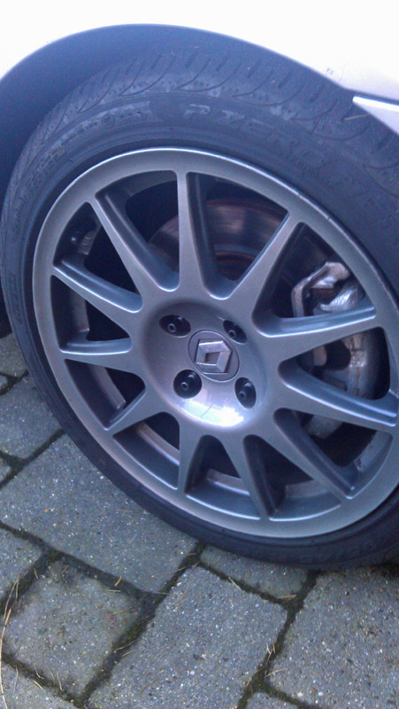

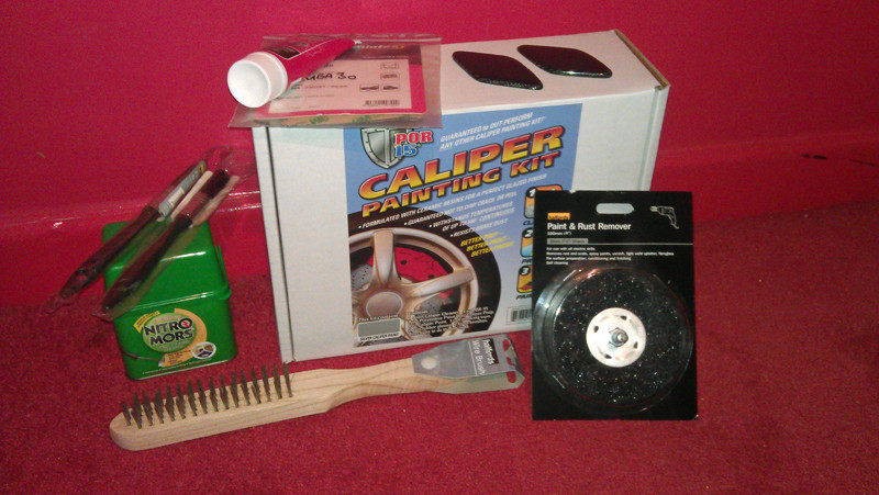

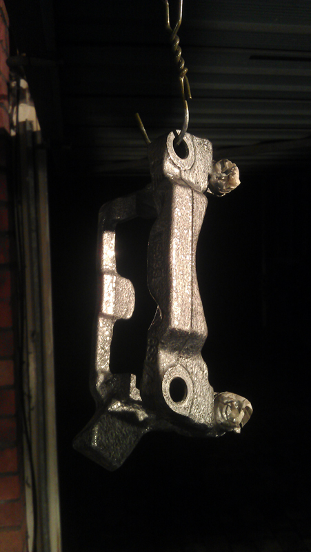

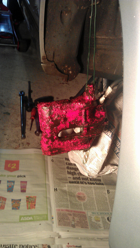

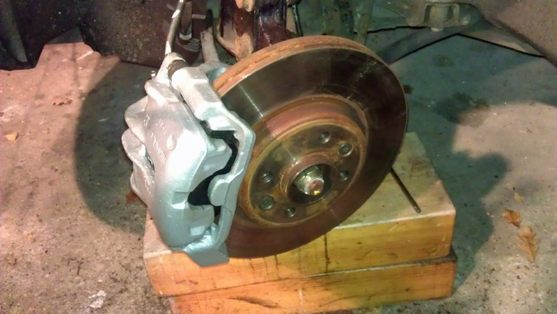

Nest up, the brakes. The replacement caliper, which had been installed after I ripped the bleed nipple off the original, had a horrible red paint job which was chipped and ruined. I set about cleaning them up with Nitro-Mors and the POR15 kit. If you've not used POR15 stuff before I'd recommend it thoroughly. Can be bought from http://www.frost.co.uk/ and really is better than any Halfords or Foliatec you'll get.
Not chronological but here are the results, excuse the dirty wheels!
While I was there I also put on my Mintex Caliper Squeal stickers and grease. I can confirm for anyone who finds 1144's too noisy that this stuff works! I no longer cringe when braking in town as the everyone stares at my squealing brakes! I got mine from eBay. http://www.ebay.co.uk/itm/MINTEX-CE...arts_Vehicles_CarParts_SM&hash=item1e77f2c903

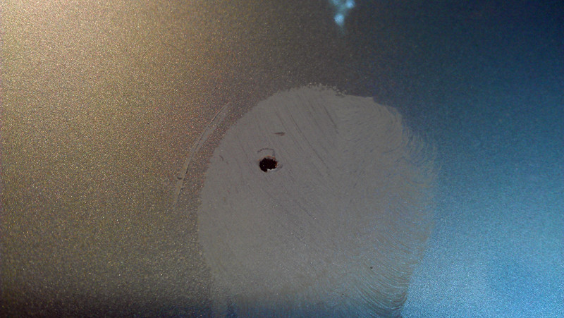

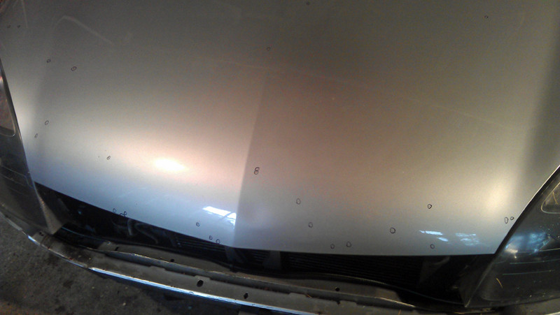

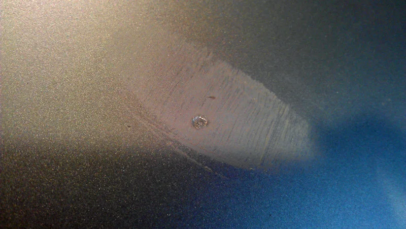

So like any 100k mile car, there are plenty of stone chips and my bonnet was one of the worse I've ever seen on a 172. Not helped by fact there is a nice bit of country lane near me which has a fair bit of loose gravel...
Spoke to Nick at DMC and he recommend Paints4U for some touch up kits. I'm always dubious when it comes to touch up but a professional recommendation put my mind at ease. I tested out the kit a while back and Paints4U's Gris Iceburg '640' was a perfect match.
Using Drive's touch up guide I was away...

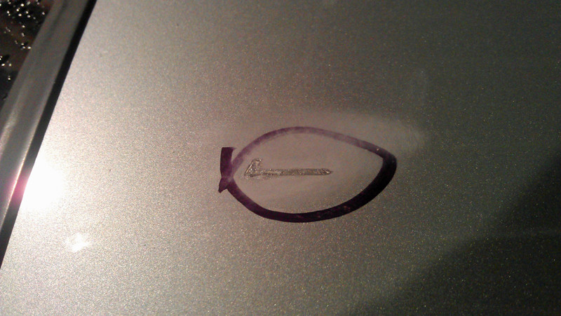

Marked all the key offenders.

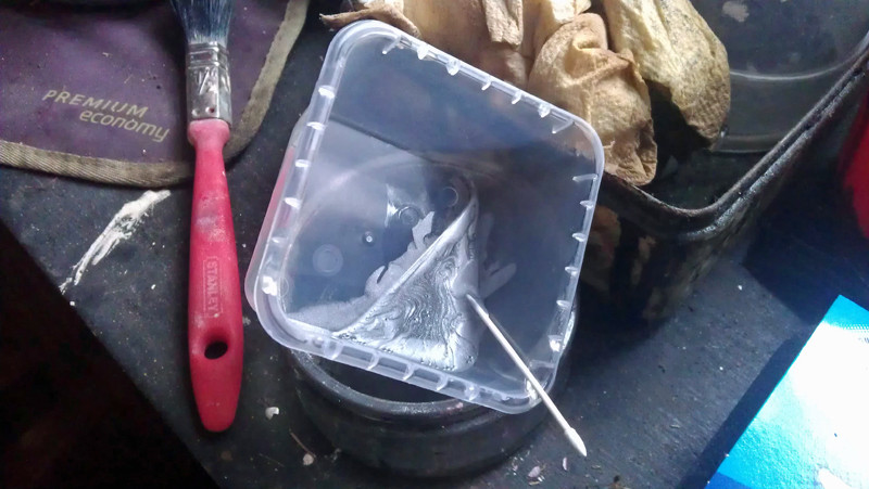

Mixed my paint and laquer and also added a little thinner so the paint would flow into the chips better.

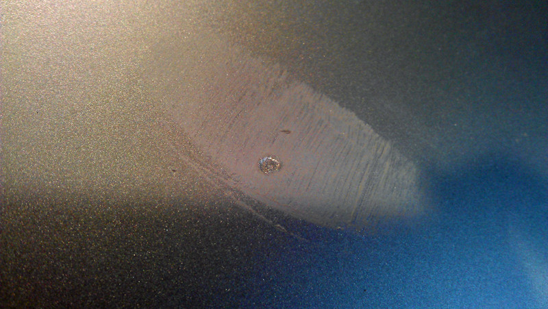

Sanded down the chips to remove the rust and give the primer something to bind to. A dob of wax to keep the surrounding paint clear and channel the touch up into the crack.
A large mark on the roof was the worst part, I had to fill and sand this one a few times...
One of the larger chips on the bonnet was a also tricky to fill, it actually took 4 days too get this back to flat and blend it in.
I don't have any more photos of the touch up or of the fitted washer blanks, but up close the car is noticeably cleaner. I really wish I had a machine polisher though, there are still visible marks from the wet sanding that I've not been able to get out with my Meguires Scratch-X.
