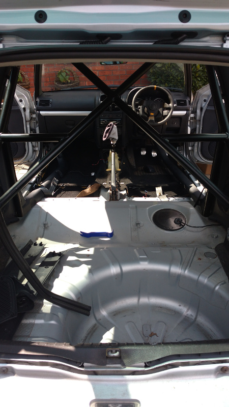

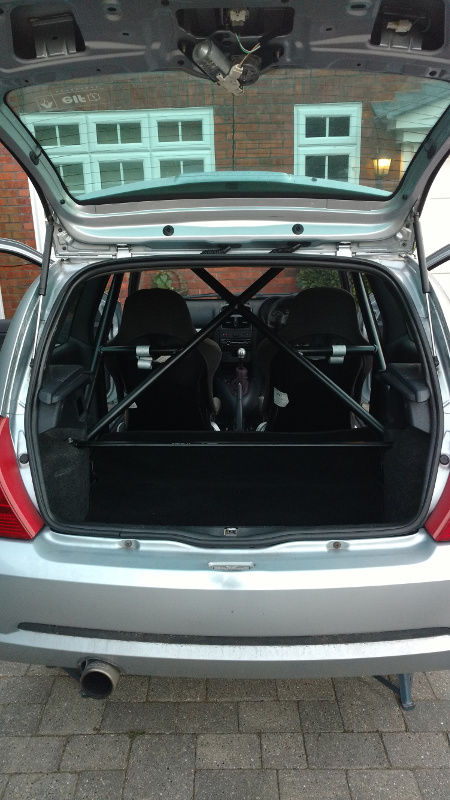

How do you rate the ebay cage mate? Feet and fixings look a little small in the pics?
Car looks very well by the way, lovely colour.
I'm really happy for the money. They are reasonably sized IMO. Not MSA or anything, but OK.
Car is "race car spec". Looks great from a distance or in pictures, quite tatty up close :p.
Are you selling your rear strut brace at all Haz?
Nah, I need it to hold my shopping. :D
I want to know of the handling has improved with the cage. Noticeably that is.
Back end is definitely a little tighter, with the insane front grip from the roll center kit, the RARB, Strut brace and cage, the back can get loose, but very predictably. No track time yet, but will be heading over Curby soon so will be able to compare with both feelings and hopefully some numbers!

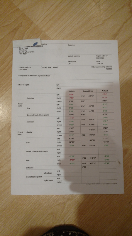

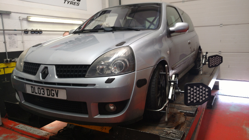

So on the lasers...

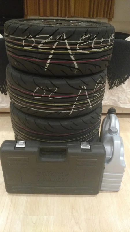

New settings, the old ones weren't far off, but sorting out the toe and a bit more camber seemed like a good way to go.
In exciting news, I'm off to Curborough on Tuesday for a neat little sprint day with the same guys as last time, looking to put the coilies and roll centre through it's tracks. It also made me realise that I never showed the outcome of my wheel refurb, as they've been sat in my boiler cupboard since summer last year!

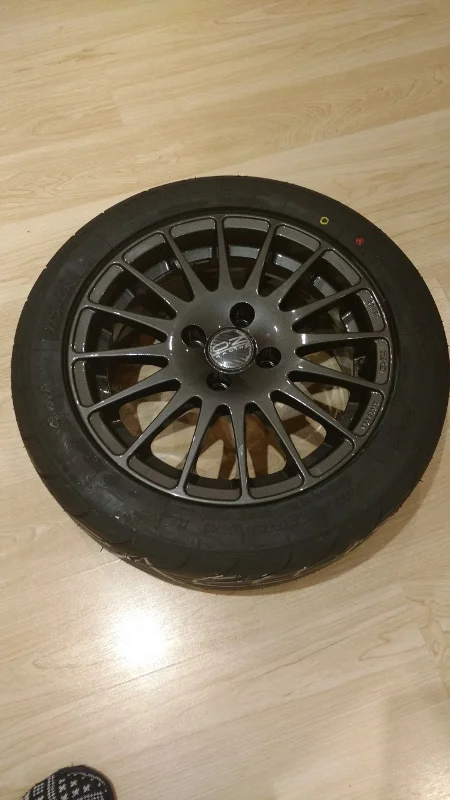

So here's the stack of rubber, and the new rims!

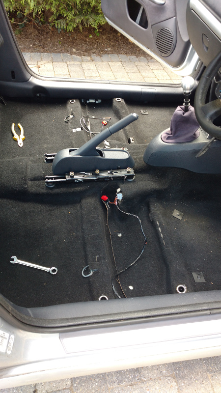

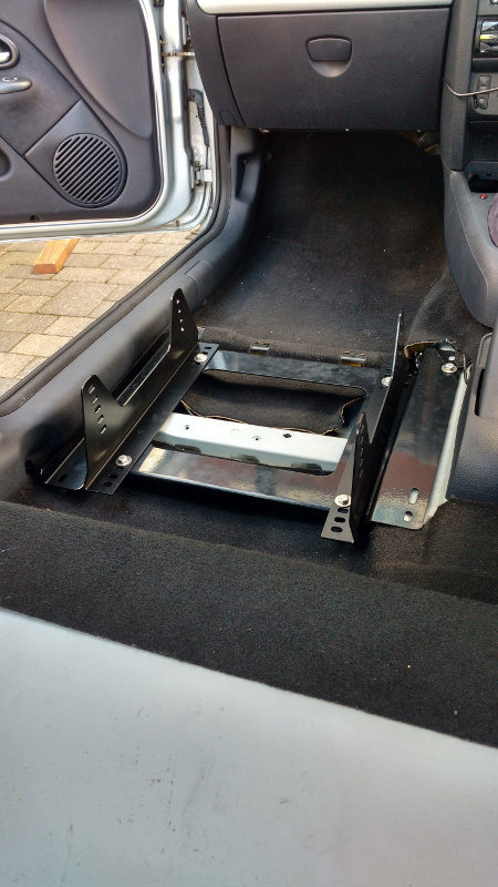

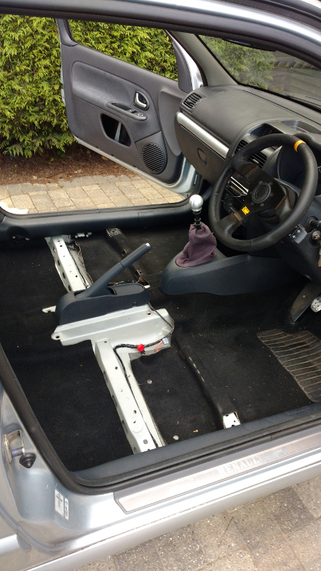

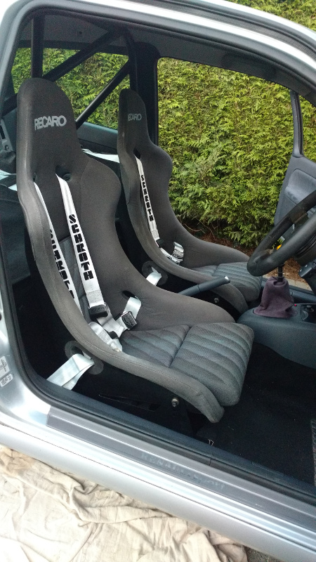

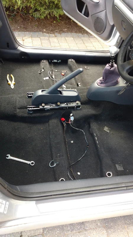

But also, I tried Dann's @JON FOZ seat mounts and was super impressed, so I bought some.
So first was to remove the old mounts, which were good, but still sat quite high.
And while I was in there I replaced the bolts on the cage because I wasn't happy with the quality, so I took a bunch of the interior out to do that...
Then back to the mounts, took some chunks out of the carpet so the mounts sat perfectly flush.
Then fit the mounts.
And with all the standard belts removed, I put in the 3 point Schroth harnesses I had from when I bought the seats. They aren't my favourite harnesses ever, but will do the job 'til I find a nicer set.

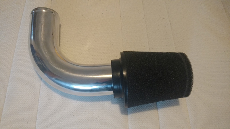

Fatty's induction set up - no louder than normal up to 3k rpm, comes alive after that!

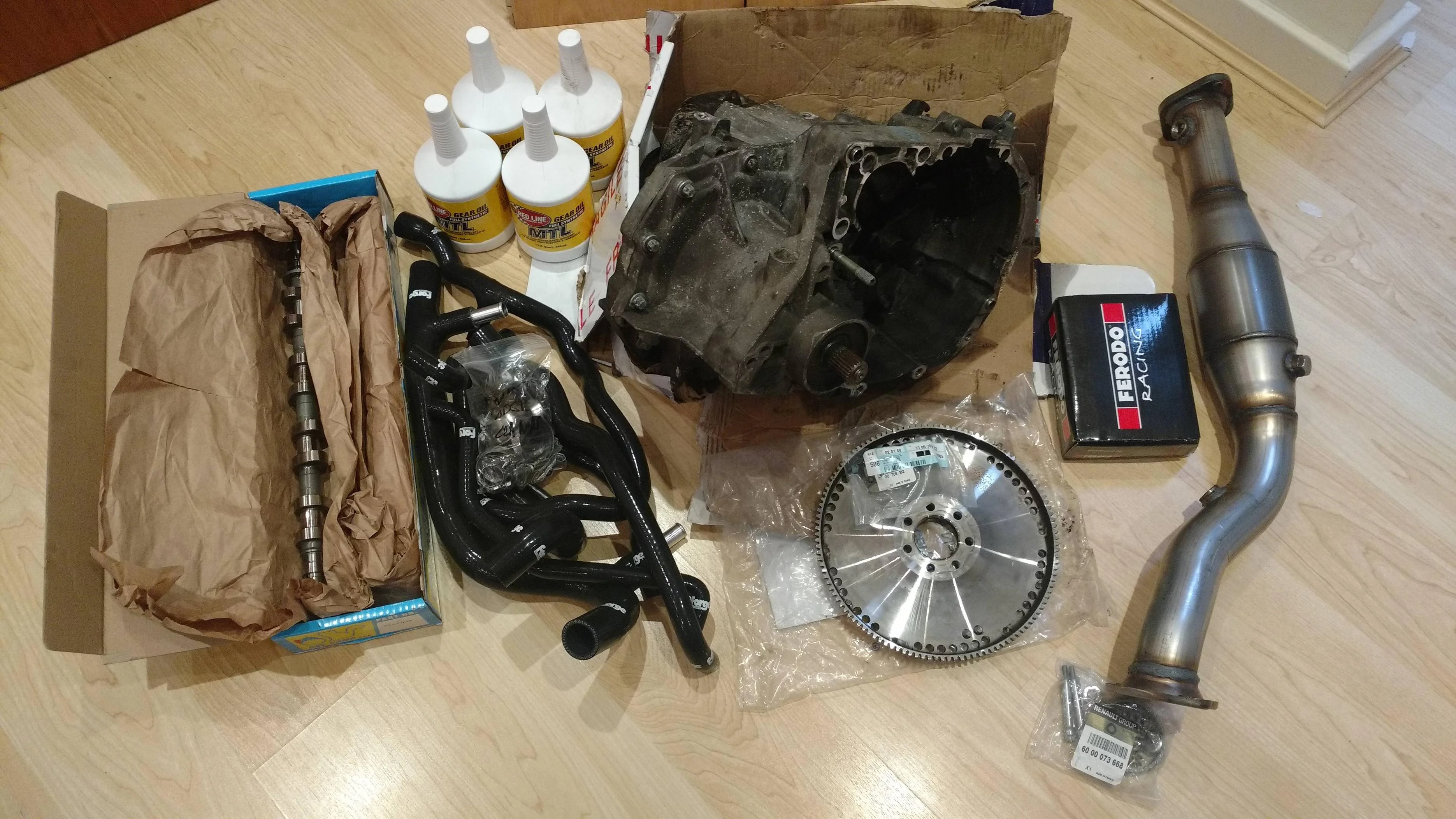

So early in the new year, all this lot is going in;
- Cat Cam 438s
- Forge coolant hoses and clamps
- Replacement gearbox - complete with new seals, and most importantly, a Quaife LSD along with Redline MTL oil
- TTV Lightweight Flywheel & new Renault flywheel bolts
- 200 cell sports cat & genuine cat fitting kit - I bailed on fitting a decat a few years back, as I really don't like the effort of switching out a decat come MOT time or the smell when it's installed, hoping this will be reasonable comprimise, allbeit an expensive one.
- DS2500 pads
All being fitted at the same time as I have all new belts, dephaser, oil, coolant and filter changes, along with further investigation to the oil leak I've been plagued with for years.

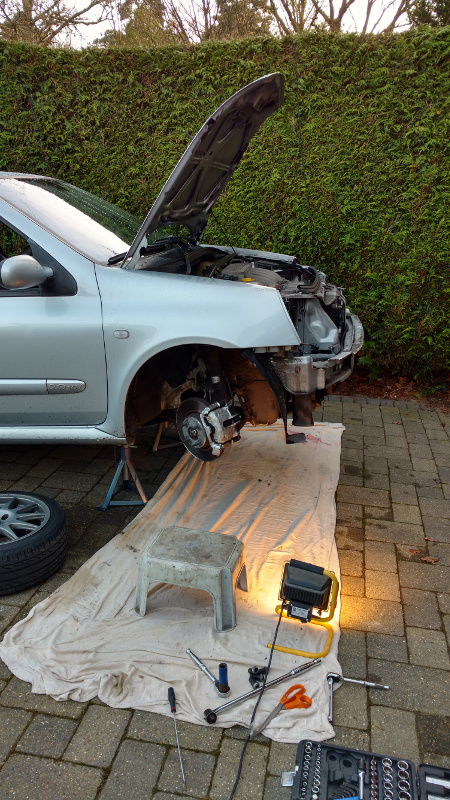

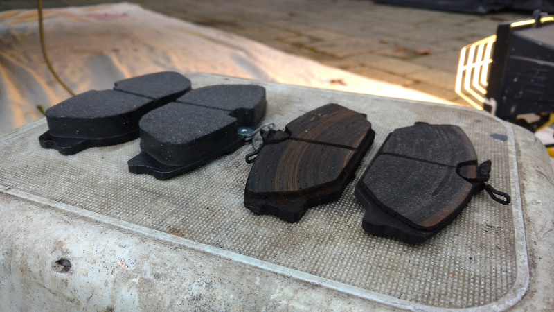

Put the new brake pads in yesterday, and polished the headlights again, it's looking good!

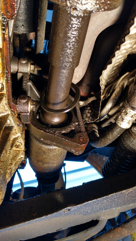

The drivers side drive shaft is knackered, both CVs are torn and the support bearing looks like this...
So think I'll need to replace all that as well, which will be fun.
Also now pretty sure that there is play in my steering rack, or column, all the trackrods etc are still in great condition, and the roll centre bearings still holding up.
