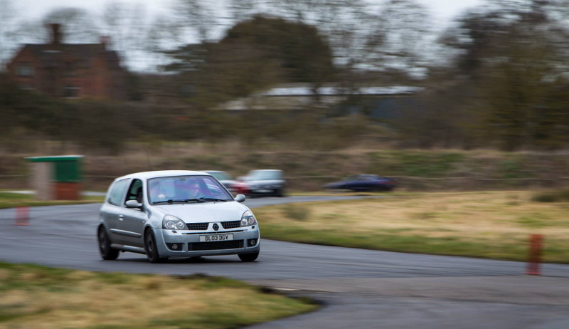

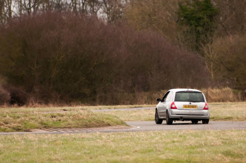

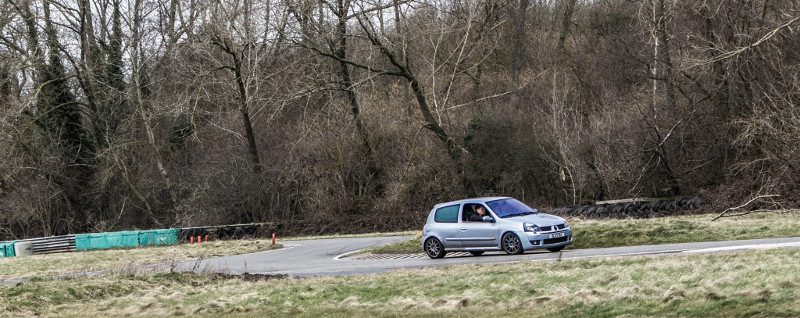

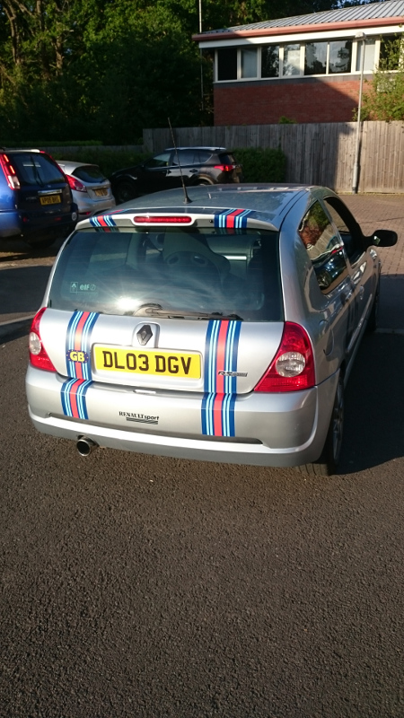

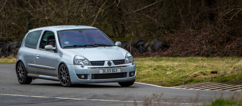

@dann2707, @AdamR and I are on another forum, actually for cycling but with a growing number of petrolheads. Someone had the idea to run a track day instead of a car meet, so Adam got us a day at Curborough sprint track.
It was awesome! Really great day had by all, with about 10 cars doing hot laps, un-timed in the morning while we learned the corners, timed in the afternoon so we could have a bit of a shoot out.
Anyway, here are pictures I've stolen off the guys who had cameras...
And the most important part, the times. Dann was getting quicker all day, and I was always 2 or three seconds off him. Couldn't work out why, as we have the same amount of track experience, and while my car is lighter, he's got his Billies installed and corner weighted, so equal really.
Turns out, it wasn't a flying lap, it was 2 laps with a standing start! So I put the hammer down and managed to beat him by a solid second.
He was still putting in the laps, getting closer and closer, and by the end of the day, the board was left like this...
I was fastest, followed by Dann, nice to see the Clio's representing.
Cheers to Adam for organising, cannot wait for TFTD2!

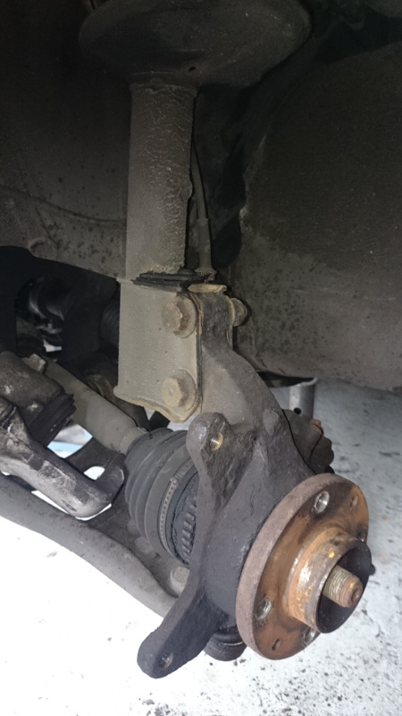

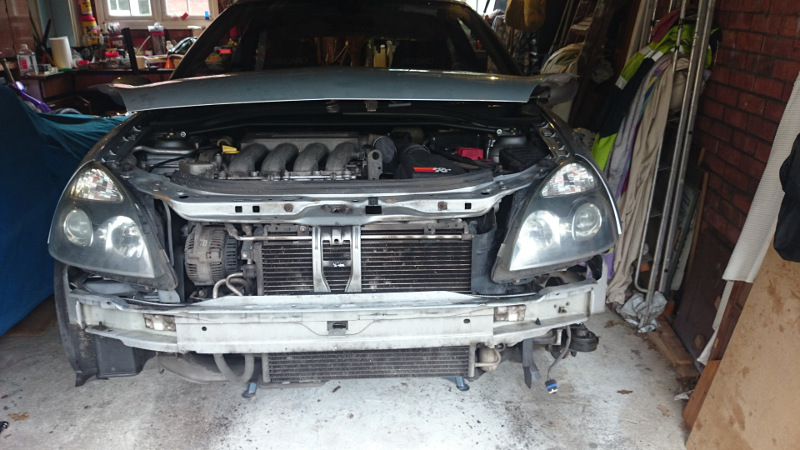

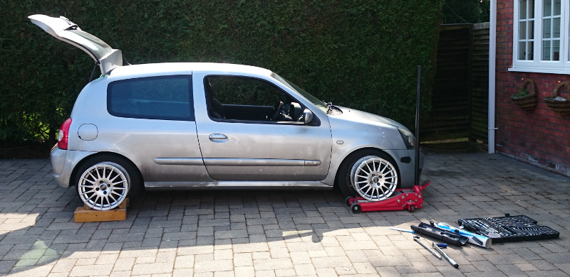

I've been busy over the Easter weekend! There were about 80 pics but I've reduced it down to 30 odd...

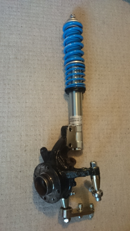

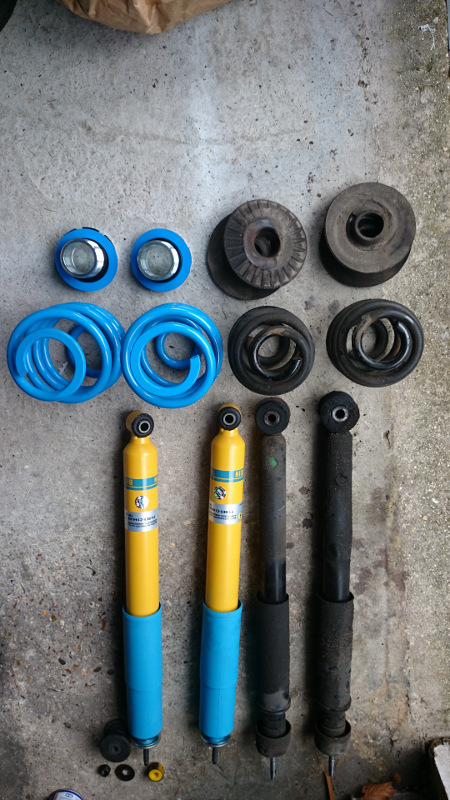

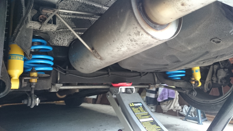

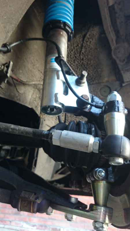

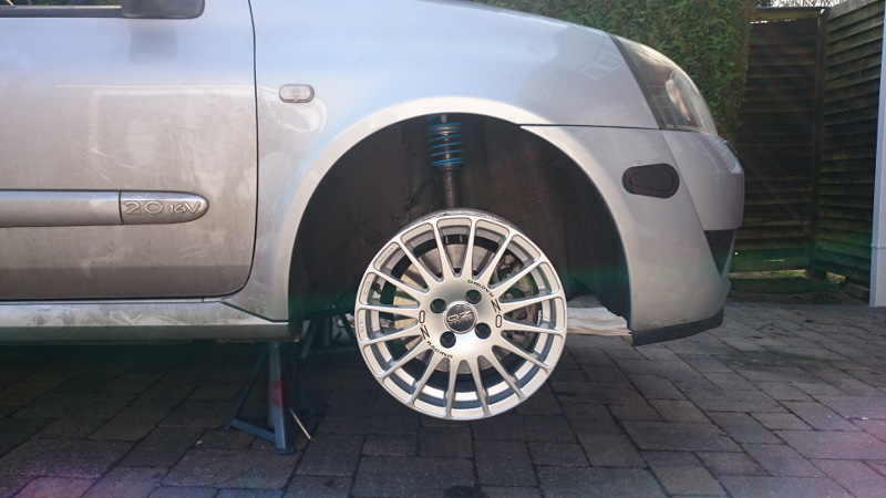

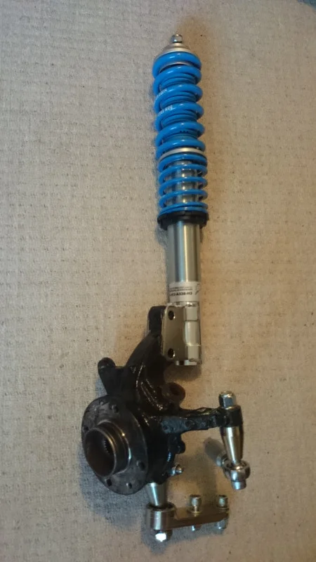

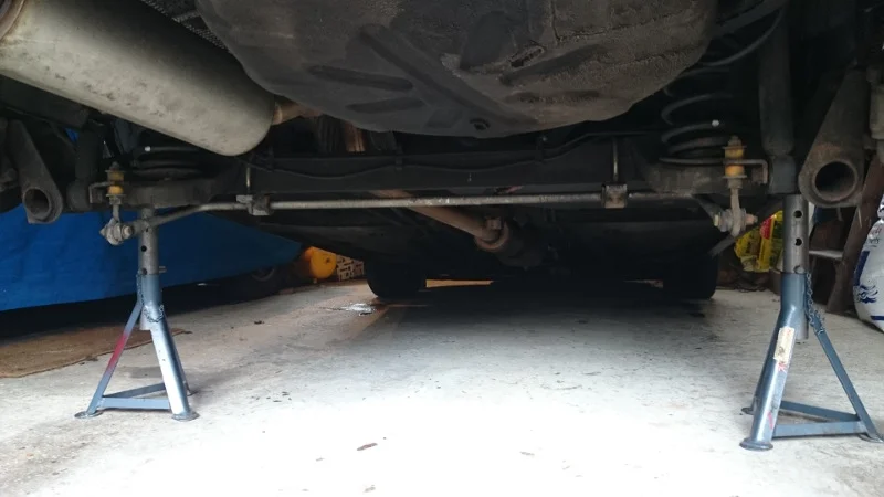

In my cupboard I've had the Bilstein B14s and before Christmas I sent a spare set of hubs off to @NorthloopCup as part of the group buy for a roll center and bump steer kit.

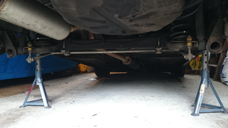

The old stuff at the back.
New springs & dampers.
All in. I've since taken the rubbers out fr
om the back so it sits lower.

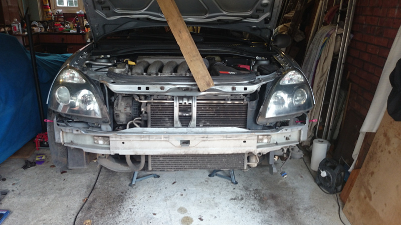

Now for the front.
All striped down and a comparison.

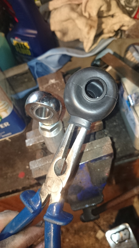

A ballsack for the rose jointed rod ends.
And voila, magically all back together!
Anybody got a nice set of camber/toe settings for a fast road car? I'm getting all the ride heights, corner weights and geo done on Monday.
I was thinking -1.5 deg camber and -0.1' toe?

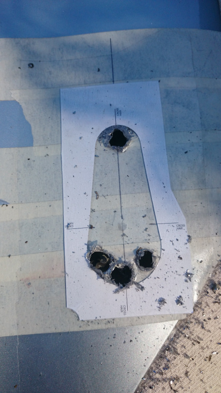

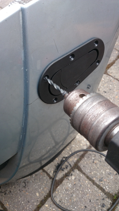

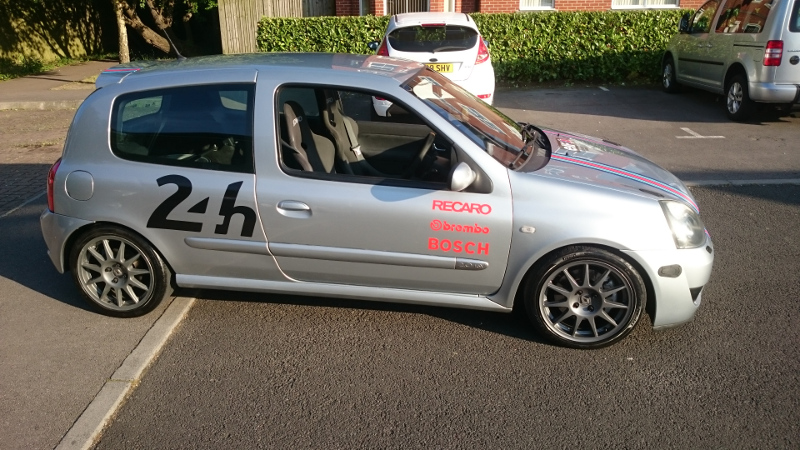

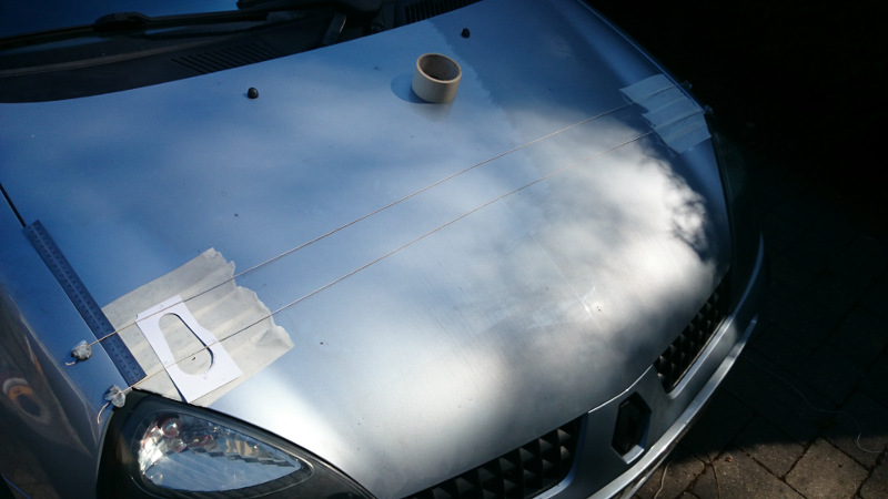

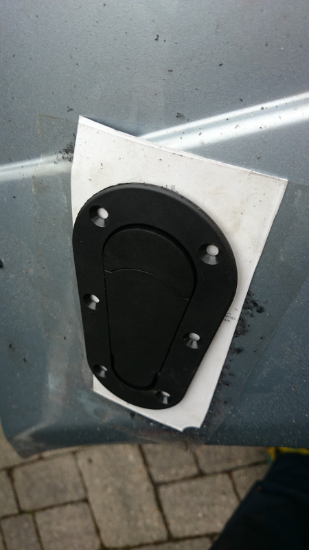

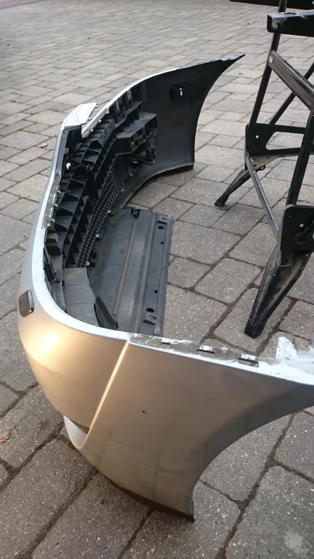

So while I was doing all this I got a bit carried away, because racecar.

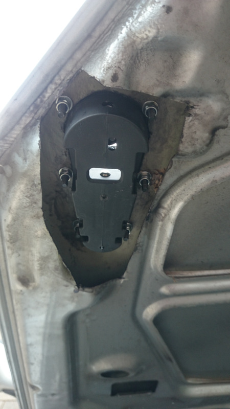

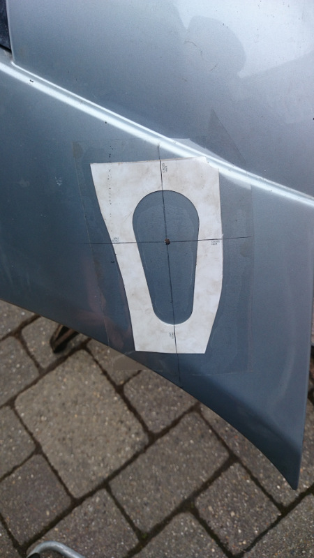

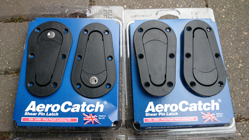

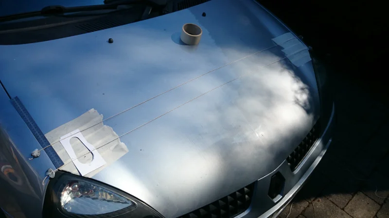

Some for the front bumper, some for the bonnet.

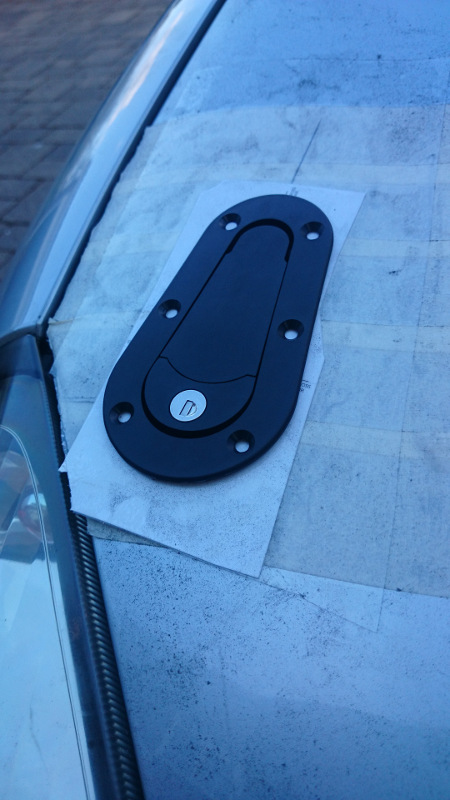

So I fit the pins, which is a bit of a mare because it's not symmetrical. I measured everythign about 40 times and it's still out! :p

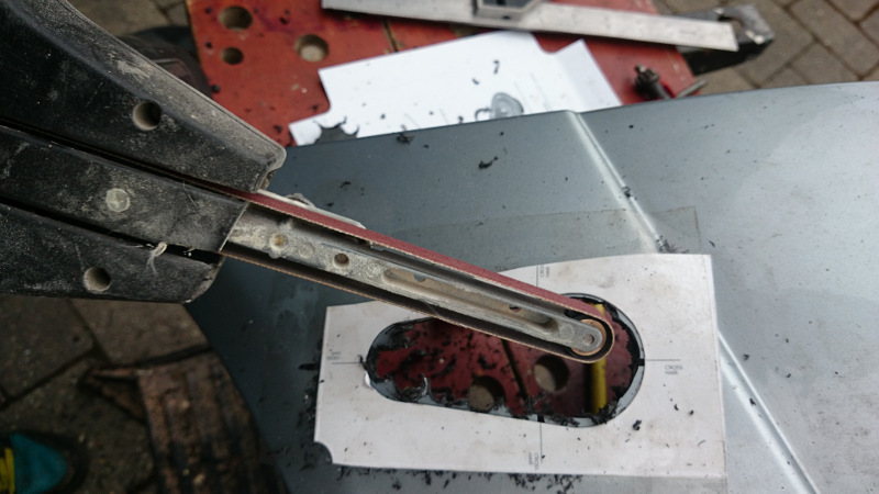

Marked all the holes and drilled them out. Sticky back plastic over the template to hold it in place.
Used a powerfile to smooth the holes, absolutly the best tool for the job here, clean up too seconds.
Test fit.
One in, next one to be drilled but I didn't want them to be uneven, that would be s**t, so loads of measuring and it was lined up!
Cut the slot out the same as before, and then drill the bolt holes.
Taadaa!

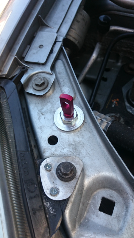

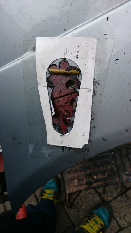

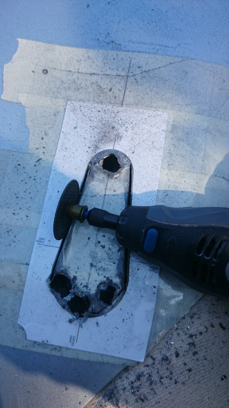

Next bit was more daunting for some reason, cutting the bonnet skin was daunting, but ultimately I used a dremel with a fibre-reinforced disc and it was all perfect.
I used the bonnet locators to mount the pins, because it's just about the flattest area on the bonnet and you don't need to drill the chassis.
When they were in I drilled the pin holes, masked everything and made a guide to line up the templates.
Measure twice, cut once.
When I was happy with the locations, I drilled some more holes.
And cut them with the dremel.
Test fit success!
Then I hacked up the skin and bolted them in! All edges finished with Hydrate 80 rust inhibitor.

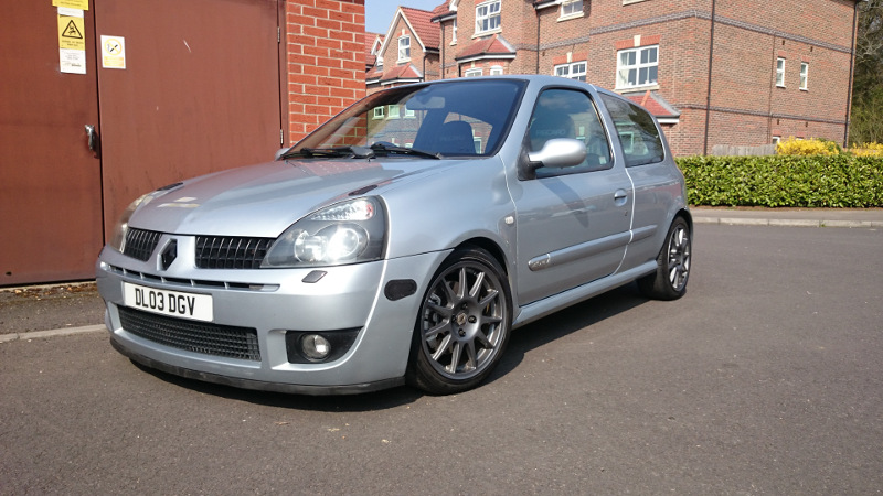

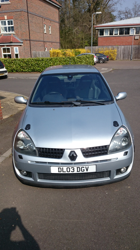

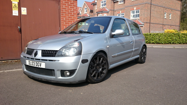

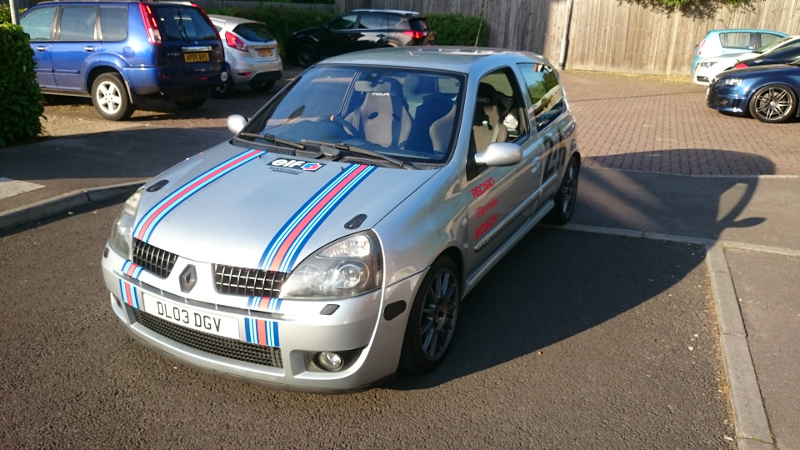

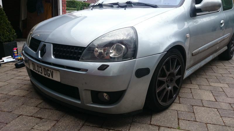

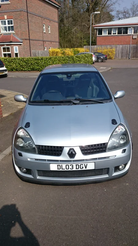

And here's how it looks now!
Don't think bodycoloured blanks would help really, would still be a bit cluttered. Also, I really hate painting.
Wheels are far too nice for that. Likely will go for something brake dust coloured. :p
So the car was set up yesterday...
@Cub. I saw your recommendation for Jtech in your thread, they did all the set up for me after I fit it.
I got my first chance at a clear country lane today, one word - Phenomenal. The suspension and roll center kit together is unreal, anyone who was unable to take part in the group buy has missed out.

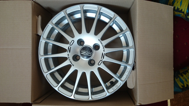

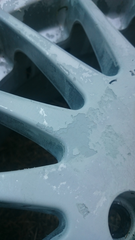

So the wheels I bought... £30 of Nitromors and they still looked like this...
So I gave in and they've gone off for a refurb, more about that another day...

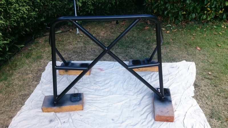

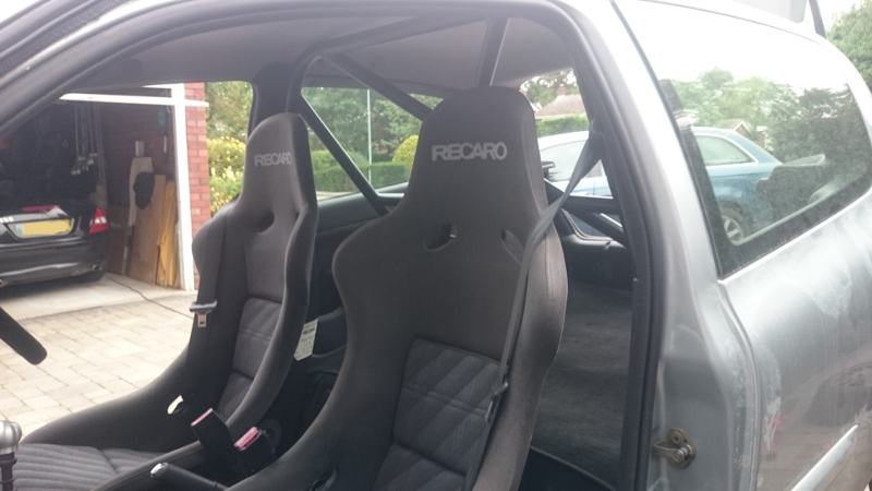

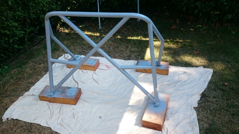

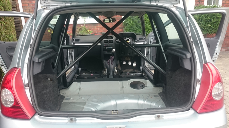

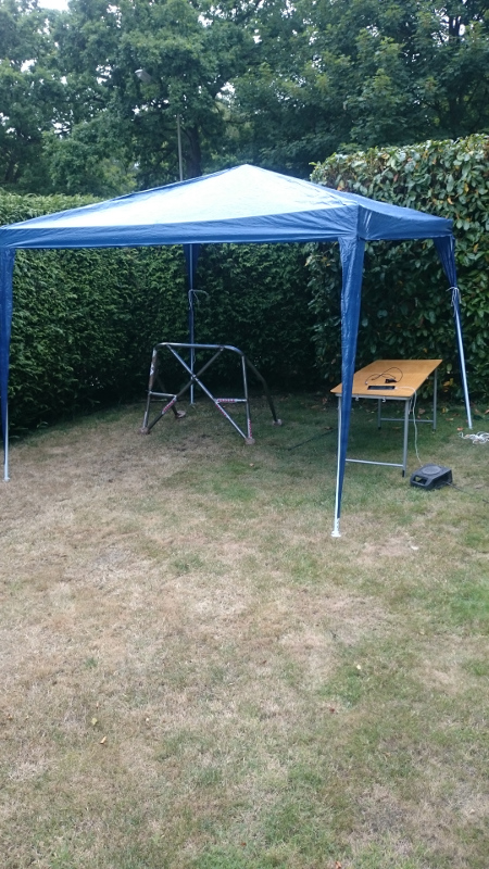

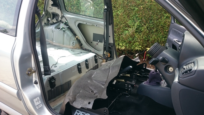

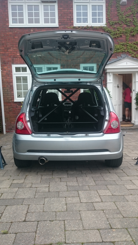

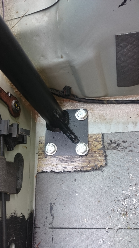

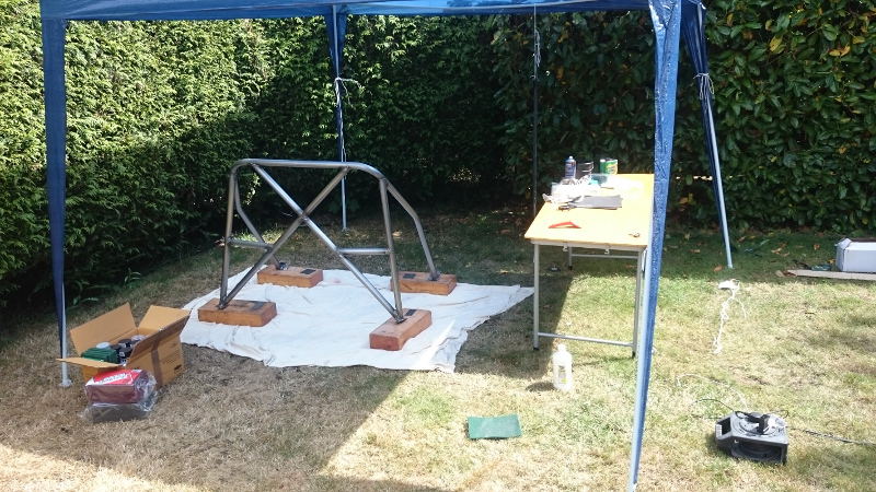

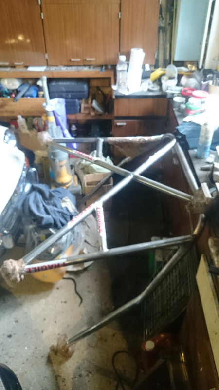

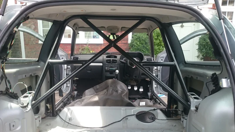

I thought it would be fun to put a cage in my daily driver! I spoke to the eBay cage man and he very kindly sorted me out. Thought about going Safety Devices, but honestly I don't need this to be blue booked so a carefully installed bolt in will do.
Arrived a few weeks back, I then set up my £20 Go Outdoors 'spray shelter' and got too it.
Skip forward to today.

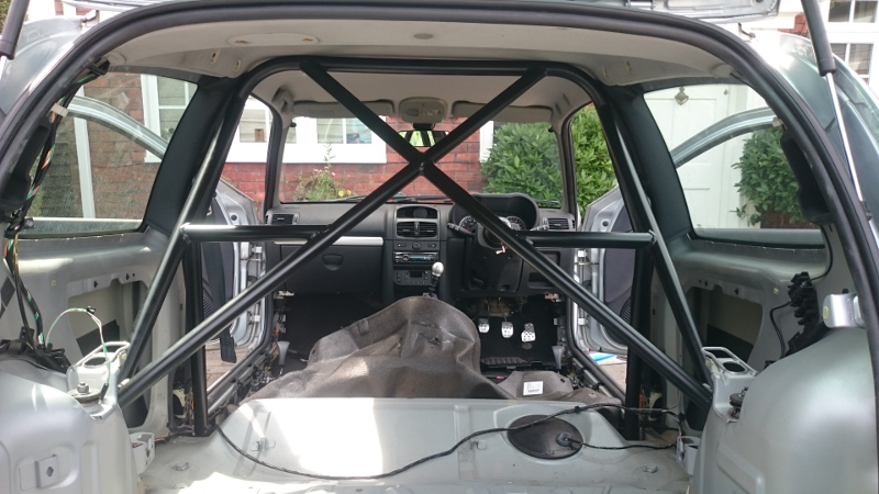

Stripped the seats, steering wheel and interior from the passenger carpet back.
Got the cage in position.
Bolted down.
Trim back in.
And complete!

That's bloody brilliant mate!
Prefer the Speedlines to the OZ though, and not too sure about the bonnet/bumper catches. Otherwise it's a beaut in my eyes.
Gus
  182Turbo,DCi90
Your car is getting really serious now. Some fantastic upgrades you have done.
OZ won't be silver for long, so we shall see...

How do you rate the ebay cage mate? Feet and fixings look a little small in the pics?
Car looks very well by the way, lovely colour.
  172
I want to know of the handling has improved with the cage. Noticeably that is.
Also how you are running seatbelts with buckets?
Is the dash airbag light on as well?
