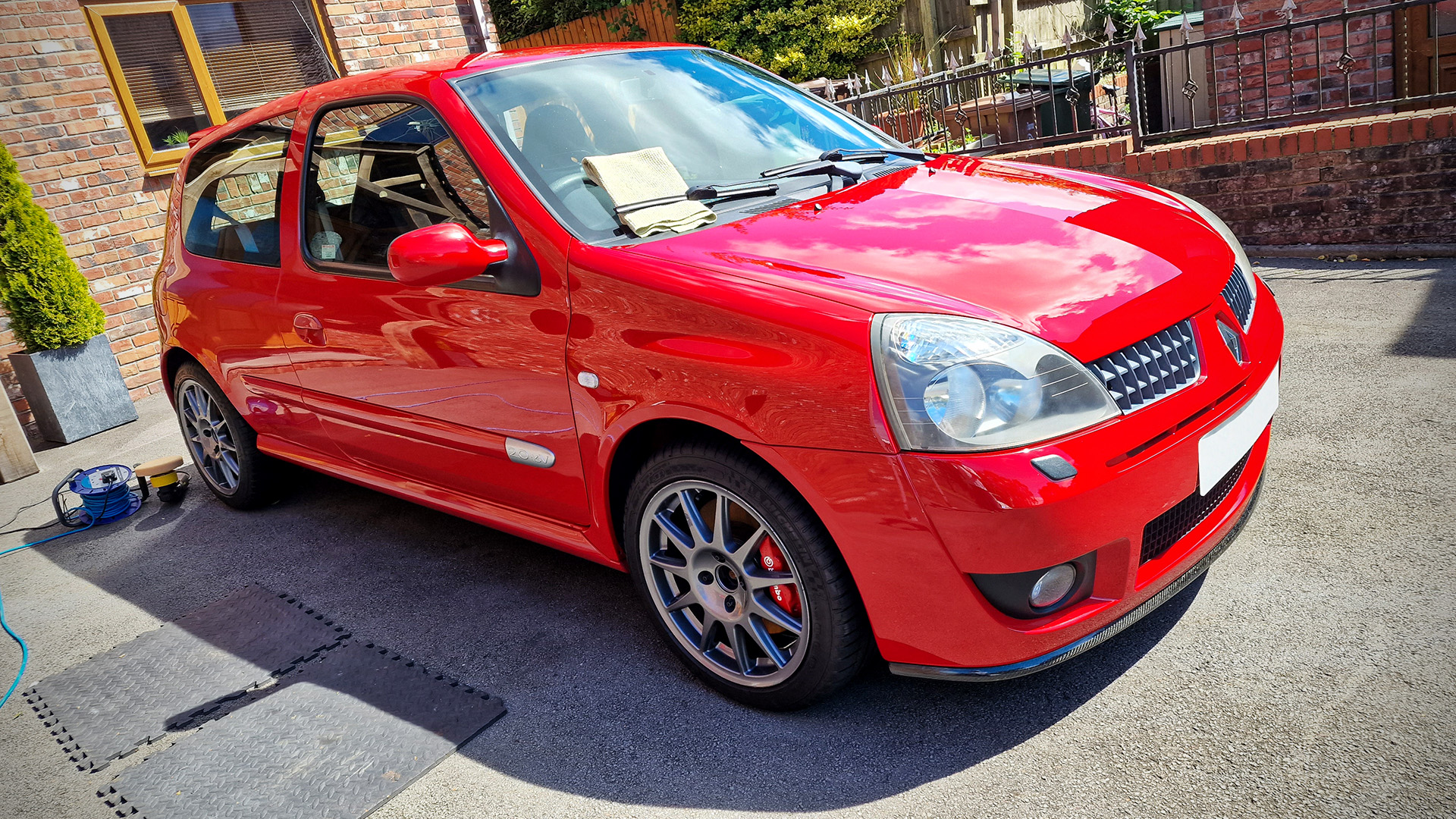

I decided to take advantage of the decent weather and the fact that I had a few days free. That meant addressing the paintwork on #165 and attempting to breathe some life back into the neglected paintwork, trim, interior, and other areas.
Day 1 was spent deep cleaning the exterior with a plethora of products, and a lot of patience. After the usual pre-wash, foam, and regular wash I then went a step further and applied fallout remover to get rid of unwanted tar, iron, and other crap embedded in the paint. Oh yeah, I also used the clay bar to remove a lot of surface contaminants and - eventually - the paintwork was looking a lot better. I also had to address the glass as it was in a poor state, too - so I pretty much followed the same steps. Ideally, the windscreen needs replacing as it's scratched to heck but that will have to wait. In truth, the rear window also needs replacing as something has damaged one side leaving pitting. Anyhow, the plastics and rubbers were also deep-cleaned and undressed.
Days 2 and 3 were spent on the paintwork with mostly my DA rotary polisher in hand and an assortment of cutting and polishing pads within easy reach. It's no show queen and some of the scratches and scuffs are a bit too deep for me to tackle without knowing the depth of the top coat (I don't want to cut too deep) so I just focused on removing the light stuff and bird-poop etchings. To be fair, it came up better than I expected... but also served to highlight the fact that the handles are now ridiculously pink and the plastics are a different shade of Capsicum Red to the rest of the shell! Oh well, it will do for now!

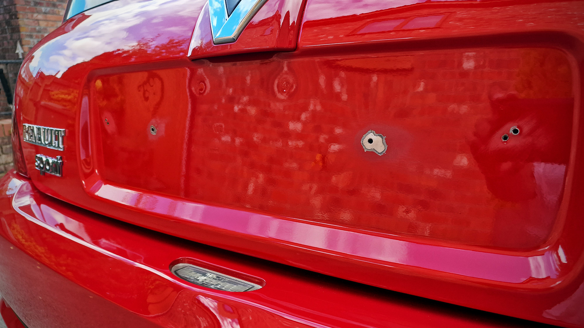

I had hoped to make a start on the interior, trim/rubbers on Day 4 but, in removing the plates, I found a little rust that needed treating on the rear boot lid. I gave it a quick sanding down, filled it, and it should be good for sanding, primer, paint and lacquer tomorrow. The rust wasn't too bad, just a little bit around where the previous plates had been screwed in. Talking of which, the screw holes were also filled and will also be sanded, primed, etc.
Whilst the painting/lacquering is being done I'll use the in-between (drying) times to tackle some of the other outstanding jobs. it's getting much closer to where I want it to be now.
I have a few bits ordered (or will be ordering shortly) - rear number plate light, headlights, that sort of stuff.

Looks great, good job on the polishing. I think the effort was well rewarded.
Thank you, mate! Hopefully, the finishing touches will be the icing on the cake in a couple of days or so... (y)

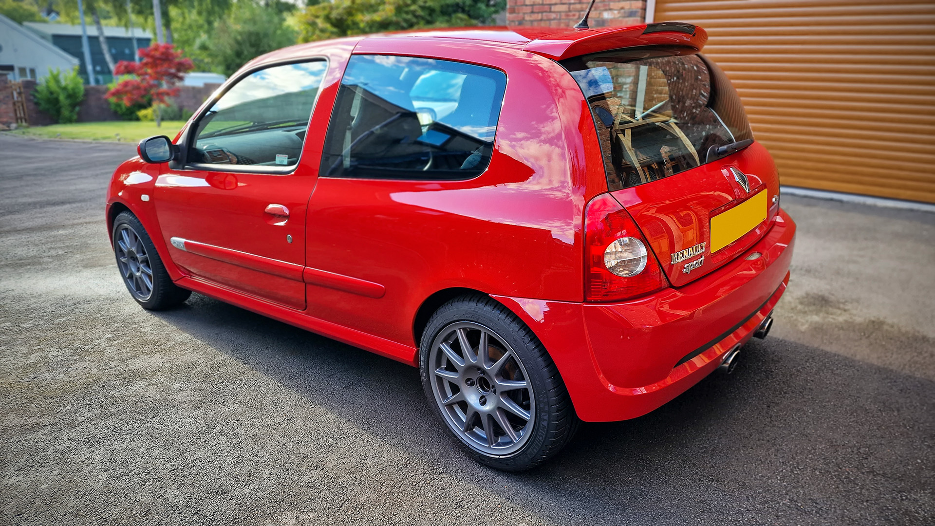

The paintwork has come up nicely, as long as you don't stand too close. Several days of compounding/cutting, polishing, and other things I've heard detailers mention in their vocabulary. I've mentioned already that it will get a respray AT SOME POINT DOWN THE LINE but, as I have also said to some folks, I'm not massively precious about it. I'll look after it as well as I can but - ultimately - it's a red Clio that I want to drive and enjoy. And I am because #165 is my daily, even if not the most practical for tip runs, fetching DIY supplies, or lugging garden centre purchases. In fact, I did have a go at a bit of painting after treating the rust and filling the screw holes from previous rear number plates...
Trophy enthusiasts may want to look away now. :p:LOL:
Ghetto painting at its finest.
Don't worry, it actually came up pretty good in the end! I didn't (and still don't) have a clue what I'm doing having never done any car paint/spray stuff before. Thank you, YouTube. Anyways, the area was rust treated, primed, painted, lacquered, etc. It took bloody ages, even doing it ghetto style. Thankfully, I managed not to cover any other areas of the car in fallout or overspray. Result.

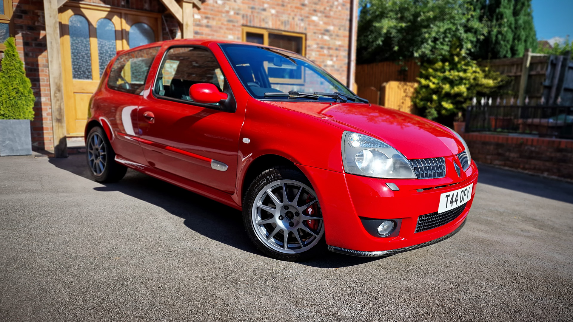

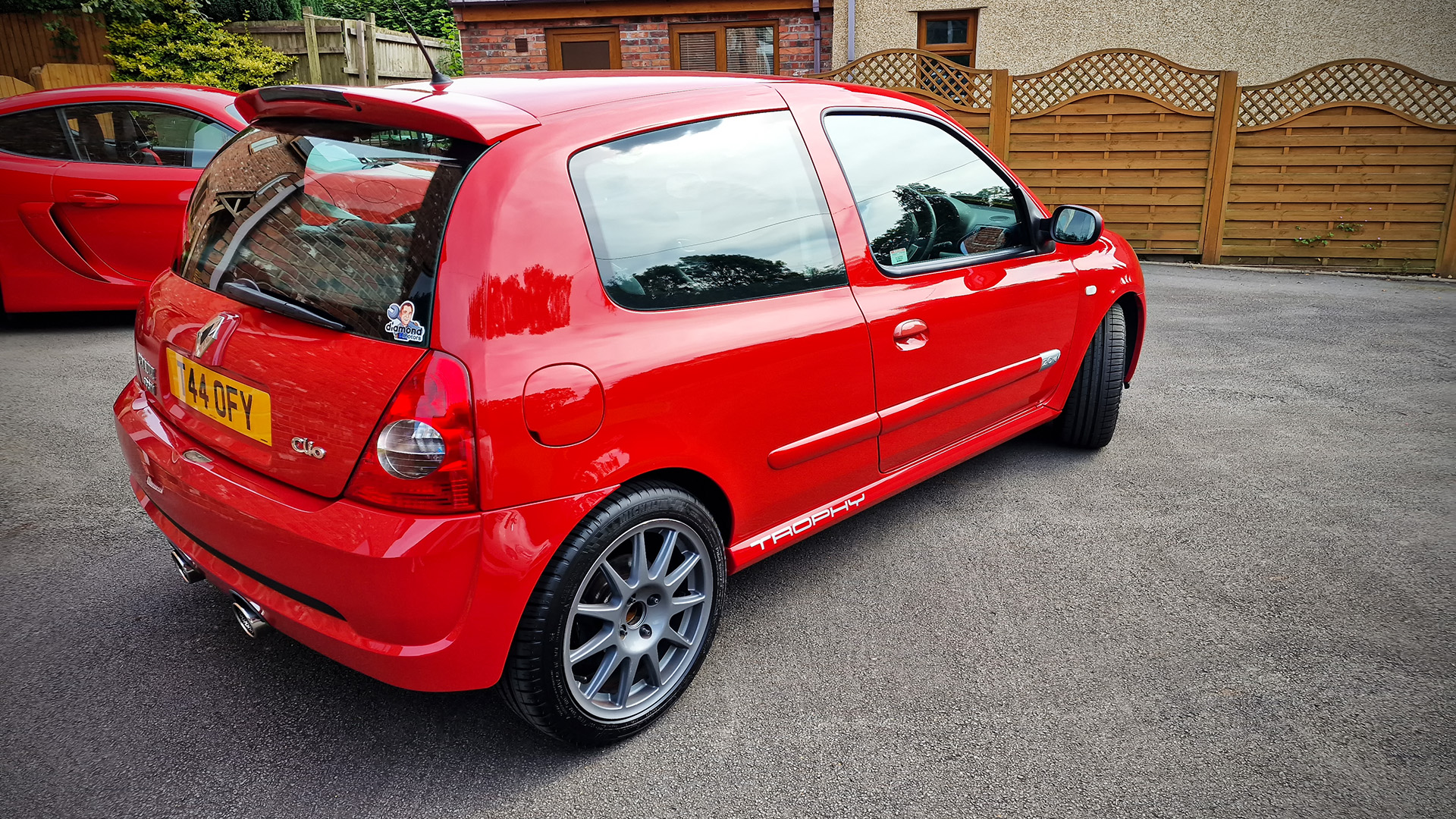

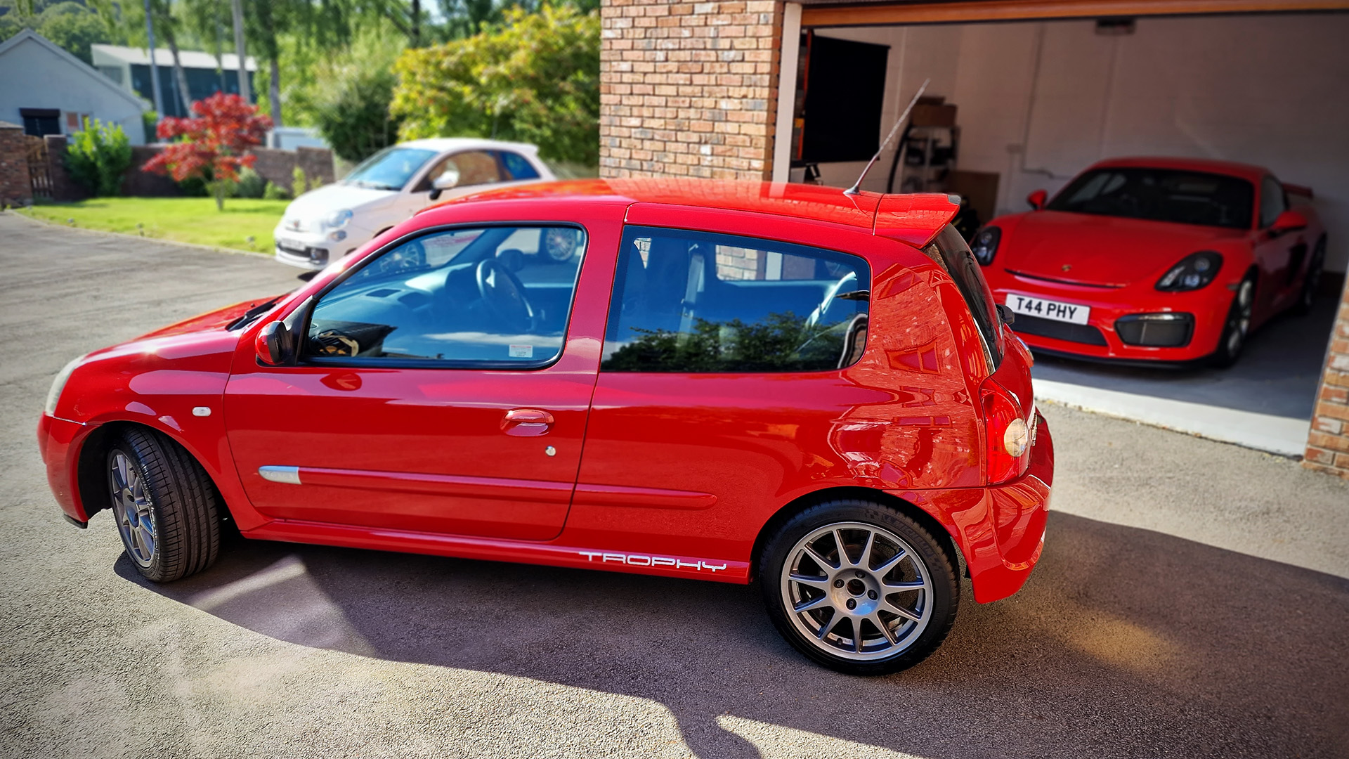

With the paintwork clean and polished-up "nice and proper", I decided to have a crack at putting the new decals onto the sills. Hmm. I won't lie, that didn't go so well. Having decided to err on the side of caution, I mixed up a mild solution of soapy water (as advised) so that I could apply the decal and then have a moment or two to slide and move it into place. Or so I thought. I roughly placed the decal (both sill and decal sprayed with said solution) in the approximate position using the provided guidelines. F**k. The decal stuck instantly! FLOL! It just grabbed and I couldn't move the damn thing! As a result, I basically had to leave the decal where it was, and to my annoyance, it is very slightly lopsided. Not by much, but more than enough to annoy me. I think I'm going to buy another set and try again. Sure enough, I experienced the same issue on the other side. This time the decal was more or less perfect (I'd learned that my first effort was pretty much going to be my only effort to locate it!) The placement was much better but the letter "H" decided to be a pillock and slightly crumpled as it left the media and attached to the sill. With it sticking instantly I couldn't do anything about it so "H" now has a slight crease in it. Again, minor but enough to pish me off. Yes, I will definitely be buying another set and trying again.
Anyways, this is how #165 is looking at the moment - complete with new plates.
(Yes, I know "Trophy" is wonky).
(Yes, I know "H" is creased-up - but not in a joviality sense).
Thankfully, it doesn't look too bad from the front end. I don't have any centre caps on these wheels as these are actually my track wheels. The original Trophy Turinis I have are stored safely away. I can't wait for the new headlights to arrive (well, when I've ordered them) as they should really tighten and tidy up the front end nicely. Toight like a toiger.

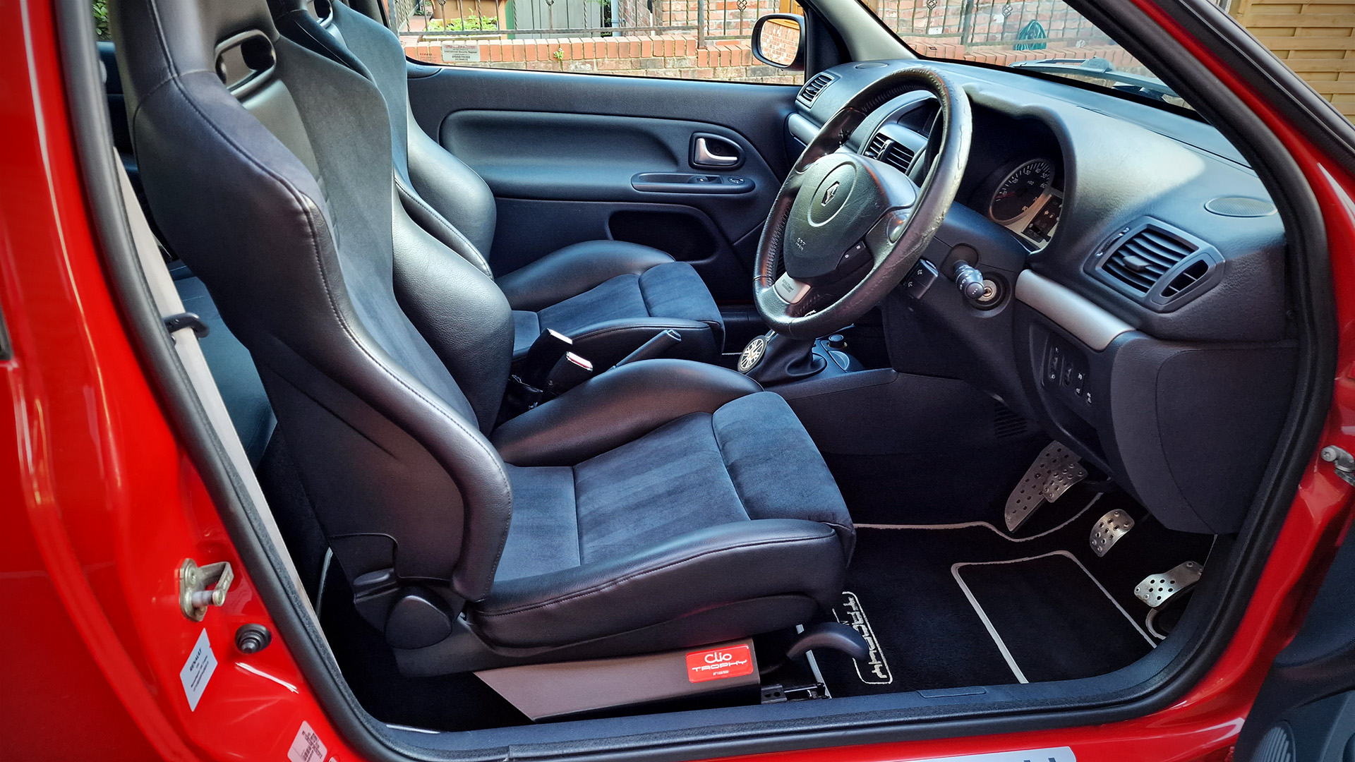

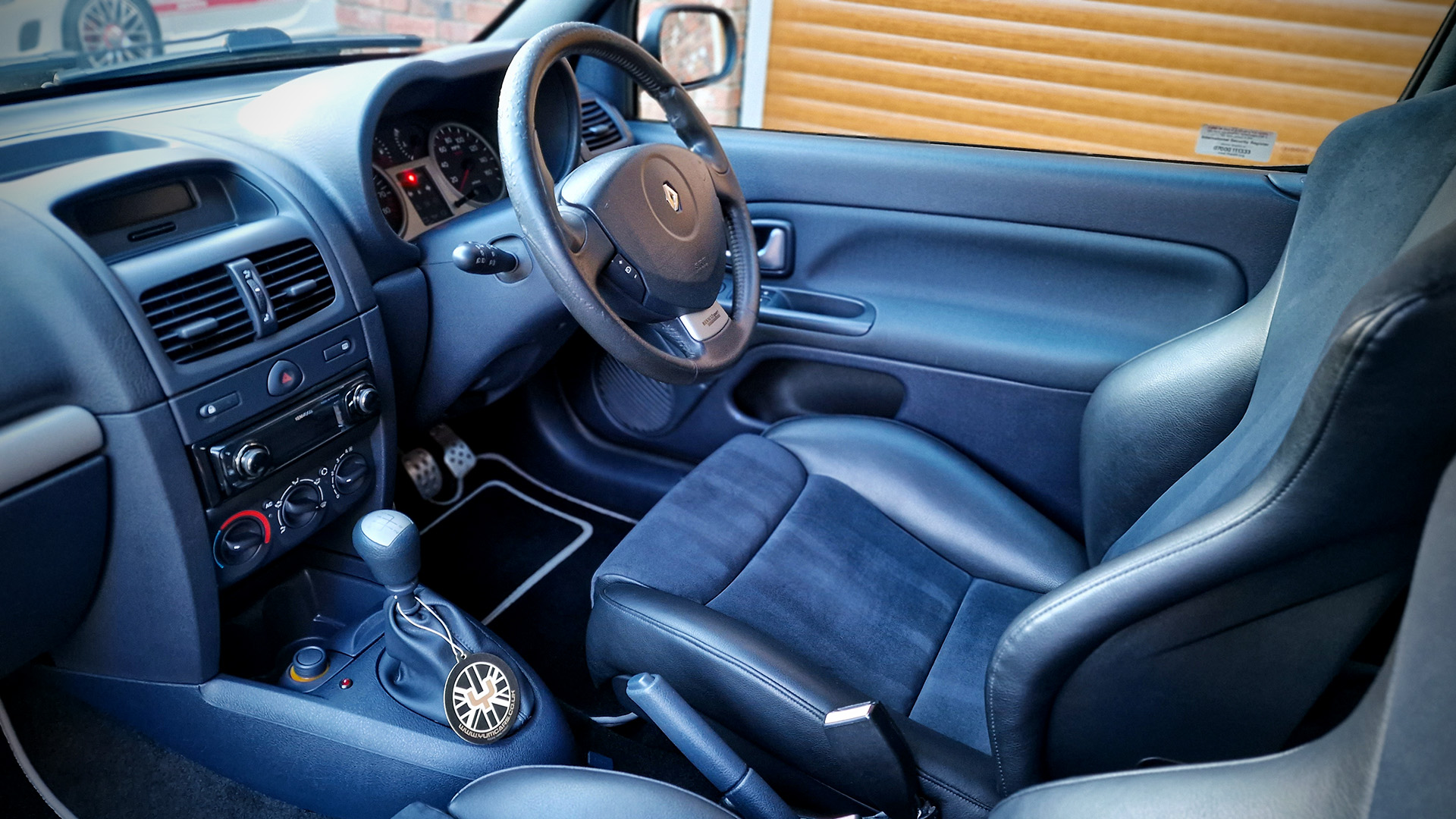

The interior got a bit of Sharky-loving as well. To be honest, it doesn't scrub up too badly for a 100k+ miler.
Replaced the number plaque as well due to the old one looking a bit worse for wear. No, it's not the original plaque spec/design but... pfft. Modified innit bro'.
