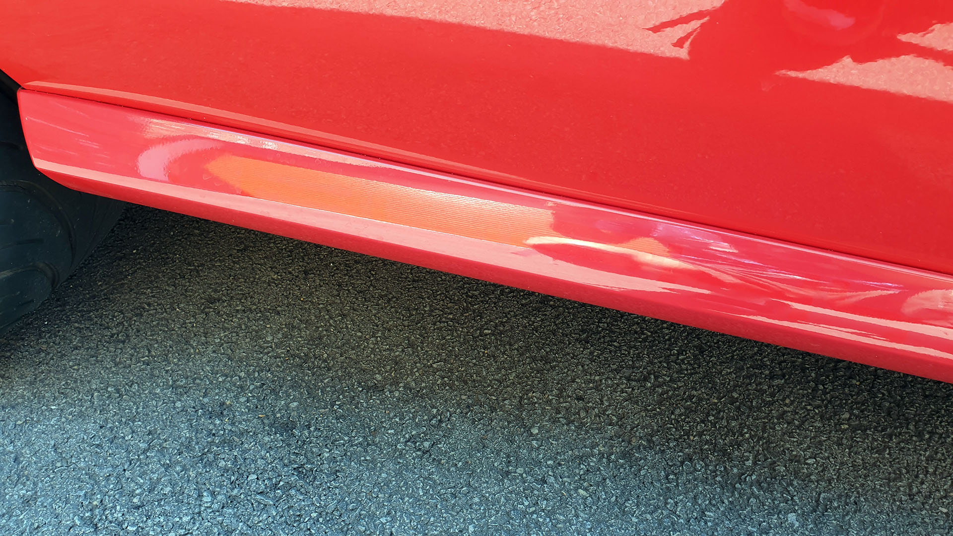

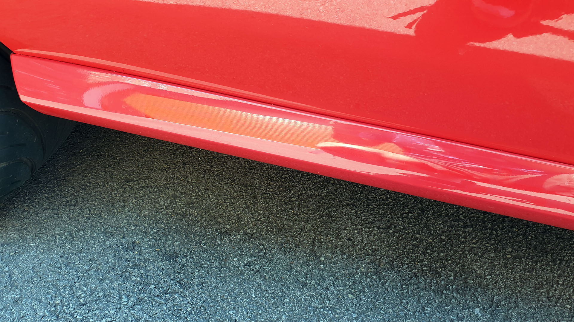

Don't polish the side skirts too much, the fading will make placing the new stickers so much easier 😂
I'm relying on them as a placement guide mate! I think I'll clean and apply the decal first, then be extra careful to correct and detail around them. 👌

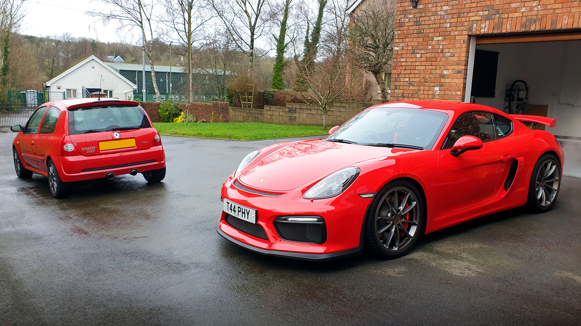

To start with I have bought a new plate. "T44PHY" will be staying on the Porsche, much to the dismay of quite a few people it would seem! I couldn't really find anything too similar (or, at least, for sensible money) so compromised on something slightly different. Or the same. And totally irrelevant and void of any particular meaning! :LOL: I'm sure it will become known soon when the change has happened and photos posted.

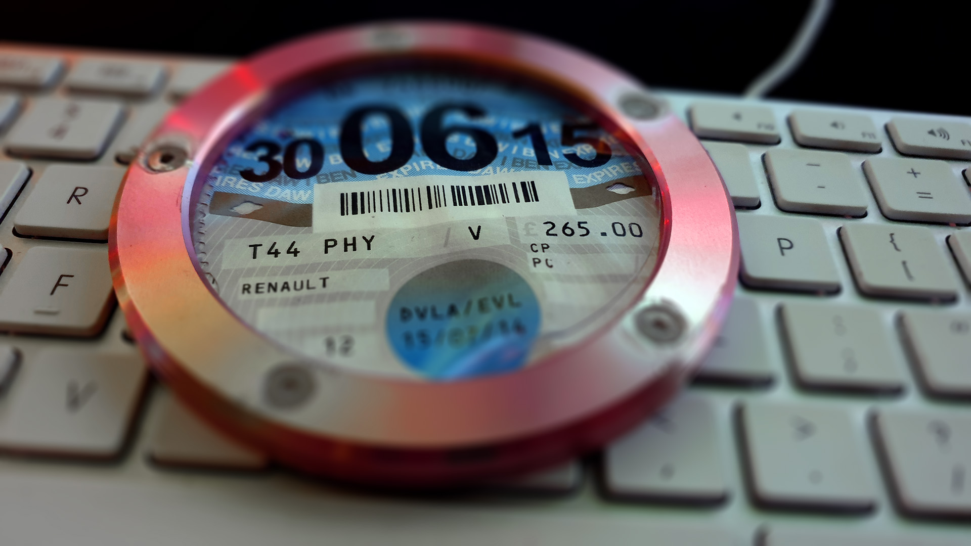

One of the BIGGEST things to happen recently, marking the end of an era, was the removal of the tax disc. I was tempted to leave it but ultimately decided it had to go. It made cleaning the windscreen easier, too. That tax disc alone gives some indication as to when I last actually had the car in my possession and was able to drive it. Briefly. Until it went tits-up again.

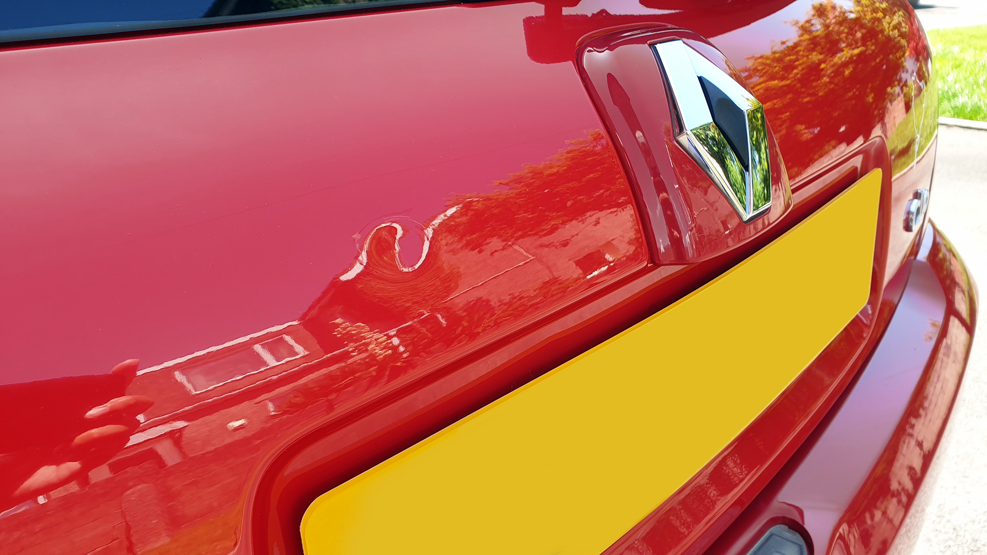

Having now spent some time looking at the exterior there are quite a few dents and dings that need sorting.
Well, they did need sorting but all is good now. The local PDR guys paid me a visit yesterday and removed the worst of them. It has made quite a pleasant difference. I can't get over how many different shades of red / pink there are on the tailgate though... :ROFLMAO: Talking of the rear, I did find that my spoiler has cracked / split on the right side near the fixing points and the boot struts were not stopping the boot short of fouling against the roof edge. This must have been happening over some years now as the affected area has been scratched all through the clearcoat and well into the paint layer. There's not much I can do about that until I decide to get it resprayed (perhaps).

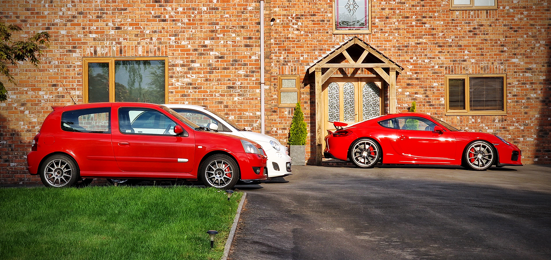

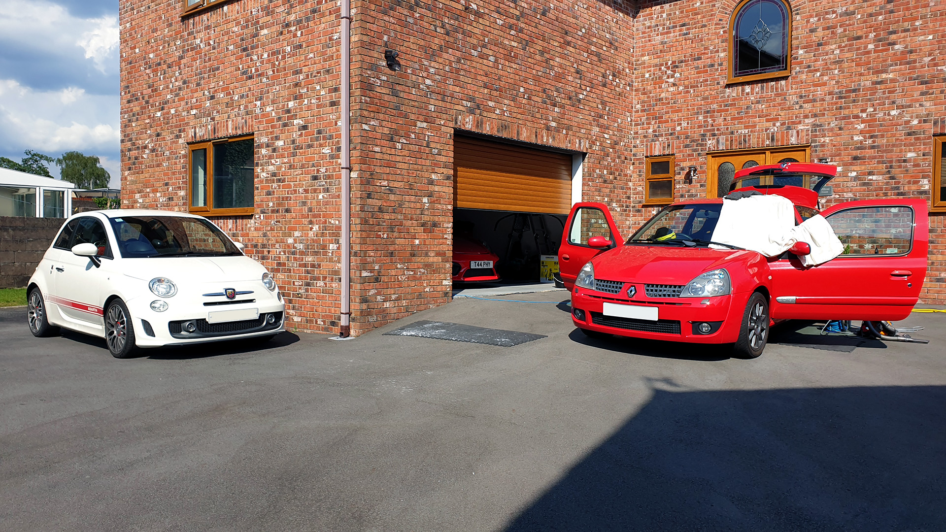

A quick shot of the fleet in the sweltering 32 degree heat. I'll state now that, in case you were wondering, it is not typical of the Welsh weather.

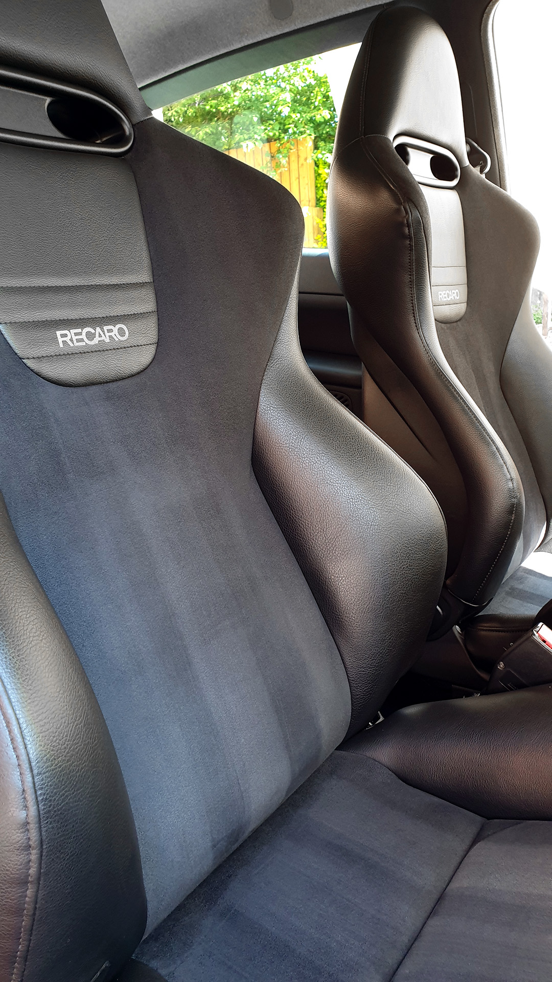

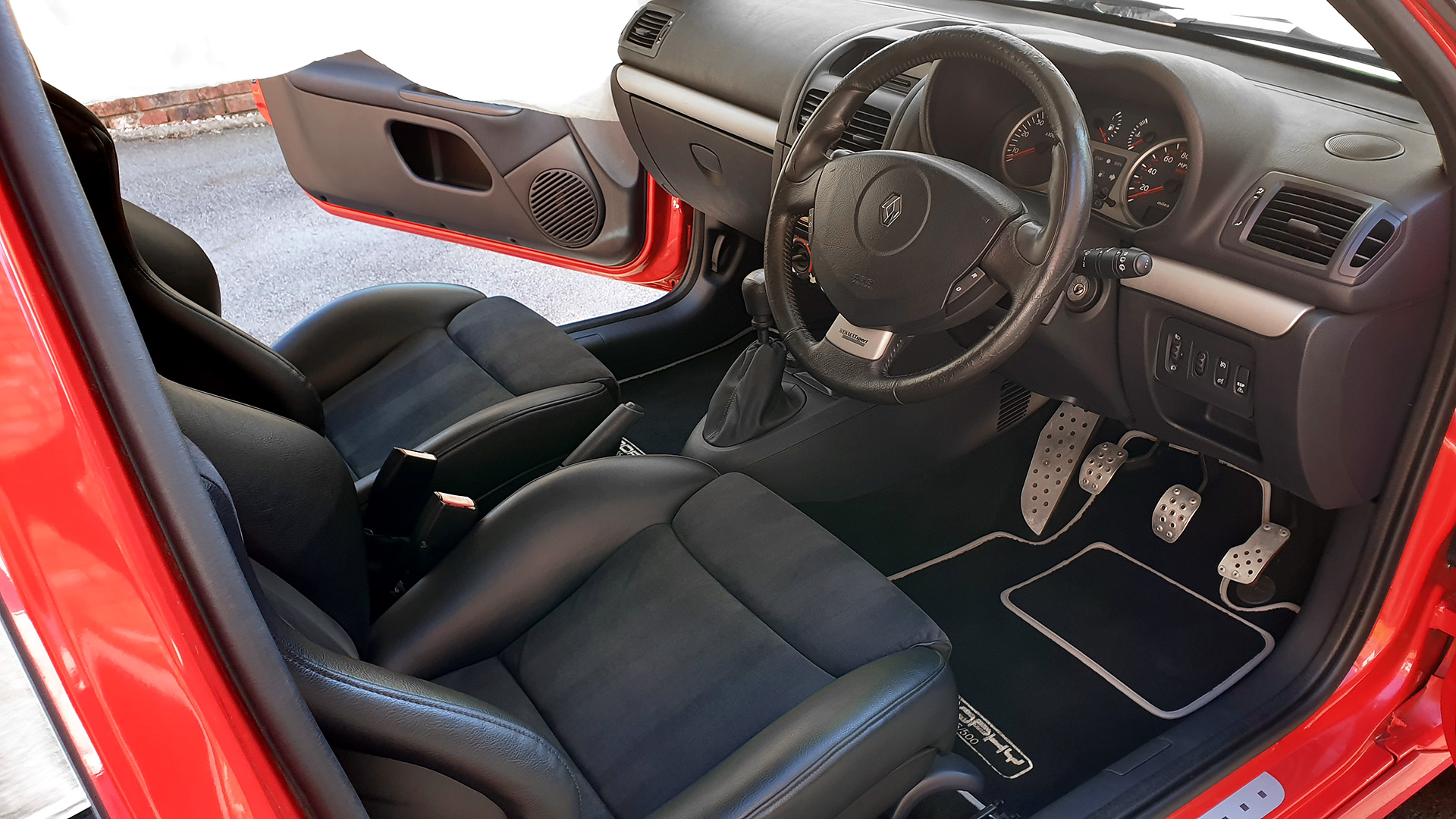

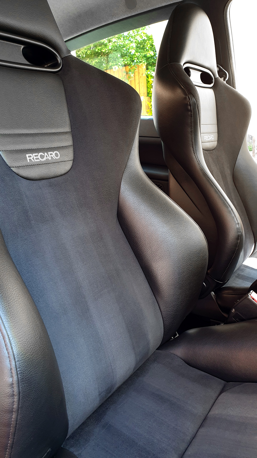

As can be seen in the pic above, I had to break-out the dust sheets to offer some level of protection from the sun whilst I worked on deep-cleaning the inside. It took a while as there were stains on the seats, oily fingerprints on the headliner, excessive dirt on the touch points, snail shells in the carpets, gunk and smelly s**t in and under the rubber trims... it was grim! Thankfully Mick had given it a quick going over and got rid of some of the crap for me (and he kindly got a valeter in prior to that to give it a quick going over).
The steering wheel is melted (no surprise) and will be refurbed, and the heater panel fascia is flaking and will be replaced. After some serious elbow grease and discomfort the inside came up quite nicely. The boot area is now clean and stain-free, as is the cabin. The rear bench seat is pretty decent too and the Recaro Trendlines have come up beautifully. No rips, no tears, no blemishes. Just a few scratches on the rear plastic backs of the seats where things have rubbed against them during... well, during whatever happened in the time before it arrived at Mick's.
In truth I was feeling a bit deflated recently as I had really wanted to get on with sorting #165, but the rib discomfort and lack of sleep was getting to me. The excessive heat didn't bother me too much but it still was draining. Then, out of the blue, I received a fantastic gift from a good friend on here - with this lovely piece of artwork very kindly crafted by his daughter. Honestly, it made my day. And then some. A totally unexpected letter through the door, but an extremely kind and generous gesture and a very welcome pick-me-up. No lies, I was cutting onions at the time. True story... :unsure: Again, thanks for this wonderful drawing.

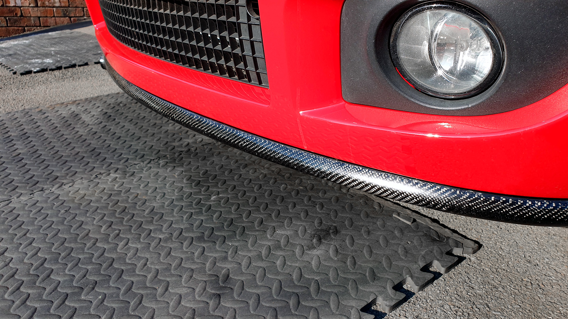

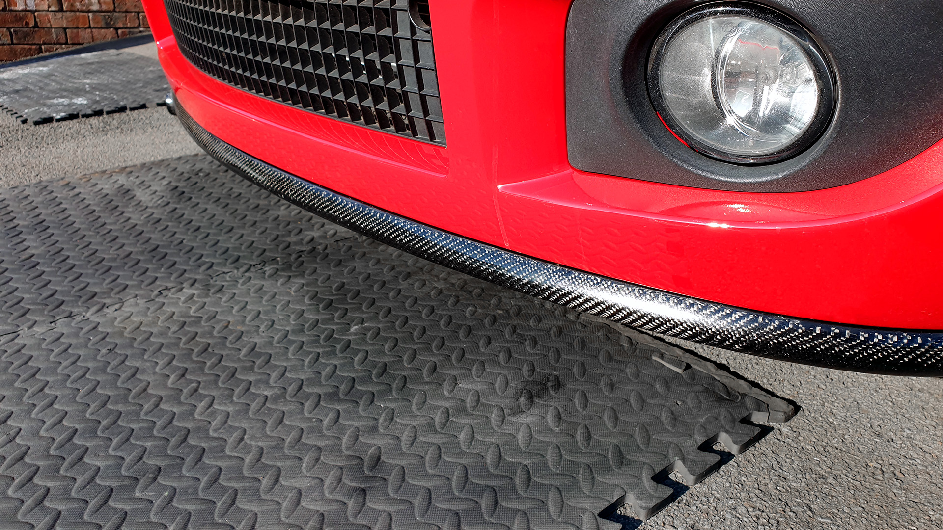

Erm... what else...? Ah yes, I decided to finish off refurbing the carbon splitter. Wet and dry with 800 grit, 1000 grit, 1200 grit, 1500 grit, 1800 grit and then DA rotary polisher with compounds and polish to finish it. Once that was done it was given 3 or 4 coats of clear lacquer and the result was as pictured below. It's still not perfect, but it looks a LOT better and helps freshen up the front end!
Talking of freshening the front, I also gave the headlights another quick going over to remove some of the fogging / clouding but I think I'll get new items in the future.
The only other thing of note right now is that I removed the old 'Ring stickers and my old car club stickers. and also removed the damaged and faded side Trophy decals on the skirts. I have replacements that will be going on once I have had a go at correcting and detailing the paintwork. 3 hours. THREE hours to get the decals off! Despite the 32 degree heat, and the use of my better half's hair dryer, the glue just would not relinquish its hold. I was worried about scratching and even warping the plastic due to the heat I was directing towards it. Another 30 seconds and the decals would probably have burned and become ash! This pic doesn't show it too well but you can see "TROPHY" on the side skirts in the car's original colour. :LOL::ROFLMAO: To be fair, they haven't faded too badly!

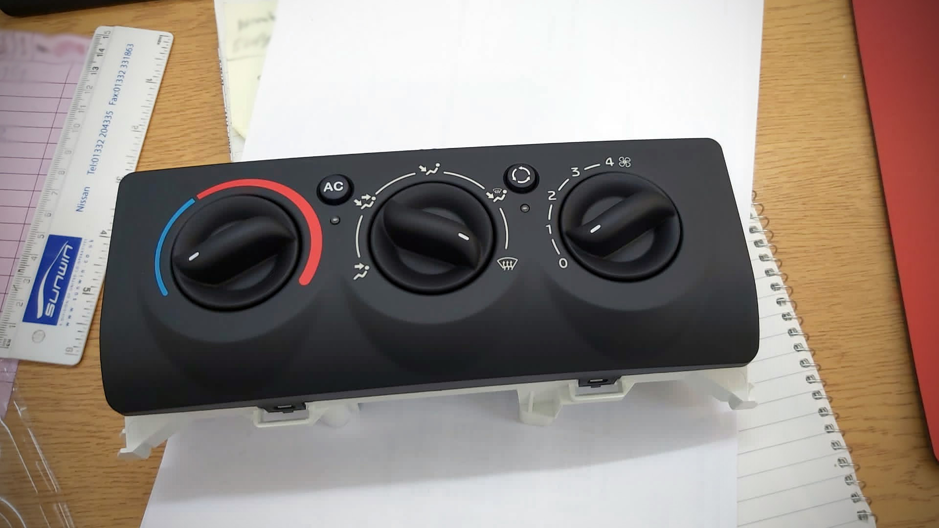

...and that immediately backfired. Having bought two spare heater control panels (with the manual AC button, poverty spec, for the Trophy) I'd never actually opened them before. And I've had them for years. Imagine my surprise, and annoyance, when they both turn out to be the wrong items and have no AC whatsoever. FFS. I can't really go and ask for a refund seeing as I've had them for 6-7 years sitting on a shelf. The problem with getting a replacement is that they are hard to come by and are no longer available. Hmm. On the off chance, Mick made an attempt to get me a brand new one from a contact in France (even though no longer available) and they found one in stock. Brand new. Unopened. Unused. Bonus. But at £210 (give or take) my ar$ehole is still stinging.

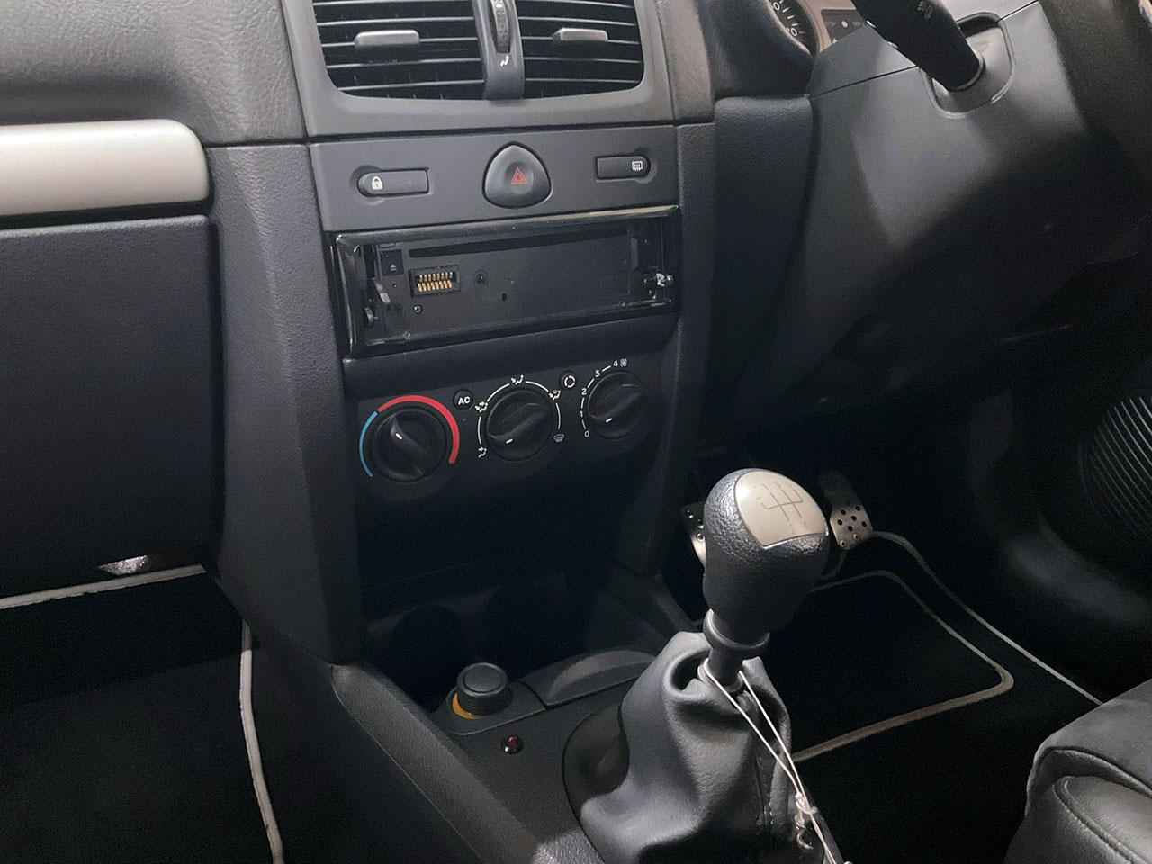

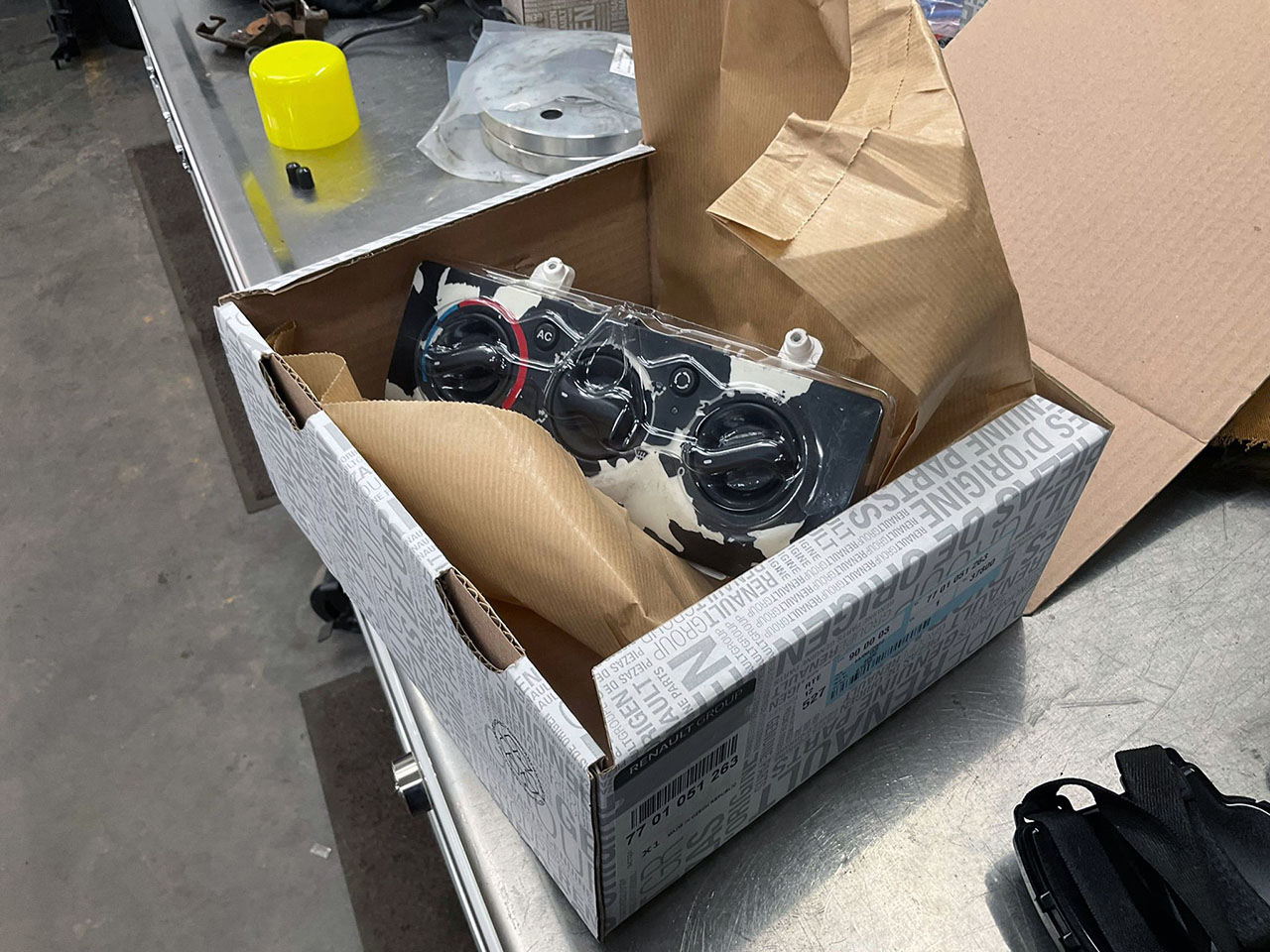

Joking aside, the old and flaky heater control panel is now out...
...and the brand-spanking-new panel is in.
It was hard work... instructing Mick (Diamond Motors) to do the work for me. He came through as he usually does!

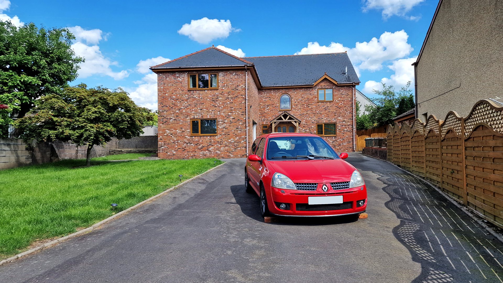

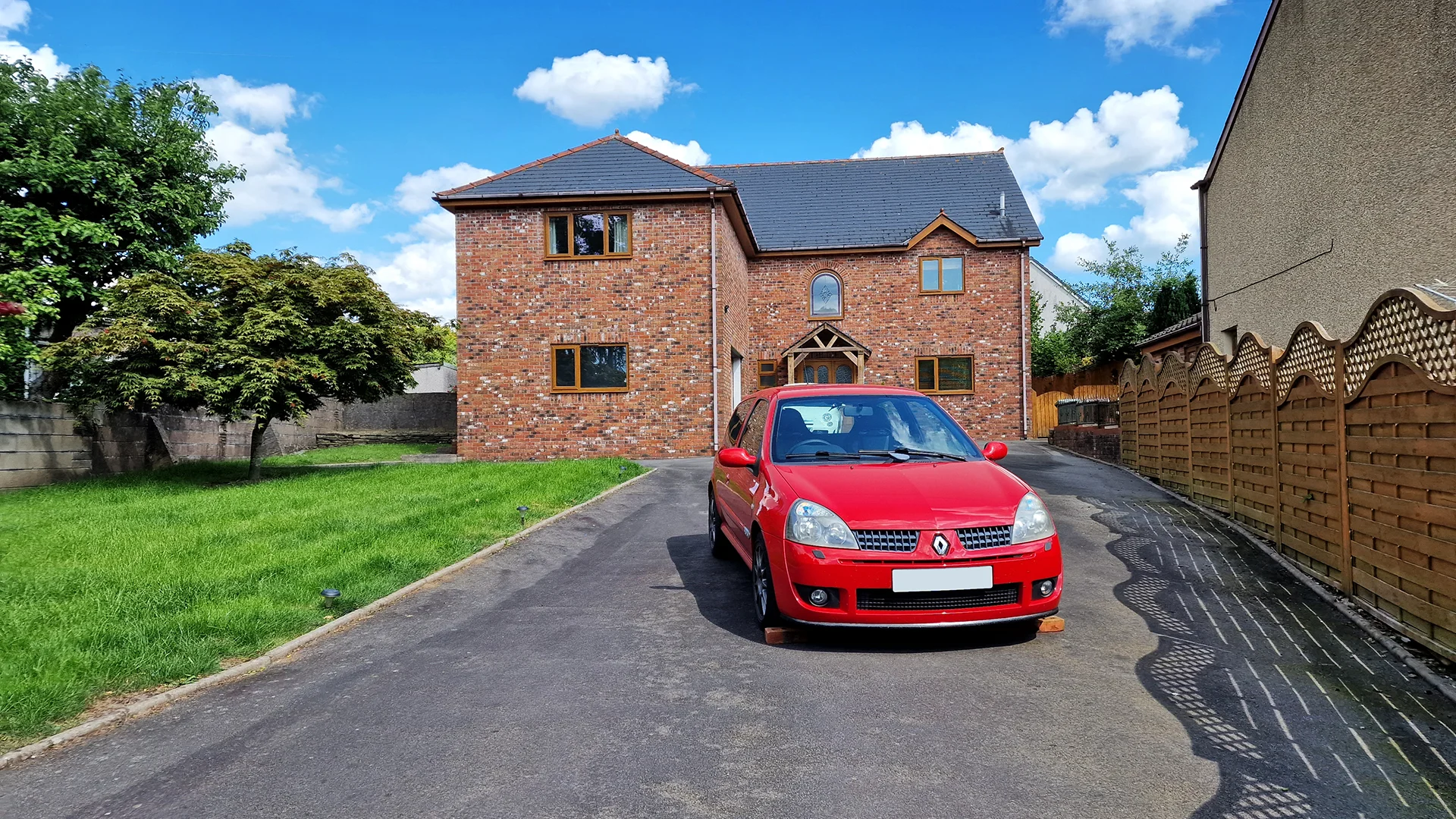

UPDATE // 24-JUN-2022

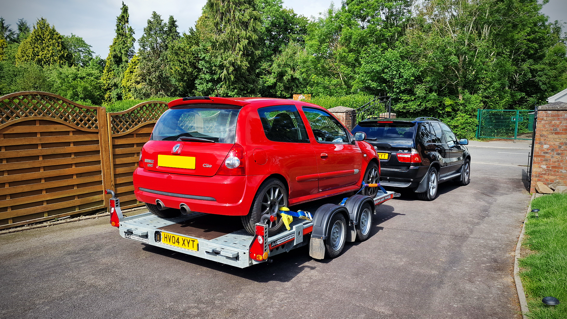

And, once again, #165 returns home! Fingers crossed that the engine loom niggles have been sorted for good (or a good while at least). I'm hoping that I can make a start on tidying it up a bit now as it really does need a bit of TLC to get back to a standard I'm happy with. Given the neglect and lack of care it received whilst in the hands of a certain specialist I'm surprised it has held up as well as it has, but here we are and I'm looking forward to cracking on.
Again, a massive thanks to Mick at Diamond Motors for sorting Le Clio B*stard Rouge's latest round of niggles and a massive thanks to @Daniel for transporting it to and from Mick's workshop. Thank you, gents. :)

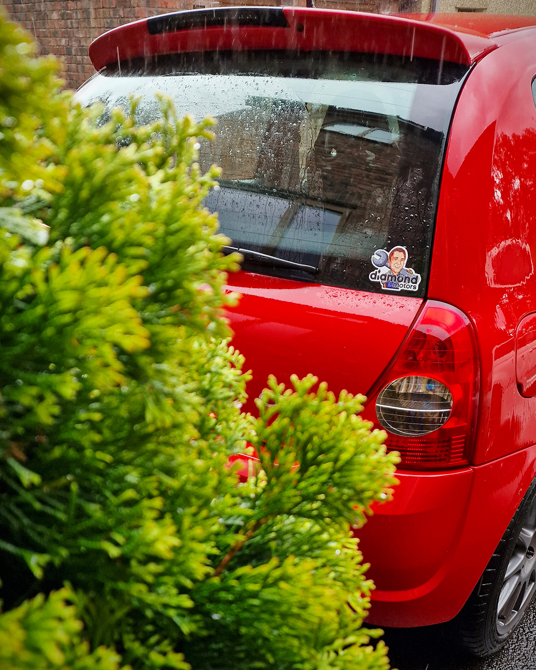

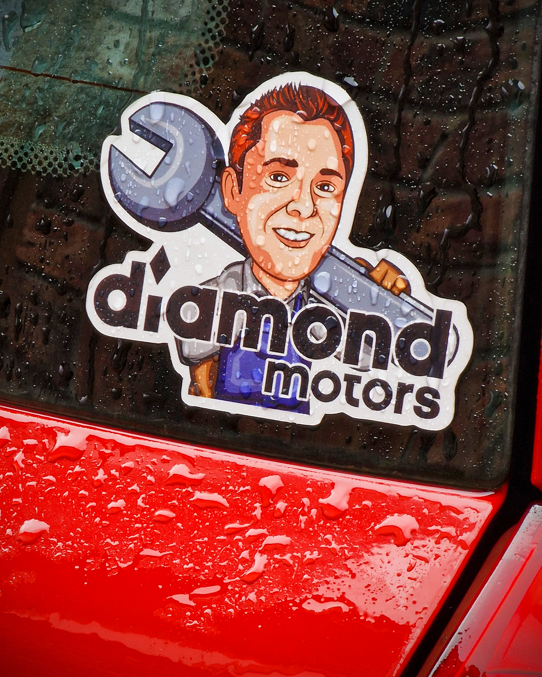

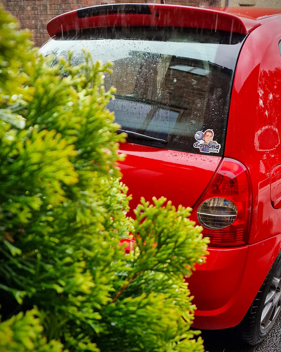

I also noticed an extra little modification that Mick carried out for me whilst the car was with him. Easily an extra 8bhp.
:ROFLMAO: (y)
