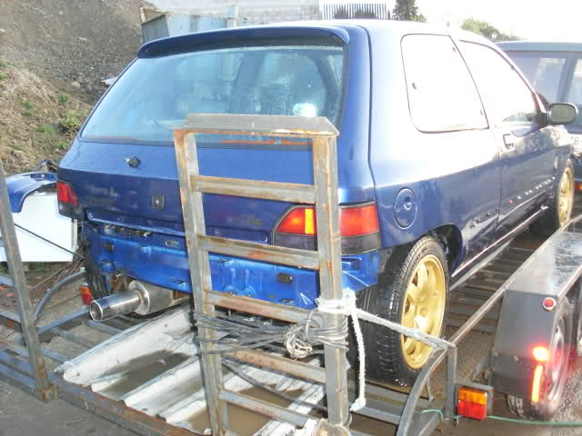

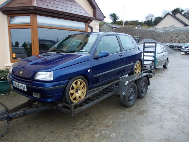

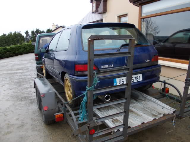

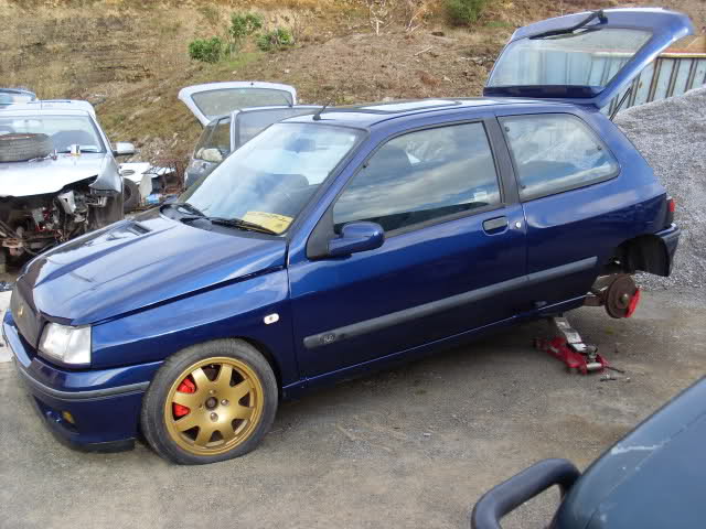

Bought this on the 23-01-12 up in killkenny,Ireland(2.5hours each way)
It was my first MK1 Clio
Its a 1995 Clio Williams 3,
Brought in from england in 2005,
The uk reg was n490 gbw / n490gbw (anybody know anything about it??)
Only 103,000 miles on her
Hasn't been driven in two/three years
Thats how the car looked when I brought it home.

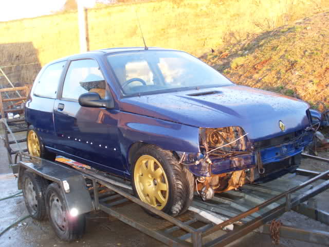

Emptied out a shed at the grandmothers so I could work on the car out of the cold/rain
Ripped the engine out the next week to do the timing belt,alternator belt and water pump.Got a Rocker cover gasket too.

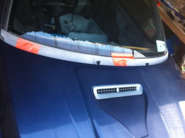

Went spraying parts then to have the car looking nicer

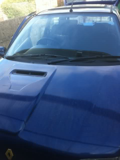

  1. [*=center]I resprayed the bonnet vent and scuttle panel in black.

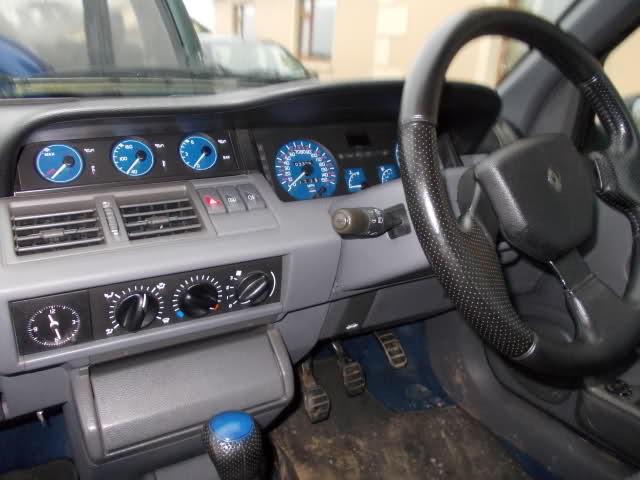

    [*=center]About 55% of the interior bulbs were gone so changed them.
So when I went to the garage today I put all the interior back that I had out from the bulbs.

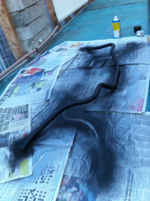

I sprayed the black cover for the engine mount,the inlet plastic cover,
I've these given 1 coat now, must give them another coat in the morning

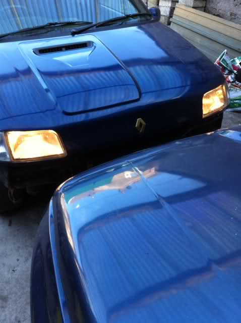

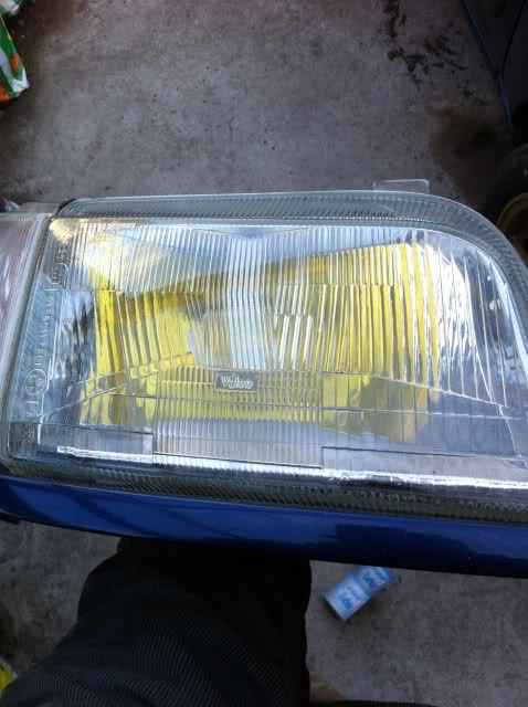

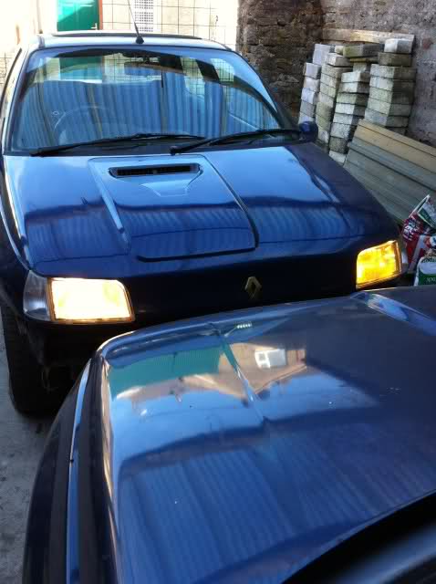

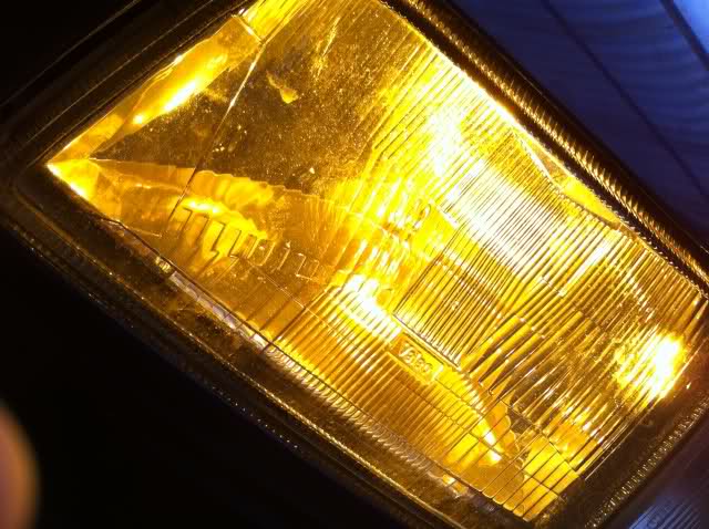

Original headlight bulbs:
New dims..(well technically dim ;) )
Here's what they will look like during the day with no lights on.

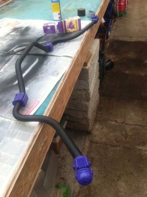

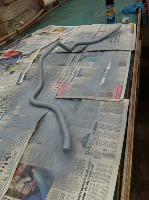

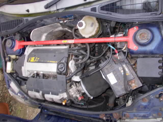

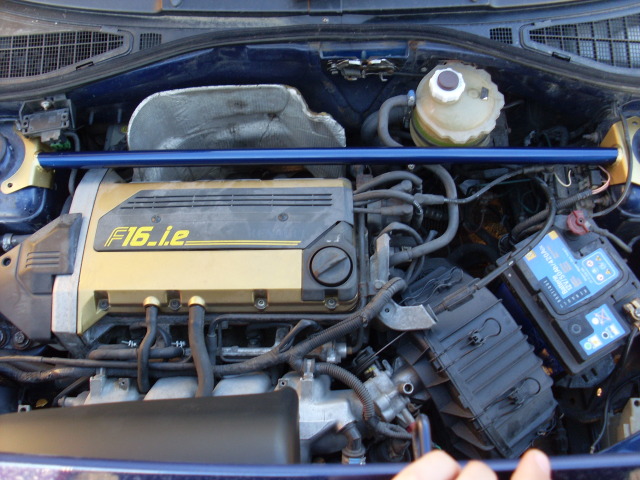

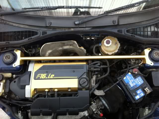

Resprayed the omp strut brace,
Didn't like the gold though .....
I thought it was too much.

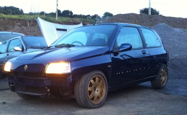

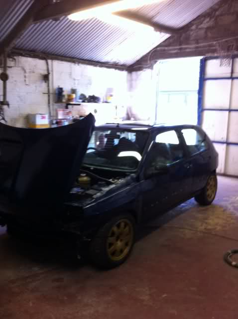

Brought the car up home then to go in for a full respray,
Then at the resprayers,
The car was gone for 3 months then....

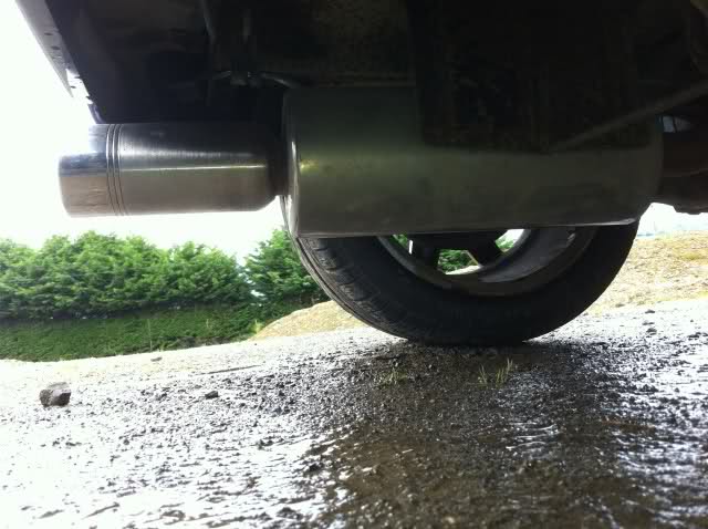

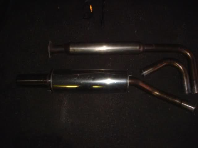

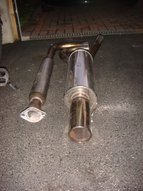

It's a blueflame SS exhaust(2K miles done)
€437 + postage new...
Bought for €50:D
It looks pretty much the same as the exhaust that came with the car?
The tip is slightly different though...

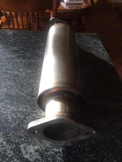

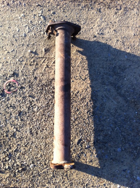

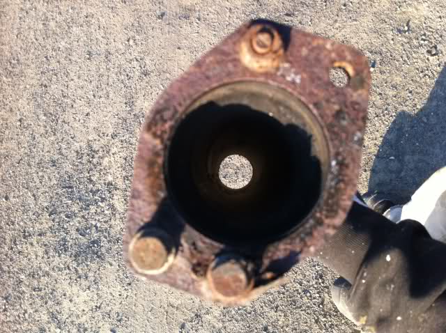

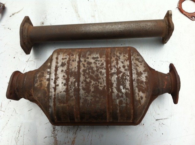

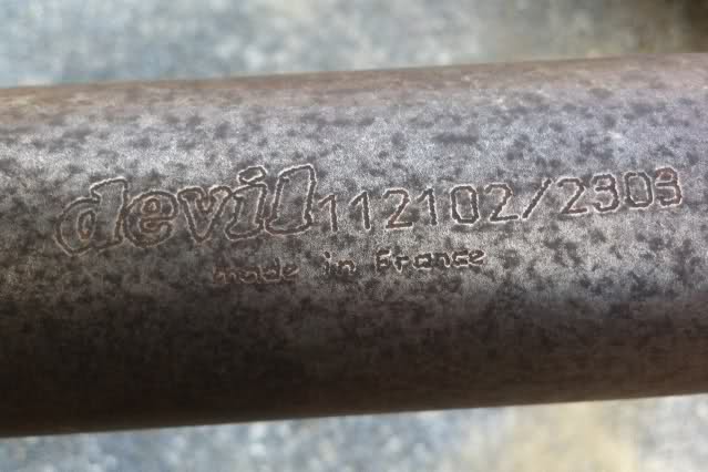

Got this off a friend in Meath(Ireland) then,
Swapped him 172 parts for it.

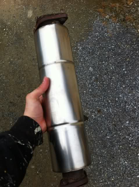

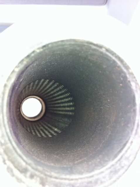

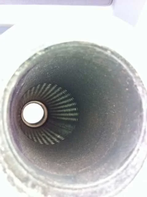

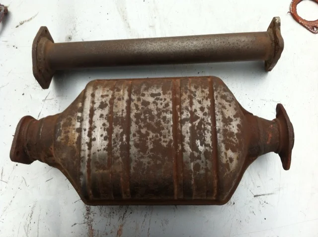

I thought it was a homemade decat but it's actually a "devil" decat.
It's modded so it will fit 1.8/2.0 down pipes.
Devil made the "group N" rally exhaust systems!!
I have a sweet silenced decat I got with my valver but it won't fit
Pity as they are expensive to buy

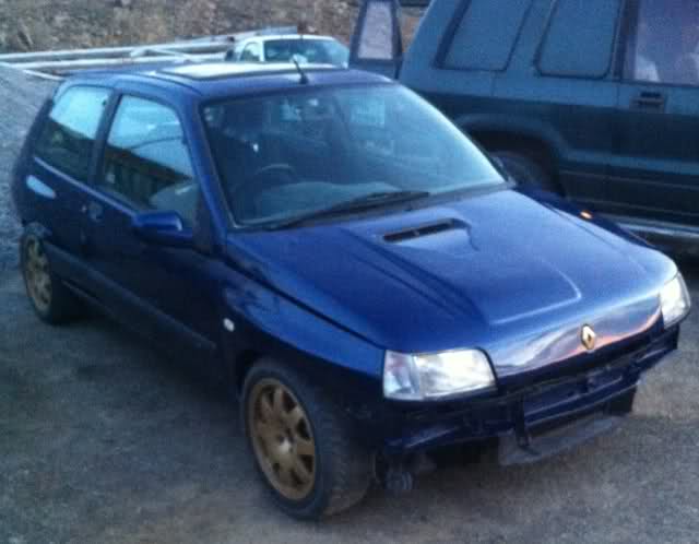

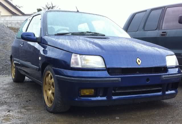

Got the car back from the respray,
The next day,

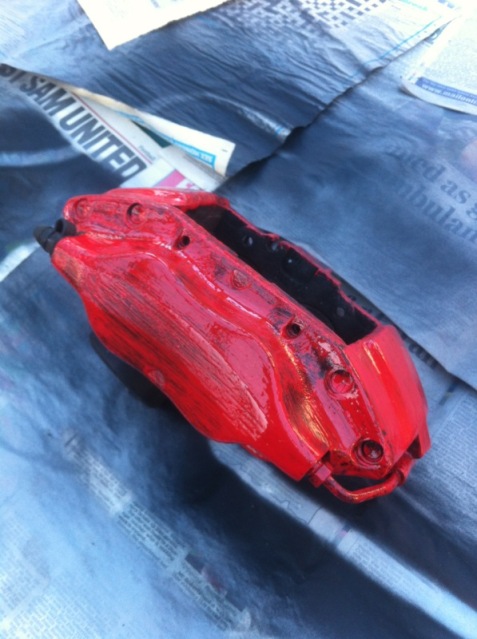

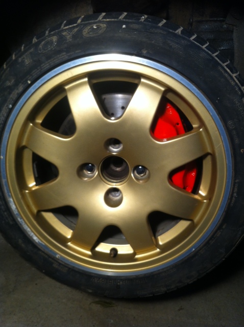

Painted the brake calipers,

Decatted the car straight away.

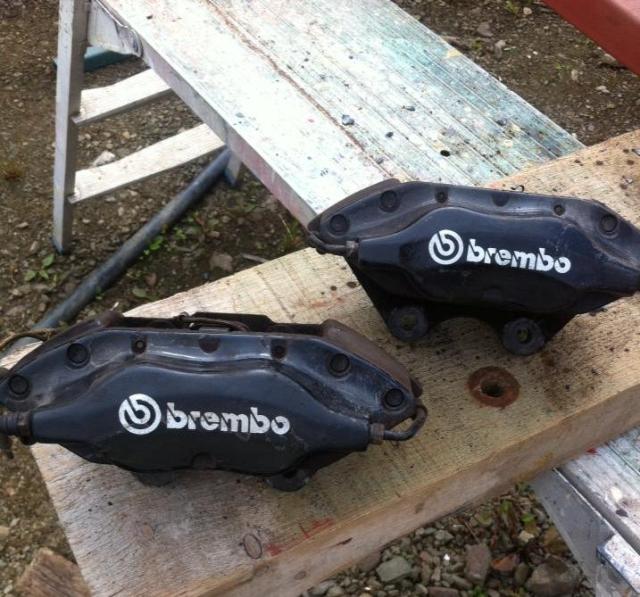

  1. [*=center]172 rear calipers and 172 handbrake cables

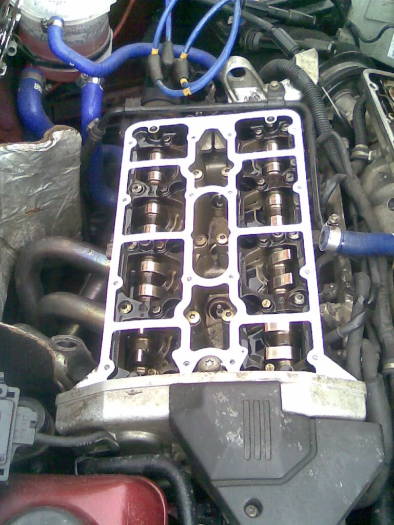

I begain stripping the car to fit new gaskets :)

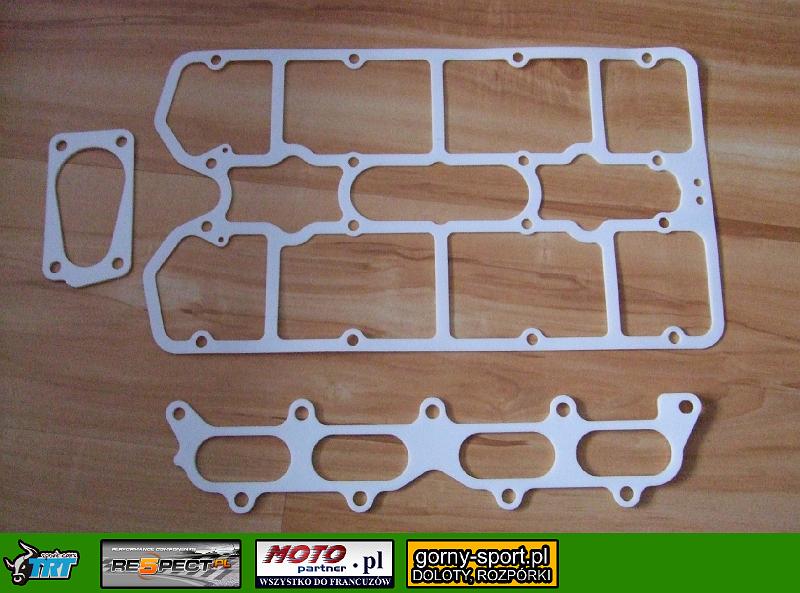

Got these off my main man 16v_paddy.
These are PTFE gaskets(reuseable unlike Renaults paper gaskets :evil: )
The rocker cover gasket at Renault are €42 trade price :eek:
So bought the rocker cover,throttle body and inlet manifold gasket for €93

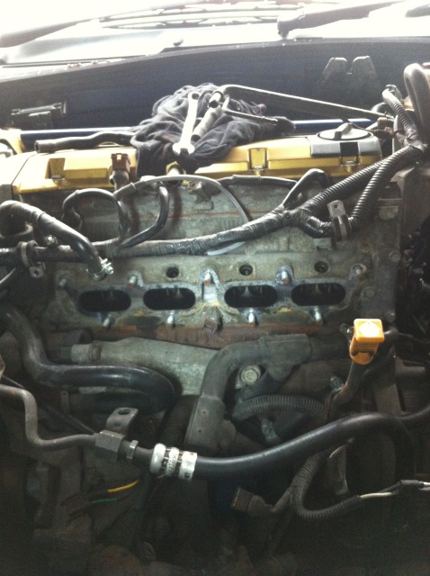

To get the inlet manifold off was a pig of a job!
I needed to remove...
Bonnet,radiator,alternator,coolant pipes,injectors,loom.
The bolts underneath were a right fecker to get at with the power steering.
I should of removed it but I didn't want to be cleaning it up.

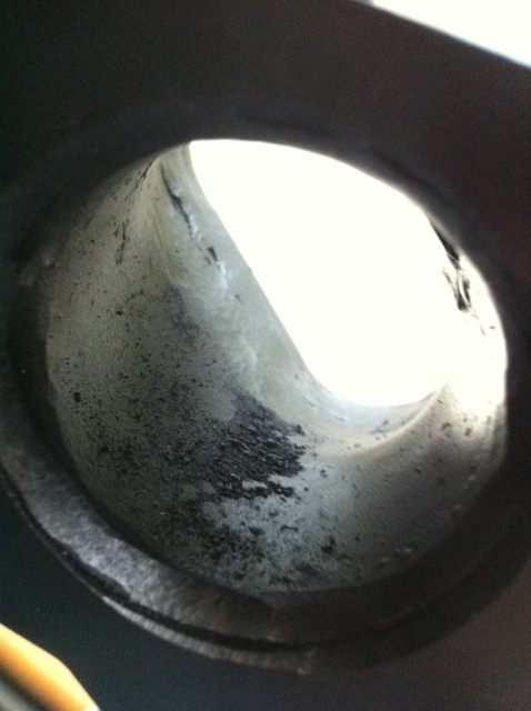

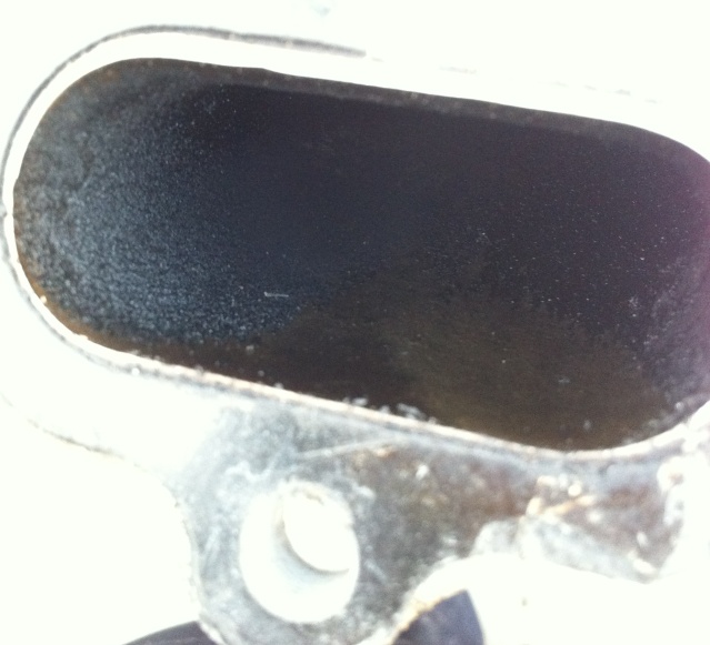

The inlet:

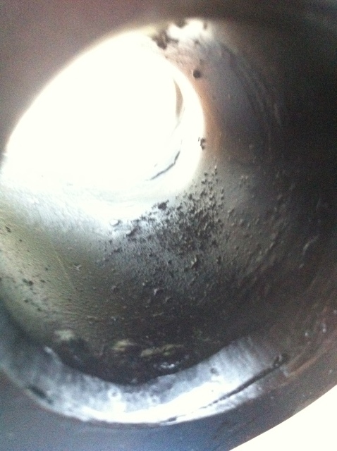

I cleaned the inlet out with "gunk"(from halfords)

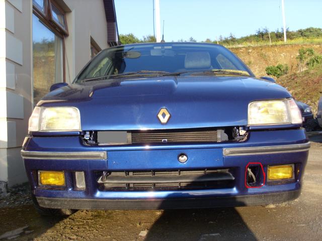

  1. [*=center]Fit a front cold air feed pipe to the front bumper
(Where the red circle is)​

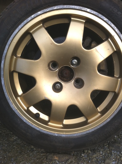

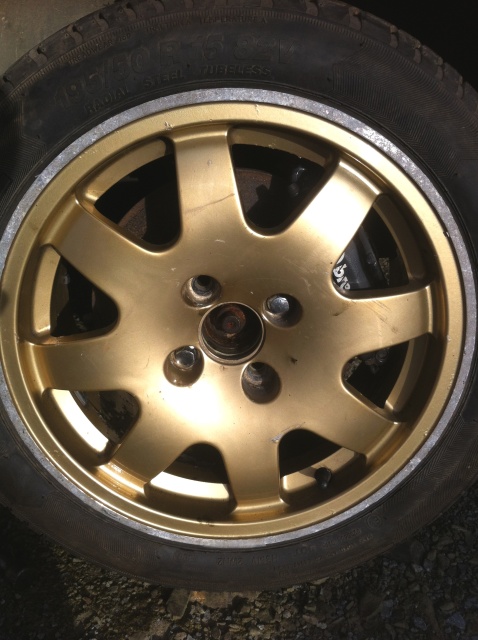

  1. [*=center]Get alloys resprayed or powdercoated

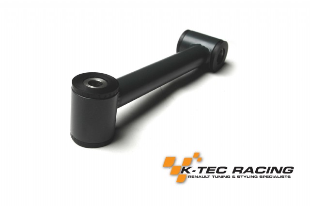

    [*=center]Fit a 4th mount from a 172 to it(I have it ready to go on)
(never came fitted to MK1 Clios)

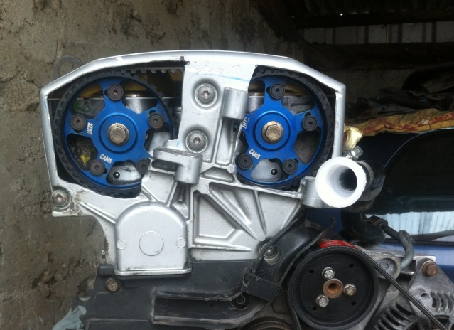

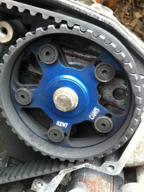

1,Kent cams
2,Kent vernier cam pulleys.

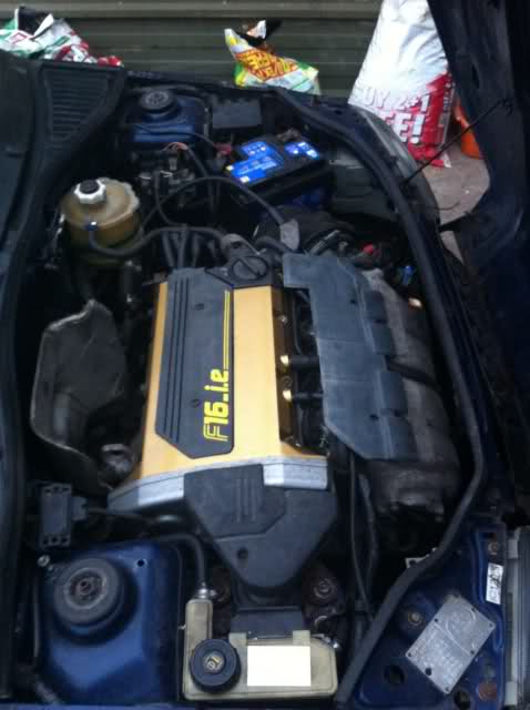

I think the biggest change I made to the car is the engine bay since I got it...
From this....
To looking like this before I started ripping it apart for winter...
Well thats my car 11 months on :cool:
The only thing I'm not sure on is the strut brace...!?!?!
What do ye think?
Or any suggestions on a colour?

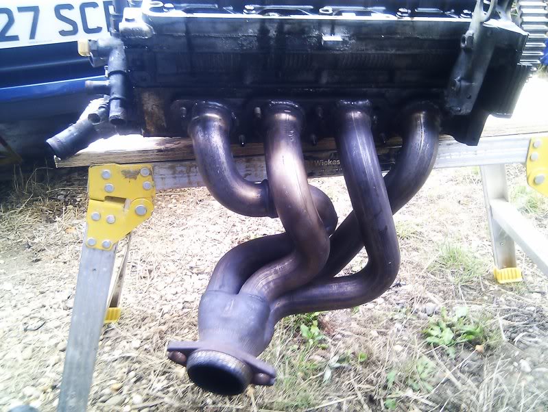

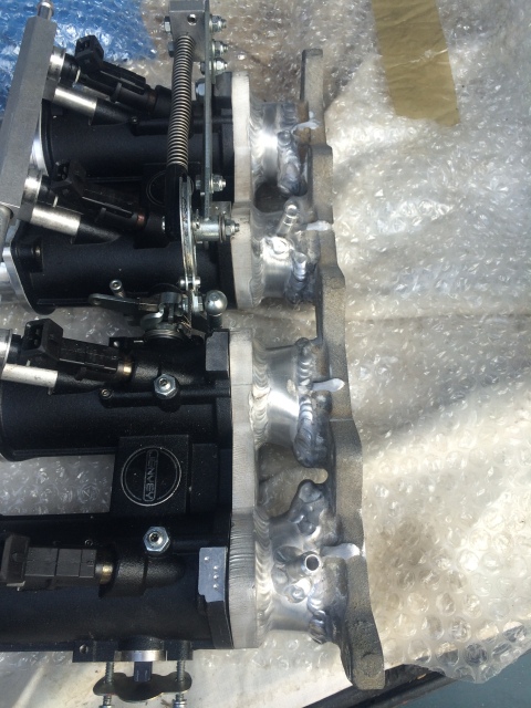

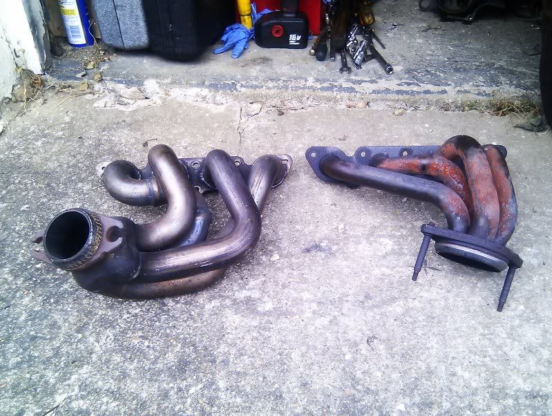

Started making a newish exhaust manifold for the car :)
Its a 172 manifold with the flange cut off and a williams flange welded on.

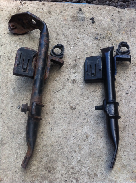

Here is a picture comparing the two exhausts,
On the left is a 172 one.....on the right is a williams one.
I have the willliams flange on a 172 manifold currently "tacked" together(spot welded)
Must get it properly welded though.

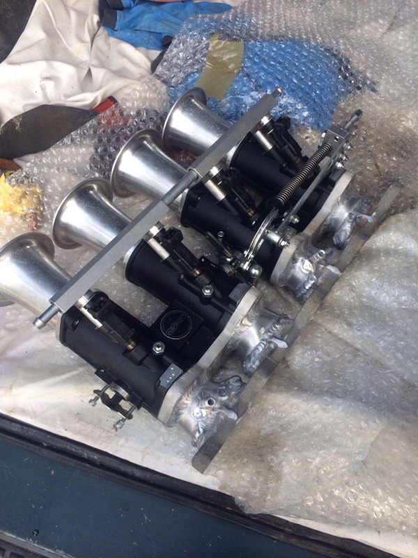

March 2013:
Can anybody say.....
Bbbrrrraaaaaaaaaaaaaaaaaap

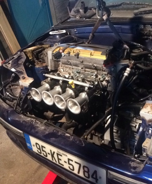

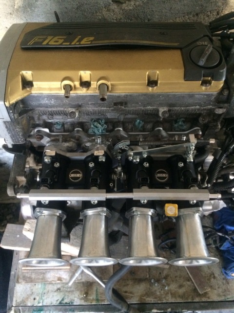

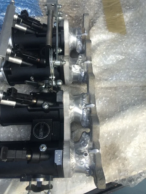

45mm Jenvey throttle bodies bought :)

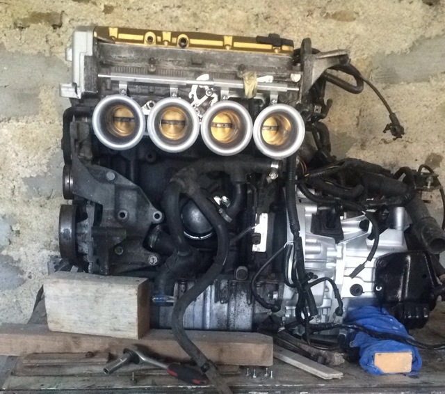

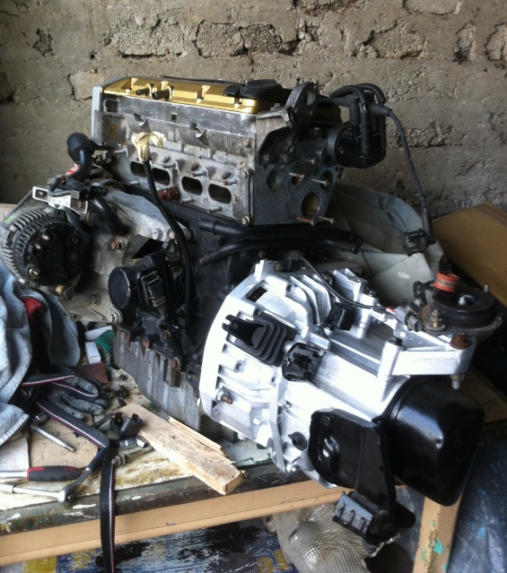

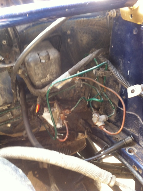

Ripped the engine out monday(25th)...
Had a bad day....
I forgot to rip one of the coolant hoses.........that goes into the heater matrix
I broke that.....so dash out job:mad:

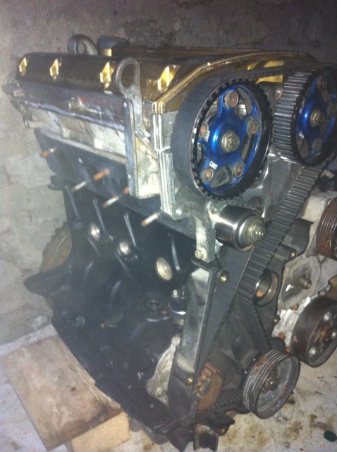

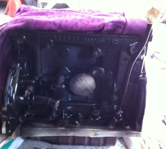

Went up to Galway,Ireland(2hrs drive each way) Monday night for a 2.0 Williams engine
Got a text about it at 5.....I was out the door at 5.55 lol!!
Made my day seem better anyway.

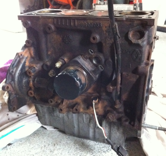

It was a bare engine(head split from the block)
The owner bought it for a spare from a rally car.
Was kept in a shed for 4 years!!
He had a sweet V6 Clio(first time ever seeing one ) and a Williams
Found out 2 days later that there's racing cams in it ha ha

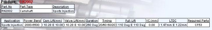

Piper 270's(pretty similar to my Kent Rn2002's)
Just cams no vernier pulleys though
Looking a bit rusty...
So I bought some Holts engine paint for €9
First coat of paint,

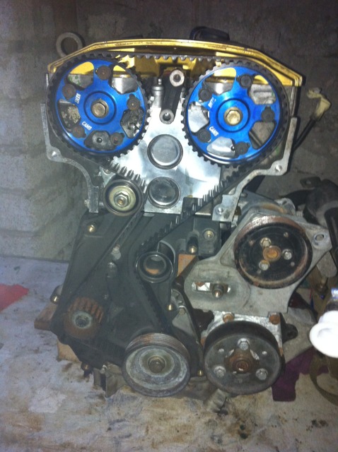

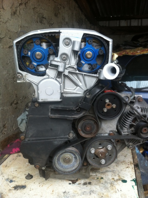

Then last Friday(the 29th) I got a friend/Renault mechanic to do all the gaskets in the engine
Found nothing in the oil pump
Found that the valve springs in the head....were doubled :evil:

So I've all the auxiliary parts on the car now :)
The original alternator had 1 external fan to keep it "cool"..
The new one has 2 internal fans :win
(for anyone that doesn't know about alternators....internal > external)

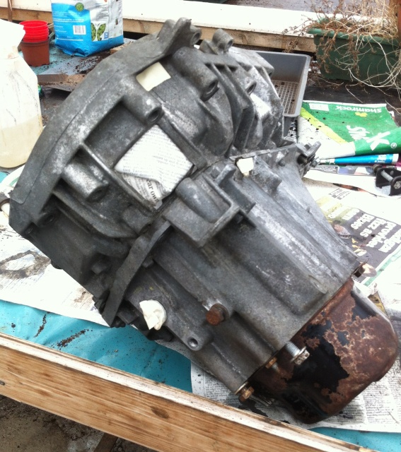

Since the engine was painted...

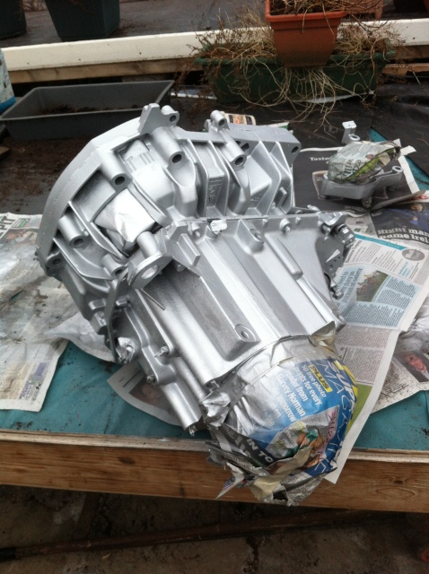

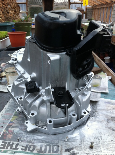

The gearbox was looking a bit grubby :(
(This is a gearbox from a PH1 172)
(Ph1 gearboxes have longest gear ratio's out of the Clio range(MK1/MK2)
(PH2/182's have shorter ones)
(this is after the gearbox has been washed/cleaned :( )

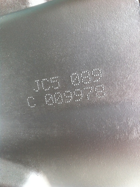

Gearbox model is "JC5 089" :)
(089 is the ph1 part)

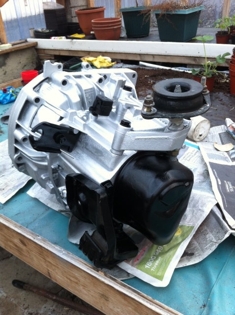

Doing a couple of parts black
(4th mount,clutch release arm, box extension arm, the "end cap"(end of the 'box in black/rust in the first picture)

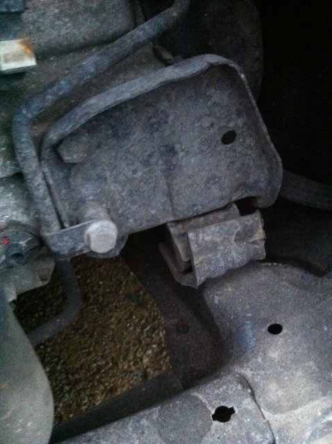

Finished the gearbox :)
(Also added a new mount on the gearbox)
(Never came with mk1 Clios)

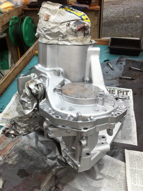

I MIGHT..... of got carried away with the spraying :D

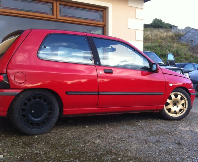

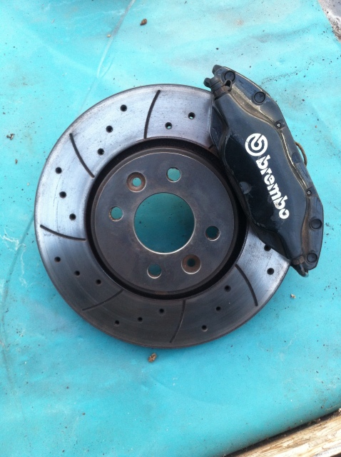

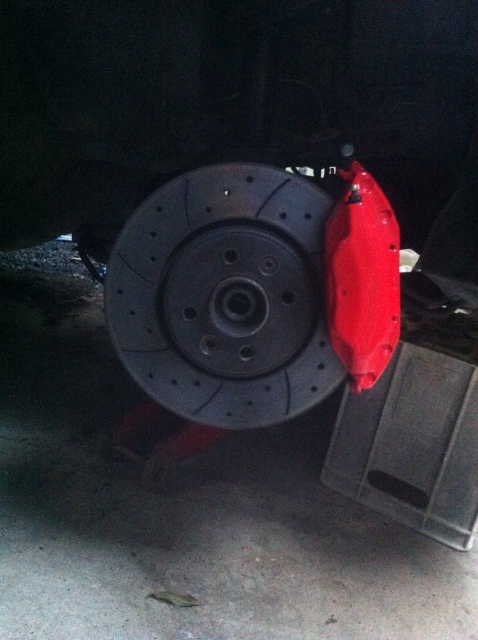

Also I should be fitting 172 front brakes this week or next week :)
(280mm vs 259mm)
(max under 15" alloys is 285mm)
Bit of work getting them fitted but cheaper then buying bigger brakes from the uk.

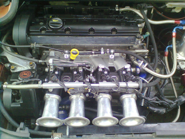

I bet that's going to sound immense. I know my Williams with the just the feed removed from the airbox sound good on full chat.
Re: The litte willy that swam across the water...
Brilliant mate, always love seeing older projects being restored!
I'd love a williams.
Great project mate, will keep an eye out for progress
Thanks lads :)
Do you mean with the throttle bodies or the manifold??
Or both ;)

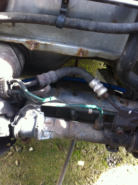

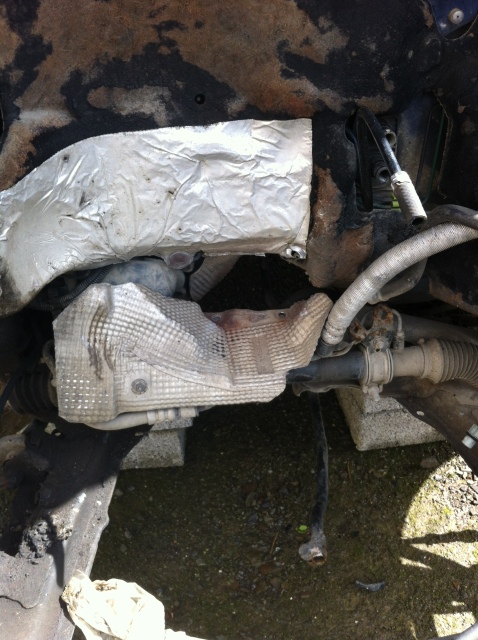

With the 172 exhaust manifold I'm making I need to make some room for it...
Would fit fine if I got rid of power steering...
But there's no fun doing it the easy way ;)

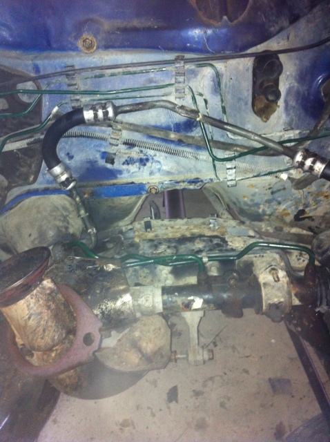

standard 172 manifold goes out between the sub frame and the bulk head,
Standard valver/Williams exhaust goes under the sub frame.
The power steering pipe is in my way for the 172 manifold :banghead:
What I did today was...
Get a megane 2.0(clio williams engine) power steering pipe(a bit different to the clio pipes)
Bent it a small bit so it fits behing the heat shield better)
Looks like I have to remove the clutch cable/mount at the back of the sub frame:(
So I've no idea what way I'm going to route it now:rolleyes:
(didn't really look yet..)
Or would wrapping the clutch cable in tin foil be okay?
Also need to use the 172 anti roll bar with the manifold.

Fitted a full 172 steering rack yesterday :)
It's a quicker rack lock to lock...
(172 is 2 and 1/4 turns)
(Valver/Williams is 2 and 3/4 turns)
(also no dodgy looking ps pipes ;) )

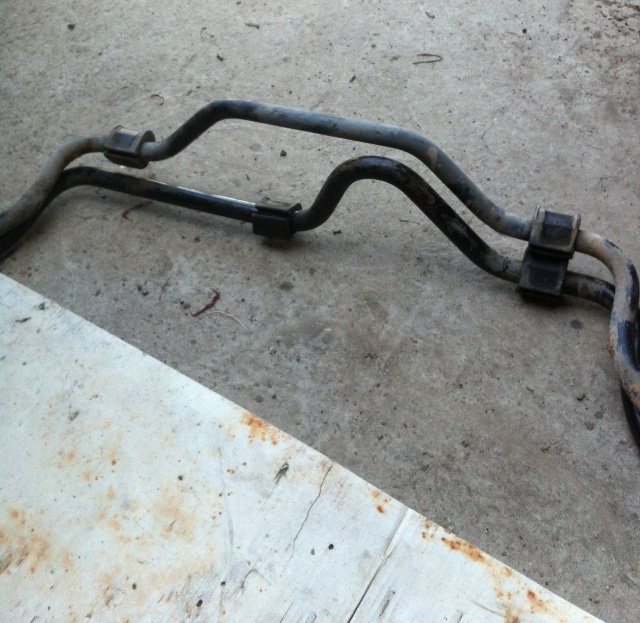

Also fitted a 172 anti roll bar,
The one with a "hump" at the back is a 172 one :)
Its 23mm thick(same as a Williams)
The last owner of the car removed the abs pump and just joined the brake lines where the pump was.
It looked messy though so I removed the abs brake pipes and the abs brake servo(2 ports)
They come out from the bulk head and come out towards the gearbox where they join each other.
I fitted non abs brake pipes and non abs brake servo(4 ports)
They look a lot better.they run from the bulk head and go to each arch :)

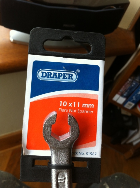

Since I was at the brake lines....wouldn't you know they started rounding :(
So I bought a "open spanner" I liked it so much I bought a second one the same size lol 2x€5 :)
It's twice as thick as a normal spaner so less chance of it rounding :D

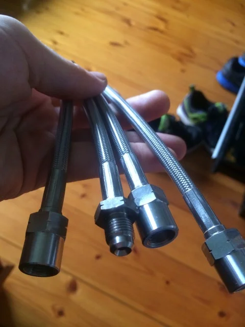

Got a front and rear set of braided brake lines for the car also :)
Didn't think the car had rear brake lines!!(non metal ones)
Fitted the rear braided brake lines :)
Last Monday I went to Cork,Ireland(45 minute drive each way) to buy a 2.0 engine and box :)
Turns out though it was a 1.8 :(
Bought a 2.0 jc5 williams gearbox with 67,000 miles!!

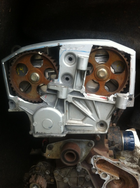

Cut my timing belt cover today :eek:
My thinking was for whoever will be mapping the car.........he can a just the cams whatever way they want.
Easier then taking off the timing cover in the engine bay anyway!!
Standard cam pulleys
Kent pulleys :)
Complete engine
I'm short 1 bolt on the right pulley :(
To get at it the engine has to crank/turn over.
(picture is taken TDC)
Can't cut anymore as the engine mount is blocking it :(
I love angle grinders:win
(not the sparks though!! :( )
Thinking about spraying another timing cover black for the car :)
Bought these a while ago,
Brembo 4 pots (4 pistons)
Wasn't sure to keep them black or go for red,
Going painting them red :)
Not sure to get a black or white brembo sticker!?!?!
Since my car is still in bits I wanted to see what they looked like so I fitted them to Conors Clio :)
After seeing them fitted I didn't like them black.
To fit the brembos I need,
Two 3mm washers where the caliper meets the hub,
15mm spacers.
I just took the spacers off the rear of Clios Clio lol, Thank god he is in oz :)
free spacers ftw!!
These are original 259mm brakes,
These are 280mm 172 discs,
I can fit 285mm(off a Renault 21 I think) brakes but I have new 172 ones so I'll use them for now :)

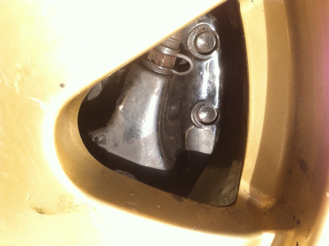

It's soooo easy to change the brake pads! I'd say you could change them in 40 seconds with the wheel off!!
Just pull out a pin, lift old pads out & drop new ones in. No need for taking the caliper off :)

Fitted the gearbox to the engine today :)
Also fitted a 172 starter and a metal coolant pipe tonight,
Tomorrow evening hopefully I'll get to fit the thermostat housing and also the coolant pipes(all the hoses are still connected to the thermostat so I don't have to find about 5 different hose's around the place ;) )

The pipe on the left goes from the bottom of the engine to the inlet manifold for suport..
Since I'm using a different inlet manifold I cut down a sprayed it black :)

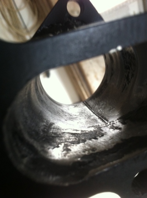

Sanded the inside of the inlet manifold today...
Before;
Its weld from the company that made it...
I thought they'd have it some bit clean before sending it out!!
After;
Looking some bit better anyway :)
Must get some smoother sand paper tomorrow to finish it off!
Took about 3 hours

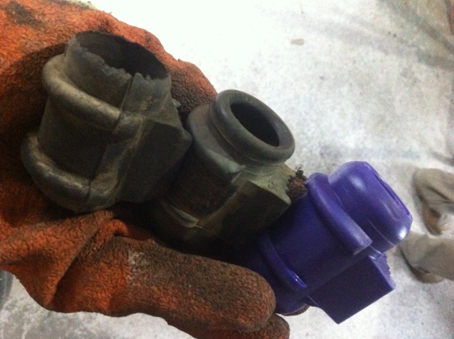

My anti roll bar bushes...
Williams - 172 - powerflex :D
Look where the bar fits into on the williams and 172...
Slight difference ;)
The williams also passed the nct/mot 10 miles ago with that bush.. :S
Anyway....
I got purple powerflex bushes arb and wishbone bushes on "easyway payments"
(AKA...Conor(the brother) bought them........but he is in oz for a few years :butt: )

Changed my mind on the 172 manifold...
So last saturday I swapped back the steering rack,
So now running a williams rack instead of a 172 one,
Basically I'll be able to get the car up and running faster as I wont have to take the car on a trailer to someone to make a cat/decat...
Aka...use the original cat/decat.
So sanded the williams arb during the week and primed and painted,
Should be fitting it tomorrow :)

Also bought this...
Instead of buying powerflex bushes for €60ish delievered
I found these on K-tec,
http://www.k-tecracing.com/show_product.asp?id=4808&appid=2
The company that make them for K-tec ;)
MK1&Ph1 172 mount
PH2 172
PH2 172
Or in the traders section here :)
Nice price difference ;)
I bought the MK1&ph1 172 mount instead of a powerflex bushes because this was £25 cheaper tbh :)
(Also replacement bushes are only £8 compared to new powerflex ones €60ish)
Also it's new out so no harm in trying it! :cool:

Yep a nice ph1 172 box(jc5 089)
It has 65,xxx miles on it :)
No crunches,
Had it in my 172 since 2009 before fitting it to the willy in 2012 :)

I fitted the arb to the car today with purple powerflex bushes :D

Sanded and painted my Brembo's :D
Took about 5 coats of paint to get rid of the black!!
I've Brembo stickers bought and just waiting to fit them,
I bought black and white colours...
I'm thinking the black will look nice :)

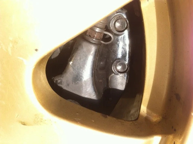

Upon fitting the Disc's and calipers...
I noticed that the passenger side wheel bearing is gone :(
Think Renault are 60 Sterling each for the front bearings :(
I think I might see how good the bearing is in Conors Blue Clio ;)

Is it me or is that disc the wrong way round?

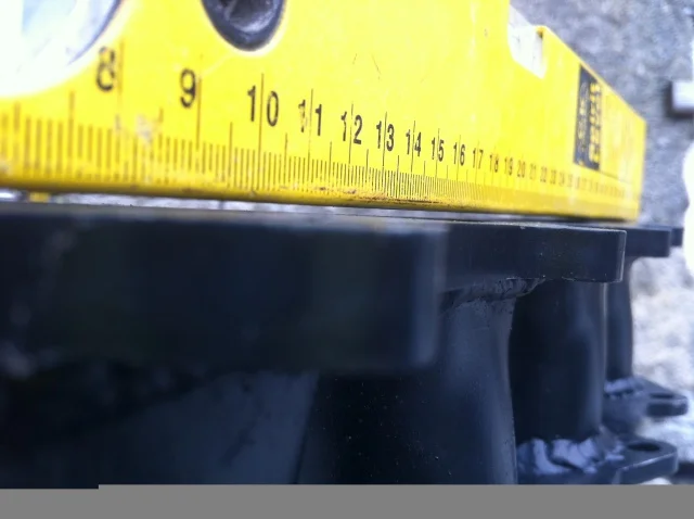

Got my manifold back from pepper,
It was warped again:S
Also it had NO brake servo ports!!!
(so the brakes wouldn't work......)
Sent it back and I'm getting a refund :)
(I hope)
Found some fella here that makes manifolds :)
He lives about 40 minutes away and it'll be made from aluminium instead of steel(pepper)

Bought some new braided hoses :)
Theirs plastic over braided part so it won't rub/wear on anything.

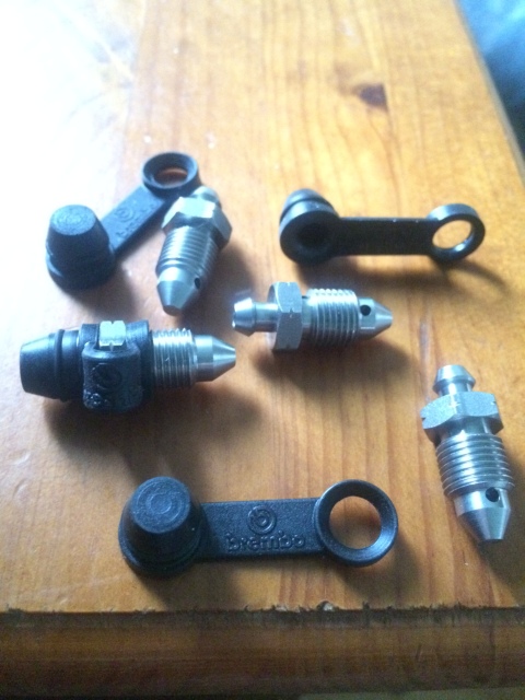

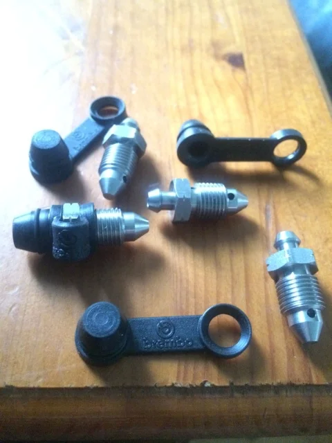

Bought 4 stainless steel bleed nipple's for the Brembo brake calipers,
Also bought 4 dust covers for the nipples..
Originally they came with brembo stamped on them so had to get them ones again ;)
€30 posted for the bleed nipples and covers :(
1 of the dust covers was broken and 1 of the threads on the bleed nipples was a bit dodgy(mild steel also!)

K-tec racing stainless steel silenced cat, €135 for this fecker!
I was kinda sick of the swapping the whole cat/de-cat with the nct!
Lifetime warrenty also :D
I'm looking for a 4 branch manifold and downpipe for the car now :)
(if ye have one let me know ;) )
I should be getting my new inlet manifold in about 2 weeks :)
I got the Manifold last night :D
Also bought a pipercross airfilter holder(no air filter yet...) off the fella.
He is drilling the holes for the trumpets this week
Gonna try and fit the engine this week or next week.
Must just change the starter from 172 to willy.
Also must wire in the oil sensor as my loom is missing it(itbs loom not original)
So must check to see is there one on a old loom around the place :(
Didn't get a chance to do much today :(
Changed the accelerator linkage from left pull to right,
Fitted the throttle bodies to the engine with a new ptfe inlet gasket.
Plan tomorrow is maybe fit the power steering and alternator and try and fix the wiring loom :)

My new K-tec Silenced cat,
Downpipe,

This is cool! Any more progress with it? I'm wanting to go 172 widetrack on my valver. Keep up the good work mate :cool:
very nice looking car mate will look good with the throttle bodies hooked up

Also. What car are the callipers from?
Peugeot 406 2.2 diesel and 3.0 v6 petrol
