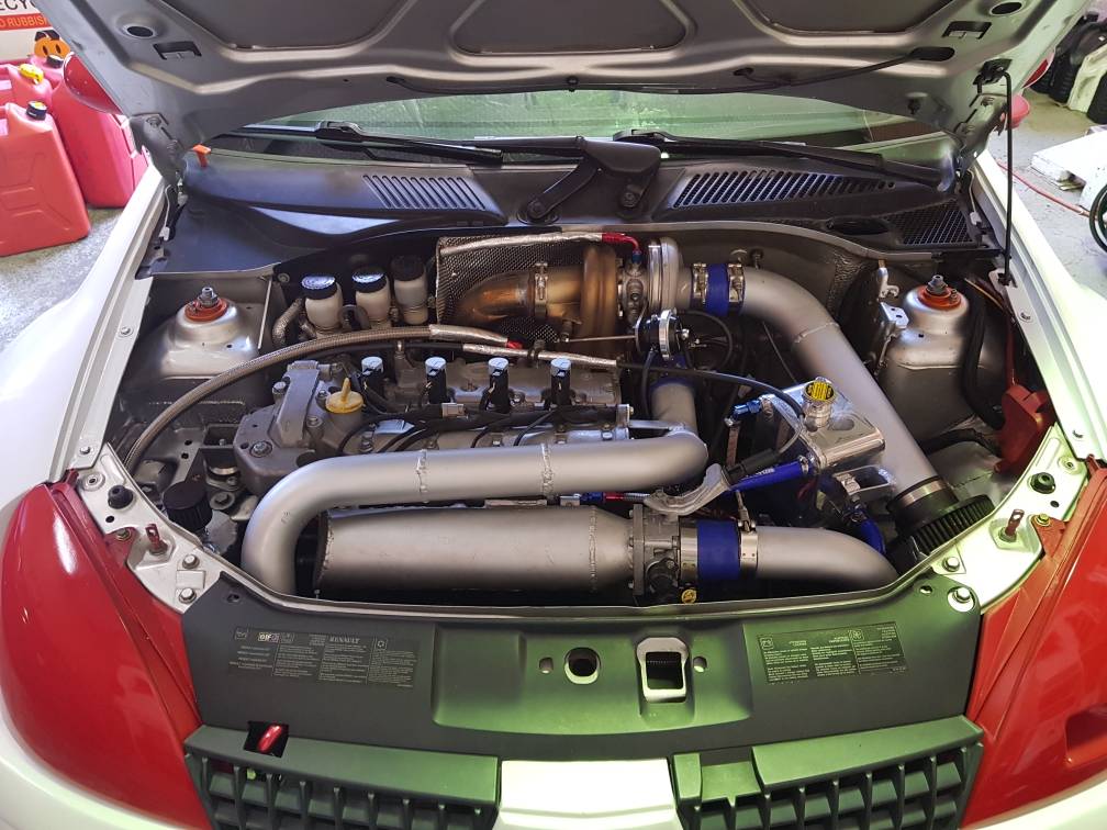

Engine bay tarted up and ready for the track on Wednesday. Installed the turbosmart recirculation valve (can also see the turbosmart dual port wastegate actuator in the pic). Also had a small oil leak on the turbo oil return to seal and a couple of other little fixes. Love the colour the stainless on the turbine housing and dump goes with a bit of heat. Have also added semis to the rear where I had been trying to avoid too much grip being on 255's - with the stiffer rear beam they are now necessary. Keen to see how it goes.

Have you given thought to an airbox to prevent the filter sucking any hot engine bay air?
There is heaps of room in the LF corner.
  Clio Sport 182
Respect on the build. Awesome.
Cheers! Intake temps on my logging are low - the headlight intake provides plenty of cool air flow. I may at some stage but not a priority. I did just install a quality intercooler so hopefully solves my boost dropoff at high rpm. Should be on track this weekend to see...

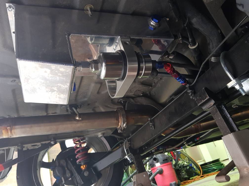

Was getting some fuel surge below 50% last time out - even with an upgraged lift pump and 1.5l surge tank! So, I have upgraded the in tank lift pump to the biggest one I could get - a Walbro 450 which are E85 approved. I also put a 4.5l under car surge tank on. The Walbro 450 is a beast filling the new surge in about 40 seconds! Still running the deatschwerks 350 as the my main pump. Fingers crossed this combo solves my issues .....

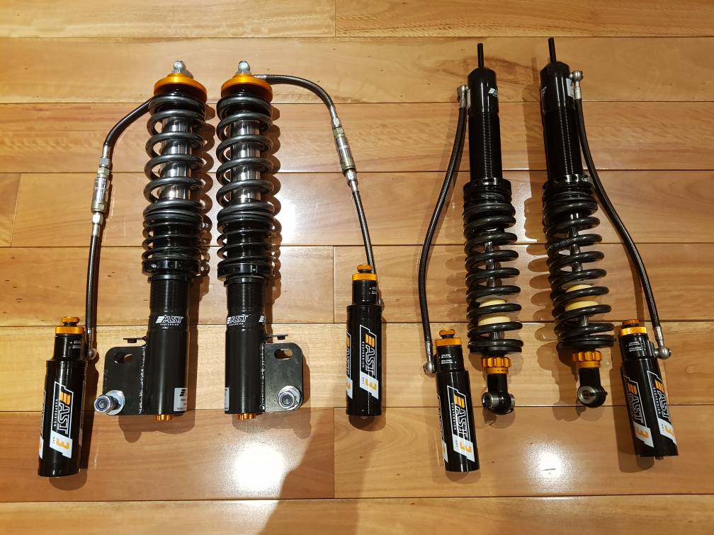

After waiting 8 frustrating months for active suspension from Tractive I cancelled the order and went with 5300's from AST - manufactured and delivered in under a month! Should have just gone this way from the start! The 5100's that are currenty on the car will find their way onto another project.....

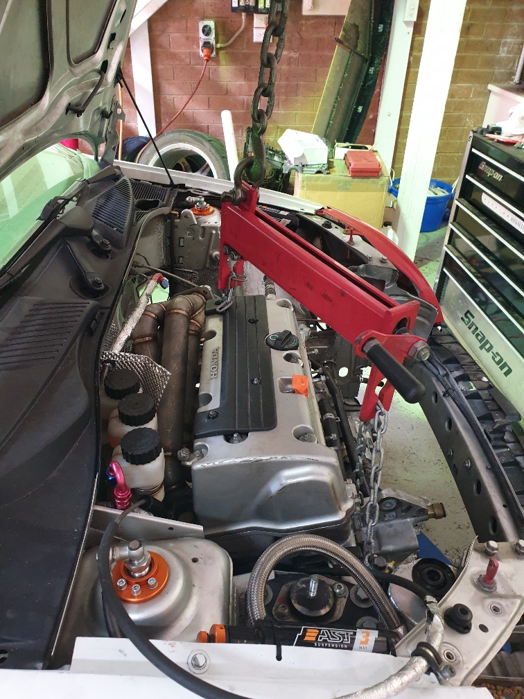

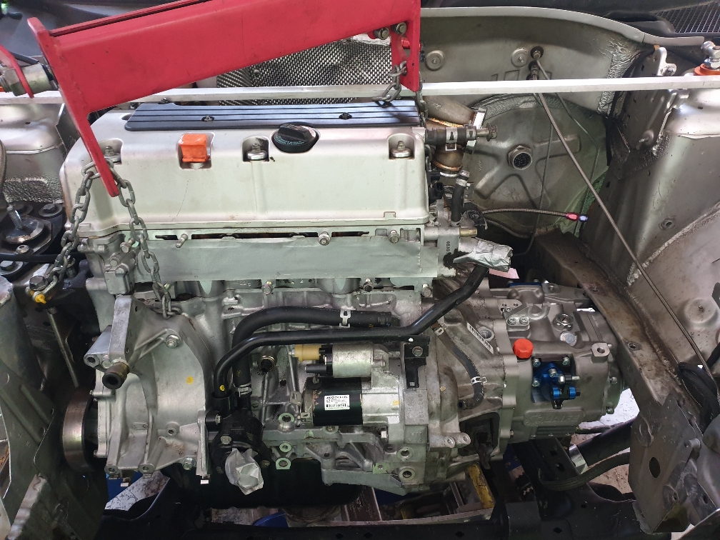

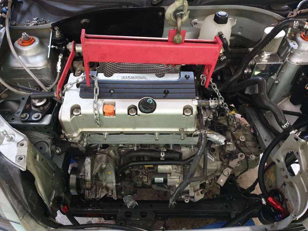

Been a while, have been building a full NA car for improved production racing.
Engine in the missile decided to eat itself (my fault - aux belt went under cam belt and we all know the rest - best one I've seen - 16 valves, 2 pistons and 1 bore scored!!).
So, here is what's next - K24 (test fitted in my NA car). Will take some time to complete.....
