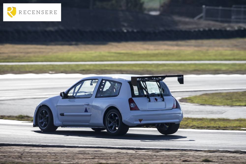

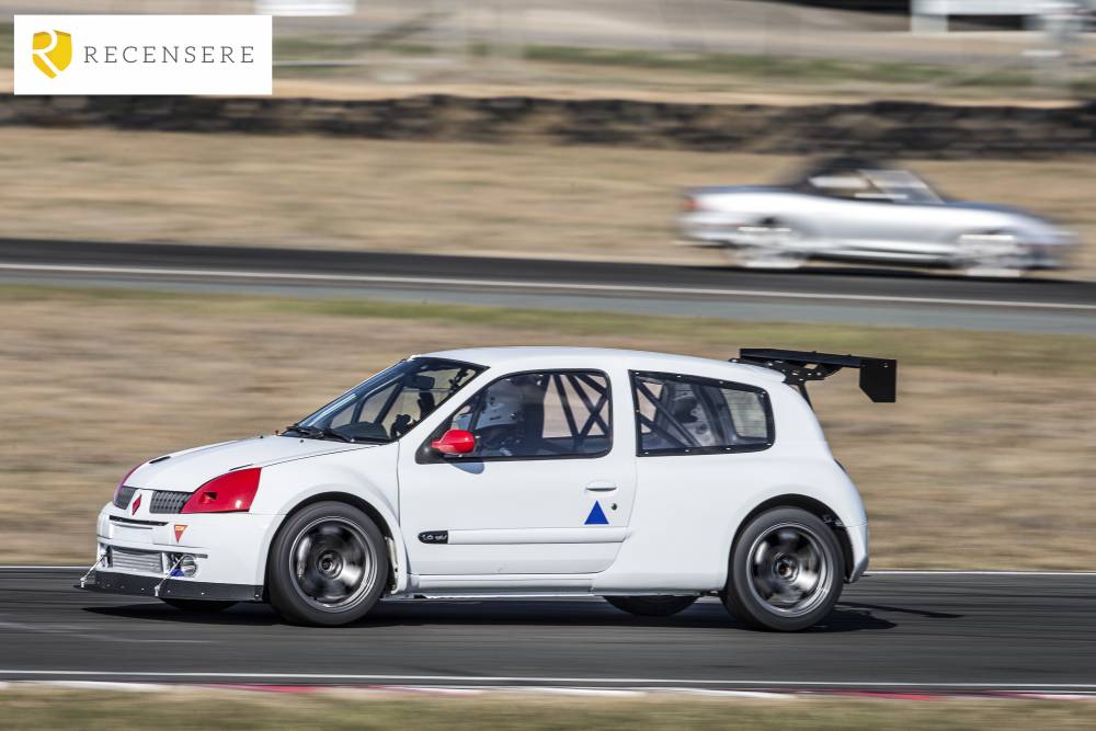

Great video, sounds and looks like it's bouncing around a lot loosing traction? What settings are the dampers on?
Cheers. Yeah, it sounds worse than it is but still fiddling to get it setup - front and rear were at full for that run.
Sent from my SM-G955F using Tapatalk
You've got a reference now though so a few clicks back at a time now and you'll be sorted. Looks very quick though and once set up will be a monster.
What tracks will it be attending?
  Clio Sport 182
We only have 2 tracks in Sydney! Intend to try my hand at Phillip Island again as well although that's a 22 hour investment to travel there and back!

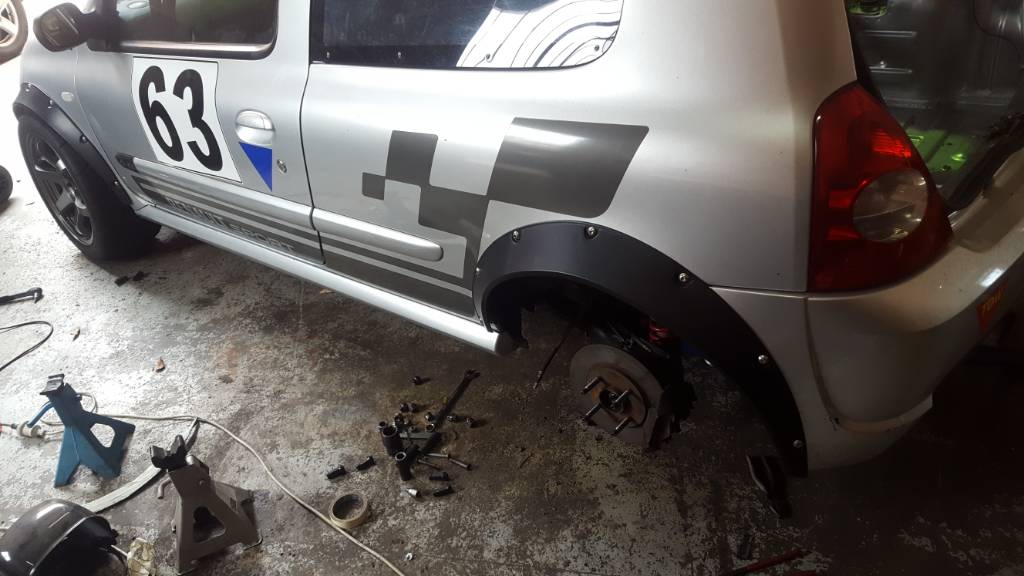

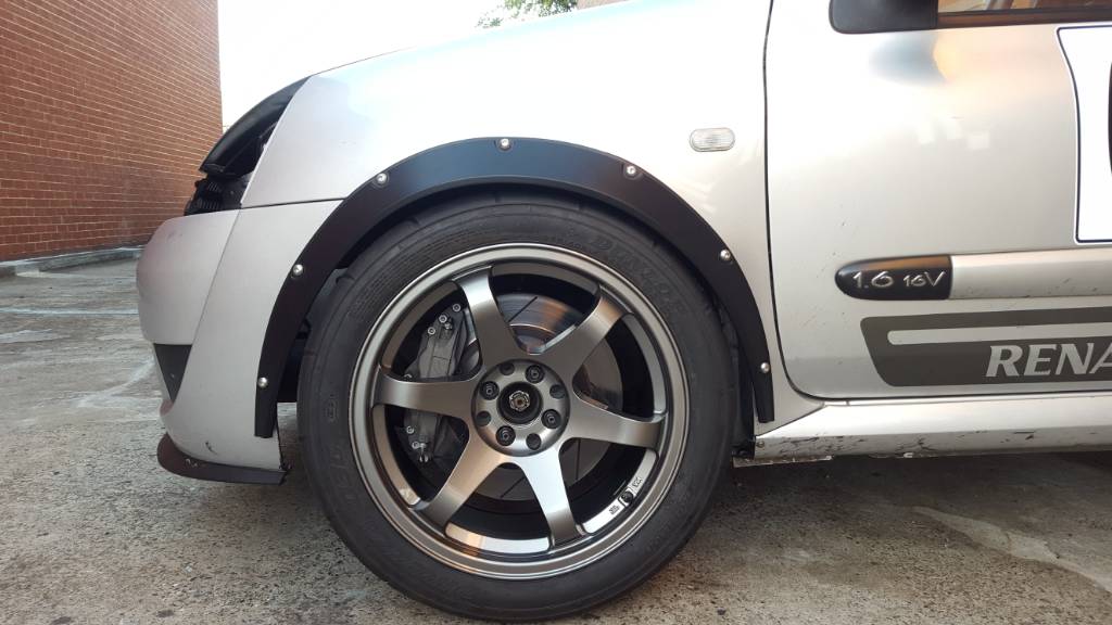

Don't suppose you have any more pics with the black plastic arch extension? Close up would be nice :cool:
  Clio Sport 182
PMS strengthened beam along with their upgraded stub axle kit with larger bearings and ARB. On track next weekend....

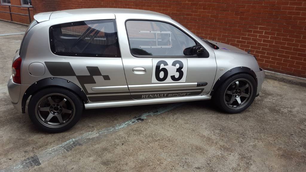

What a build, love to see something different :)
What's your day job out of interest as you're clearly good with a spanner!

Cheers!
Work in finance so not much overlap there! Always been mechanically inclined and I figure if someone else can do it why can't I!

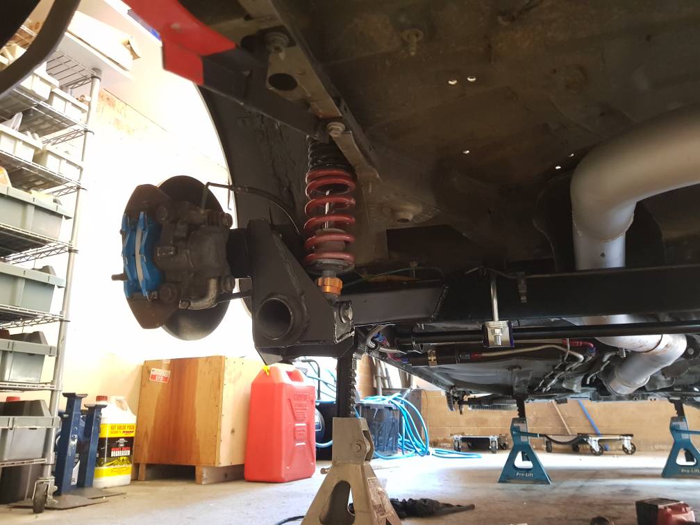

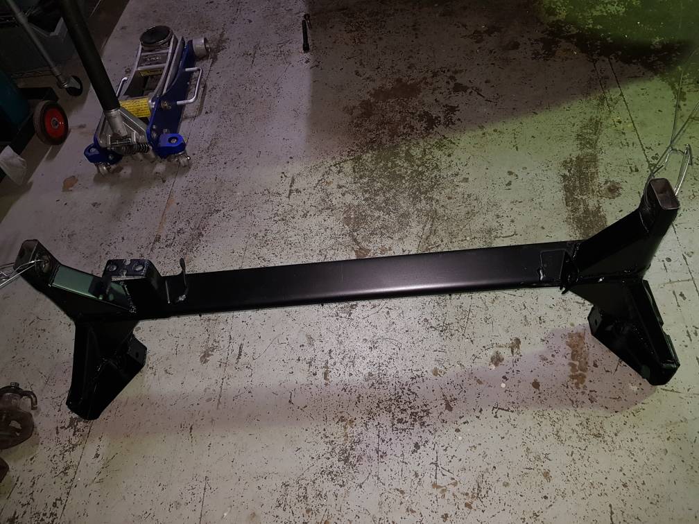

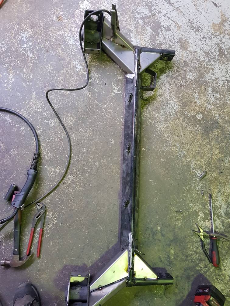

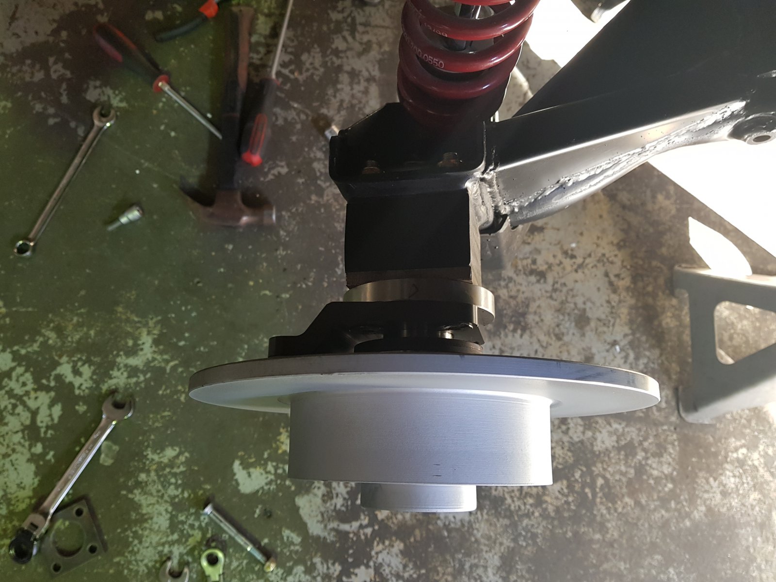

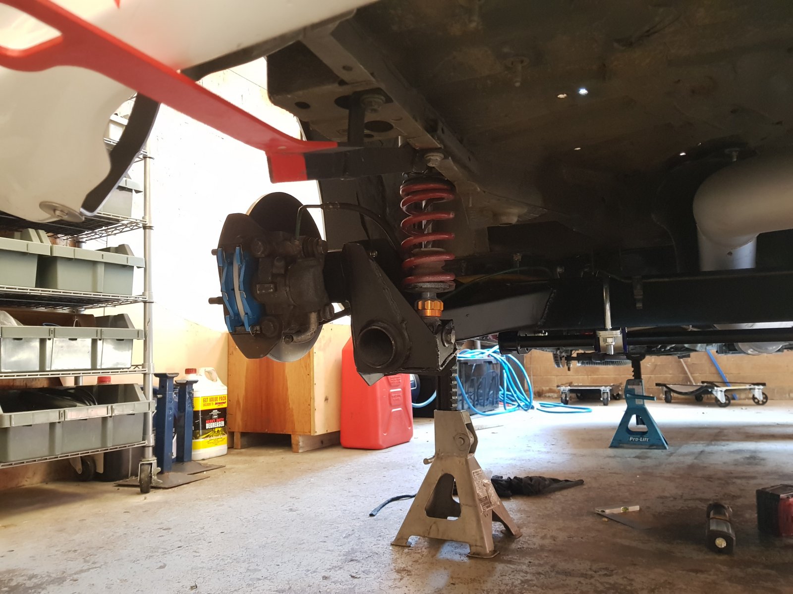

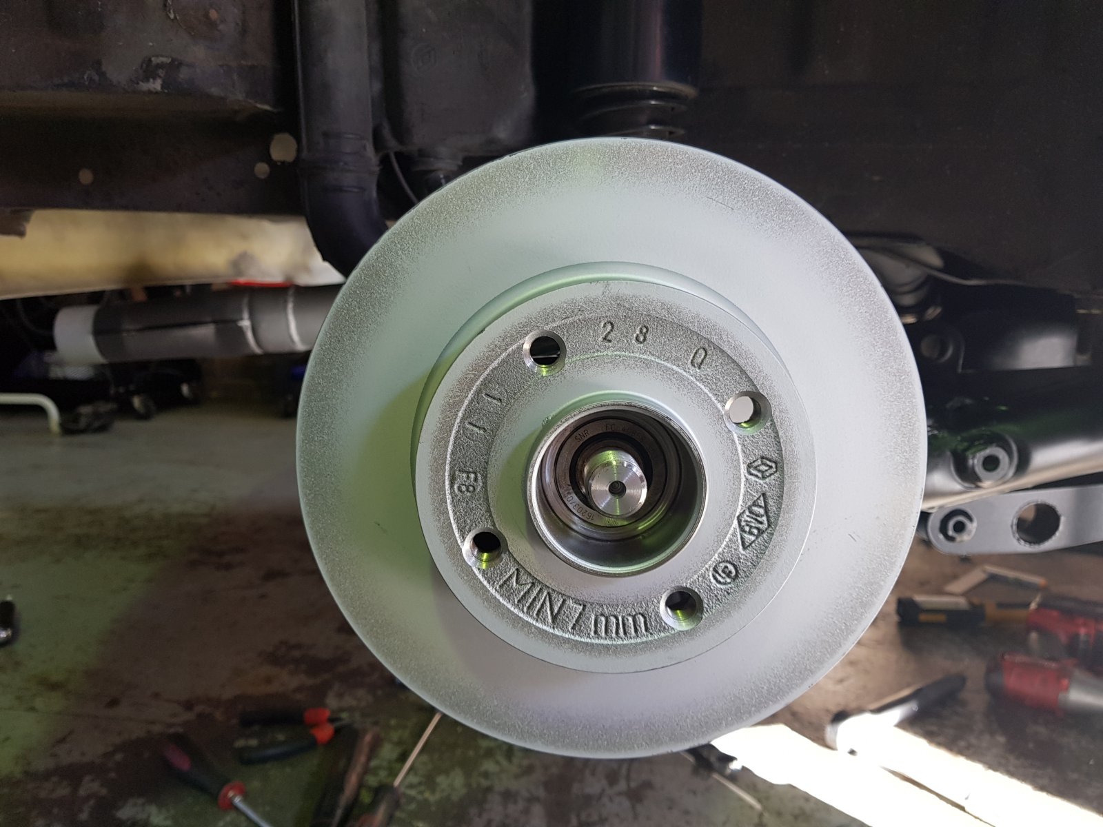

  Clio Sport 182

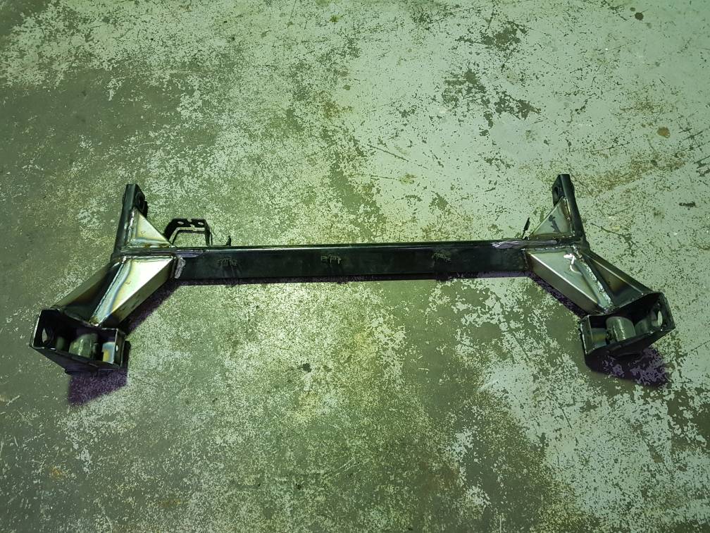

Rear beam installed along with PMS arb and upgraded stub axle/disc/bearing kit. Also through some Hankook Z221's on the front - great tyre for sure, every bit as good as the DZ03.
Got out to Wakefield again - managed to find myself facing the wrong direction a couple of times with the new found rear stiffness - time for some semi's on the back. Improved best lap by 0.6 seconds, albeit an average looking lap
Oh, and e85 is terrible for cold starting at -7.5 deg celcius (yes, it get's that cold in the high country a couple of hours south of Sydney where Wakefield Park is).
  Clio Sport 182
I didn't think you need a rear ARB if you strengthened the rear beam ?
Probably is on a normal Clio but this car is significant wider and running on 255's which can chew standard wheel bearings in a day or two - there is a lot of twisting force there - in saying that it is stiff! Think grippy rubber on the back will be just right - only one way to find out!

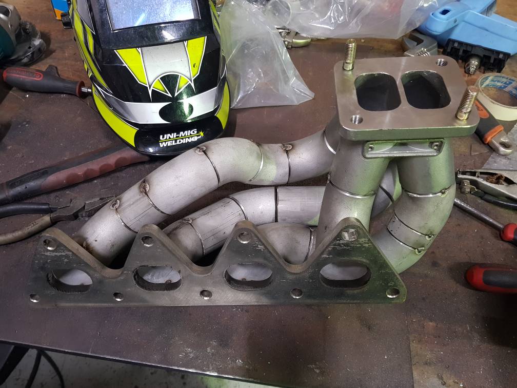

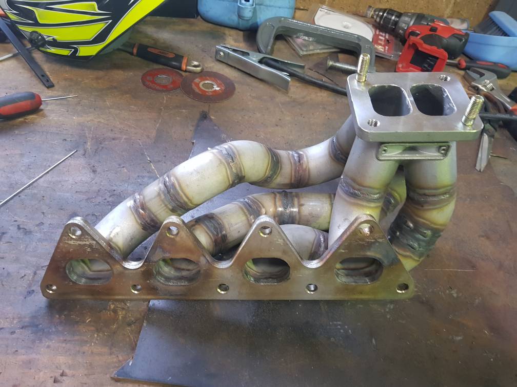

  Clio Sport 182

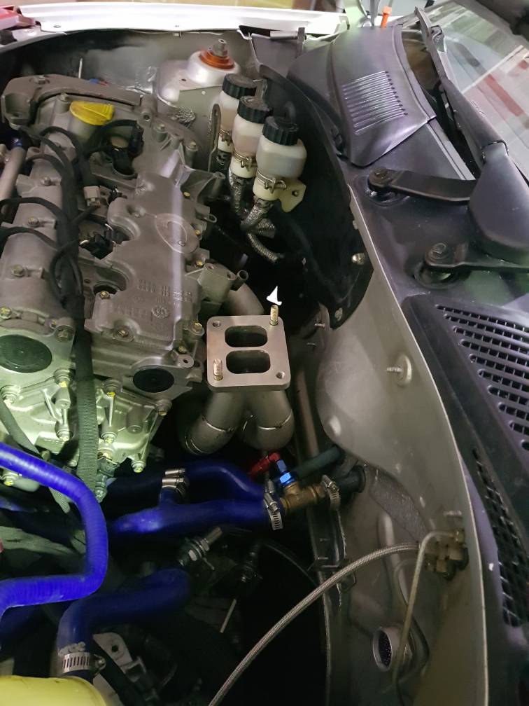

Manifold competed. As with so many things on this car got lucky with space and turbo fits perfectly. Next, weld new intake and exhaust pipes, make up water, oil and breather lines, relocate expansion and breather tanks.

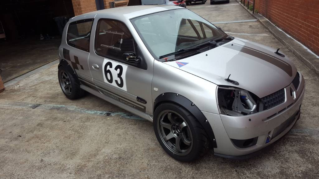

  172 Phase 2
Had a sneaky look at this thing when i met up with Matt to pick up a few goodies, pictures don't do it justice to how wide the thing is. Very impressive mate keen to see more

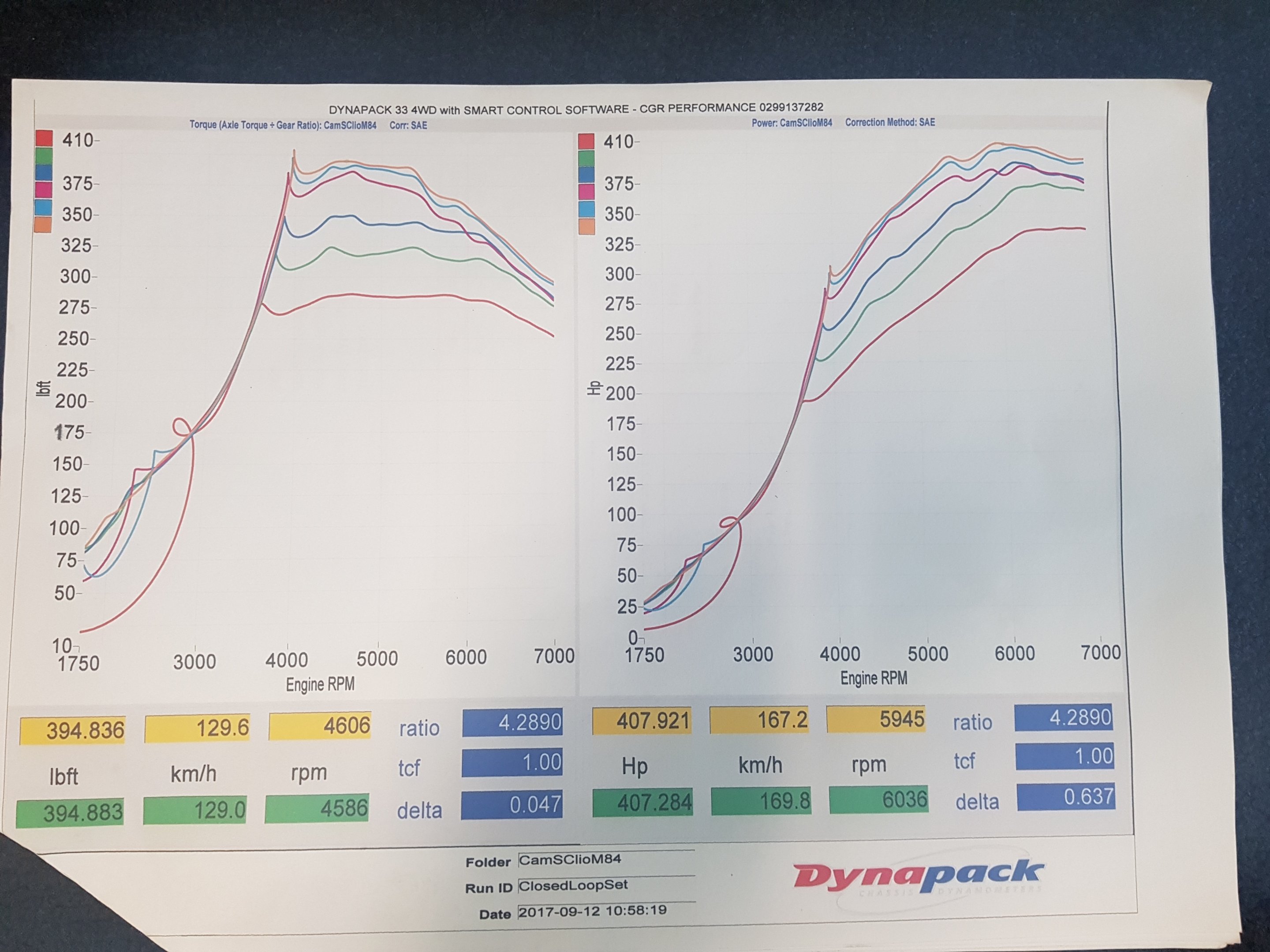

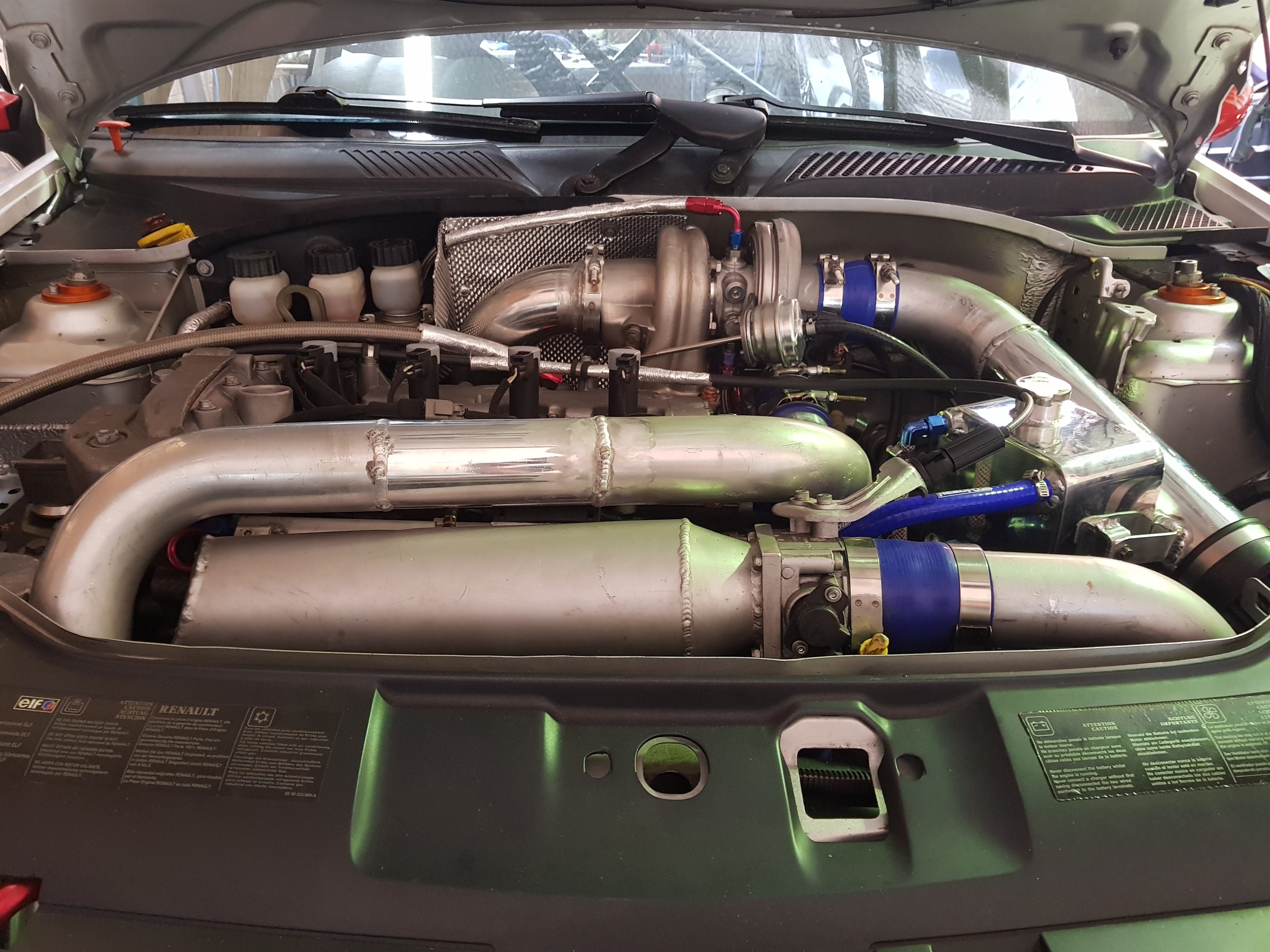

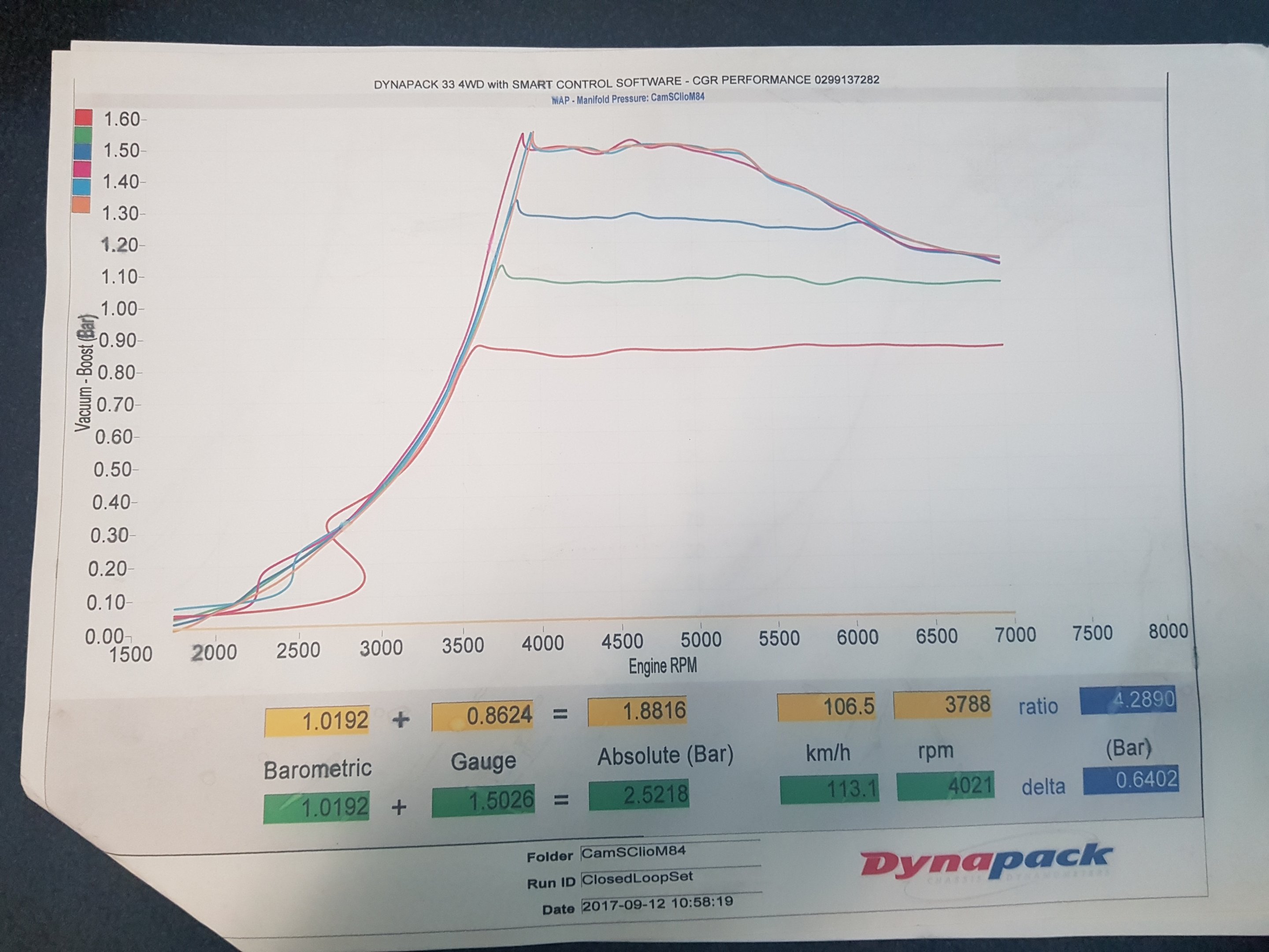

  Clio Sport 182

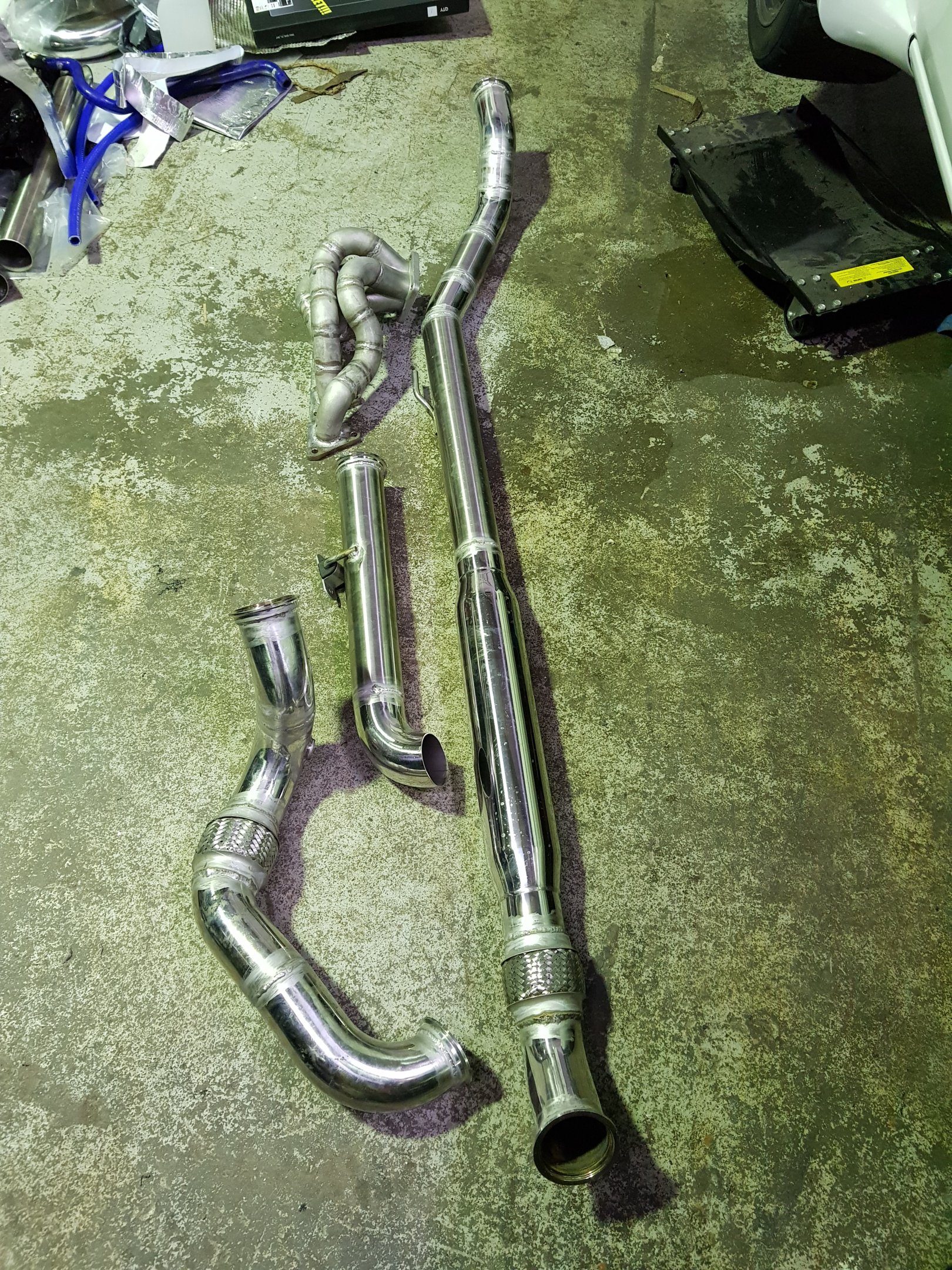

Turbo upgade finished. Now running a twin scroll borg warner efr 7163. Good for up to 600hp all in such a tiny responsive package.
Along with the manifold I welded up a new 3" stainless exhaust
Took it for tuning. First problem was the wastegate not allowing enough boost even with the control solenoid at 100%! So upgraded to a turbosmart dual port wastegate actuator. Has assisted but still losing a lot of boost up high. Tuner thinks it's somewhere in the intake, possibly the recirc valve. Have ordered a turbosmart upgrade unit. If that is not successful then will start measuring boost at various points on the intake to see if anything is holding me back. Still made over 400hp atw and a crazy amount of torque (395 v 339 ftlb). In any case there is a heap more power between 3 and 6k now - e.g. up 65hp at 4.5k. Once we get the boost to hold that torque curve will flatten and power at 7k should be high 400's hp atw! On track next Wednesday so will see how it feels then. Also have a pretty exciting package enroute form the Netherlands.....
