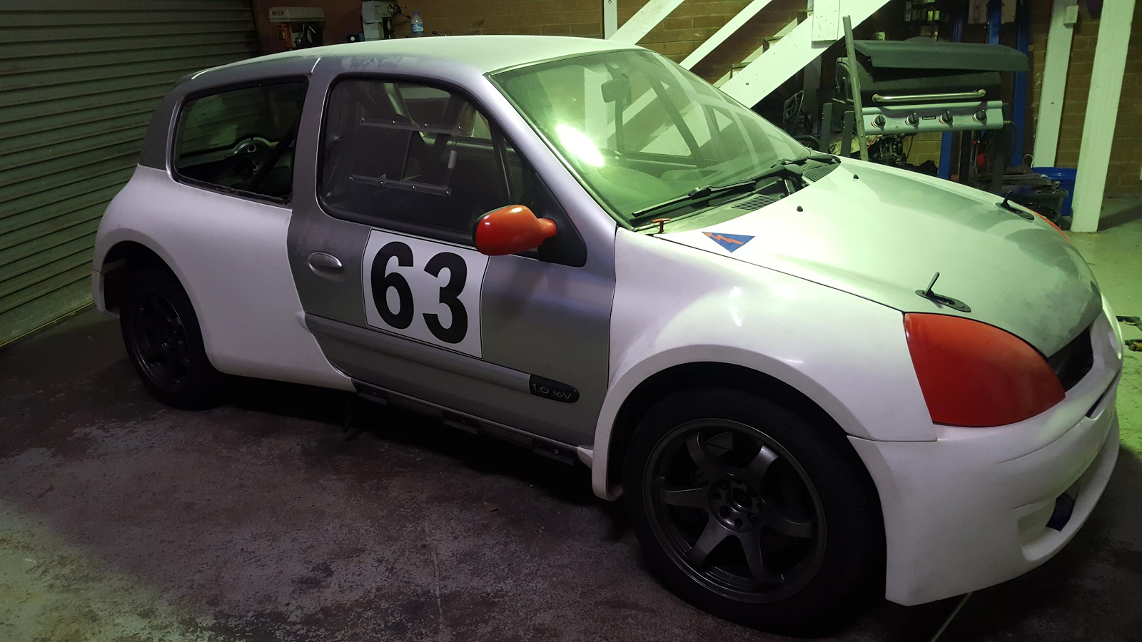

  Clio Sport 182
The car started life as a standard Australian delivered 182 non-cup purchased so I could get out on the track and improve my skills. Pretty much as soon as I got it I semi-stripped the interior, put in some AST’s, added a race seat, ED cams, lightweight wheels and dz03’s along with the other peripherals that go along with a basic setup (pads, camber bolts, bushes etc).

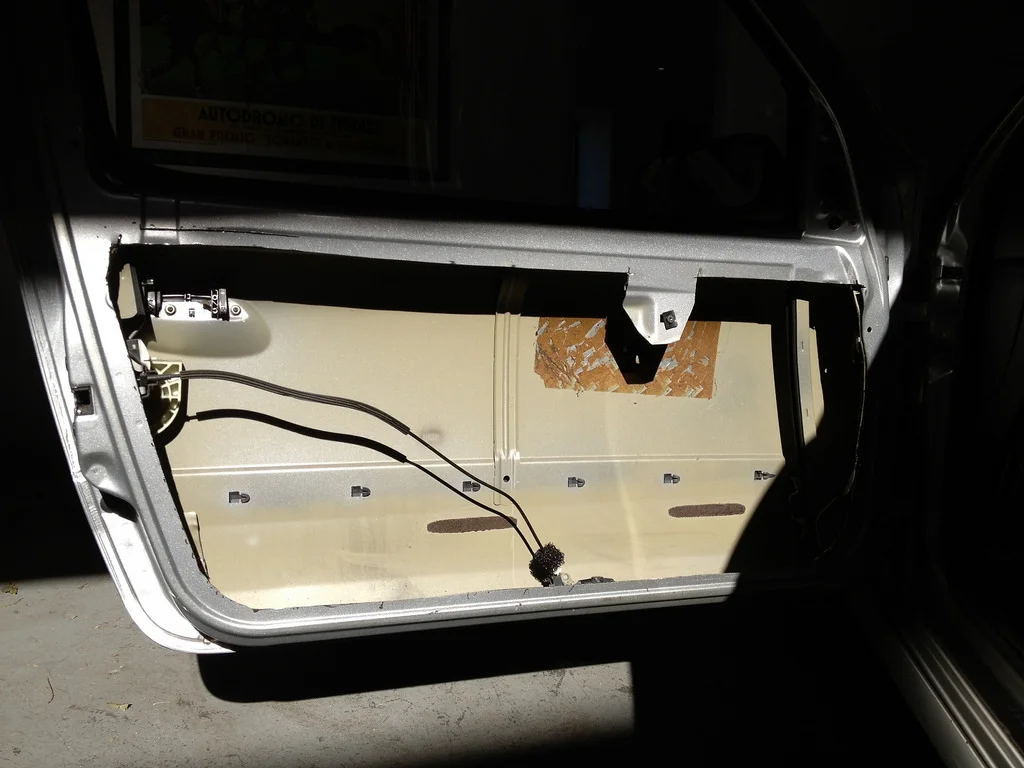

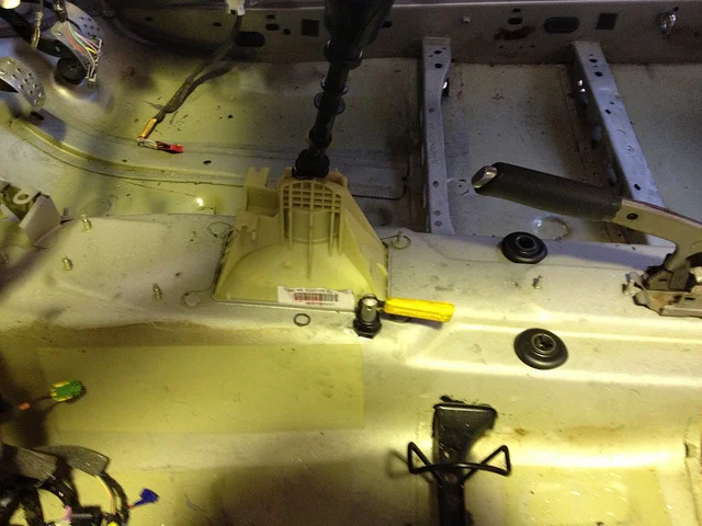

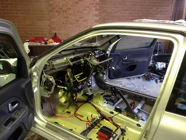

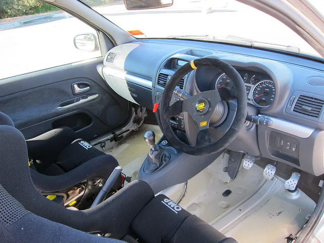

I also decided to strip a little more of the interior.
Kymn_1SQWgKEOFKMD5Hk9PDa_vCEpCzyvHAuVfuwOg2CRlvVRoo9YN2yskrIKMjXvFYCYB55756II7wVGbL-E6Ib3k8StnDd.png

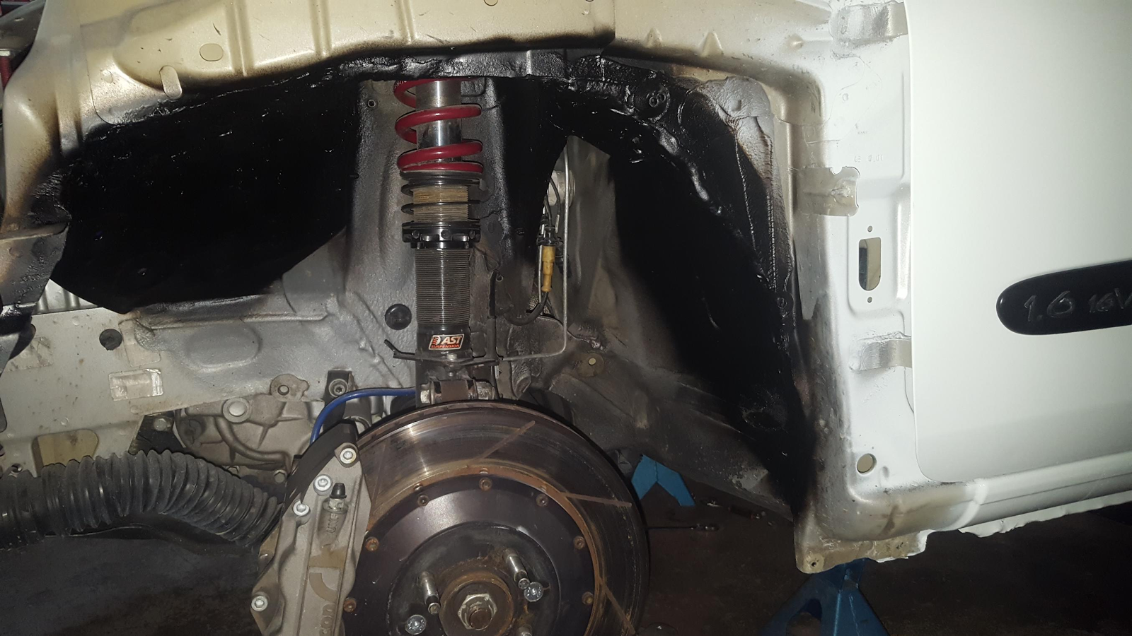

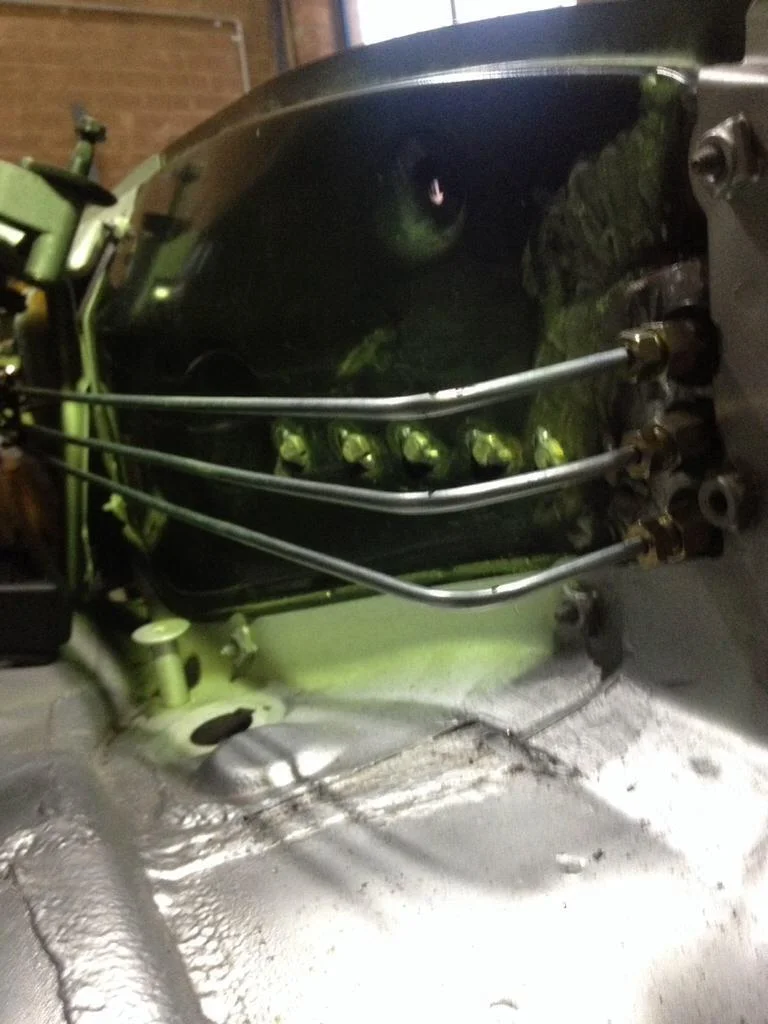

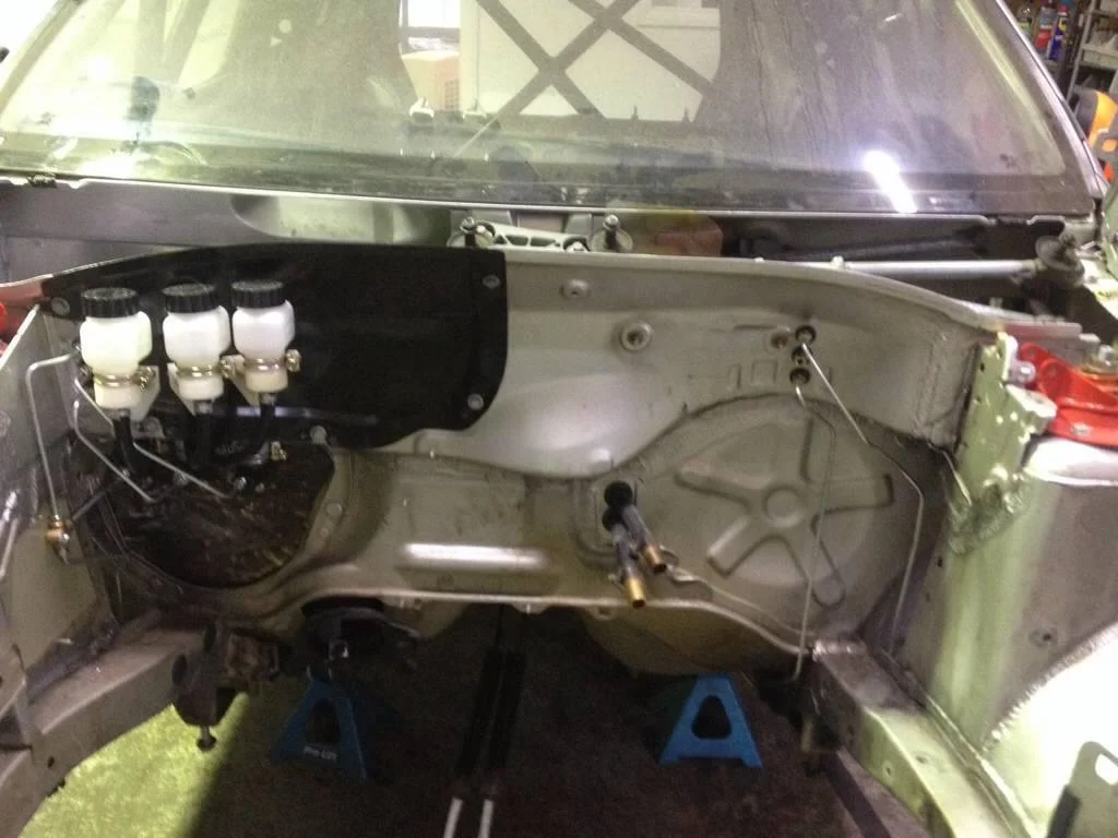

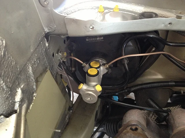

While at it I removed the ABS, installed a 4 port master cylinder, hardlines and a bias valve.
Wo97VJky6sirMBMgzi-3Hr975X6O5LJoBuHDDmdRuDd4eG7lJR-4RvqD8pbBu-BVsMr7ezmcNJ1DMIbSQYmKc_dmpoHurB0P.png
uuGe0GQ0PTXK_fwY2ERV2ZmMwG-WdBzrI-ocyN0DPck2sc5oO5T1L3s84rGOn3sEBgqwe27vD2XHBJjRzpjfMksHYTmCqWM3.png

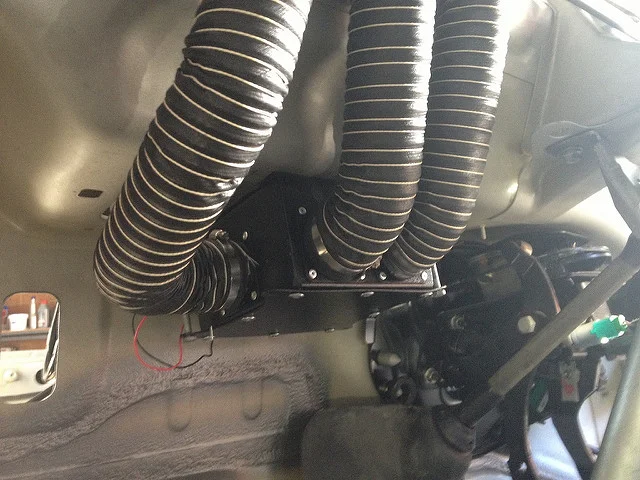

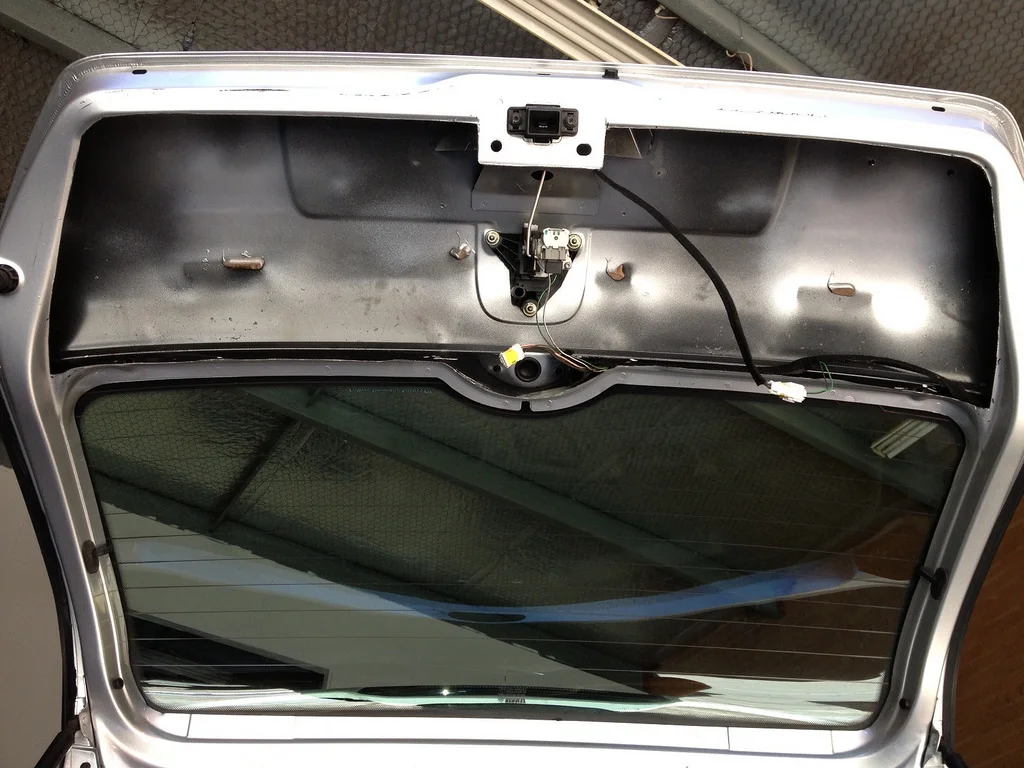

Next came a lightweight screen heater having removed all the factory parts.

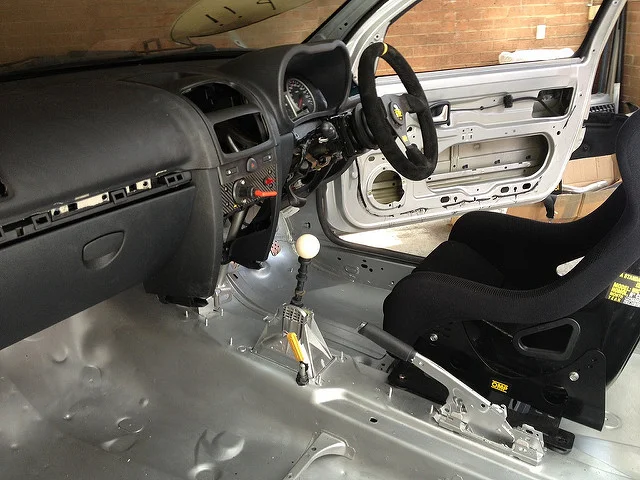

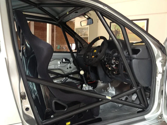

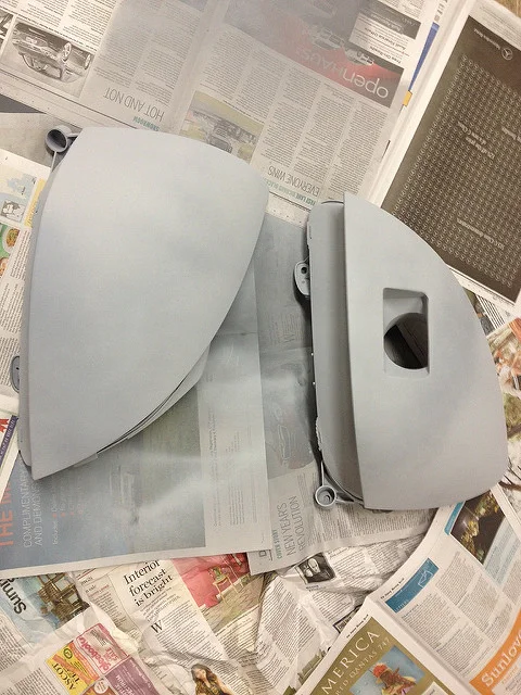

With everything installed and all tar removed I painted the interior.
U7z1CoayEfcYzbGiyTol7sW4c1p0KmkYT1dymYA0YeL3LVtVt6XHU---DfpWWkdEP-6EGqk95ldJoWmMoz2qh8WK95JHHr51.png

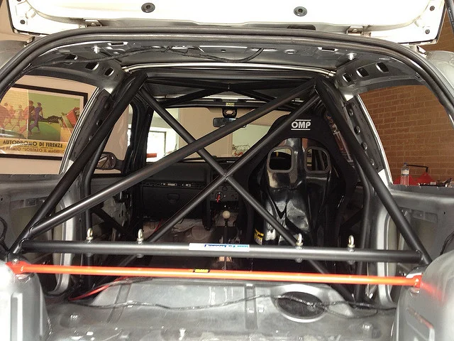

Decided a cage would be a good idea so had this installed - 6 point national spec cage.
5JX0Q3wm_EQuLVMDxVQETgGEFXLIZ6OYmpKFImB8geWHGcgHWbKEHR_bJqgsaA_Xumrqd7RLphkzNo9x0ZzNLAM3-X3_KLeF.png
JioG_2a-EDAJcjiaCv2XdOwKe1TbWdlJLFQ8Rmb-Kx2FEODK5kg9gJCtBtIwwnWAPvtEeKAn9oUEqnOntOkWSdgB4WQ0bCf_.png

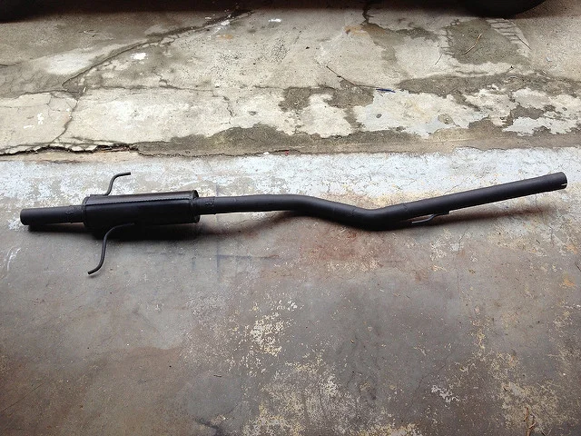

Welded up an exhaust for a little more bark and also welded in a pure motorsport bearing kit on the front wishbones.

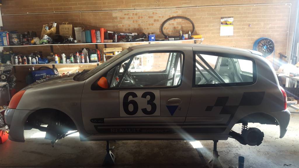

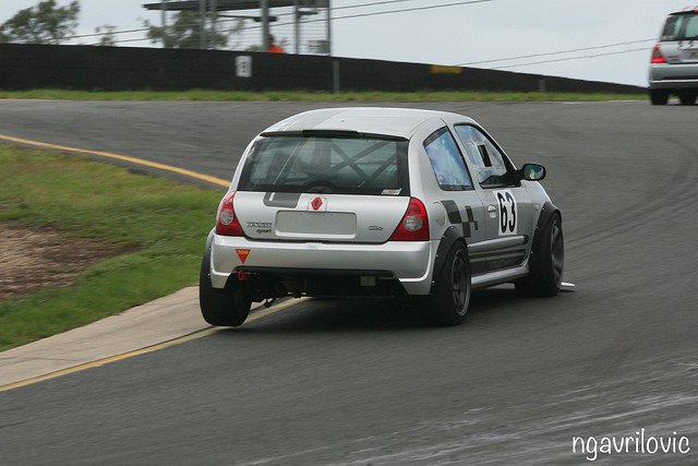

At this point, fully loaded with the cage the car weighed in at 931kg.
Time to get on track.
lJ-e6zghv1_QCyiA9MoL3S2pMBEFpiX4-fW6A35pcidkuEynRJzIbFzC1Cf0AcEbO2dYN2H_x_fSfo3BUhOEMIfFirCNL9bC.png
V4oFpqoA7gTewduuP7tbL9DLmXf-lKsFzxMrgK06E9cpzgn7QHRWdFEAE2ymIO1SZ0x6Jg_uz8vN0_UuZnDuicXR8m1V81IU.png

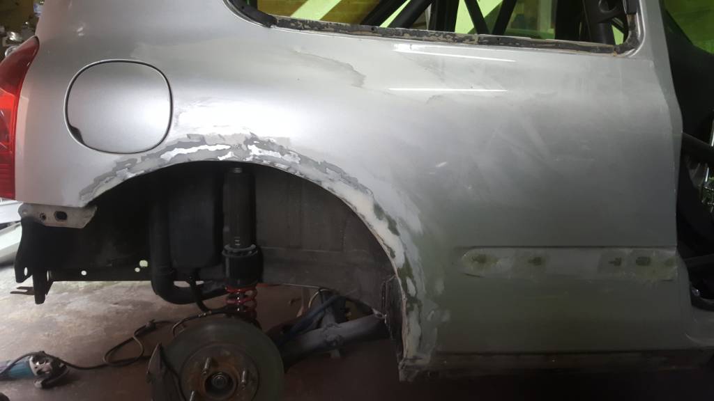

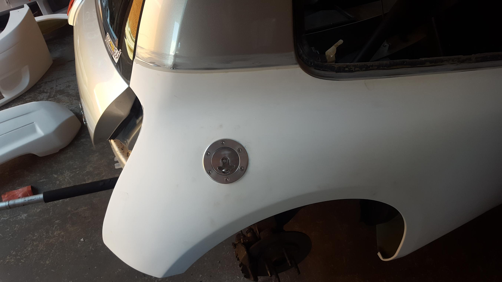

Back in the shop lightened the boot and door skins.
xDQ5v8W6lJL60u8Kk_L8f2m35A0M8mzHMoeaZNHOHrRe6OeF1X-hhar2836hXXv0cjs1a6VPOU7ezK_lVHiKw21ce3D39fka.png
k4bZDAITskz8Ux66UBFVwGlUTx-VF41UJs10TmEAQY1SrXNCtWdiiNRpYA0Mez5vuicRpnaSiQQfn2zn3nUmvDGNIDPNcCNd.png

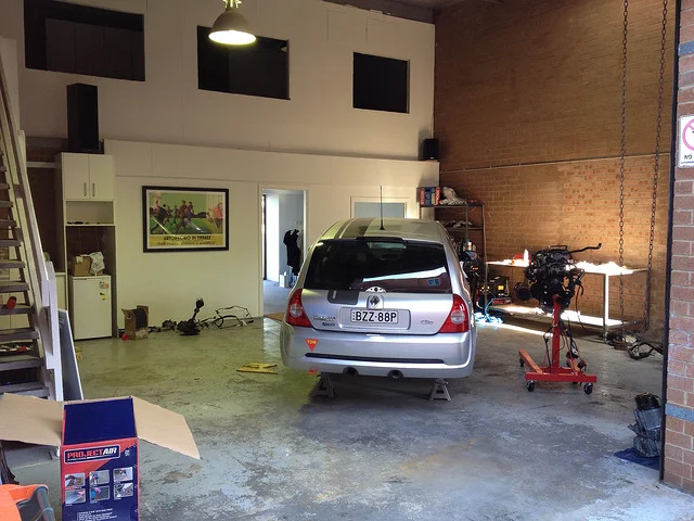

I started thinking about what I should do & I could not get the idea of putting a 225 engine and box in out of my head. I scoured everywhere but could not find anyone who had successfully done this in a Clio 2 (this was 2013) so I bit the bullet and bought a written off Meg.
U5hGnkZg1RIHqrL9Vhr485W94wXKwFv08j0BBFpOe8KG61Crr_v8a-jDZG-0WmrP7SCpYzCk8tGcPDfScEj4JWg_Q5C9FUjT.png

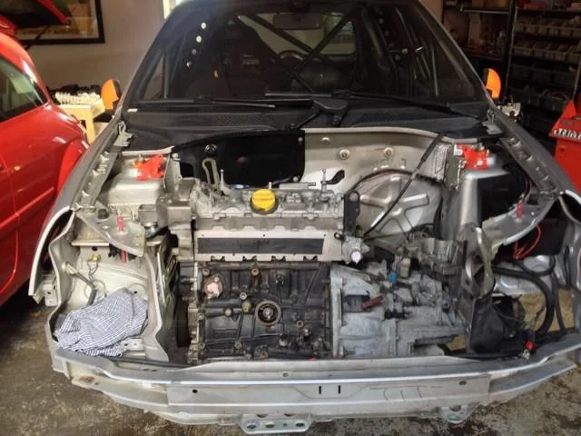

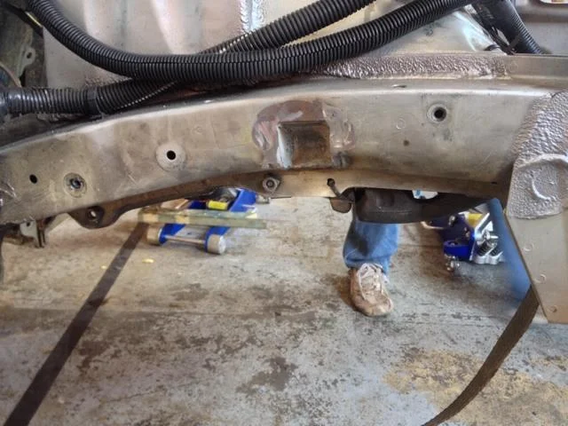

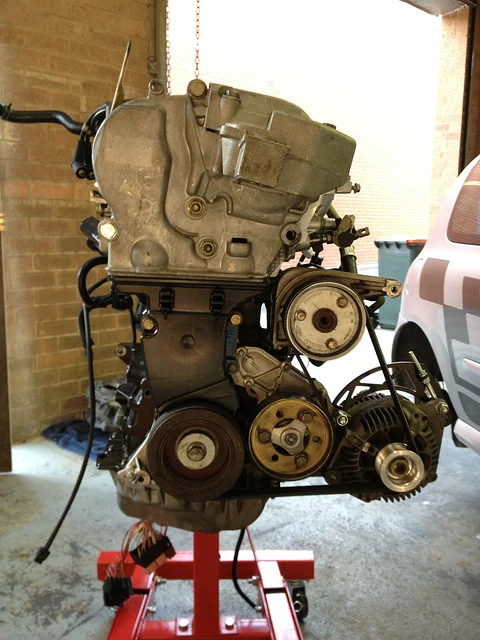

With no reference I thought I would lift the engine in and see how it fit. To my surprise it pretty much dropped in, with only a slight notch in the chassis rail required for the gearbox.
SlVMXkL9TW1vVAl1PQT6msFMFZwKGt9XyuI6ZBUhm0bf0Xgtey66kVvHMotwxOYnX_nHTOpE_bvJtKUsdmh-3aQEK55lzSxR.png
lAL3Qvlw-WqOaf7iPasv275ZwwquRXRQ1y0MQY6JHV5EHGA1G8ahXSpknzwhVI8OmbpituucjqVwFmQC2zvCihK2v0JkOGX8.png

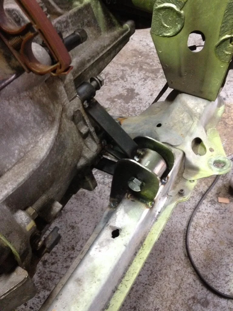

Decided the engine needed a little more support so went about making a front and rear dogbone and mount.

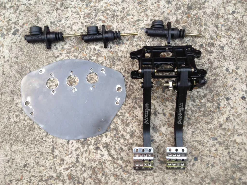

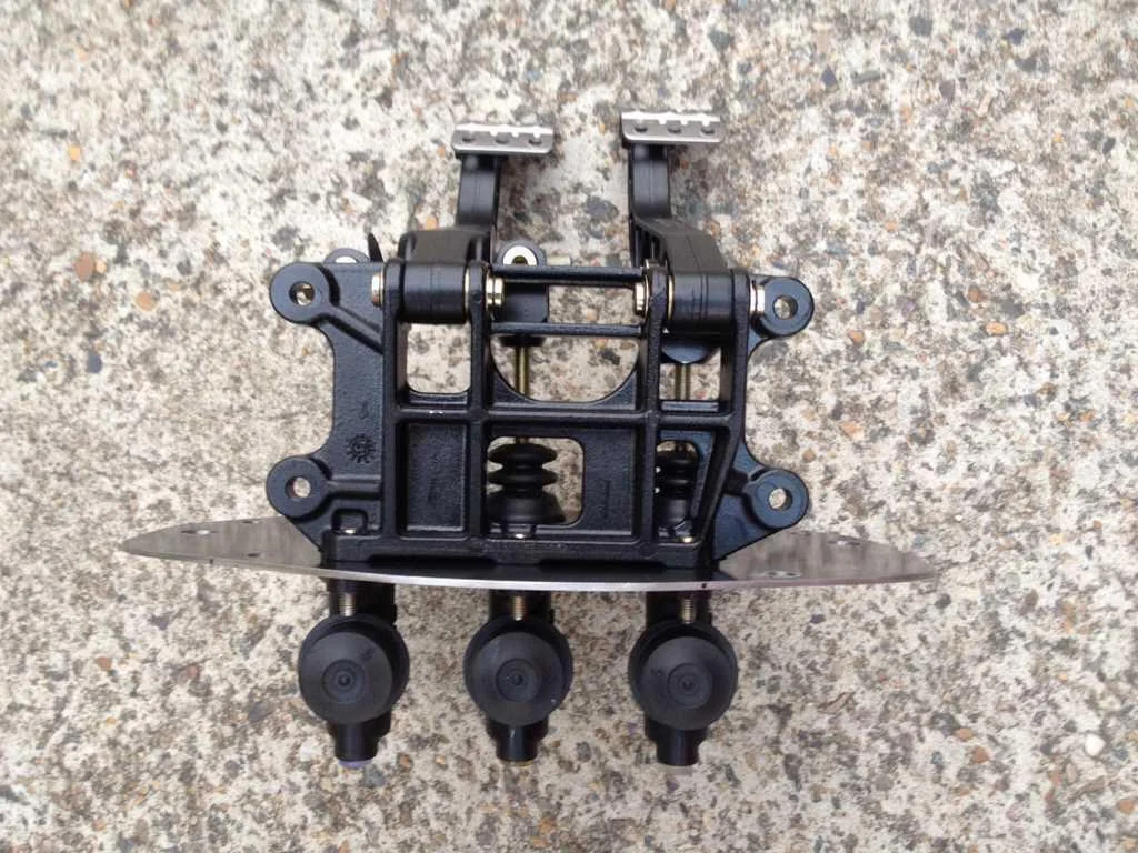

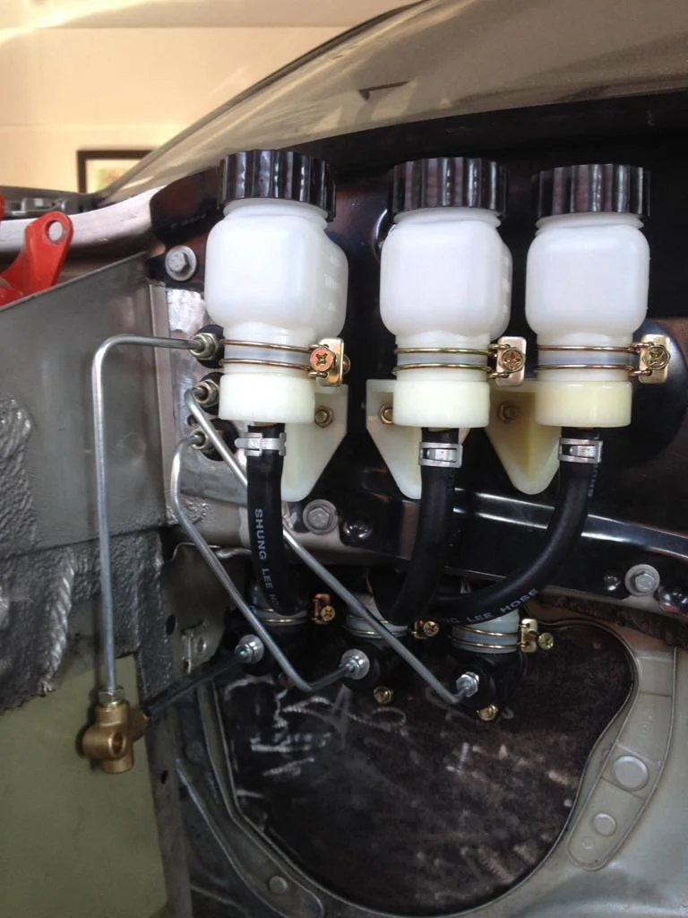

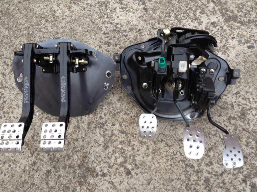

Thought a proper pedal box was the way to go (also needed a hydraulic mc for the clutch) so bought a wilwood pedal box with adjustable bias and tilton master cylinders and made up a plate to go in the factory location.
7ttSazdJj9_y_jyAepU6ymLBepngftoM-cjc7OZqgJ1vR-wumzryf07ZAp_0m2ZnaGIEyYQDKUvwMASdZ4B-Ei98p-AKuNlz.png
dlYQ0maB2AR-3lvCoKMR4D4Kc3LEo2dZKzob2tGhSZnE3WU4JnMjshL5wFhJci8K4NU8t5QZum-3YdysRa5W_ZLf9NFmCbeA.png
9GtMIusGbiNPQNa2QMRzH4vLsRoPc3w4xFM0iWgdUYtSGNua0-kWLikmTRzQqiMkCtVesV4RPdIzWc0rGOfRRE1htpQ8JNef.png
Installed the reservoirs and new lines.
i5AaAfJLQafOYpg6k81FlE2fqwUTfIabKUBJa57prSTkSfxAHJVUl_qU3x5fyrNf1CVpGJ9yqdVqWe9sJX1k4fo3BmvOYi6m.png
R1XIM-dDJFvc5t7bAJd834smNK_SQQLZPMGfLMRzxmn0pKmZZkv7_CCBaeiK_s5VFaxzH8XWGgoSH2IyBntLb_TwPLLMPcdq.png
QBWmRcfUVX9_QCQLbEHxERYb9-SghnxJRx3RfGrPV0_J6iDxVr6JzapmCwxFPtOaAI_56yBiLU2y96VTm7QfTcERFcR8D99C.png

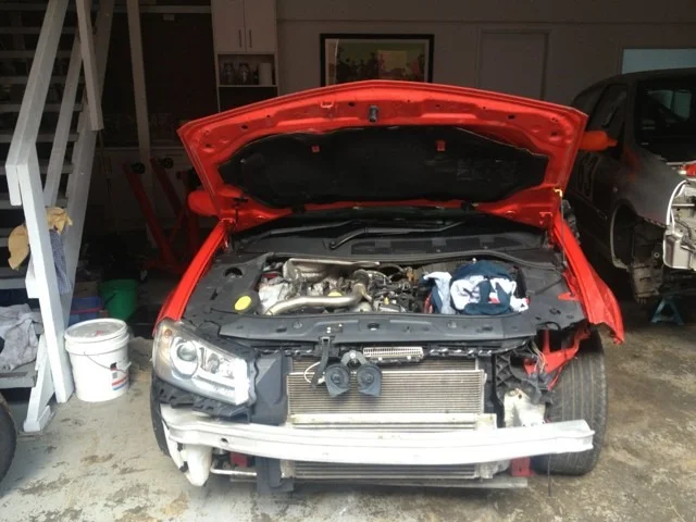

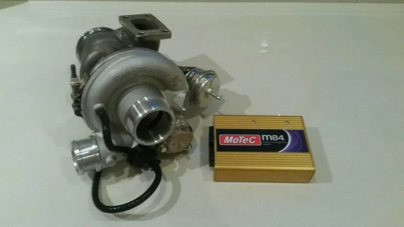

Thought a larger turbo and an ecu was in order - ended up with a borg warner 6258 and Motec M84.
QEDouOXGDt7fPizRYUSbqntIHNr-NIBTvmrnC6j0ebJELt25zOC_bV6AY6GJ_f4QsUB9I_0jUtBNSWSQb_M6poTd8rr2p-7u.png

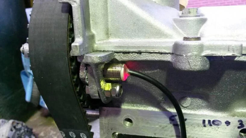

Needed a cam signal to run sequential injection/ignition so installed one.

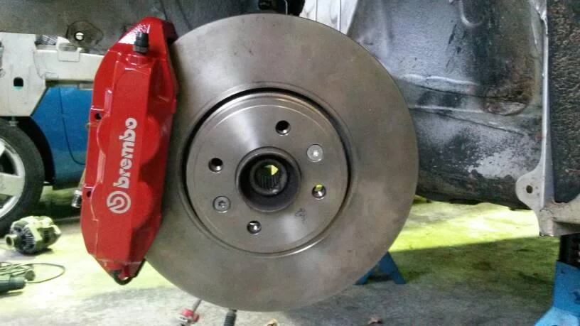

Upgraded the brakes to scenic 300mm discs and Meg Brembos.

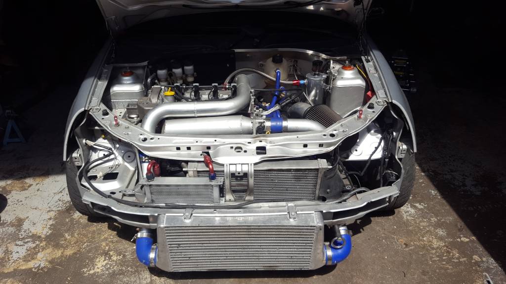

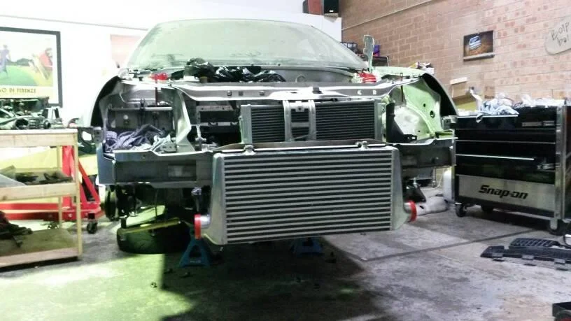

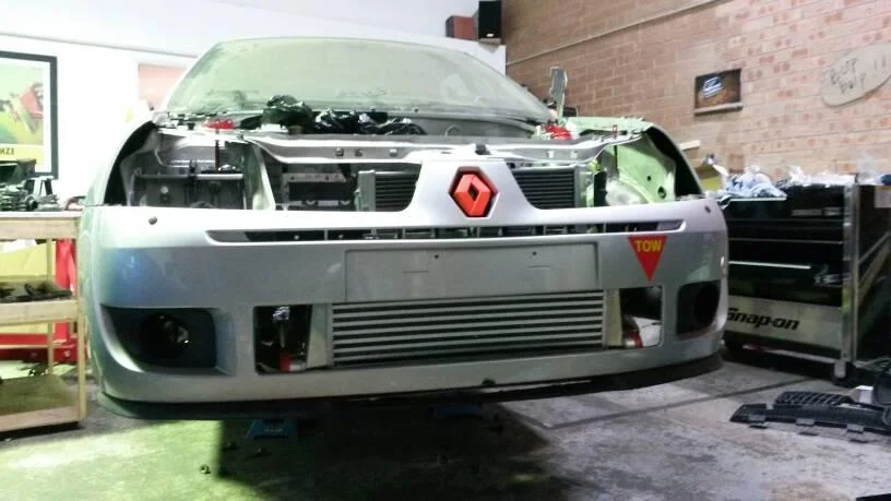

Installed a large intercooler.
ypbvgU4JExjtjBPlP3pYYlpqh27ljFh9iGuBkhOic3RmzPKPOBEhzAenzyTobwXiZsZcPL36ChYmjpY2_5RkAw-luu-XitKJ.png
dmdhF_k1U7I78xDZzX2oriIcsG-Qqf1eJToetnciDPTjgOPpWjcweh__V6zy3HtMoF2RrwyLrBNuDjxpUu1kIJgokJE5nPKW.png

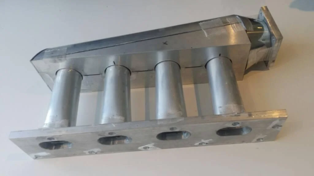

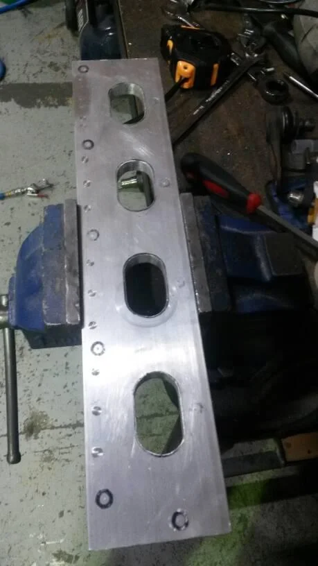

A new intake manifold was required - this was a good opportunity to learn a few more skills so bought a tig welder and went about making something up. Unfortunately most of the photos of this have gone AWOL.

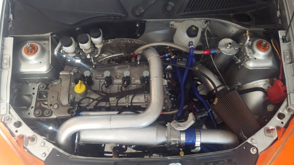

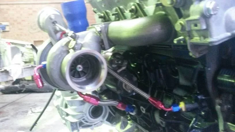

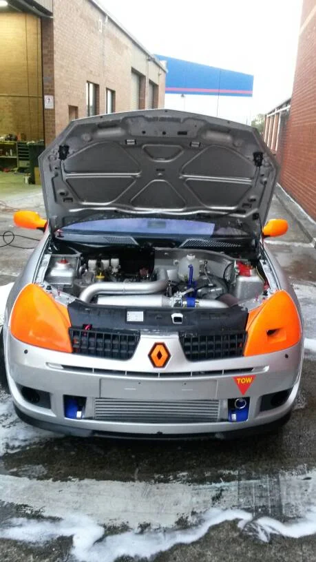

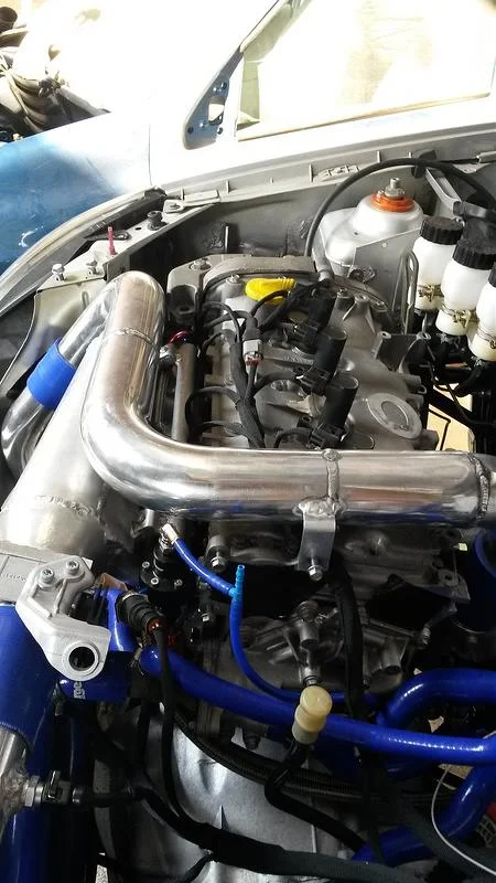

It was time to bolt the turbo on - running a log manifold I put it all together.
26hiNq_7hj6HxMt8_CMr7uyanramBqyCRIurGOL1DYz2WMmTOo6s4Yj9_vKW0TBMfDj3LSLYKg8kygBReyqHBhgebyd7Y1jL.png

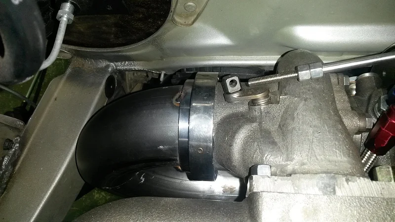

With the engine back in I welded up some 2.5 inch intake piping. Also had a new fuel rail made up with a return and installed.

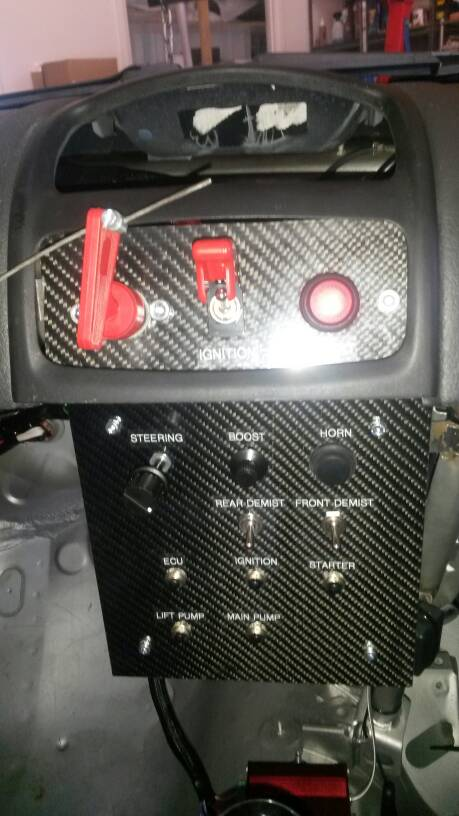

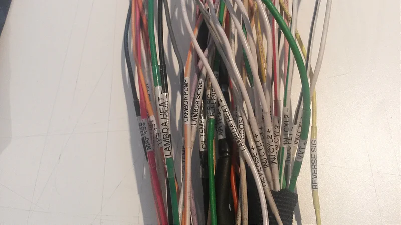

Time to wire. Having never done this (or most of what I have done!) I labelled everything for easy reference.
WwXkCsZAcapFw8UkM7WyhdEuiAl2IGEjxS8nCCNtvqaTMJyfsZyTPJEj7wxewnTFzZF6iEptW_ovPGPcWKy6rdliFLxvgMIT.png

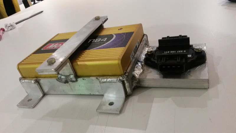

Welded a bracket for the Motec and igniter and connected everything up.
PonpQ5dYGJAMHvwNWIYmrSenfawIRGU_t-2g-JYUBVO6rpEWPHIHUdqzCuLhWxREbrYaiPW_g7StSgHm0UmpQjzVMAbYjYgX.png

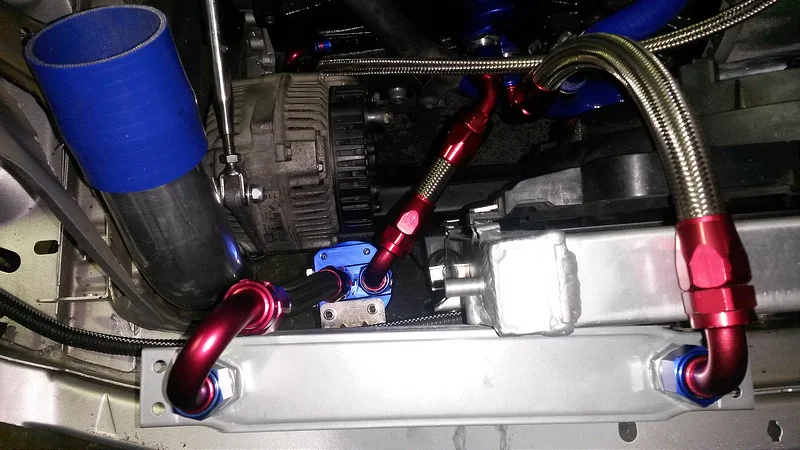

Installed a remote oil filter and oil cooler.

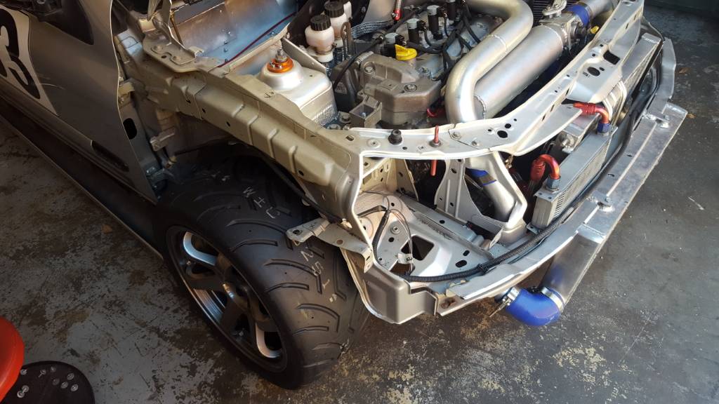

Welded up a 3 inch dump pipe for the turbo. Very tight!
LDeKEogbsERFHqlYw1lCHBflESR01BMoVVZGDl_KRfSWbcO-uX4RN8cBk7z2Q6Xqb6eWTwg3NXyUMO7rRiZH486Us5mAV7p6.png

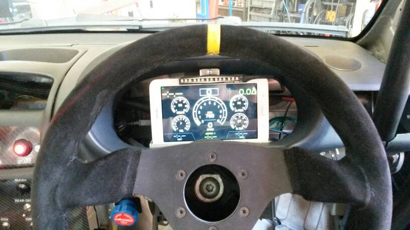

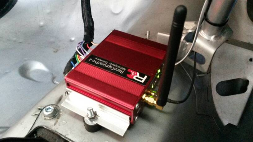

Before heading to the track I finished up the interior and put a racecapture unit in running a tab dash (very cool bit of kit!).
Stx8KY8FEFktNmiKkSvywSITAXxDwe8vlZJOadNT5WWzIFivLW_EsbZPubYzZ-MyTM8ERpGi70g1ZujjhB7FkxcI0dxeAeo6.png
vO9Y8OGQvLTnLsk76Xzj3205aXiK6DkyO7PuXLtzrXpET0CyZn6gPq_9U1hUH-93wt3OtHheJHcXS6oHRLkeDBfz5UqojpBU.png
H61H6D4BqSbFh5tDNcSRuZXJSRUxt66yiBq780r-fLRB0A6yrO2nvdsEBOVViattfFsv9fsG39W-CsBOgo6pFbczS6K_bCMG.png

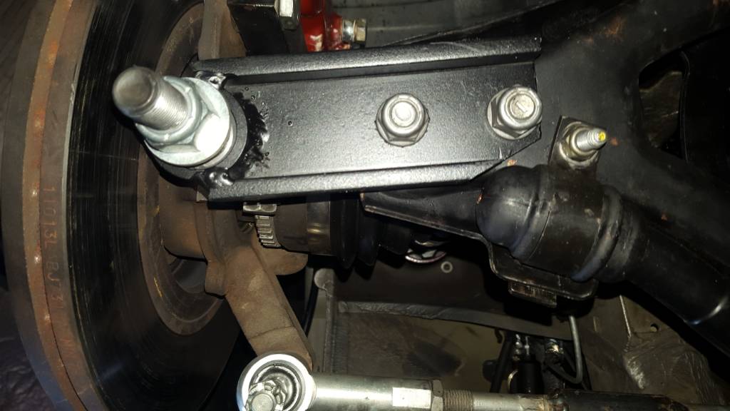

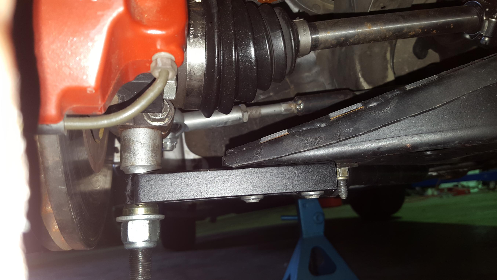

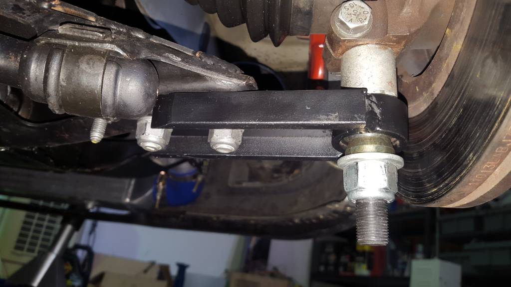

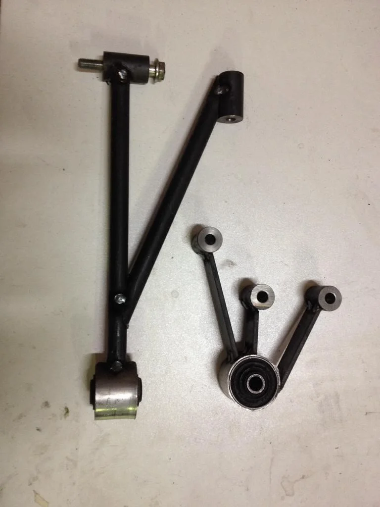

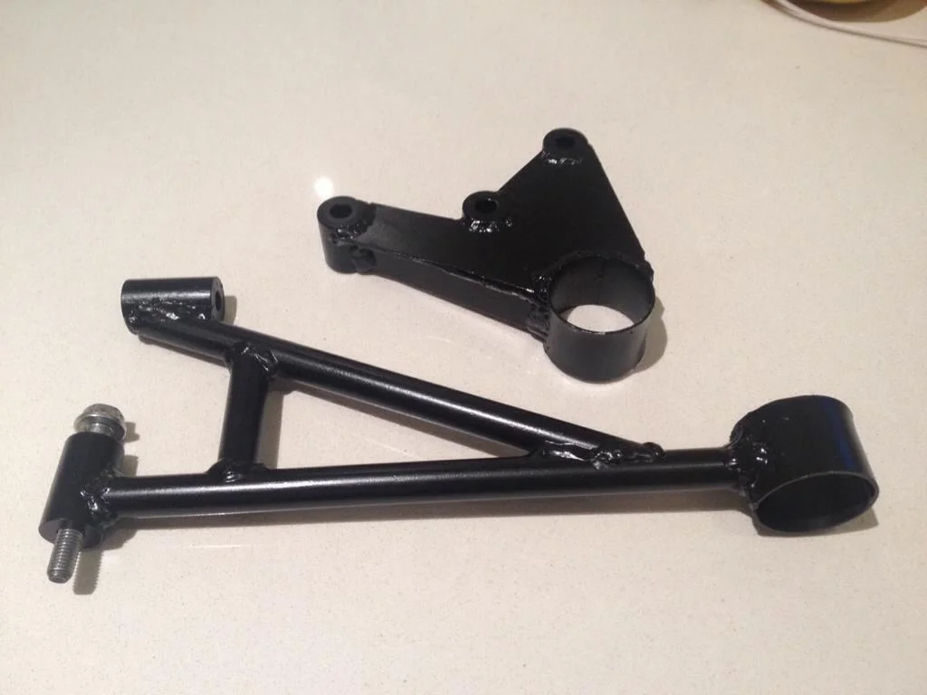

I read a lot about roll centre adjustment on here so made up some lower control arm ends and pins.
hGVswdOeNLO_1e7dNM07yAE9wV3d6sGkJN5e4iCZN0ygrZOoXRmRNac7pakso8u6SxbDx8MCAov8vWKyr5Fy9-_BdelQdsou.png
I took the car out on track a few times. Everything worked as expected and it was a hoot to drive. Unfortunately I had an issue. When I took the head off this is what I saw.

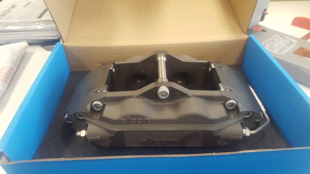

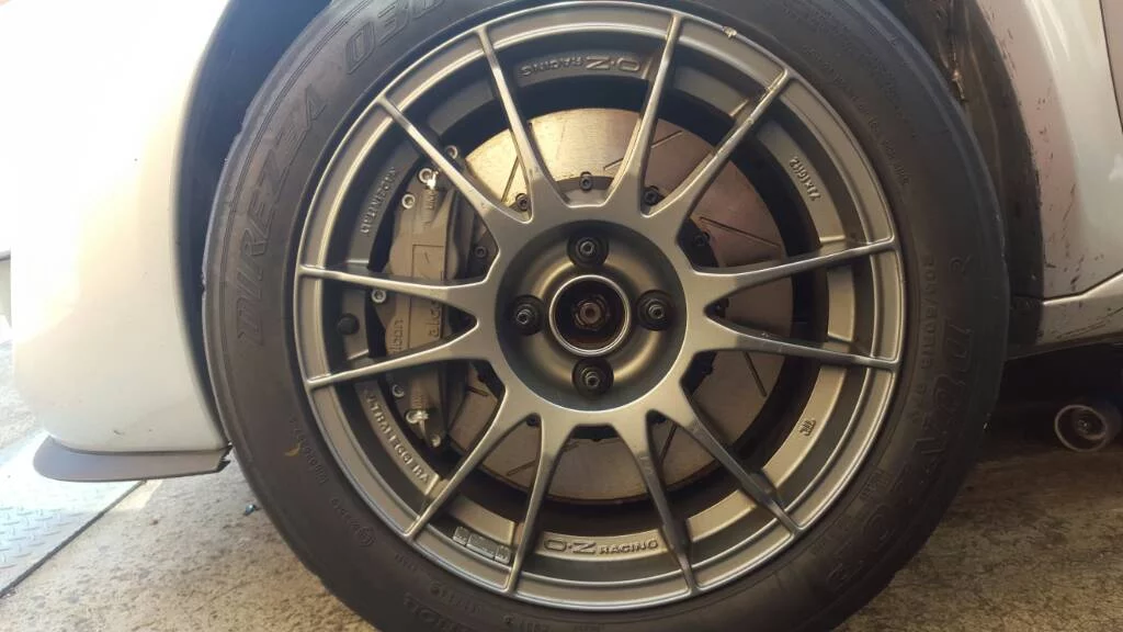

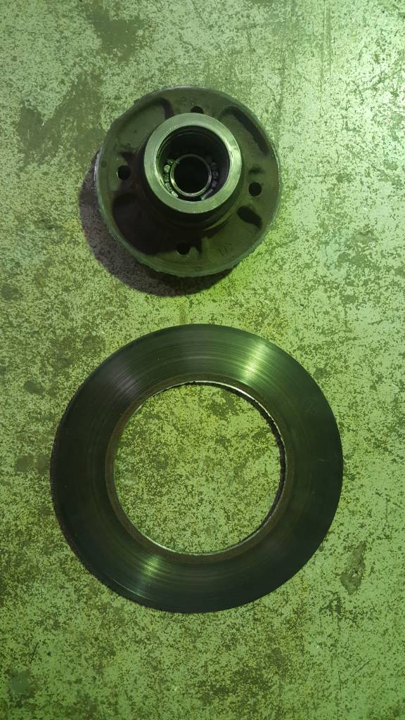

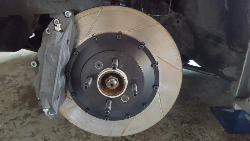

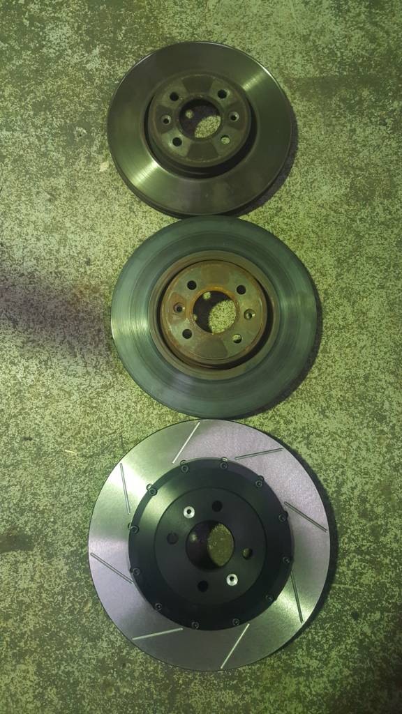

So while the engine was off getting rebuilt I decided a brake upgrade was needed.

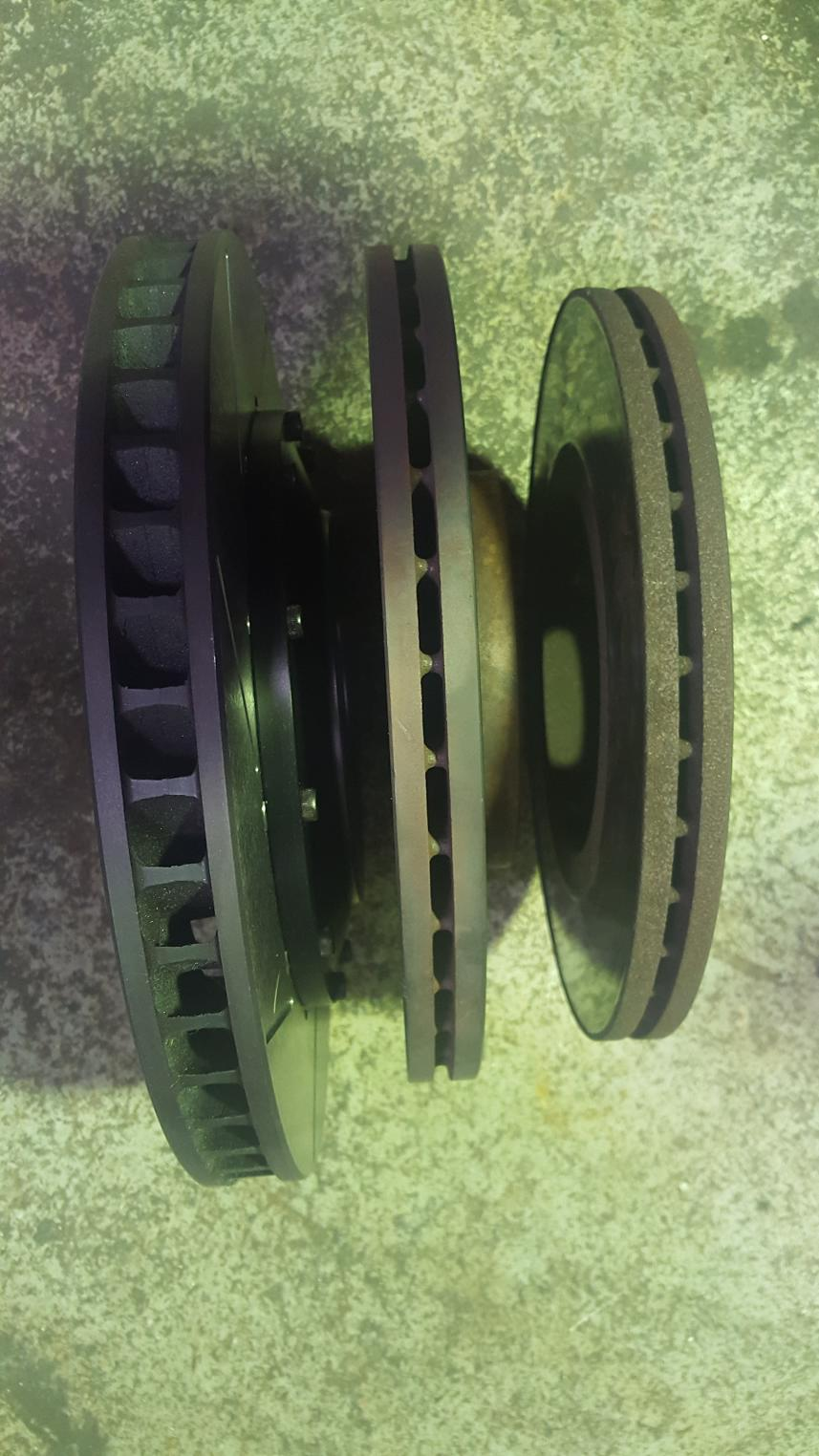

Ordered some 325mm 2 piece discs (compared with clio and scenic discs).
Y2wE3L5wyIPIEGa1FcnI4TElmP5hUKyD4_cW7HOEn8lYtycMC0lbGTBrN5k37VXEDGVRoO80yTcK3_7M-YBqXM4A_pjsgRnA.png

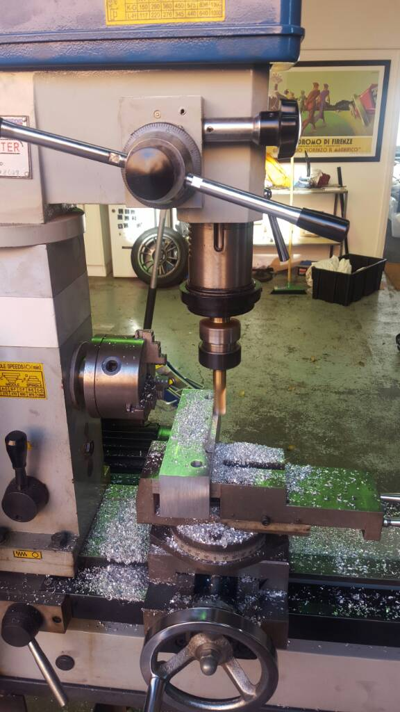

And some Alcon calipers (this was the largest setup I could get under a 16). I machined up some mounting brackets and made up some lines and got them installed.
5g8lZzi_srGJQAkaisnluc-KPYKL1l1KCvZBnremr6UlFLnP_Rv_DUHBZ6T-hjkmknFv66MS8peCkIEM-6nhgZYRyAuxswsE.png
0Cp_My_s59of2n6LdJtl8f_nMfdmuZs7z71vO4523lPhU32KksB9S6CcjkYVXKf1N2A7bwr7-EUdqqHSCVL1tgRtXvNPNB3U.png
eIA3D2R8vrSw_SLQbTGlidqhEgP2YZmpFYf7xRsHO5ZsckAmo-oPhkzE2MU3JBn_W-4-vWtEeNpo856XYhnhngfCta6OMajr.png

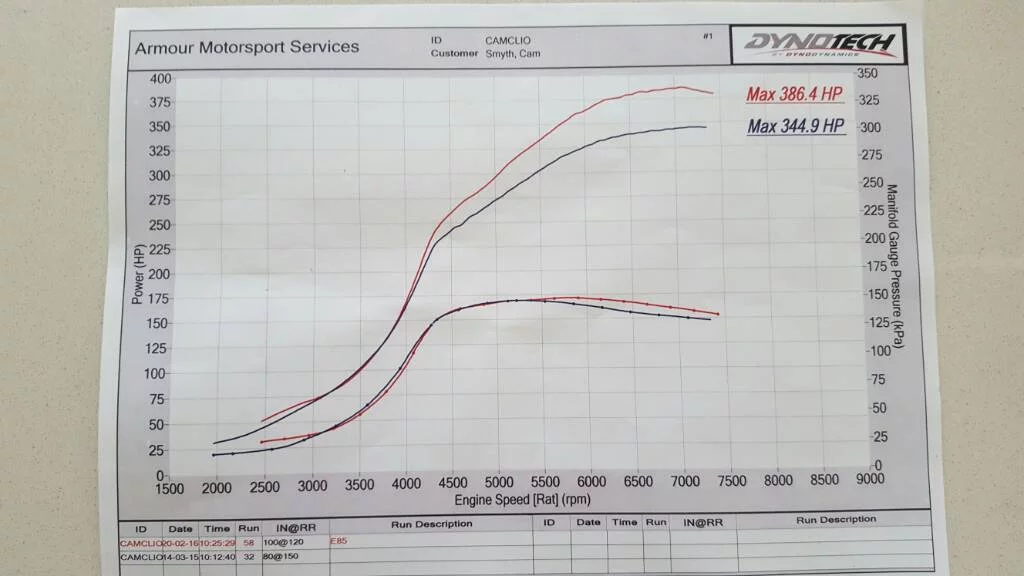

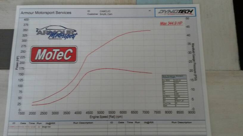

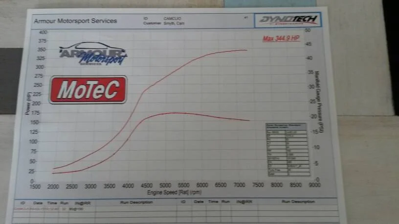

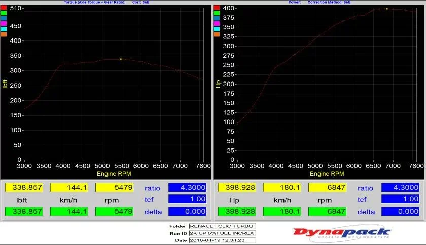

With the engine back I went about getting it in. Having decided to move to E85 I upgraded the lift and main pump and also put some 1500cc bosch injectors in.
And the initial result was 386hp at the wheels.

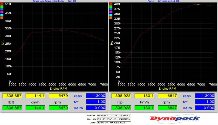

e8asmXYlpEtSLAM0Wi3Iq-HQULvNkScNCnyjcMdUUFxCH2yPG9GQaPnzfmDmpx-zgqomV-revBBcn2MaYWkZdB7pmg1qFy_3.png
After some more work we landed at 399hp at the wheels.
317cb6Uo0ovRvJCTPdrX-UuwQrP2PpTbukgibcO-a3au_w_3f1LhWfp_VhTs54AIRqiuM3xL1wtZo6g7M4j3wPm9PMrDQF4V.png

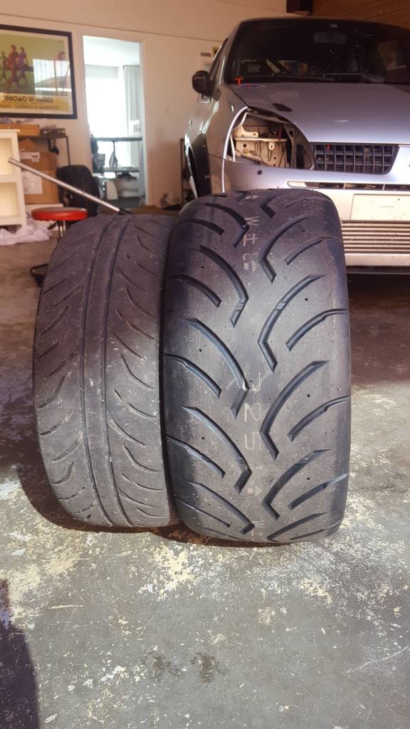

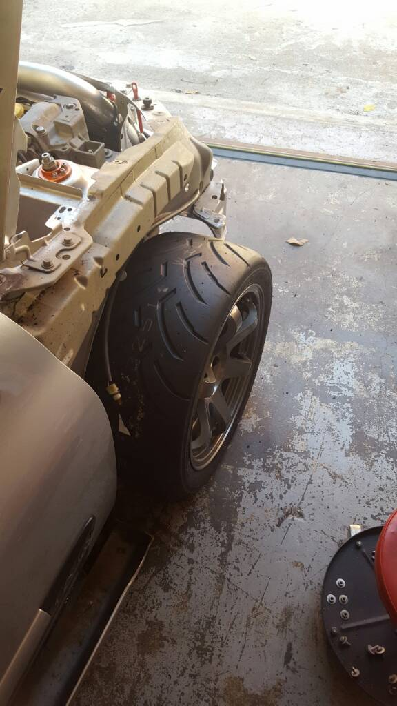

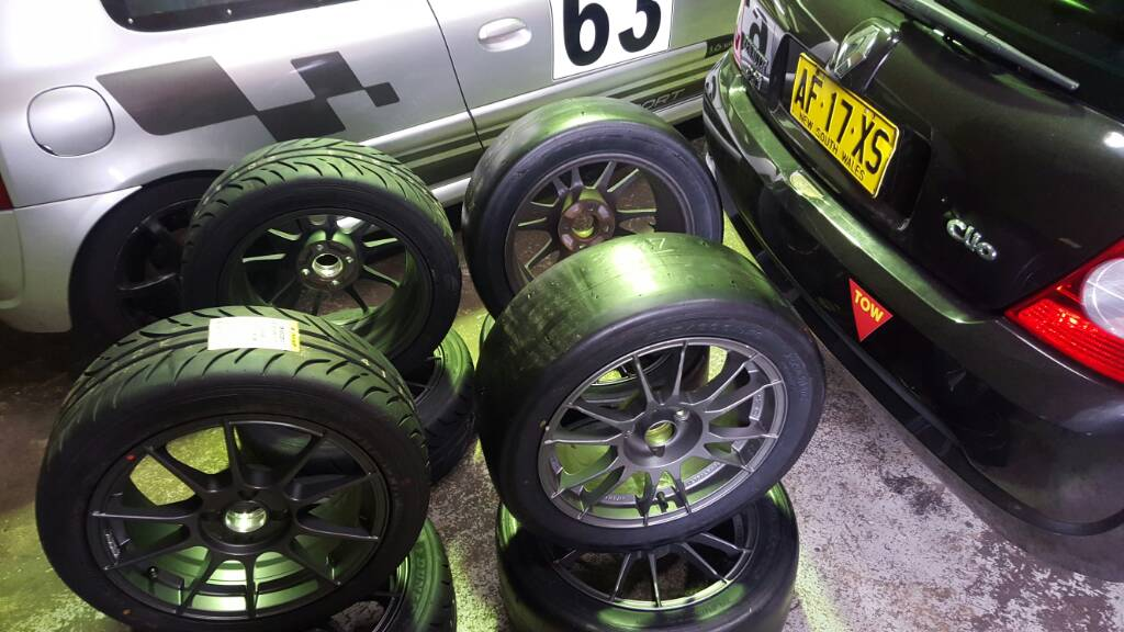

Decided to try some slicks in an attempt to get more traction.
XkO-f5uhDlxhaUOT5lGUKa9EIaalKrIwUM4DMVY7vmEnTAsHD99itJIUc5ONwDmy9CDExUkLu6QXoHXH7pQ3mYLVwroGkv53.png

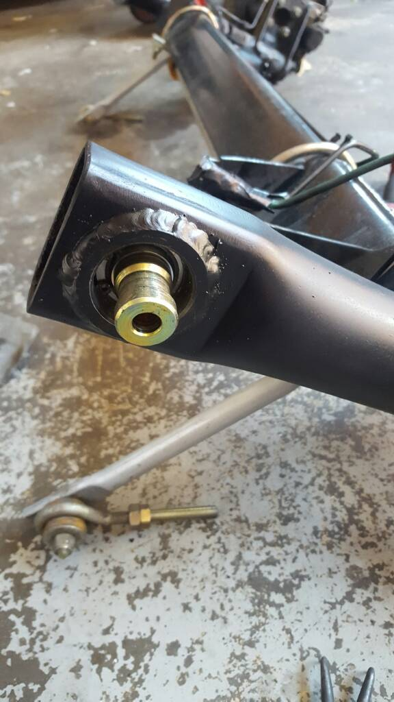

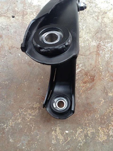

After a few more days on track I decided to install some PMS rear beam bearings.
KTP-Ew5X3nnIiuVM_6hiJlVJnQl86Xm8iAYfZ_1PH6P5S5RLHrDrYo_8JJnmnD1zdmj_HAUU-mwYG9gYVpC46pcIjeEFDbE9.png

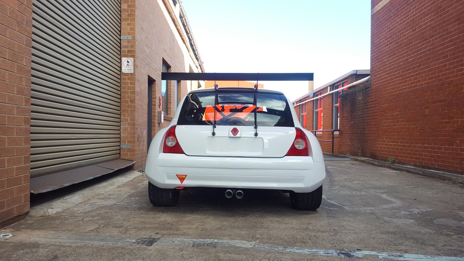

Then after a couple more days out I decided I needed more grip. The slicks just were not doing it so after some research I decided to emulate the FWD time attack cars. 255’s on the front and 225’s on the rears. The guards required a little work to fit.
YeHIbNCTKz0cK6SCF3TZxqGpQqgx3Z-04QtQ-UjZtosNWu9Lo8lDwF50jdSjHJDn5SUfWSh1Y0g8qq6ZyjyW-w3U23WGiXRm.png

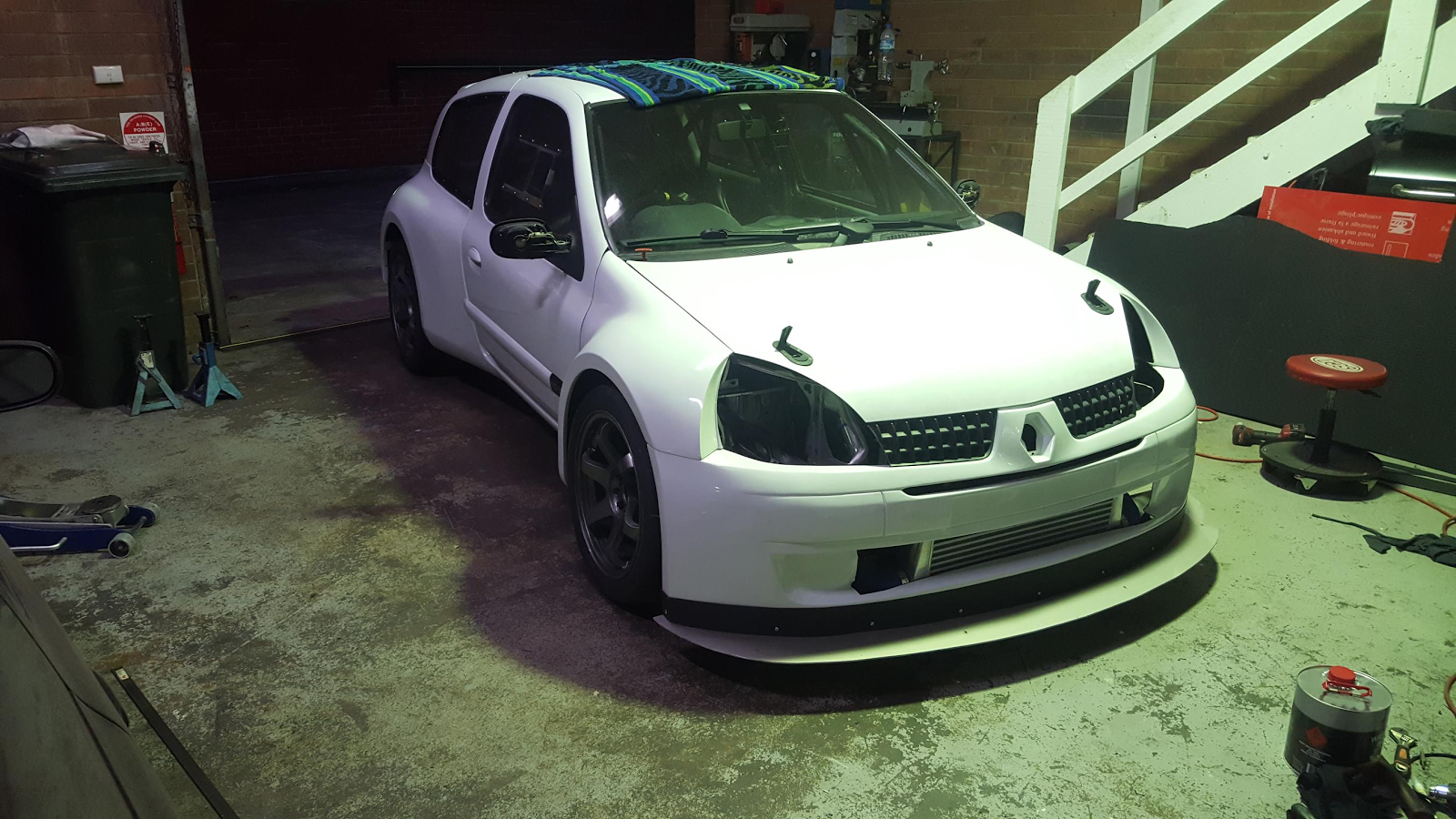

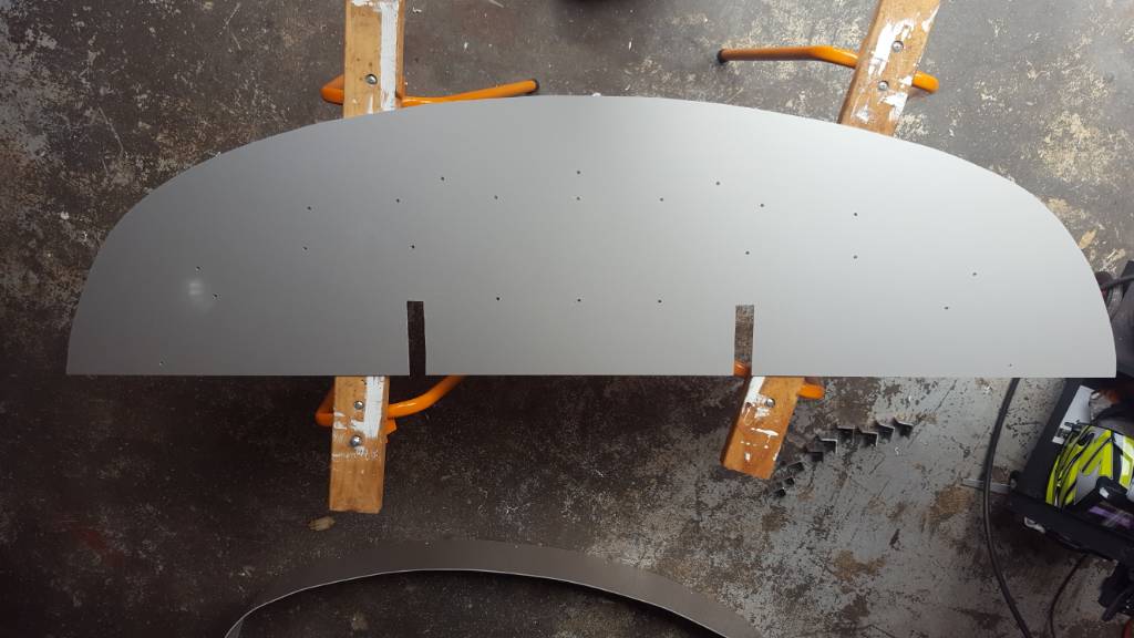

Also added a splitter on the front. Amazed how much difference it made.
zEQJsIiXS3O7xbWVYnImEO5mbXTeN48ezN1JAQOQGRlb5ehtDOCBfUukio2_mR5qimLa2yENW60As82mDkfugQNfjodwBIEO.png

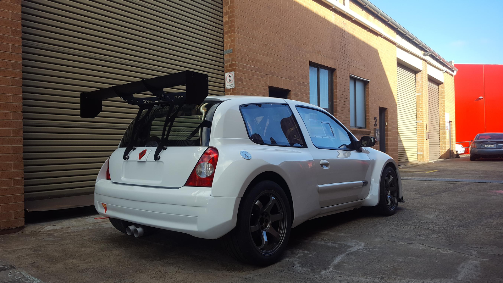

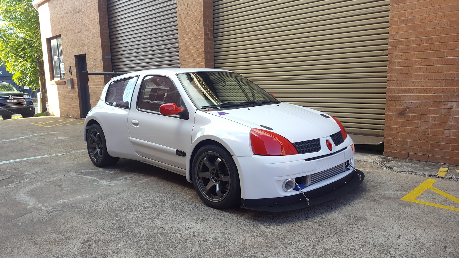

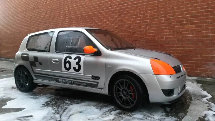

At this stage, with the car pretty sorted I decided it needed the looks to match the go. So, after a lot of work making it fit I put a s1600 kit on and added some 255’s on the rears to match the fronts (and some spacers between the rear beam and hubs to get it wide enough). Front inner guards required some cutting and welding as did the rear.
tJ6SXMGDbHYe3zFjCb7XYX2xgrIt0JJpUDgiCbDr0GVmhnys-xthX1Skb67ZLjkue9iMXRjwdQy_pdZWr1KtwN6Z6kOMWv2s.png
jcoaVds-e3gWSECrrI3n3hsZvBKb279XQ-q8VKqL7wJdOvfrDCDdqcmoUz_yd7Brukmb2w5EpfHUzNrh4mHPWfAV_zSiJgjx.png
p3bQRD38kRbSVcoIBwVAGBP2uR5Mi_WYAMxNlym6-9Nsn_tekxKpAwSnxbxgxNjccPE3iHHEmnlhuMkumvxyniRWh3UZFFc0.png

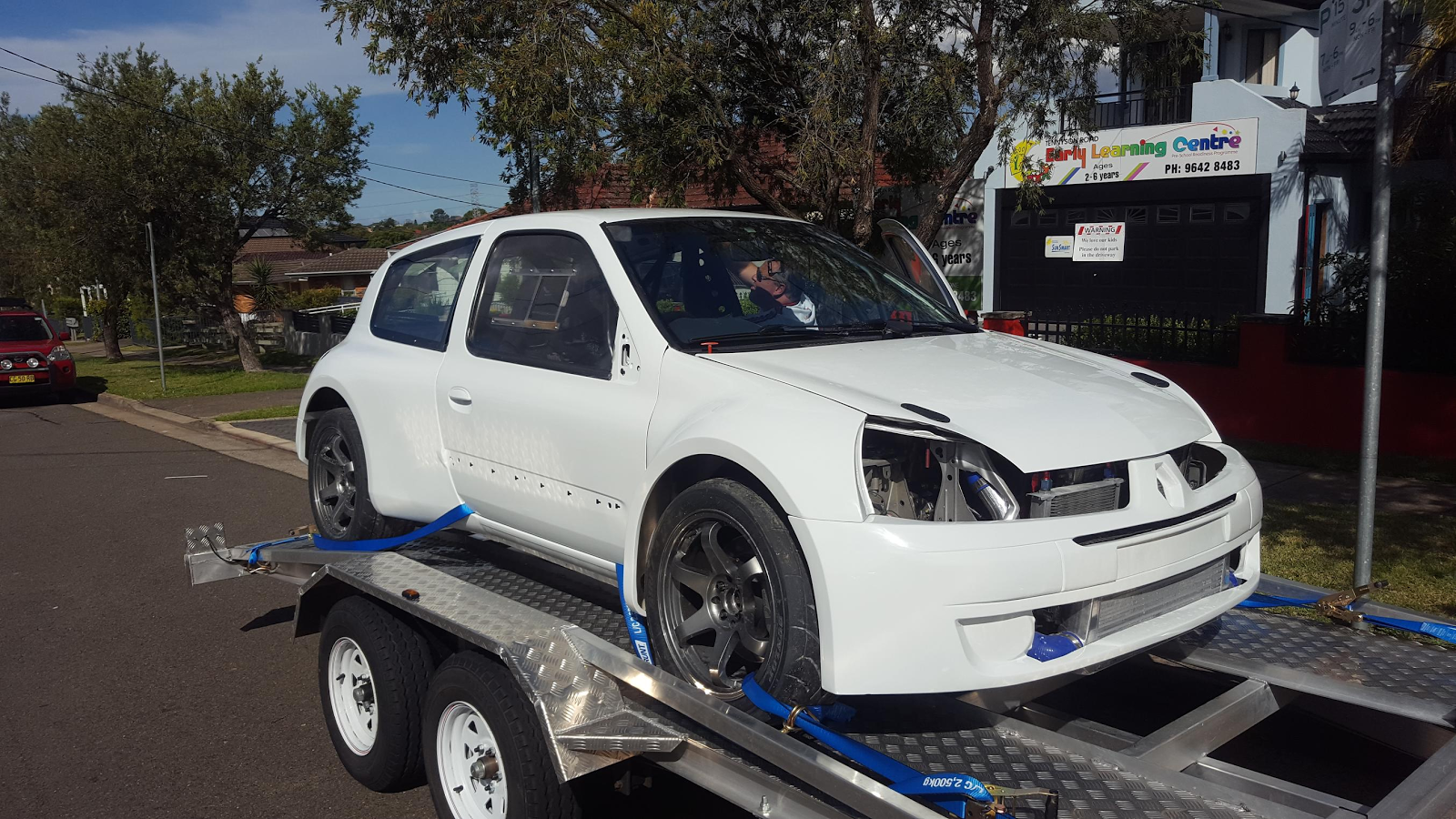

With the kit on I decided that Glacier White was the colour I wanted so I sent it off for paint. And this is how it came back.
YjECt-jxXhYcDqmq4EjE-mtOkLcqXJjCX06cHmseVZkdPrSyoY8aOW-6D065Z12tnXSpN-fnr5u3AaE6n7E6L89RjAWaGbUD.png
zrBJyHm8HS1I2giSF-LlSQeuWKnAQMiC2whiF99YmU00K2HkaMdfwjNb2e06iNx48LrKbRgYjpFxBcdT329yvh9_uh1dDpqw.png

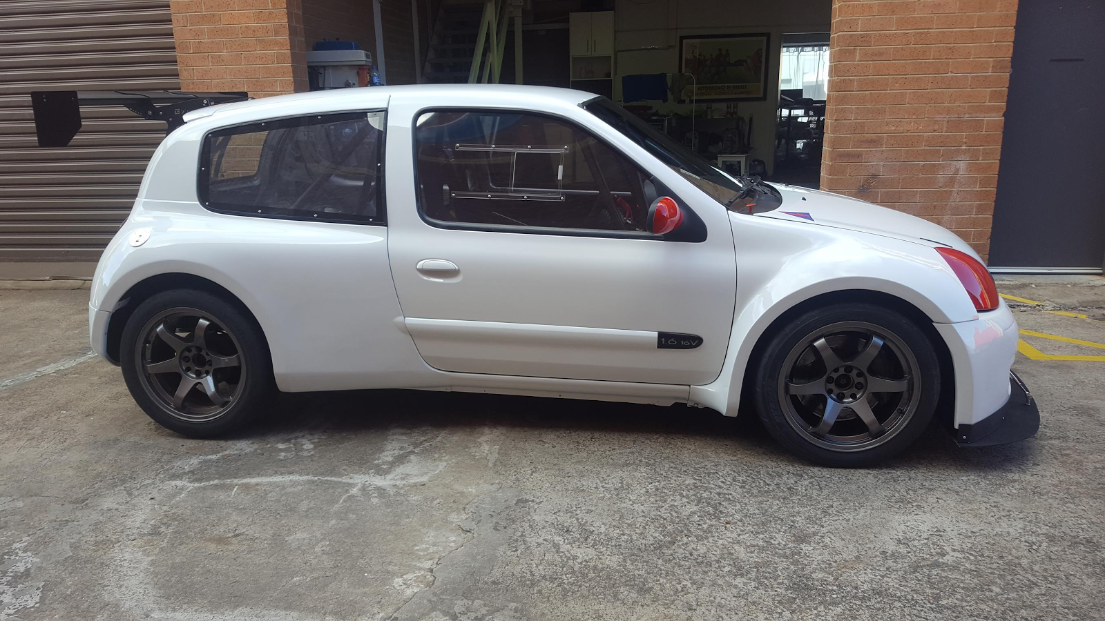

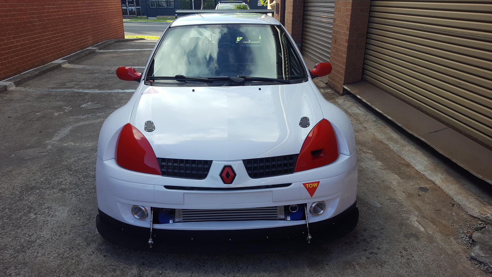

And with everything bolted on ready to go.
kXDj2hWHQq1iS_sm7z7QcIY7dx1Rx7E2d8ZgpNUkMZs7PufP5qbpUf15z0Gs2a2Rii9S4aQ8PESYj-dgv4YQtP1EdML_GZIc.png
NnIlT8Dt-Cn1s5HWCb1Qkp07TvQwCt4aoYYOgr43A3WxEIjSRmKmfyMquV-yp5B_Zx5lP0gv2KRa7w5_K_eBtZbGU_4eHJVd.png
3XCOJTzf8faDeXY4MtVVQN1A5Fd8M-4ztsHpCarkm_Alb_P-bAHlTeSXhbP01Y00H-ukpyViMmvIyZclqM7cb6mHYiUBNN52.png
R2Vjzody3E193uJedbc1IwrMy8Y2m8tEolE7svwM3DZUxxTPR5XQsWrEnFIK8uI0LVzcb7A4byolYaLo4cCBRJzQ7z7j4bSj.png
oP02ahG82NzEa87aoYQflQ20pD9CMCR5e9PoOl7Xe50fFVF8Z-PigWAsyxw6JMCLIuXs-KtRKPdsSM1c1GpRuWIUlPweuaDo.png

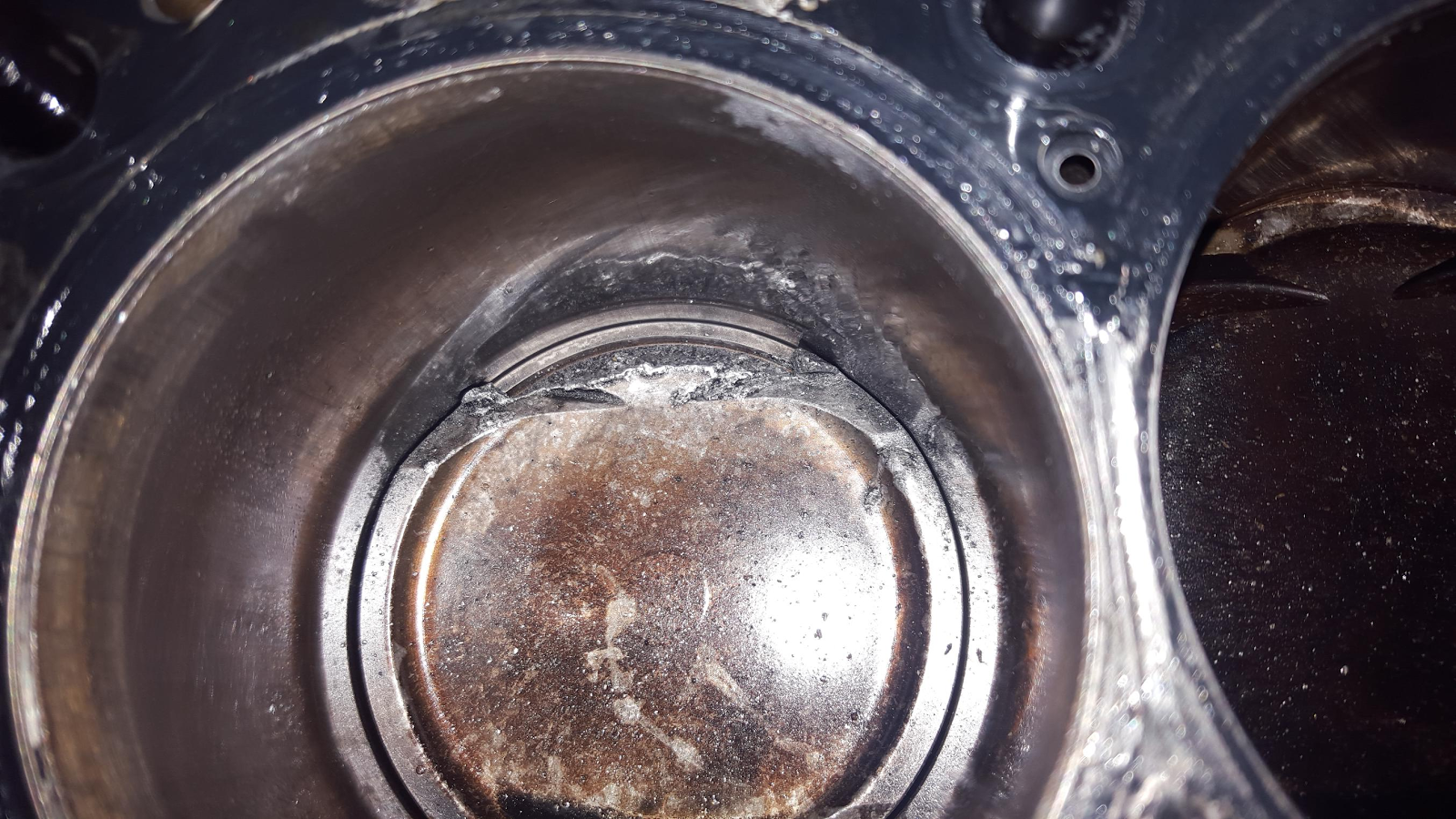

Have only had one day out in it and aside from a collapsed rear wheel bearing (suspect I may need to upgrade) it is brilliant. Can't wait to get back out!

Suspension/Steering
AST 5100 Coilovers
AST Adjustable Strut Tops
Pure Motorsport Wishbone Bearing & Stiffening Kit
Pure Motorsport Rear Beam wishbone kit
Powerflex ARB Bushes
Whiteline Rear ARB
Rear beam to axle spacers and Camber Shims (-3 deg)
Bump Steer Correction Tie Rod Ends
Roll Centre correction lower ball joints, pins and spacers
182 Cup Front Hubs
Electric Steering Column & Rack

399bhp at the wheels! What's that at the flywheel, 450?
Something around there! Was a handful on 205's but much more manageable on 255's now. Actually makes me think about more power!

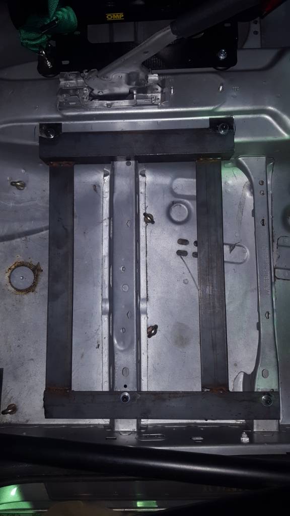

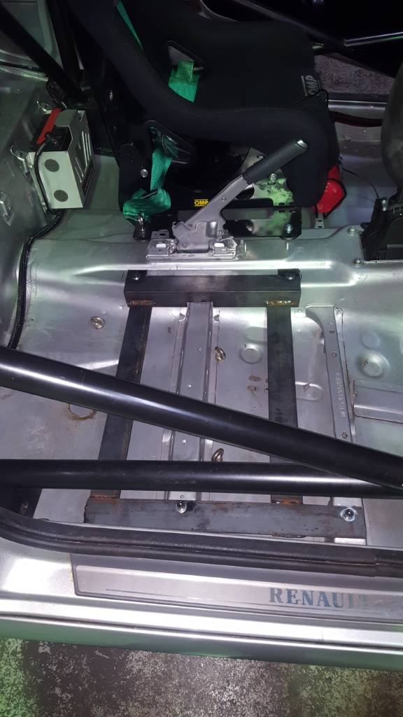

If anyone wants to mount a seat nice and low - effectively an inverted version of the OMP mount which goes down in the middle instead of up on the outside.

That explains the weather in the photos! I'm guessing there's not too much to be improved upon, so build updates will be minimal? Have you got any more photos of the roll center mod?
  Clio Sport 182
Haha, yeah, it's a nice part of the world!
Control arms are about 40mm wider than stock and also shift wheel further forward (more caster). A little over engineered but better that than a failure!
Bolts are not threaded into the hubs. No issues thus far but will consider if required.

Got black flagged for 96bd. Quick trip to the exhaust shop and I was back with a new resonator and just over 90db! Also collapsed another rear bearing - have ordered the upgrade stub axle/disc/bearing from PMS. Ordered their rear beam stiffening and sway bar while I was at it!
