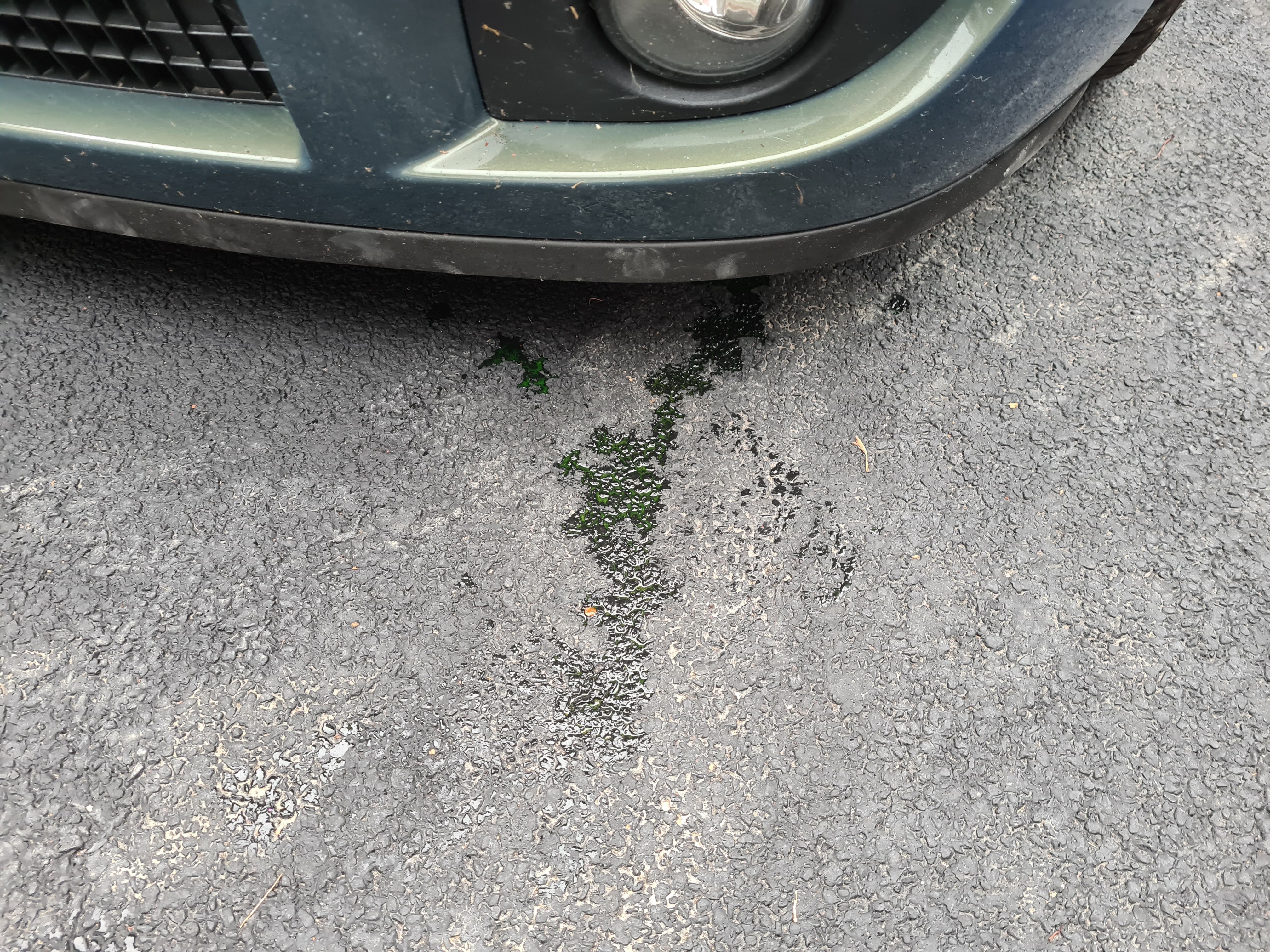

Well didn't get much driving done with local lockdowns. When I finally did I got greeted with this the following day :(

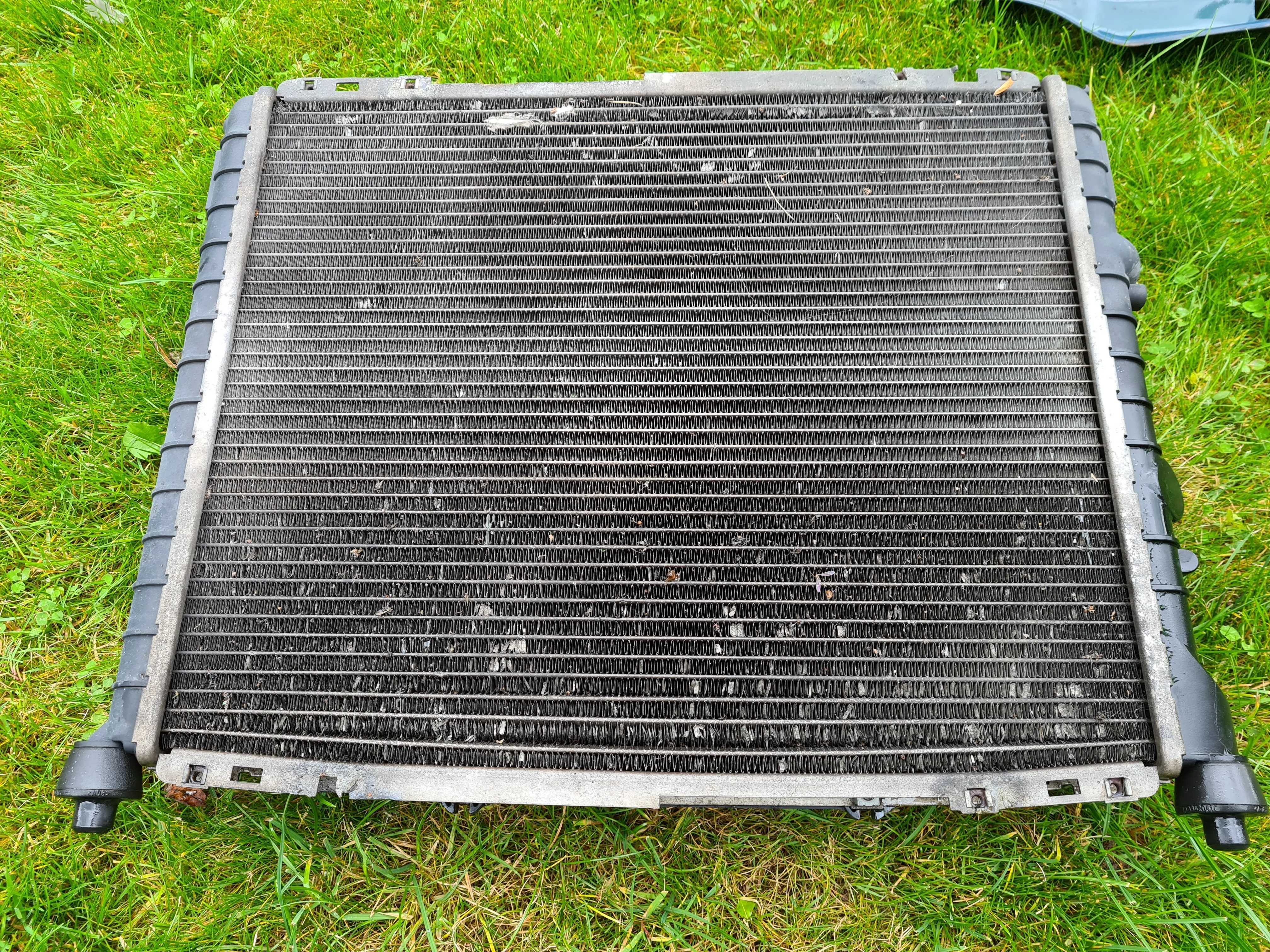

Must've hit a stone or sprung a leak, but at least it got me to crack on with the AC restore project.

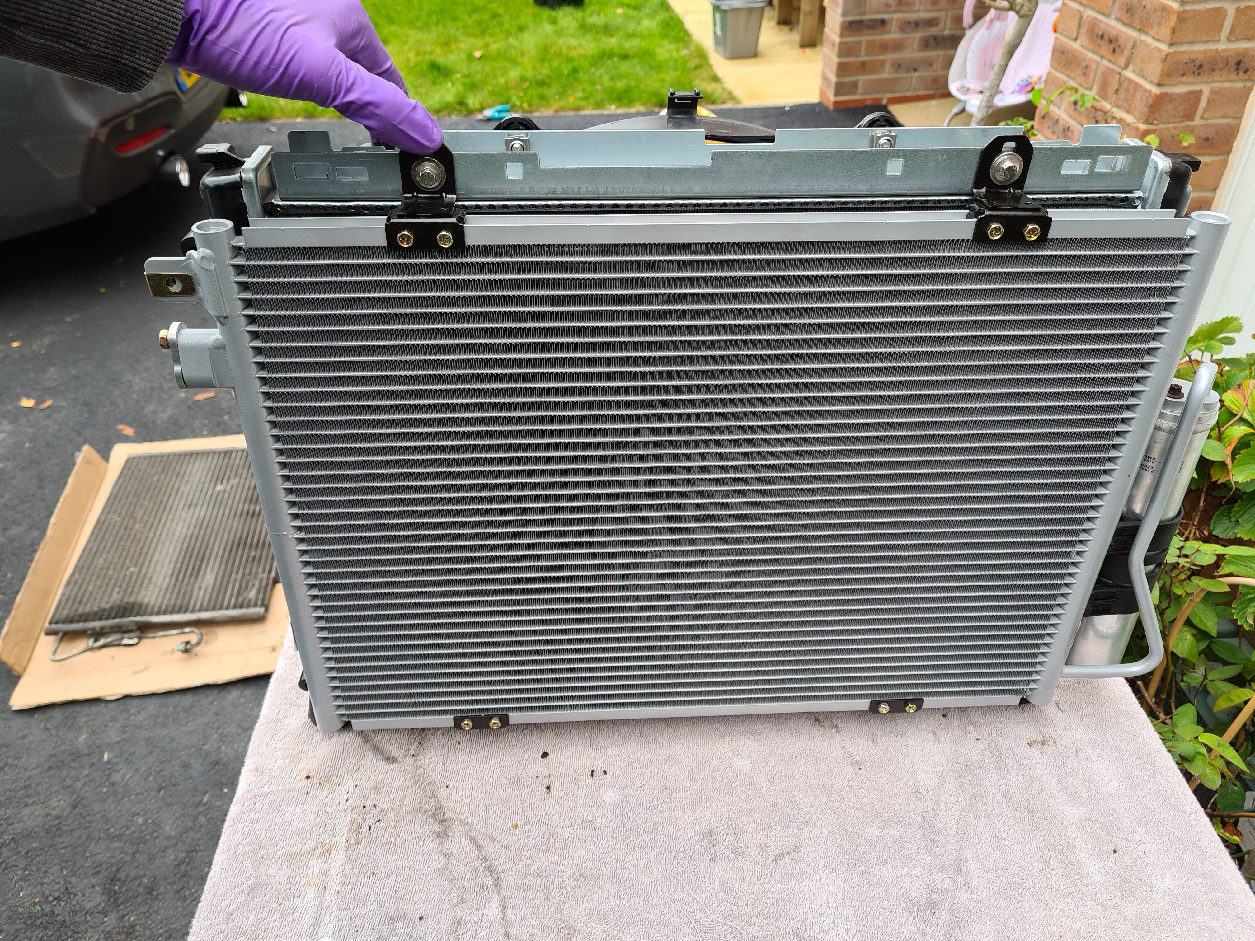

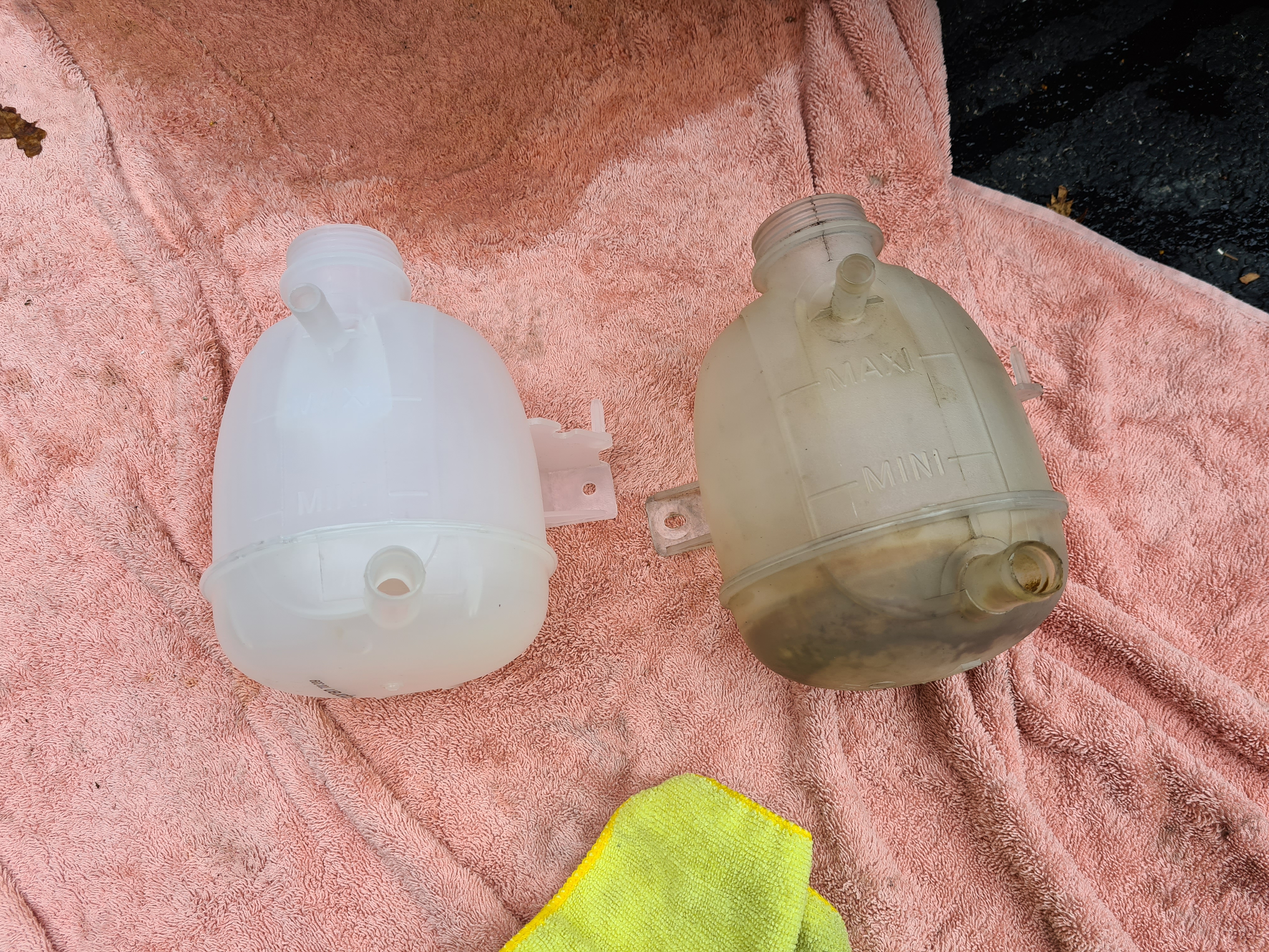

Ordered a bunch of bolts, nuts and washers, condenser, dryer and radiator and did a bit of prep work. Let's hope it'll be calm and dry next couple of days!

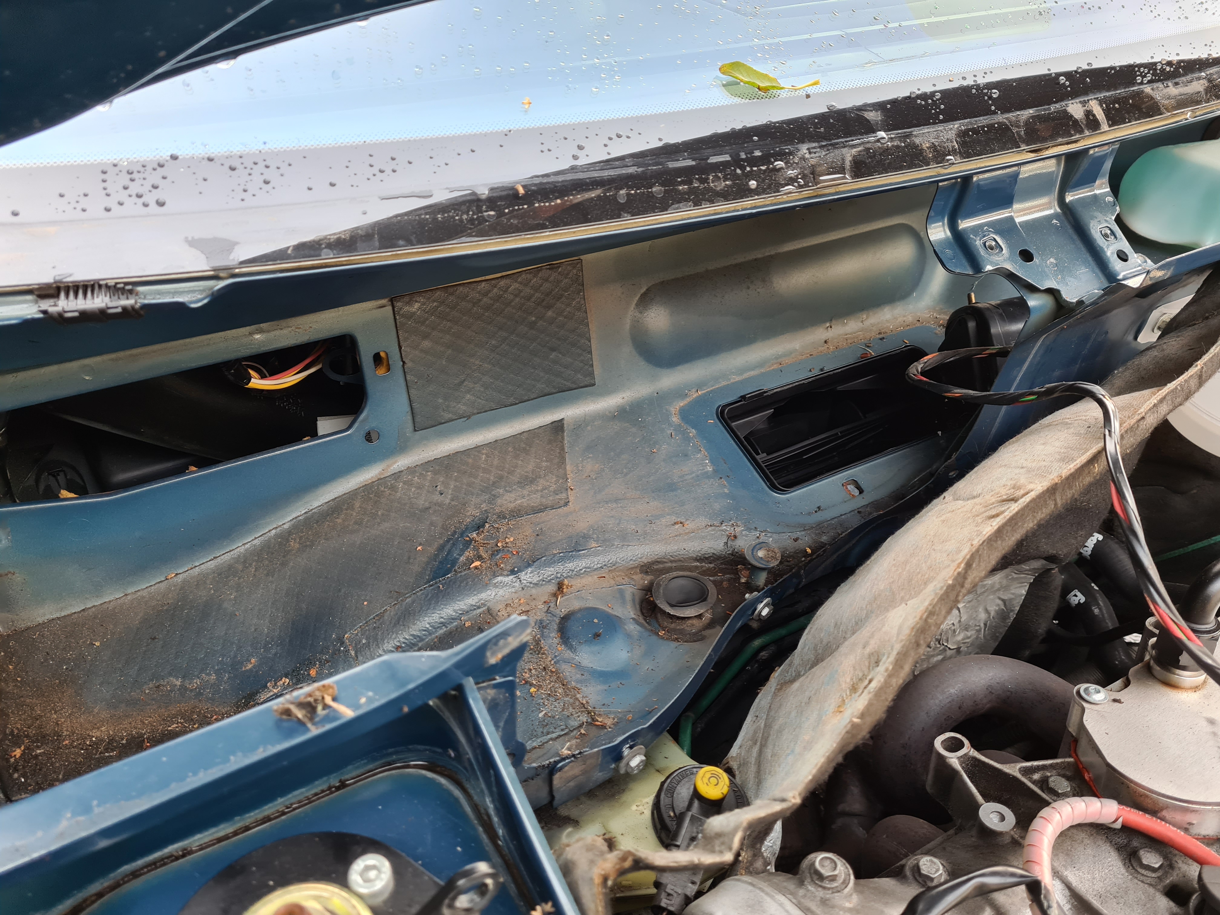

Scuttle cleaning:

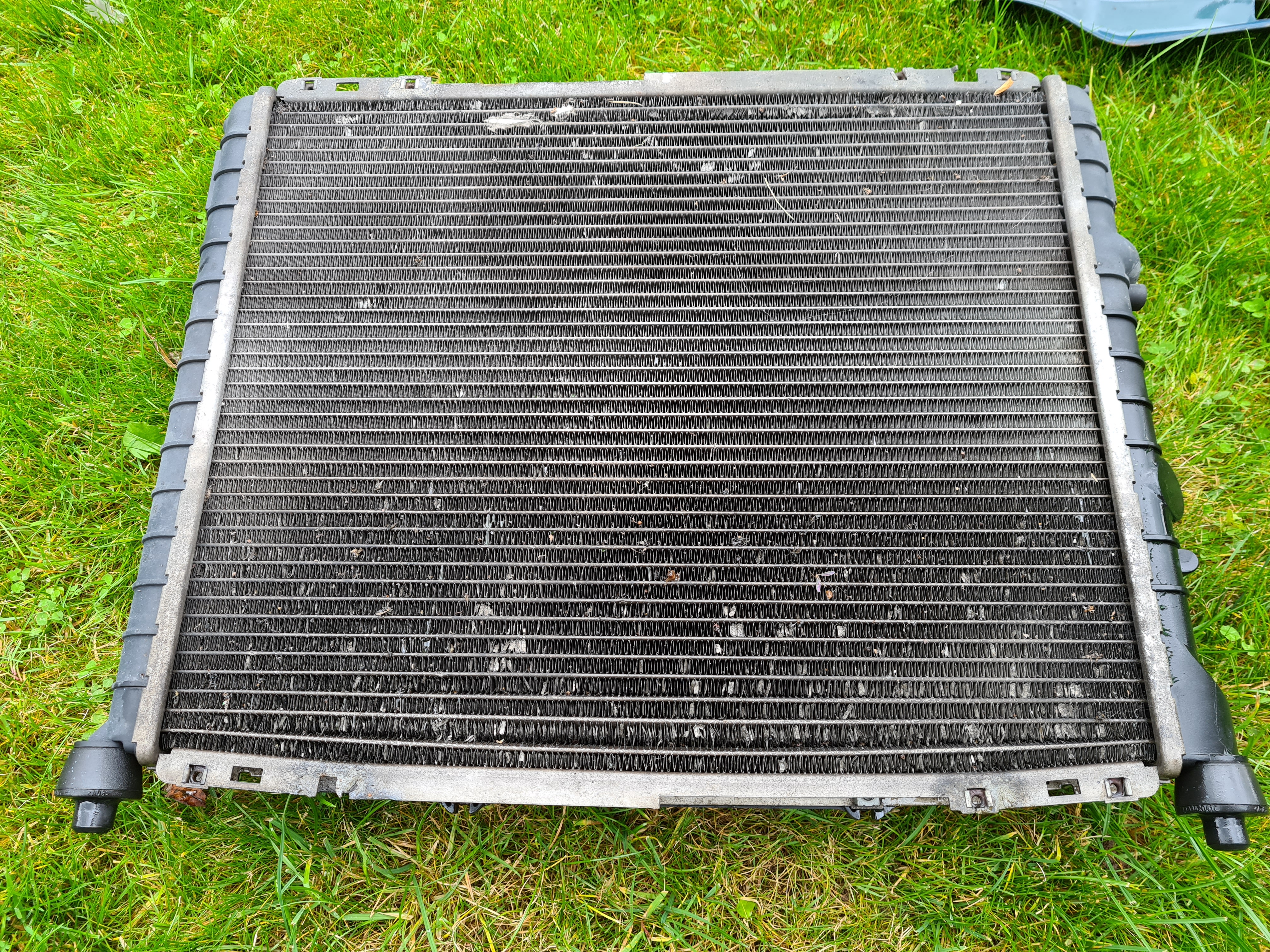

Old radiator looking a bit sorry for itself
New expansion bottle
And the new radiator and condenser ready to go on

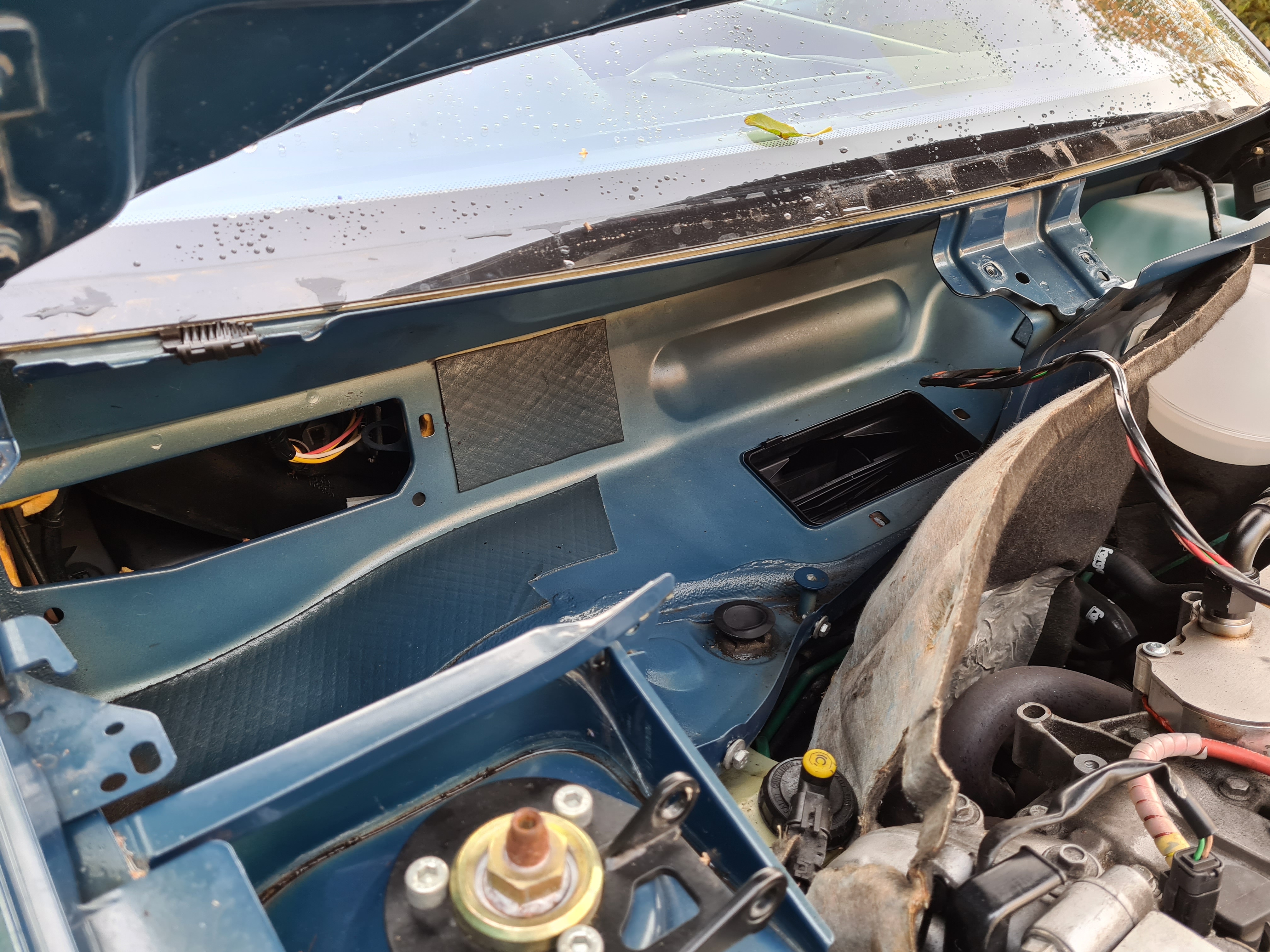

It's fairly straight forward, but I have to admit I cheated by using the PMS ac delete guide.
Fitting instructions at the bottom link to a pdf document with a fairly good guide! Not all bolts are showing, but can't miss really. Took me about 45 minutes to an hour to get the whole thing out and about 30-45 to put it all back in after cleaning.
Couple of things I found:
  • The bolt that you have to remove to move the central duct to the side is underneath the alarm horn so you'll need to remove that first.
  • If you don't have one, get a wiper puller, makes getting the wipers off a ten second job without risking damage to your windscreen or bonnet!
  • The blower motor clips in at the bottom and needs a bit of persuasion to get out while tilting to the front of the car after removing the screws.
If you have any questions, let me know, I'm happy to help!

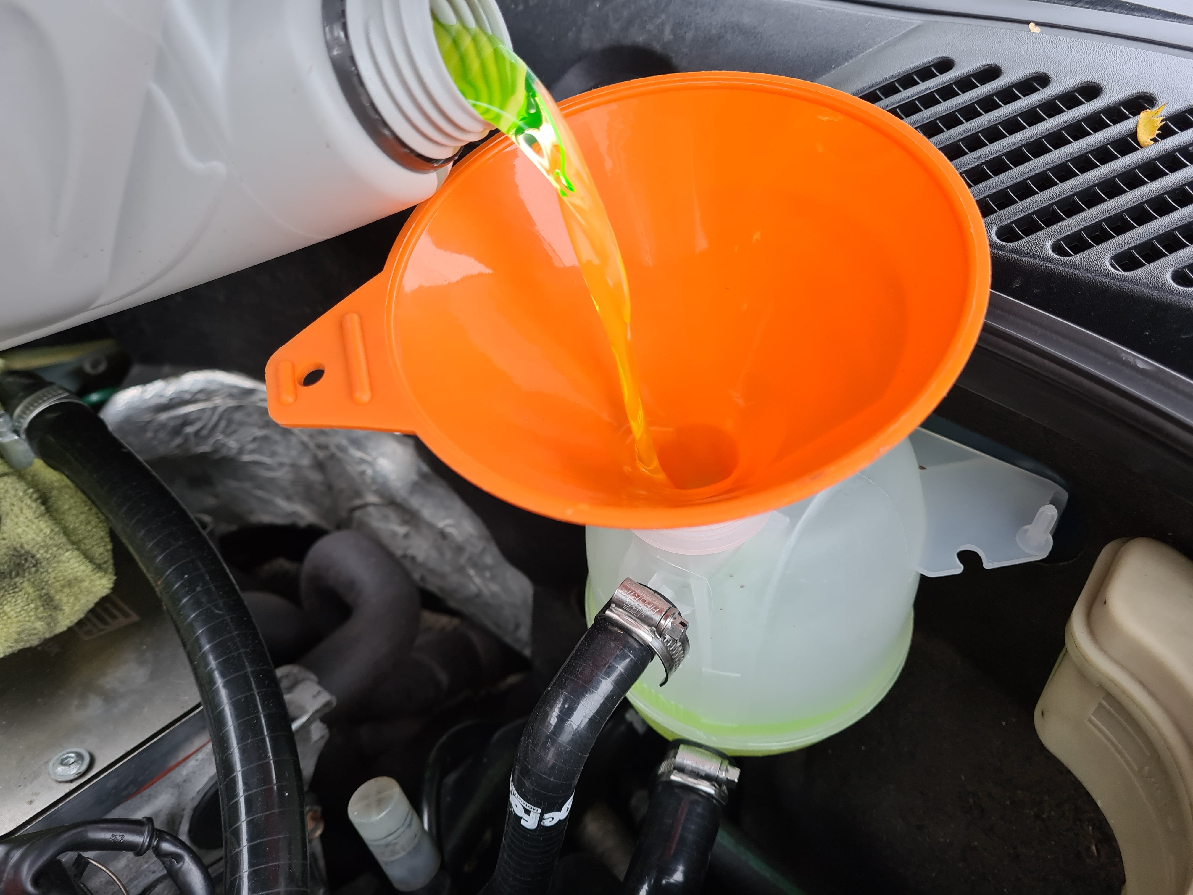

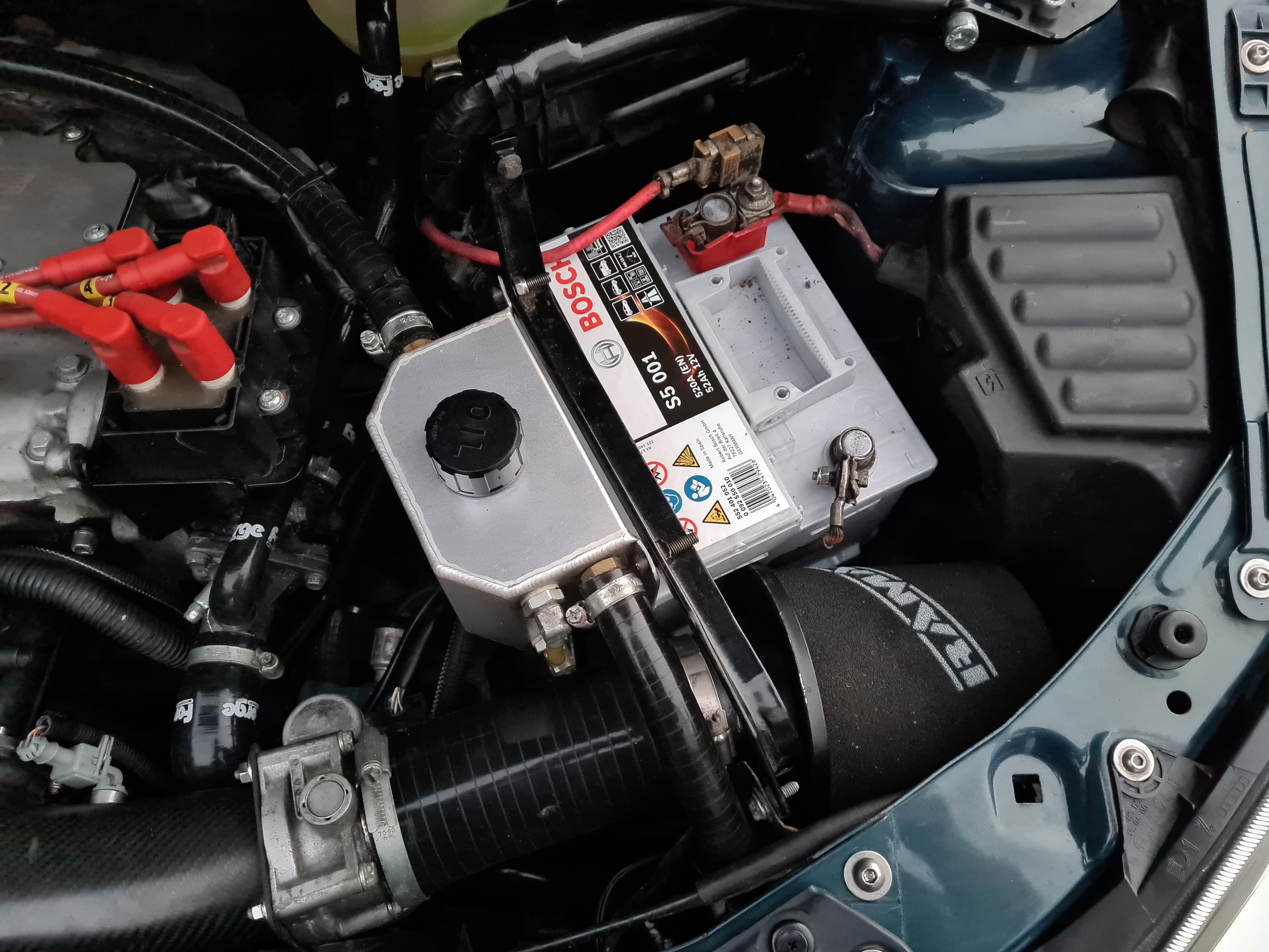

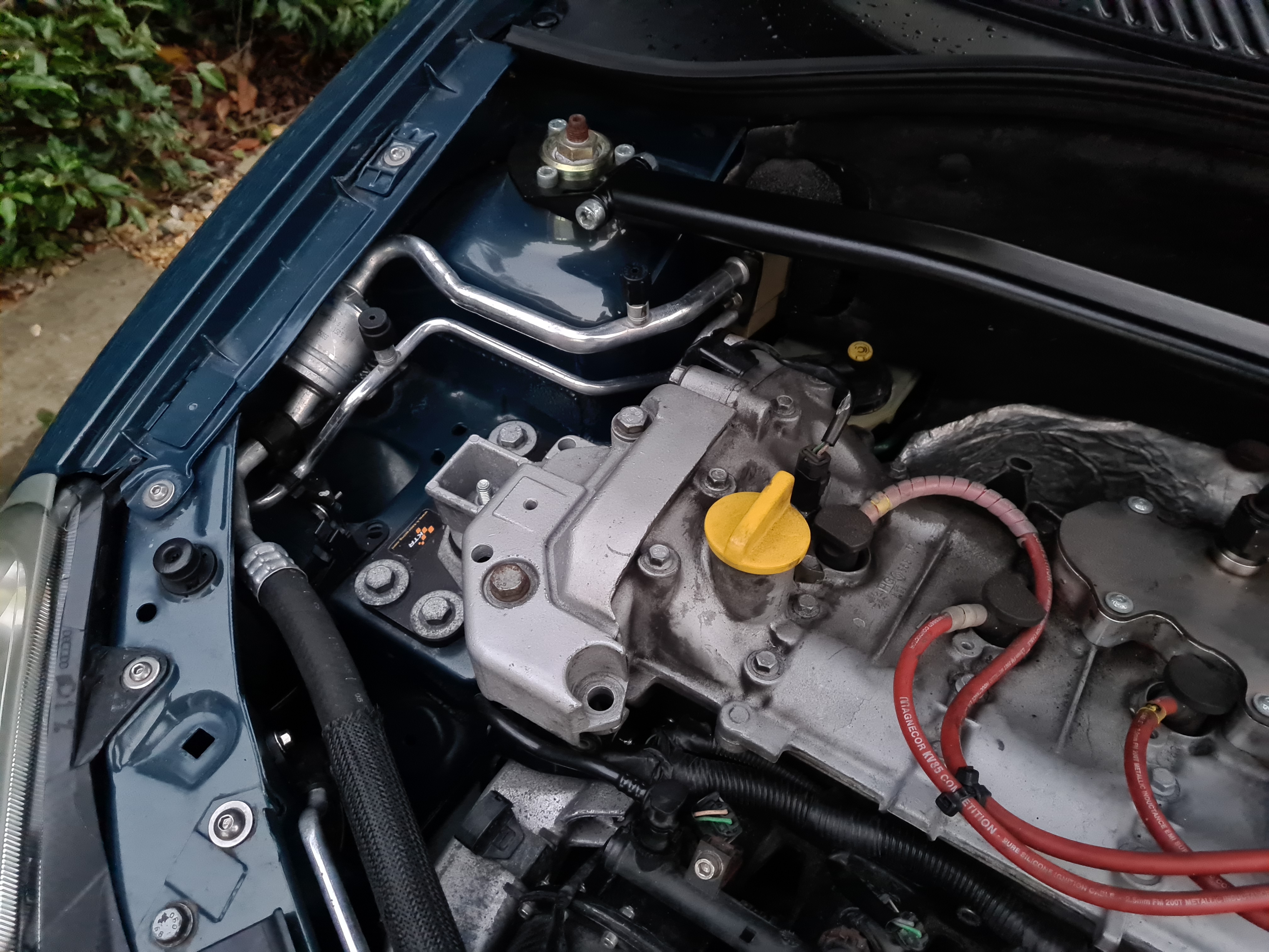

AC is back in, just needs to be pressure tested and filled and the Odyssey battery has been replaced with a full size Bosch unit, yay for no more weekly charging!
Pipes fitted
Fresh coolant in
Fat battery in (the battery terminal is just temporary, I just refuse to pay £6 postage on a £14 item.)

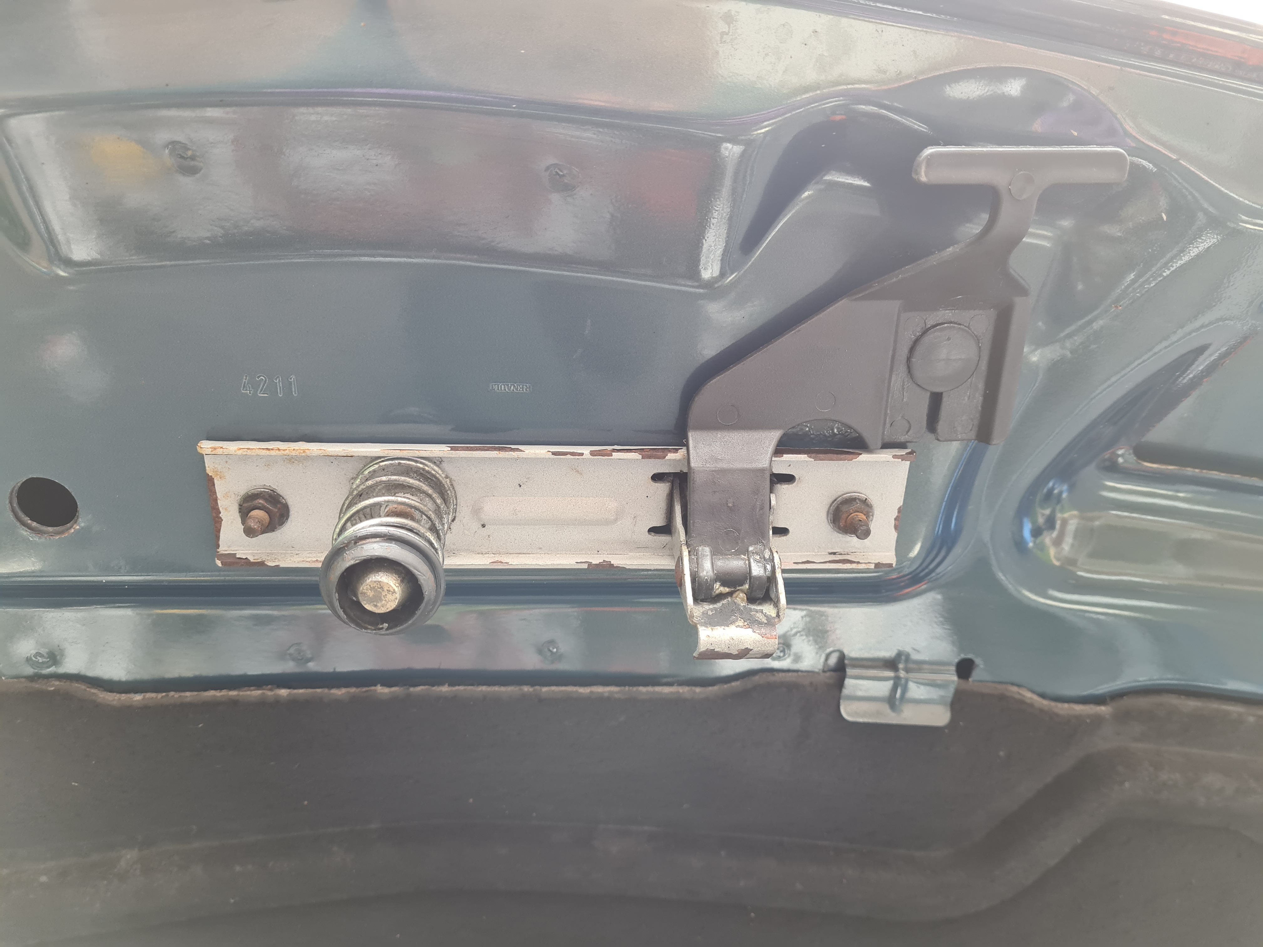

While there I gave the bonnet lock mechanism a bit of a clean and greased the whole thing. Works a lot smoother now.

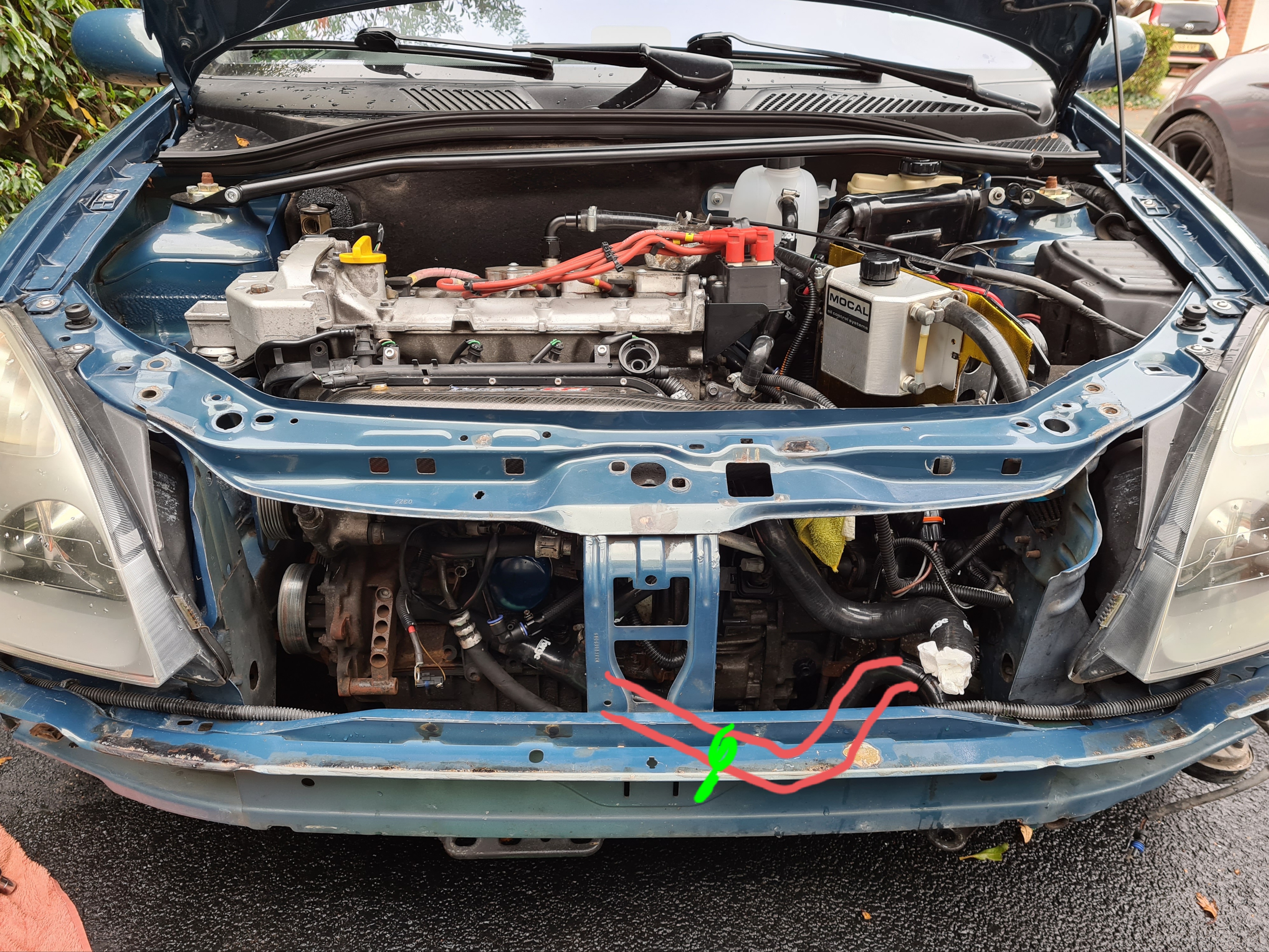

Did you secure your silicone hoses under the battery tray/ onto the bottom of the subframe?
Hmm I don't know really, just left everything in place and only taken the radiator out.
Not sure where under the battery tray you mean and I've been going through pics I've taken and haven't got any good pics of the hoses.
The bottom hose is attached with a clip on the subframe here though (the green doodly thing).
Anything specific you need to know? I can always have a look for you.

Yeah the little green one you've highlighted is the subframe one. There's another that clips under the battery tray, i made a little p-clip style bracket for mine but no idea if its needed! Stops it from hitting against the side of the battery tray and potentially rubbing i guess.
MLB
I'll have a look next time, all hoses looked in pretty good condition with no rubbing in the front, but I have to admit I haven't looked so far down, which hose specifically does that battery tray one clip on to?

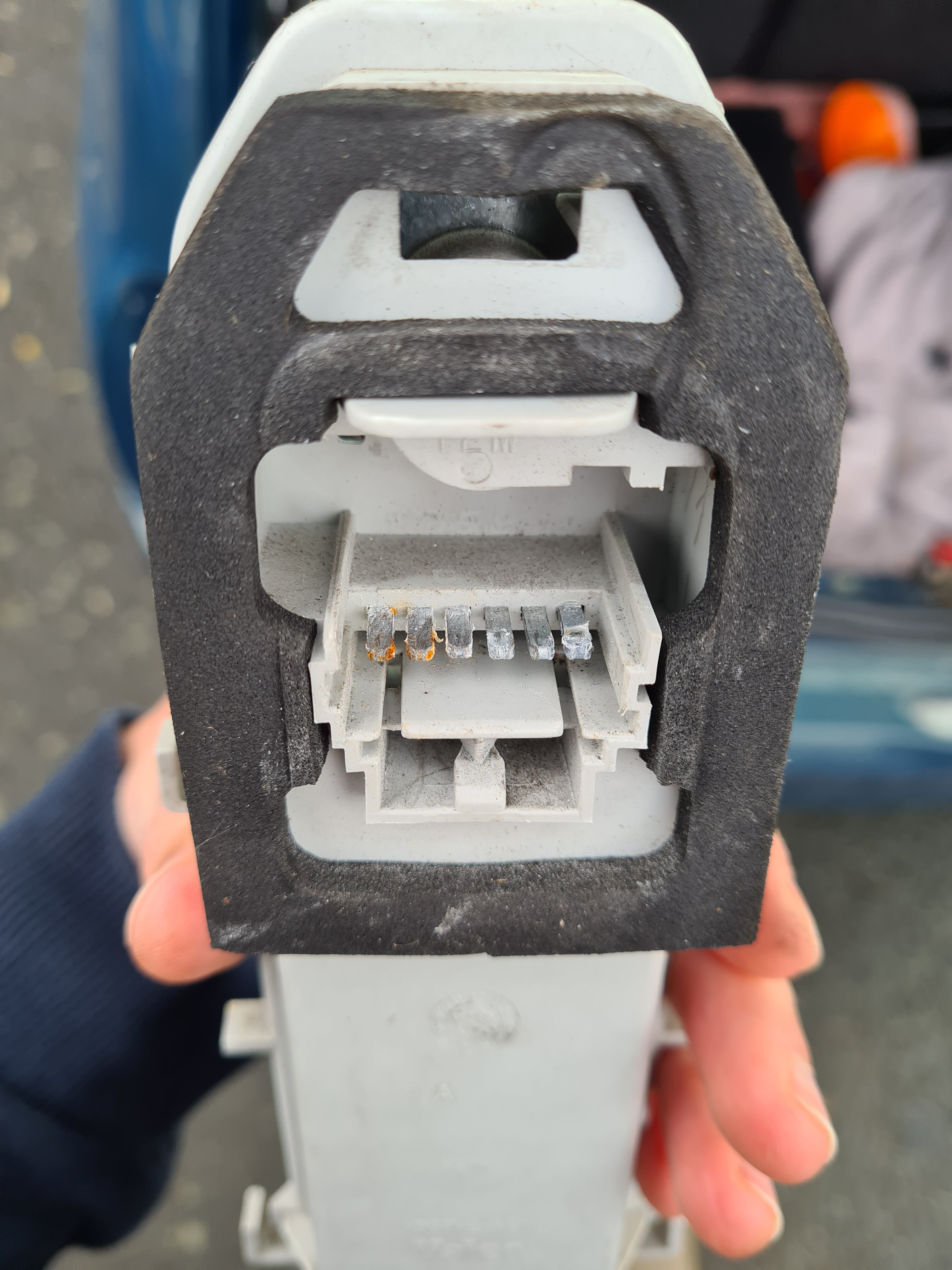

Another small job done today, noticed the fog light was flickering every now and then while braking and the cruise control sometimes would disconnect when indicating left.
Took the left rear cluster out and found the expected corrosion. All cleaned and working fine again!

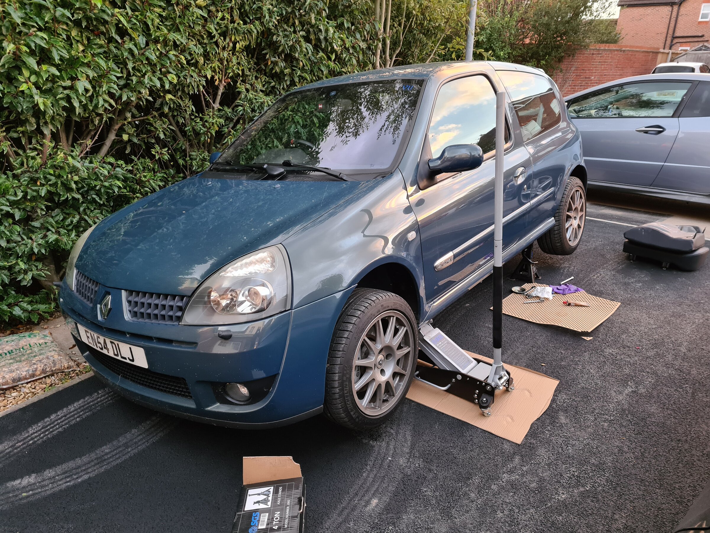

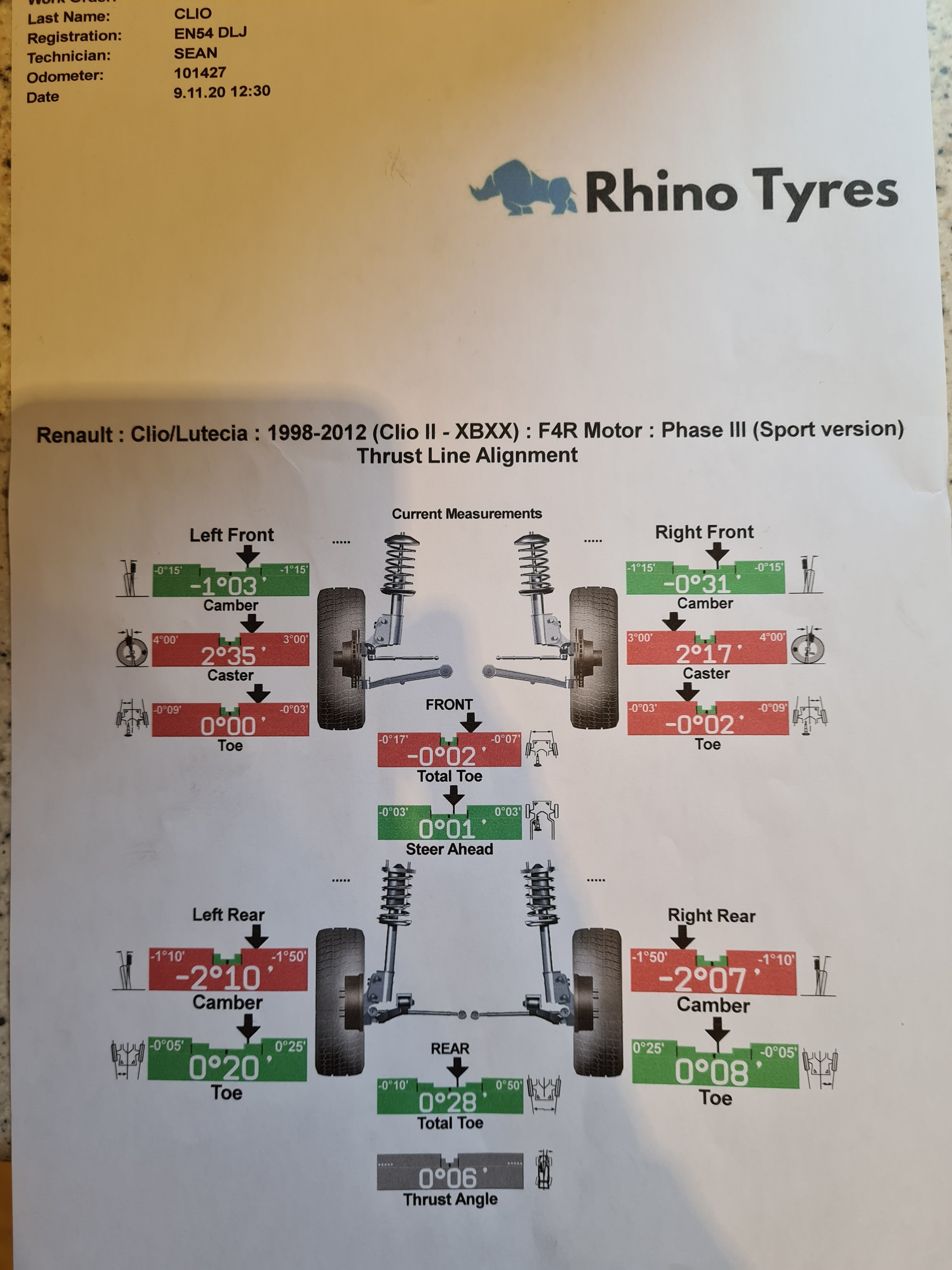

Also been for an alignment, just to get it checked really.
Time to get some coilovers and camber bolts this winter if funds allow.
Been reading a bit about how to set it up, but can't really work out what's a good starting point. 2 degrees camber and about 3 caster on the front with about 7' of toe on each side?
What's people's thoughts on rear camber shims?
The one that goes to the expansion tank.

I'm having this light flickering problem too, is this just the rear light assembly? In mine the light itself doesn't flicker just the indicator on the dash.
Re: setup - as much front caster as you can get, usually done with top mounts, this gives you more dynamic camber as the car turns. Static camber I'm at 2.5deg on the front and 5 minutes per side toe out to get to 10 min total. This is for track so probably too aggressive for road. Likewise 2deg of negative on the rear is probably too high. I'm as square as possible on the rear.
Will be the same pins on the rear light clusters as above.

As Hollidog says.
Max the caster and I'd say about 2 degrees of camber will be enough for a starting point.
Do you have slotted holes on the dampers?

@Hollidog, yes sorry, that wasn't clear, my actual fog light didn't flicker either, just the indicator on the dash!
I will still use the car on the road so may start with the 2 degrees camber with max caster that @Kev@KAM also suggested.
Rear camber isn't adjustable, probably a bit higher than the (standard?) 1.5 as I've put PMS hub spacers in there, so could try to get that back to 1.5 with shims.
@Kev@KAM I'm not sure if the holes are slotted, but I don't think so, just standard cup shocks with grams springs. I'd be looking at getting the BC racing DS coilovers that you suggested with their topmounts. I don't think those are slotted are they, so just use Eibach camber bolts?

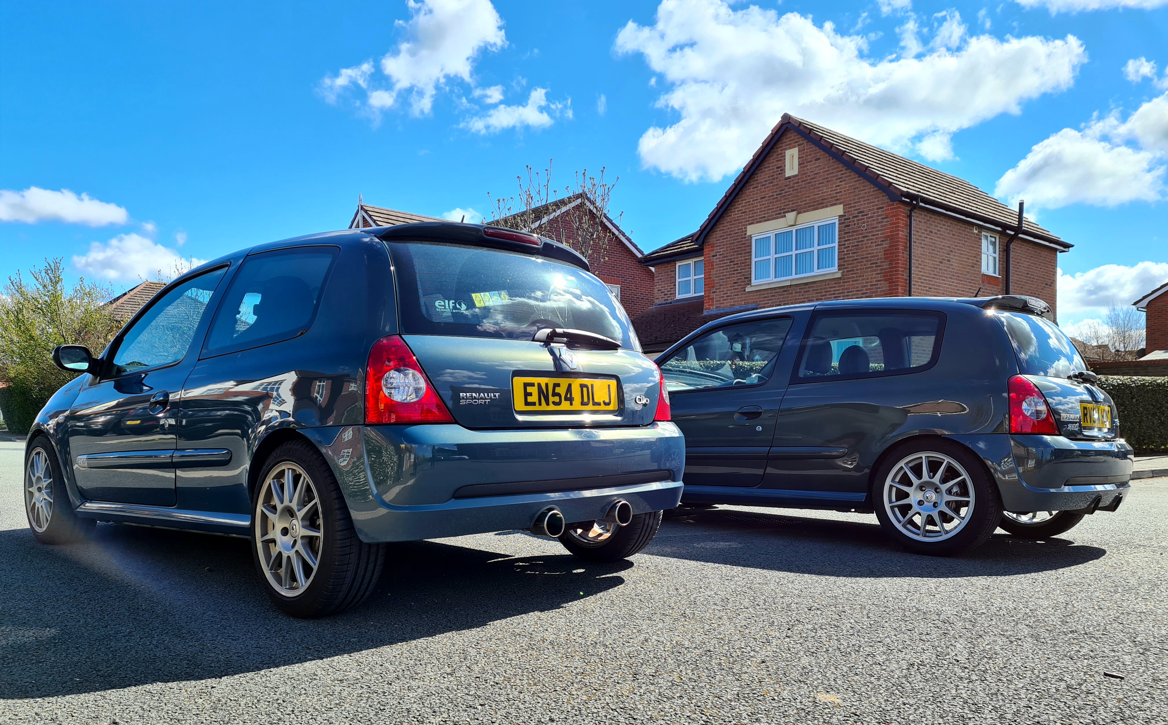

Today was a good day!
Firstly the Arctic Blue flew through it's MOT with no advisories, great start.
Then, after six months of part hunting, bolt measuring and swearing when everything had to come off for the second, third or fourth time it was time to get the airconditioning system of the Petrol Blue vacuum tested and regassed.
Held vacuum and then took 710 grams of gas, exactly as per manual, spot on!
Fingers crossed it won't develop any faults and will keep me cool and dry for a while.
They don't look too bad together on the drive, I will miss the Arctic once it's gone!

My car also has the foglight light on the dash flickr occasionally under breaking, so glad I clicked on your thread now.

Thank you! Yes it is very satisfying when jobs go well and it works again afterwards! Difficult to tell the difference at the moment with the cold weather but it should at least keep the car condensation free over winter as well.
It's a common issue, the corrosion in the rear lights, so definitely worth checking every now and then, luckily isn't a difficult job!

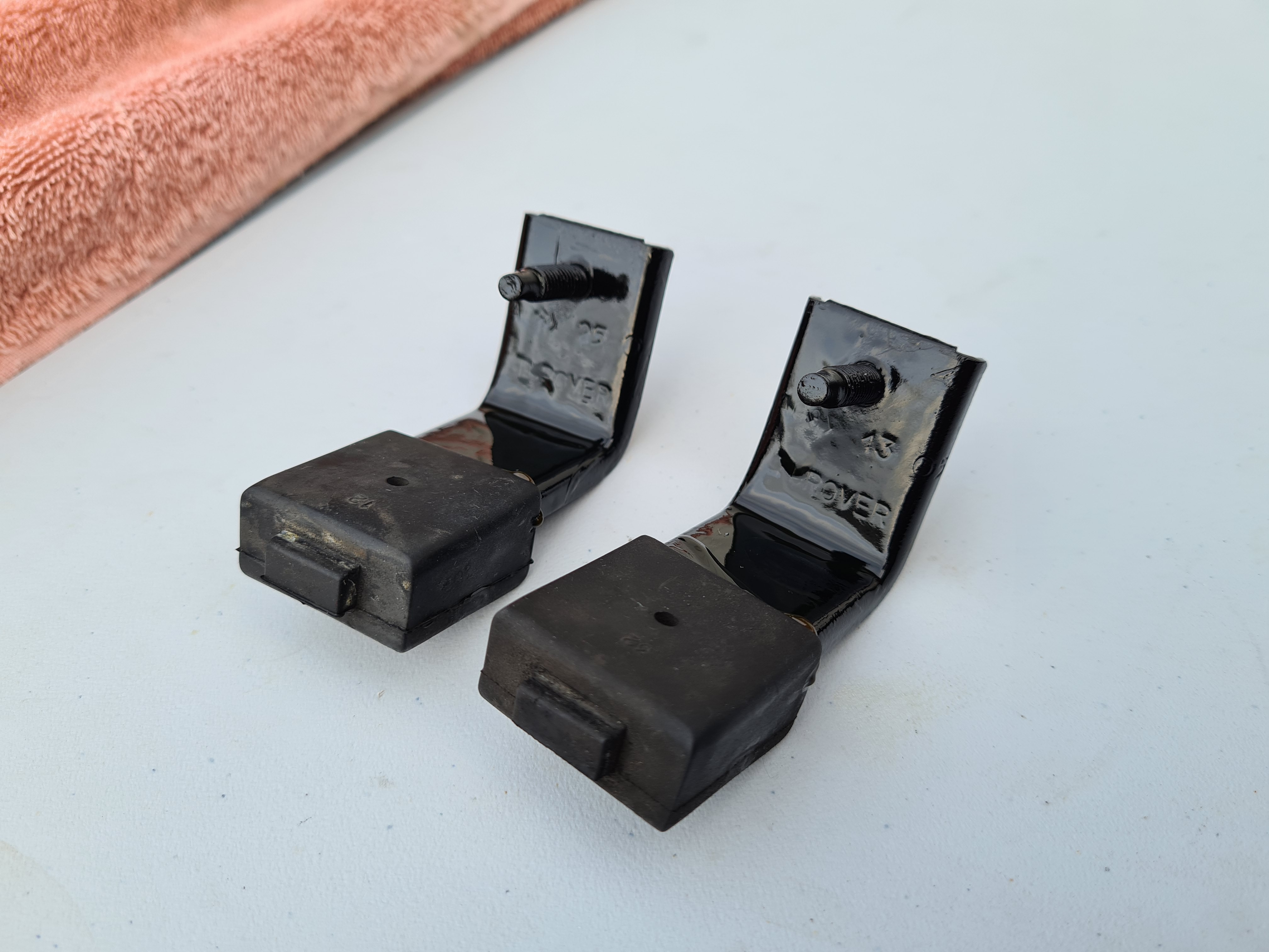

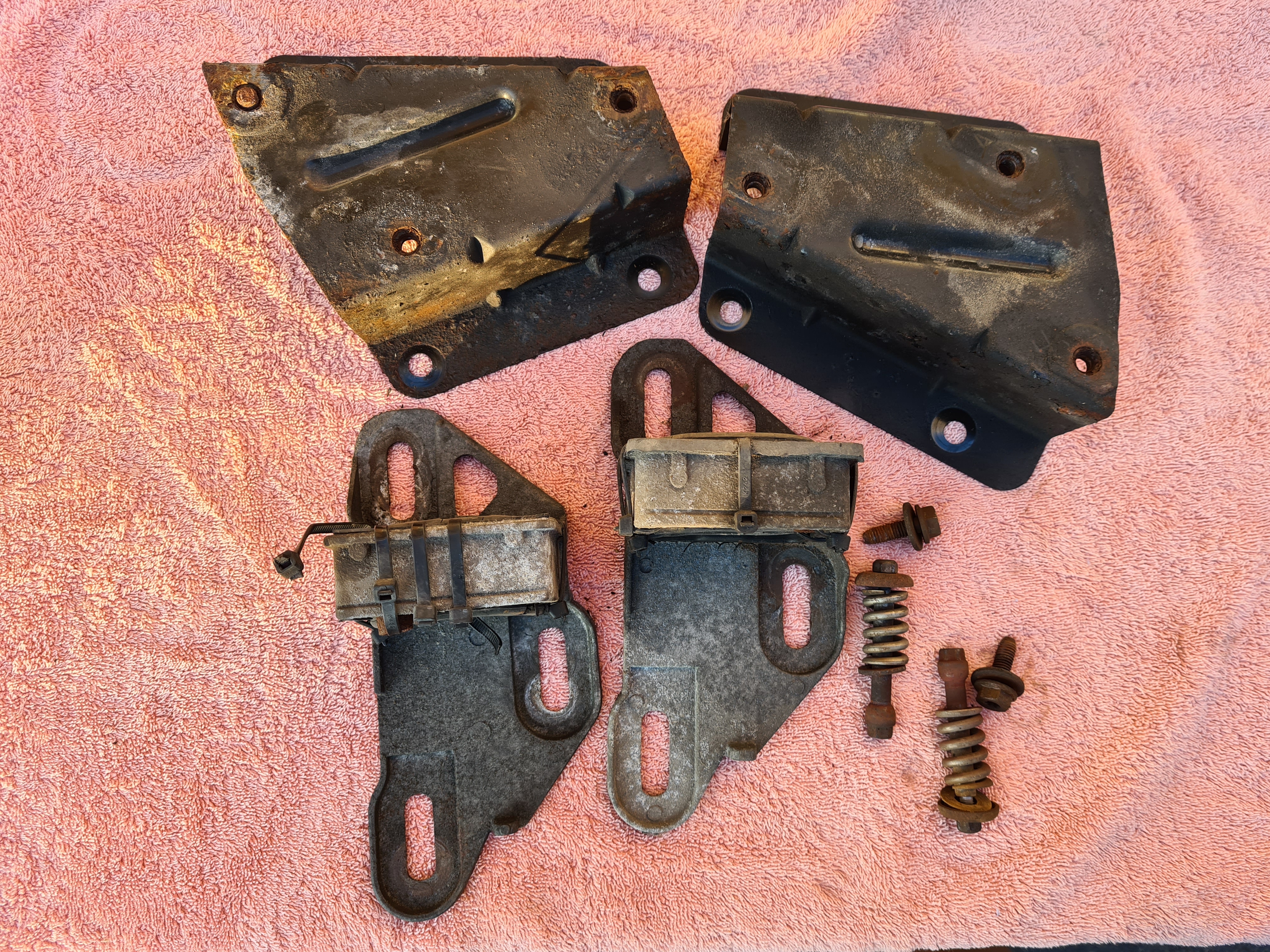

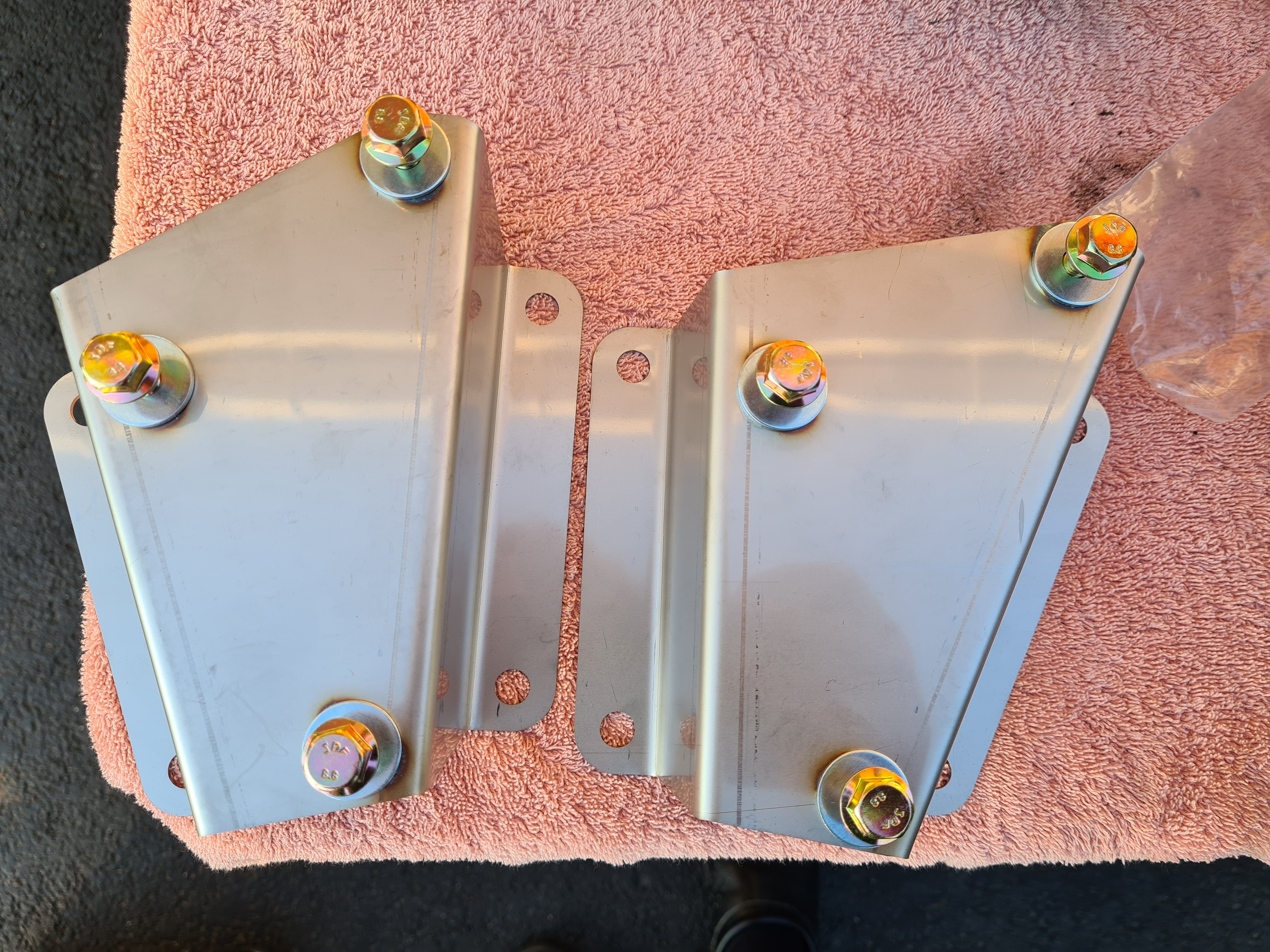

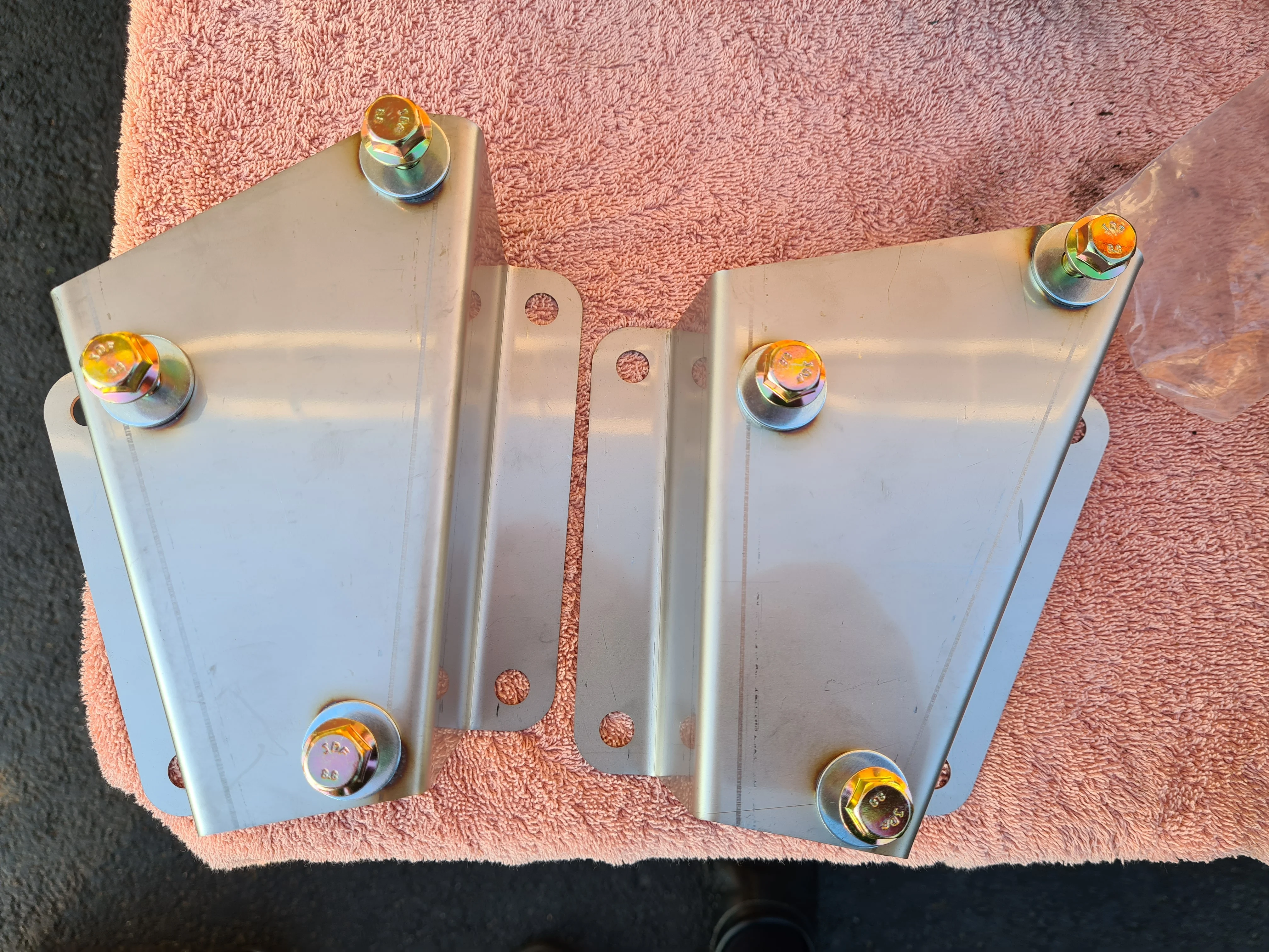

Bought some radiator brackets a couple of weeks ago, they looked good enough to go on but after a chat with @RustyMojo and seeing how well he'd done on his I decided to restore them anyway.
Found some rust underneath the rubber so wire brush, deox c bath, two coats of electrox, two coats of satin black and then coated in XCP before they were ready to go on again, should be good for another decade:

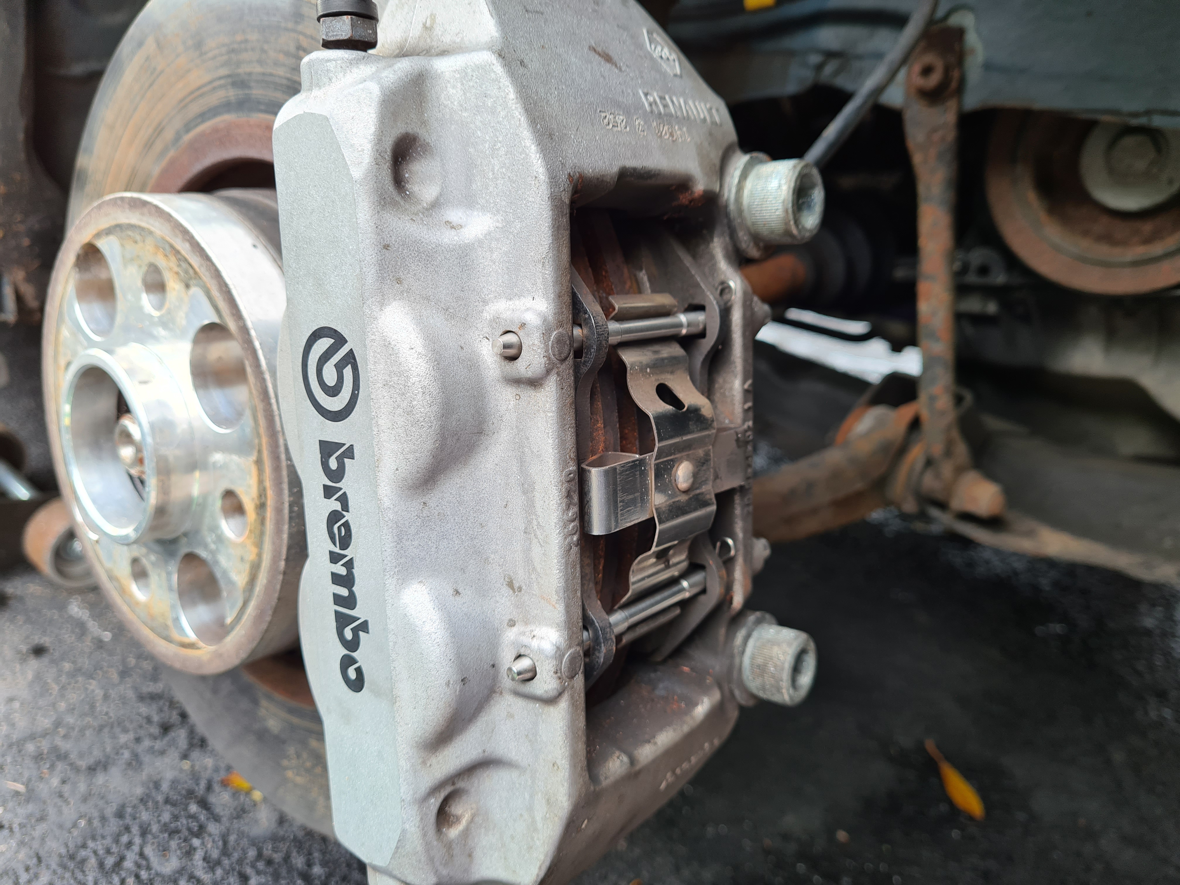

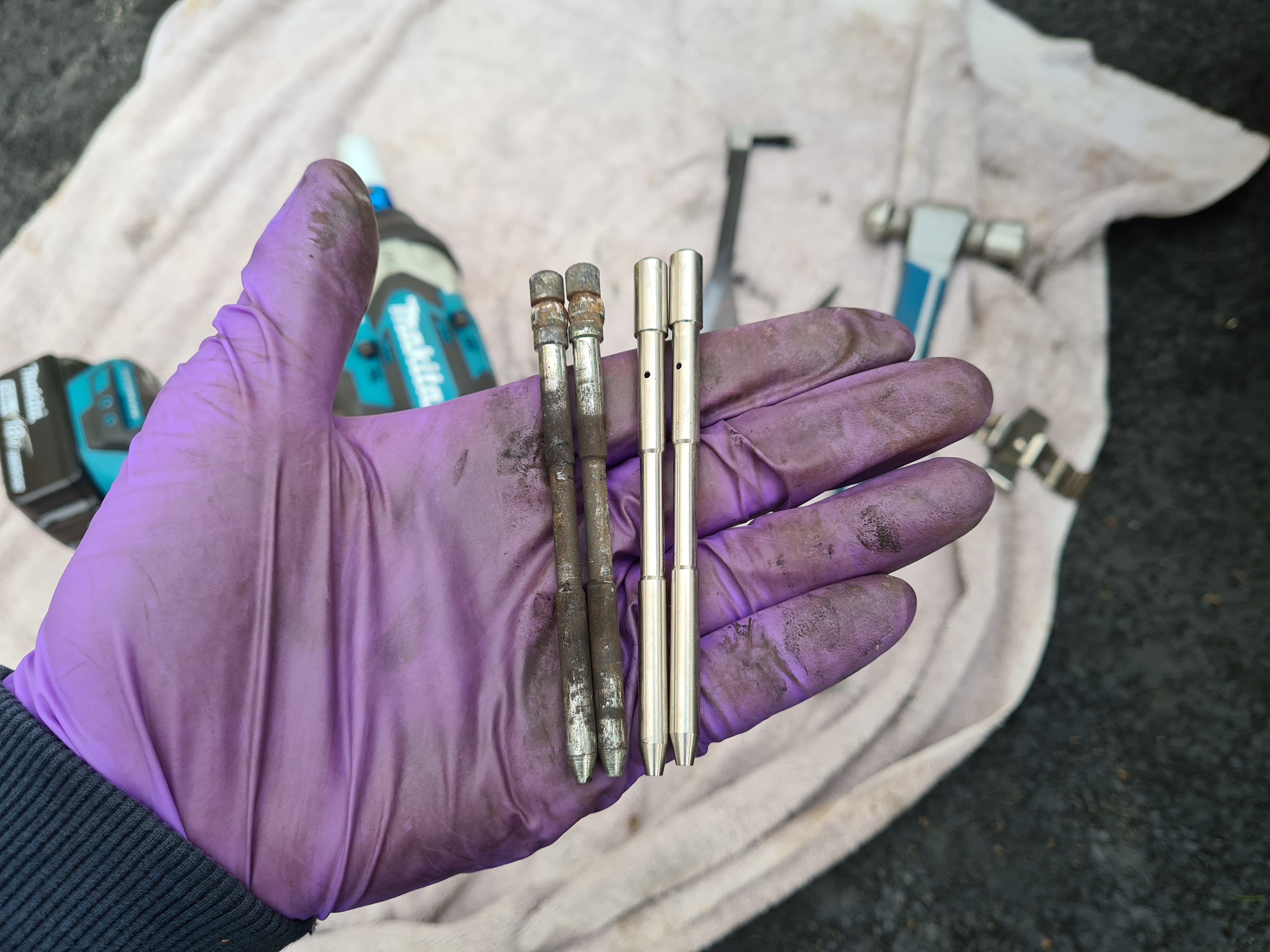

Then cleaned the brakes and even though the pins had been out less than 300 miles ago they were sticking already. Time to replace them with Mr Pink items, looks a lot better!
Weather looking to be wet with 23 knots of wind so kept the PS3s on.

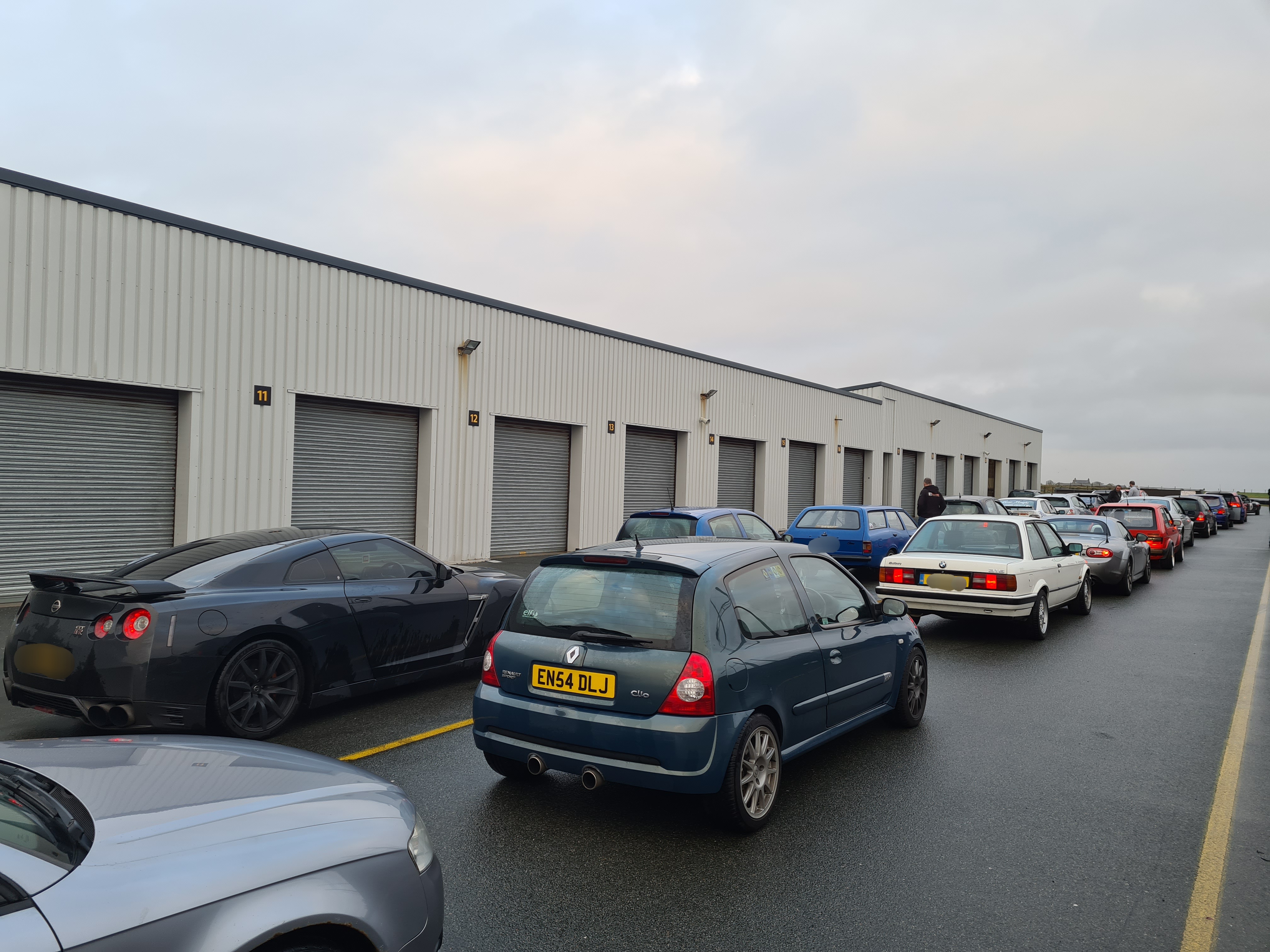

Had a great day out at Anglesey today! Everything got soaking wet and it was windy as hell but loved the track and managed to get 102 miles on the clock!
Takeaways from today:
-PS3 tyres cope amazingly well with wet track work.
-LSD is insanely effective.
The day was well organised under the current Covid restrictions and there were three different groups but still managed to speak to a couple of Clio owners and look at some proper machinery. Actually quite cool to see people using their £100k+ cars to do what they're made for on such a wet day.

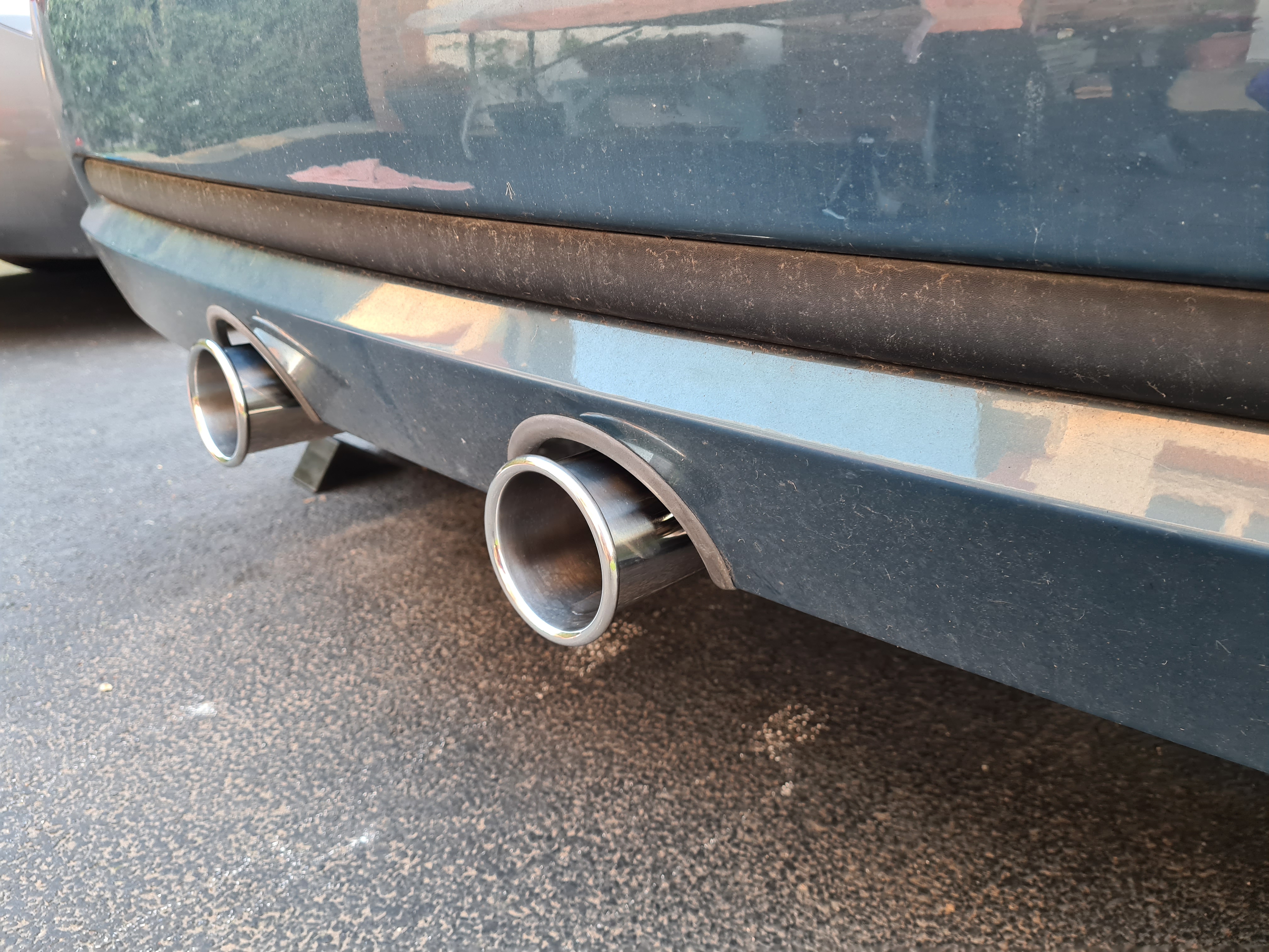

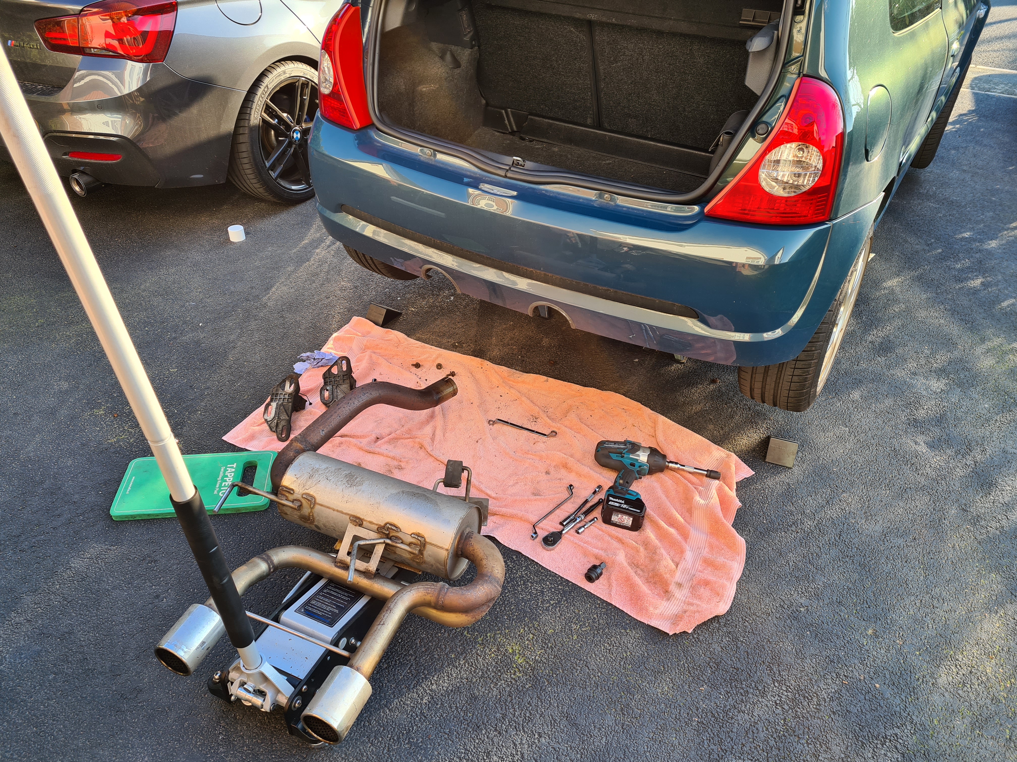

Finally got the PMS exhaust fitted today.

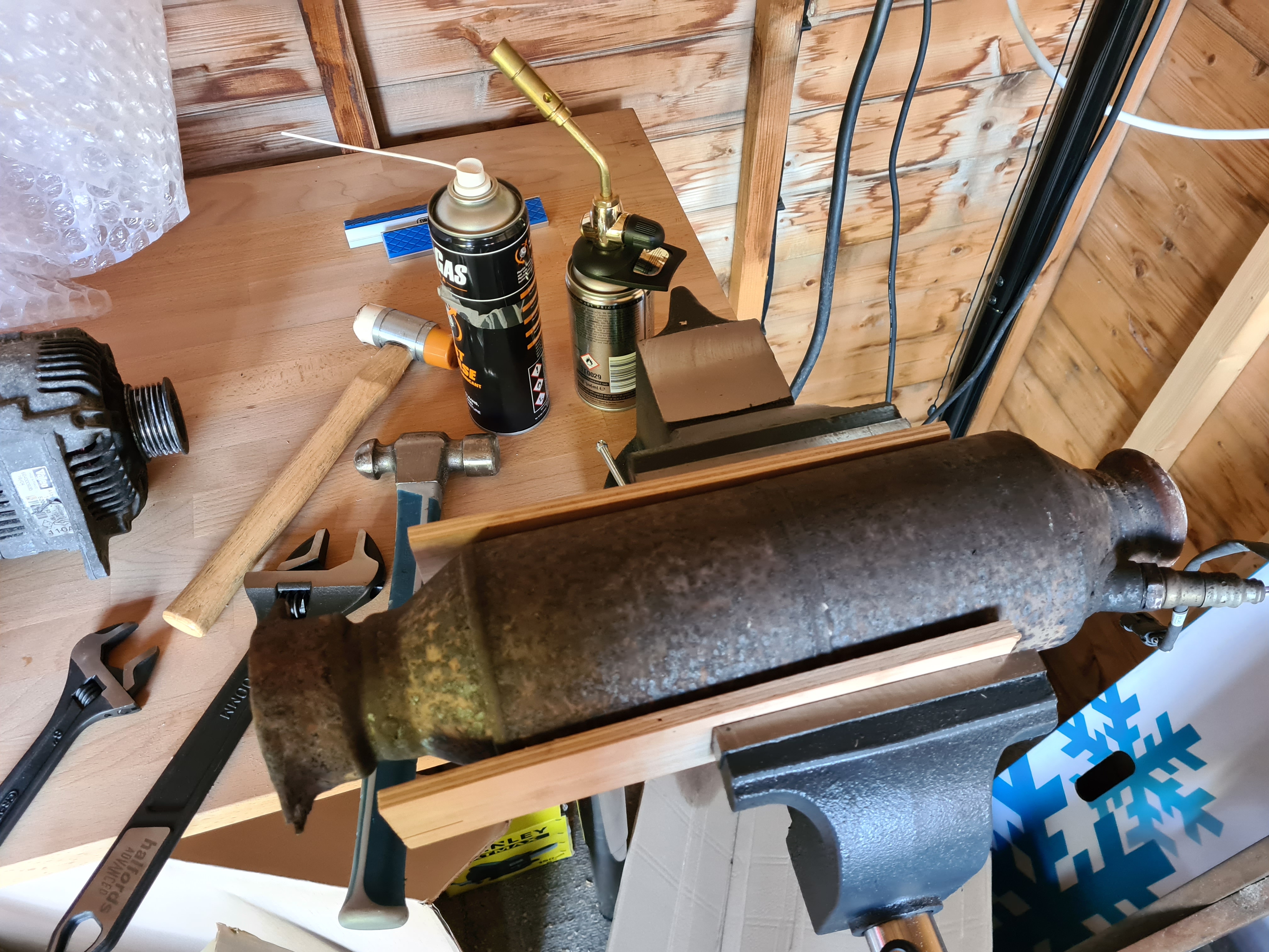

I prepared for the worst, knowing how rusty and stubborn Renault bolts and lambda sensors can get but I had a pleasant surprise when the lambda sensor just unscrewed without effort!
My wife read an article last week about the increase of catalytic converter thefts with a video of someone's cat being stolen in broad daylight. She asked me if you would notice.. So I this was the perfect time to let her hear the Clio without exhaust.
I think she jumped about a meter up in the air and a couple of worried looking neighbours came asking later if that was the new exhaust system I was installing ..
For the rest, the only thing that needed a bit of persuasion of the impact wrench and hammer were the old exhaust clamps and the cups in the exhaust manifold before the cat.
Only realised when I took the hanger mounts off that I already had the shorter ones but decided to get the Pro-Am ones installed anyway.
Out with the old crusty stuff and in with the new shiny stuff!
Ktec off
And finally the PMS system on!
Please don't comment on how dirty the car is, I know and I am ashamed..

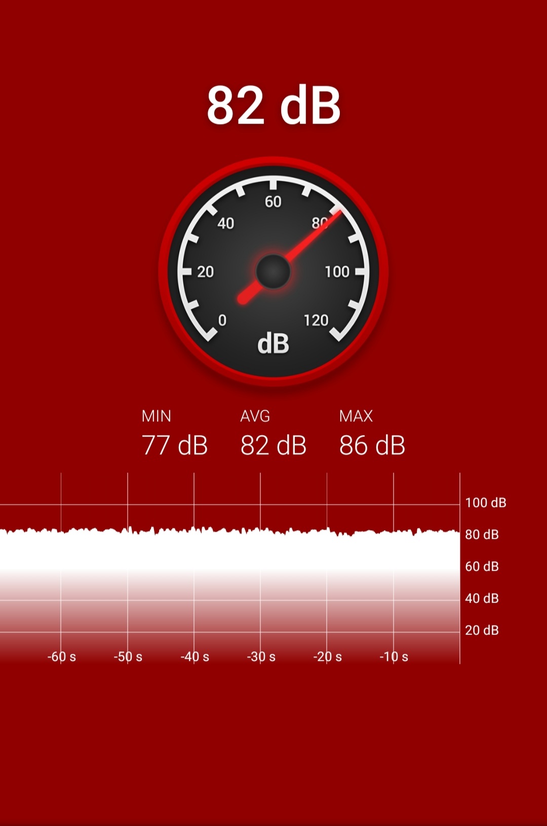

As for the tips, I have been driving my wife and some people on the forum here crazy trying to figure out which exhaust tips to go for, but I am well happy with the look of the outward rolled 3" pipes!
The system will need a bit of readjusting but will give it a couple of weeks to settle and then fine tune.

I will see if I can take some video footage. Be interesting to hear if the sound is a lot different from yours as I've got the PMS sports cat installed.
Also planning on doing a side by side comparison with ktec exhaust as I know where that is going in two weeks!

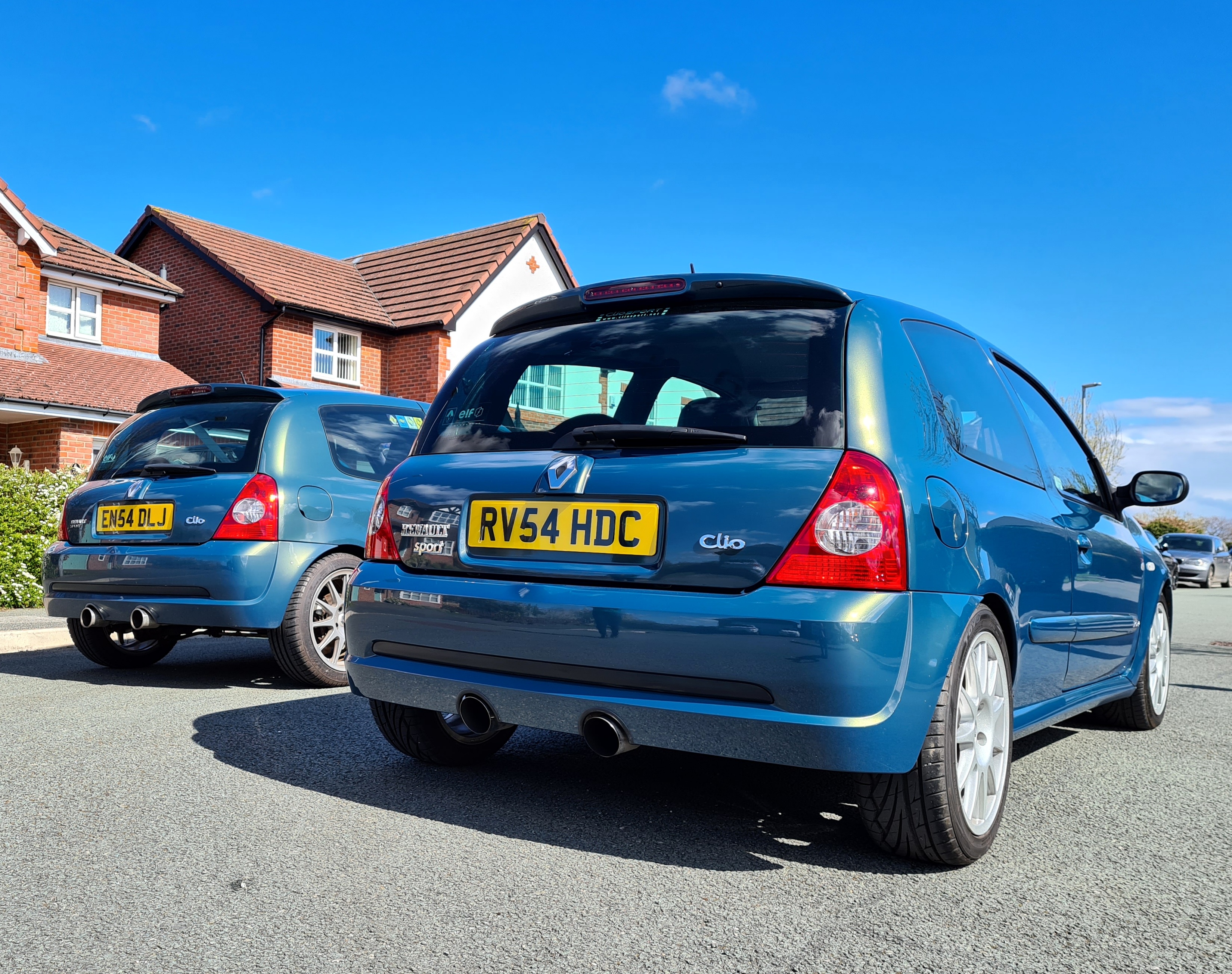

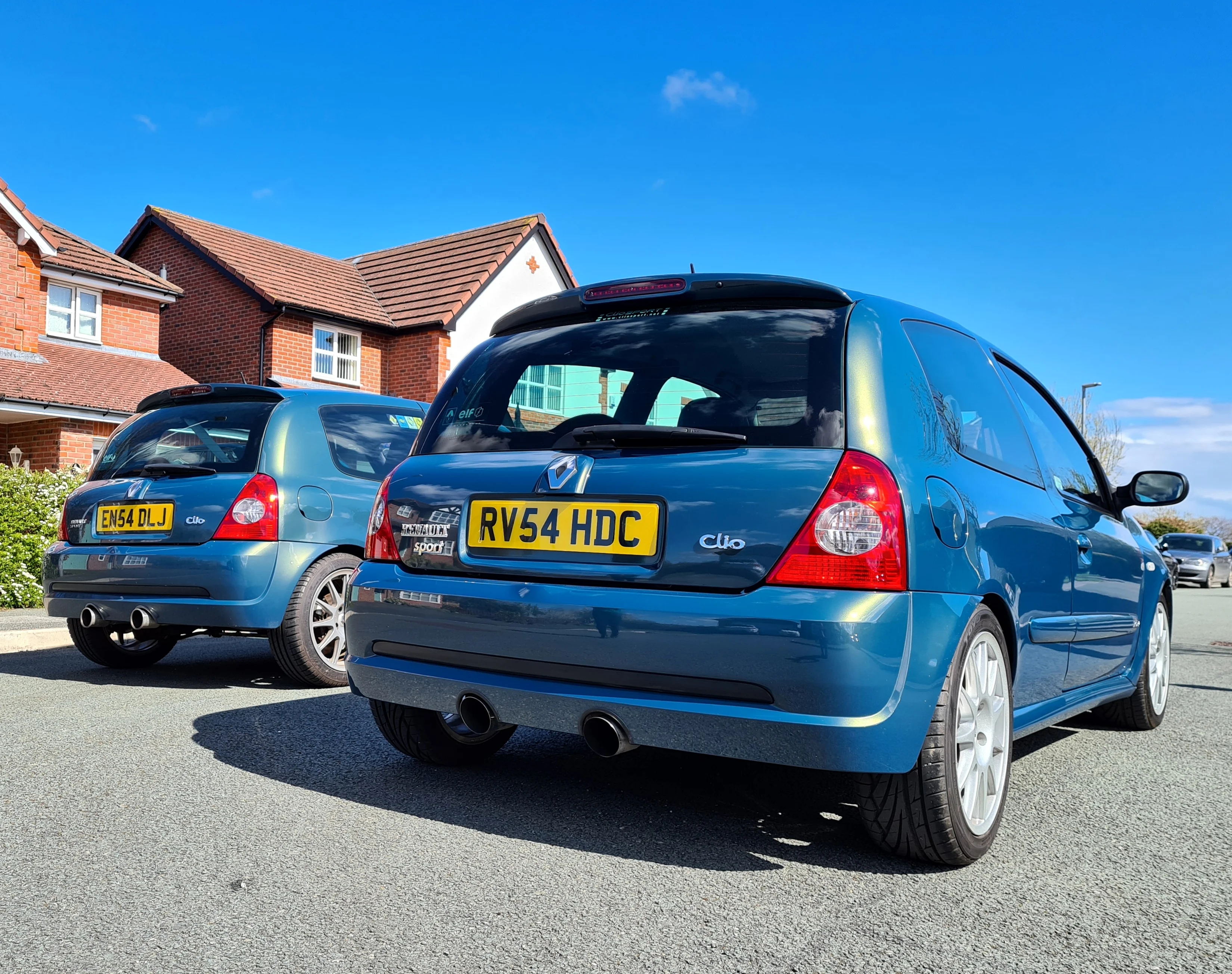

Sold the Ktec exhaust to @HAP yesterday, was great to meet up and see his car. Was super clean and looked stunning in the sun!
Mine was dirty and we couldn't go anywhere for decent pics but would've been rude not to take a couple of pics..

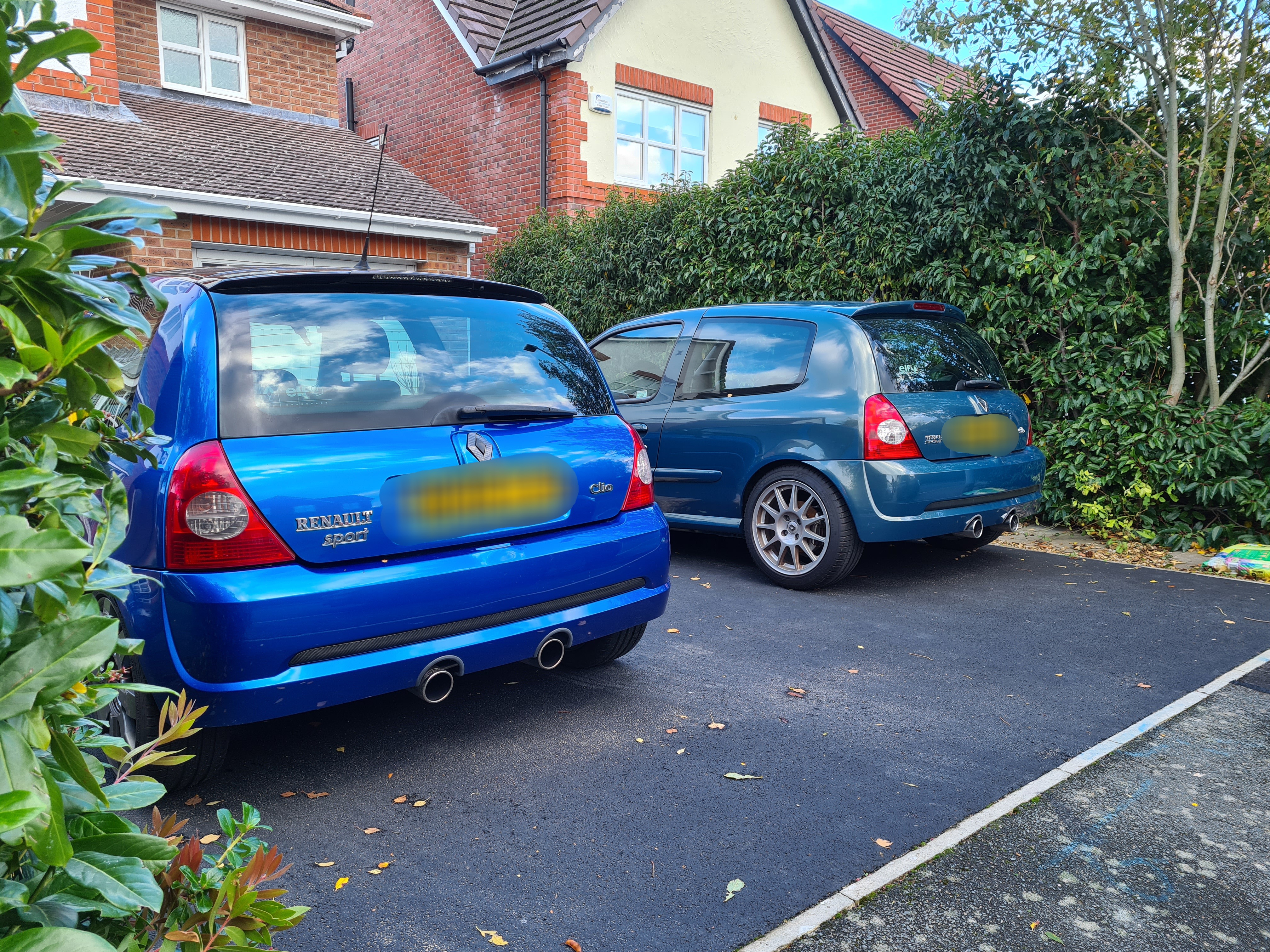

MLB
Thanks guys, and a third Petrol Blue lurking around North Wales now as well!

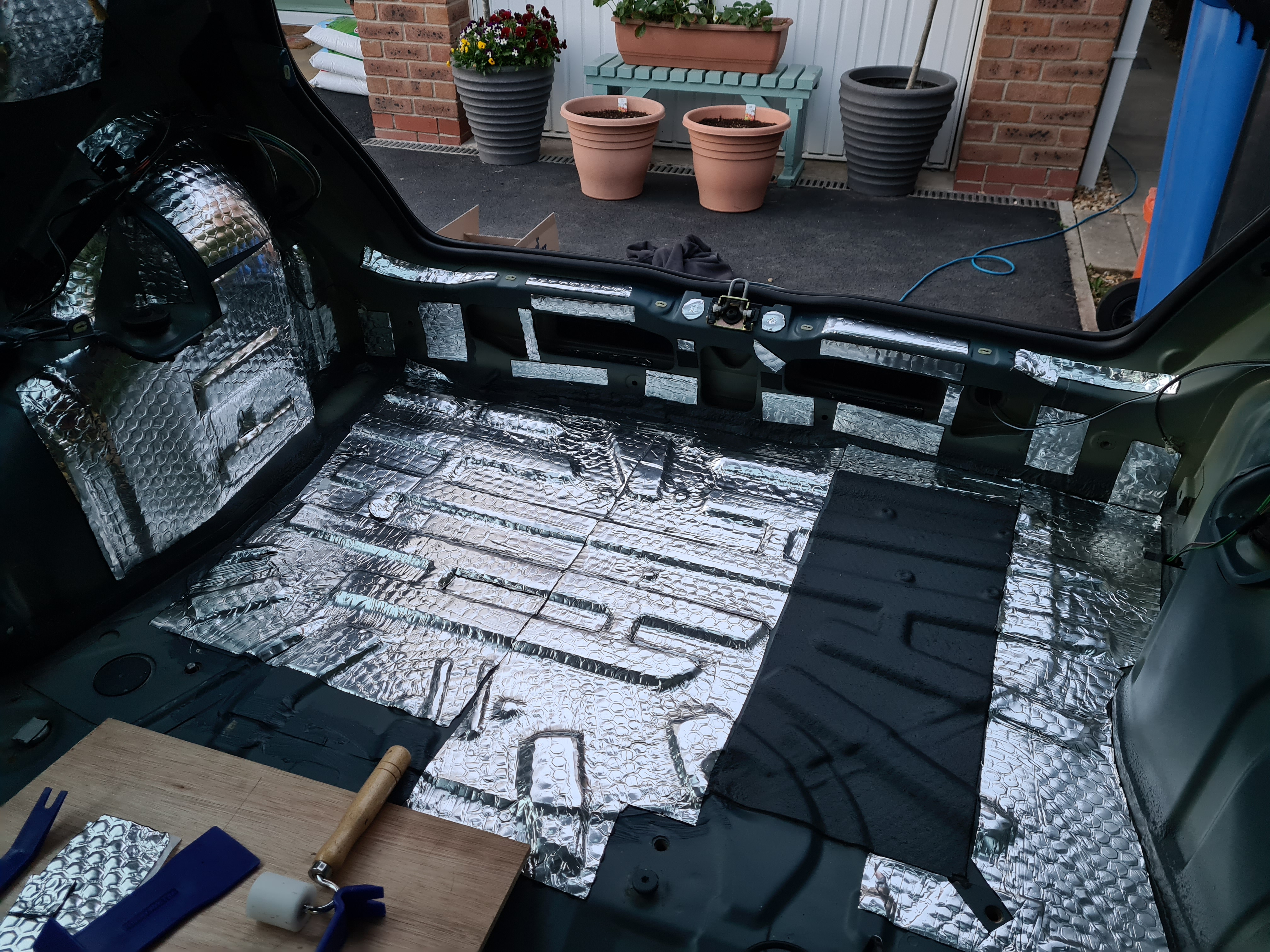

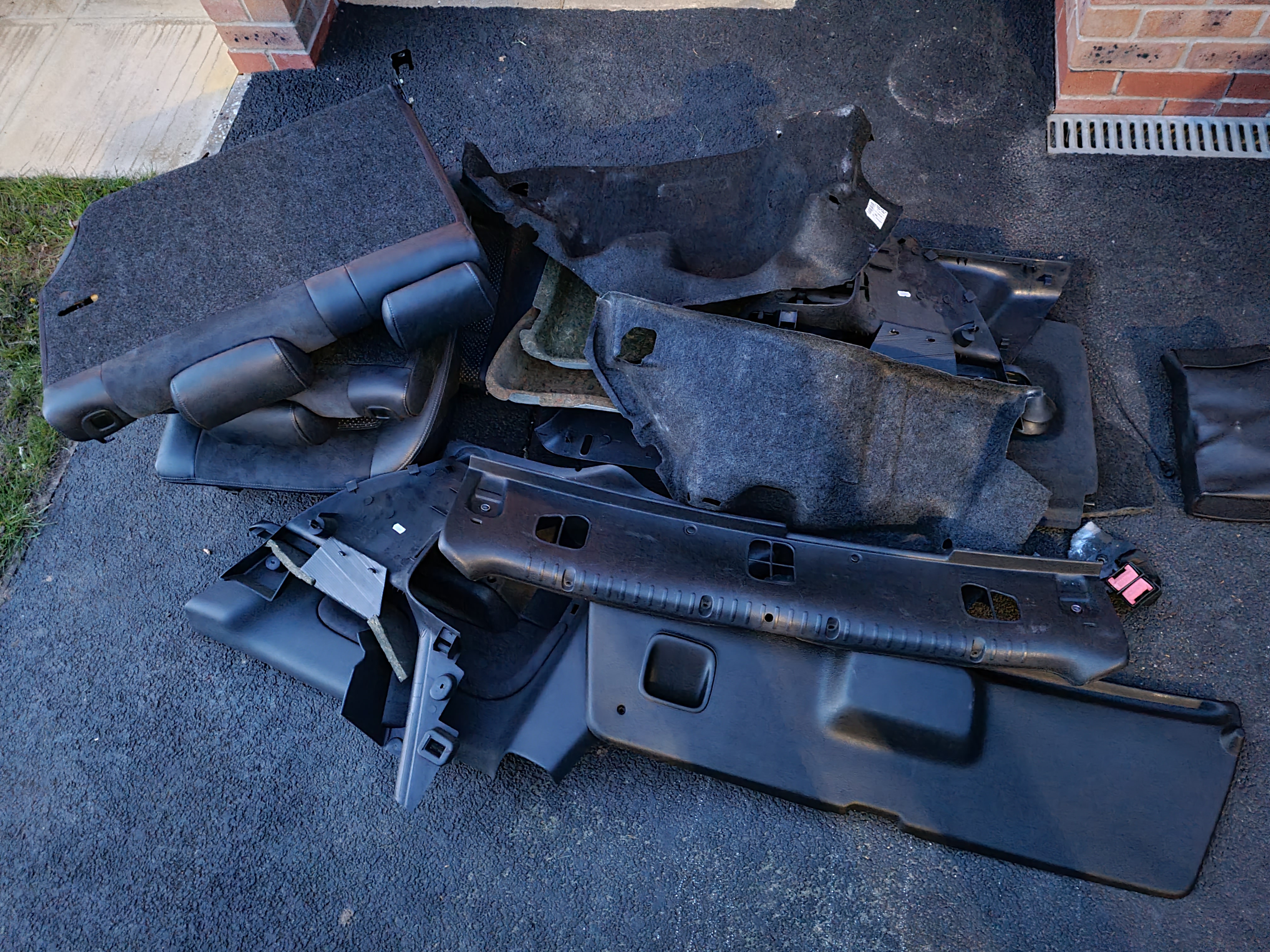

Inspired by @frayz I've ordered some extra weight for the car..

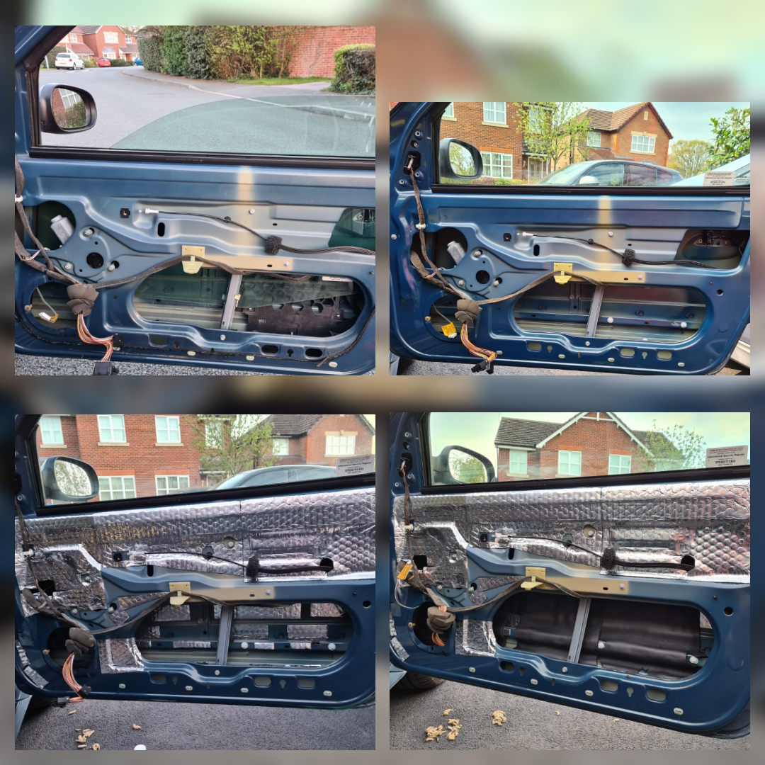

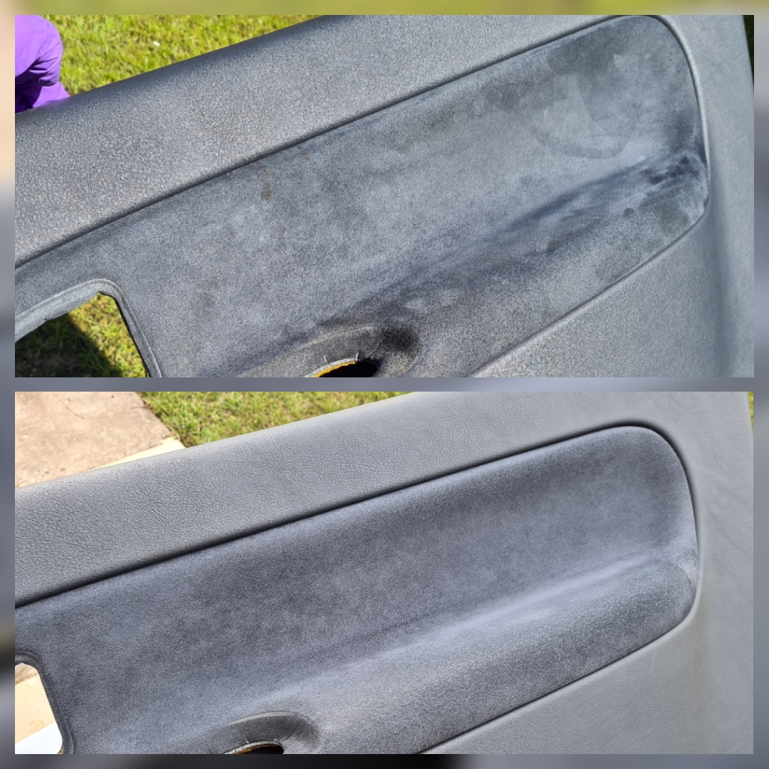

Plan is to take apart the interior in stages, fit the sound deadening and do a deep clean/interior detail as I've not had time to do that properly since buying the car.

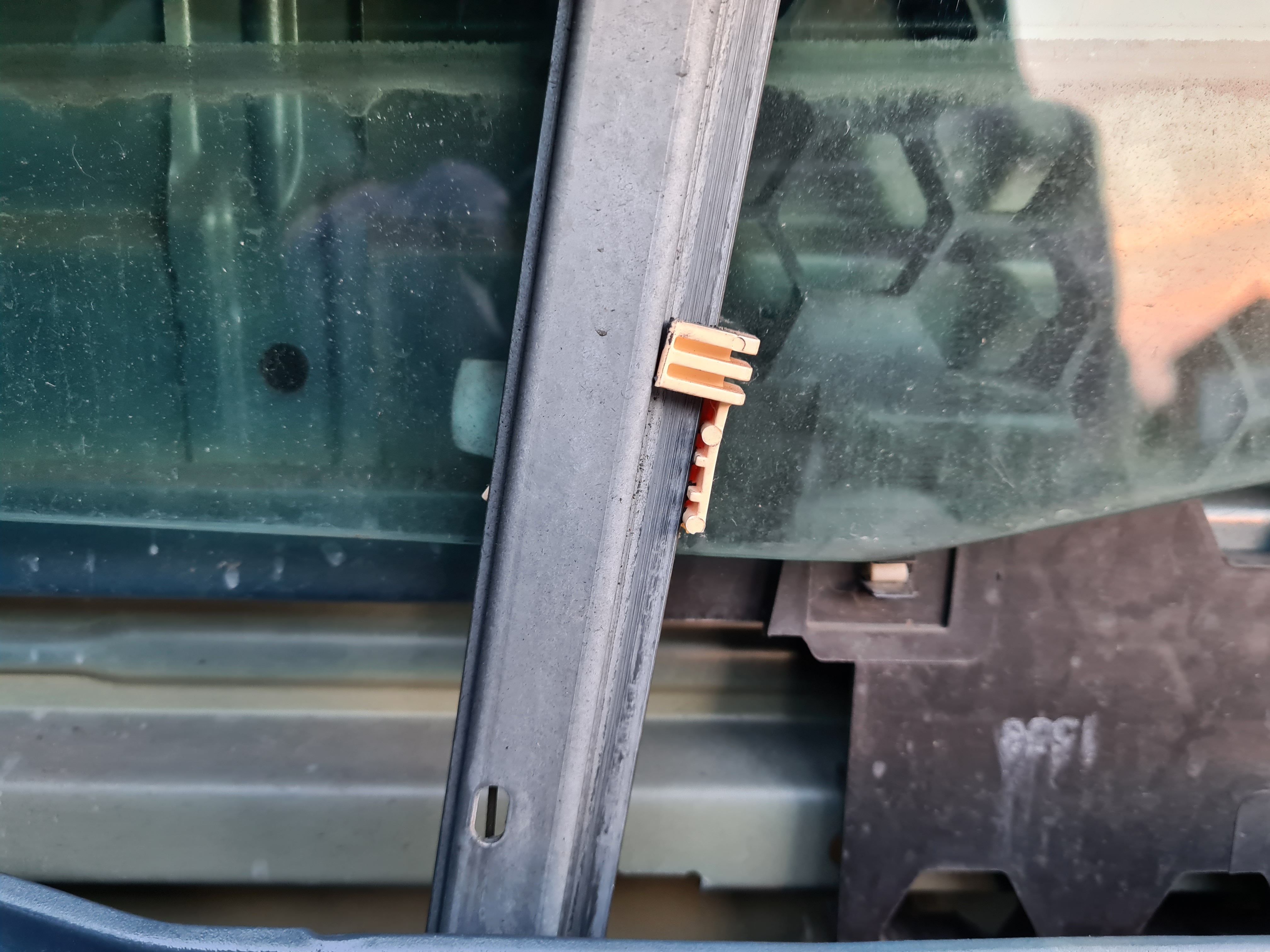

Started with the drivers doorcard to see what was causing the window to get stuck in the down position.
Culprit wasn't hard to find, replaced, cleaned and now all working smoothly again.

Then I realised I hadn't saved the full interior sound measurements so went out with the rear stripped and got 82 dB average on the motorway at 70 mph.
Started with sound deadening the driver side door and cleaning the door card.
All fairly straight forward except the Dodomat super liner, that stuff is sticky!
Alcantara came up well.

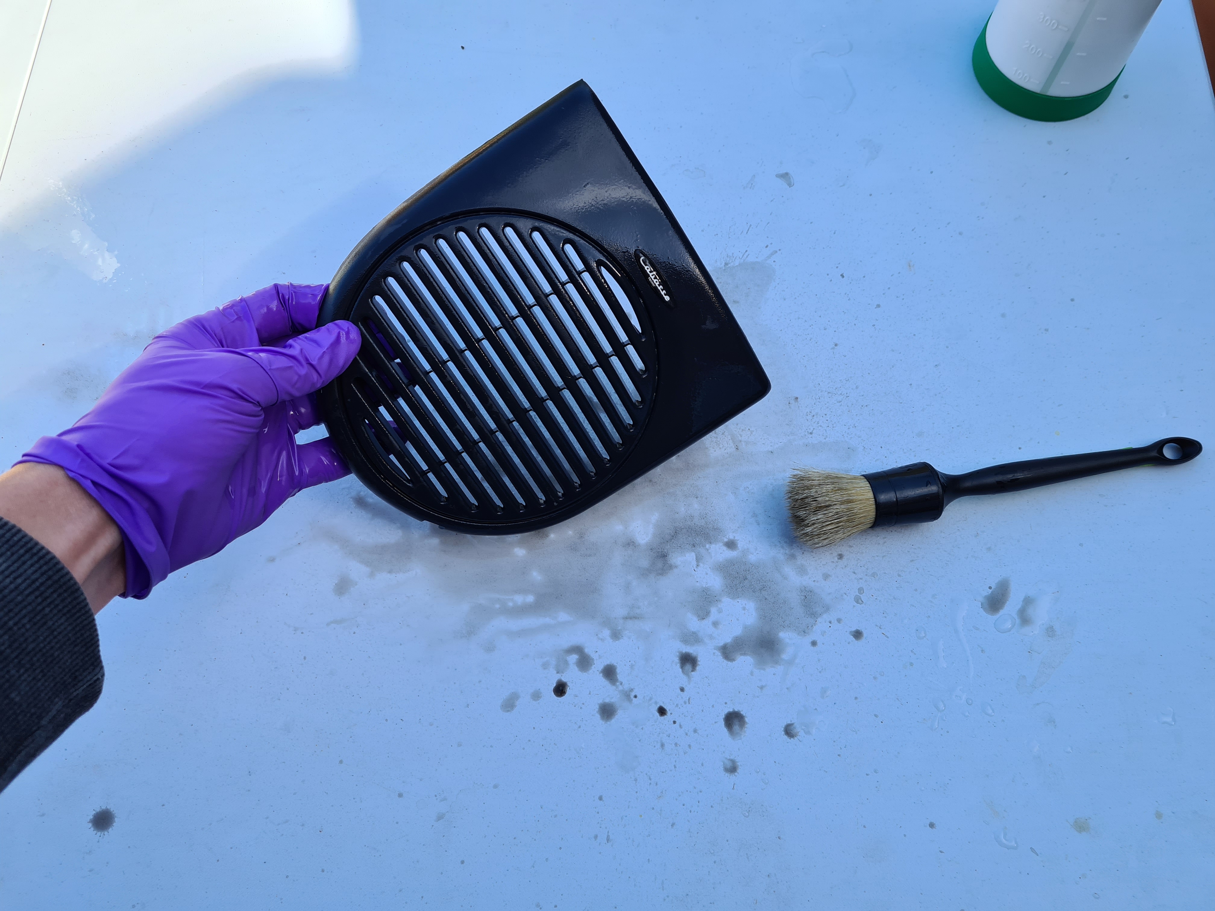

Speaker grills are always a nice dirt trap.
Still waiting for some audio components so started with the first layer of sound deadening in the rear today.
So far I'm liking this job, it's very therapeutic and I've been wanting to do an interior deep clean for almost a year and a half now.
Downside of cleaning, sound deadening and doing audio at the same time that it's going to be a long project.
Thanks for reading!

I don't know how, but I totally forgot to take pictures from the boot lid but finished it today, outer skin and inner skin with dodomat hex and plastic cover with dodomat super liner.
Not sure if it's noticeable in the video audio but the difference is incredible.
