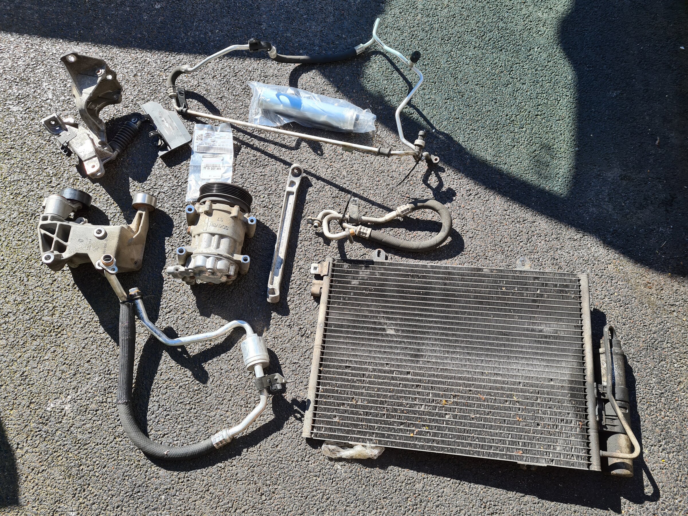

Started to collect parts to reinstall the airconditioning, I see how weight saving and performance are nice but I think I'm still very much the limiting factor in the cars performance and I just like cool air in summer and clear windows in winter.
Not sure if this will be a full DIY project but got this far thanks to @Brigsy and @RSPez, thanks guys!
I've started a seperate thread https://cliosport.net/threads/ac-reinstall-parts-needed.833510/ but without much succes.
Except the aircon alternator and aux belt, will I need anything else? Is it as easy as install, regass and go?

Good to hear the seals arrived ok (y)
Working ac is totally the way forward, id rather go on a diet myself than pull it out of a road car.
Id be temped to change the condensor for a new one as it looks a little bit oily as they are quite cheap to buy. Ive found a source for the wide seals that go into the condensor if you want new ones. Lube up your seals with PAG oil before fitting, get an aircon specialist to fill it and add a leak dye.

Thanks @Brigsy ,yes I was planning on changing it, already got the dryer but missed out on the cheap deal for a new condenser, I'm not in a hurry so just waiting for the cheap nissen items to come up again.
If you don't mind, I'd be interested in getting those wide seals! Good tip re the pag oil, I've not worked on ac yet so all new to me.

Those condensors have gone up considerably in price now, im sure @Old Tarby! had one for sale cheap if it didn't already go.
Do you need to swap out the o-rings when changing a condensor? I've got mine to do aswell! I've a spare dryer but seems you already have one.

Can get the pag oil cheap off ebay about a fiver for a small bottle. Sometimes you can get a bit out of the old pipework to wet the seal.
Regarding replacing the o-rings, i spoke to my local air con specialist and he said they rarely change the o rings unless damaged or the system has been in a million bits or incomplete for a long time.
I had to reuse the thick ones on the pipes that fit in the condensor as did not have any when fitting, my o rings looked ok and fitted quite tight in the condensor when lubed up, and passed the vac test before filling. Ive seen a bit of leak dye around the top pipe to condensor though, which seems to have stopped as i guess (hope) the seal has swollen. Time will tell if it holds the gas i guess.

I took a punt on these seals for the wide ones, supposed to be for a megane. No idea if correct size yet as not disturbing anything unless the gas leaks out.

Thanks for that Brigsy. Hope you dont have any problems with yours! What did you pay for the regas and dye out if interest?

I paid £60 for a regas with leak dye. I believe most places will add leak dye for free if you ask.
If you think you have a leak, any good specialist will be able to fill it up with nitrogen, leak dye and a small amount of refrigerant. I paid £25 for that, and they checked around the visible parts of the aircon system with a uv light for leaks.
Fingers crossed mine holds the gas. Its cost me 2 re gasses, leak test and new condensor/rad to get it somewhere near. Almost the purchase price of the car :LOL: on the plus side, it now works great and ice cold. The clio blower is a little bit wheezy, but does the job if you knock it up to number 3.

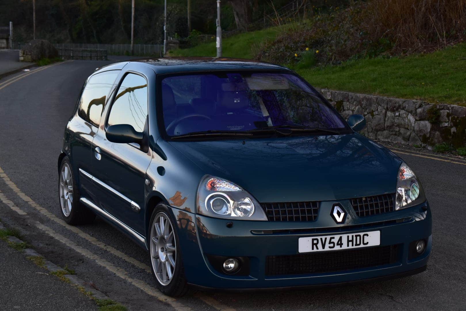

And it's back home again!
Quality service as always from @Birchdown, serviced and a couple of things looked at including the brakes. All cleaned and lubricated and it's like hitting a wall again when slamming on! Thanks guys!
Great 70 mile drive home even though I missed Llangollen and the Horseshoe Pass due to road closures and slow moving traffic.
Couple of pics along the route!

Birchdown
  172 cup / 172 Exclusive
Stunning car and fantastic colour, the one and only petrol blue we have seen in our 14 year Birchdown history. Colour looks better in the flesh I must say.

Ah cool, I didn't know that Andy, suppose not surprising with so few around! Don't think my local Renault dealer had seen one before either.
The colour just needs lots of sunshine, maybe I should move to Spain!
