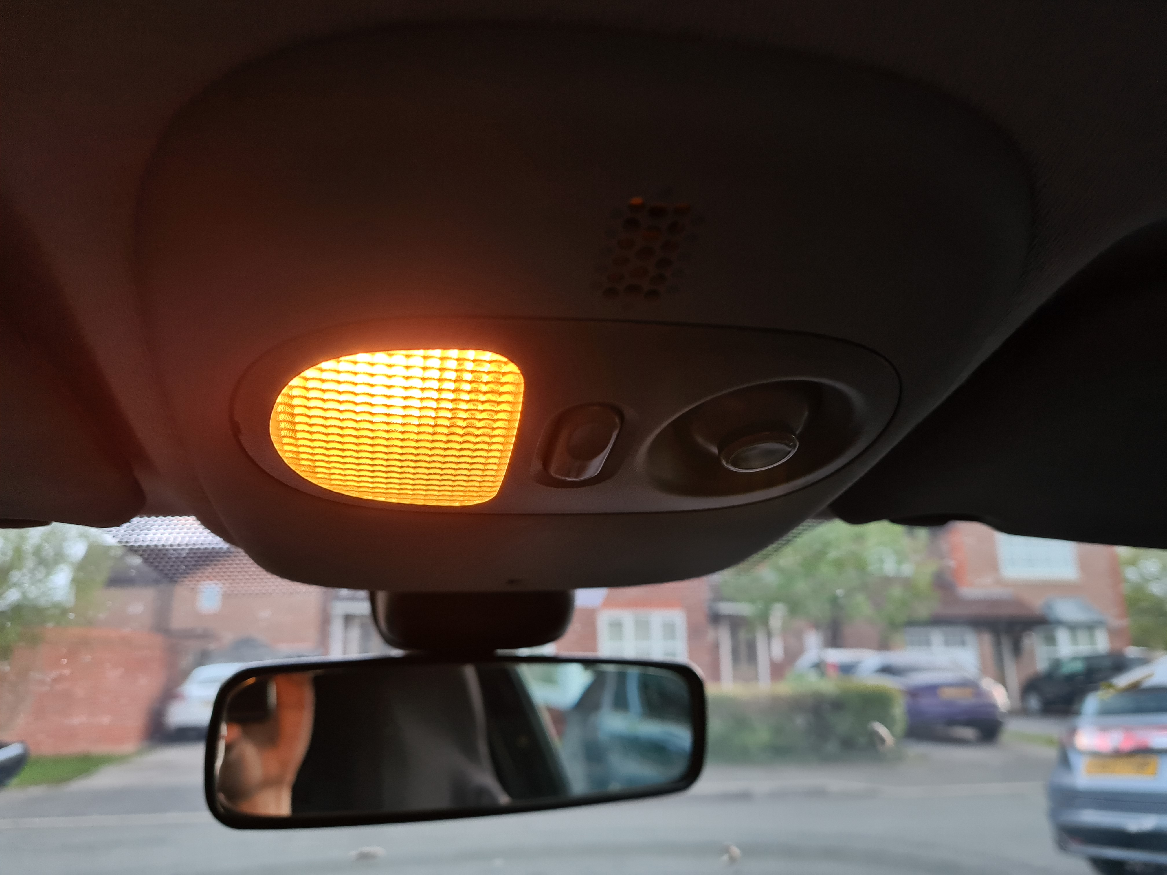

Slowly working my way though the interior and finally changed the broken led bulb in the cabin for a normal W5W one. So much more light and not the horrible faint blue glow.

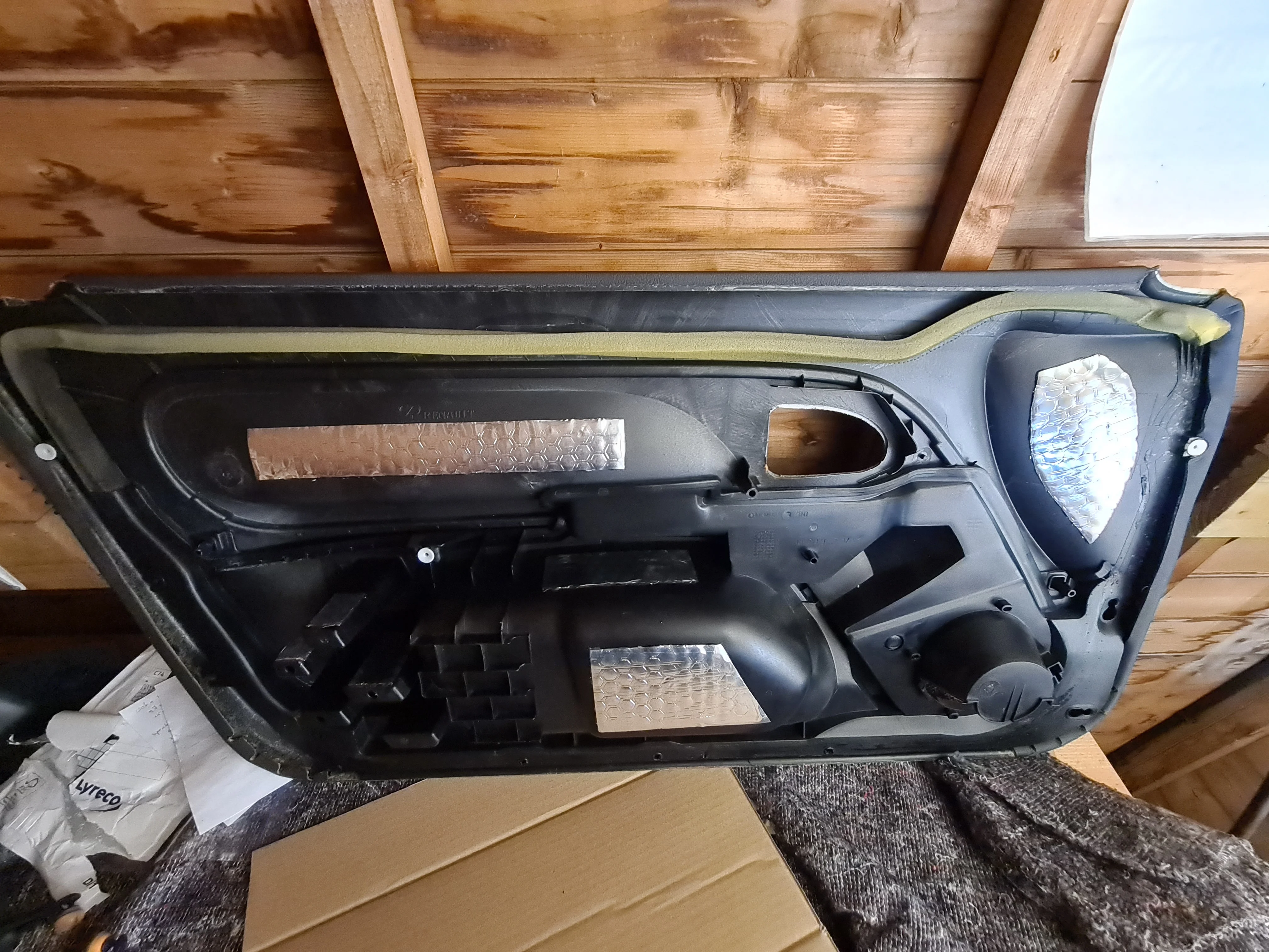

Door card of the front door is done now, just waiting for the paint to dry on the speaker rings and then the speaker and door card can go back in.

Little progress on the sound deadening, lots of work, little time.

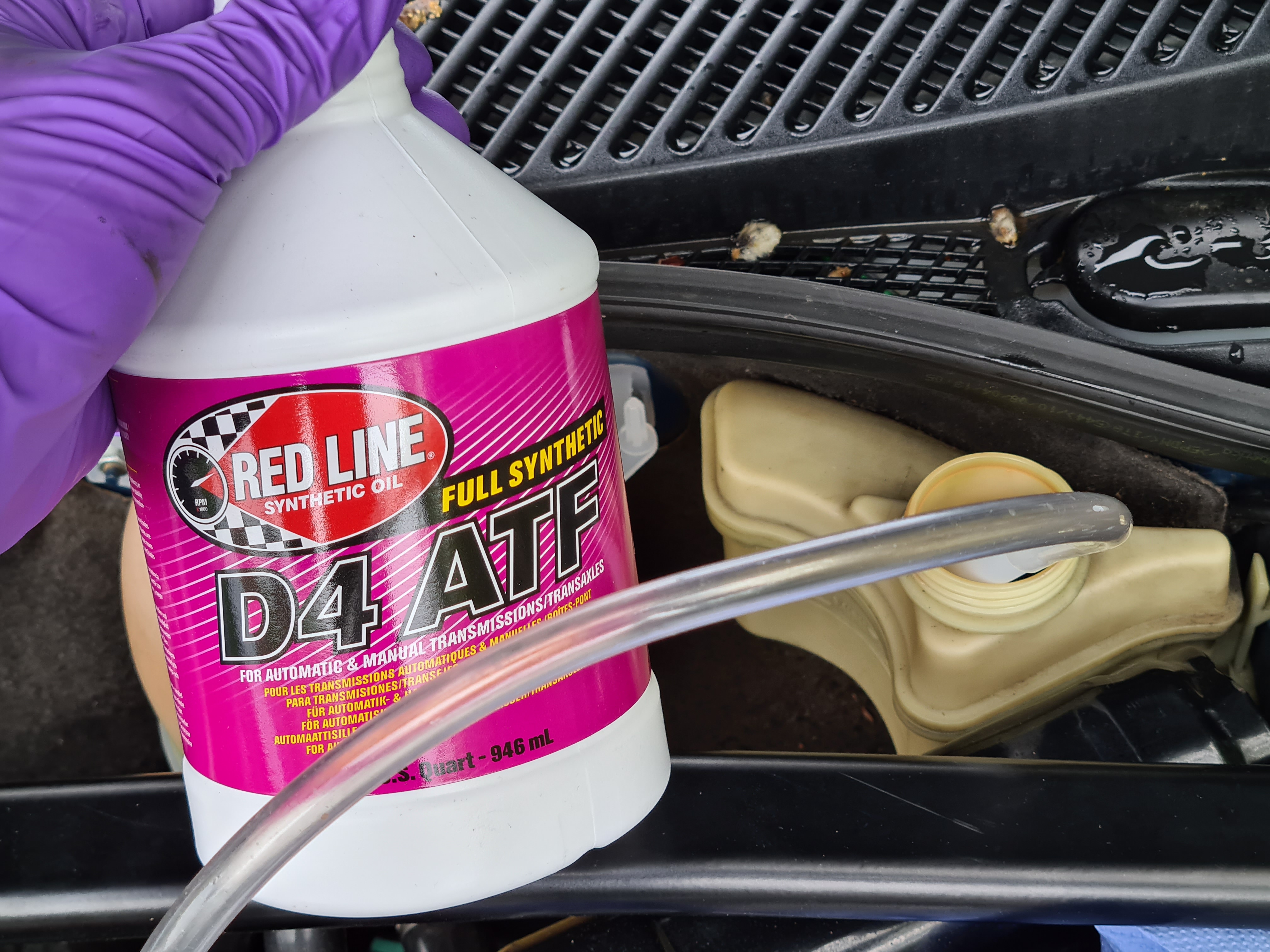

Just a couple of small upgrades, fresh PAS fluid and brake fluid bleed last week ready for the Donington Park evening session.

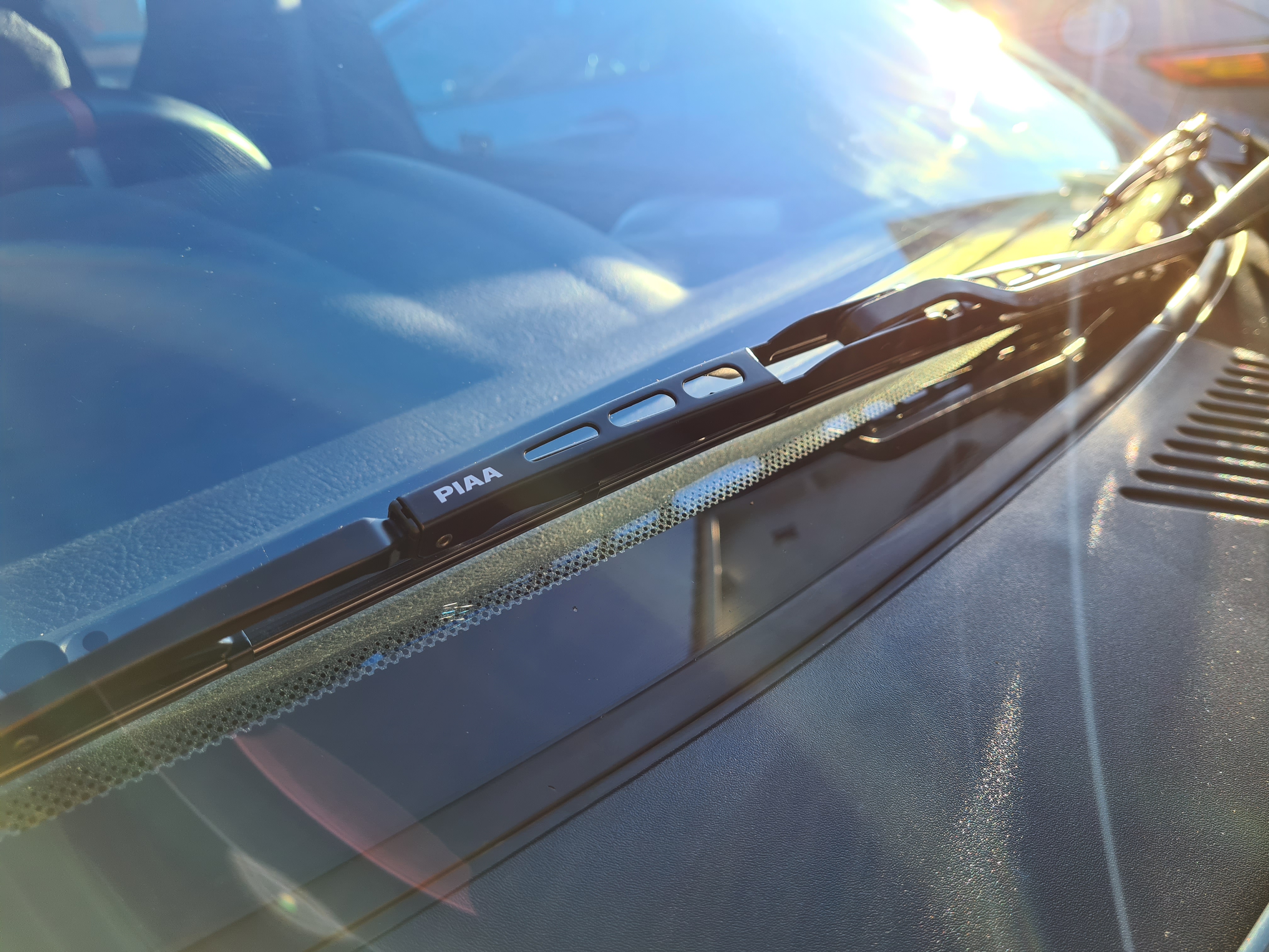

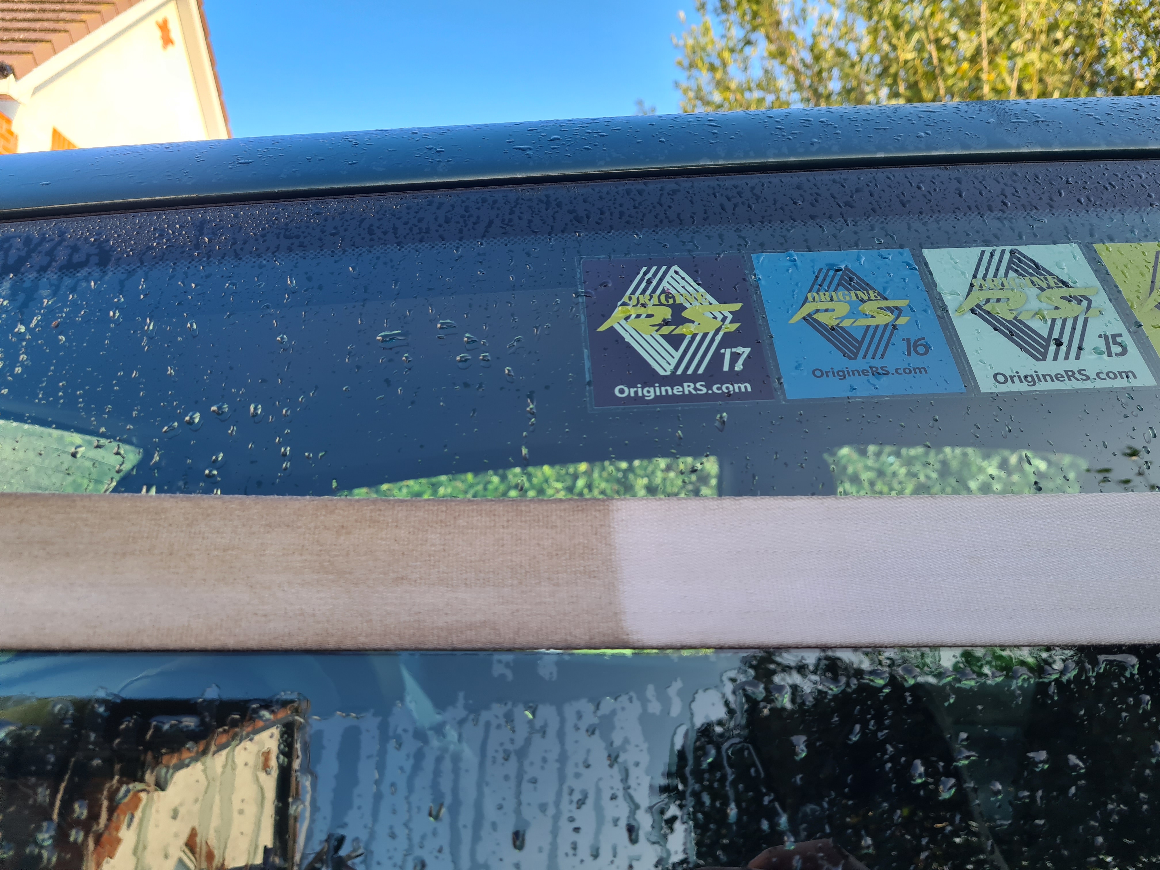

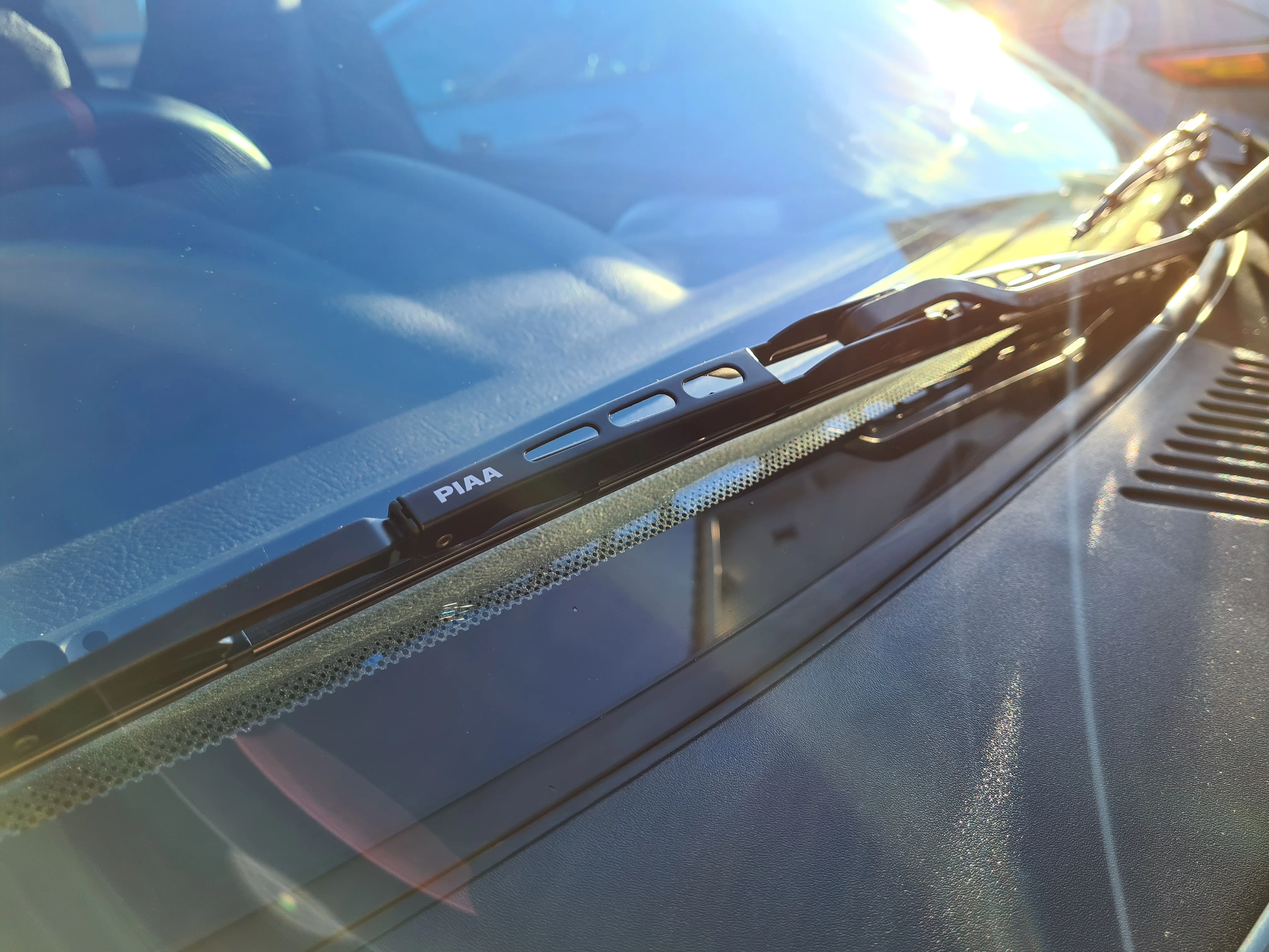

Ordered new wipers as they seemed to be giving up and I've been wanting to see what the whole PIAA thing is all about.
Gave the windscreen a clean, polish and then wiped with the included wipe, see if they are worth the money.

Interesting that you went for the D4 ATF and not the dedicated power steering fluid they do. I've just put some of that in mine.
Bin them and get bosch aerotwins
MLB
I suspect the included window treatment wipe is very similar to rain x.
Do find that Rain X wears off quite quickly for speeds under 40mph.
Usually coat my windows in Gyeon View, so never really use the wipers on the motorway anyway but in heavy rain on track I found not using wipers not an option in low speed corners and with all the spray behind other cars.
Just interested to see how much truth their claim of leaving behind a water repellent coating while using the wipers holds.
If that turns out to be a load of crp I'll be switching back to the Bosch Aerotwins.

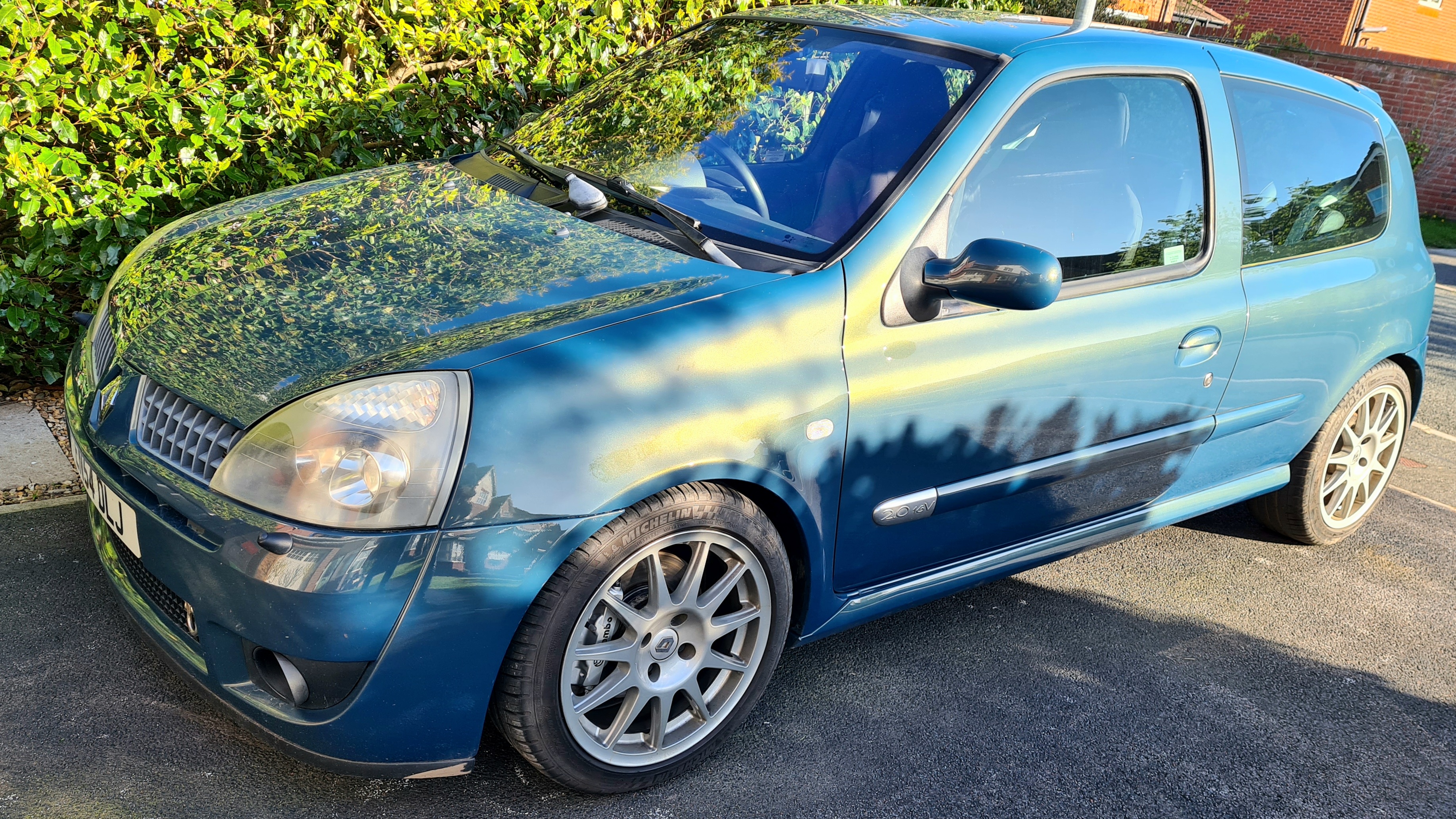

Been using the Petrol Blue a bit more, almost 2000 miles in two months, including two trackdays, Oulton Park in July and Anglesey last Monday.
Two good days, both dry and sunny, which meant lots of comments on the colour.
Surprised a couple of people at Anglesey who assumed I'd wrapped it until @HAP showed up with exactly the same 'wrap'!

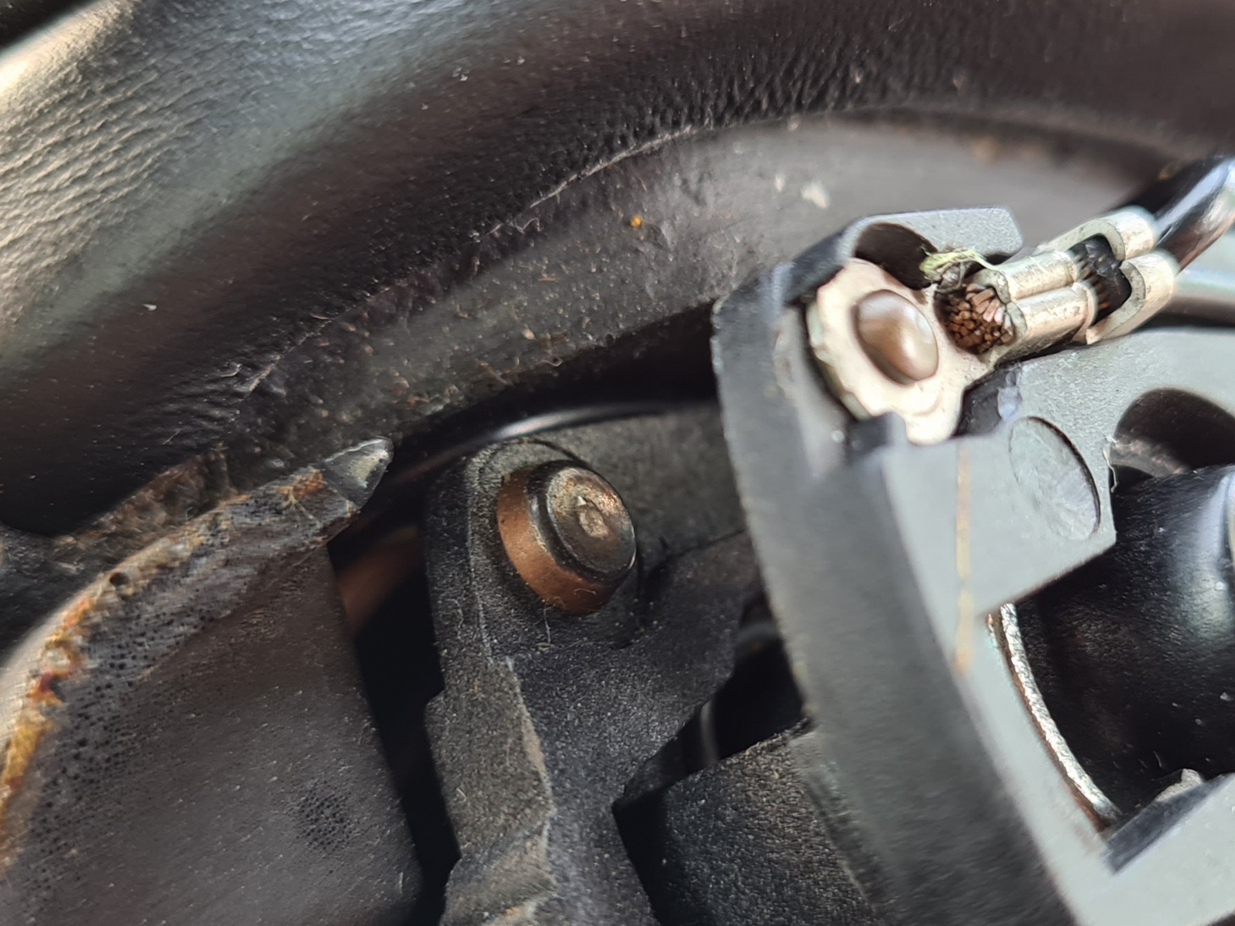

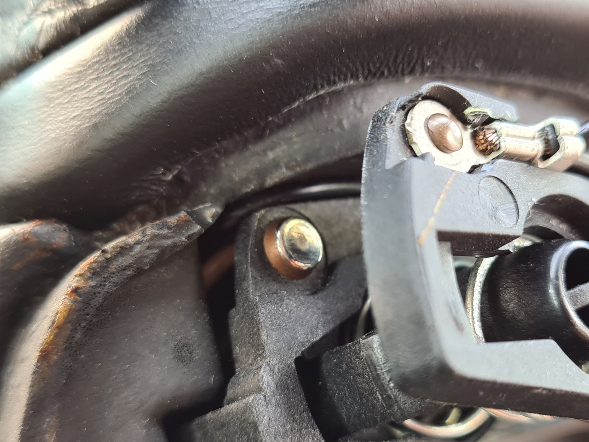

Did notice that my horn had ceased to work.
Reconnected a loose wire in the wheel well which didn't fix it so feared I'd damaged the wiring when I had the airbag out recently.

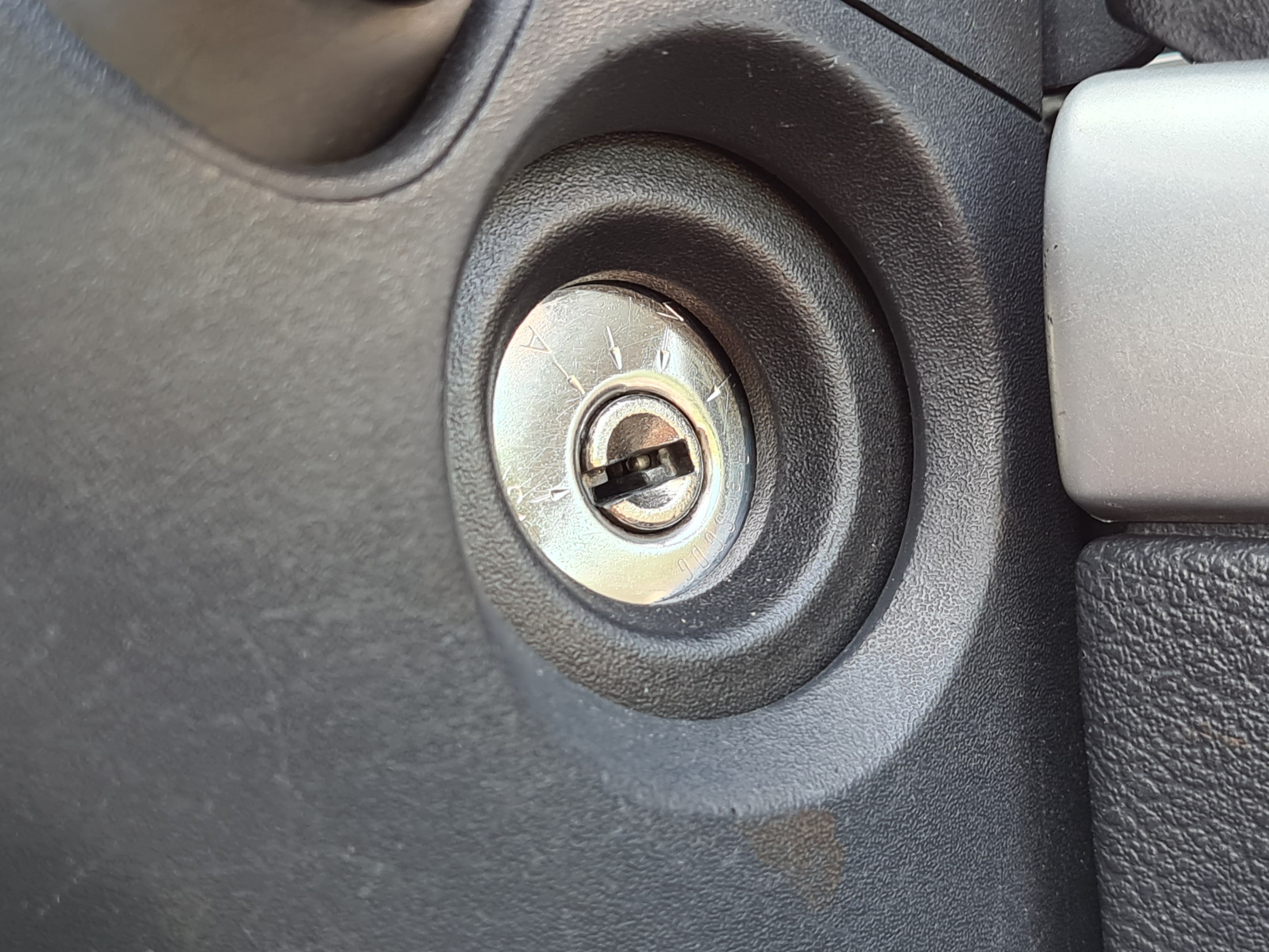

Luckily it was just filthy switches, quick clean and all three work again. While there I gave the ignition switch a polish as well.

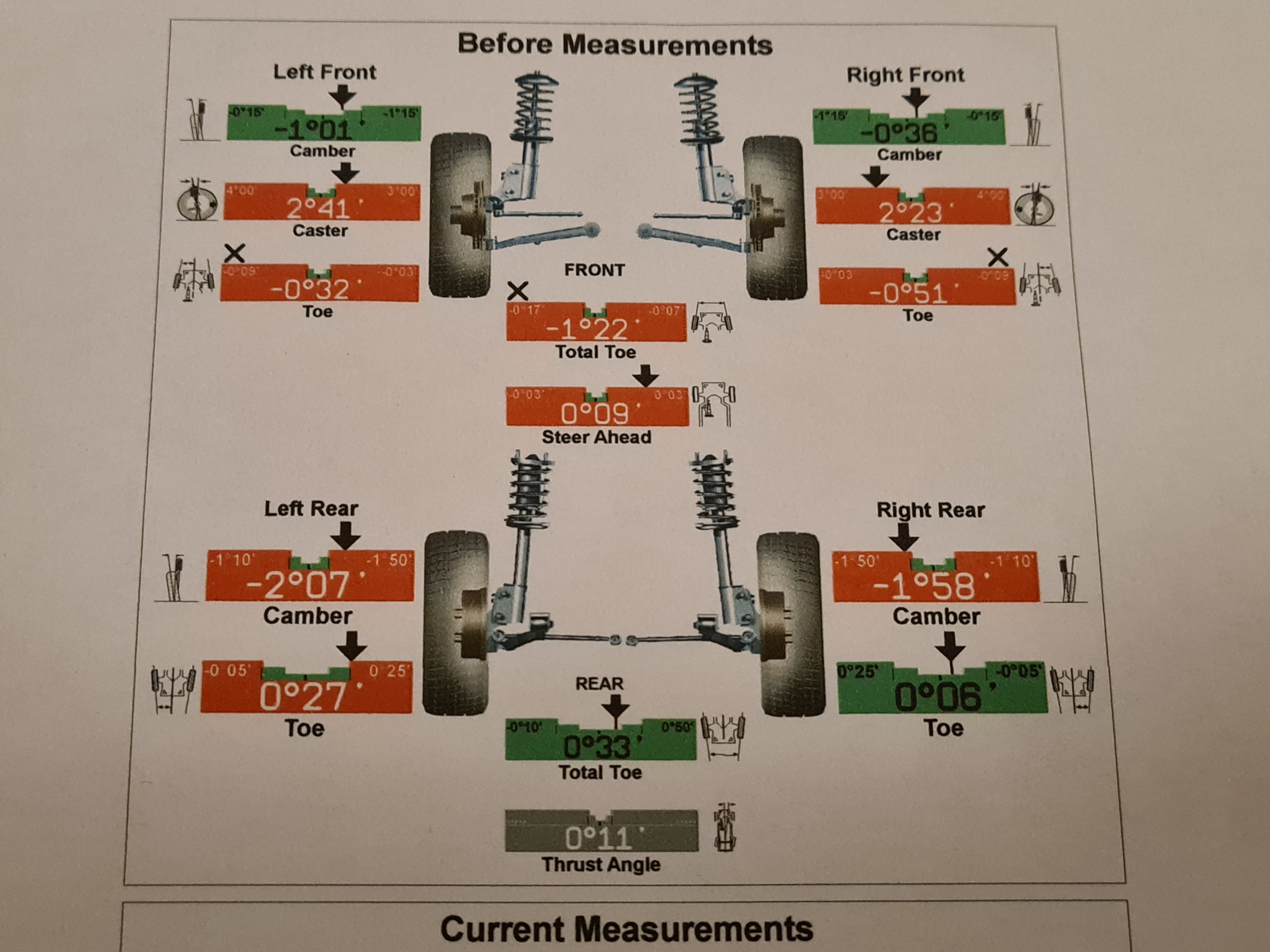

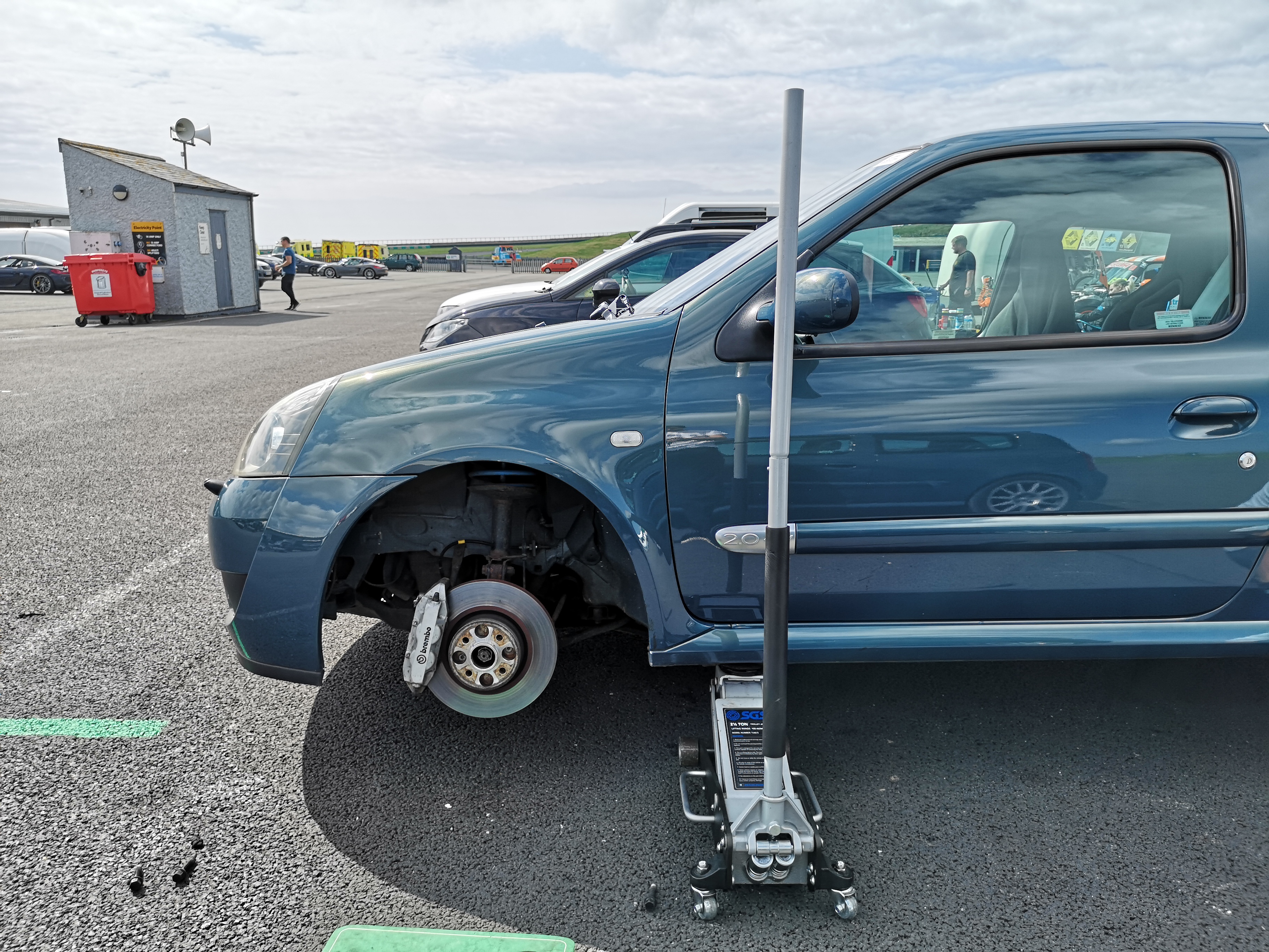

Annual service with a couple of extras done at Birchdown in Malpas. Oil/filter change, new track rods/ends, fit camber bolts and a couple minor things.
Brilliant service as always, thanks @Birchdown!

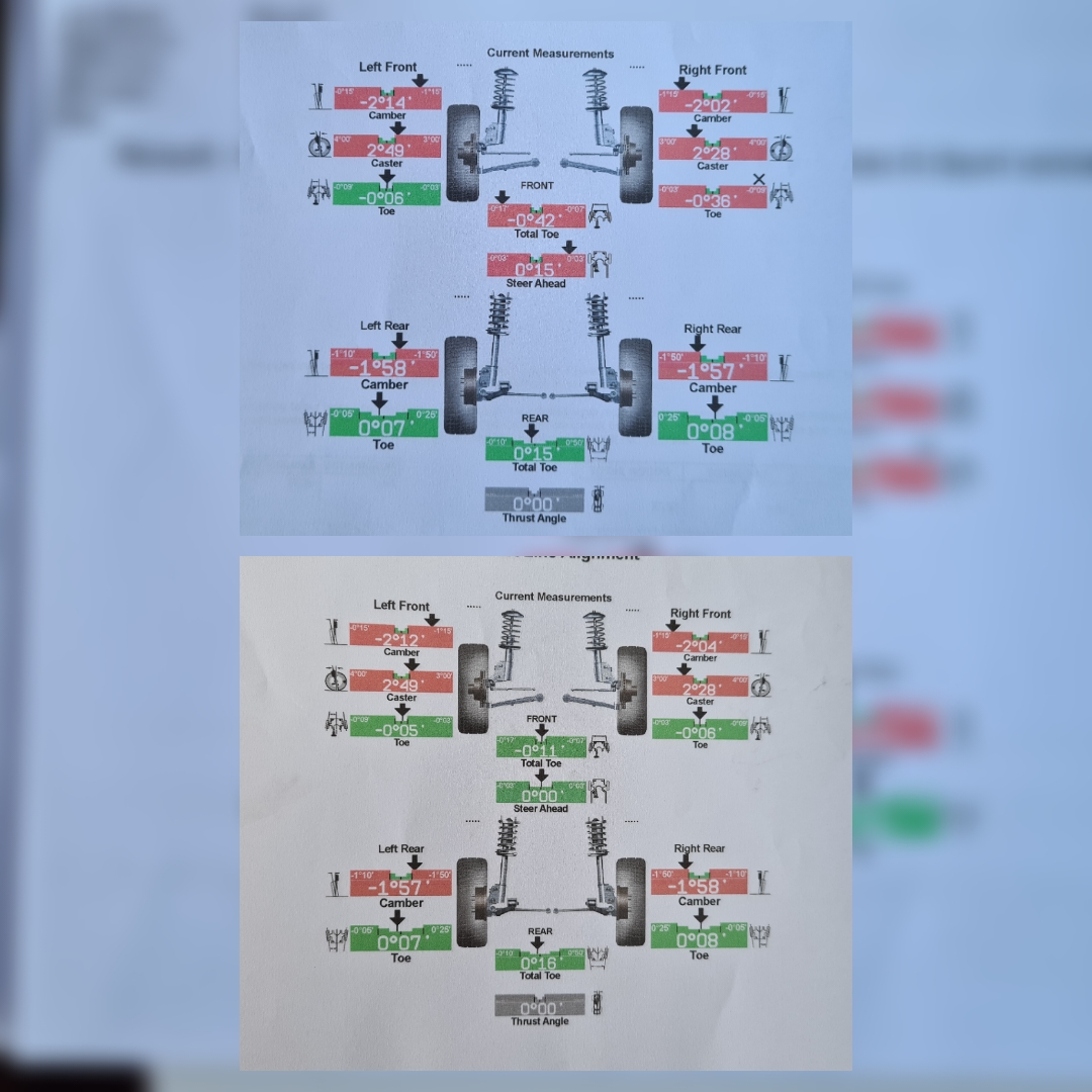

Had the car booked in for wheel alignment the day after but sadly the garage I'd booked couldn't adjust the camber. Bit of phoning around and Demon Tweeks were able to fit me in thst afternoon, took me from 0900 till 1500 to get the alignment done but it feels great, like a new car, so much sharper.
See how it feels at Anglesey on Monday.
Before
After

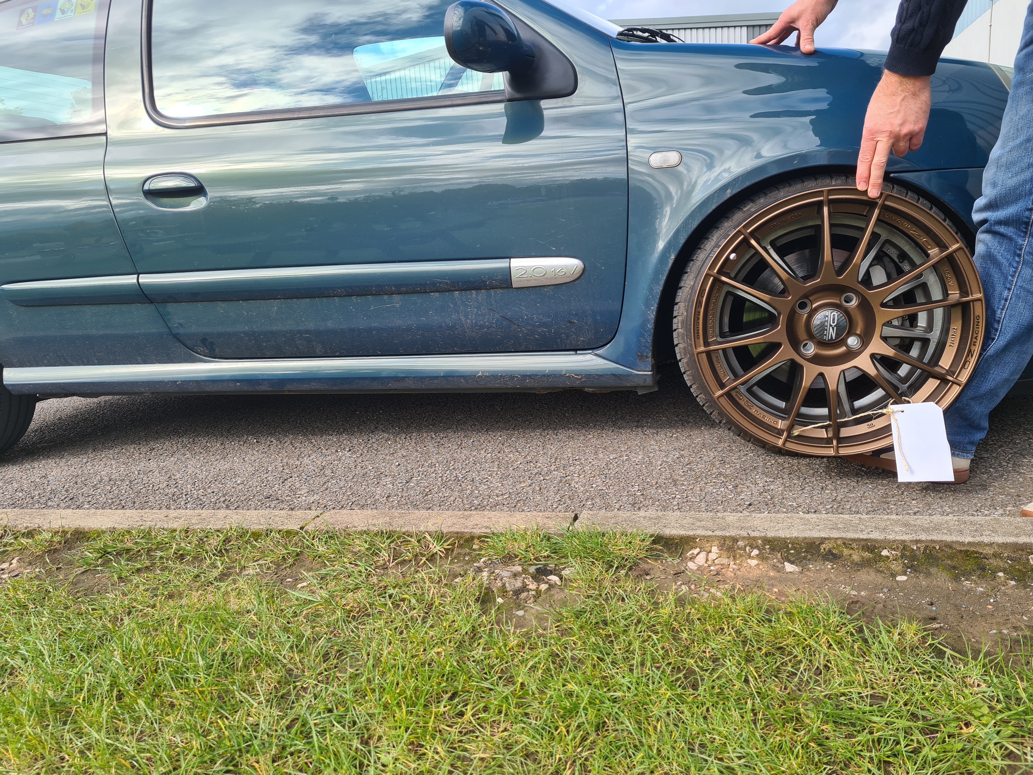

While I was at Demon Tweeks I got a bronze Ultraleggera out, I quite like it, nicer than the hyper silver I think.
Before
After
Not a good match for the car colour imo anthracite all the way
MLB
It's just something else, think gold would match the gold paint flake better but they're a bit too bright.
Matte graphite is the grey option for these, but I think they might look a bit dull. Easy to clean after a trackday though!

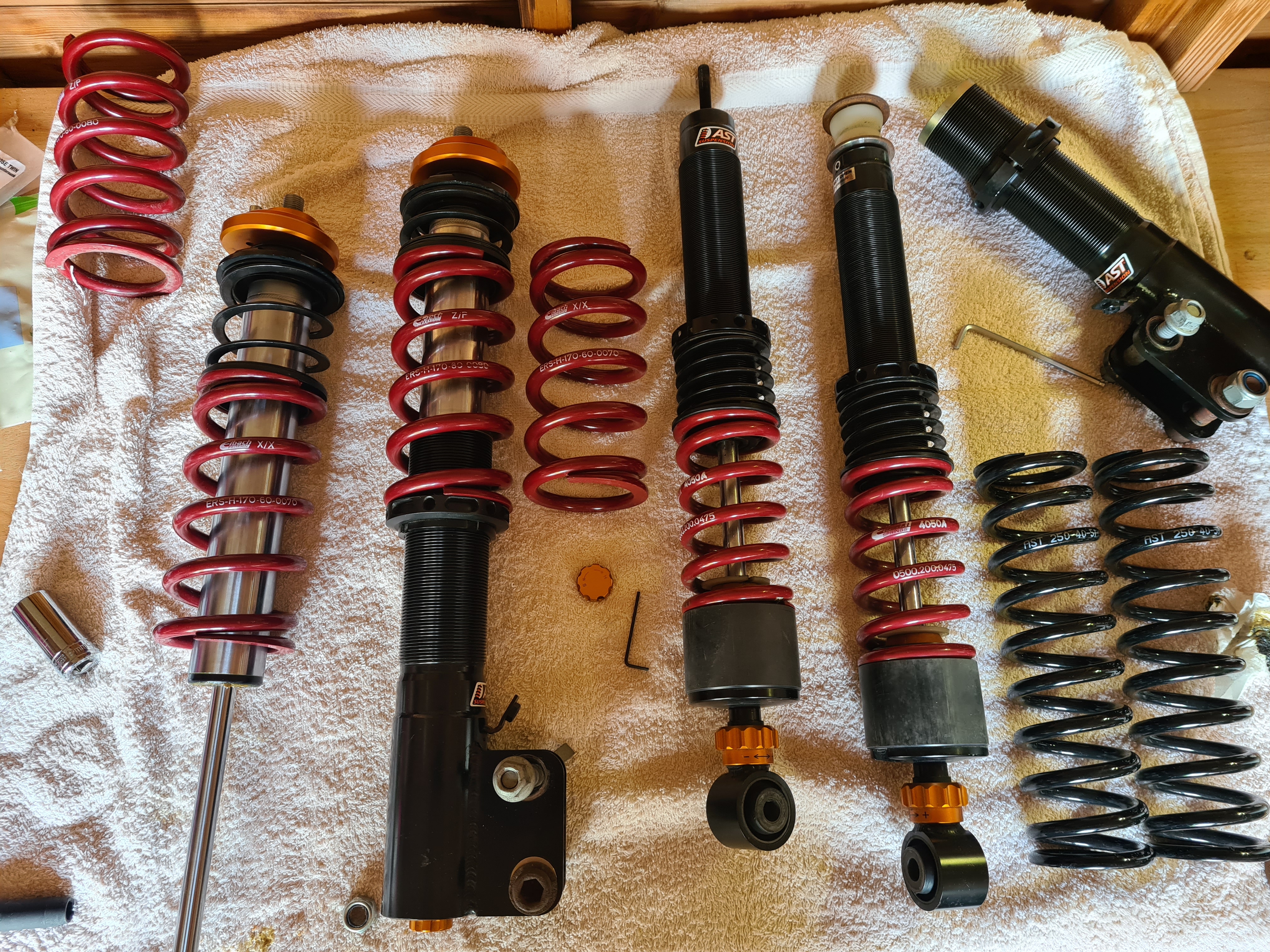

Rear shocks

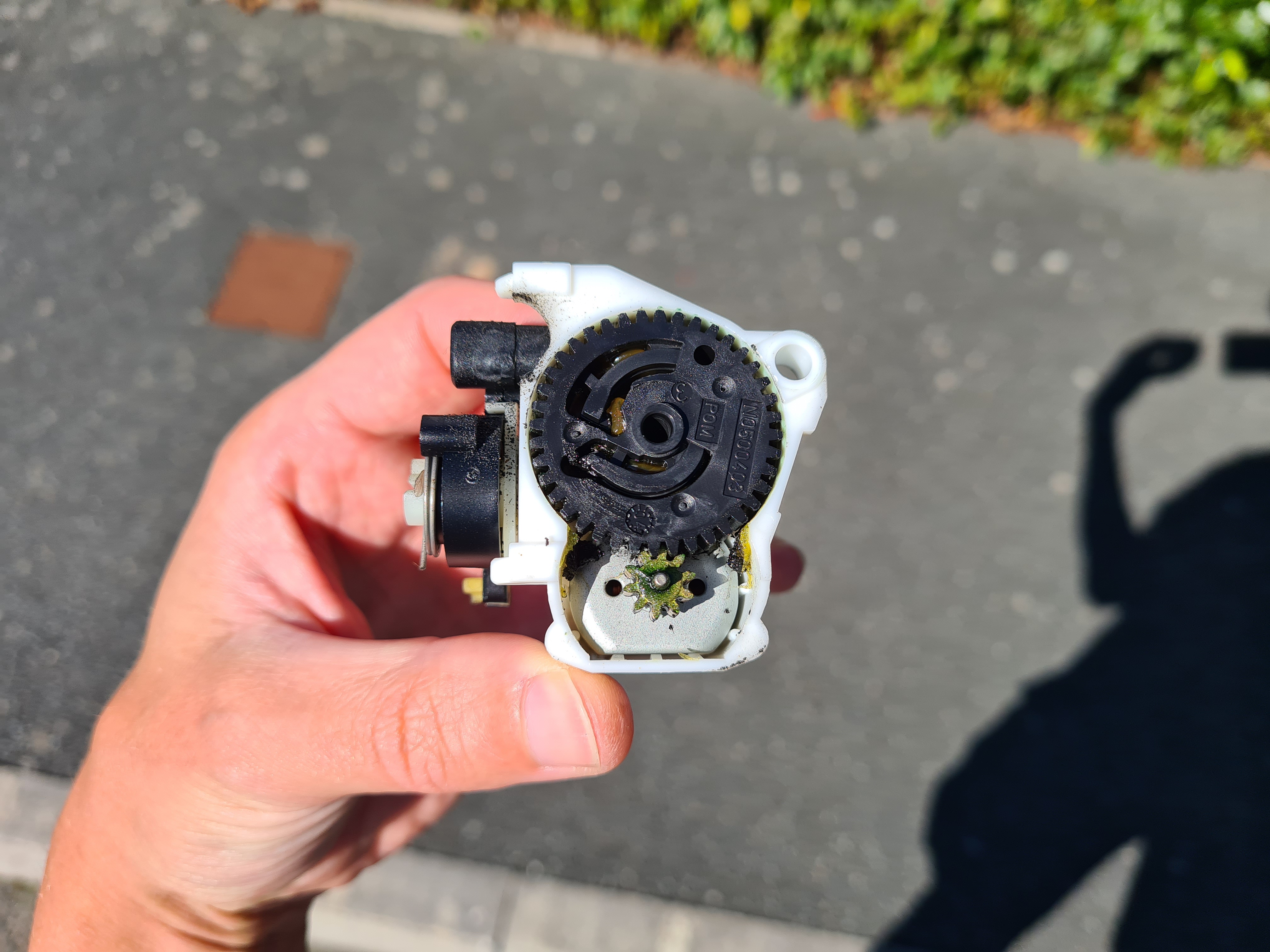

Boot lock stopped working so took that apart, was just full of plastic dust and grease, all cleaned out and working fine again.

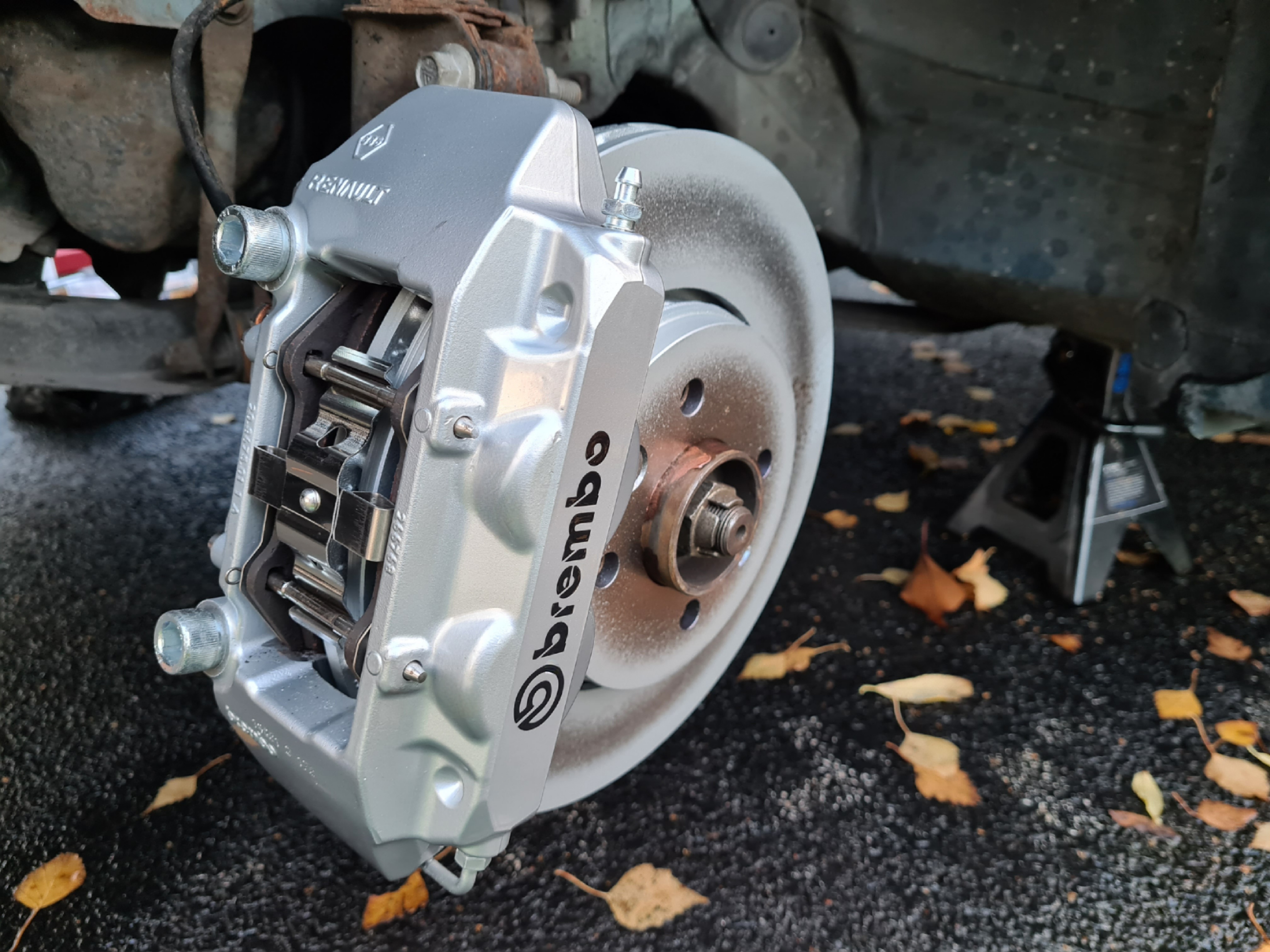

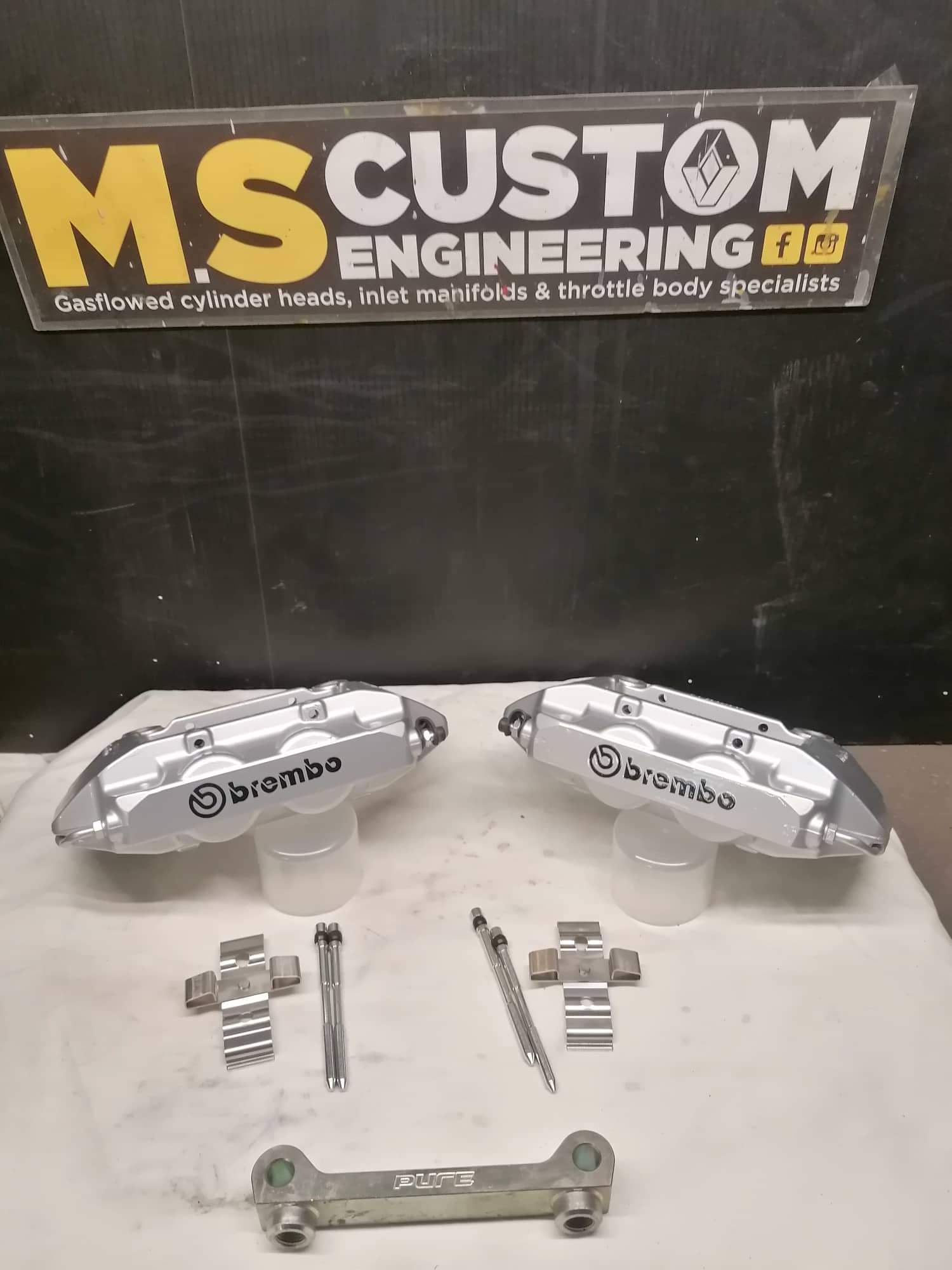

With winter approaching and no more trackdays booked I decided to SORN the car and review the brake system.
Noticed three out of four bleed valves were leaking last trackday so got the calipers sent off to M.S. Custom Engineering.
Max was great to deal with and within two weeks I had the refurbished calipers back, ready to go on with the PMS 280mm brackets so I have the option to run 15" wheels.
Genuine Renault discs this time

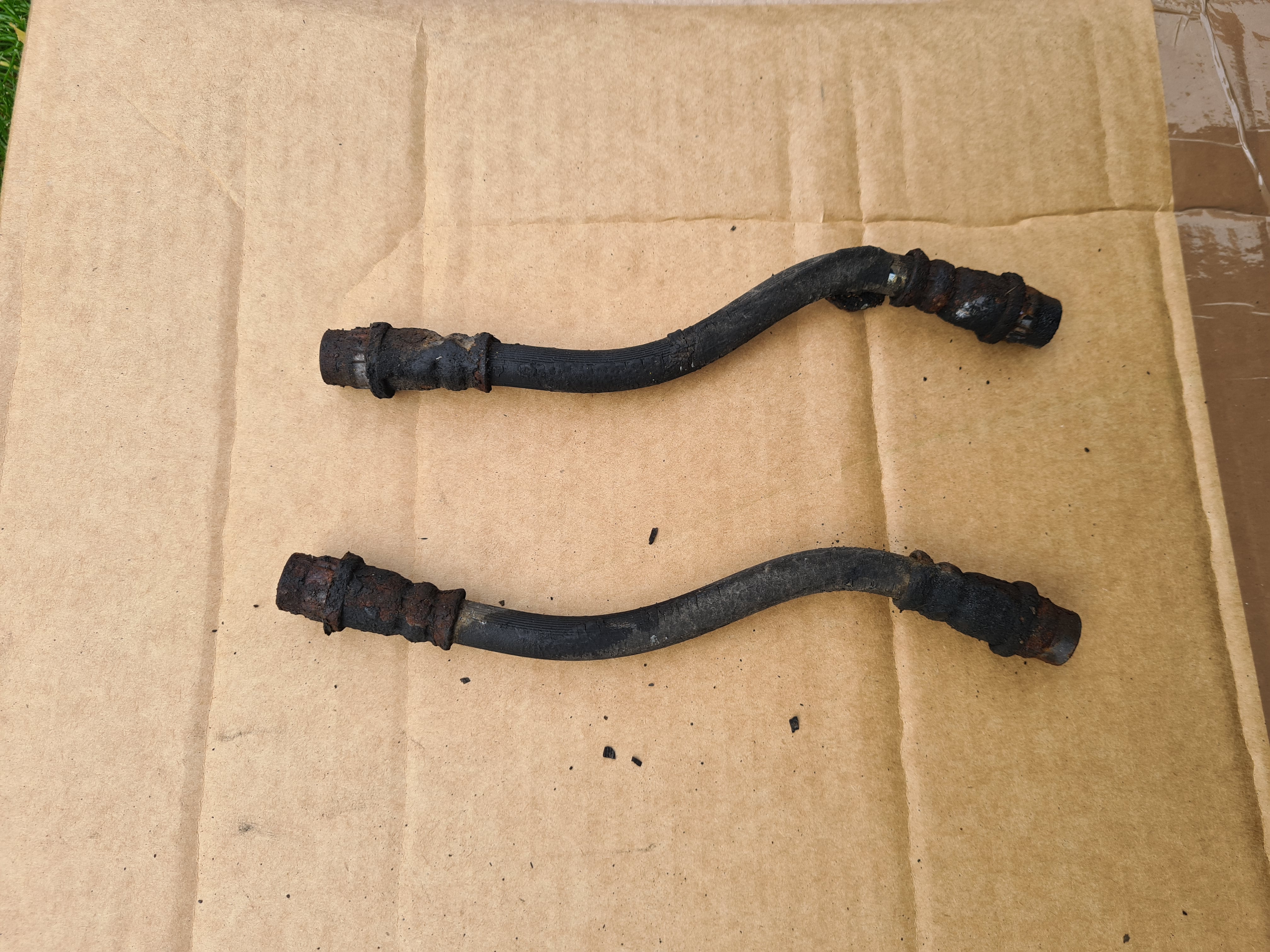

Rear flexis replaced with braided HEL hoses

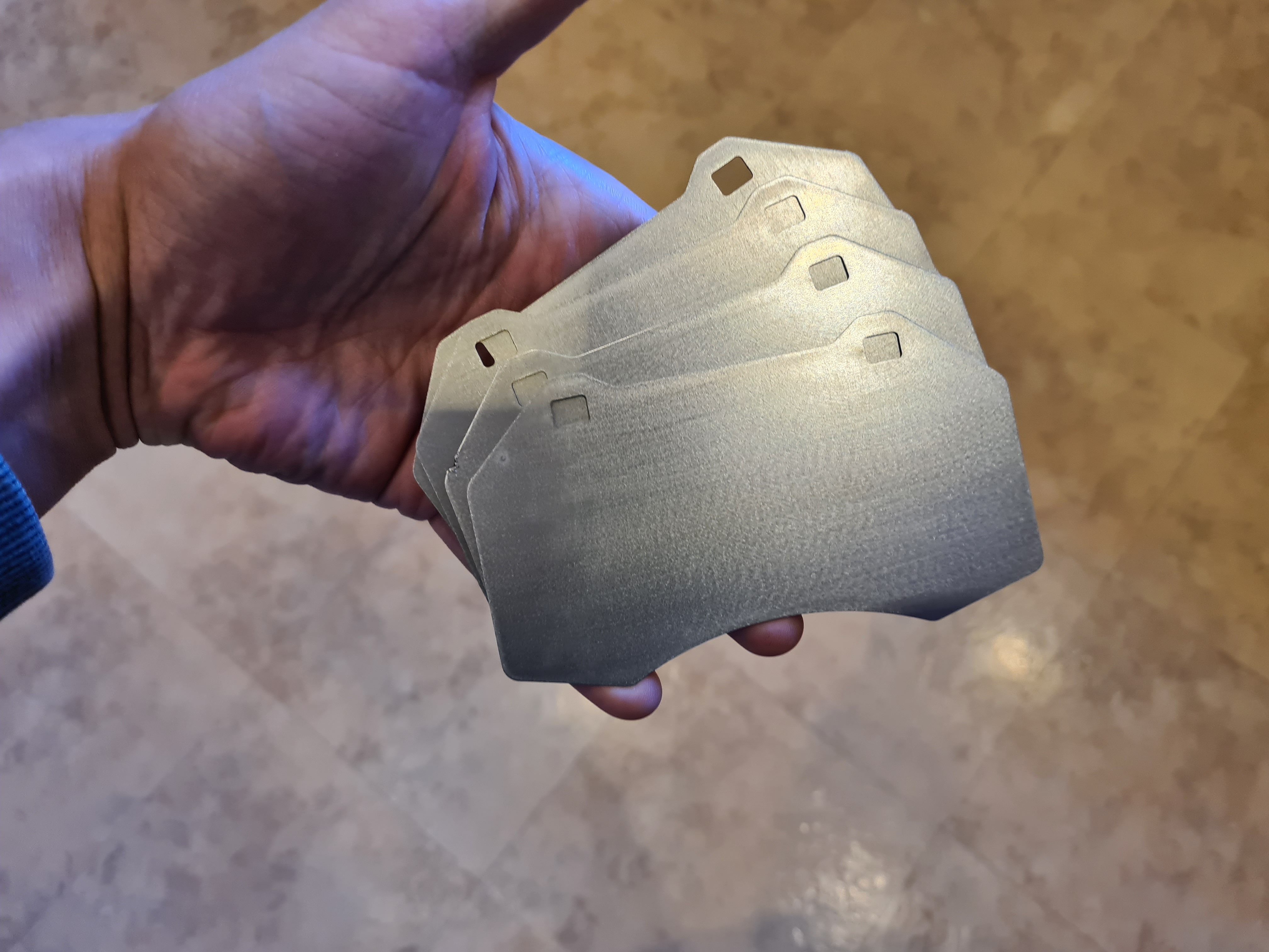

Other upgrades are titanium shims, Ds2500 rear pads and Castrol SRF.

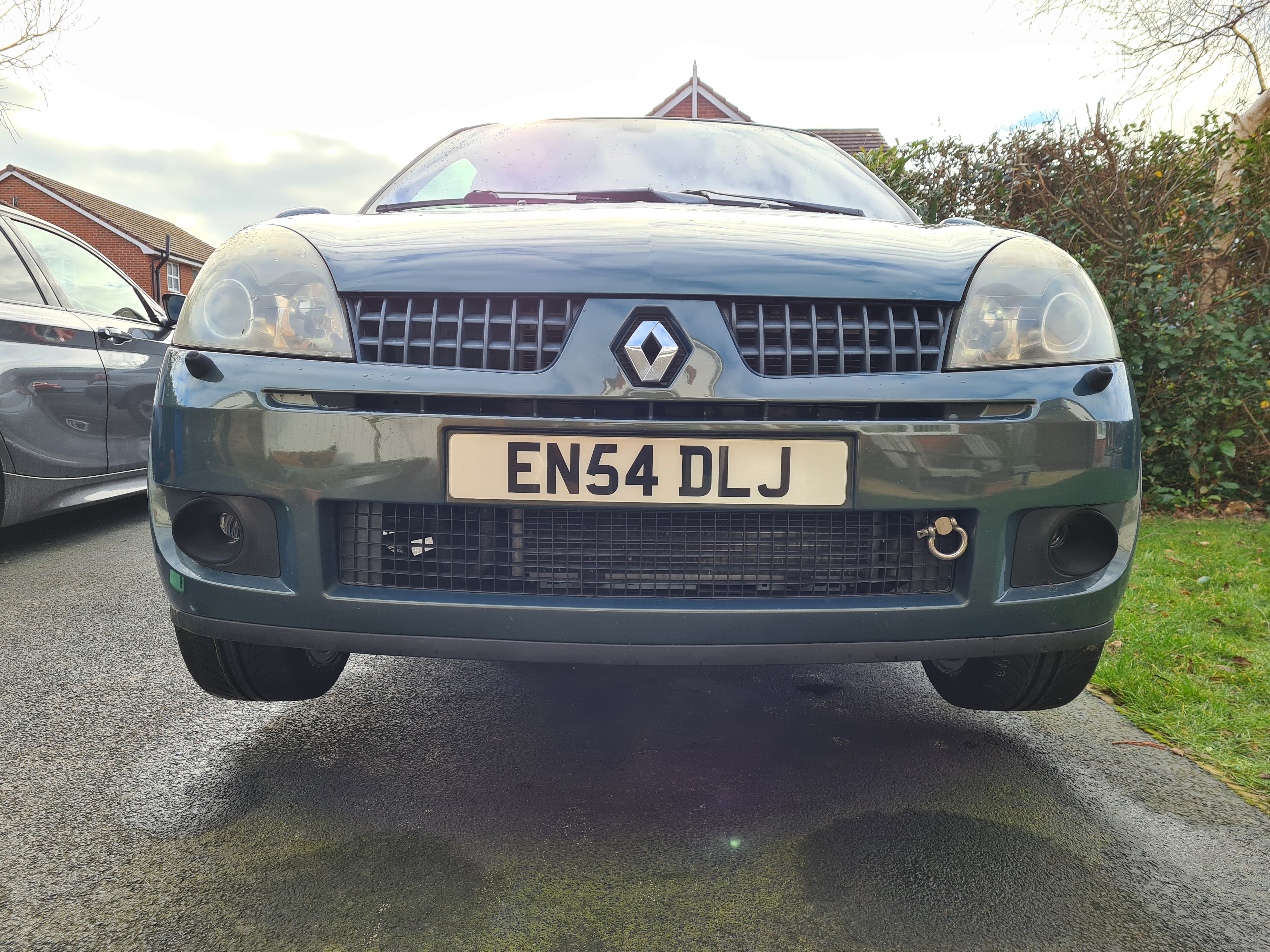

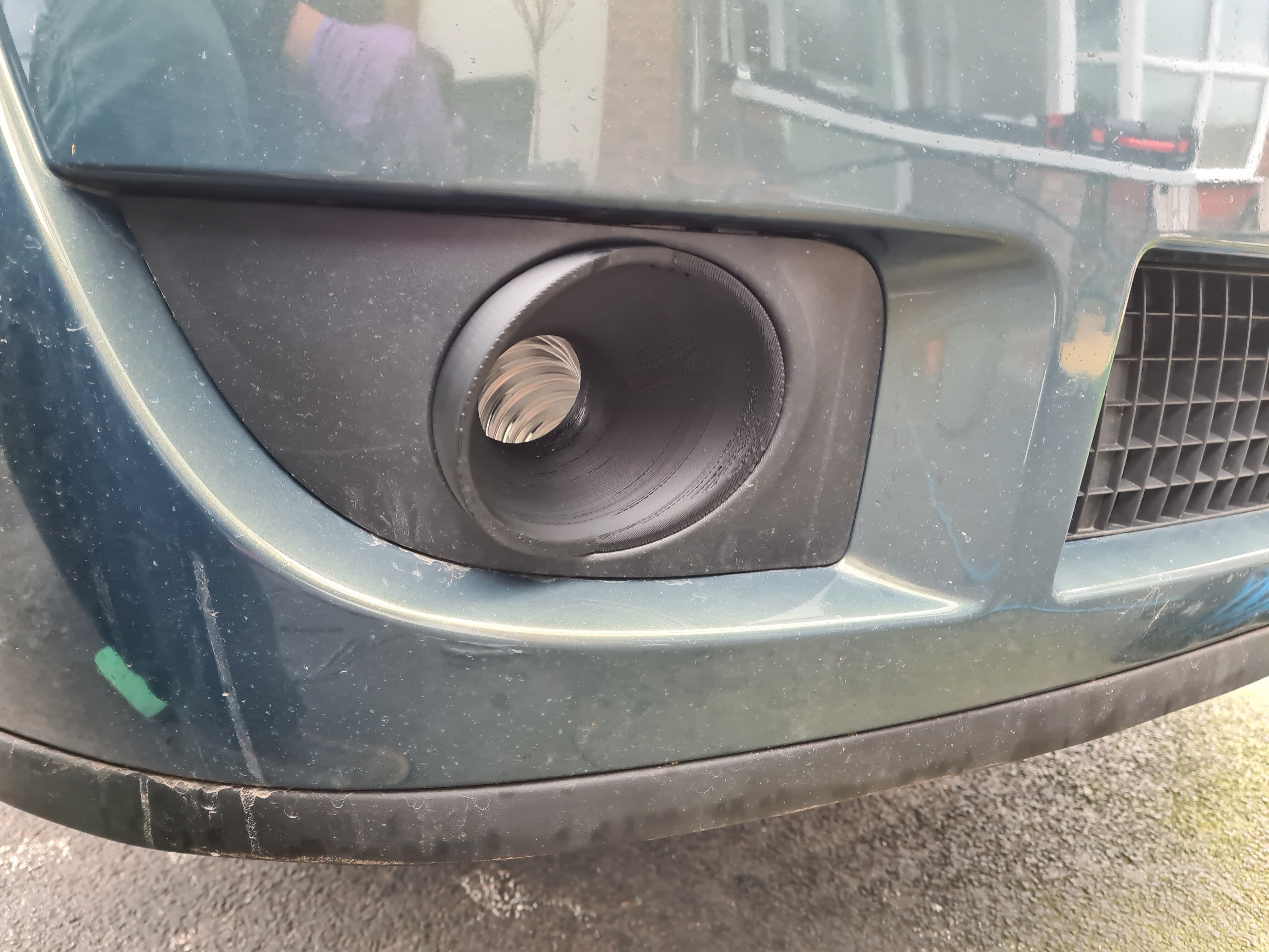

Only thing I'm waiting for now are air scoops to fit the brake cooling kit. They should be arriving in the new year and then I'll have to get some more trackdays booked.
MLB

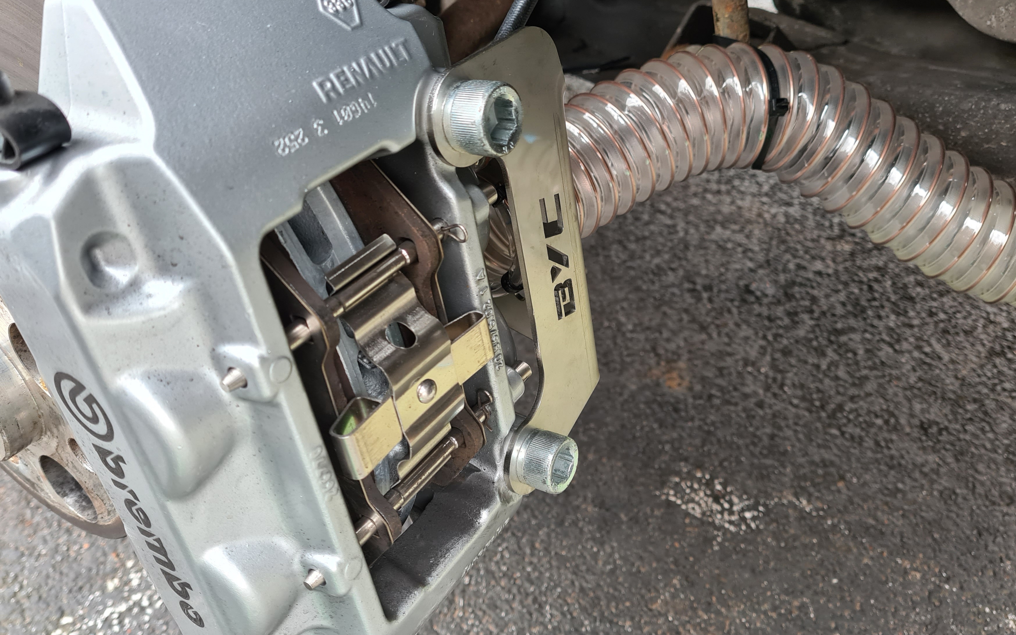

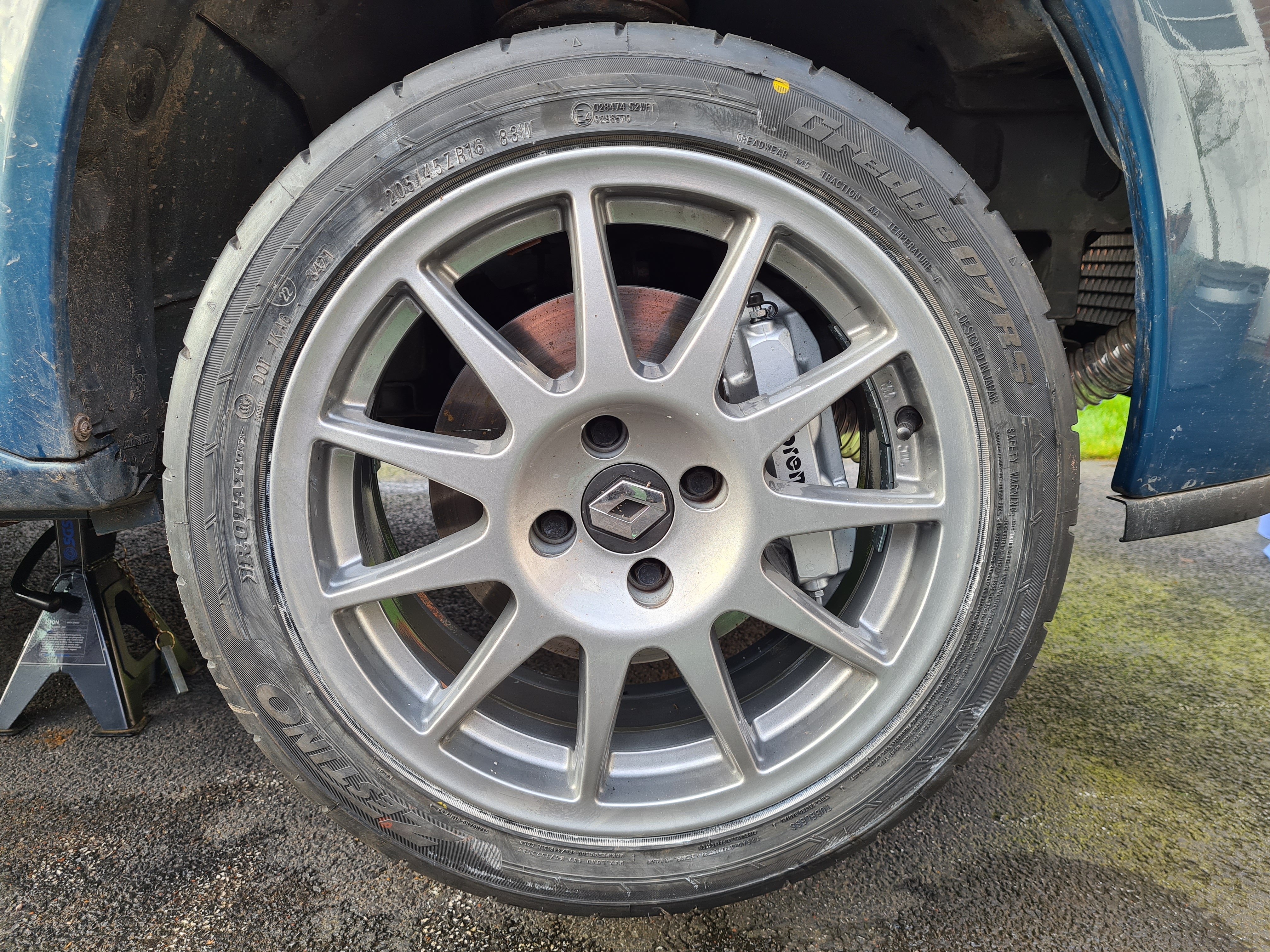

All ready for Oulton Park tomorrow.

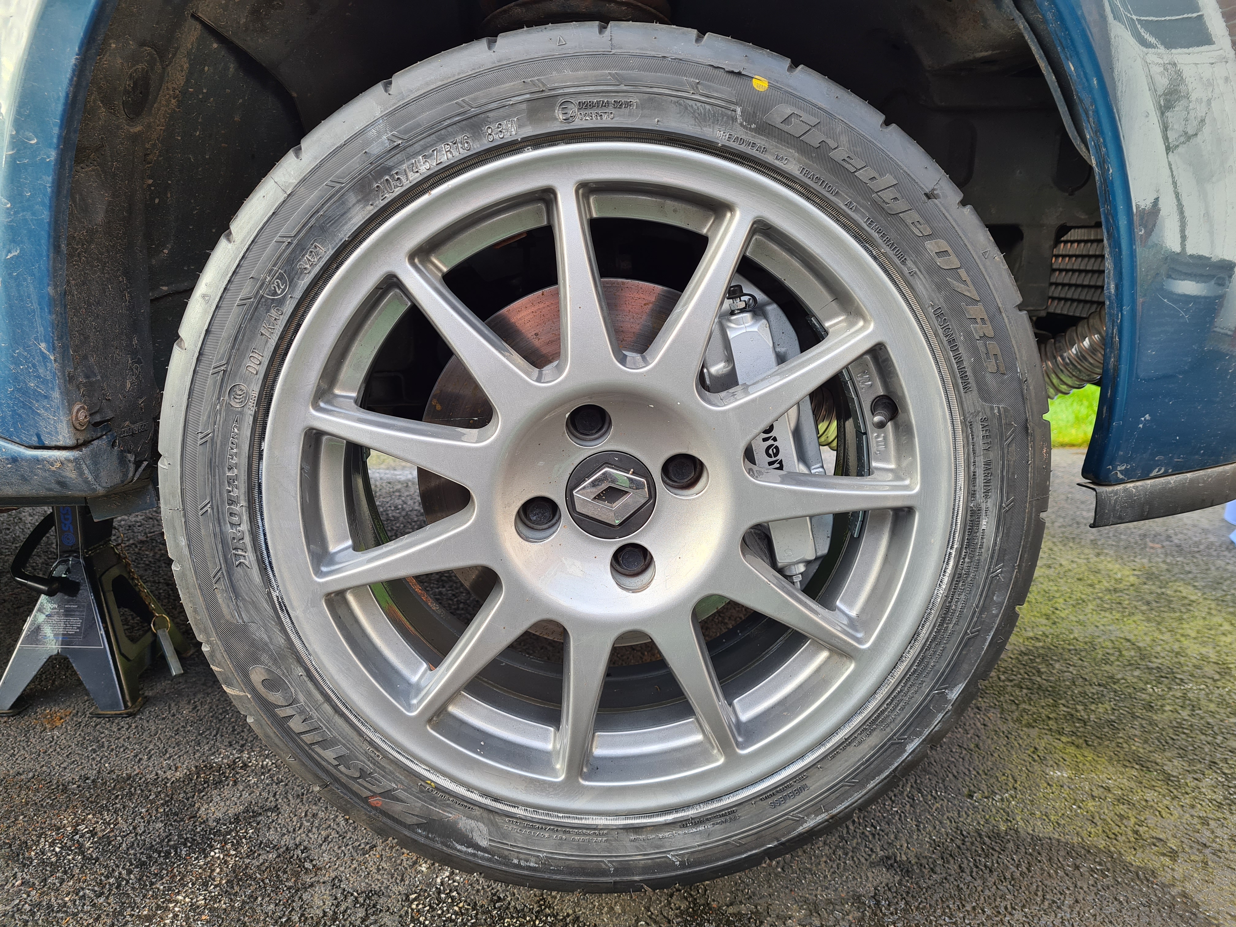

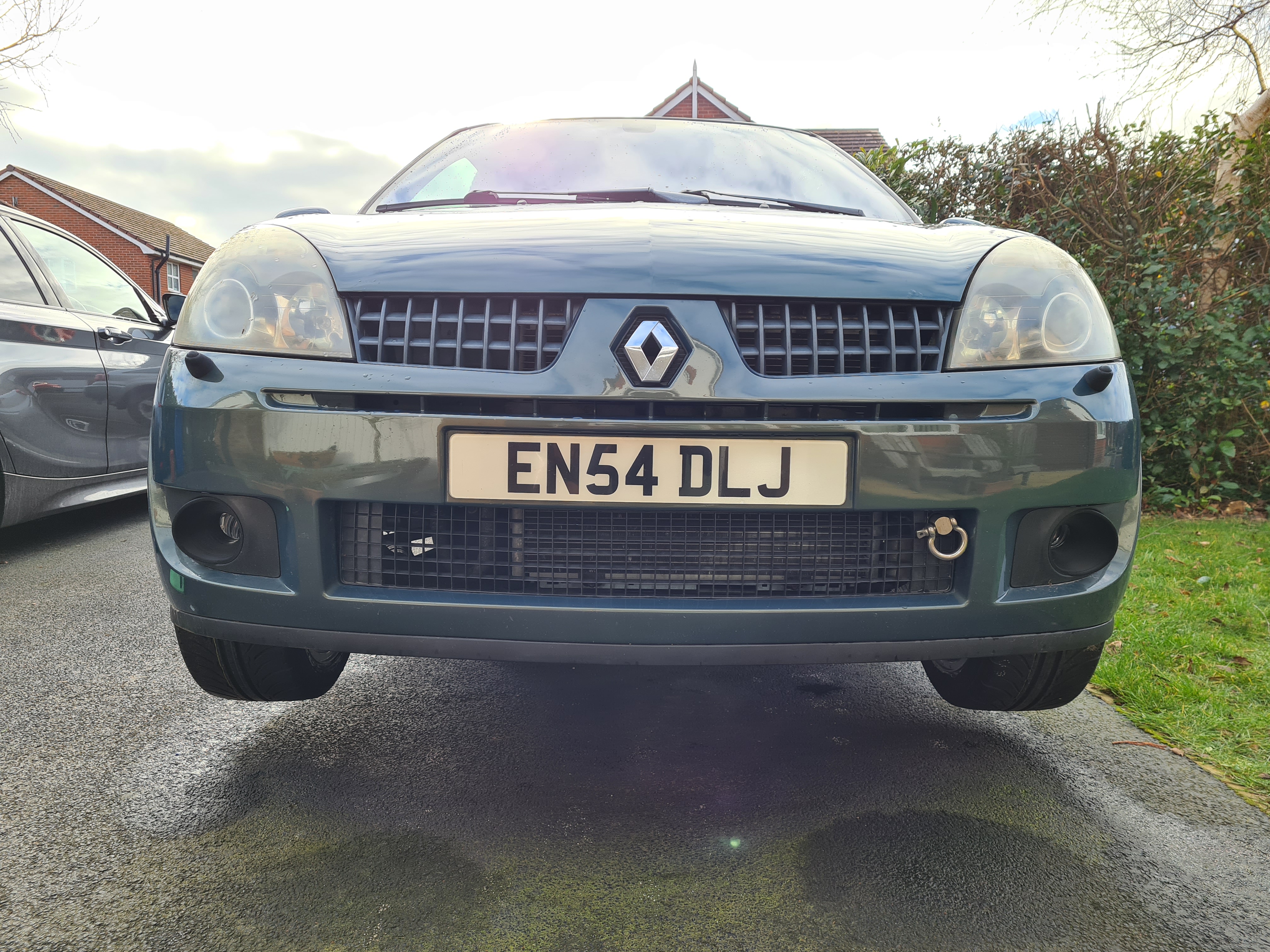

New Zestino Gredge tyres fitted, all fluids topped up, oil change done, brakes bled again and cooling fitted.
Air scoops arrived and are a perfect fit. Seller was super helpful and willing to adapt the design to fit the 54mm air ducts for the BYC kit.
Brakes look tiny in these wheels now, coming from 300mm discs!
Looks like it's going to be cold but sunny, hoping for a great start of the season!

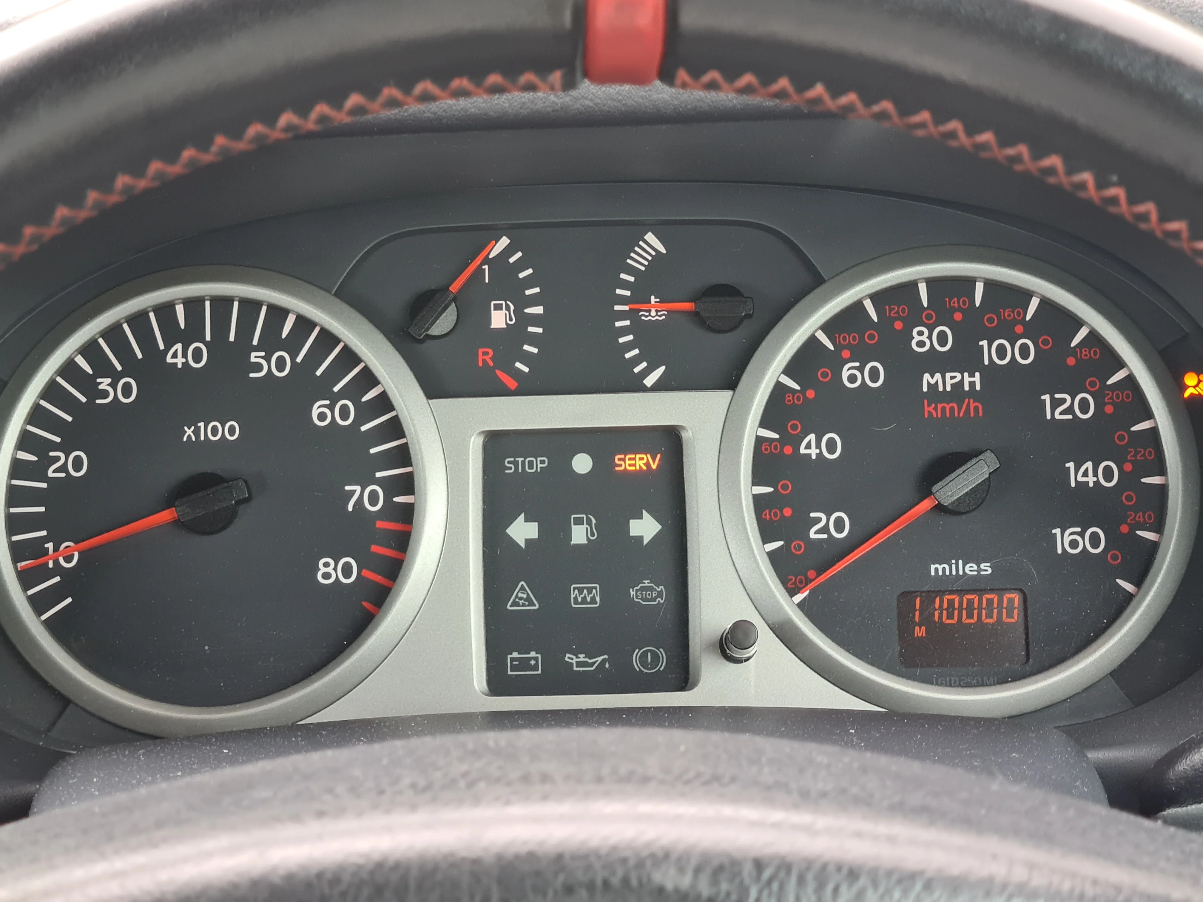

Ticked over 110k, which means exactly 10.000 miles in my ownership and still going strong.
First time I've got a light as I've removed the passenger seat to finally put the stereocables away.

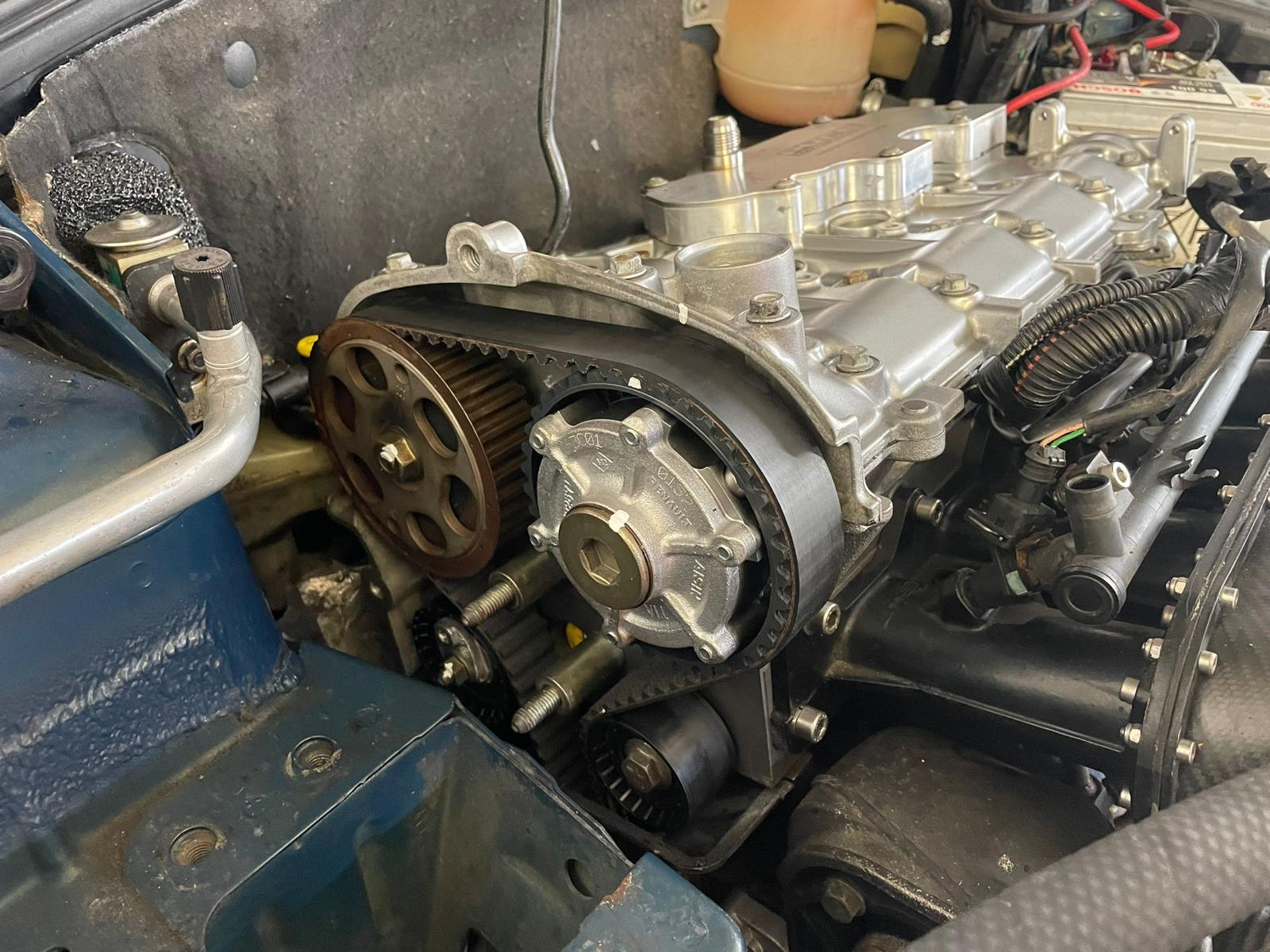

Steering got a bit vague and started pulling left and right coming on and off the throttle which turned out to be the balljoints. Replaced with Lemforder items and all is good again. Just been for a drive and the vagueness is all gone.

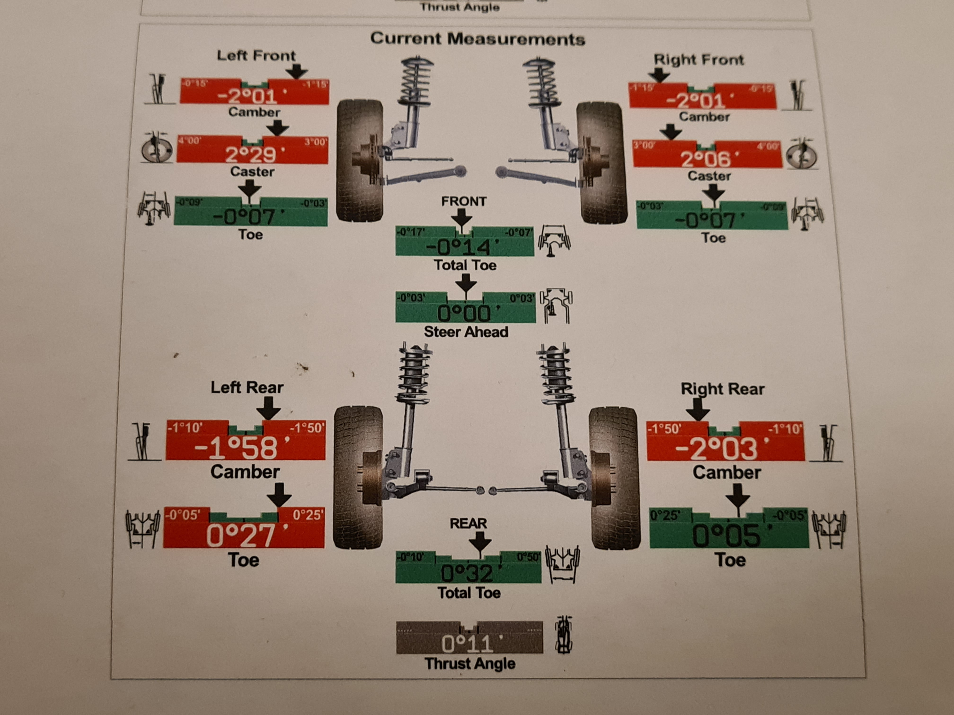

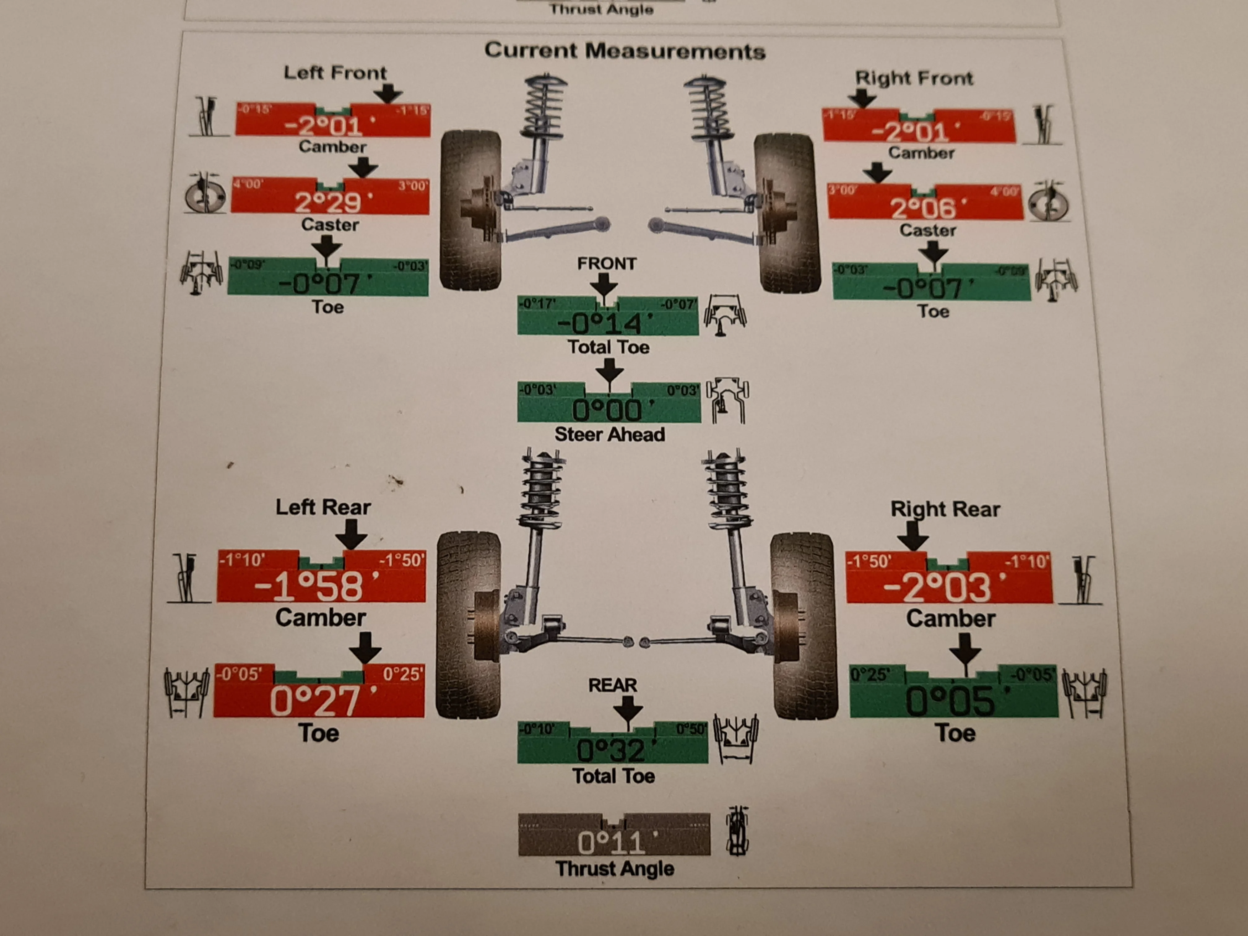

Got a wheel alignment done in preparation for Anglesey last Monday.
Was a great day, beautiful weather and except for splitting an air conditioning pipe the car performed faultlessly.

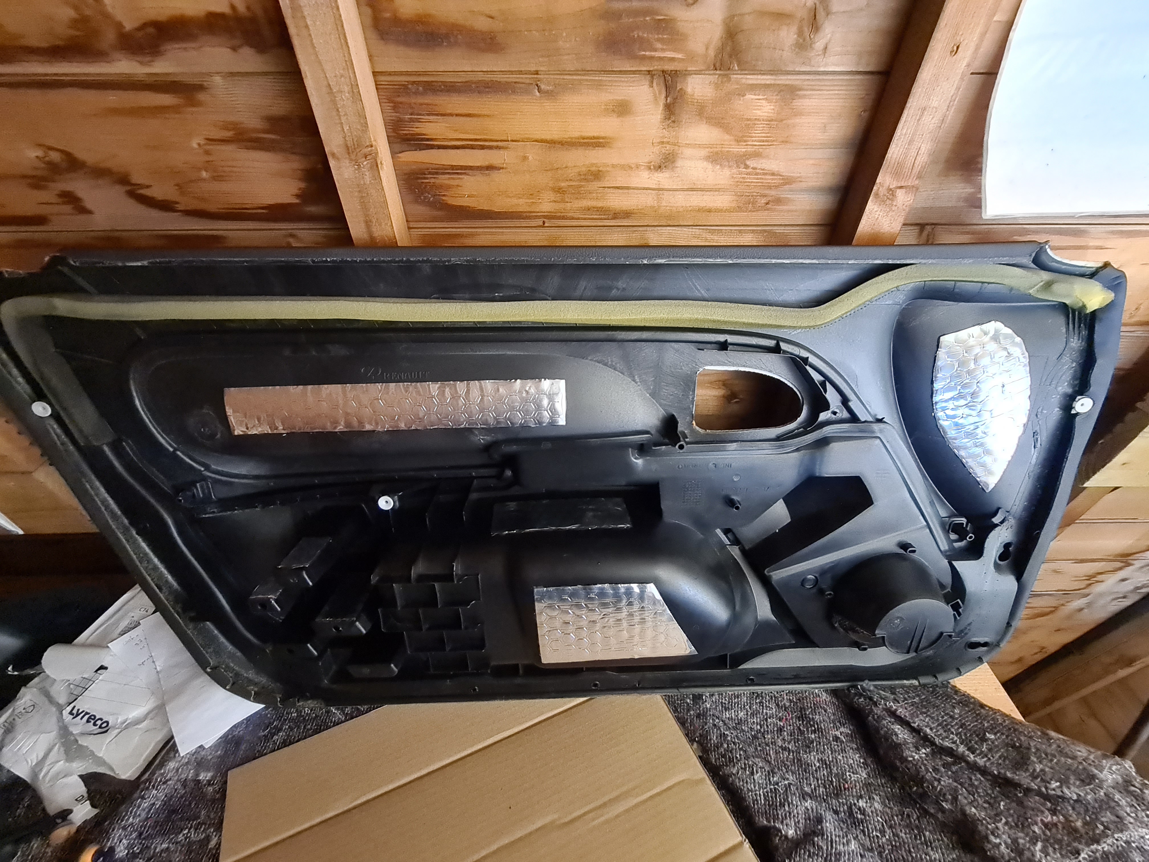

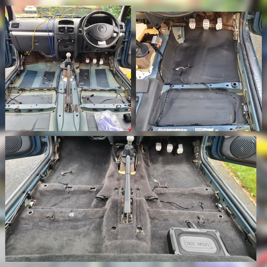

Also finally finished the speaker cable/sound deadening in the front. Have been driving around with cables across the cabin for more than two years 😂
Had to crack on a bit so not many photos as I wanted to get it finished before Anglesey again on Monday. Not driven it except to move it on the drive but it sounded a bit quieter again.
