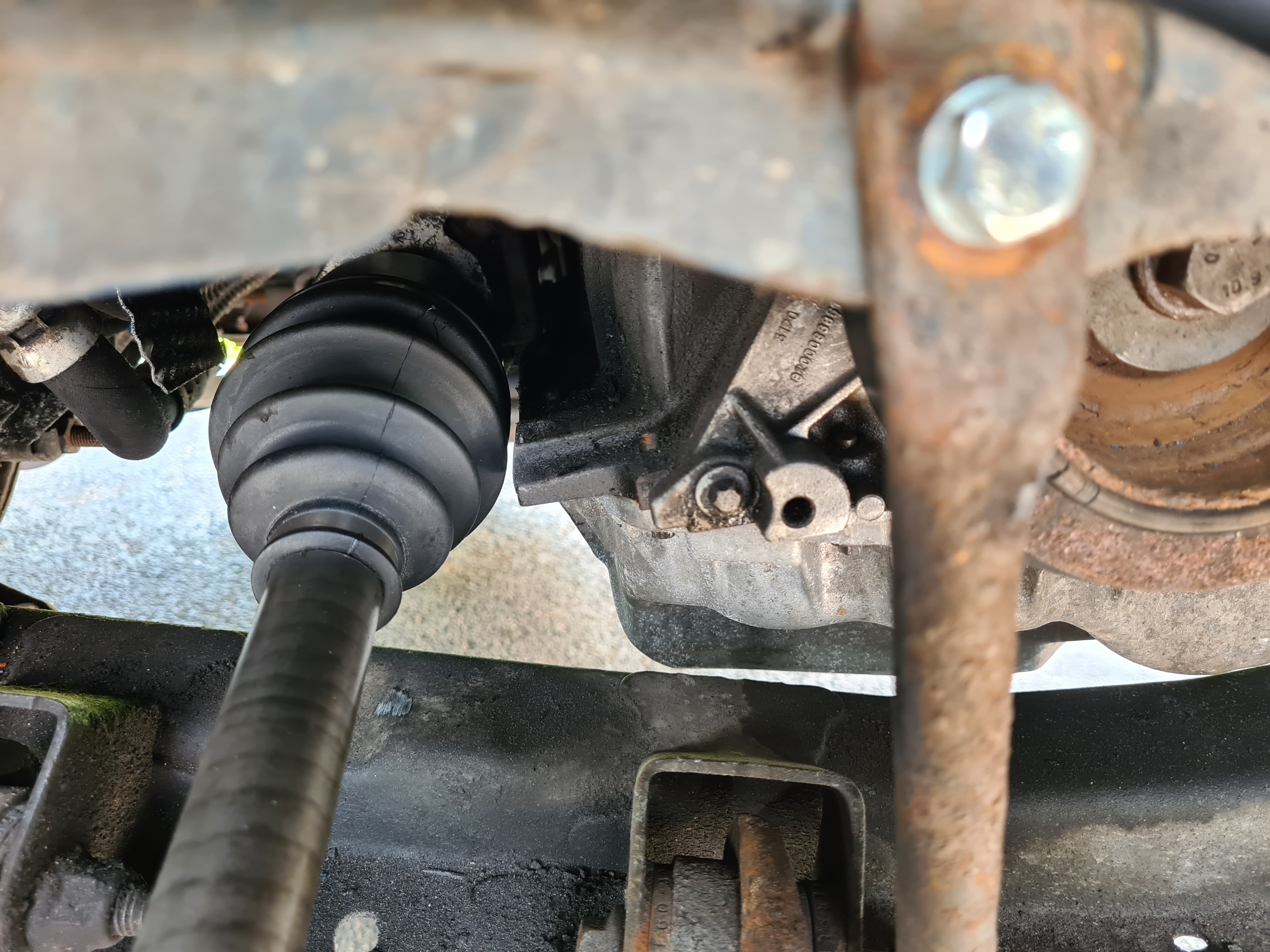

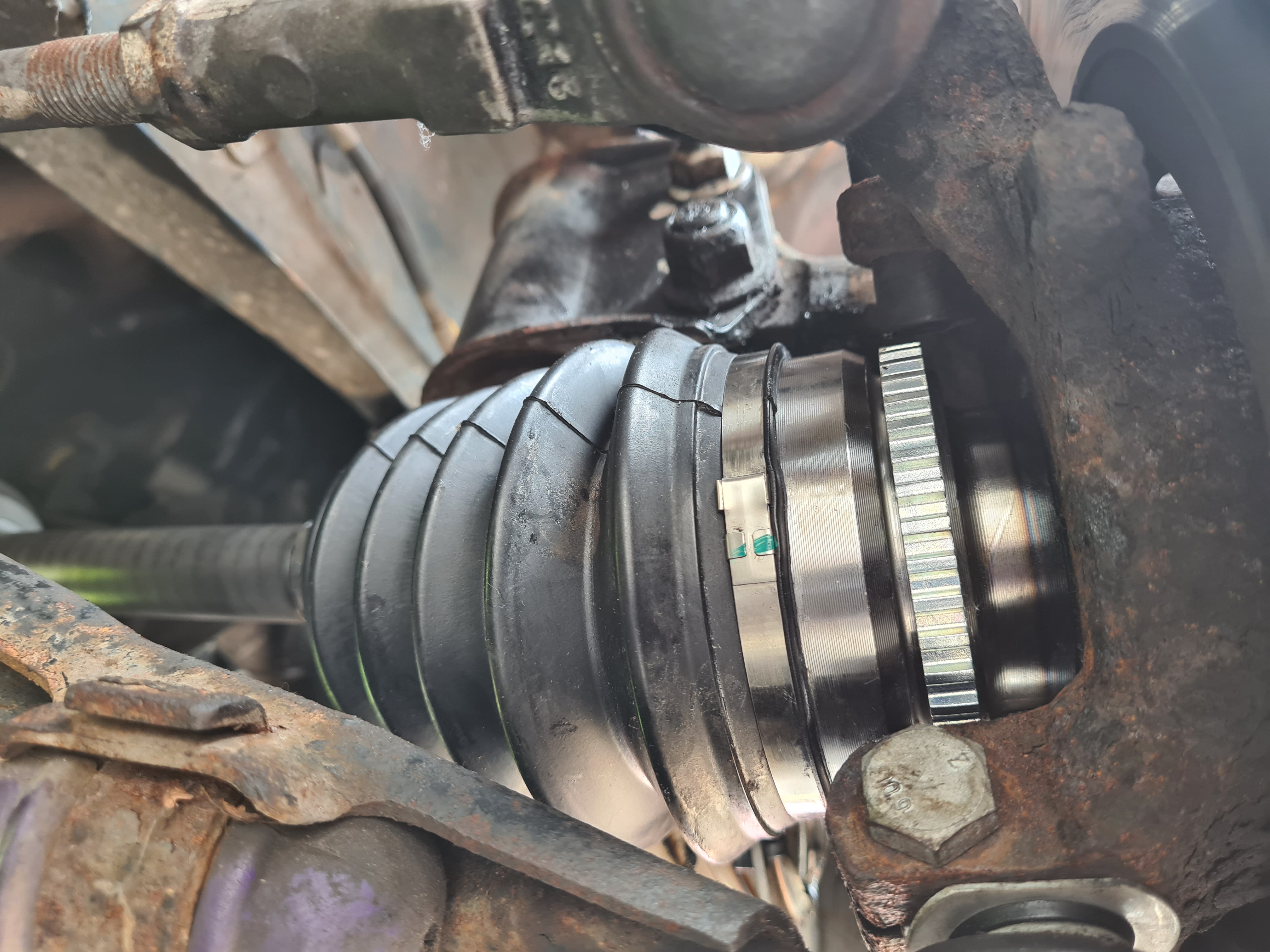

Replaced the driver side driveshaft after the brand new cv boot had split within 60 miles, slinging cv grease EVERYWHERE.
Except for cleaning the grease off the it wasn't a bad job as it had been out the week before when the cv boot was replaced. Hour and a half or so.
It's a Borg and Beck unit and seems to be decent quality. Only thing is the abs ring which is 8mm instead of 15mm. Haven't driven it yet, but if it gives problems I'll get a 15mm abs ring ordered.

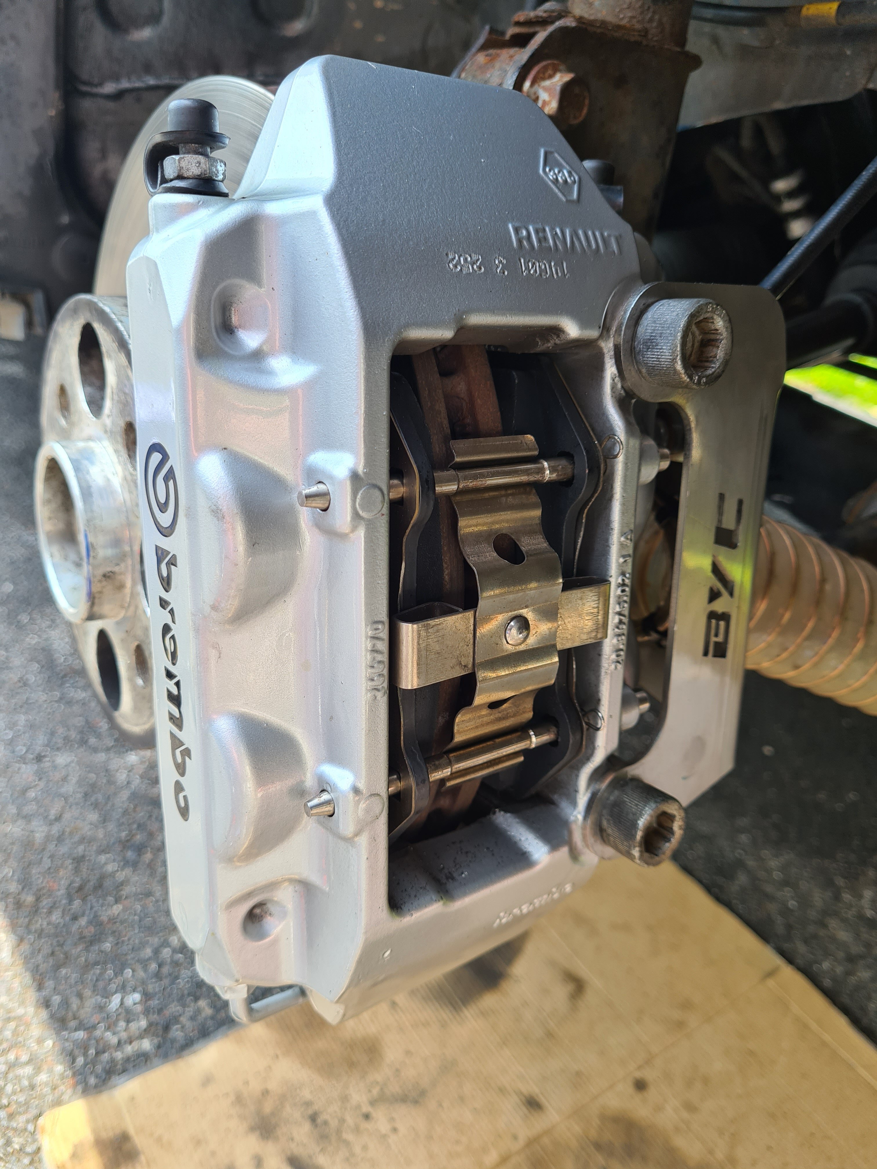

Calipers still clean up well after their refurb 👍

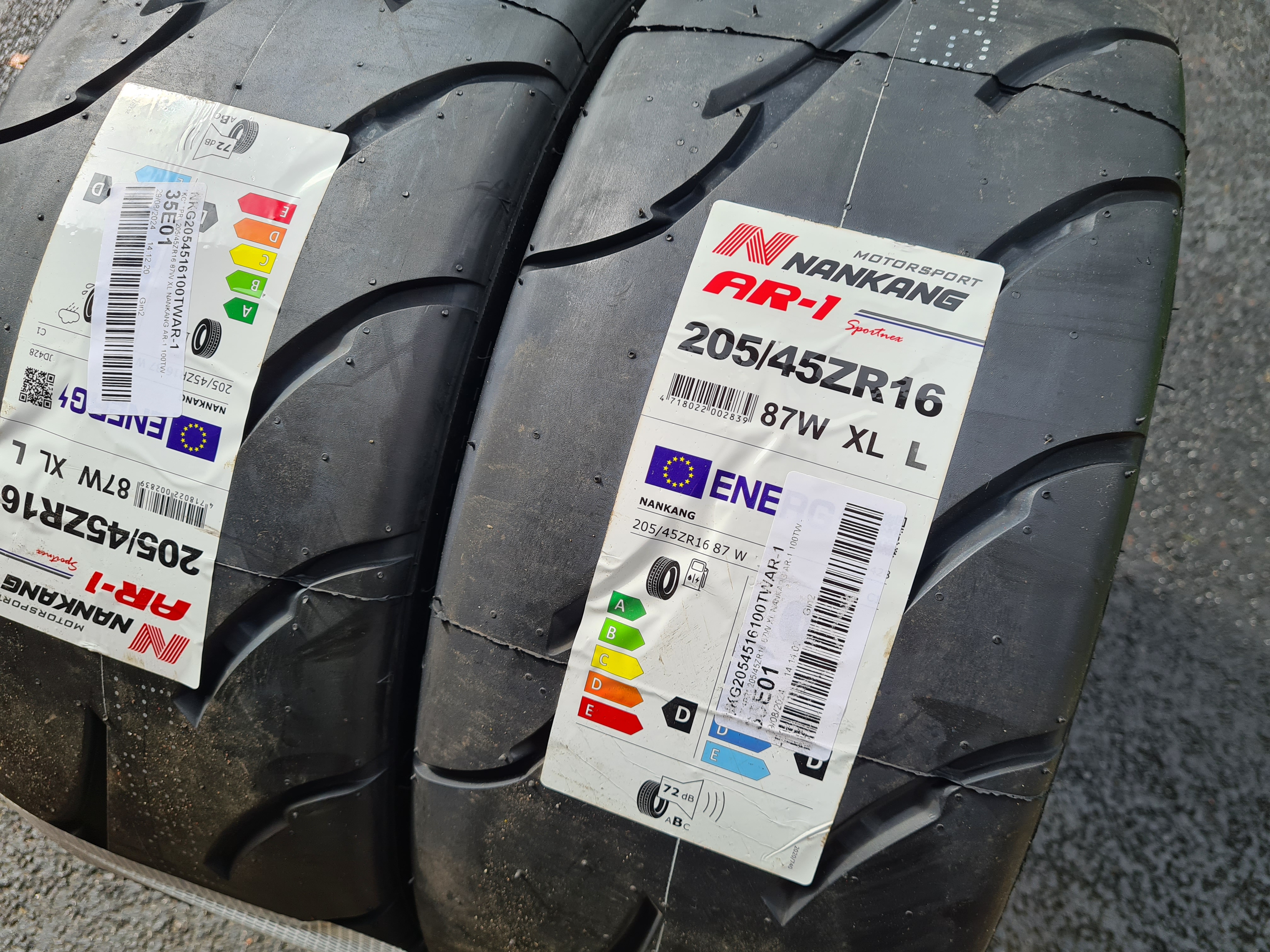

Zestino Gredge tyres worked well by sticking to 10 minute stints, total of 90 miles in the morning but only 40 in the afternoon when the front tyres started melting.
