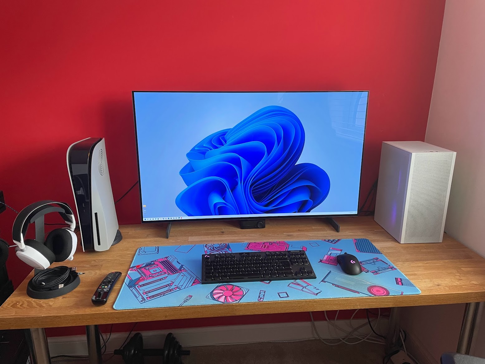

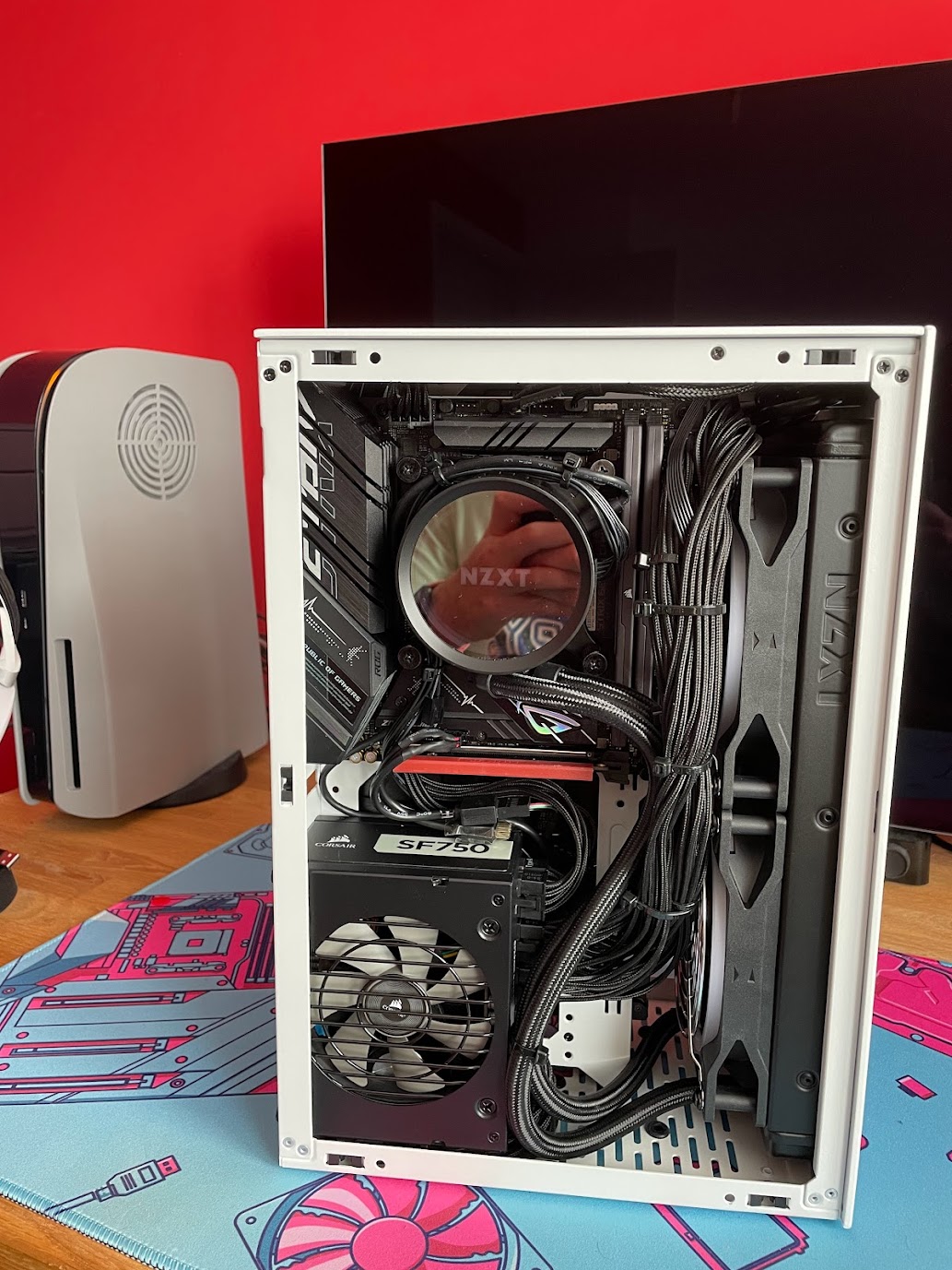

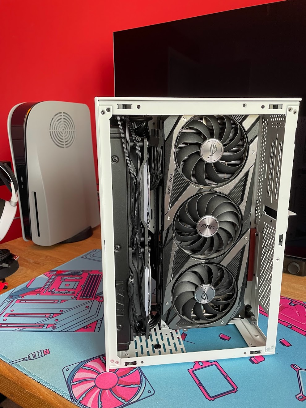

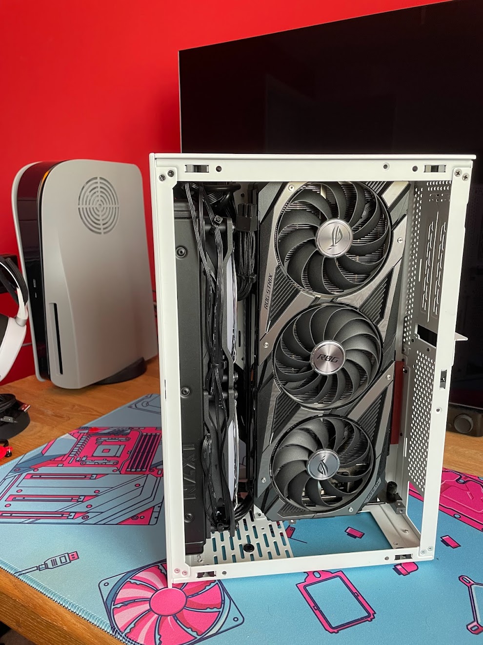

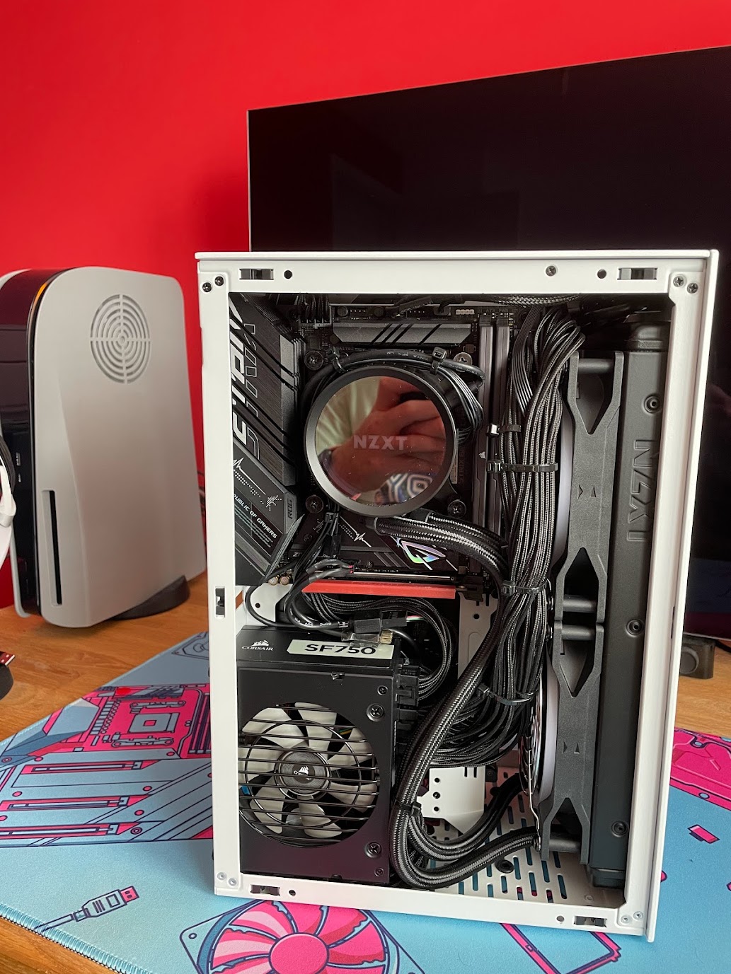

We are back in the small form factor case (SSUPD Meshlicious). Motherboard (ROG STRIX B660-I) and RAM (Corsair LPX 2x16Gb 5600 DDR5) came yesterday so stuck it all together.
Temporarily ran it with an old 700W SFX power supply with horrible cables to test it all worked together but today the new Corsair 750W SFX PSU (With much nicer more forgiving cables) arrived and I installed it and tidied it all up.
As you can imagine fitting all this (And my RTX 3090) into a 14.7 litre case was difficult but I think I made a very good effort:

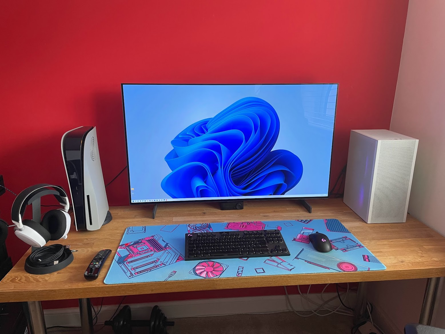

And the setup pic:

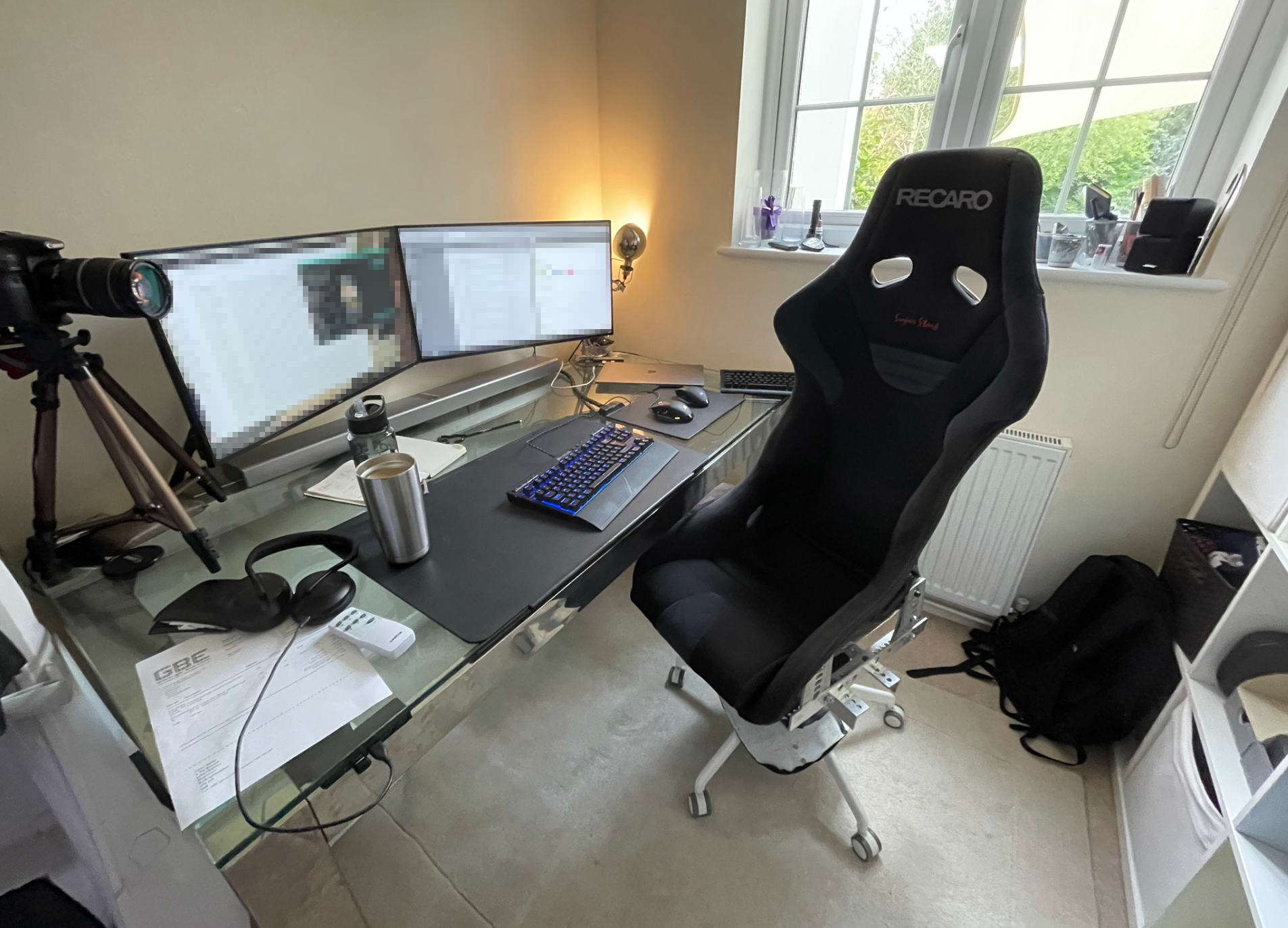

I had some spare OMP reclining seats. They were super comfy going to the ring and driving around Europe so made a perfect gaming chair.
Would be interested to see how the Secretlab stuff compares tbh, given the hype.
I did this with a spare Recaro RS-G (fixed shell) I had, felt really comfy but gave me quite the sciatica in the end. 😂 Looked mint though...

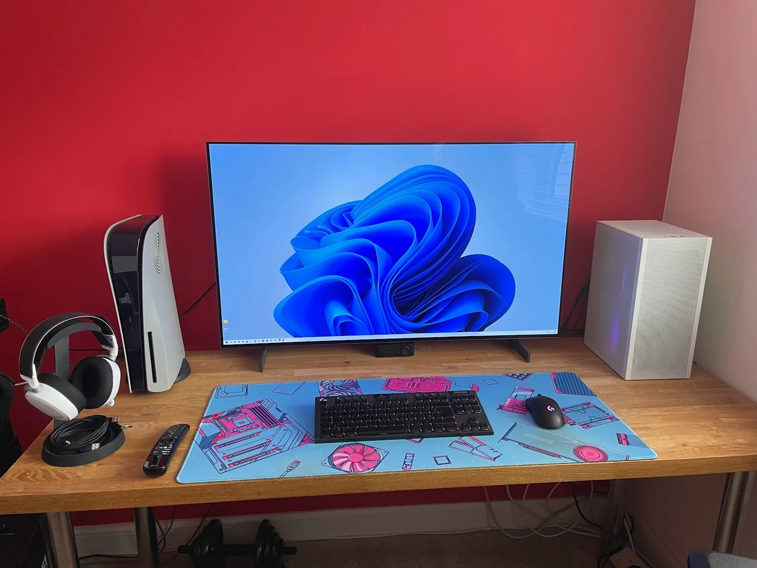

And the setup pic:
How are the temps in that!?
ChrisR
Always loved small form factor.
Had a little Shuttle many years ago, and my current nCase M1 is awesome (only 12.something litres!).

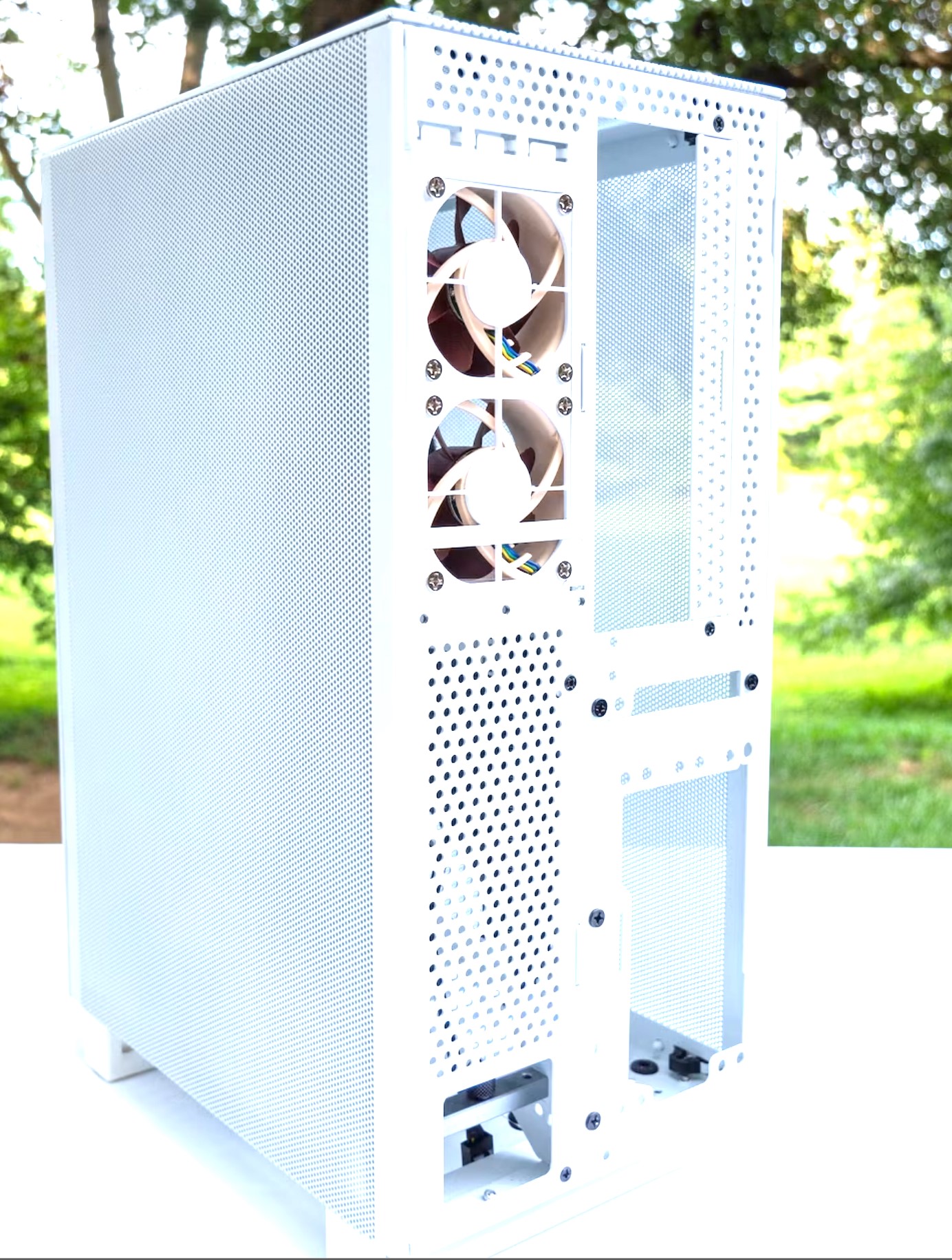

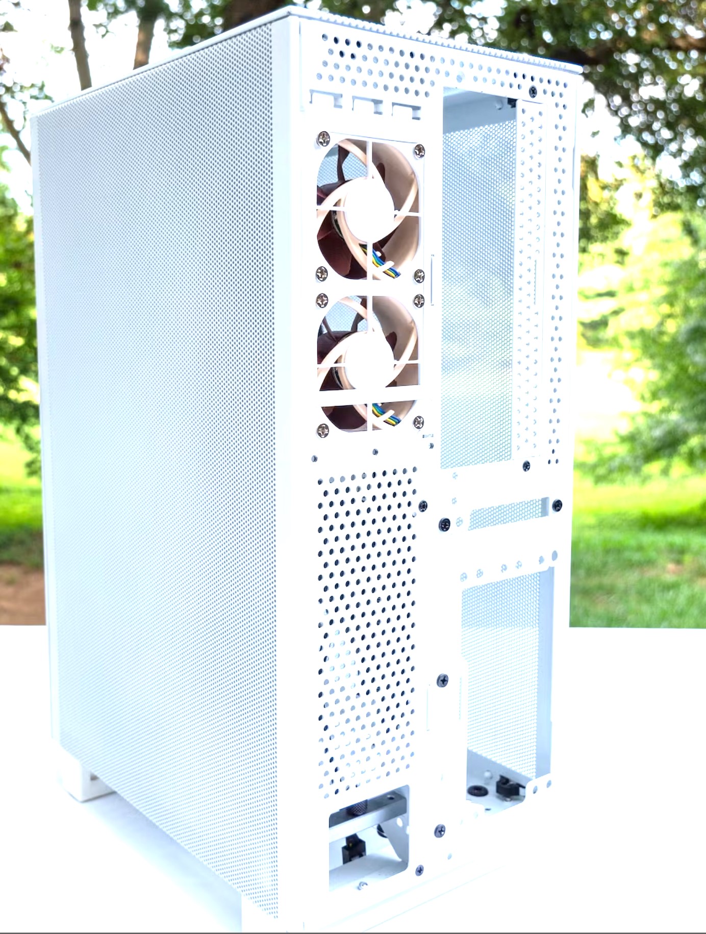

Definitely warmer than they were in the mid-tower (P600A). GPU tops out now at 72 degrees and CPU 69ish. I have ordered a wee kit that'll allow me to mount 2 of the wee 60mm fans to the rear to help exhaust the hot air from the GPU.
Daz...
  Inferno 182 Cup
Have you tried undervolting the GPU @N0ddie ?
The temps on mine dropped by 7-8°C whilst still applying an overclock to it.
Wilkeh
  MK4 Anni & MK5 Edt30
Definitely warmer than they were in the mid-tower (P600A). GPU tops out now at 72 degrees and CPU 69ish. I have ordered a wee kit that'll allow me to mount 2 of the wee 60mm fans to the rear to help exhaust the hot air from the GPU.View attachment 1611214
Blimey mate 72 and 69 isn't bad at all for a tower that size!

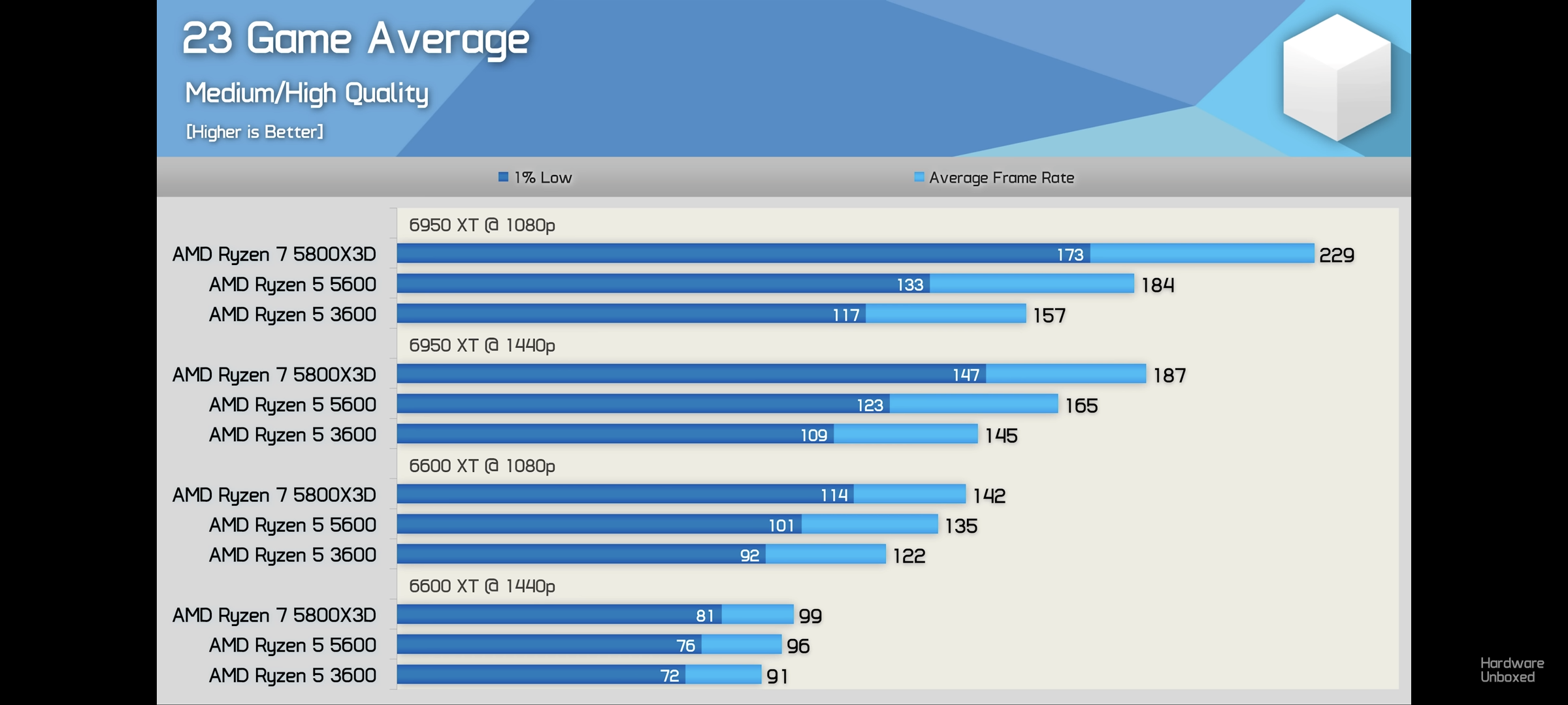

I have a 5800x but I think the 3dx(?) would be the one to to for as the benchmarks I seem to remember having much more stable framerates and higher 1% lows even though the average wasn’t much higher
Double the price though mate, a 3DX is like £450+ :cry:

Might be worth getting the GPU first and wait for the X3D or similar to come down in price.
AM4 socket has been replaced, so you'd expect the previous generation stuff to slip down in price slowly.

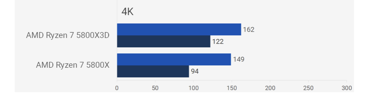

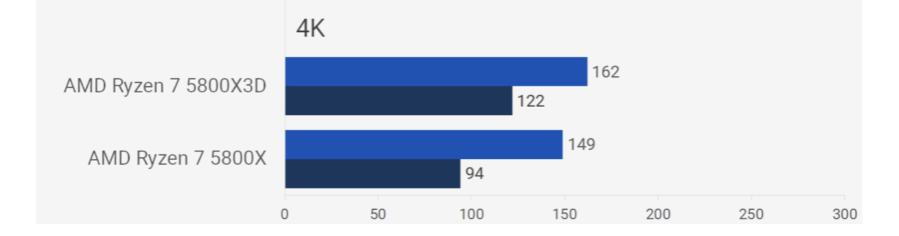

Depends what you’re playing 😂
e.g. Assetto Corsa Competizione
Only 12fps gain on average but 28fps better 1%low will be a much smoother experienece.
That's not at the highest graphics settings though, only on medium, and it's an extreme example. Most modern titles see zero gain at higher resolutions as they're GPU bound and utilise multiple cores a lot more.
If money is no object or for eSports then fair enough. But at this stage it's best to wait for further developments of it with AM5.
A better GPU makes more difference.

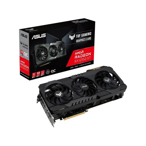

New?
Good price, cheapest I can find is this one.
Yeah I believe it's new

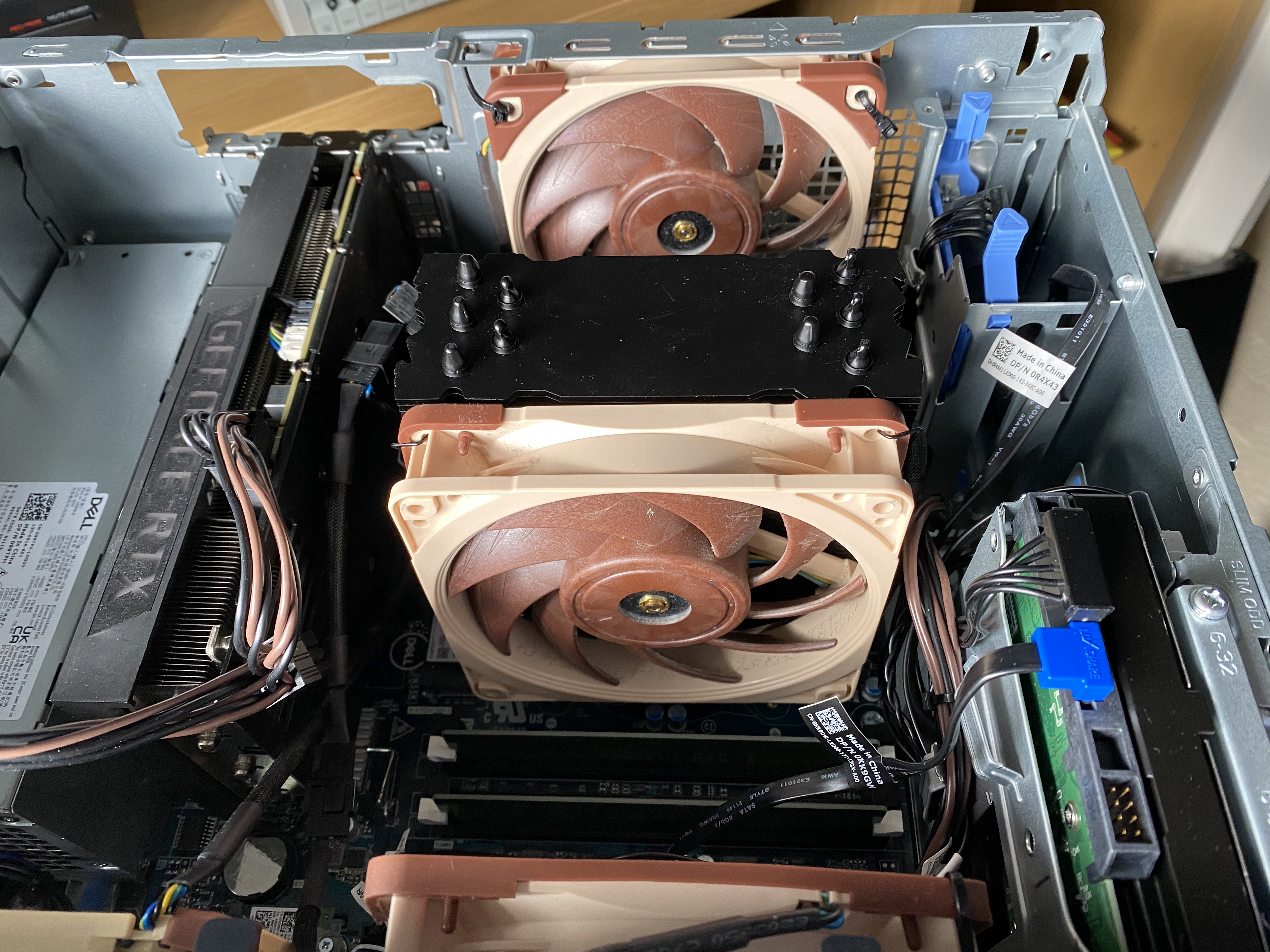

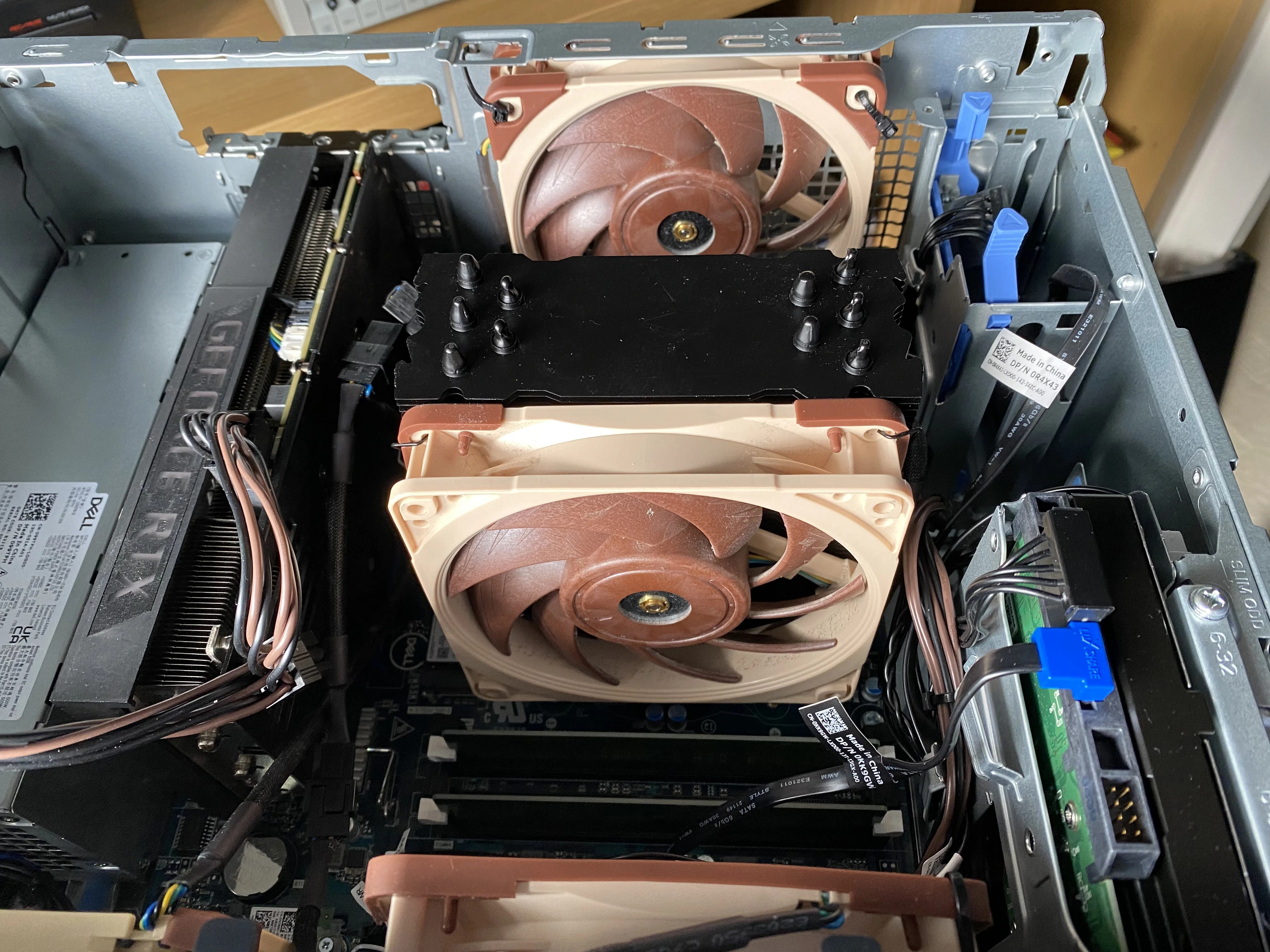

Not really a “power” PC, but I had a little play with my XPS which I bought during lockdown/graphics card hell as a cheap way to get a 3060ti.
The cooling was an absolute joke. Single 80mm exhaust fan, hard drive blocking most of the airflow from the front of the case even though there was a free bay at the top of the case which wouldn’t cover the vent grills.
Moved the HDD and bracket, put as many Noctua fans as would fit in the case, added a VRM heatsink and swapped out the stock intel cooler for a tower cooler.
GPU temps unchanged, but fans max out at 70% not 100% which is a massive difference in noise. CPU temps down 20C (!!!) and the PC runs so much quieter.
The hard drive at the right was where the fan at the bottom of the pic is, completely blocking any airflow. Genius.
Oh, and the memory wasn’t running at it’s maximum rated speed either. FFS dell!

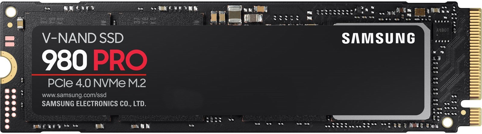

You wanna get yourself off that HDD and onto an M.2 NVME SSD. They've come down massively in price recently and make such a difference over running off a HDD.
charltjr
I've got an M.2 boot drive, the HDD is just for my Steam folder. I don't play enough games where loading time is a factor for it to bother me.

Samsung have a cashback offer at the moment, means you can get a 2TB NVME drive for £150 (£230 usually but £80 cashback).

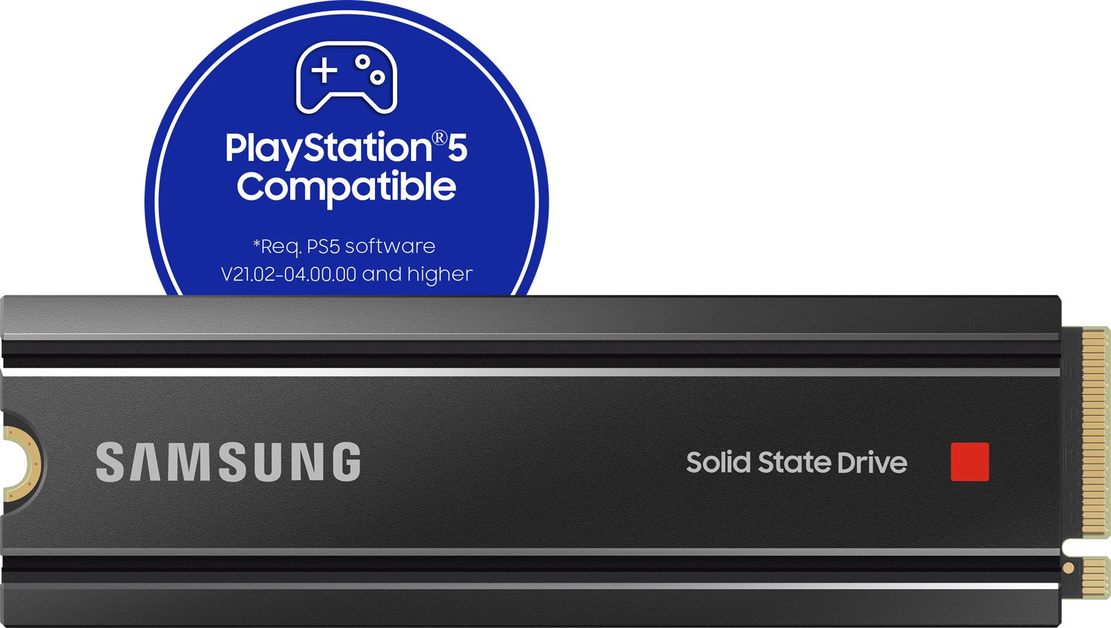

Where can I find this offer? My son needs more storage on his PS5.
But I think you want the heatsink model for PS5, which isn't on the cashback offer afaik
