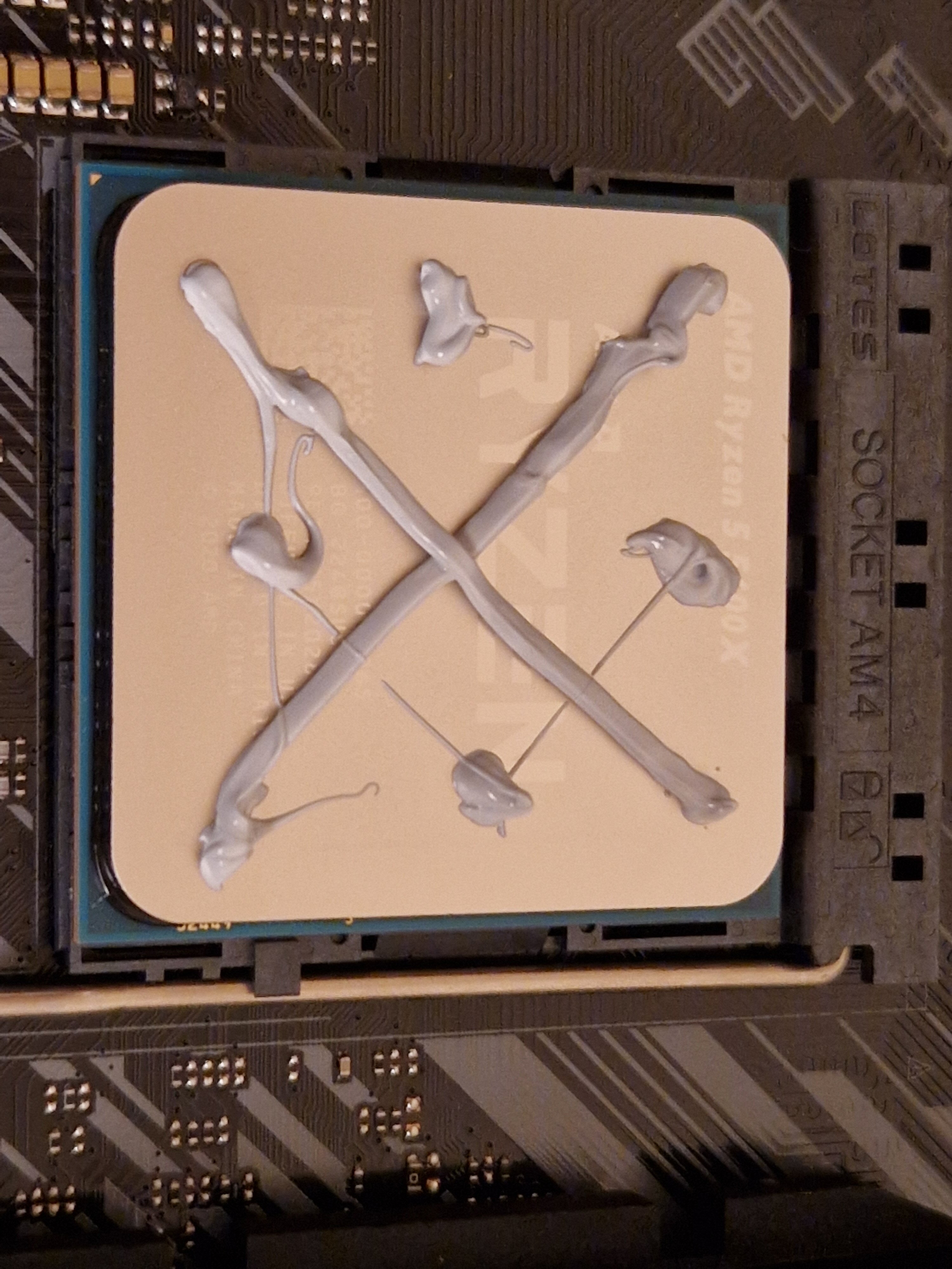

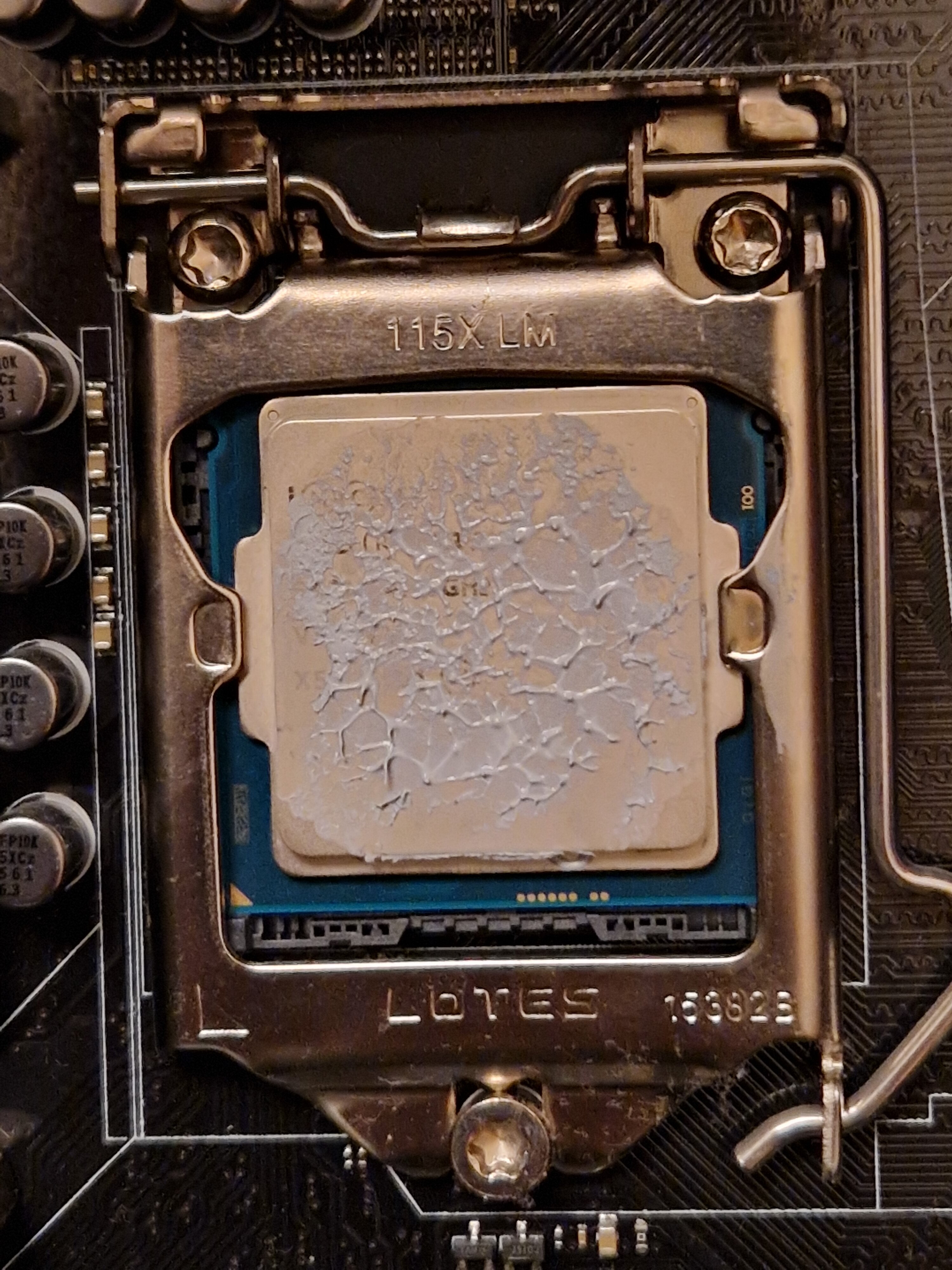

Better than not making full contact, not that it really matters. This was my 4790k which ran at 4.8Ghz for years and temps never went above the low 70s. May have had something to do with the fact I de-lidded it though 🤔

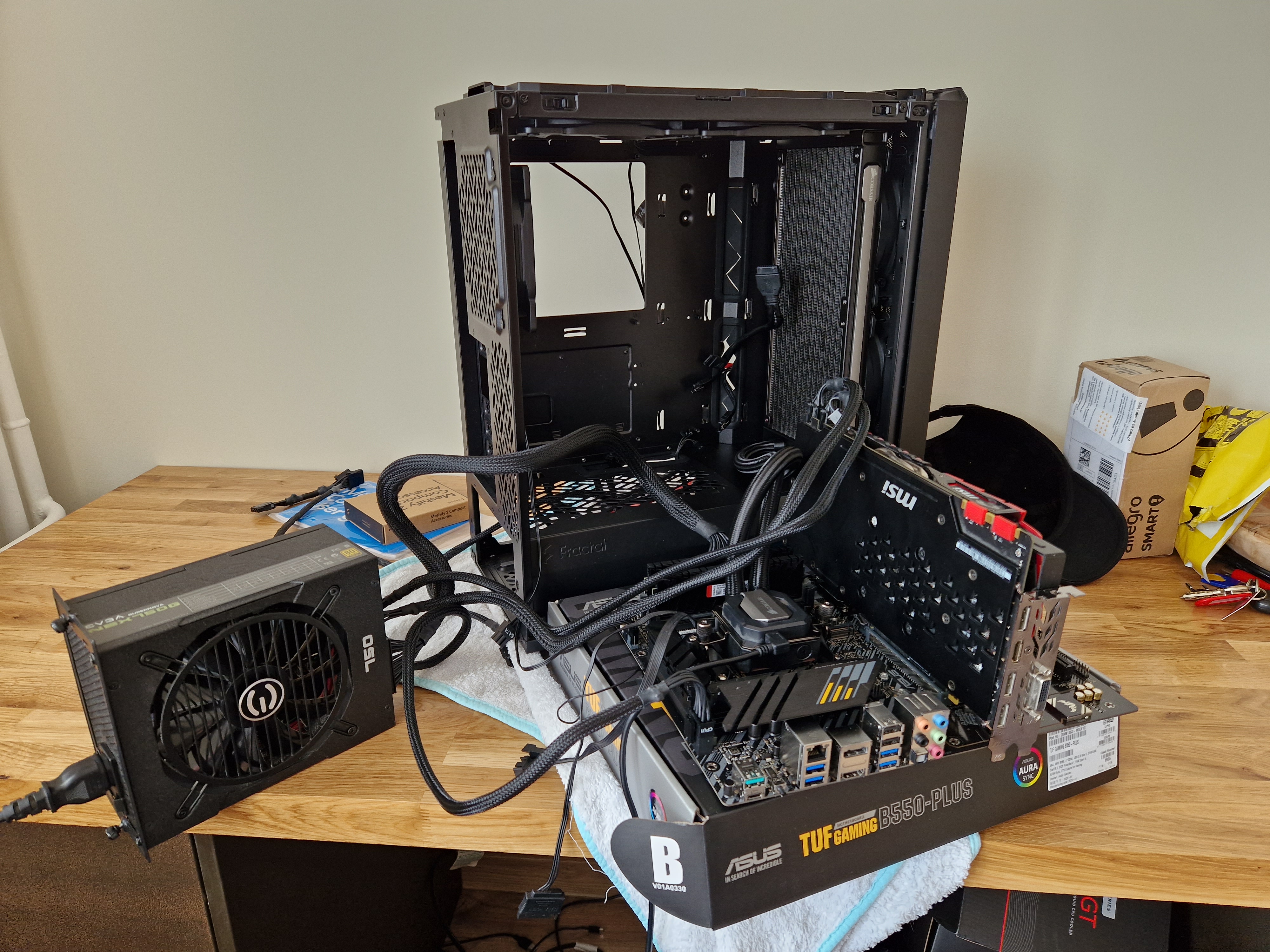

What’s up with it?

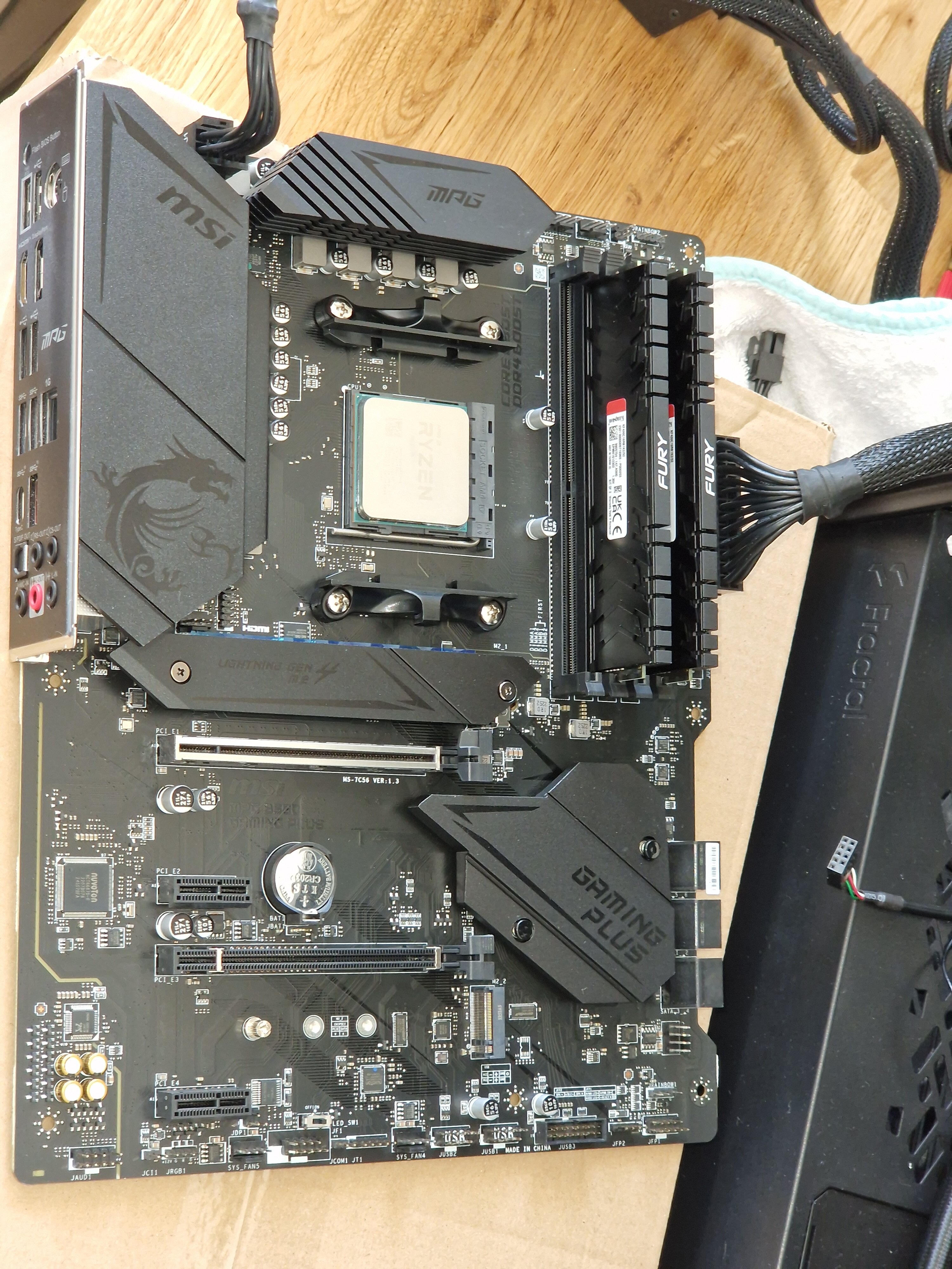

Won't power on. Board is getting power because the RGB lights up when I turn the power supply on, but nothing happens when I short the power pins.
I originally thought it might be the power button on the case, but it still didn't respond when I unplugged the button and used a screwdriver to short the pins.
I've tried reseating the RAM, I've tried only using a single DIMM, both of them separately, I've reseated the CPU, I checked for damaged pins, I've tried booting with no GPU, I've tried booting with no RAM.
Something's clearly fucked, but I don't know what 😞

I've tested the PSU in my old system and it boots up first try, so I'm pretty sure that narrows it down to motherboard or CPU. No idea how to diagnose which it is without having spares 🤔

Sounds like you’re going to have to get them returned. Odds are in favour of it being the motherboard tbf.

You didn't end up squidging the thermal paste to somewhere it's not supposed to be did you?
Lol no, it's non-conductive anyway so wouldn't be an issue. Believe it or not there was barely any squeezed out the sides, despite my best efforts 😂

Does the motherboard support the little beepy speaker?
Aren't they supposed to give a set number of beeps that tells you the CPU is fucked?
Yeah but I don't have a little beepy speaker. There's lights on the mobo for CPU, RAM, GPU and something else though, and none of them were lit up or flashing.
