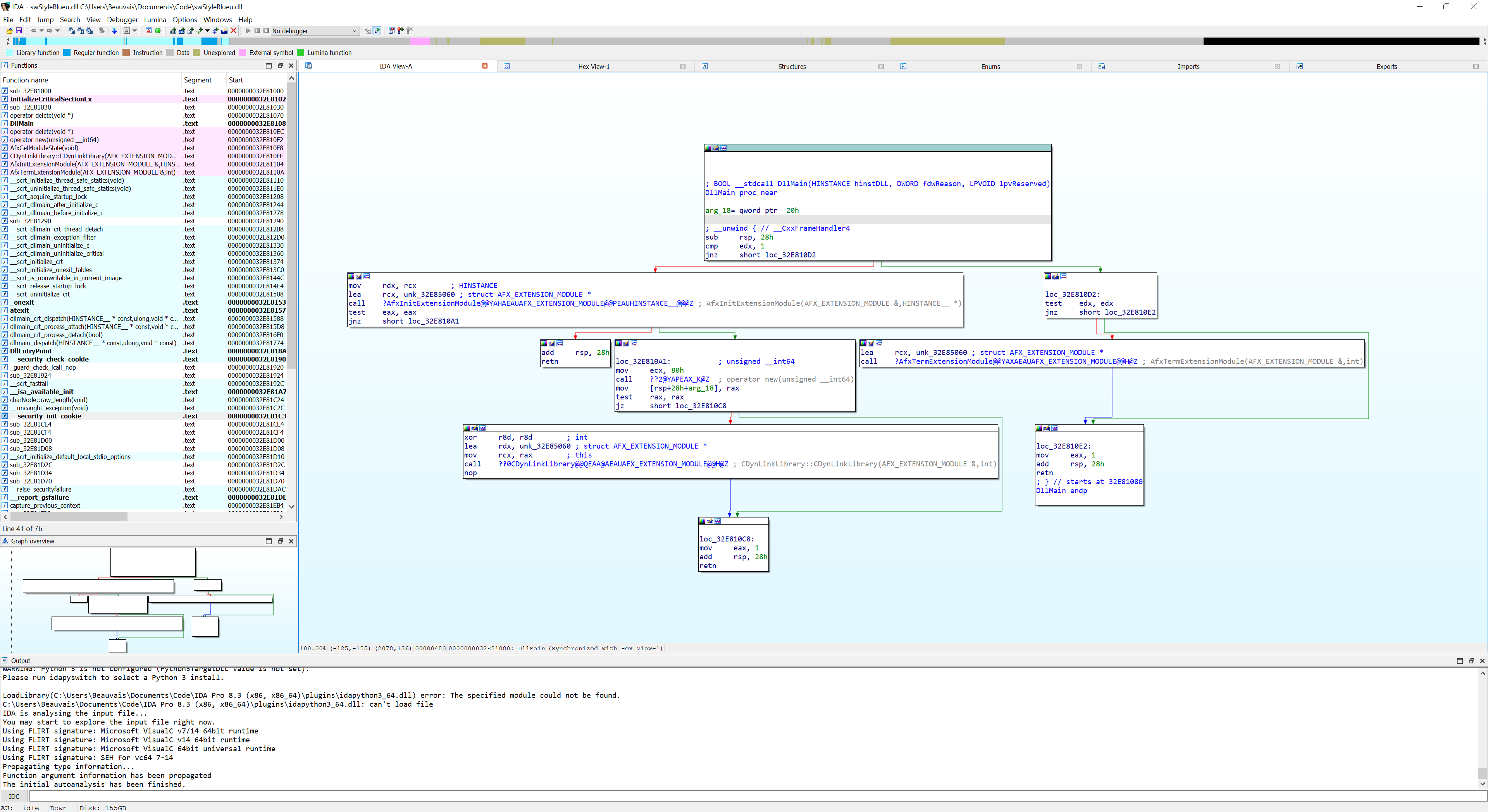

I'm not 100% sure what the developer(s) meant with that comment, but it suggests that introducing new enumerated values (perhaps to represent new /additional colours) means that they also need to be replicated in multiple locations (i.e. the files you mention). For enums, this seems like a bad design decision as you generally want to specify them once in a well-defined source location.
It seems that a mixture of managed and unmanaged code is being used here. As you mentioned, .NET Framework 4.8 is being used in part along with unmanaged code, which looks a lot like C++ to me. The colour/styling themes in the unmanaged assembly look a lot like the resources that get spat out when writing a C++ application using the MFC library. This makes sense as, in my previous post, I mentioned that I believed Solidworks was written originally in MFC.
I would imagine that the managed code (.NET Framework) is marshalling data to/from the unmanaged assembly's resource section to style and present the user interface. And I'm assuming that that is what you are trying to figure out to create new styling (or edit existing styling)? It can be tricky decompiling a DLL and the process is not necessarily straightforward. DLLs may be wholly encrypted, partially encrypted, obfuscated... and they may not.
However, even if we assume that a DLL can be successfully decompiled, other problems would need to be overcome. In this case, being able to replicate those enumerated values in other files. Just having those files available and being able to change them doesn't mean they will magically work. You would need the entire code base in which those files reside. You would need to make the changes to the files (adding the enums), and then rebuild the entire code base.
On the subject of the enums, do you have any examples of what they are or might be? In C# and C++, enums are designed to represent discrete sets of named constants, typically using integer values. As such, they cannot directly store complex data types like an RGB triplet.
As above, it looks/feels/smells a lot like legacy Win32/MFC given the assembly structure and the naming conventions used in the resource section.
Thank you for the guidance, has pointed me in the right directions quickly!

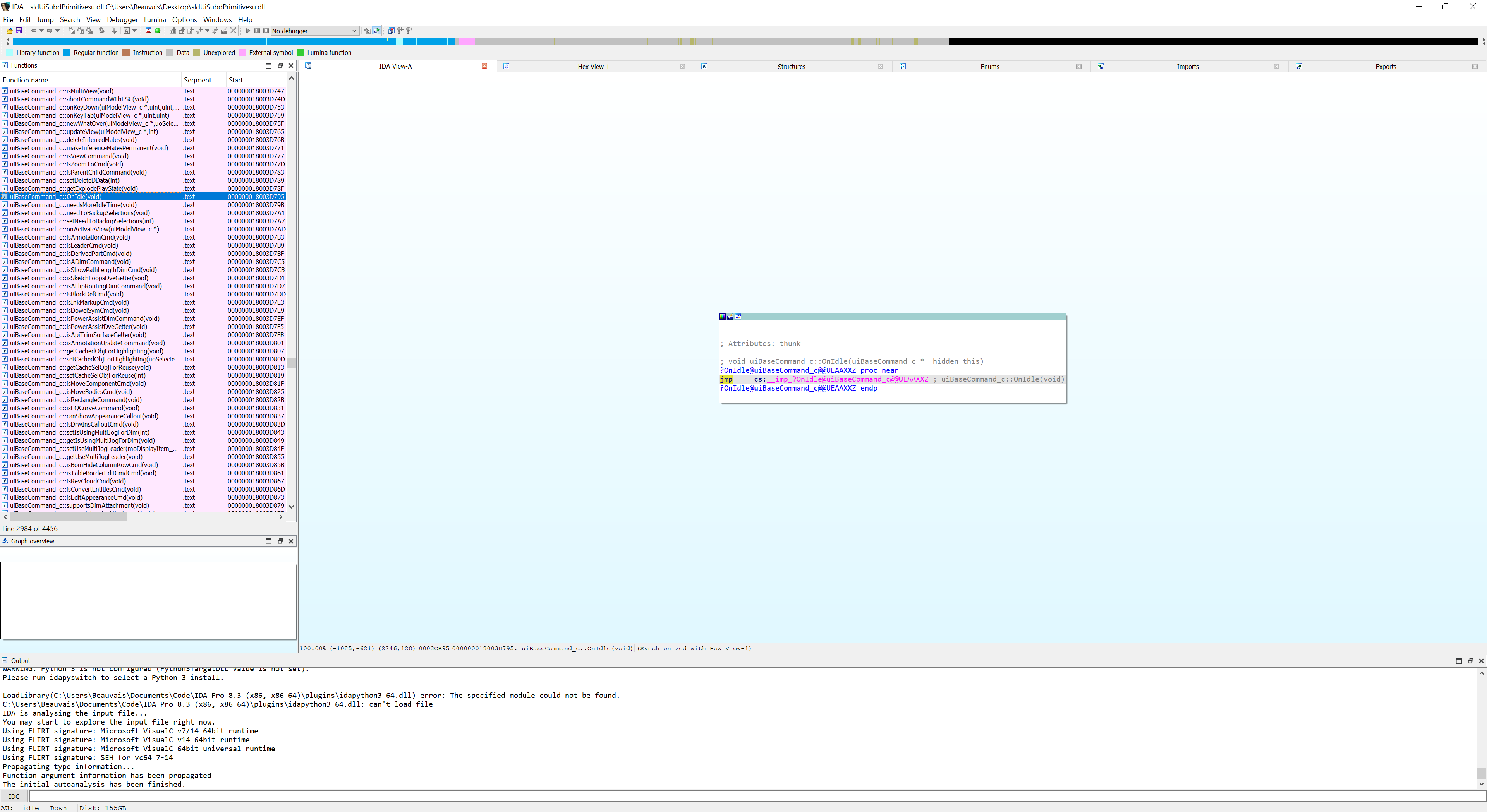

In that txt for the theme rgb colours, there are random notes made by someone like "JCW - WE WANT A HORIZONTAL SEPARATOR, BUT NOT VERTICAL SO CODE NEEDS TO CHANGE", have included the file if you're curious.

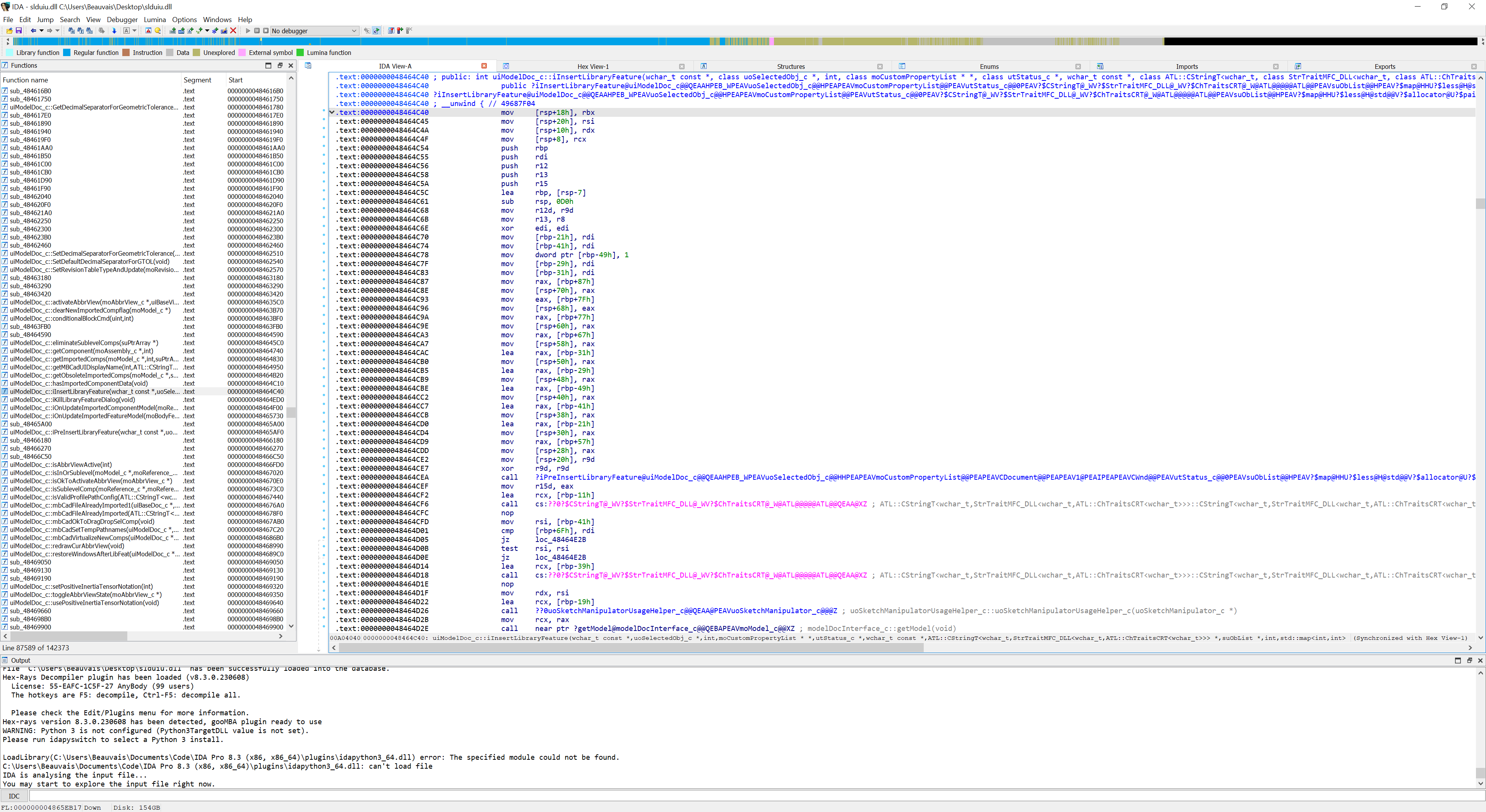

The unmanaged file contains nearly all of the icons/buttons/logos png's in different resolutions, using resource hacker I can replace them with a different colour or image, top left logo used to be red. This info may not help at all..
The directory that they point to in the txt file starts with am, I just had a play in IDA and opened a different dll which came up with this, implying 'am' is a folder in c drive. It couldn't find it but went through anyway and came up with this.
This is a another dll for ref.
The main dll that contains the theme txt files.

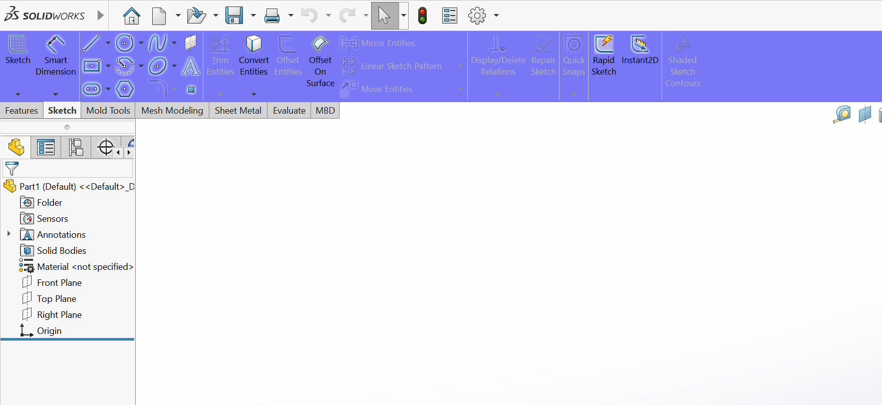

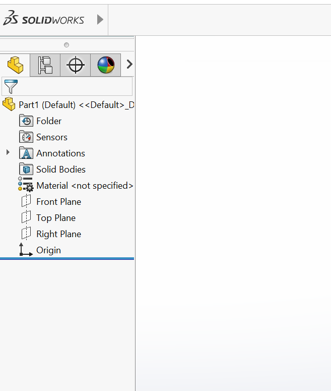

As far as what Id like to change/modify about the ui, its probably the equivalent of learning to swim by jumping off a cruise ship in the middle of the pacific now seeing how IDA decompiles the dll files.
The first image I shown with the feature manager to the left has a solid colour background, 247, 247, 247 in the txt file which I confirmed is right. Id like it to be transparent. Now the possibly good news is there is a transparent feature tree in sw but it doesn't stay shown once you've created a sketch or feature, so you have to press c twice to open it again, also you have to L click a feature before you can r click to list options to change, something small but as far as work flow goes it slows you down. I guess changing how the transparent tree functions could be no easier as you still have to find the file that contains the code and edit/ compile.
Said tree, it also hides half of the text until you hover over it. So 3 changes that I would want to make.
Edit: I just opened a large file and with the transparent tree open it runs so slow lol. At least theres merit in trying to learn, right..? :LOL:

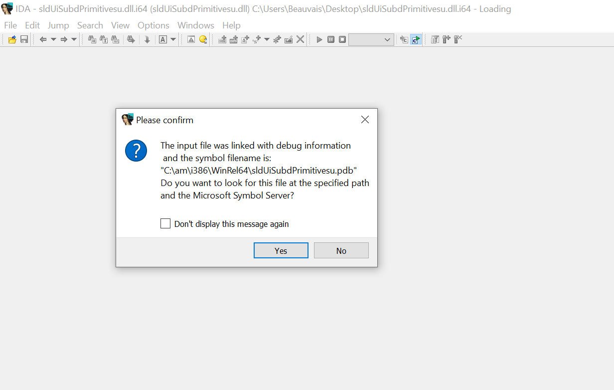

Which happens to be the case.. When it brought up the message about microsoft symbol server in IDA I didnt know what that meant, had a quick search and realised its something at the companies end. Changed some of the values randomly in the txt file and it works. Well at least I know you can completely customize the ui colour scheme in solidworks if all else. If from my reading is correct IDA decompiles C++ into C ish? So in some dlls its mostly impossible to know what the code is for. More to read and learn about I guess!
The DLL file decomp images don't really show anything that will be useful I'm afraid, unless you are interested in a breakdown of the assembly language instructions of the code segments contained within the DLL. I can see in one of them the code that handles how DLLs are attached to, detached from, loaded and unloaded, which is a mechanism implemented by DLL developers so that each of those stages of DLL life-cycle management can be hooked into. However, this probably doesn't help you much!
With all due respect, what you are attempting to do is far, FAR more complex than you may realise. In fact, it's also impossible unless you have access to the complete SolidWorks source code and the required build tools and supporting libraries. You cannot change or alter features within the software just by hacking a DLL. You've probably got about as far as you can go in terms of being able to hack the colour values for the UI and change the likes of logos and images that you already have access to in that DLL. Being able to change the transparency and functionality of the tree/menu within the app requires the full source code for the application. Sadly, I don't think Solidworks will give you that no matter how nicely you ask!
@Touring_Rob
The decompiler doesn't convert from one language into another. It will know which compiler was used to generate the code from some sort of signature, and it attempts to break down the code segment into the various named functions and modules so as to appear as close to the original source as possible (this is a gross simplification of the process). Sometimes that is not possible and it may just show the assembly language instructions (as seen in the above DLL images). It's difficult to explain as it really is a complex area and would take a lot of time to write down. It would also likely make very little sense unless you have an extensive software engineering background and knowledge of compiler theory and practice, how software works at the very lowest level, and so forth.
With all due respect, you cannot really go any further than what you have already found (i.e. perhaps changing existing images and logos within a given DLL, or changing the RGB colour values in order to alter an existing colour theme/style. Decompilation is an incredibly complicated and complex skill that requires an intimate knowledge of software platforms, the technologies being leveraged, etc. On top of that, there is a huge gulf between being able to decompile/look at a DLL and its contents and altering it to change the functional behaviour it provides (if it is at all possible). There is also the ethical and legal side as licenses generally prohibit the hacking and reverse-engineering of proprietary technology and products! 🫣
I'm not meaning to belittle or cast doubt on your abilities by any means - it's just that what you are ultimately wanting to do is not possible.

@SharkyUK Fake transparent ;) Fortunately the txt file has all the border line colours and main background is just done in menus to blend them all together. Still they need to sort me out with the source code!!

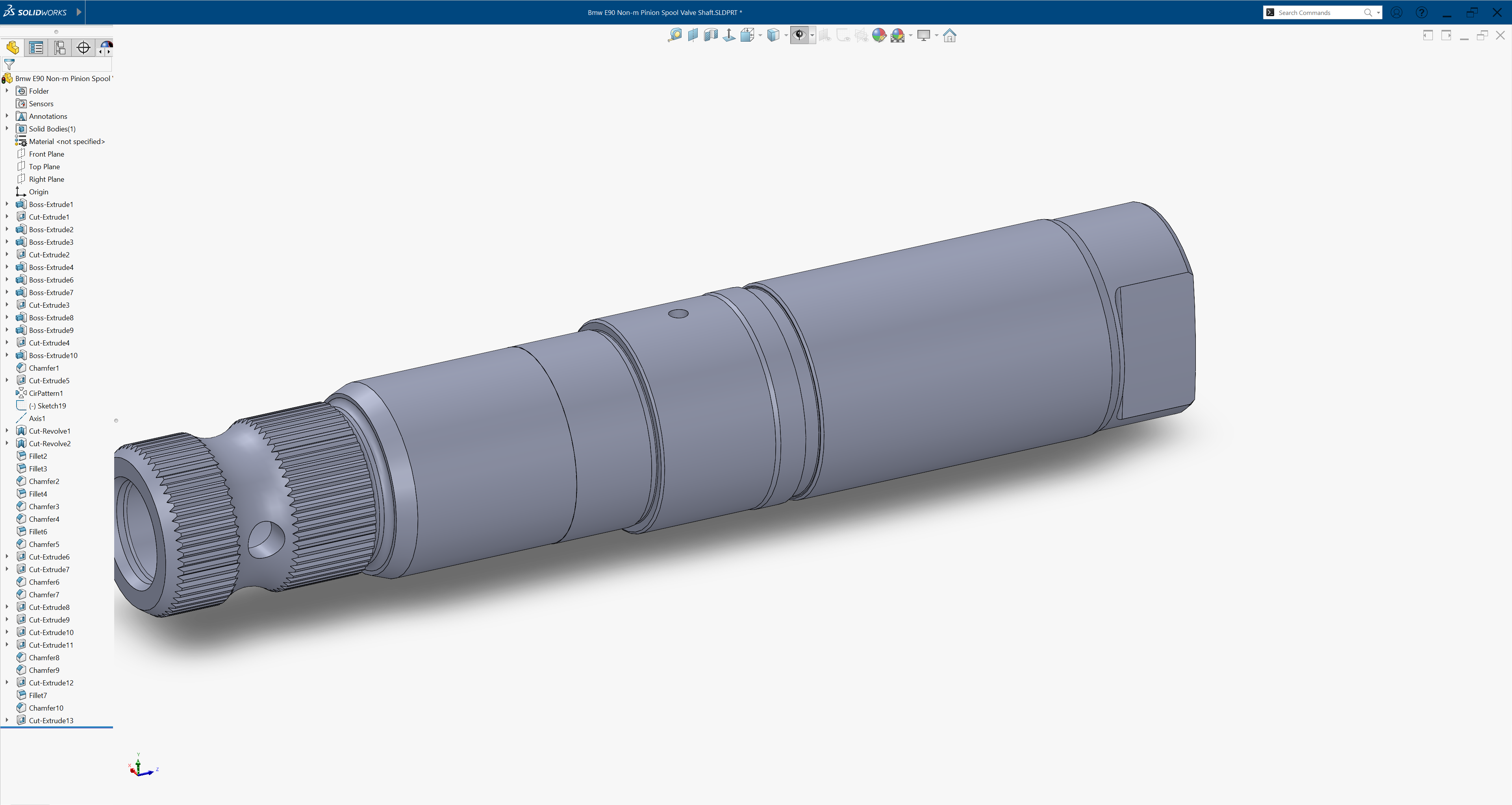

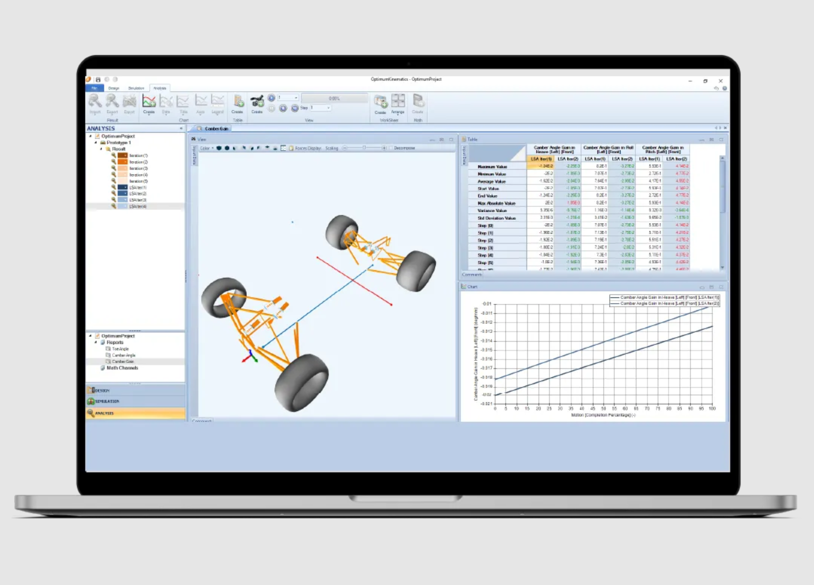

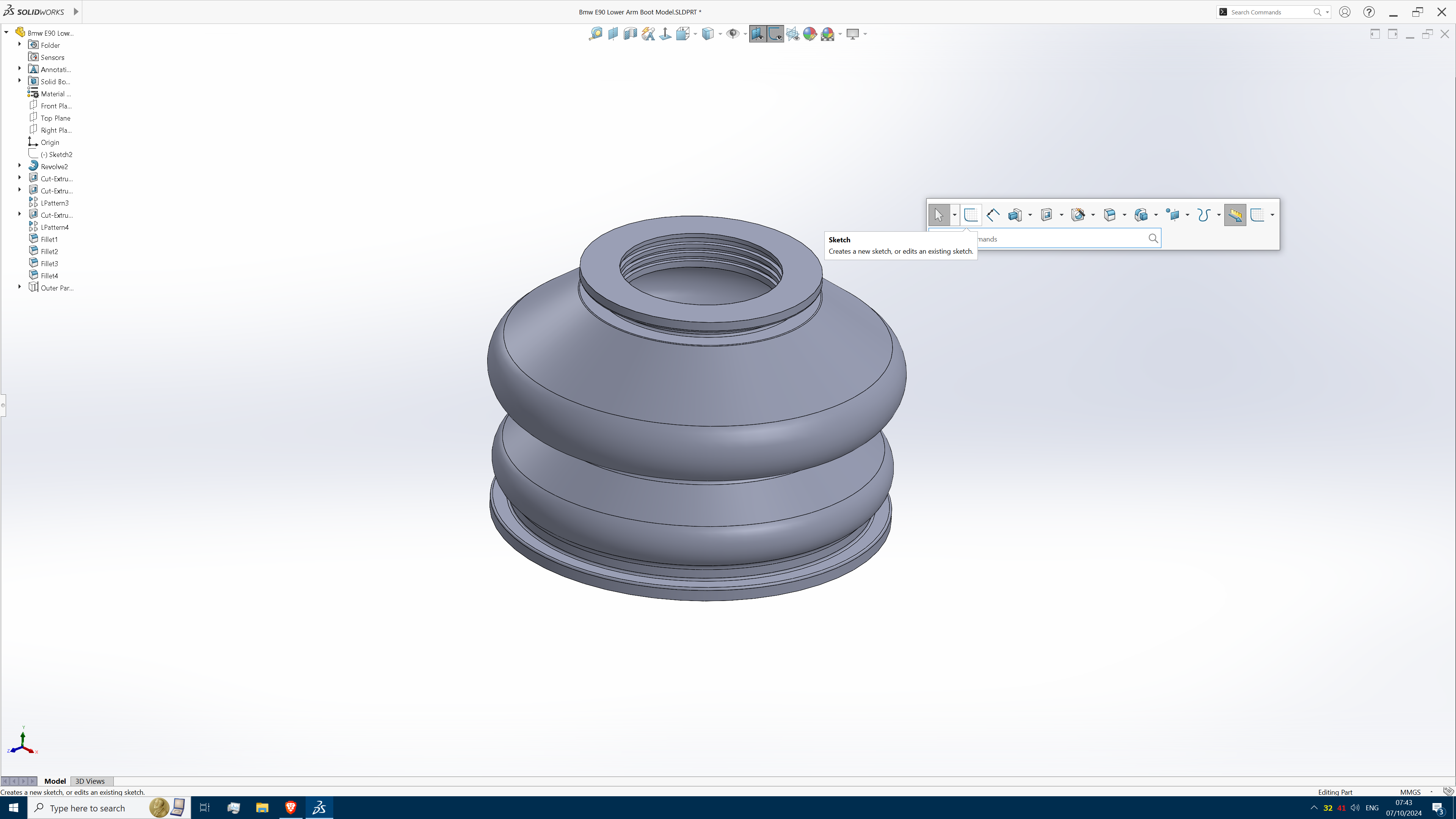

@Touring_Rob I was looking at some add in tutorial videos on youtube and they are going through the whole procedure which is nice. Although I know what I want to do will require a bit of work, a basic suspension kinematics add in, I really want to keep everything in sw and doing so you will be able to set limits in the assembly, if you alter geometry/suspension you can see how that changes the travel limits and check for clearances quickly, thats just part of it anyway.
I know there is motion and you can set the min/max travel then take the graphs plotted in time and change to travel after in photoshop or the likes (how I thought you could do it anyway) but why do all that when it could be done right from the get go?
The dedicated software's aren't exactly motivating as well. Its 2024, things dont have to look so basic anymore.

I've never designed suspension stuff in solidworks (or anything else) but I have designed a lot of mechanisms, I nearly always do them as sketches and then later once I have modelled the real parts I set limits at an assembly level and just run the auto clearance evaluation tool at each limit.
With the exception of mass related stuff (I guess unless you know it) I suspect you could excel suspension stuff out faster than blank sheet solidworks.

See it didn't take me long to be hooked on shortcuts toolbar, you hardly move the mouse and move it the same distance each time to select whatever feature/sketch thing you want. I made sure everything I use is in the bars so have no reason for command manager.
I've only assembled press fit components so far and haven't used clearance verification, good to know about it! Say you had a ball joint in a subframe assembly, how does it work to calculate the limit, or does it just calculate which components are the first to limit in the assembly?

Have a quick google for dynamic clearance. As always with Solidworks there are a number of different ways to achieve a similar thing. With dynamic clearance you can limit motion based upon clearance between parts. So as you move an assembly about it will stop moving before parts morph through other parts. I find it works ok(ish) but still prefer eyeballing it then running the clearance tool.
In your example I would just undersize the ball, but keep the shank the right size then move to each limit and run the check. You can also place a sensor which will tell you what angle your suspension arm (for example) is at.
You can also do similar within a motion study.
