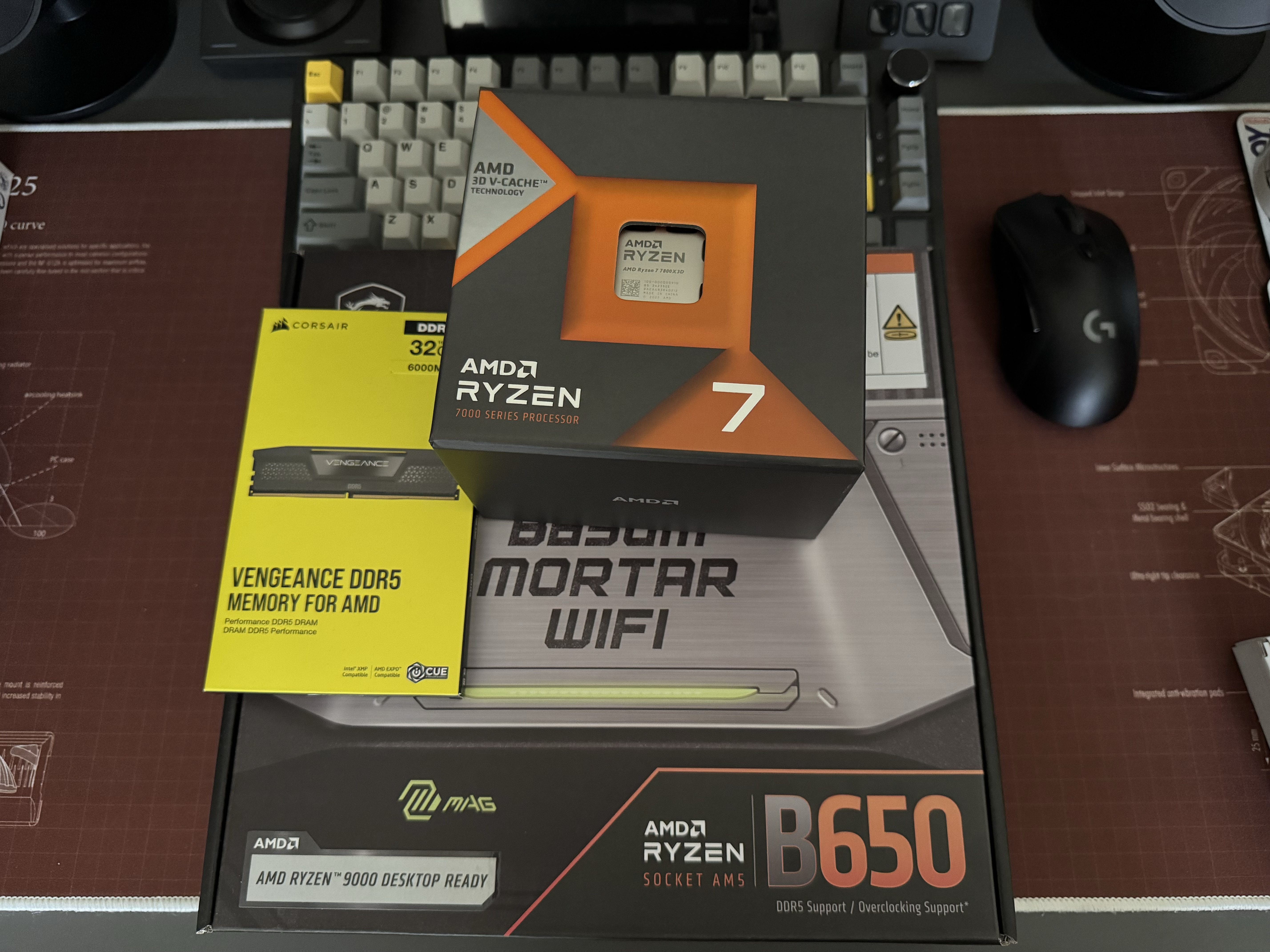

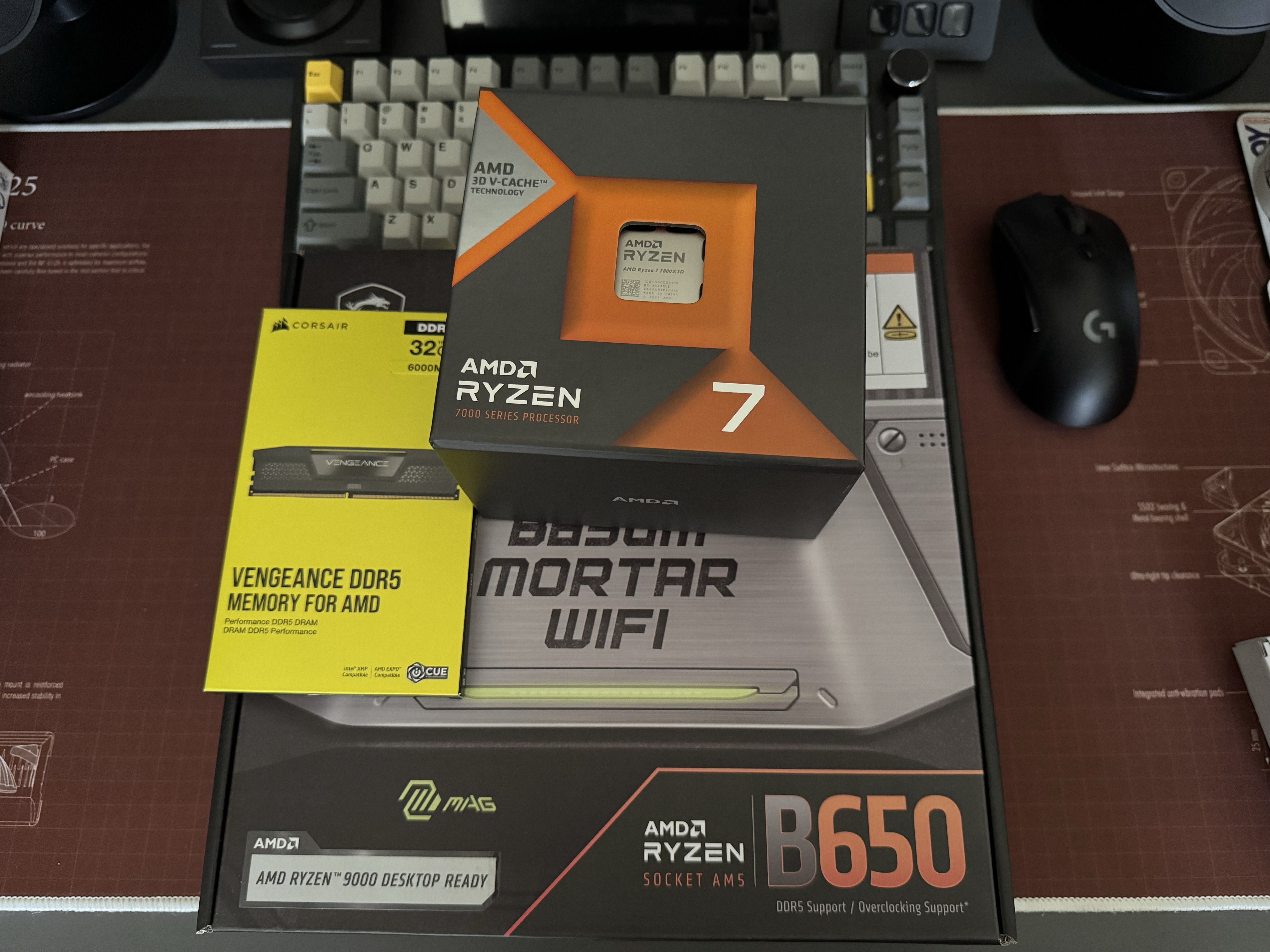

Beauvais Motorsport
New 7 7800 3dx and asrock b650i not working :( Computer turns on but nothing displays. Updated the bios via flash back which correctly went through but same thing, have tried all the take it apart and re seat and nothing.
According to asrock site, the ram i have is not on the compatible list, I need a different cas latency for the speed/size I have. Will call supplier later and go from there.
ChrisR
Beauvais Motorsport
You slotted the ram into the correct sockets? Usually it’s a2 & b2 if using two sticks.
Mini itx so only 2 slots, I tried one stick at a time and nothing. I’d done that before with the intel cpu and confirmed both ram was good.
it could be cpu, would be ironic considering I bought it because it’s more reliable than the i9!

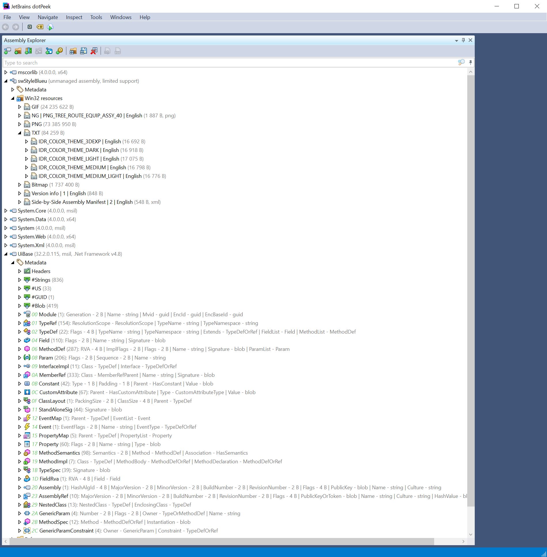

Anyone know how I can go about finding these 'files'? Web points me to scmutils, something scheme mechanics, probably not the best start to anything code related but I just want to to find out about how the user interface is made in solidworks.
// NOTE - ENUM VALUES ADDED TO THIS FILE ALSO MUST BE ADDED TO
\am\sldworks\ui\swcmgrui\swcmutils.h and swcmutils.cpp.
Thats inside a dll file I extracted as a bin a file, it has all the 'code' for the colours of the ui. Example..

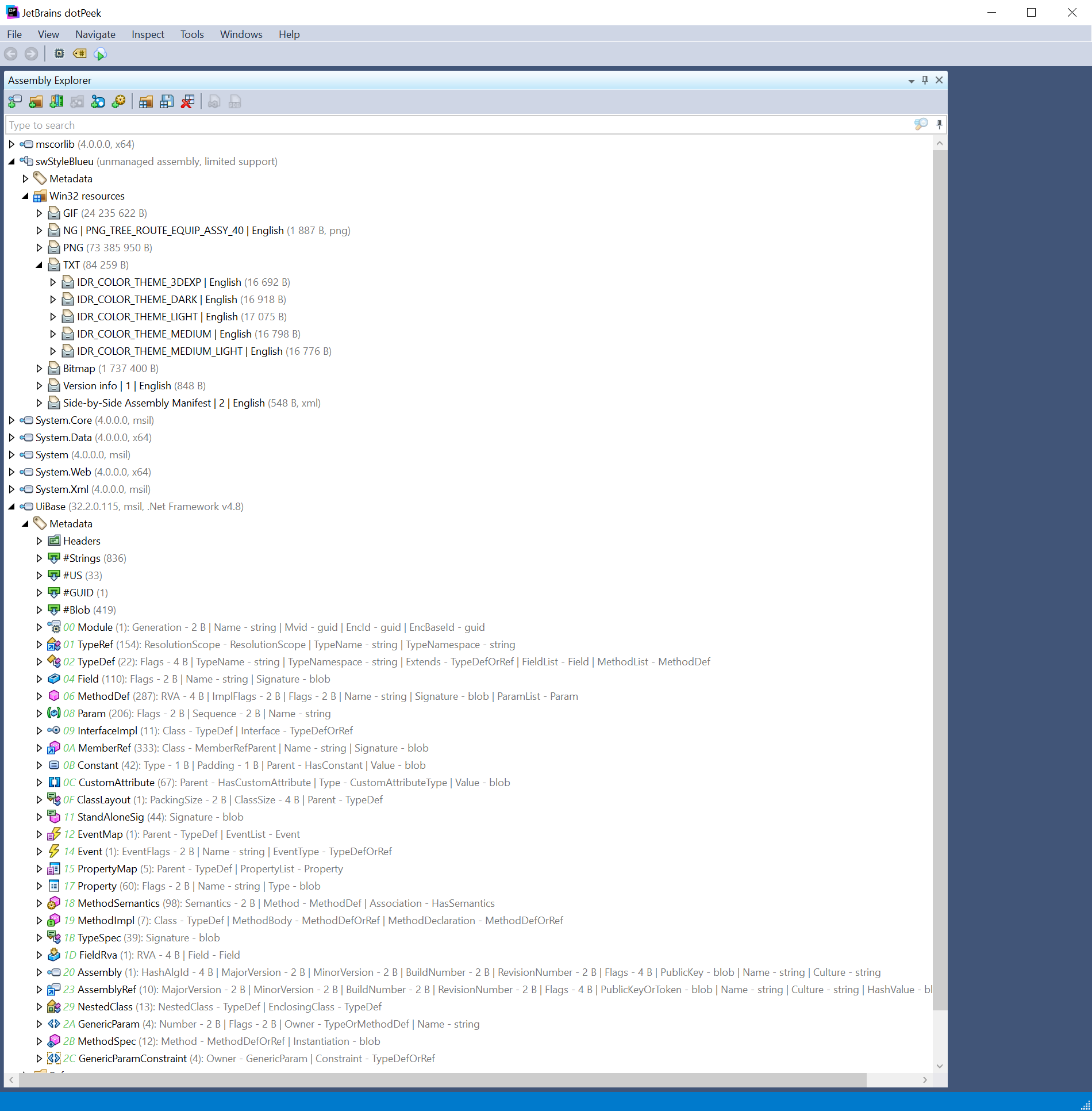

@SharkyUK Just checking If I'm on the right track? I opened up one of the dll files in the main sw directory in dotPeek, it says .Net Framwork v4.8 which means it was possibly written in c#? But 'swStyleBlueu' says unmanaged assembly, which means its possibly written in c++? So I need to decompile said dll file if possible into something that can at least be understood, as from what I read, c++ decompiling is not straight forward. This file is what contains the txt file for the ui colour themes which are written in hex code, I take it when it says about 'enum values added to this file must be added to'.. its talking about the header and source files in the the same file?
If I want to modify anything code related in this or any other files I guess I need to learn about first decompiling to usable code, writing the code (c++?), compiling.. Basically programming, easy right? 😅

I'm not 100% sure what the developer(s) meant with that comment, but it suggests that introducing new enumerated values (perhaps to represent new /additional colours) means that they also need to be replicated in multiple locations (i.e. the files you mention). For enums, this seems like a bad design decision as you generally want to specify them once in a well-defined source location.
It seems that a mixture of managed and unmanaged code is being used here. As you mentioned, .NET Framework 4.8 is being used in part along with unmanaged code, which looks a lot like C++ to me. The colour/styling themes in the unmanaged assembly look a lot like the resources that get spat out when writing a C++ application using the MFC library. This makes sense as, in my previous post, I mentioned that I believed Solidworks was written originally in MFC.
I would imagine that the managed code (.NET Framework) is marshalling data to/from the unmanaged assembly's resource section to style and present the user interface. And I'm assuming that that is what you are trying to figure out to create new styling (or edit existing styling)? It can be tricky decompiling a DLL and the process is not necessarily straightforward. DLLs may be wholly encrypted, partially encrypted, obfuscated... and they may not.
However, even if we assume that a DLL can be successfully decompiled, other problems would need to be overcome. In this case, being able to replicate those enumerated values in other files. Just having those files available and being able to change them doesn't mean they will magically work. You would need the entire code base in which those files reside. You would need to make the changes to the files (adding the enums), and then rebuild the entire code base.
On the subject of the enums, do you have any examples of what they are or might be? In C# and C++, enums are designed to represent discrete sets of named constants, typically using integer values. As such, they cannot directly store complex data types like an RGB triplet.
'Win32 Resources', does this imply the use of Win32 MFC like you said?
As above, it looks/feels/smells a lot like legacy Win32/MFC given the assembly structure and the naming conventions used in the resource section.
