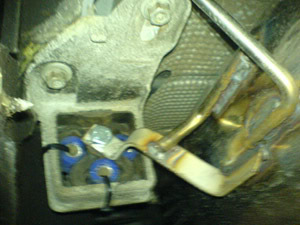

Does anyone know of any better rubber bracket for my 172 back box? (Mk2Ph1) as ive been through 2 of these rubber mounts and they seem to perish very quickly meaning that the back boxs just hangs in the metal surround bracket and knocks about, very annoying.
Thinking of making my own rubber mount out of more durable rubber tbh wouldnt be difficult.
You can use a bit of hose pipe, cut in to two smaller pieces and zip tie in place to help support the rubber mount.

just cut out the old rubber bit (or burn it out!), and wedge in a new oval rubber, will cost about £4 and will never need touching again
I'm going to wedge and zip tie some old sockets or hose pipe to support the mount.

Basically, the rubber is p155 poor in the mounts and will ultimately sagg so to help support the rubber mount that is in the shape of an X, you can support the bottom part of the X.
Basically, imagine a square, an X in the middle, and a circle in the middle.
The exhaust slides in through the circle, which is in the middle of the X. The bottom half of the X saggs under the weight and movement of the exhaust, so in order to support the X and keep the exhaust hidden under the bumper, you need to wedge something there, or replace the rubber to something more durable. I'm sure Fred could provide a link to somewhere?
^ like this?

Yeah just like that - what size mm piping did you use?
