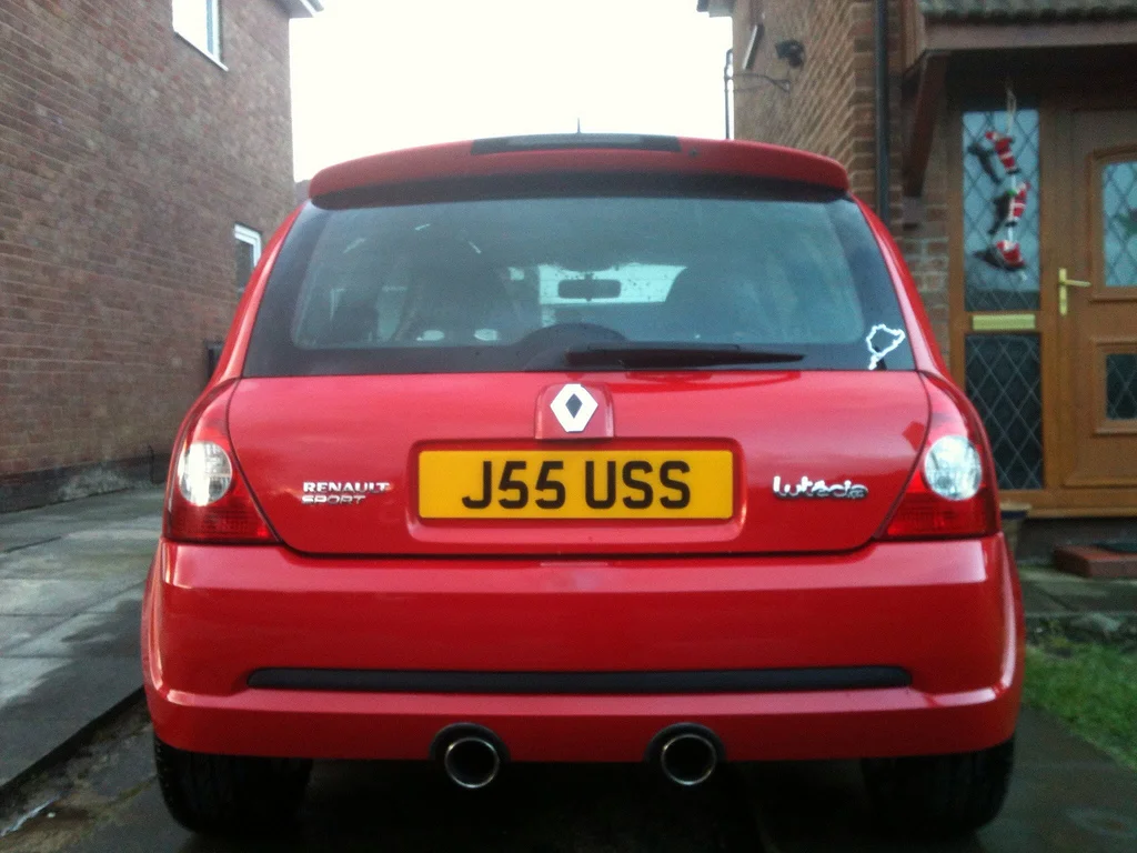

I really like the lutècia badge i wanted one myself but it just looks odd now with the new style RS badge imo.

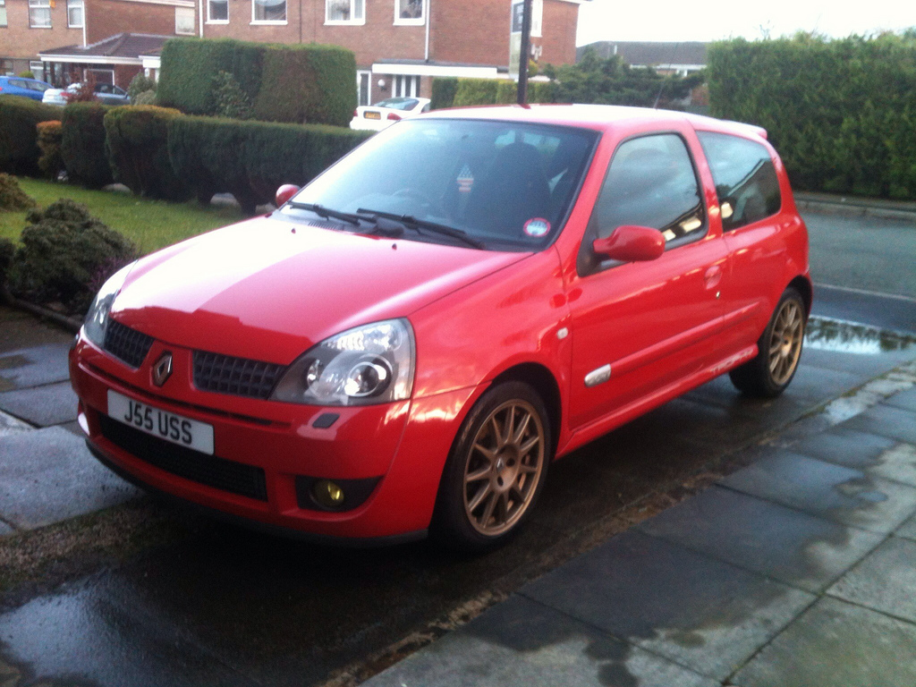

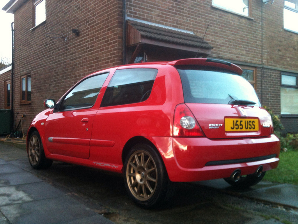

Gave it a quick clean today and took a couple of pictures. I really need to upgrade my phone for a better camera, but the 3GS just won't die!
Milltek sounds a touch louder and deeper now. It's blowing at the decat to centre section join so I'll be fitting the Milltek decat which is sleeved to sort that out.

What is that "lutecia" badge?
Re: Third Time Lucky; Trophy #41 - UPDATE - Yozzasport has gone...
Wikipedia said:
The Clio has been sold as the Renault Lutecia in Japan, because Honda owns the rights for the name Clio (being one of Honda's sales networks in Japan called Honda Clio).

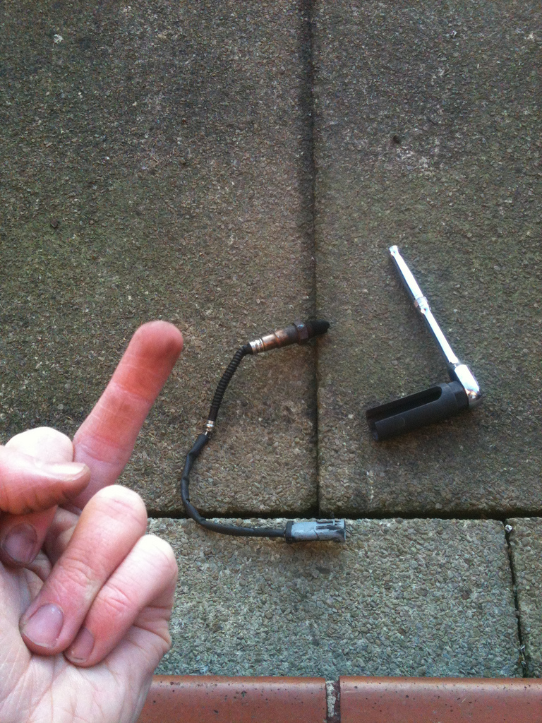

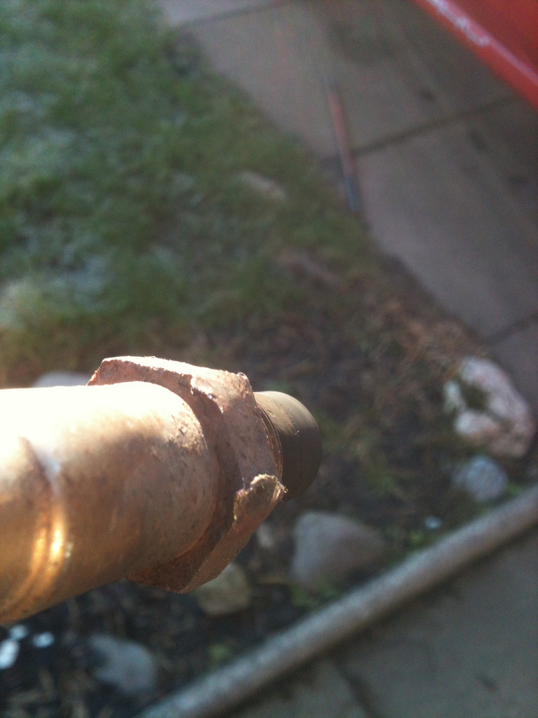

Cheers Rhys!
What a b*****d it was to get off!

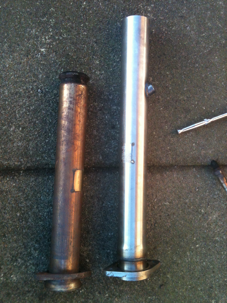

Still, it was off. Got the Milltek decat fitted but alas, the alignment went off.
Here is a comparison shot of the Scorpion decat which is the same as the standard cat length/fitment and the Milltek sleeved decat:
It's a fair bit longer, so I don't think that'll be blowing any time soon :approve:

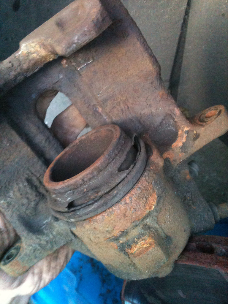

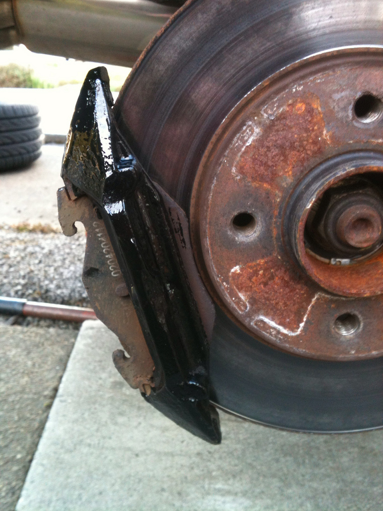

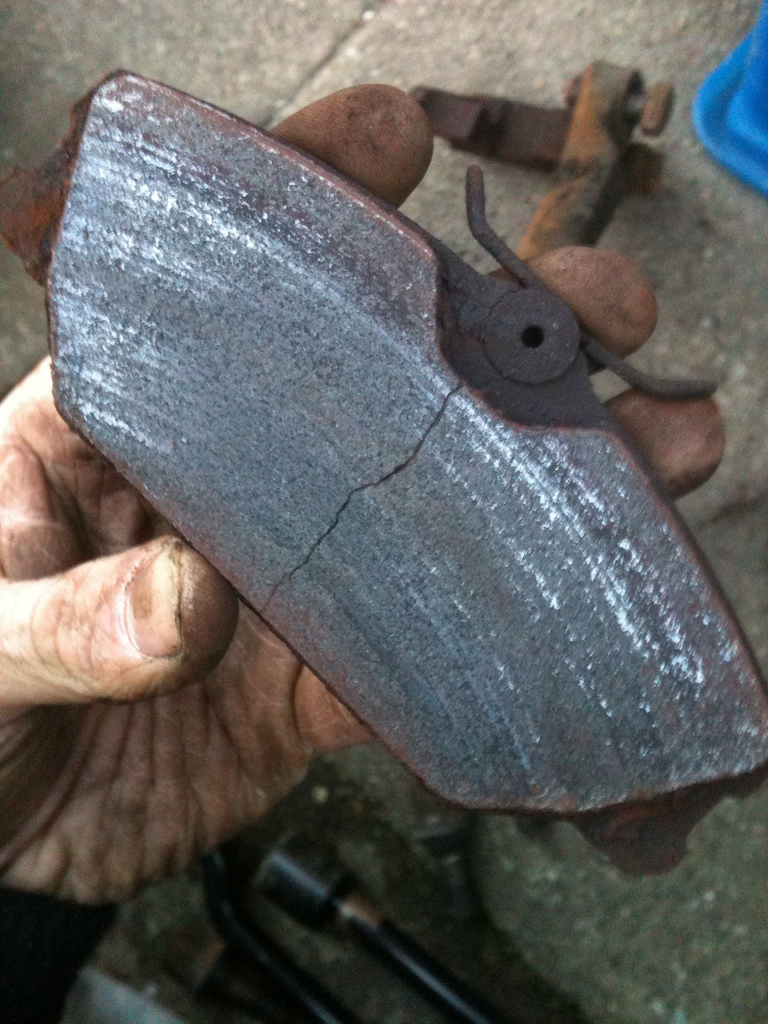

...and my caliper failed.
Figured out it was fairly bad as the piston was seized and the brakes were stuck on on the front N/S.
Ended up purchasing some newly refurbed calipers off here, just one thing though... they were bright yellow :dead:
Got them fitted anyway just so I could carry on driving the car.
However, I only managed to fit one side. The other side's Goodridge brake hose was stuck in and the nut started rounding off.

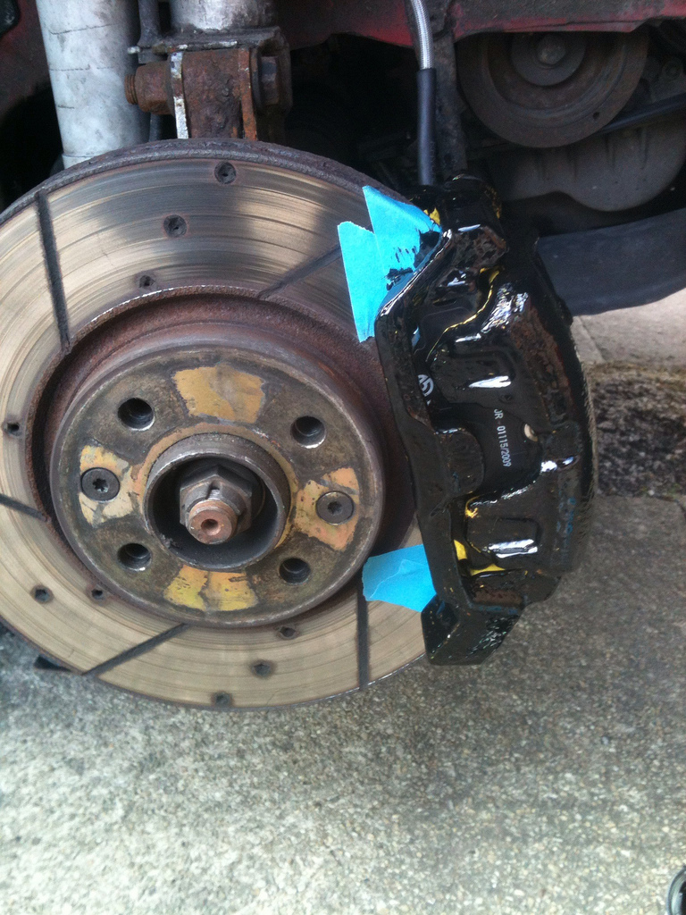

Instead of pissing about I just bought another set:

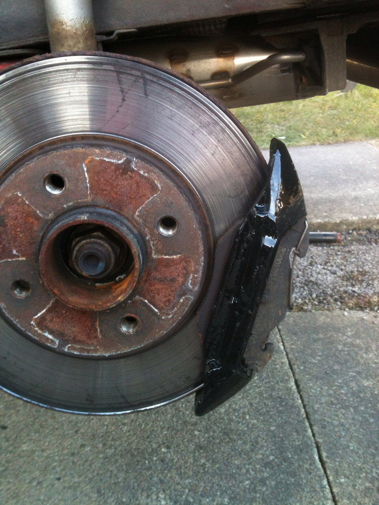

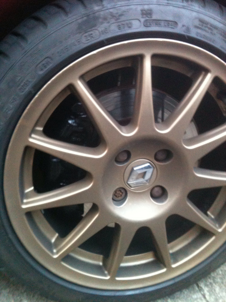

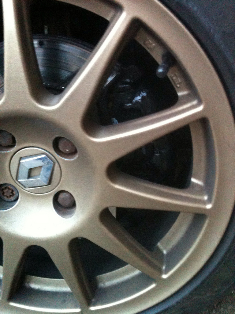

After this, my tin of Hammerite arrived :)

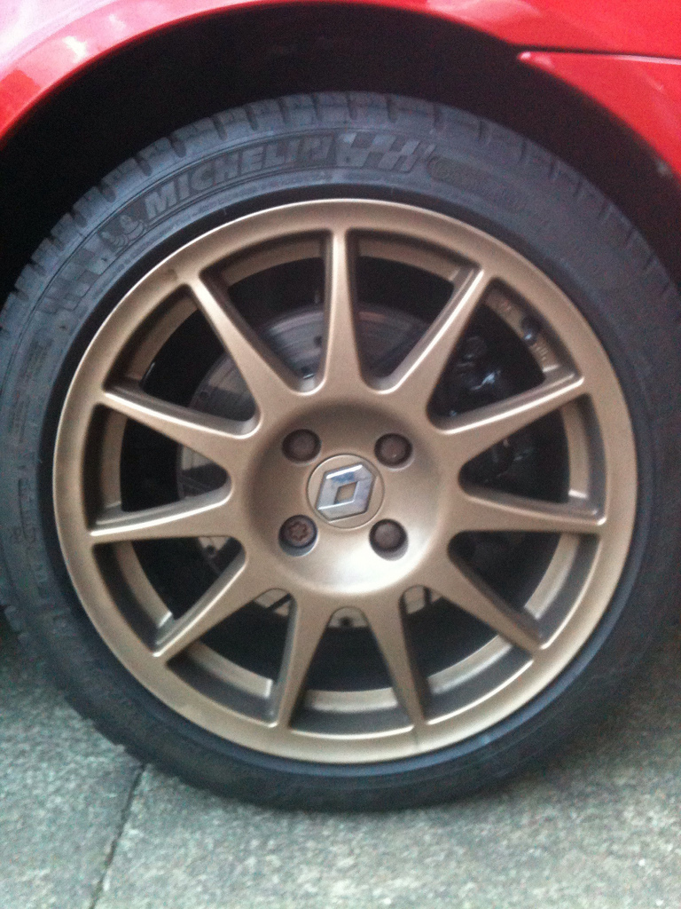

(Bit crude on the front, it's difficult whilst they're still fitted! The second coat covered the yellow though)
...and with the wheels fitted. Much more subtle!

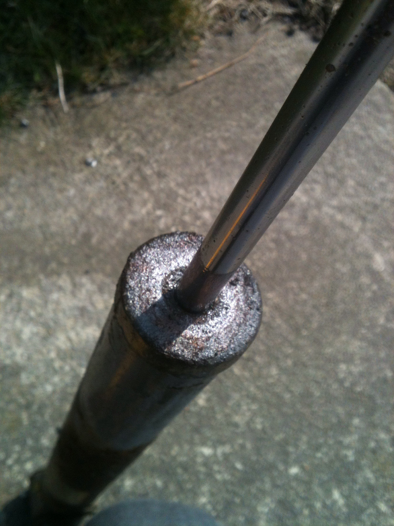

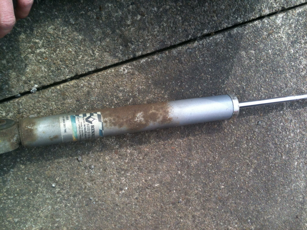

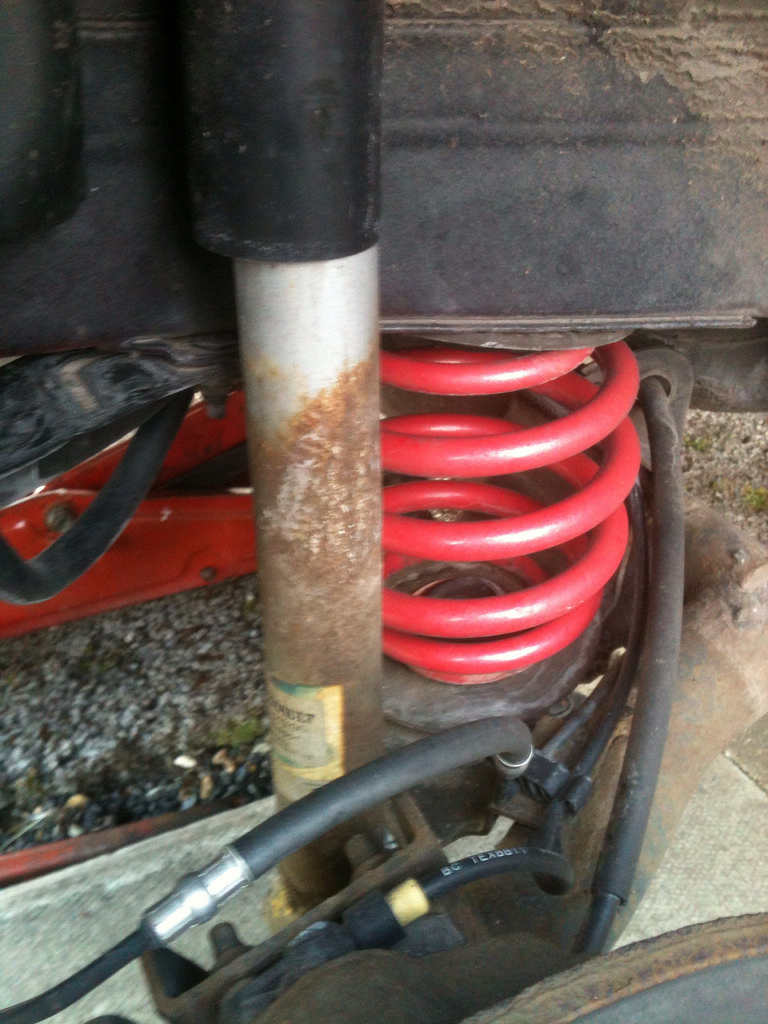

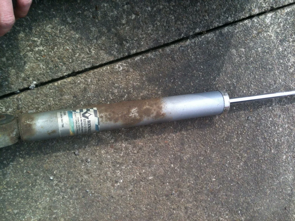

As you may or may not have noticed in those photos of the rears, my rear Sachs shocks have seen their prime a long time ago:
I've just ordered a brand new set of Koni adjustables to replace them. They came with a lifetime warranty from Larkspeed so will be good for as long as I keep the car which is a great peace of mind.

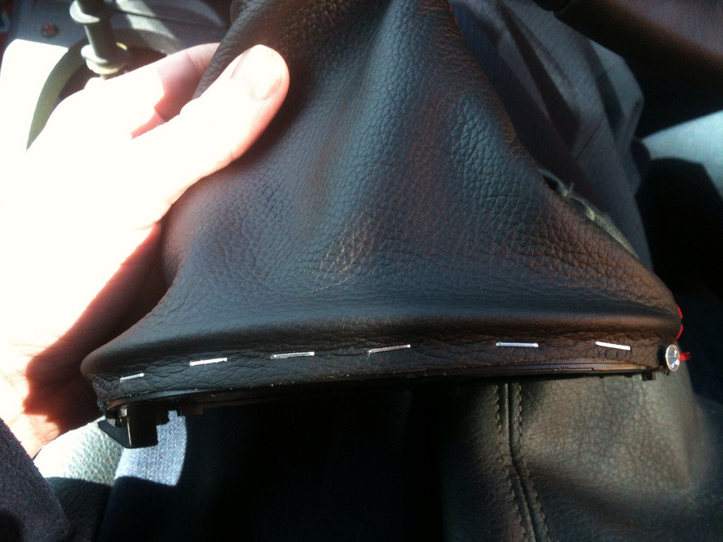

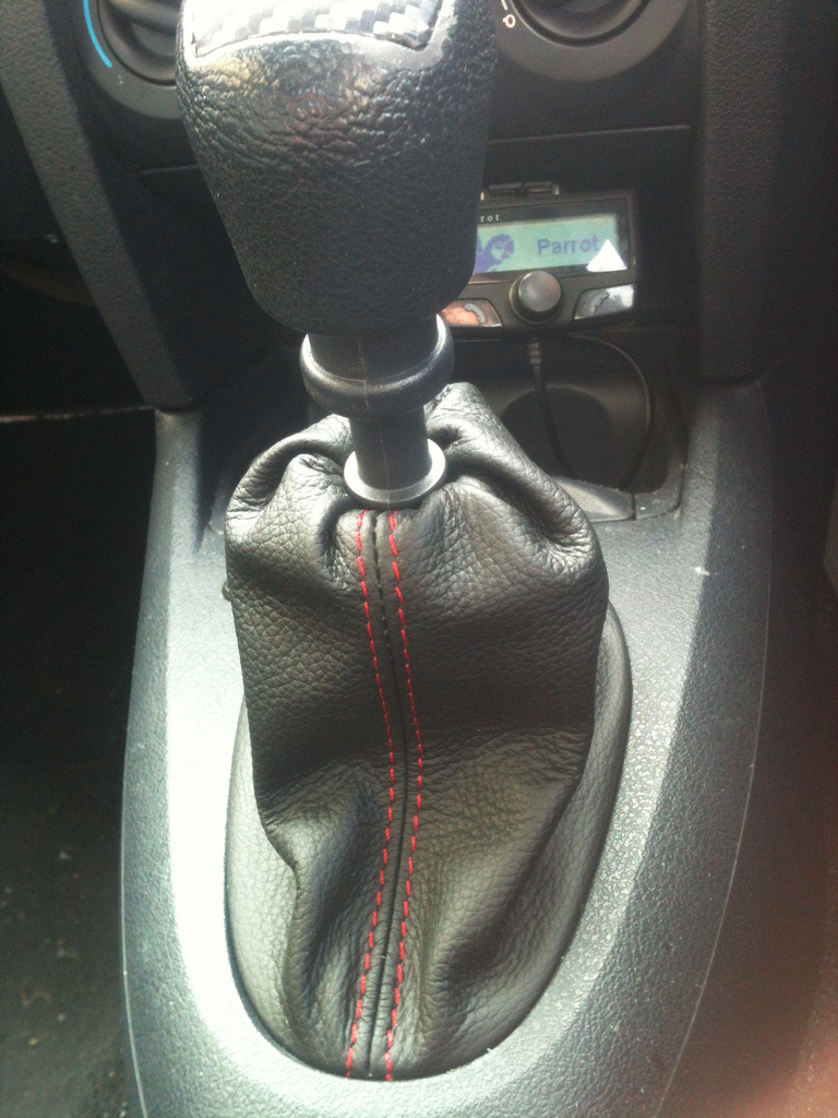

Finally, I ordered a custom gearstick gaiter to match my steering wheel. I work for a bus company so took it into work and asked the guy who trims the seats to give me a hand attatching it to the plastic surround. Staple airgun sorted it!
...and a quick photo of it fitted. I'll get some better ones another time showing the steering wheel too.

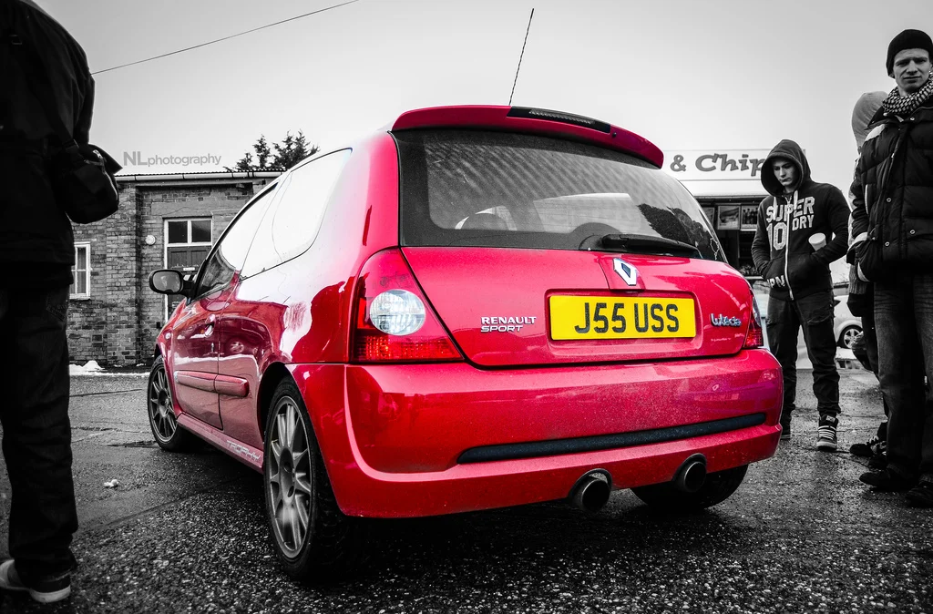

Here's a final exterior shot from the Chester meet courtesy of Niall97 on here :)

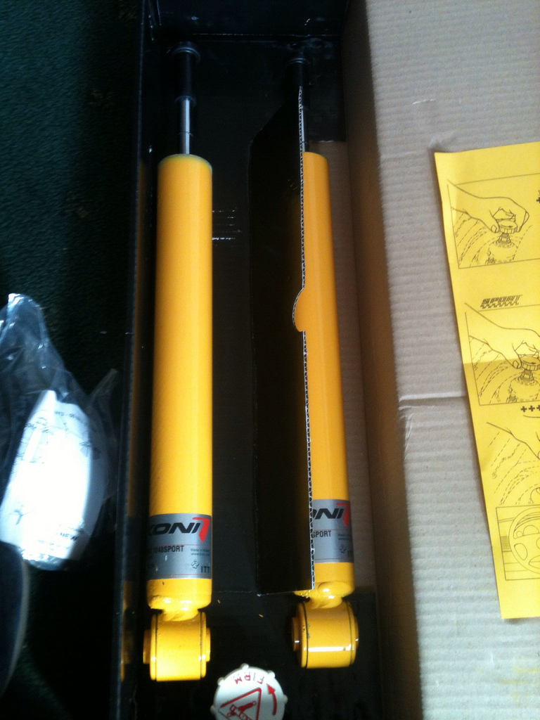

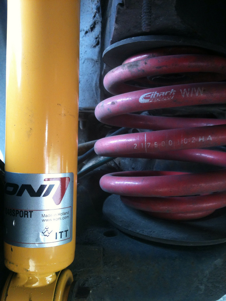

Konis:

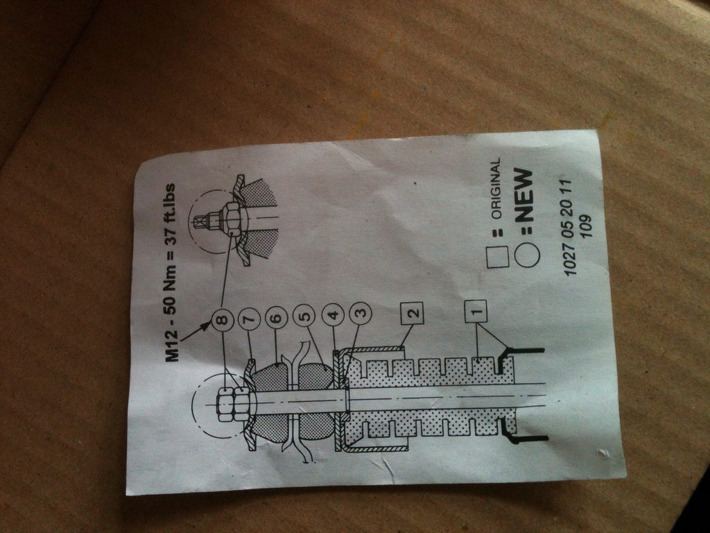

Instructions were great! Much like Ikea furniture:

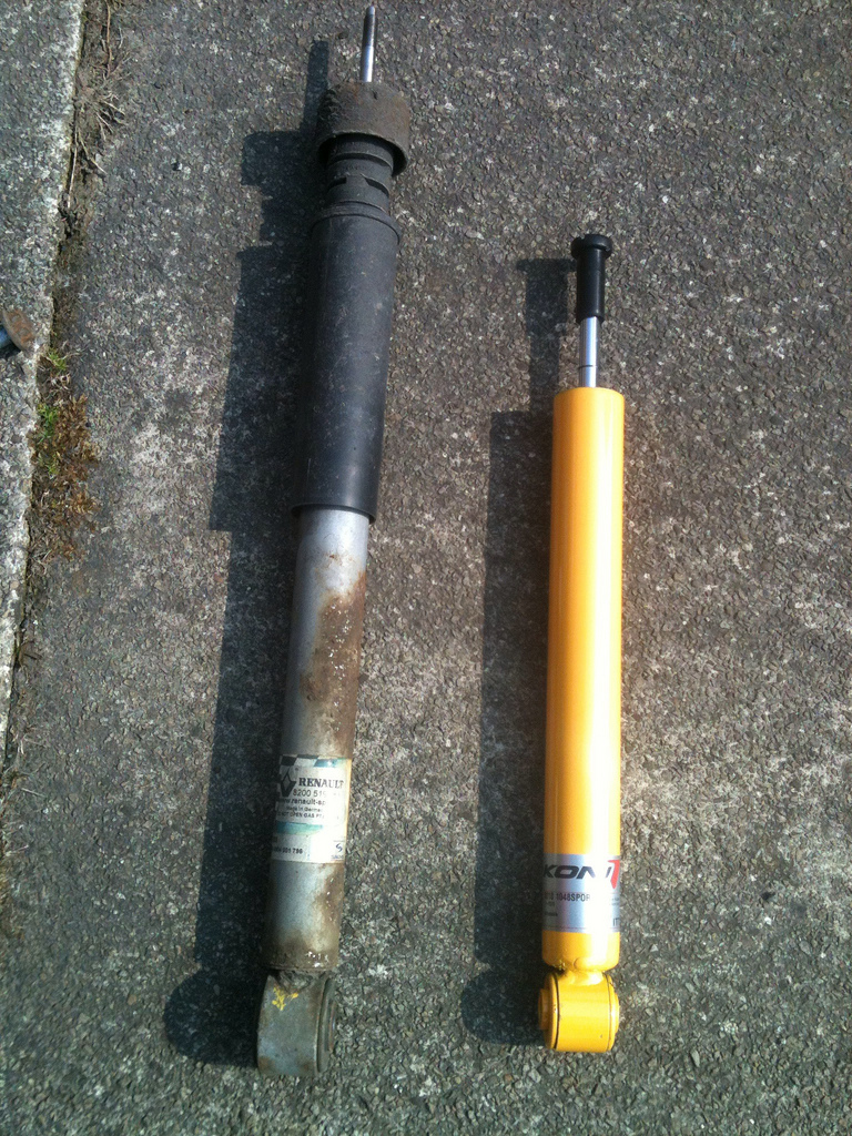

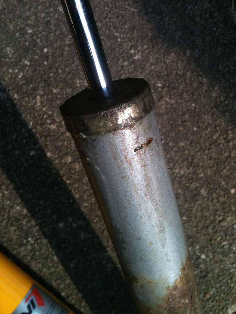

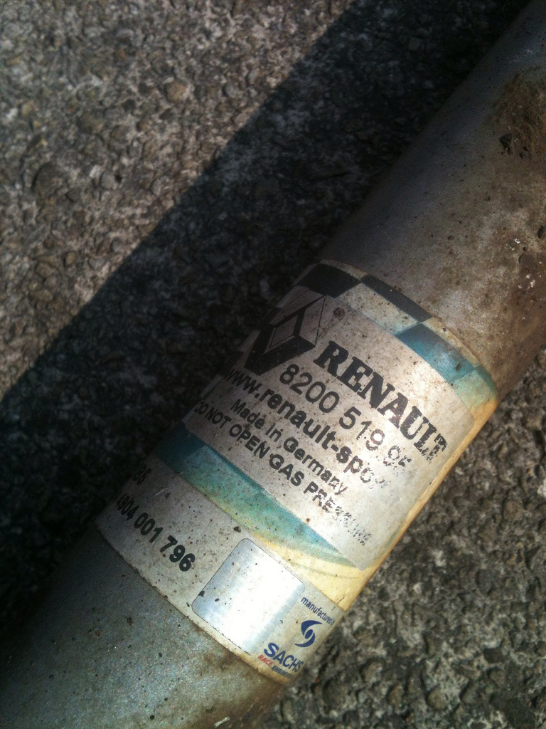

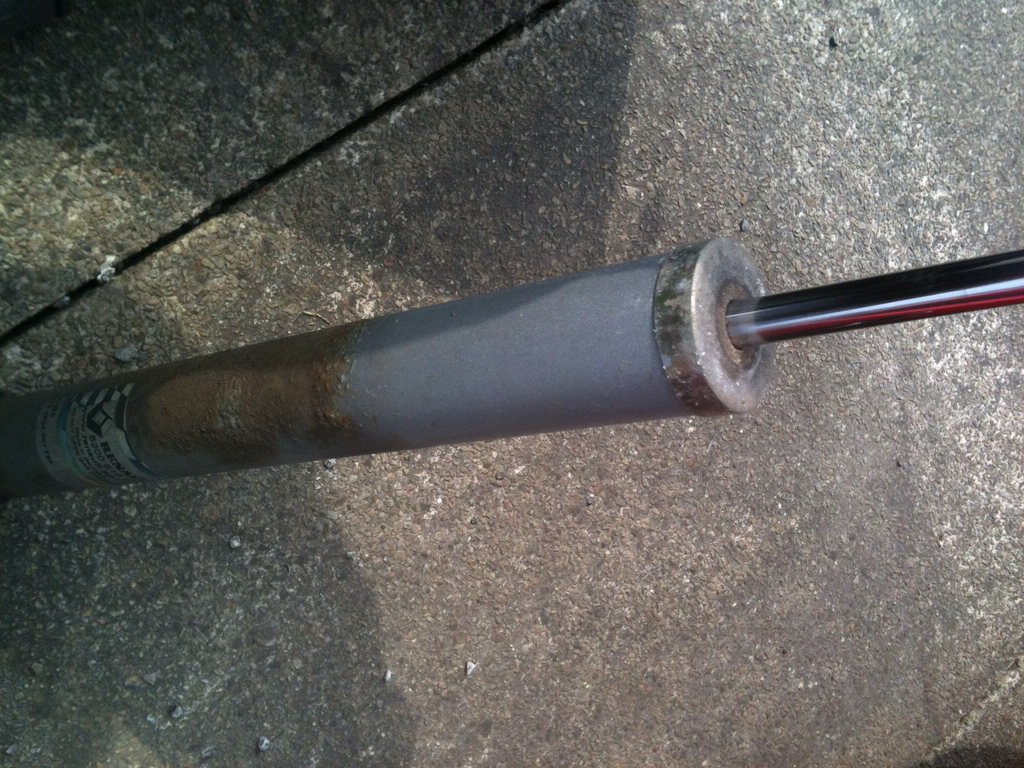

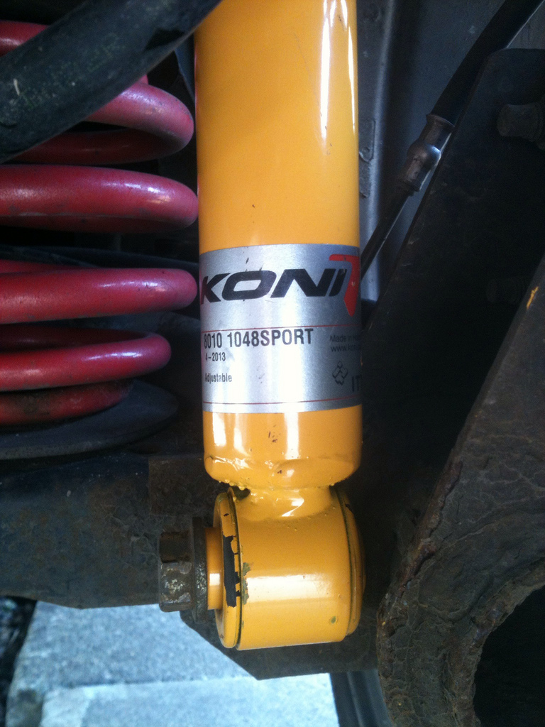

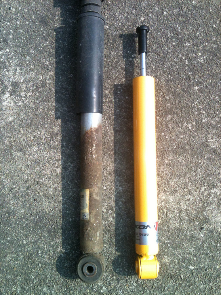

Old vs. new:
The other side wasn't quite as bad:

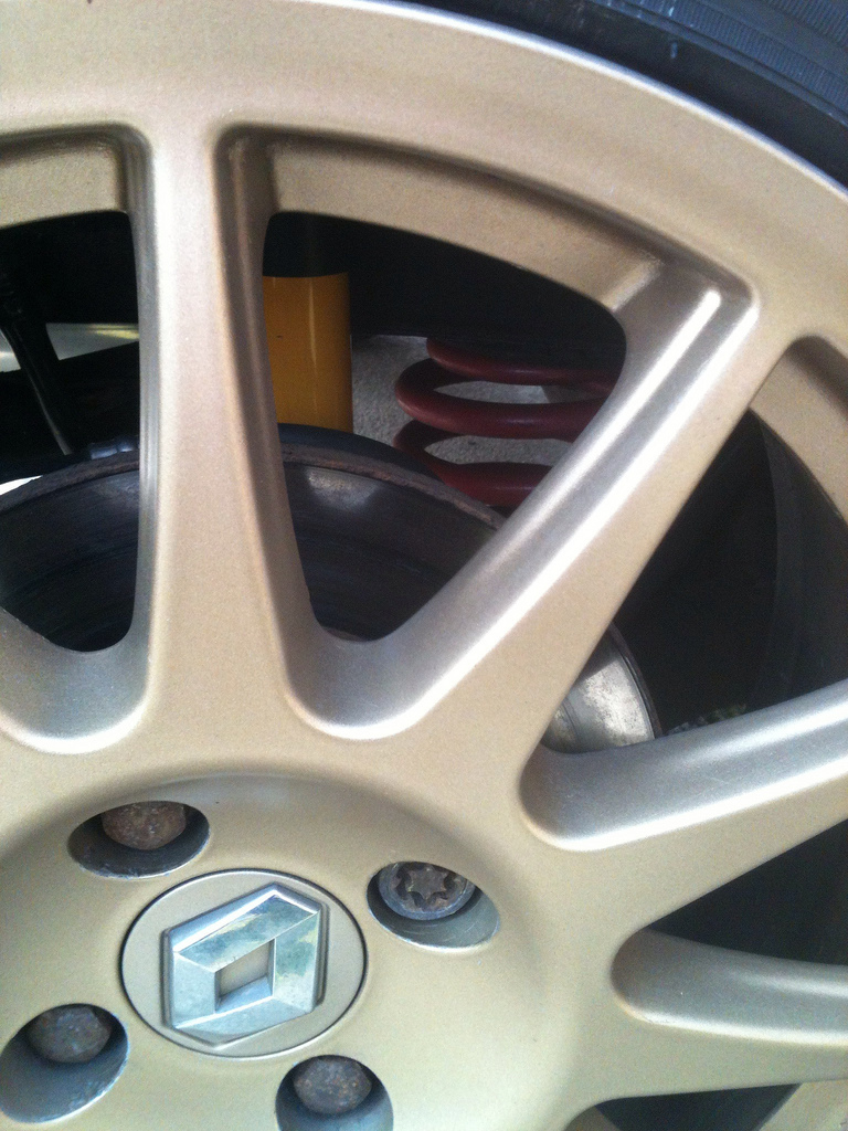

...and fitted:
Adjusted to half way for now. I'm going to use trial and error to get what I think is the perfect road setup so I've left the adjusting tool in the glovebox for when I find a decent roundabout ;) I set the front Sachs to the factory standard the other day, I'm not sure what they were set to before I adjusted them but it's made the world of difference (22 clicks from the bottom for those wondering).
