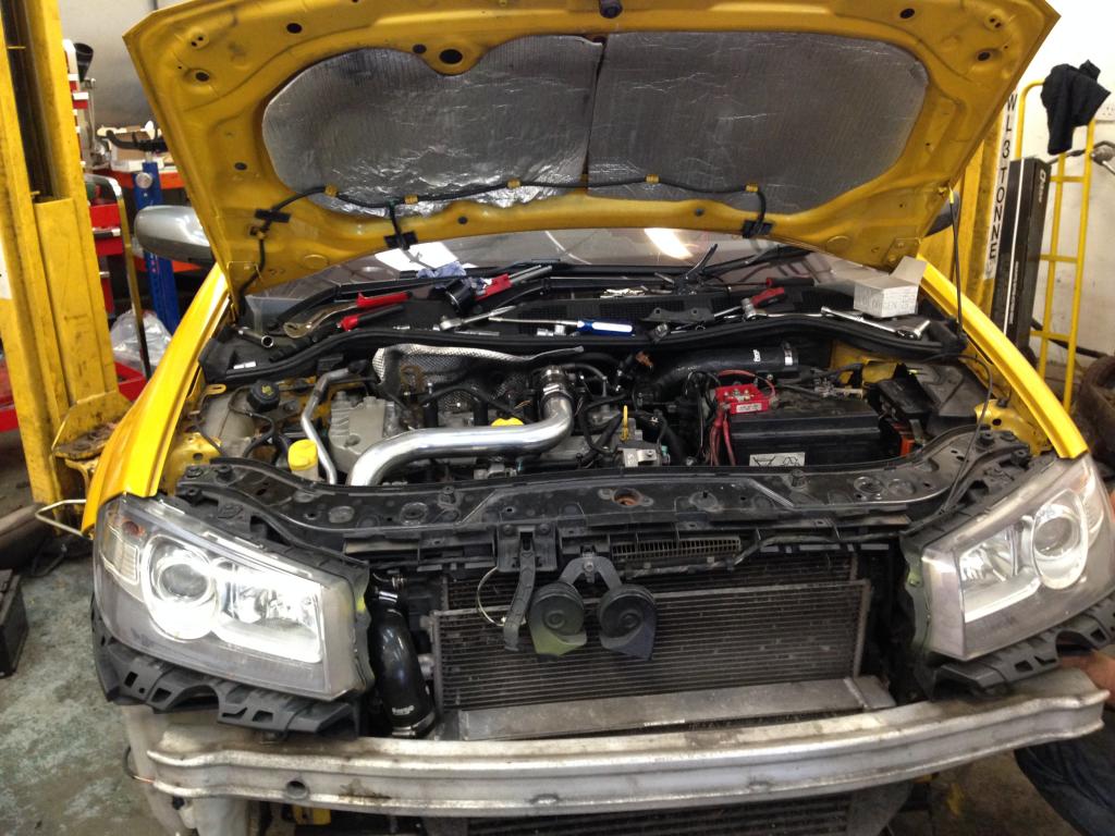

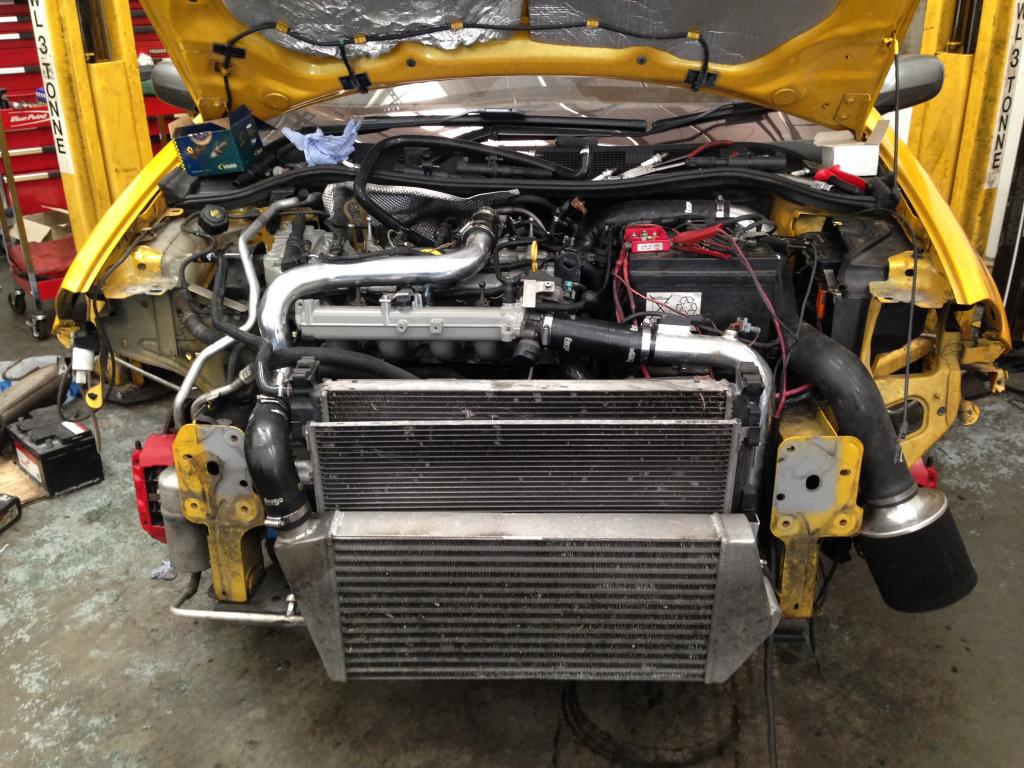

Yes, engine has been run up to temp now. There were a couple of coolant leaks so once sorted should be ready to go.

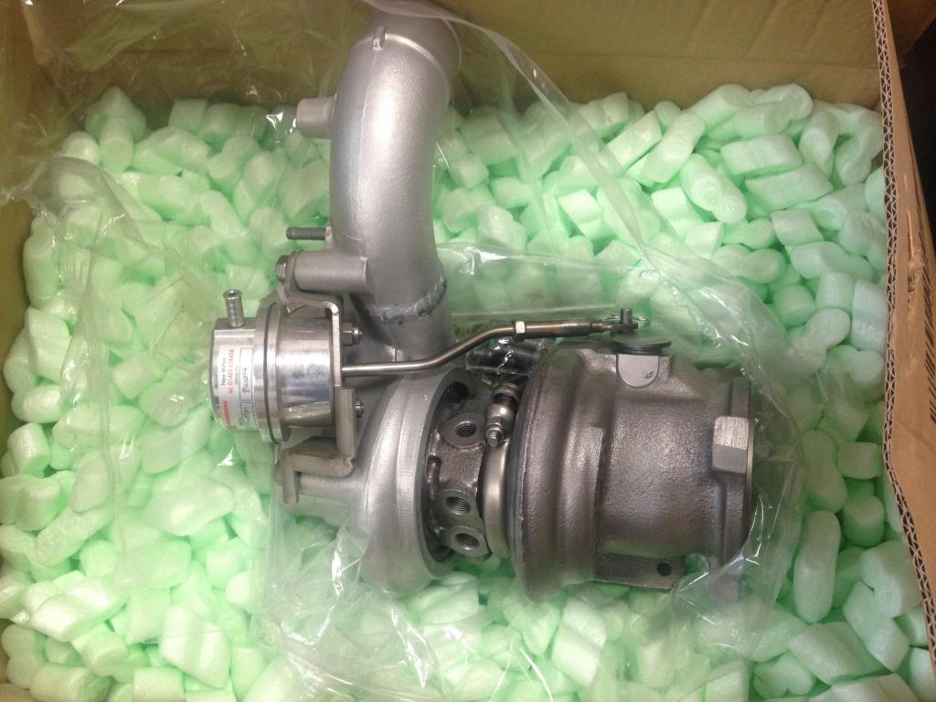

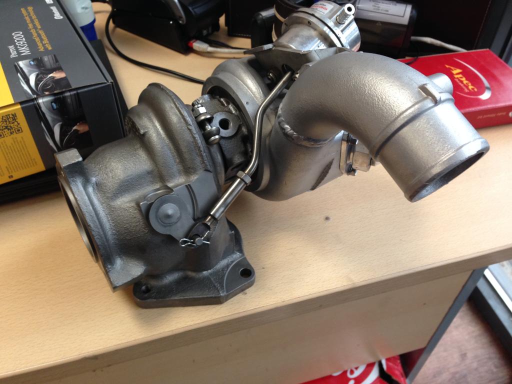

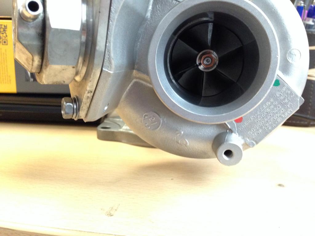

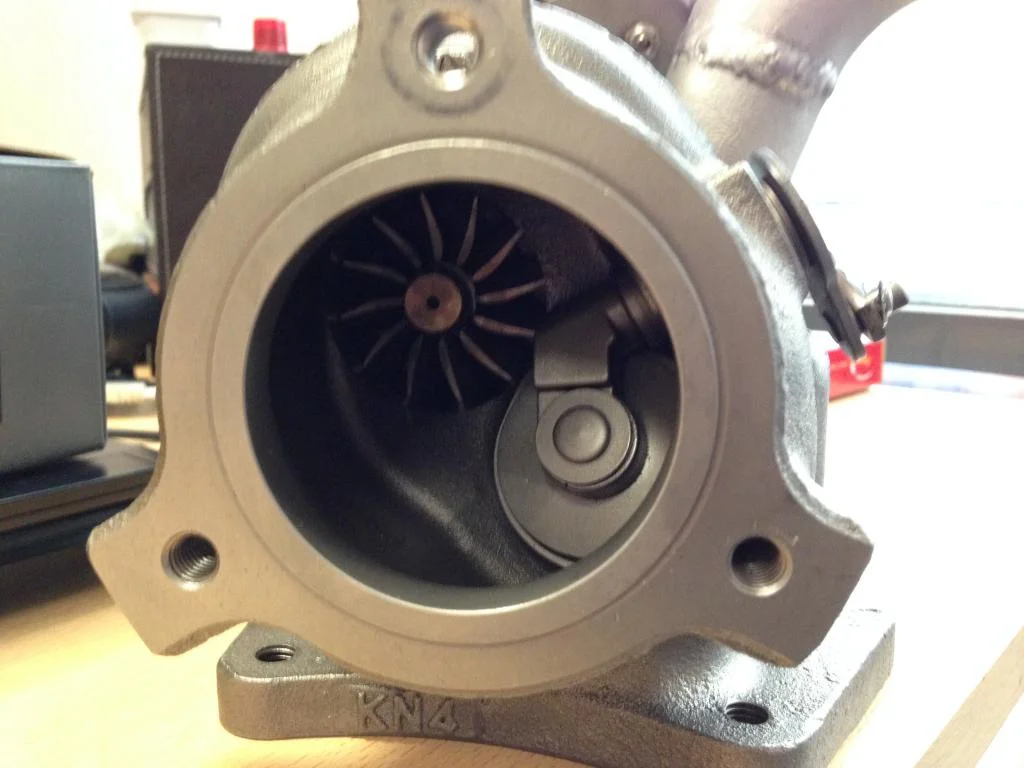

Turbo is at CR Turbos to be hybrid'd this week.
Hopefully I'll get gearbox and turbo back by end of week and I'll be able to drive my car again sometime next week.

Turbo will be back early next week as well so by end of the week I should finally be able to drive the car again :smile:
