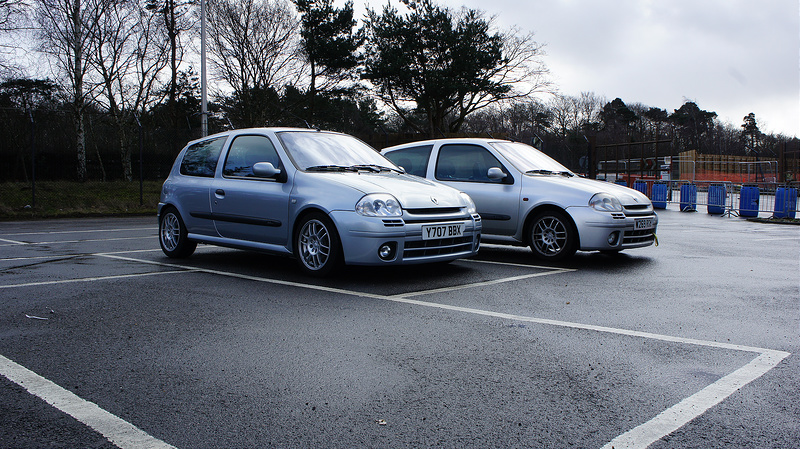

Got a few pics from today:
2x Ph1 172's by Dr-Jekyll, on Flickr

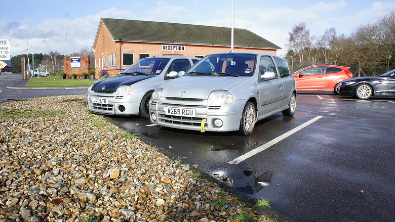

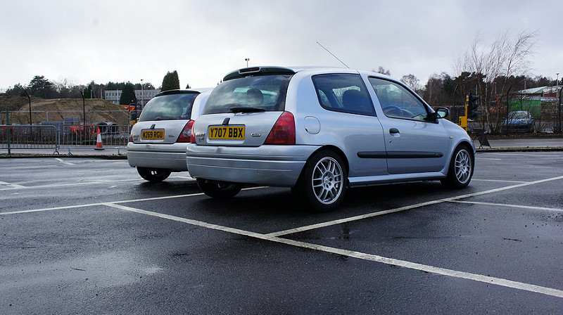

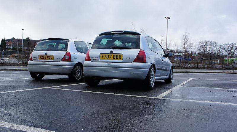

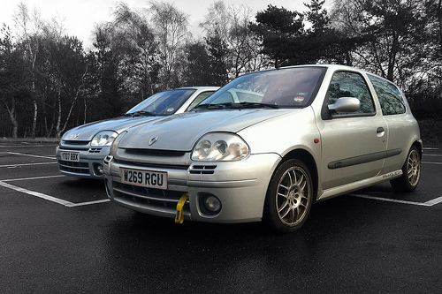

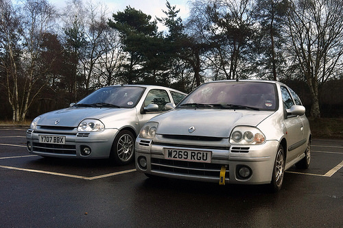

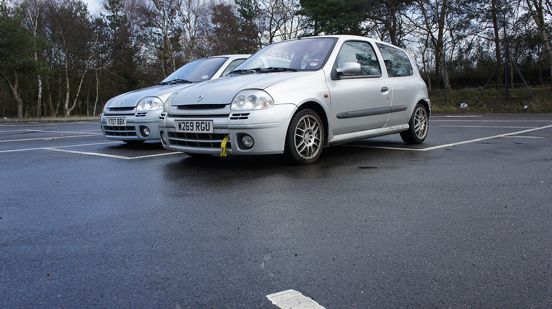

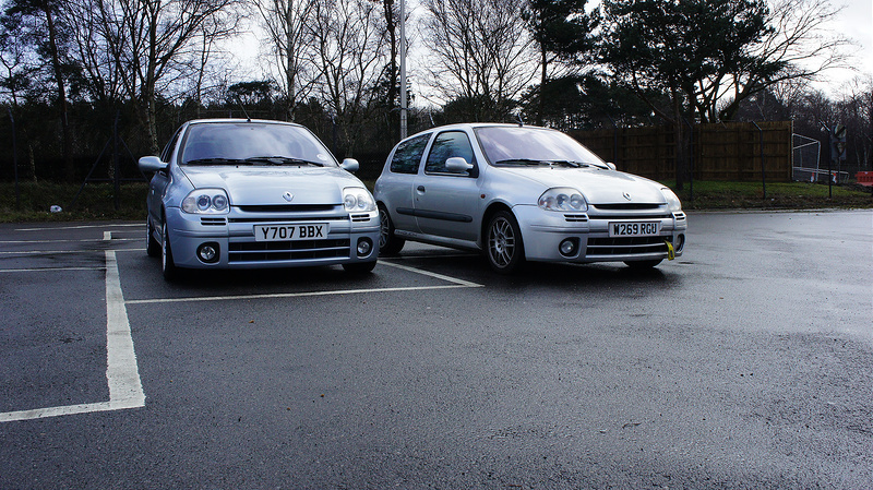

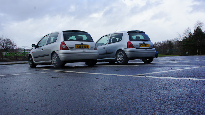

Anyway here are some pics of the RR day and a mini photoshoot with @Dr Jekyll
DSC00325 by Timmsy21, on Flickr
DSC00300 by Timmsy21, on Flickr
DSC00324 by Timmsy21, on Flickr
You'll have to excuse how filthy mine is in the pics, didnt have chance to clean it before the day :(

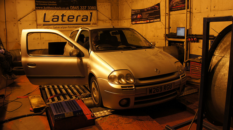

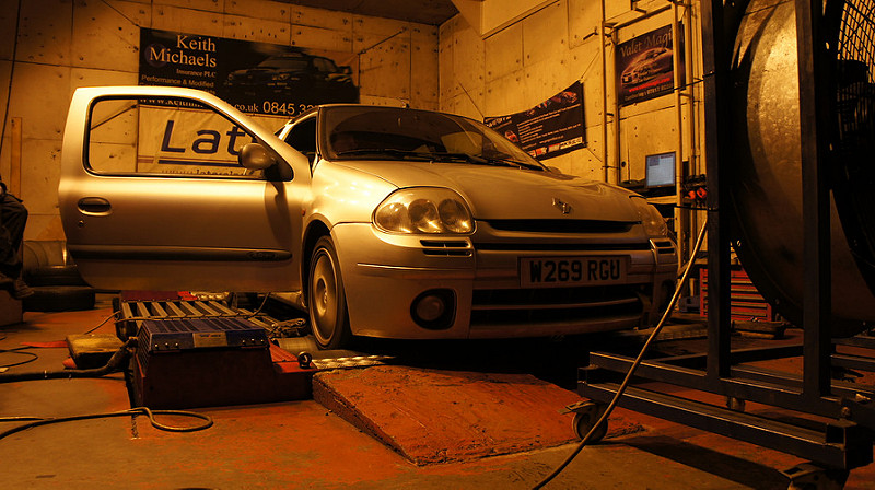

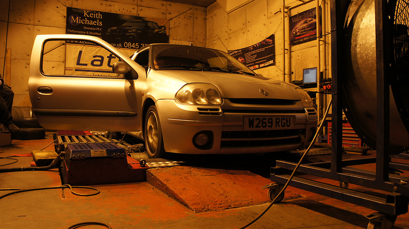

And a couple of it sitting on the rollers
DSC00313 by Timmsy21, on Flickr
DSC00312 by Timmsy21, on Flickr
DSC00311 by Timmsy21, on Flickr
DSC00309 by Timmsy21, on Flickr
Think its safe to say that the filter was a tad dirty!
My rear bumper looks so dented :(
Yeah it was filthy!
I did wonder but it didnt look dented at the time, is it just the colour that does that?
I was a bit hacked off with the new scuff on mine that i noticed Saturday! in fact so much so that if i need to have it resprayed i'll put on the ph2 one ;)
Jekyll
Yeah it was filthy!
No, a few are like that. Quite common. It's not cracked or anything so getting a hair dryer on it and pushing it from the inside out should sort it.

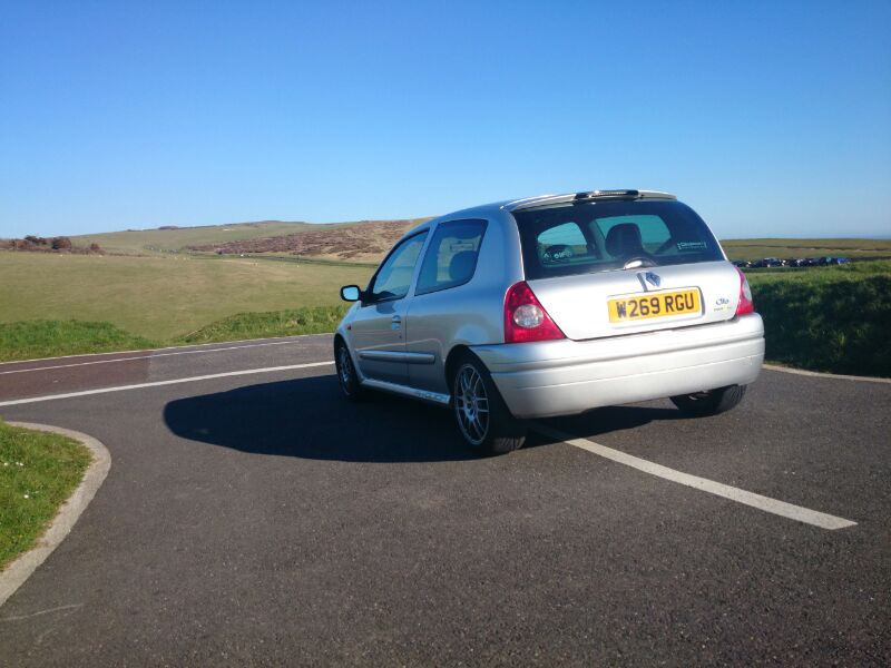

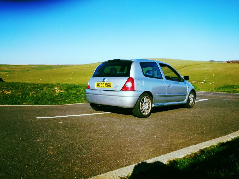

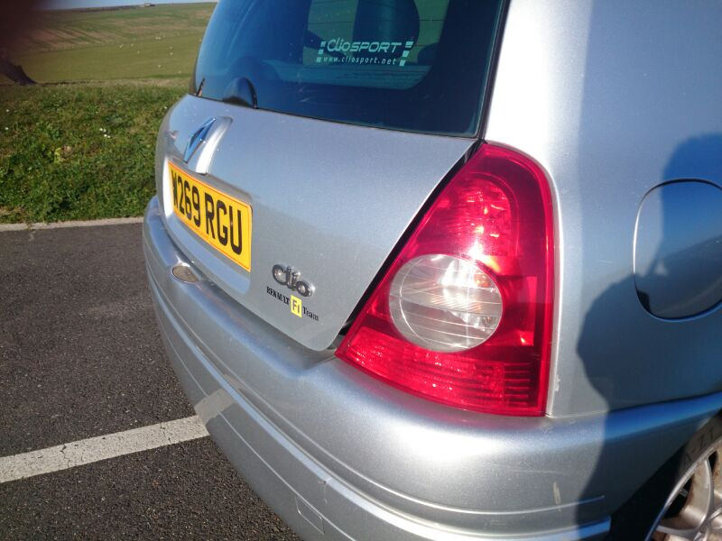

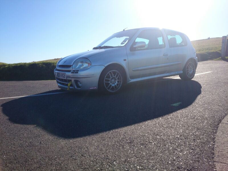

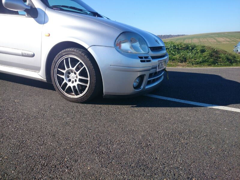

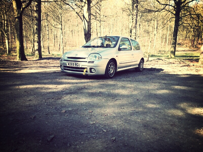

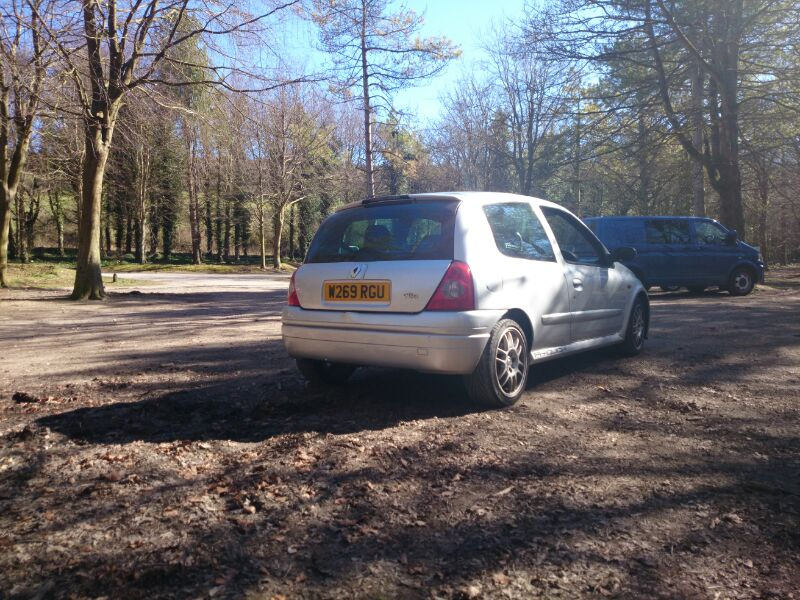

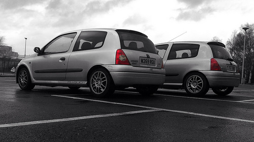

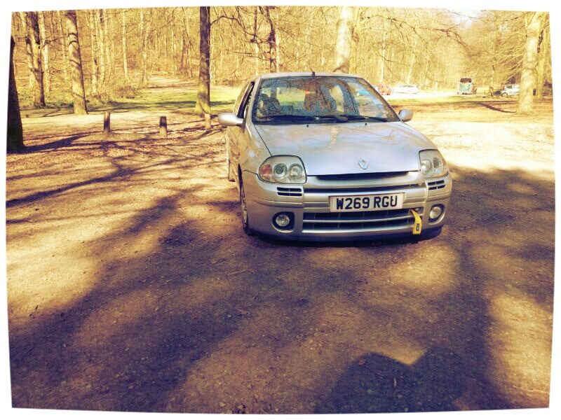

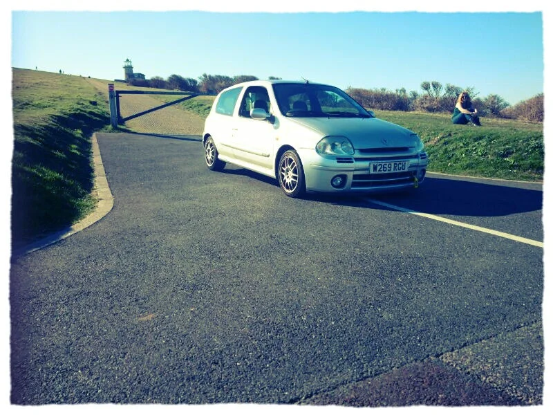

Well here are some long awaited pictures of the Ph2 parts on, im 100% certain on leaving the ph1 rear bumper in place now.
Gave the car a quick once over at the jet wash (really need to get it done properly at some point) Got some stickers on, need to fit my RS200 badge and take the tow strap off i think
Anyway went out for a b-road blast on Sunday and stopped by for some pics.. sorry about the quality.. girlfriends camera phone (apprently the best camera on a phone ever)
Also MOT time is coming up soon and i think i have a blowing exhaust, need to sort that out, brakes need sortting but im just going to see what it fails on, cant afford to go replacing stuff that may or may not need doing until i find out for sure :(
Would love to get some bigger profile tyres back on, 45's are just to small for 15's i think. Wheels really need a refurb too! and the amount of chips on the paint work i might as well get a full respray too! mechanical things firth though :eek:

Sweet! Glad you came round on the rear bumper. Side strips look ok on the ph1 as it makes it look more modern but the ph2 rear bumper is a bit too much.
Whens the MOT due?
Same Barry. I gave my splitter to Alex as I was unsure but seeing yours makes me want to do it again now! Lol. I probably get another one and go through the motions again!
looking good mate :D
i still haven't got my splitter fitted yet,i'm undecided.
i too am on the lookout for a set of spacers,if i find any deals i will let you know
I really do prefer it with the splitter, finishes off the front bumper just right. i do need to trim it down a bit still but havent got round to it yet
Whens the MOT due?
Yeah i think the ph2 rear bumper will be too much, only just pulls of the ph2 boot hatch imo.

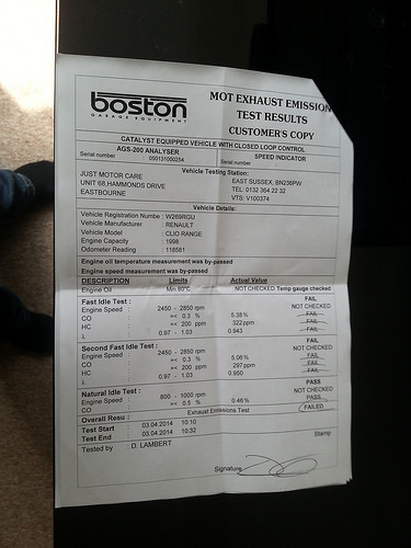

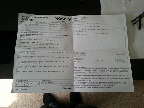

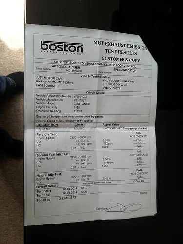

Sooo the MOT has been and gone
Failed badly :(
Exhaust had a couple of holes, Emissions was way out on a reading of over 5% parking brakes low on efficiency and rear shock absorber leaking
All the above has been fixed bar the shock absorber but i'll try and do it one evening this week.
Stealth system purchased from @Budgie
Cat Converter from Mike Woodford
Some partern part rear pads c**till i can afford a full disc and pad set)
Rear shcok absorber from Adam at renault wolverhampton :)
Had majority of the above fitted by a good friend Sid at Ainsworth Engineering who also tightned the handbrake cables along with the pads and ran the brakes tests again and now passes as it should.
After fitting the exhaust system it still wouldnt pass the emissions so Sid poped in a brand new Bosch lamdba sensor, now its well under the 0.3% max for emissions :)
Sid mentioned that it would be over fueling like a B**** which is probably one of the reasons it was so down on power.

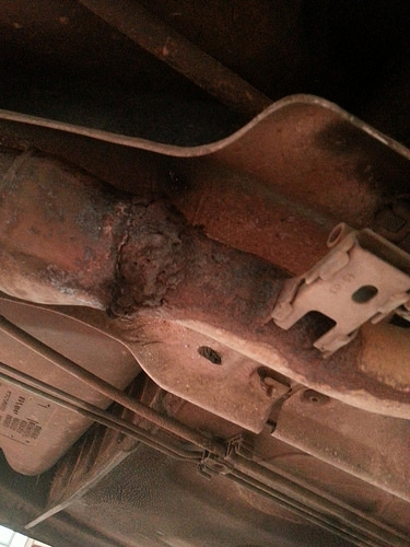

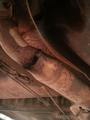

Old exhaust where someone had done a bodge job of welding it up previously!! professional welders would cringe at seeing these up close and personal!
MOT failure sheets in case anyone is interested

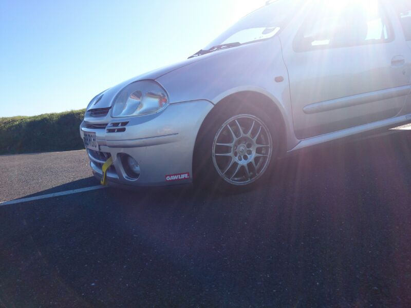

25mm front spacers on. Looks a whole lot better spaced out now than it did before.
