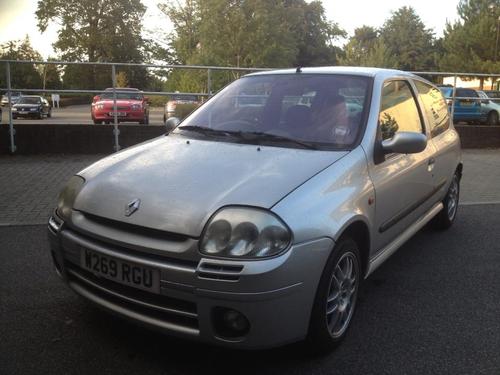

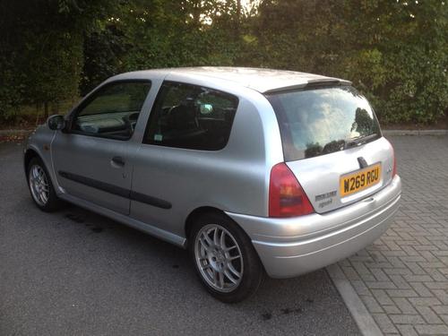

So here are a couple of pics the day i picked it up,
As you can probably see the bumper needed fitting properly, bonnet and boot need to be the right colour.
I'll try and get out and wash it and tidy it up a bit this weekend if the weather is good.

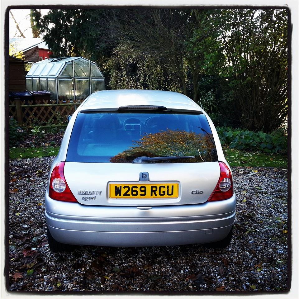

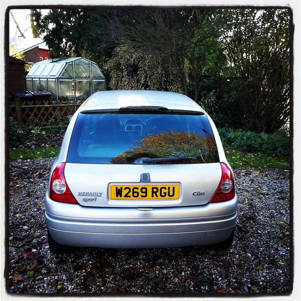

So i added the rear lights last weekend,
I may still stick with the Ph1 rear bumper at this rate, with the light upgrade it already looks a whole lot newer :D

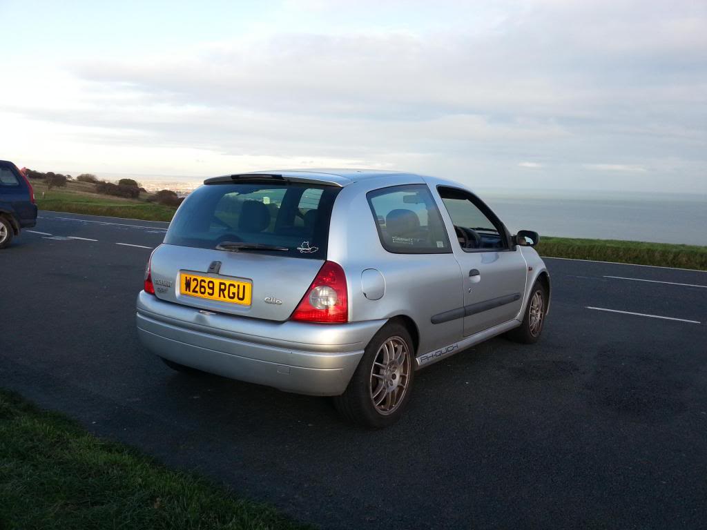

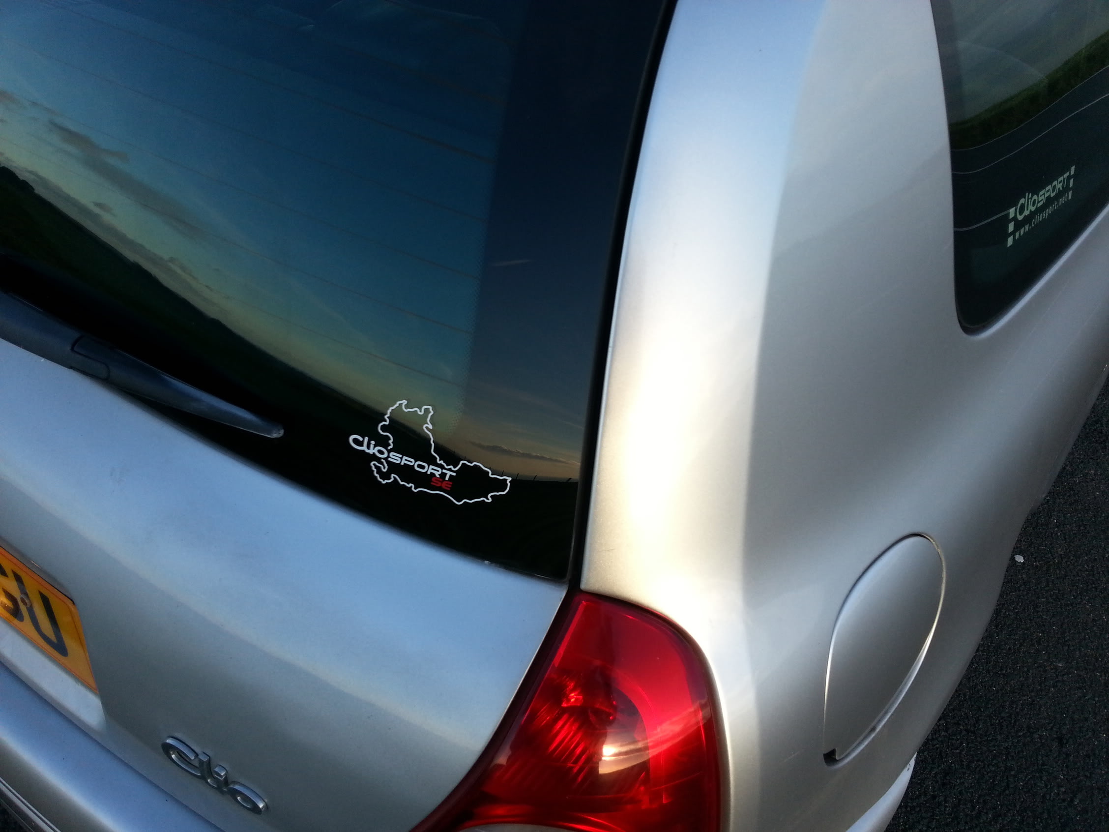

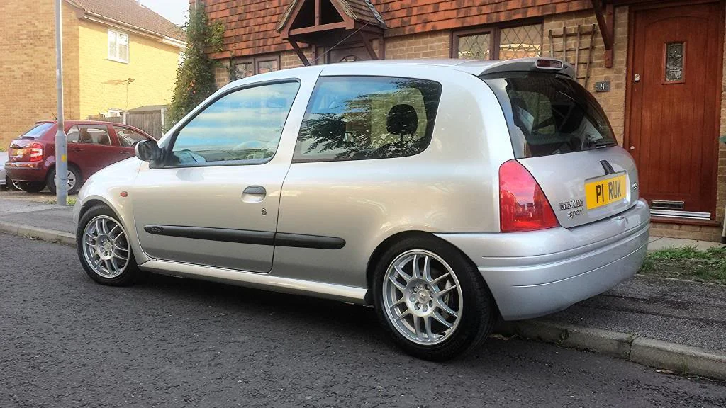

So the weather was good today and havent driven the car all week so thought i'd take it for a B road blast. Also added my Cliosport SE sticker too :)
Just doesnt miss a beat and is an absolute joy to drive :)
Excuse how dirty it is! Only got 2 pictures as i thought driving it was much more fun than taking pictures ;)
Glad to see your still enjoying it buddy :)
I was going to put my sticker in the same place but I think I may put mine in the center just under the spoiler.
Whats next?
I thought about putting it under the spoiler but just didnt seem to look right :-/

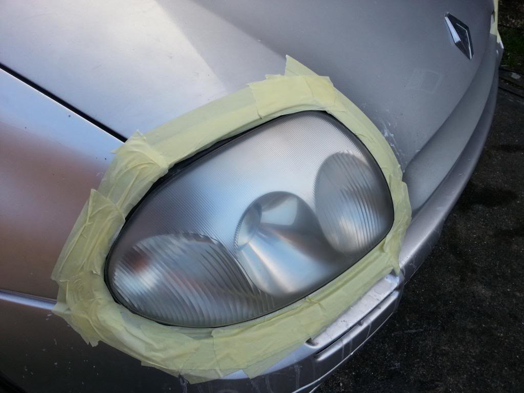

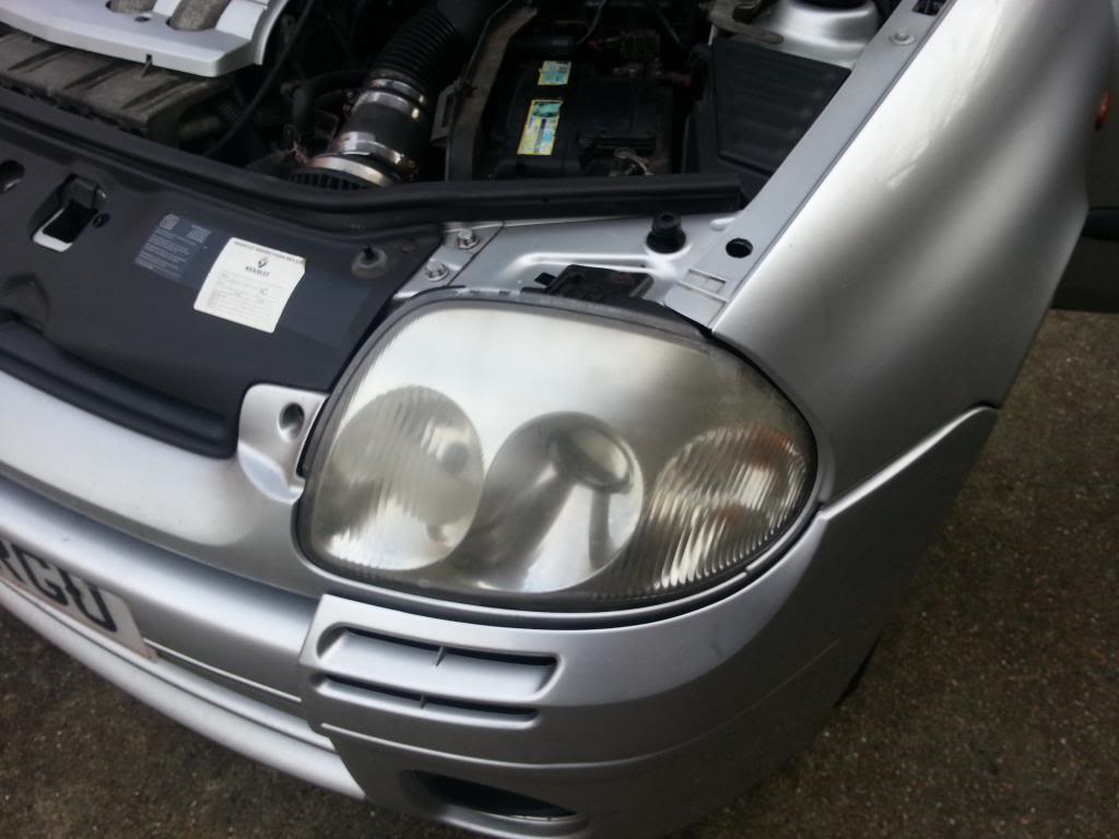

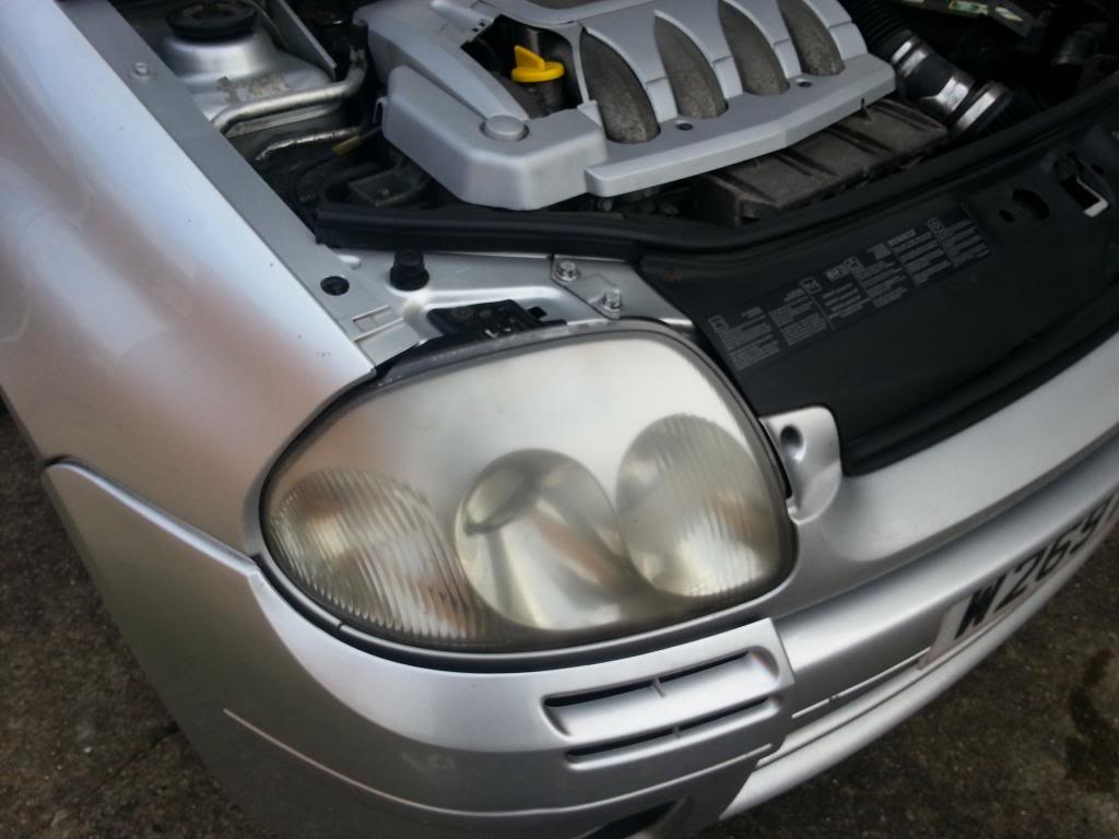

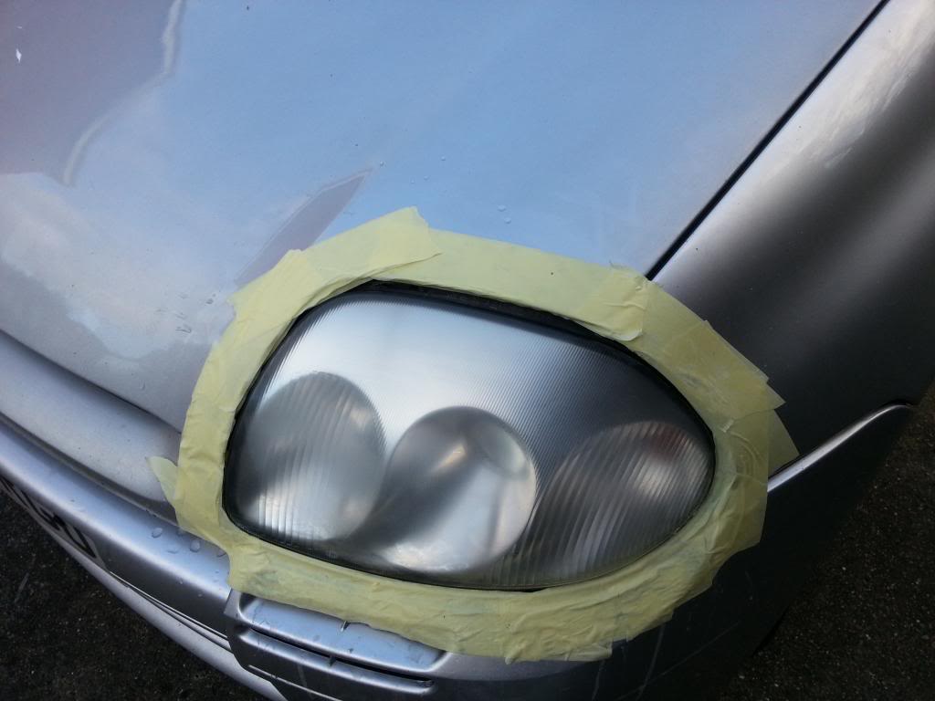

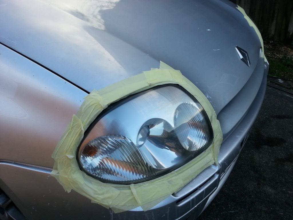

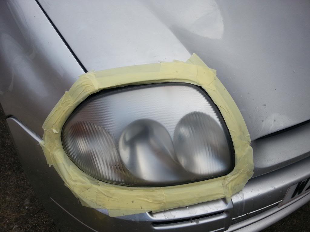

So i got round to doing this today
1500 then 2000 grit wet & dry by hand
Then the below on the rotary
3M Fast Cut Plus
3M Extra Fine
3M Ultrafina SE
I havent sealed them yet, will give them something tomorrow as was getting dark by the time i finished.
Will let the pictures do the talking ;)
Horrible yellow lights
1500 Grit - looking 1000000x better already!
2000 Grit
And after the 3M Fast Cut pass
Very impressed with the results! Drive back home was more enjoyable now i can see more down the country lanes
